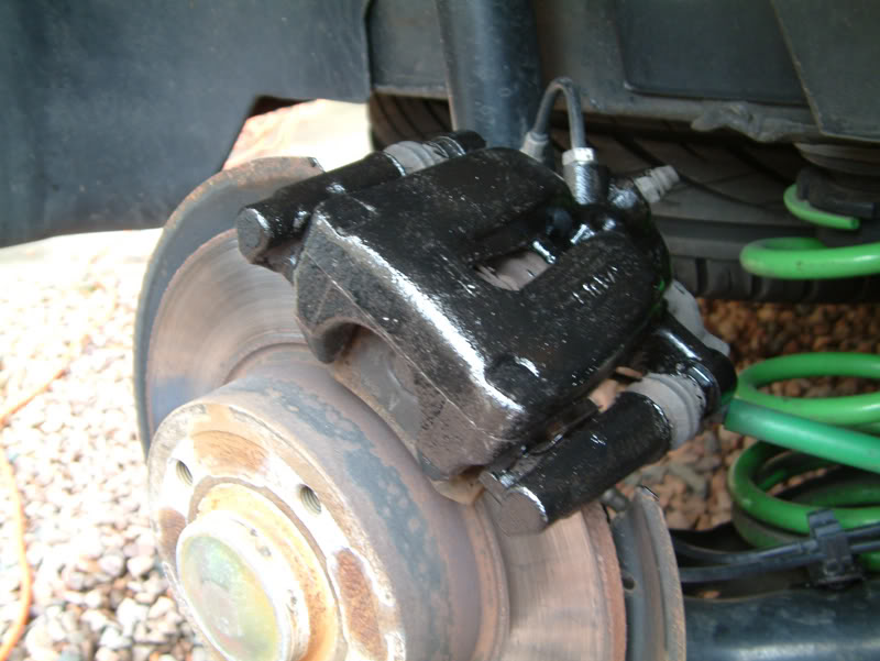

hmm. could be water in the caliper, try a spot of WD40 in the top bracket. My 172 when sitting around does it quite a lot and i sprayed some of that on a treat on the caliper.
  White Sti Hatch
No idea what bit your on about :) so where bouts on the pic if its visible

Got a vid of brakes while i jacket it up in the drive and stuck it in reverse so it wouldent roll away and handbrakes was right down but i could hear noise, the vid will show you waht i mean and it happens on both sides.

Could be that the callipers are very slightly seized?
Does not sound like the brake pads moving as that makes a much less metallic sound.
  PH-QUICK
May be worth getting them off and getting a wire brush and some WD40 on them if it is just a little seized.

Dont have a clue how to do it so not even gonna try rather be shown how than use a guid as kinda depend on the brakes working :boring:
Just spared some WD40 on the calipers so will see if that helps hopefully it will
