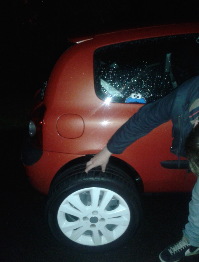

lined up the alloys on the clio, if i dont like the white i was gonna plastidip them matt black, but the white is growing on me
haha knuckles, personally i like them

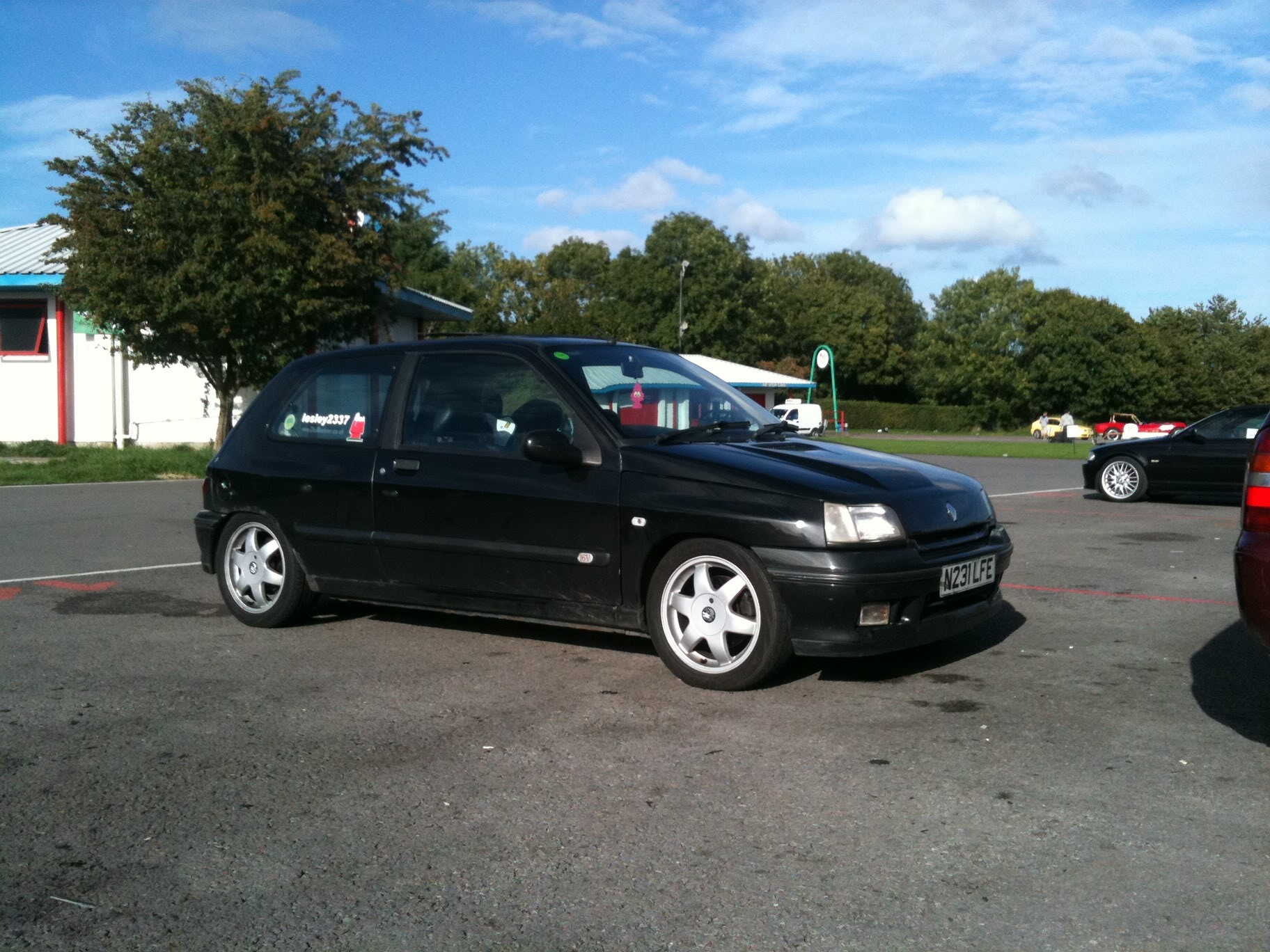

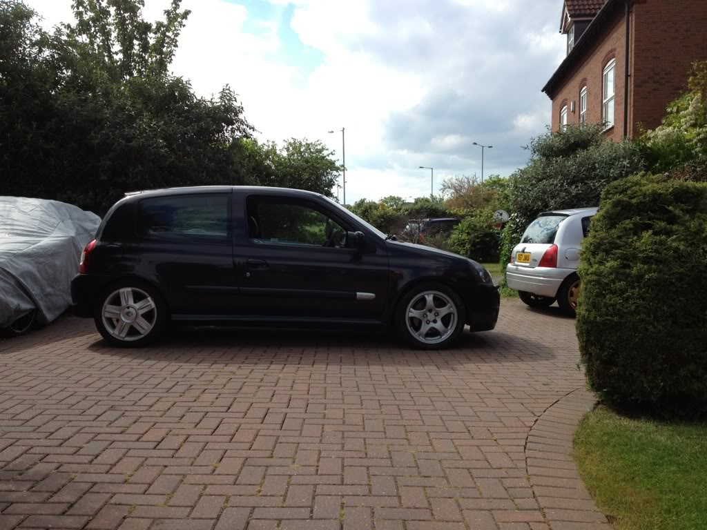

Here are the vauxhall wheels we did, on the mk2 they looked ok, but on the mk1 they looked absolutely epic I reckon.
We also did a scooby wheels one as there is a scooby rim we really like that we were keeping an eye out for (not the ones used in this picture thats just some I had lieing about to try, same fitment but different style), but those were a right pain due to being 5 stud and same PCD, its all but impossible to get right!

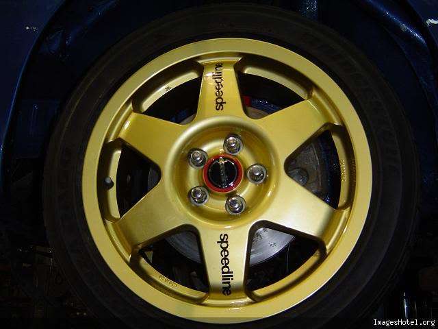

The wheels we were actually making up the adaptor for though were either of these:
(but not in gold)
