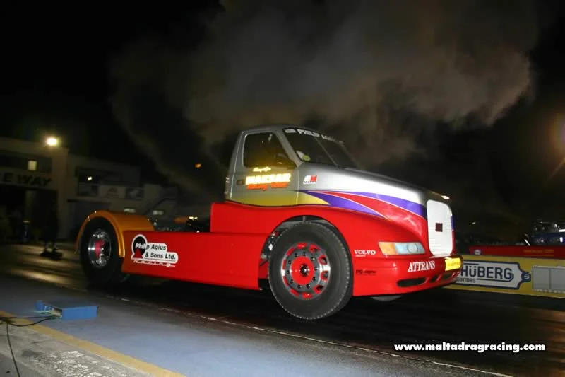

edde, in malta they did a quartermile run with a cummins diesel engine. Had a dta taking acare of it. Pic is here.
Vince
