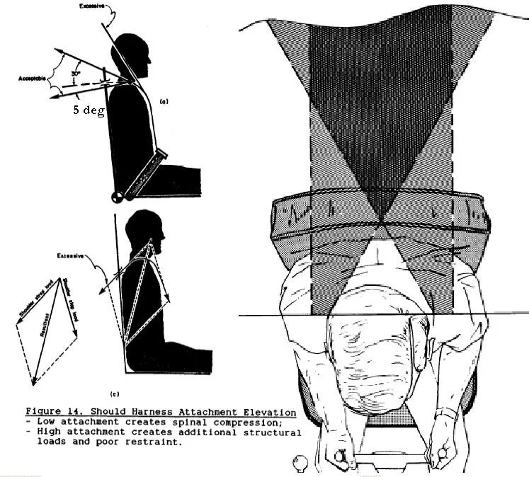

You have to use the rear seatbelt mounting points, or a roll cage with a proper harness bar. Anything else wont be strong enough in the event of a crash mate.
I've posted this picture time and time again showing why those rear belts arn't safe but noone listens they will do you some serious damage in a crash it compresses your spine in massive deceleration.
Idealy use a cage or else use the rear seat belt top locations.
Plus frees up the boot.
The only disadvantage is in a wide crash it will cause more injouries.
What? Didnt understand that. You saying my harnesses arnt safe?
IMO yes. That diagram is what the standard spec are for aircraft and they are designed to be as safe as possible. When I had my harness in that possition you had under hard brakeing you could tell it was pulling me down and back into the seat an in a front end crash it would have compressed my spine causing masive injouries.
However in a side crash your way is safer as that metal shoulnd't deford for ages and tigthen you in your seat wheras mine would have tigthened if the crash has been as bad as to move the rear seatbelt moutn i could have be stuck tigh into my seat its the way it is only safe way is a full cage as that has bars positioned in the right location.

oooh interesting.
i have noticed that pull down quite alot.
Im putting in one of the "caged" cages soon though, so ill get a proper harness bar welded into that to mount them on.
