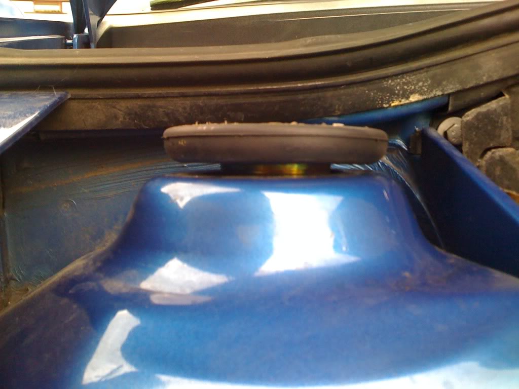

Ok, so trying to fit standard top mounts with FK Silverline coilovers is proving to be an issue.
First off, we accidentally fitted them without the spacer block, (shown below) so after a while they started knocking, as you'd expect.
Second, we got hold of the spacer, tried to fit, and since doing so the top rubber is a mile off fitting correctly.
Picture explanation below of how we are putting them together to see if we are going wrong:
First off, the top of FK. As you can see, there is no allen key hole in the top, but a 11mm nut head instead. The rubber donut is fitted below with the o ring in place.
Next fit the spacer:
Next fit the compression nut:
Next fit the top rubber donut:
Next, tighten as much as possible (but we can't go too tight as we can't get on the nut on the top (it won't go far enough before hitting the metal))
When done up as tight as possible, this is the gap:
The main problem is that this seems to be as far as they can physically go, as metal meets metal, so we're stuck.
Help, CS.

Dude, that looks ok to me.
Apart from less thread at the top with them being different shocks I don't see a problem.
The top nut is only meant to be nipped tight anyway, not super tight.
P.s. It would have been nice To get some Fred tm washers in there but you haven't enough thread imo. Bearings definitely in the right way round?
I just did mine the other night but I'm afraid I can't remember if they were hole or flat side up

No, the rubber donut is holding it in place....
the top mushroom is only to stop it falling out altogether.

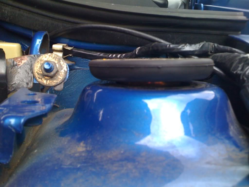

mines like that standard
Yeah but without there being anything pulling the donut tight to the car, surely all that is holding that donut in place is the weight of the car? So it's really going to end up moving around and knocking?
Yours is like that standard? With a gap THAT big??
h3ppy - if you could take some pics of how it's assembled, that'd be amazing.
I know? Like HUGE! I'd heard there was a gap on all of them, but that just looks silly :(

I know you say they're not supposed to touch, but surely there shouldn't be THAT much clearance? As when I go over a bump it's able to just jump all over the place?

you MUST assemble the top mount on the shock first then fit it to the car otherwise the top hat of the coilover might not clear the strut tube correctly, hence why the tap cap won't screw down far enough
there's ZERO wrong with the stock top mounts, better than the solid ones IMO
These were assembled off the car fred, the only thing I did whilst on the car was add the spacer to the setup. I'll give taking the whole setup off and assembling it a go though, I'm a fecking pro at removing/fitting suspension now.
Cheers mate.
If they still don't go tight, then surely solid ones are better? As that much clearance can't be healthy?
its fine, they don't go tight as in clamp down on the body, you wouldn't be able to turn the steering
MAKE SURE the top hat on top of the spring is seated on the strut tube correctly, you'll see what i mean
Will do mate, I know they don't clamp down (I've seen you mention it many times before), but as you can see in the pic, I can get my finger in the gap! Which to me doesn't look right.
I'll get them taken apart tmrw evening and see where I get.
Muchos gracias for the information so far, I'll report back with further issues... lol!
