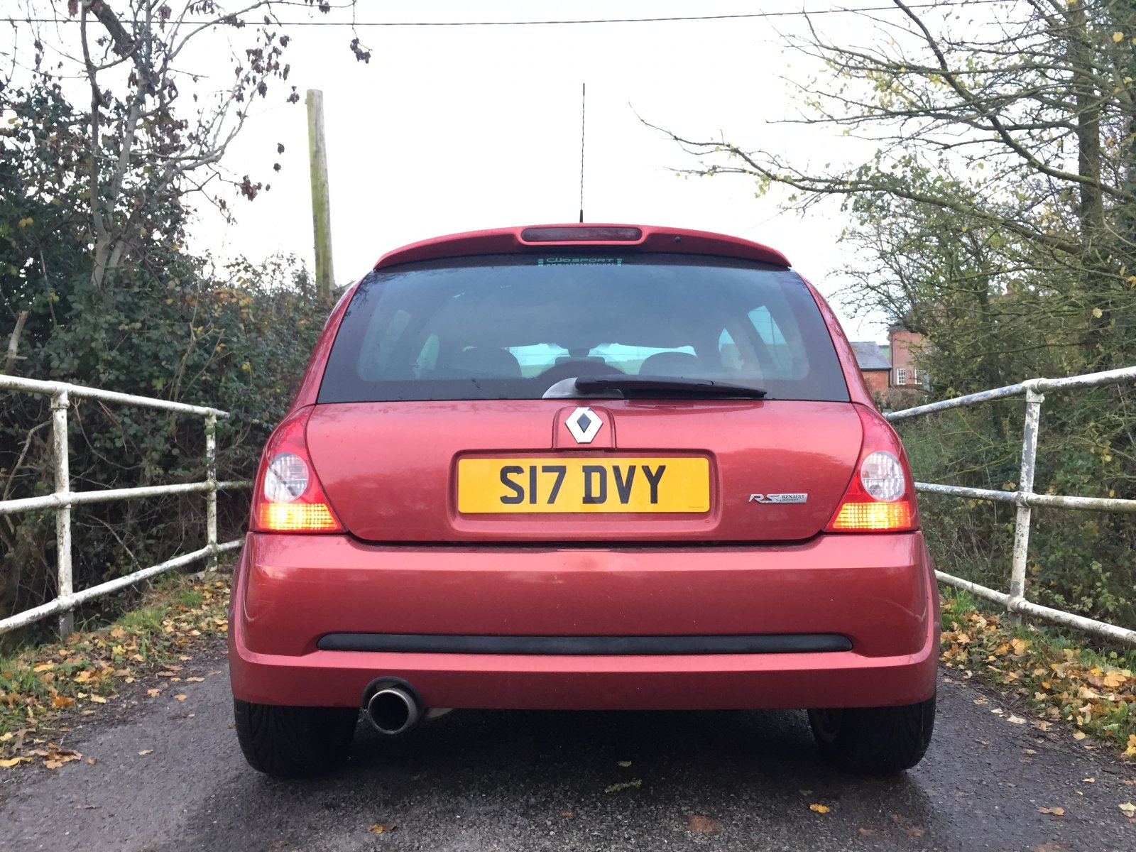

At the moment I have the Ktec Stealth system on my cup and as you all know you get that booming drone on motorways etc doing about 80 and this is caused by the sound bouncing back up under the car.
So im thinking of cutting the rear bumper to fit an exhaust trim and then cutting off the tailpipe from the stealth to fit/weld a normal tailpipe,ie 2.5inch rounded style tip,so my question is has anyone done this before? and did it actually stop the boom/drone exhaust??

Oh ok mate.i see you mean now.Yeah that does look good,but i might try @bloke idea and just cut the tailpipe a bit more so it aims more out of the back and see how that is as i would ideally like to keep it looking stealth.
  dan's cast offs.
did it on the wife's car, was awful with just back box, chucked a middle box in and was loads quieter. with the tail chopped it's a lot quieter in the car, above about 85mph it's quiet to say the least!!
MrBlonde
Sounds good mate,ive got the quieter system so already have the centre box,but will defo cut the rear tailpipe to 45 degrees and maybe take 1cm off the length :up:

I don't really want to spend any money as i like the exhaust and theses nothing wrong with it apart from the motorway drone noise at 80,but im going to cut the tailpipe at an angle so its not directed at the floor as this is way it drones because the sound bounces back up under the car rather than away.
