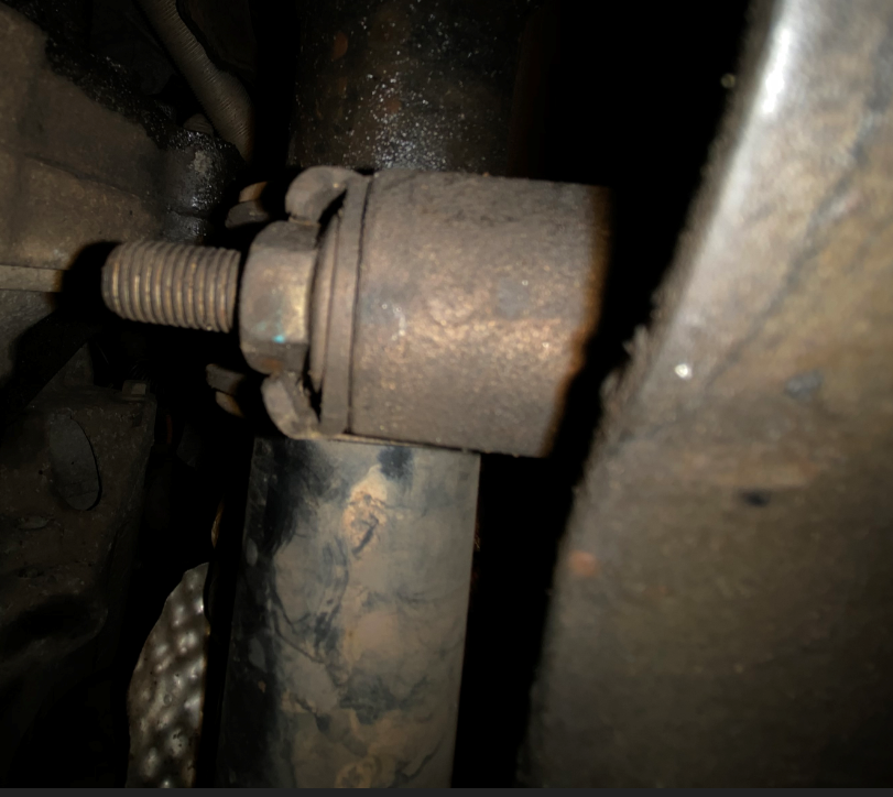

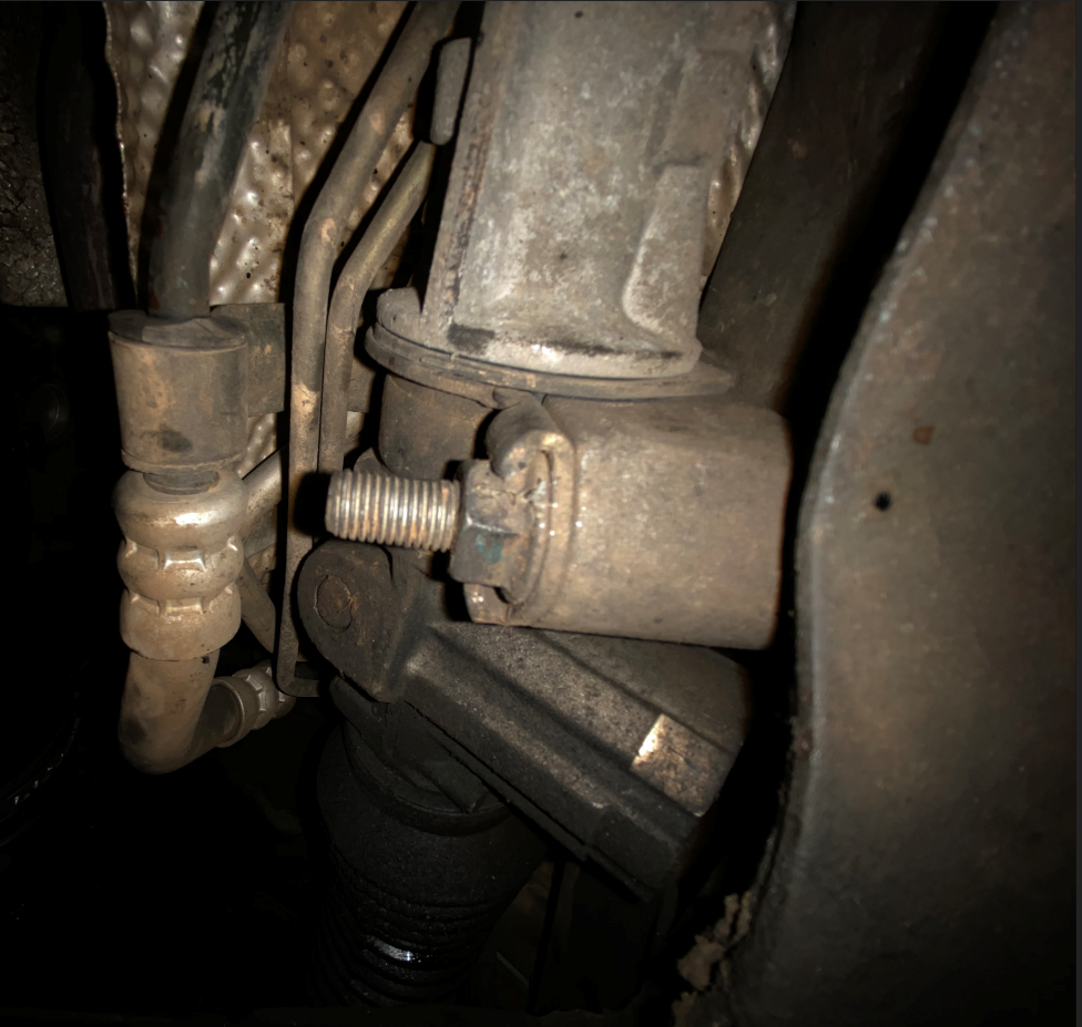

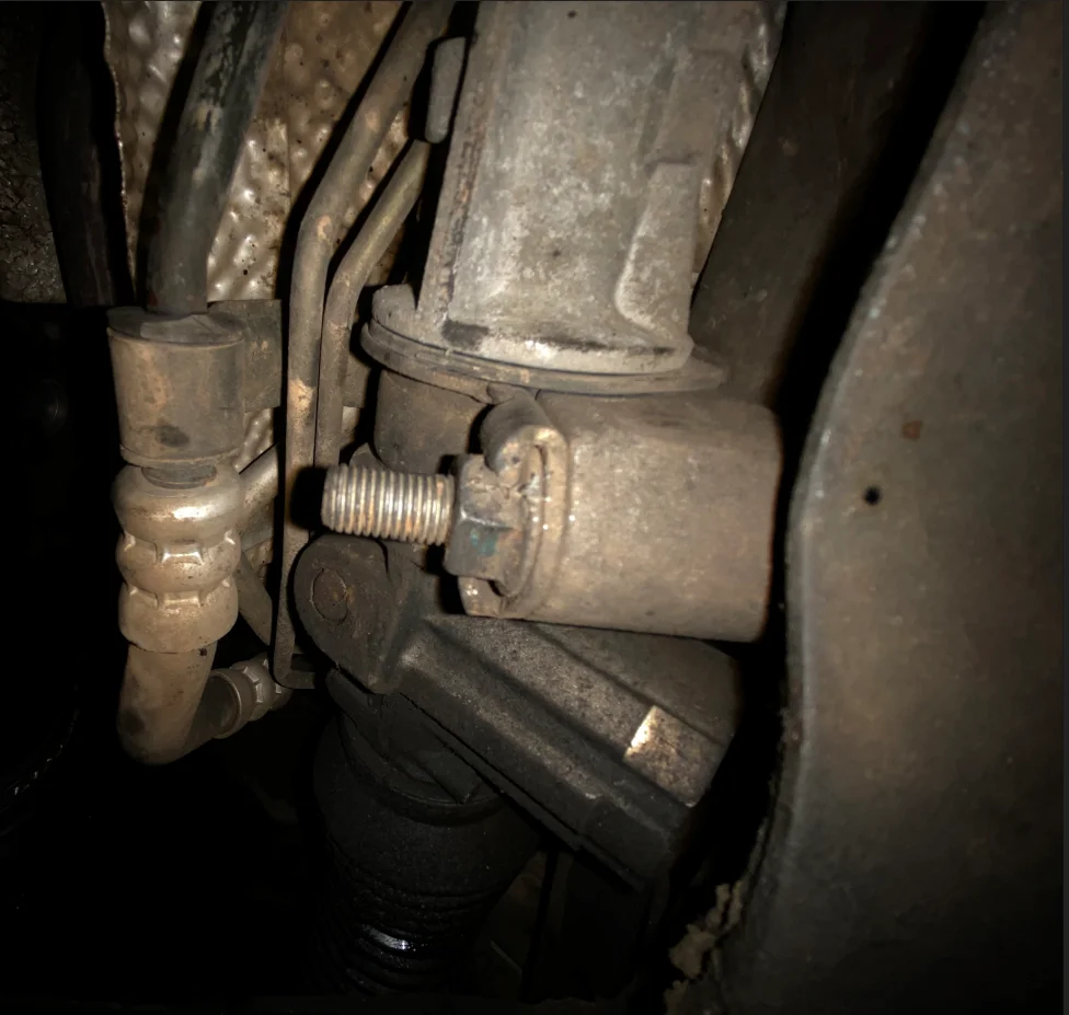

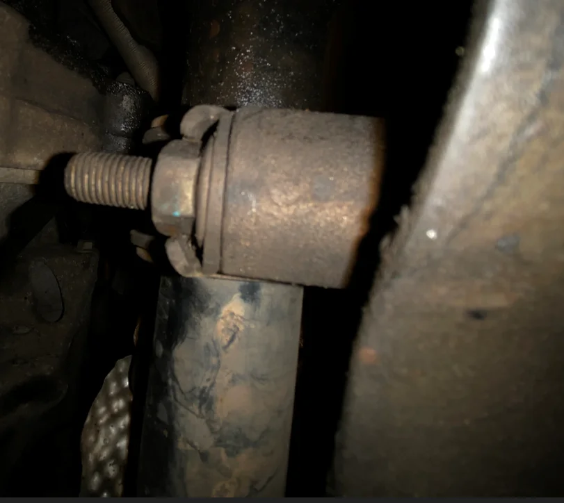

I have a set of Powerflex steering rack bushes to fit as there was an advisory on the MOT i've just had done that the bushes are worn. Jacked the car and crawled under today to have a look and found what I think are the clamps and existing bushes, but if I have the right culprit I have no clue how I would get the nuts off as they are surrounded by a shield that wont allow a socket/spanner on that I can see. I've taken some pics as best as possible to show what I have found. Any advice would be grealty appreciated. I have seen there are some other threads, but cant find a how to guide. Apologies if there is one and i've missed it. Thanks :)

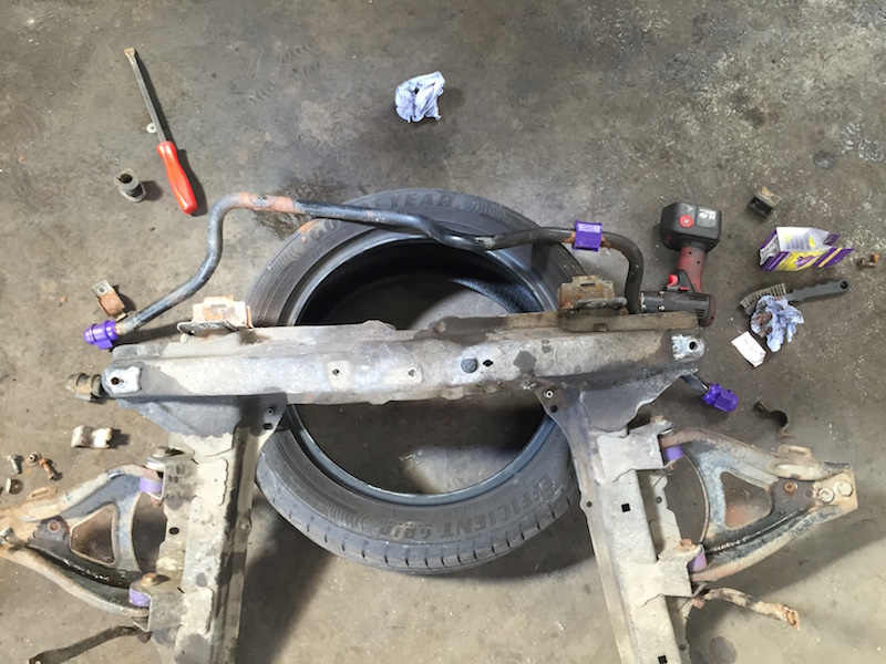

I got the garage to drop the subframe and do the lot as I believe they can be a pain in the back side.
On the back of the subframe there are holes for a deep socket to get onto the head of the bolt that goes through that clamped nut.

Aha! Thanks so much for this. Would you know what size the nut is in the recess please for a deep socket?
As above, 16mm on the backside of the subframe. They're a bit of an arse without a few extensions, I changed the rack in place on my old dCi and put a dCi rack on my 172 without dropping the subframe but I took the engine out so I could literally sit in the engine bay
Also, one of the bolts to the clamp which goes to the subclframe can't be accessed via a hole and deep socket, I believe it's the upper bolts, you will need a rachet spanner unless you want to spend hours with a regular spanner as you can only get a few mm of movement each time and there's a lot of threads lol

Got to the top 13mm nut on the passenger side with a 13mm ratchet spanner, however there is a bracket that when I slide off appears to reveal a 2nd nut that I am struggling to see to get access to. Is this right?
Also on the drivers side I can’t figure a way to access the top nut with a spanner. Can’t even find an angle where I can see the nut as again there is some kind of bracket up there there appears there may be a recess in the bracket that might allow a socket on, but I’ll be damned if I can work out how.

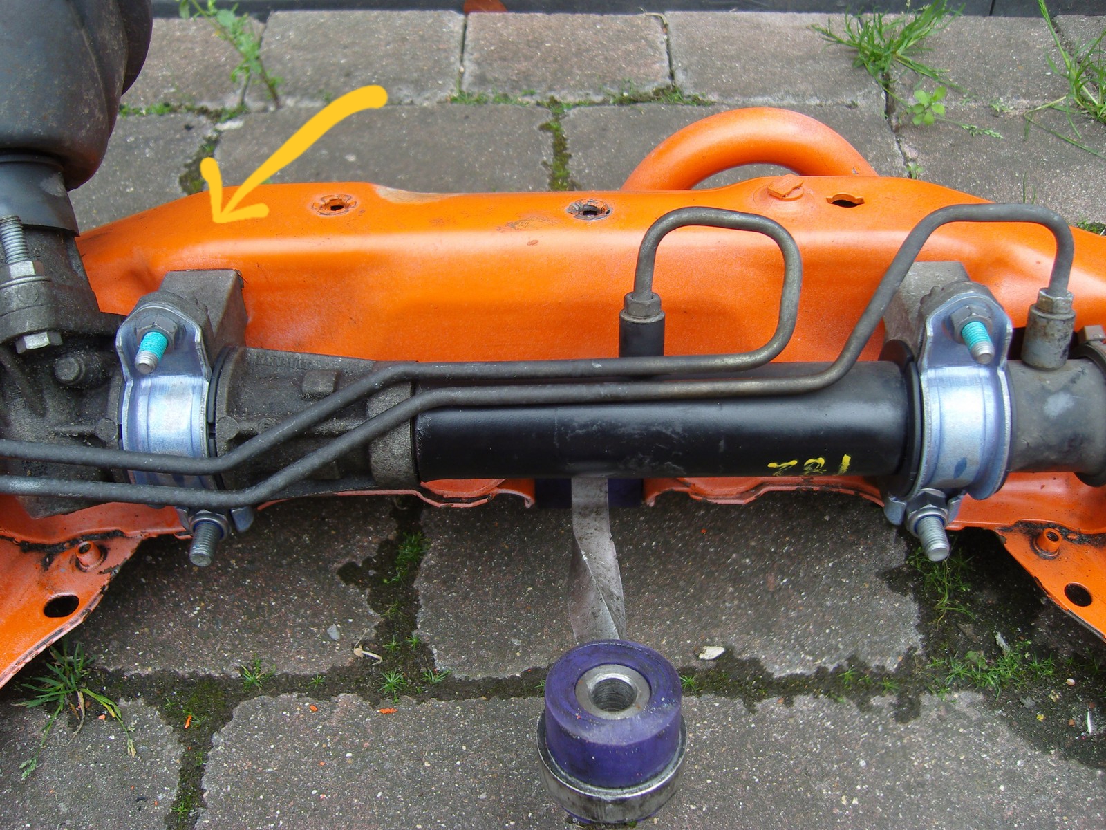

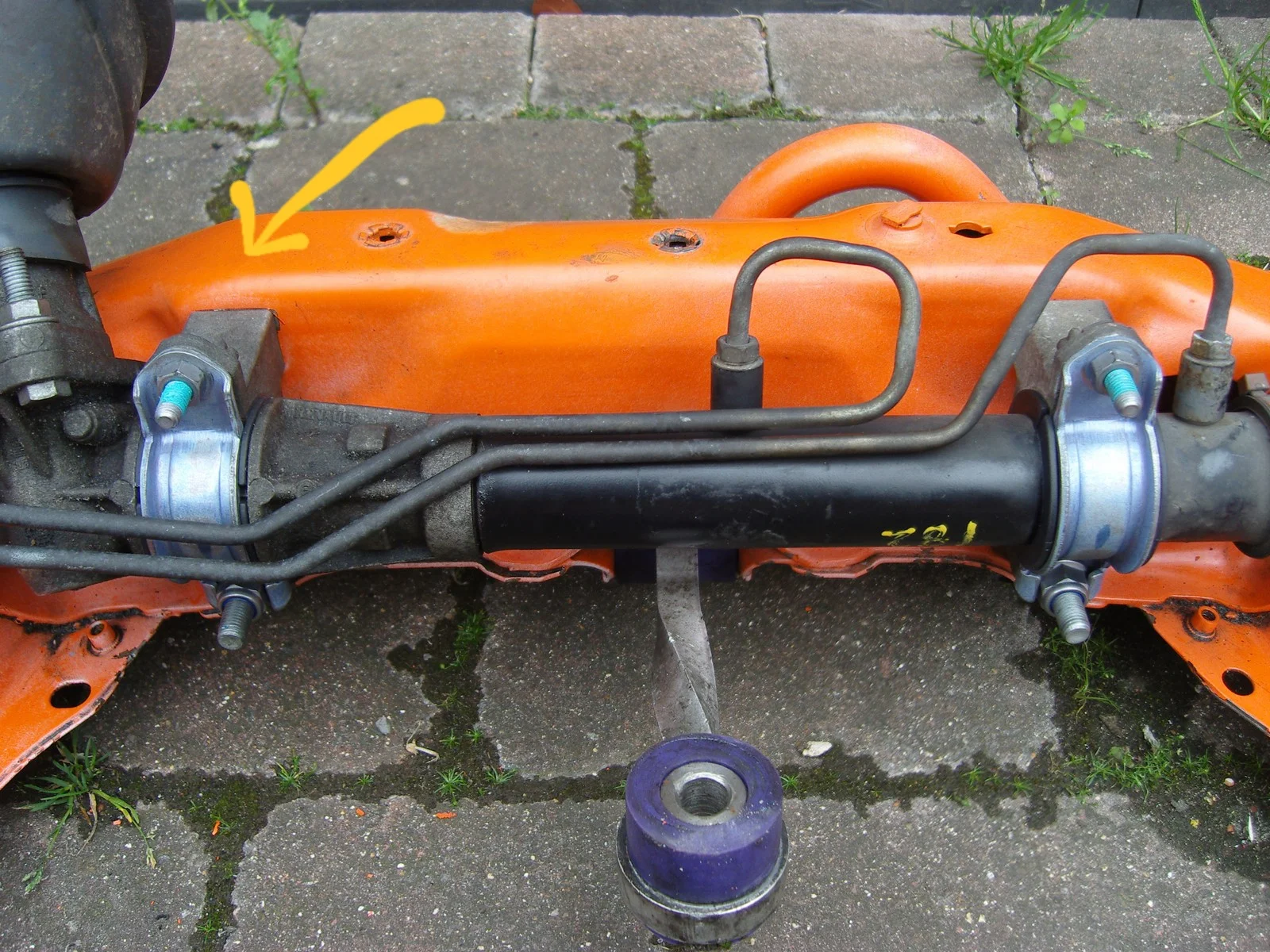

Take a look at this pic and itl give you an idea, it's the bolt which clamps the front of the clamp to the main bracket which you have just unbolted from the subframe and squeezes the bush in place.
With those 4 main bolts removed you should now be able to wiggle the steering rack about to get your hands in lol.

The upper ones are what have me confused. I’ve removed 13mm nut on the top on the passenger side. There was a separate bracket behind that nut. I pulled that off the thread and moved it as clear as I could, and there looks to be another nut behind it that is holding the steering rack bracket on for that side. Is it normal to have 2 nuts on the passenger side upper bracket thread?
As for the drivers side, again the pic you shared doesn’t include the weird bracket that is blocking access to the upper 13mm nut on my car. I can try to get some pics if it helps?
Yeh the extra nut on the passenger side you mention is holding on a bracket to secure the pas pipes I believe from memory, remove that first and then you can get to the nut you need to shift to get the bush out
I can't remember anything being in the way of the driver's side upper bolt, I remember it being a pain and needing a racket spanner but can't think of any reason you would be able to get at it with a spanner.

I think you've missed the other 2 large bolts securing the bracket to the subframe. They sit inside here

Nope, if you look at where my arrow is pointing they are in there.
