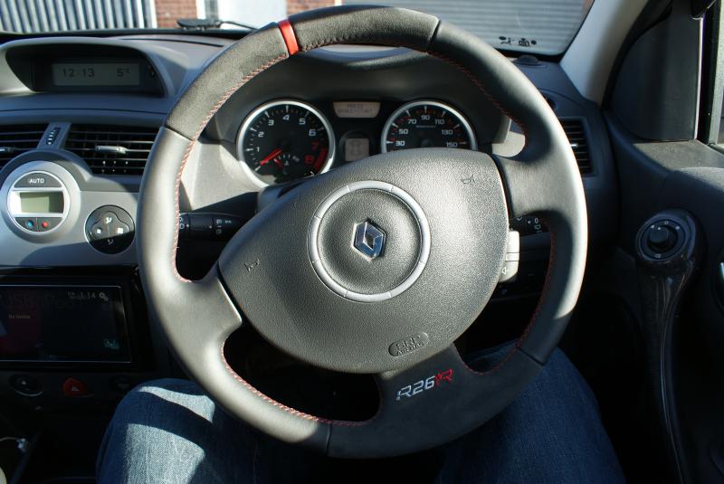

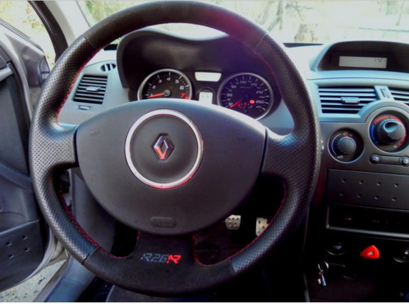

Received my re-trimmed wheel from Snappy yesterday (Thursday), incredible turnaround and service, only posted it off to him on Monday afternoon! Quality is outstanding, cant wait to get it fitted over the weekend, such an improvement over the original. Was also kept updated with pics of the work being carried out which was a nice touch, cheers @snappy !

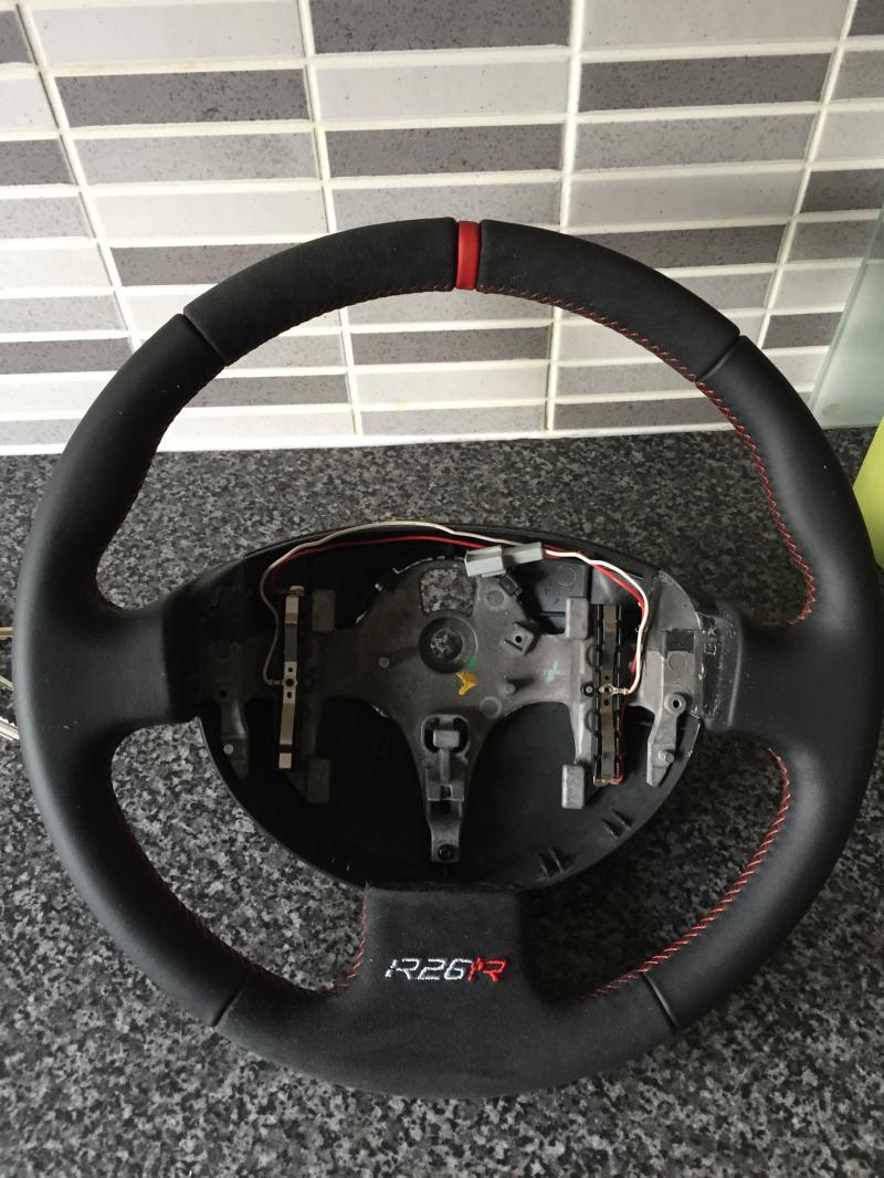

Are those "R,s" supposed to be like that?
The white R looks like it has a bit of stitching missing, and the red R looks like it has chicken pox?

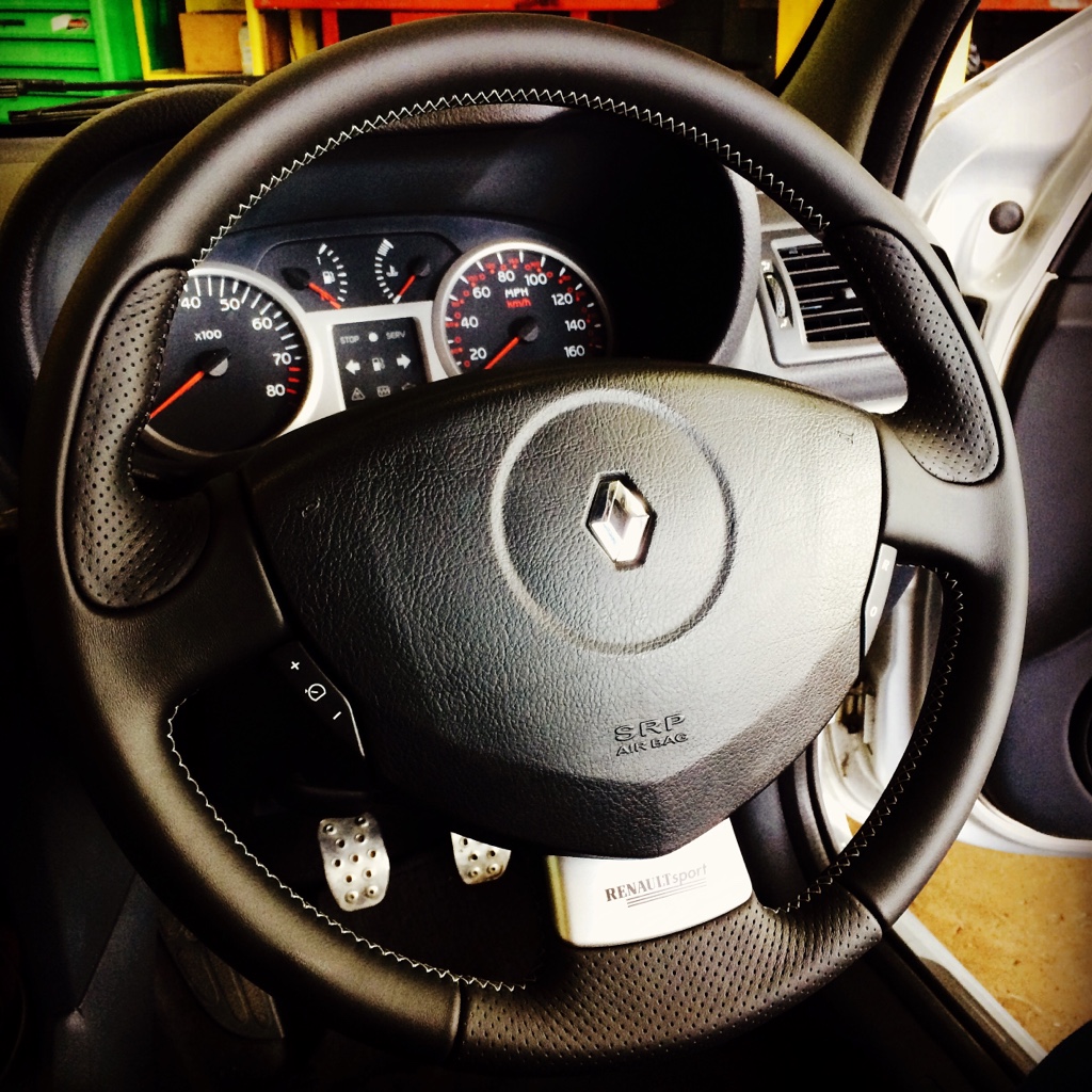

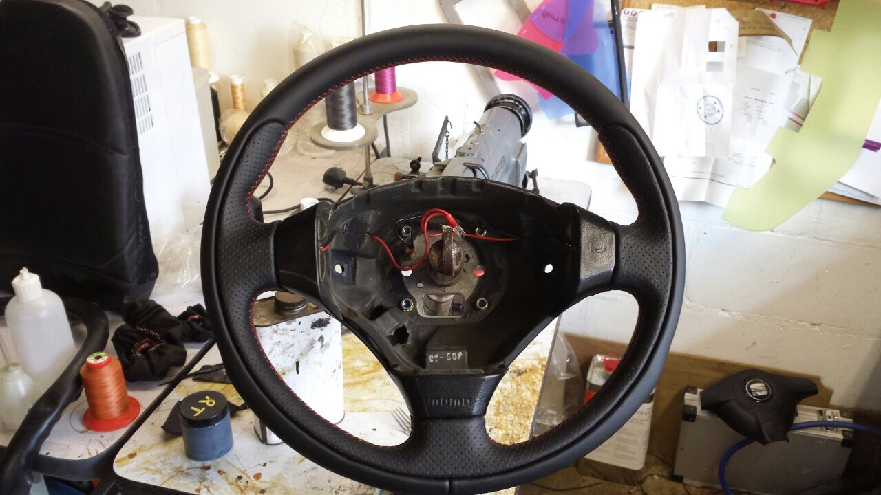

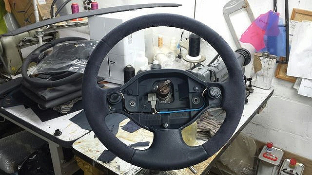

Snappy sent me these yesterday, what a great guy and very very good at what he does.

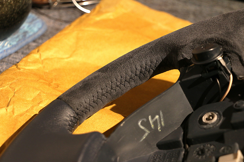

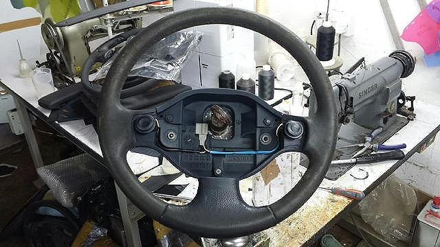

I wanted my PH1 wheel made thicker so Snappy had to trim it twice.

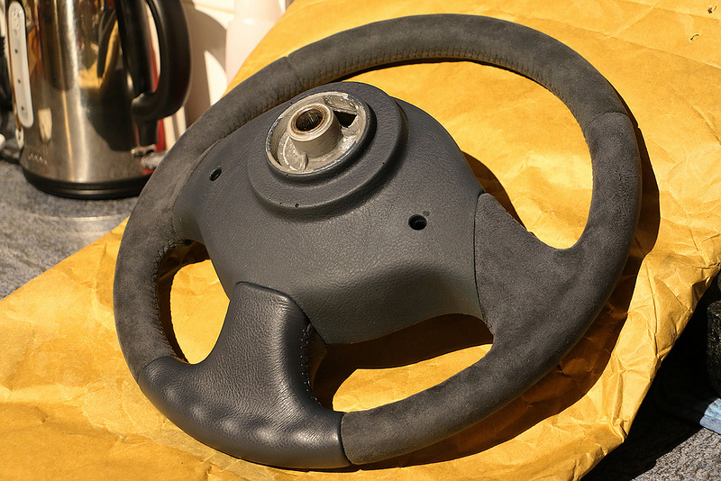

The wheel i sent him.

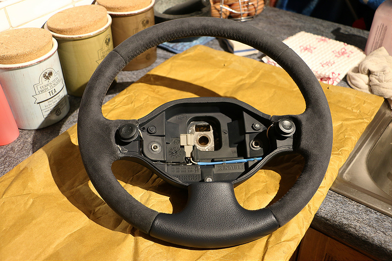

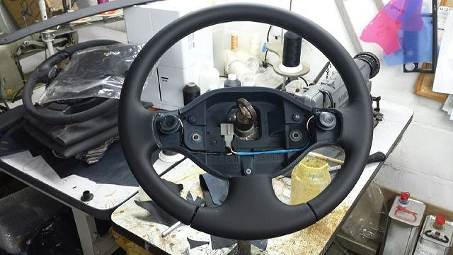

1st layer.
Untitled by scottieraven, on Flickr
All done, ill get some better pictures once i get it back, should be early next week.

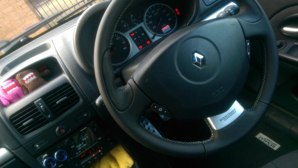

Got my Snappy wheel today, great service and quality workmanship.

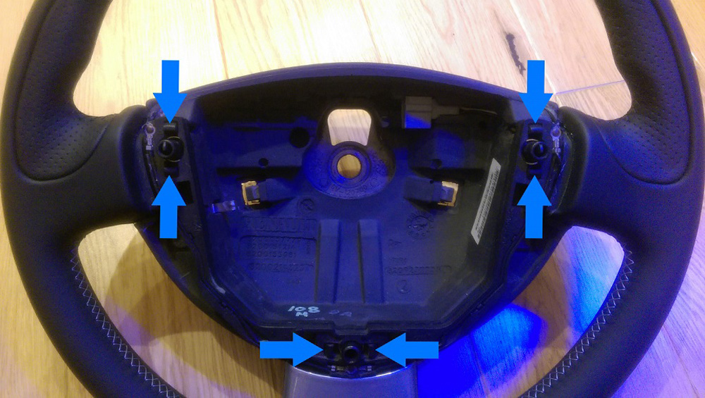

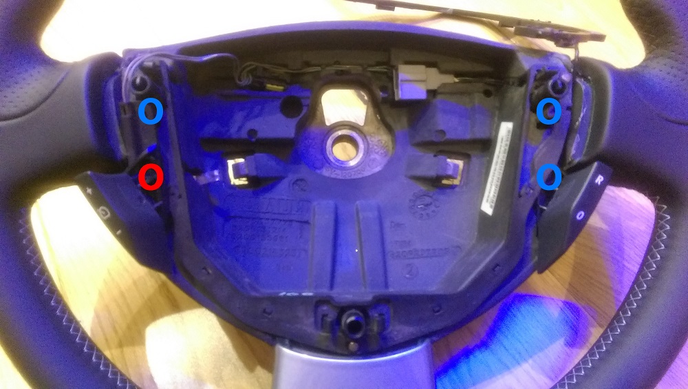

Done a quick guide on swapping over the cruise control buttons:
Step 1: Squeeze the 3 clips in to release the frame, move to the side and take out the springs
Step 2: Each button is held in place by 2xT20 screws
Bottom ones are easy enough but for the top you need to push the steering wheel in towards the middle to get access.
Note: make sure the metal tab is in place before screwing the screw marked in red (not sure what that's for)
Step 3: Slide the wires into the grooves
Step 4: Put the springs back in and clip the frame back on

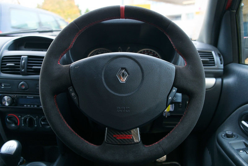

Hopefully this isn't akin to mentioning Man U on a Liverpool FC appreciation thread, but I've just got my wheel from Jack @ Royal Steering Wheels.
I've never been a lover of the Clio thumb grips so didn't want to retain them after a retrim hence why I decided to go with Jack rather than Snappy.

Royal steering wheels always look crap imo
Just basically wallpapered over the s**t underneath. Skill in the work i just think snappy does it properly imo

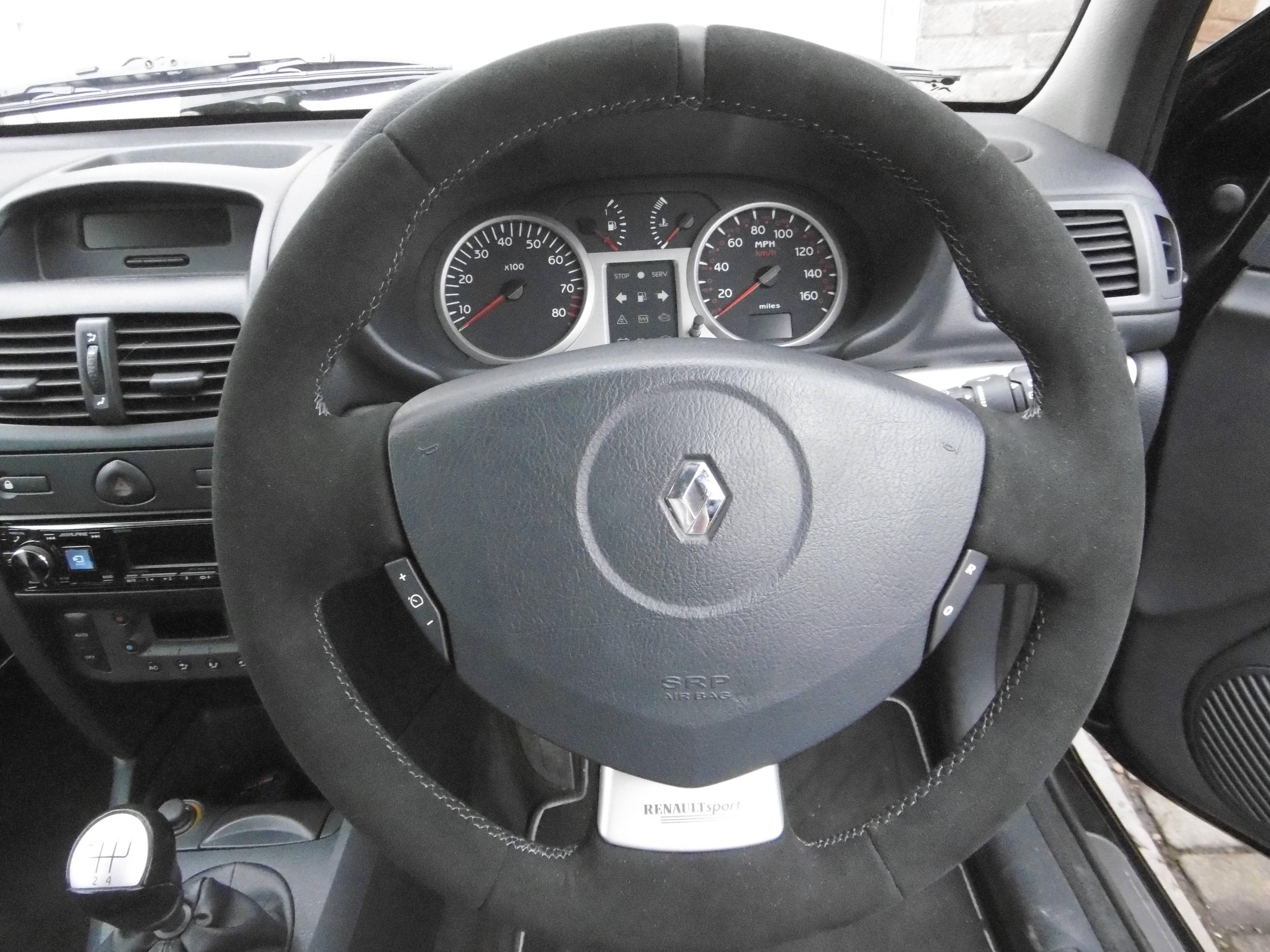

Snappy ones are very nice and look more oem. I guess its what you want from the wheel, I wanted a much thicker wheel finished in alcantara so had Jack from Royal do it. The feel of this wheel is lovely.
The above is mine but got the idea after trying gambits wheel in his trophy. the below wheel is gambits:
