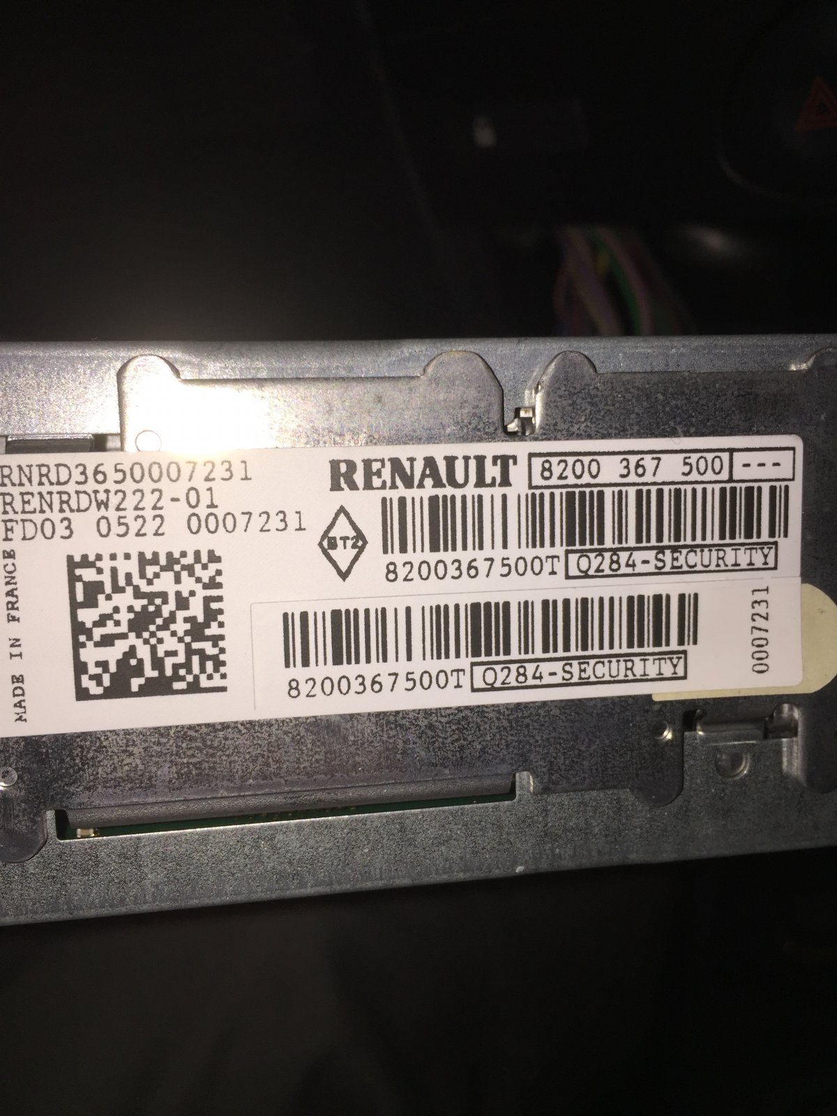

If you need the code for the stereo then I can help you out with it, just need a picture of the bar code etc on the top of the headunit itself.

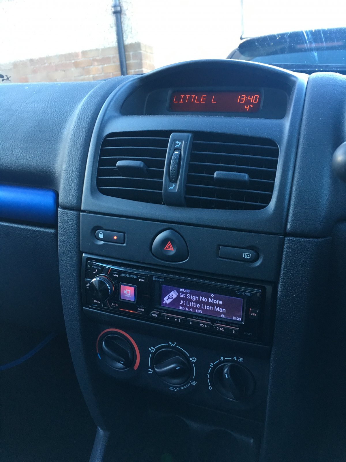

Recently bought an Alpine CDE-178BT along with the Alpine APF-D101RE Steering Wheel / Interface Adapter and it all works well for a tunerlist setup and can recommend it.

That's the info from the current head unit Chris. Any assistance would be welcome.
A couple of other great replies folks. Brilliant thanks.
  Clio FF 182
Chris, it worked a charm mate. Thanks a lot. Passenger front speaker isn't working though but a good chance that's a wiring issue at rear of head unit. Further invest required...
Can you stream radio stations and music (from apps like spotify etc) from your iPhone to the head unit?
  Listerine & Poledo
In many cases if you fire up spotify, or even YouTube, on your phone when it's connected, the head unit will play that back.
