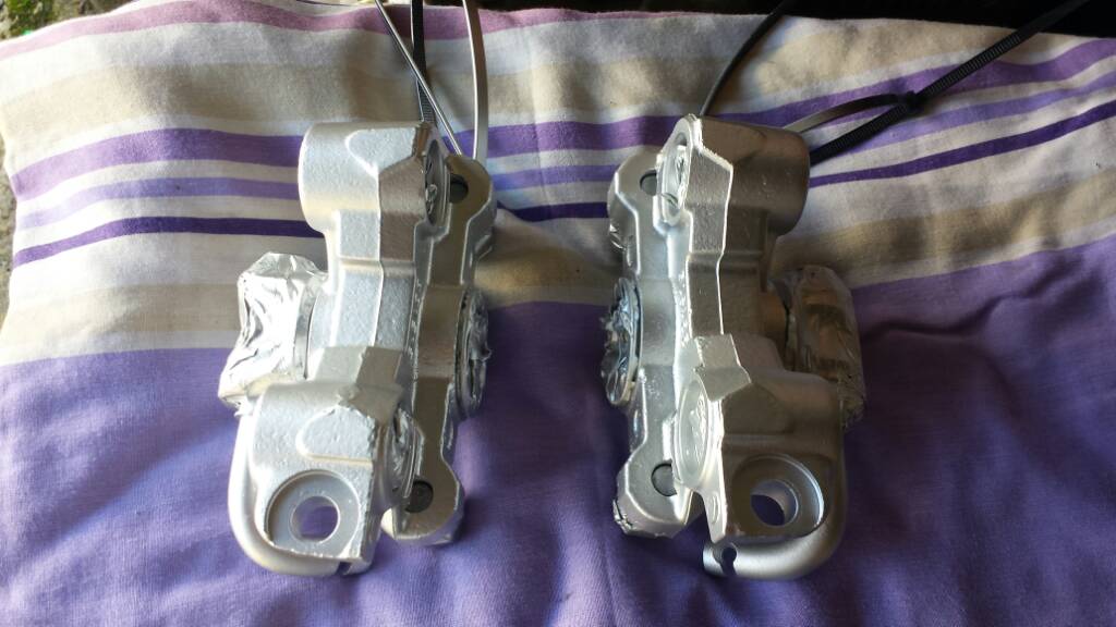

I got some Bigg redd refurbed calipers off eBay a few months ago. Not sure if they are still on there but they were £70 for the pair. Brand new piston, seals, stainless bleed valve etc.
It's £109 to have both front callipers refurbished by bigg red, either electroplated in silver or gold, usually a 3 day turnaround, that would be the option I'd pick, the callipers from ECP etc don't include new slider pins etc
Does the big red one include the caliper carrier too then?
I'm sure when I looked yesterday it didn't, only the actual caliper.
