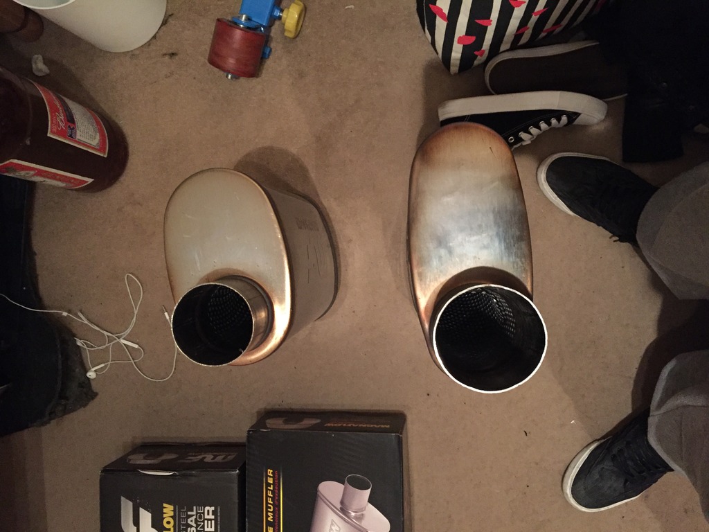

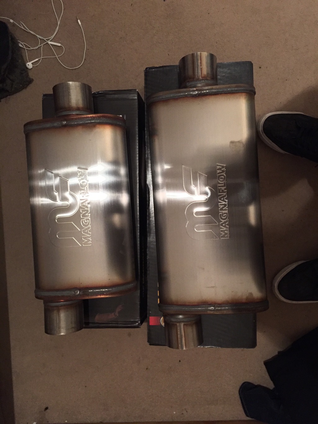

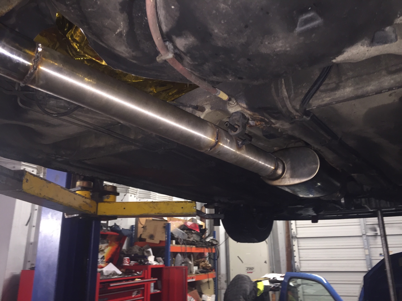

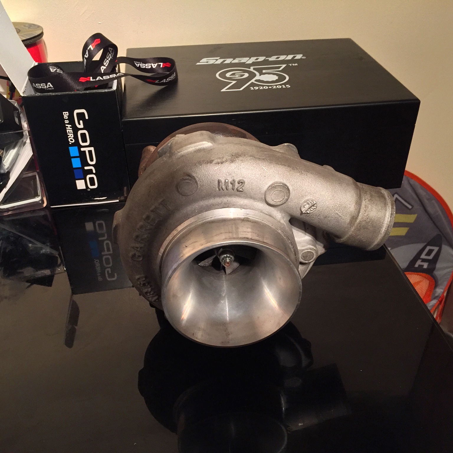

The last silencer has arrived just need to find time to build the exhaust now.

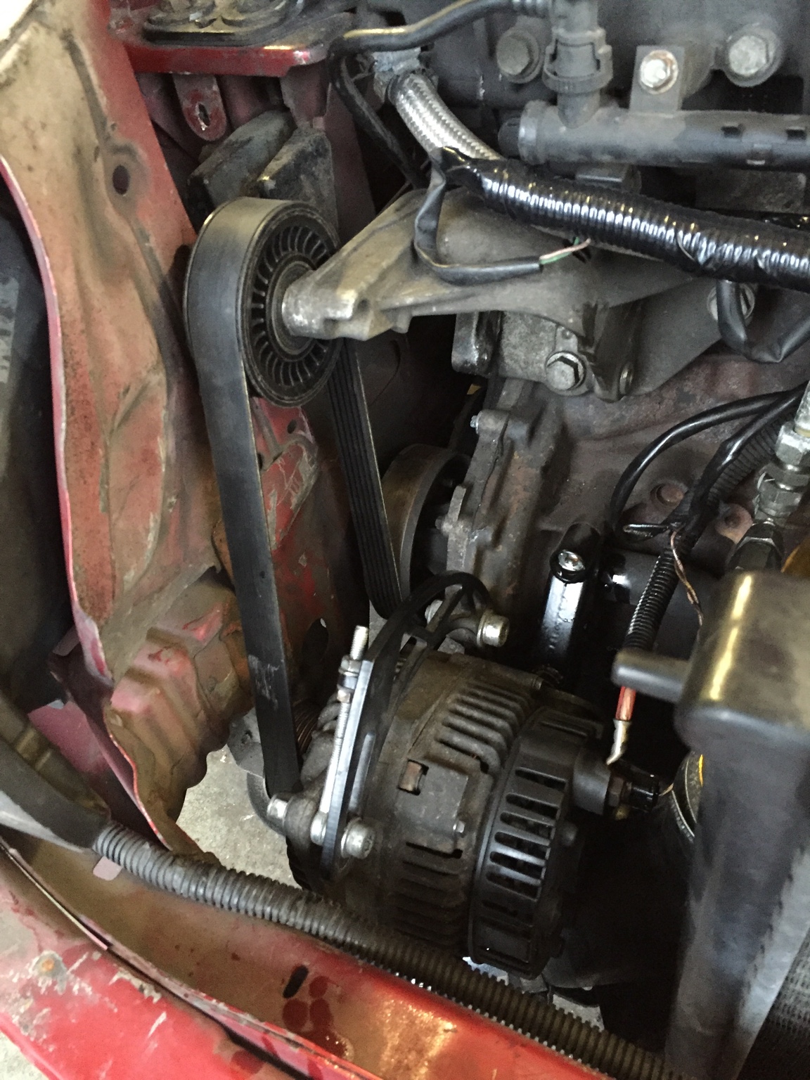

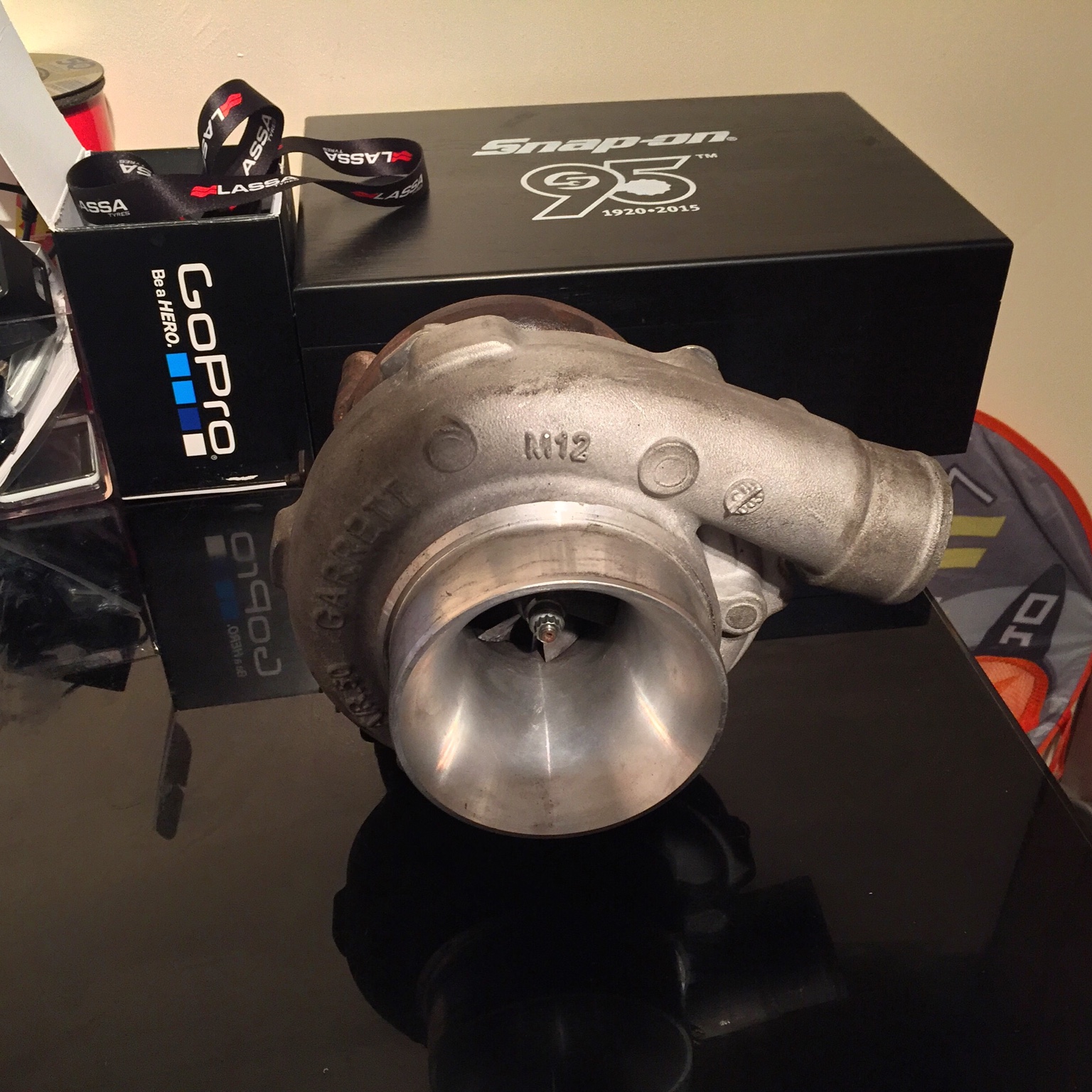

Thanks to dan@sjm I now have a gt3071 turbo, I have started ordering parts to make my new manifold. I also have a epas conversion I just need to get a new aux belt. I will also be deleting the abs which should give me enough room for the turbo View attachment 141701
A very nice project build mate:up:I really have enjoyed reading your journey with your Clio this early morning:smile:But....I think that the turbo choice "gt3071" that you have made is going to be a lag monster and that's coming from experience....I ran one on my 2.0 litre Subaru which has AVCS heads a free flowing turbo back exhaust and the lag that I was getting was out of this world:fearscream:,it completely ruined my car and was quickly sold on for a GT2871R turbo which was a match made in heaven with the 2.0 litre Scooby.Saying that the gt30 had a good top end but I didn't fancy waiting a day for the turbo to get on song,the fact that you do track days I would have thought that you would of preferred a more responsive turbo that spools up earlier but still has a hard hitting mid/top range?Just my two cents:cool:.Keep the updates coming...SJ.
Cheers[emoji38] the gt30 turbo came has a gt28 exhaust housing so the exhaust side so spool shouldn't be that bad,but I know I will get turbo lag. on a 1.8t it was making boost at 3800
LOL Yeah the smaller exhaust housing should aid with spool up a little...but as the physics show:wink:you should fit the smallest turbo for your desired top power level.Just make sure your in the right gear with your right foot planted with the gt30,as you should know mate big turbos need feeding:up:.SJ.

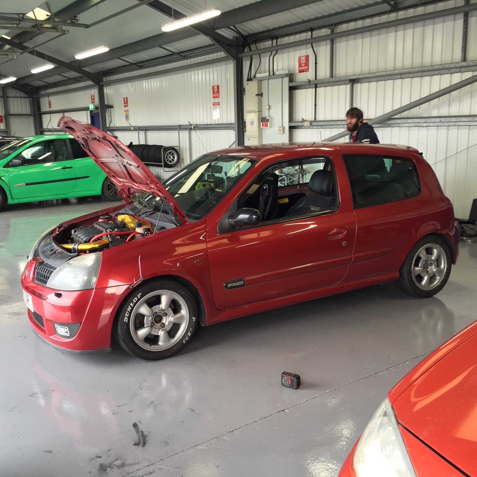

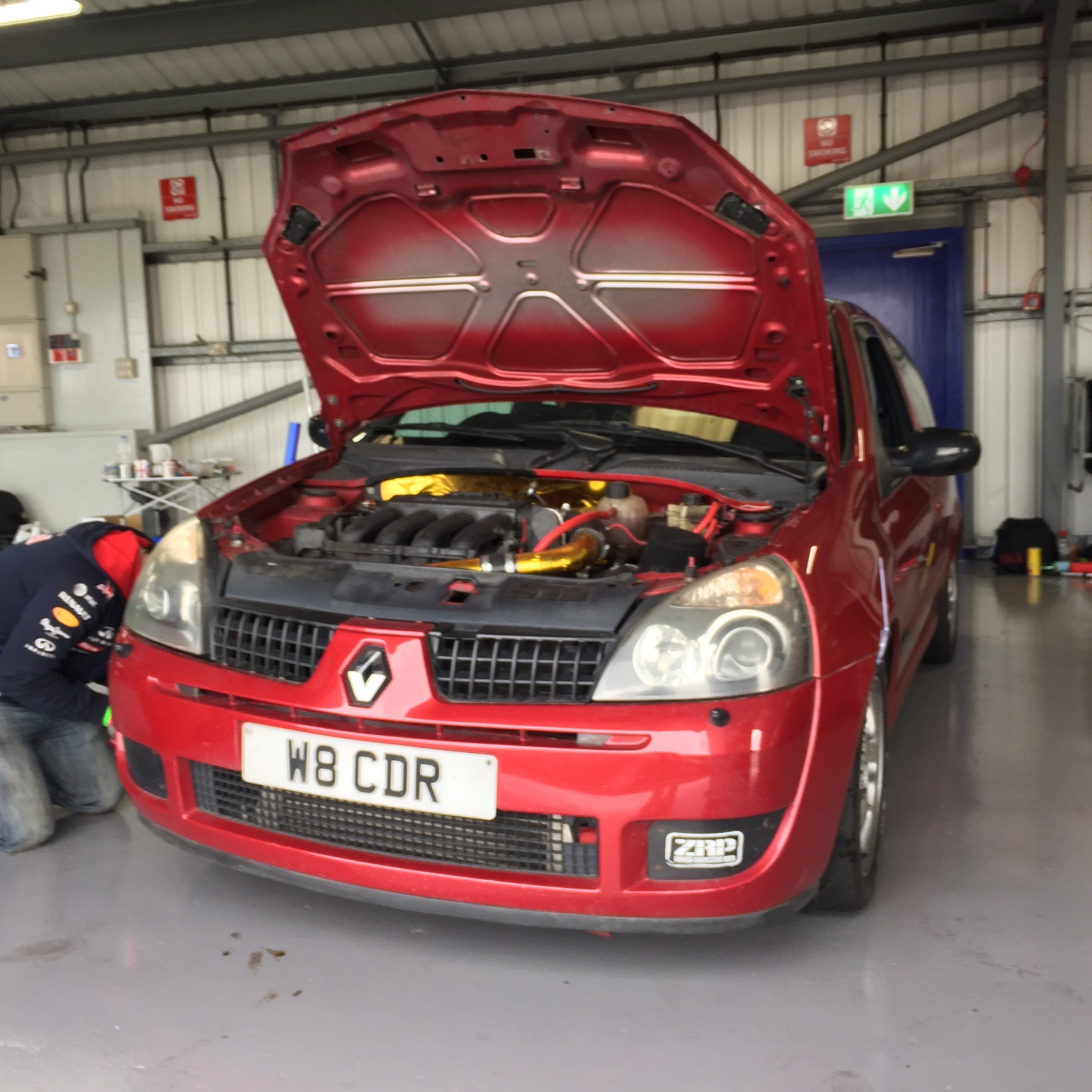

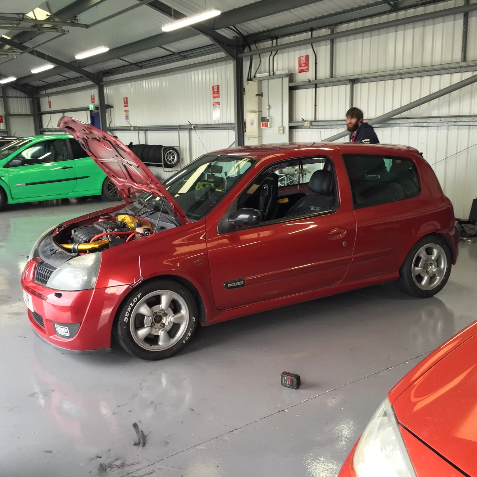

So we had a rolling road day at work today (Tsr performance ) so it was rude not to put the Clio on. The car made 300bhp and 326lbft which is less than it made at mtec. Had a couple issues with getting it to grip in the rollers and I was losing boost in higher rpm. But was a good day

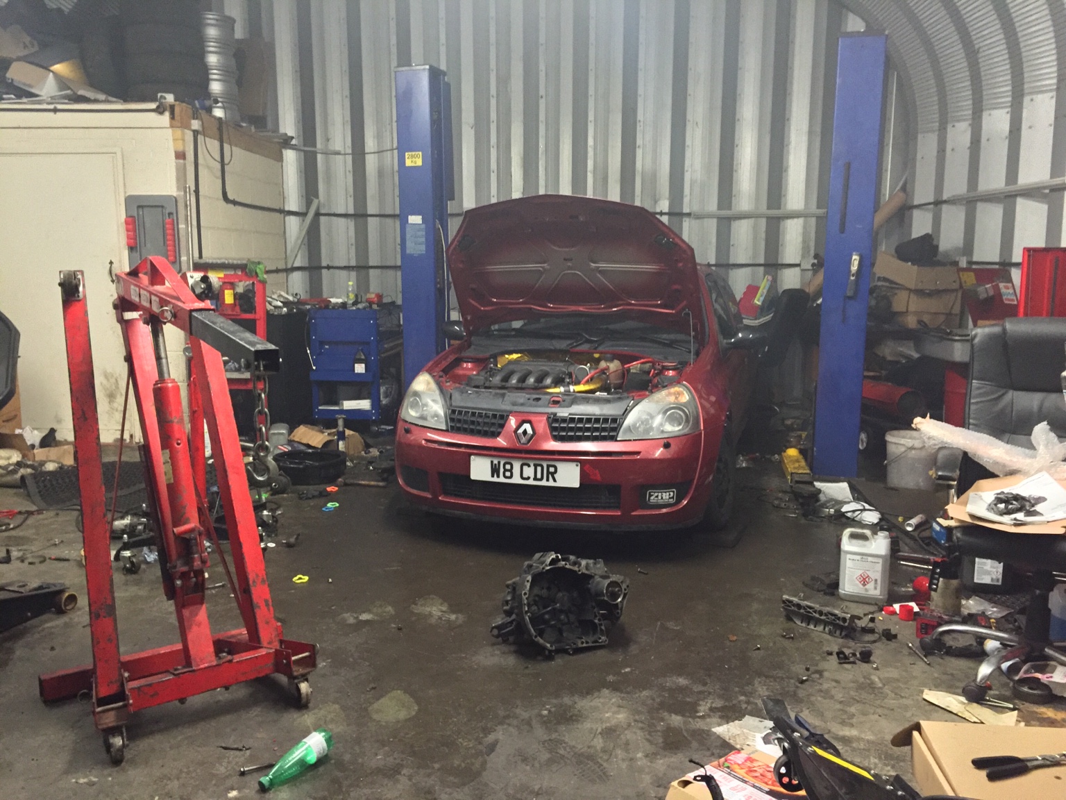

For the brake issue I will be changing all of the fluid and I will be moving the turbo over the gearbox so will no longer be next to the brake lines

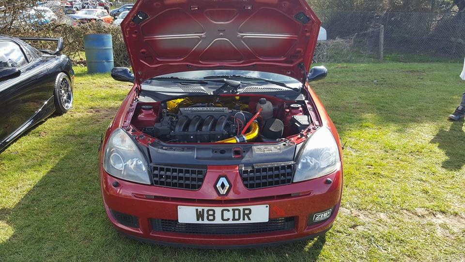

Yea the manifold above that I'm making I still need to finish and hopefully fit over the bank holiday weekend

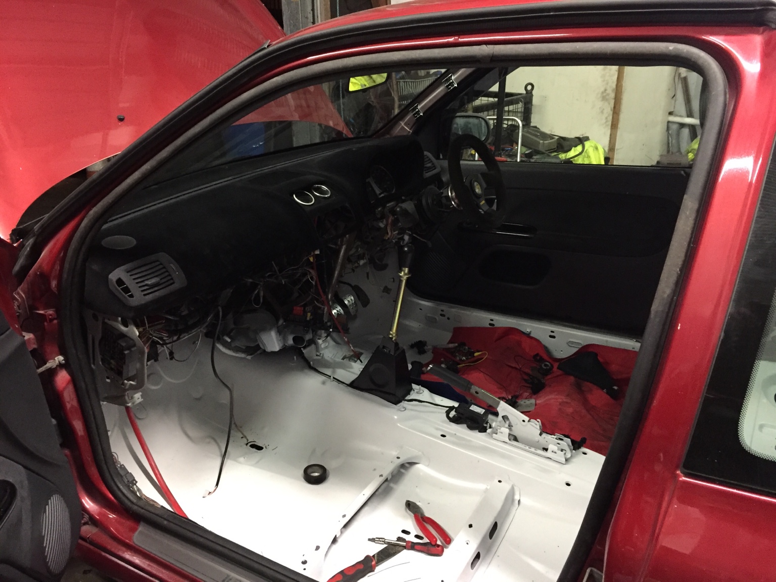

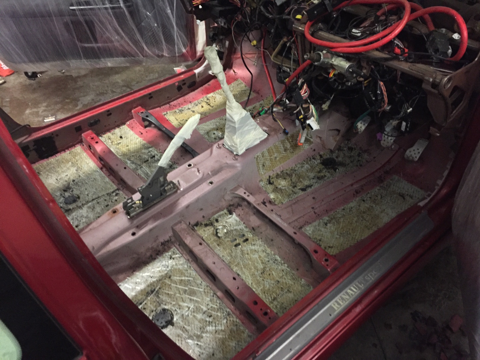

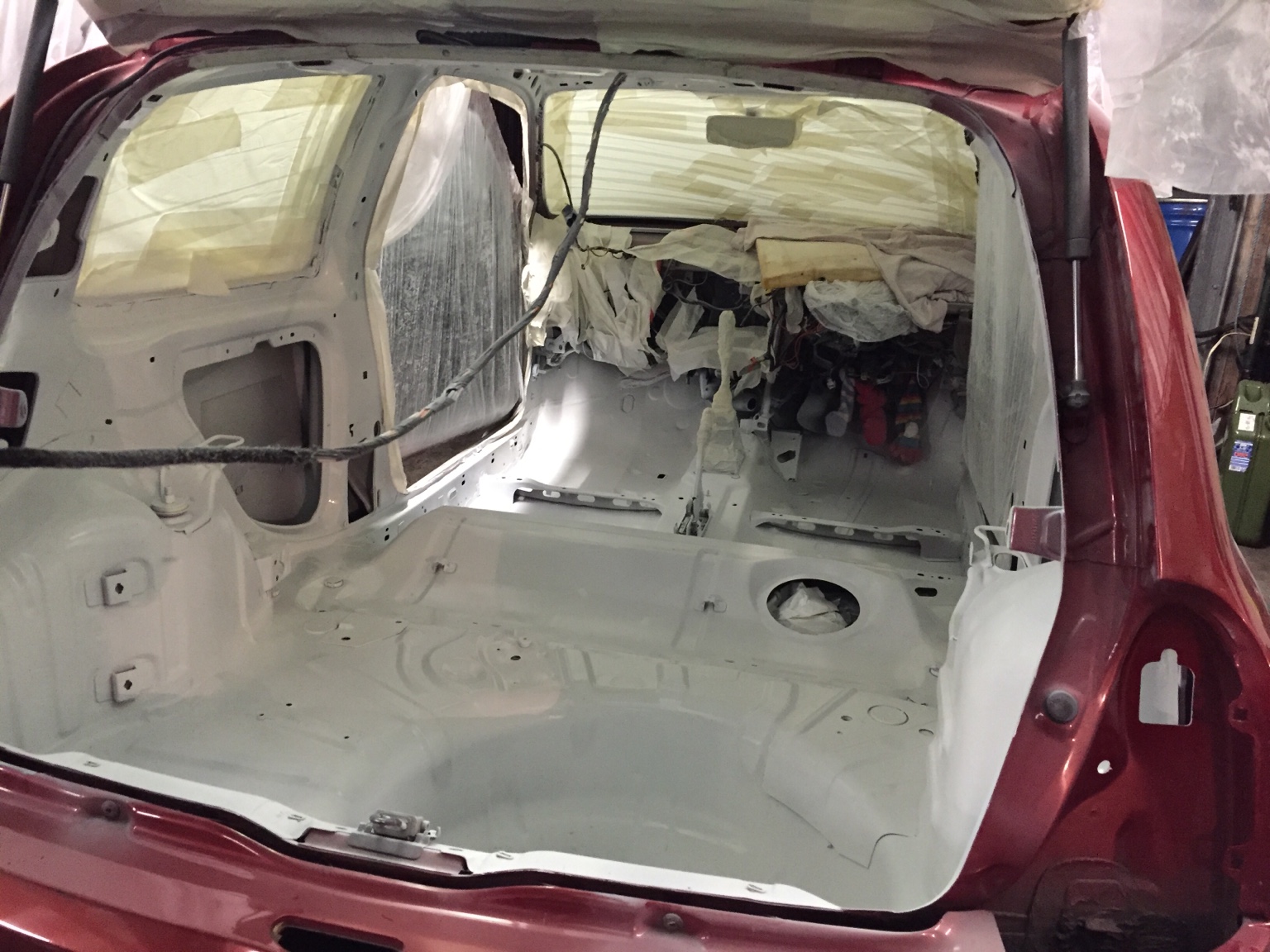

Update time. I've been working flat out on the car to be ready for Combe today. I decided the car needs to become a proper track car now. So the interior is gone.
I removed the power steering and added epas
Removed all of the interior and painted inside white
