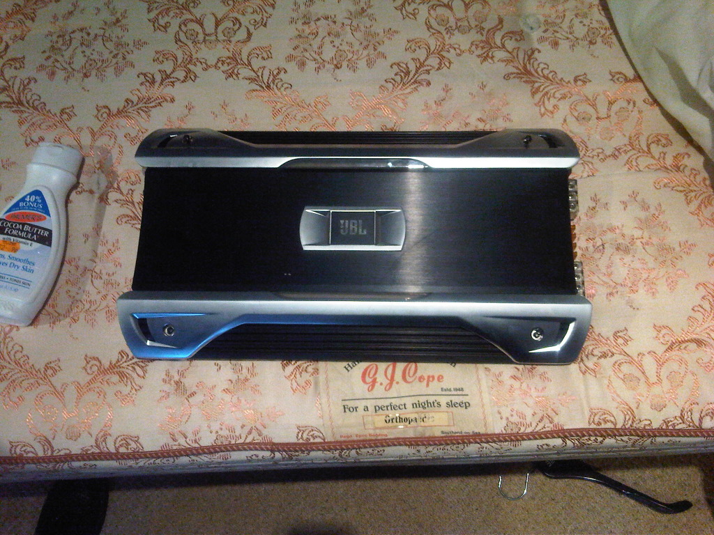

Autoleads level controller (for bass)
2 pairs of Infinity Kappa 5.25" coaxials
JBL 14001 bass amp
JBL 1004 4 channel amp

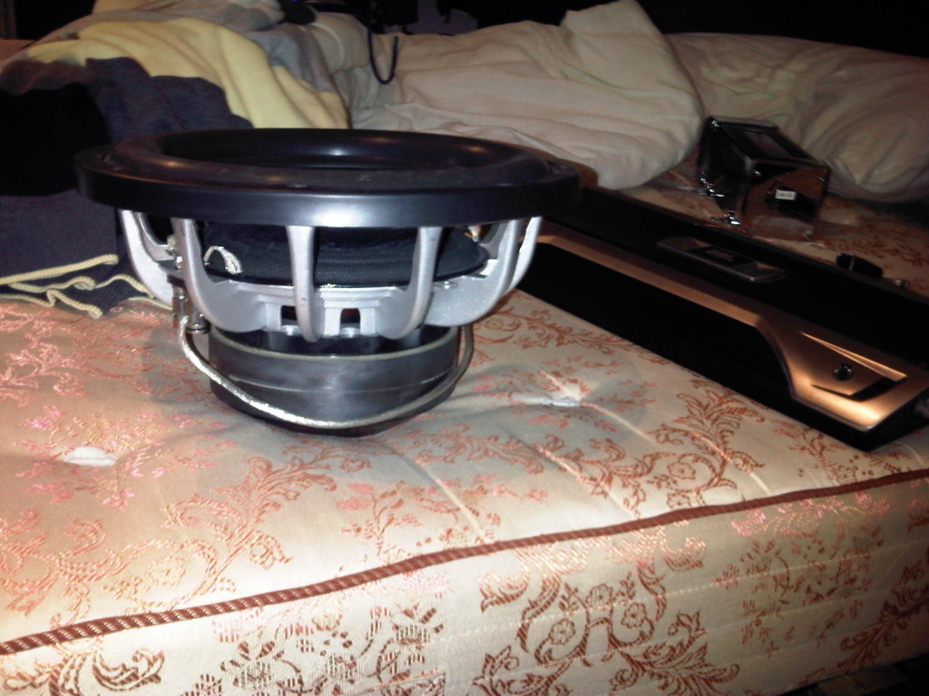

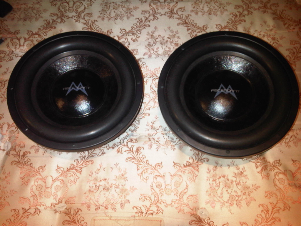

2 Ascendant Audio Chaos 12's

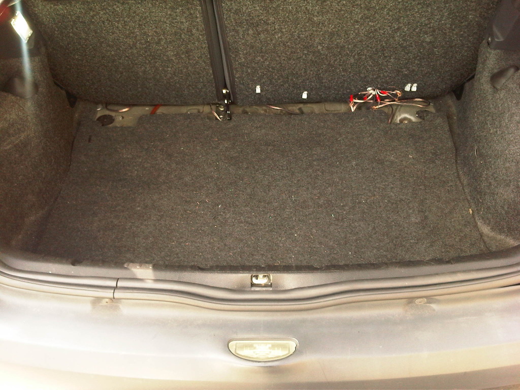

Boot before the big upgrade...

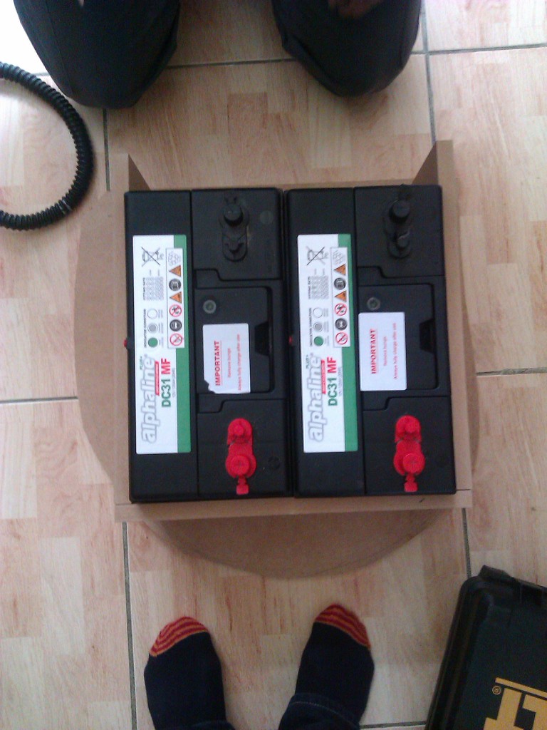

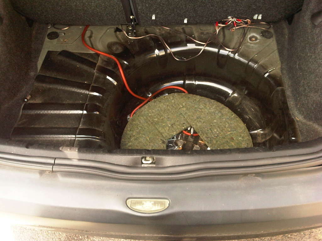

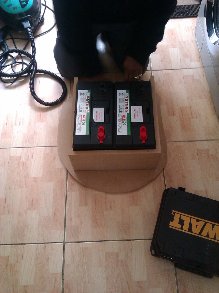

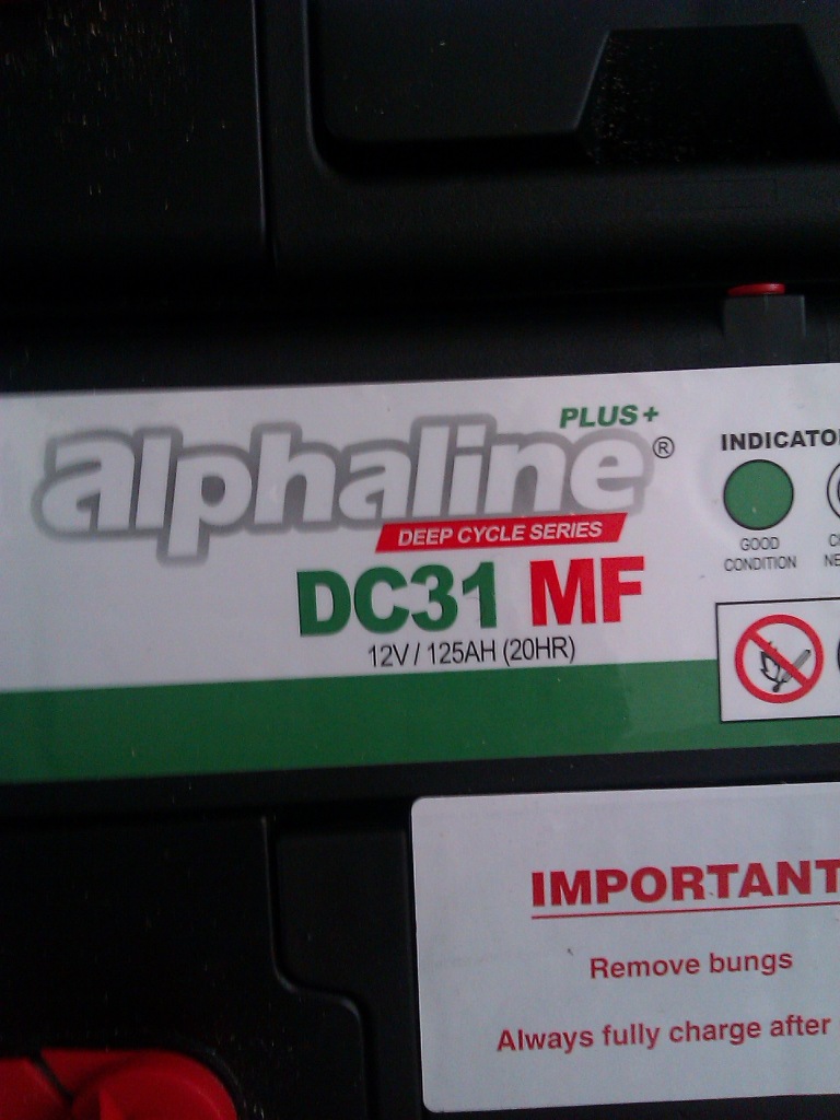

To power the install properly I needed extra batteries so I took out the spare wheel and mounted them down there...
I got 2 of these batteries and made a cage for them...

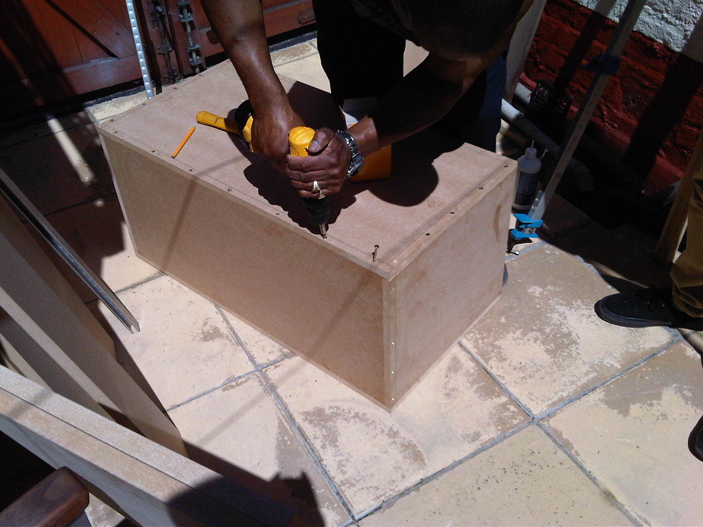

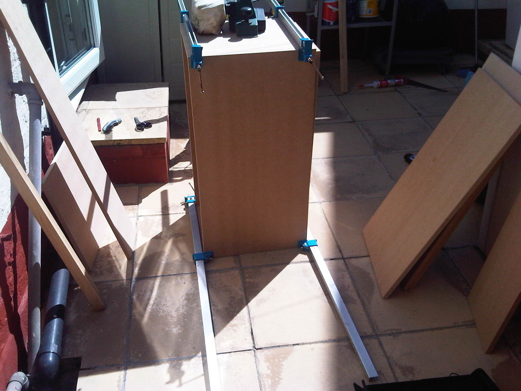

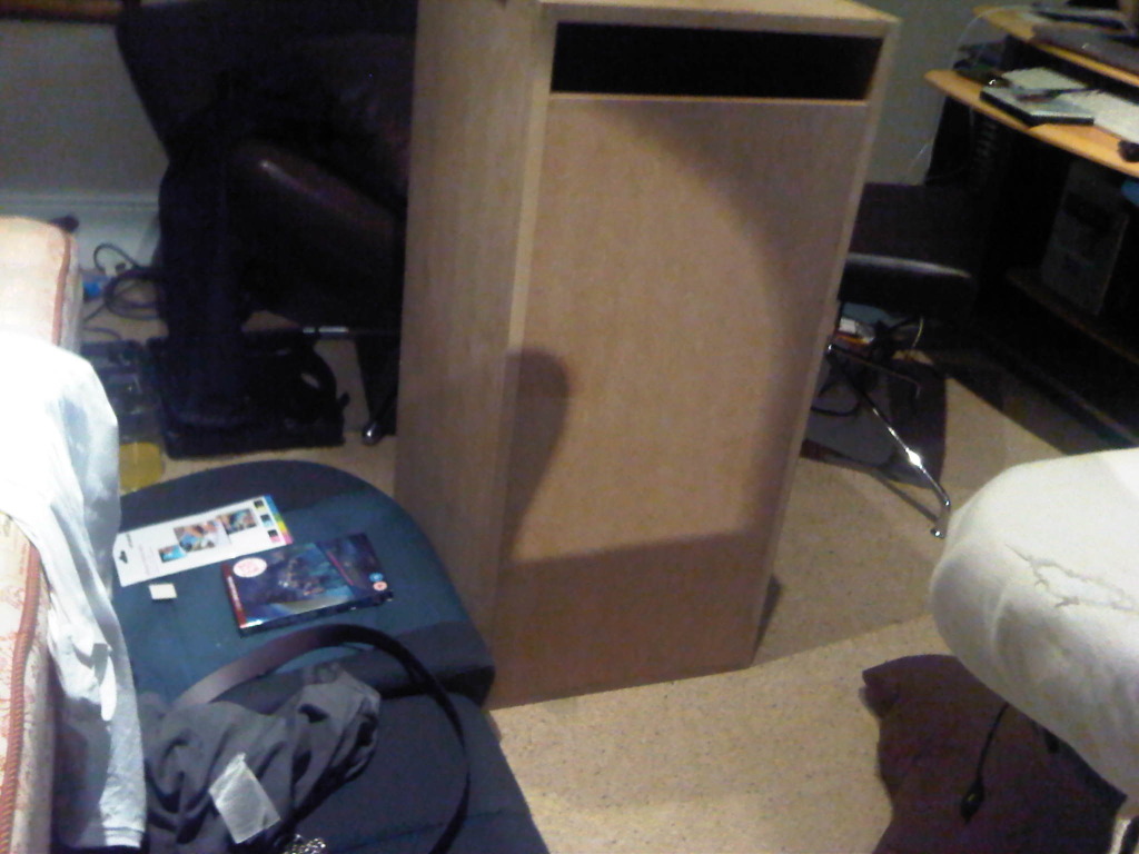

This was the box being made with just 4 sides in the clamps to let the glue set
Drilling pilot holes and screwing in the TurboDrive screws

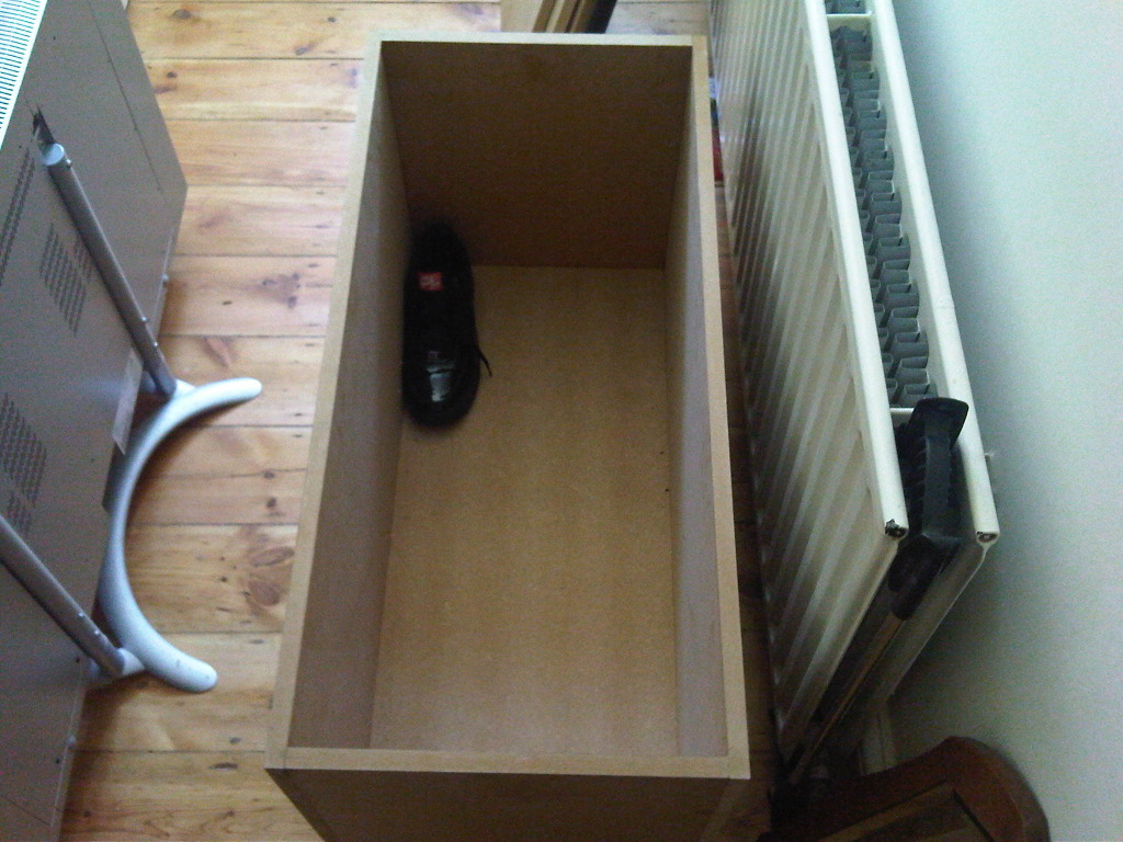

Basic box in my hallway with a size 10 shoe inside lol

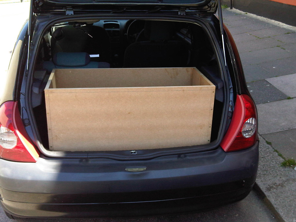

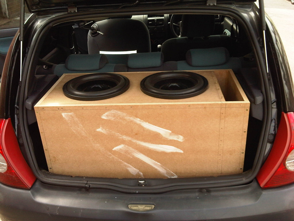

My dad and I put the box in the boot to see if fits with the boot shut and left enough space for the lid....The rear wiper and motor was removed for extra space...

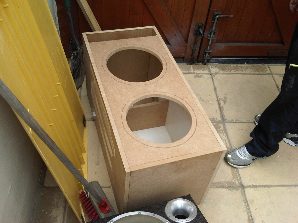

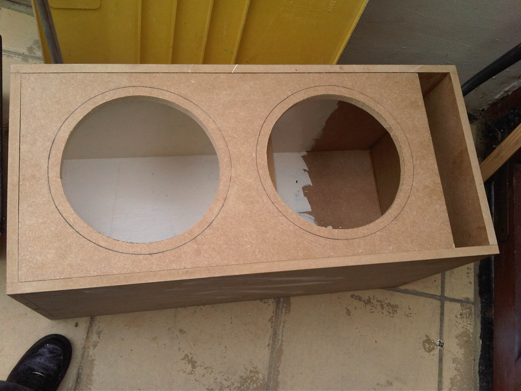

Box put together without the port in place as the wood hadn't been cut yet

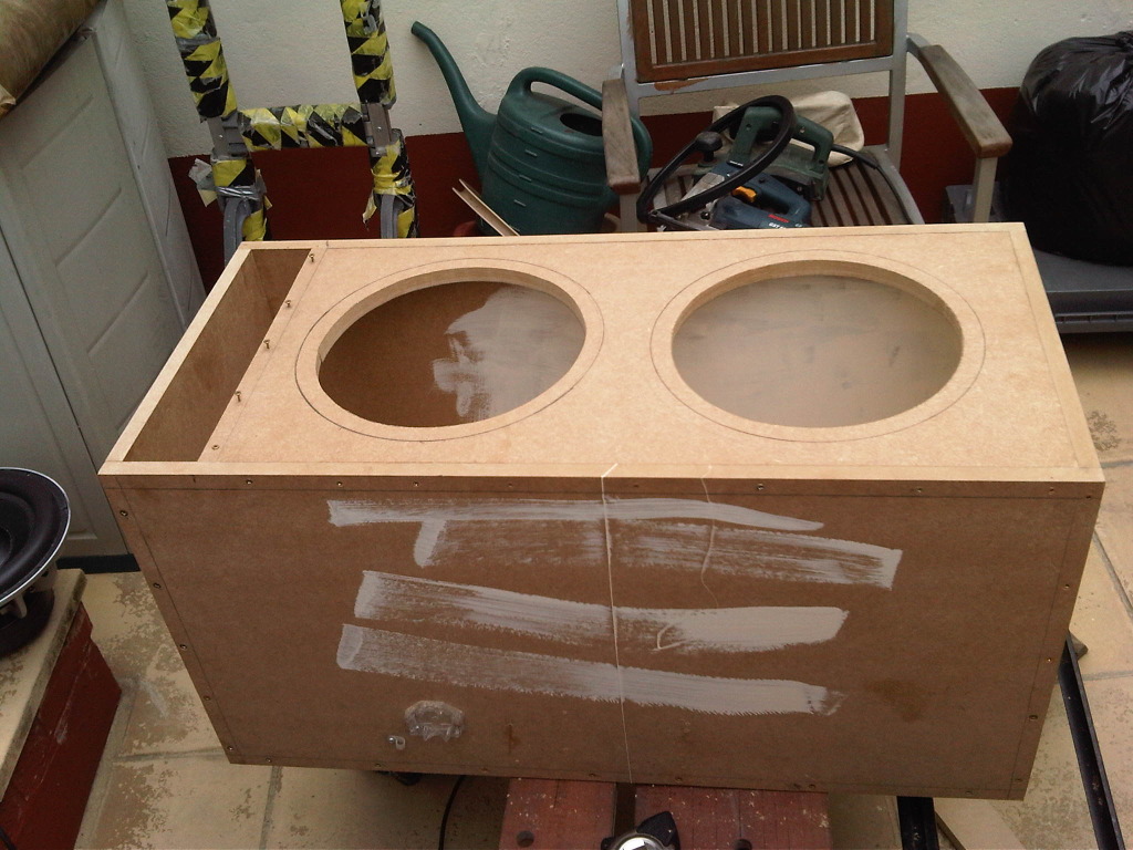

Holes for the subs were cut out with the jigsaw not perfect but close enough..

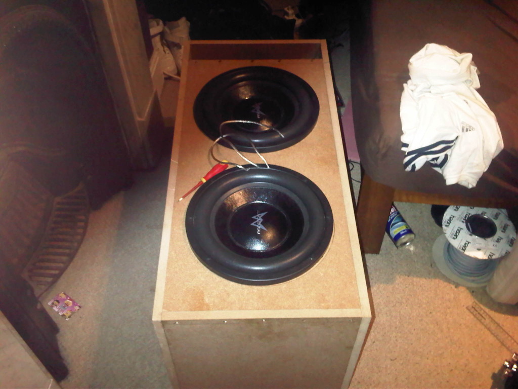

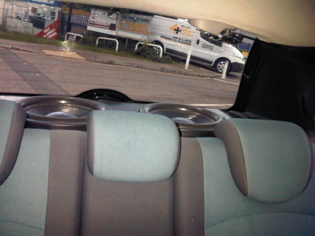

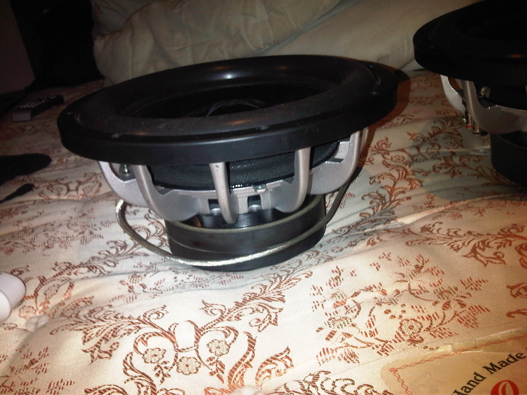

Placed subs in the box to see what it looked like..
Then put it in the car for a test fit...

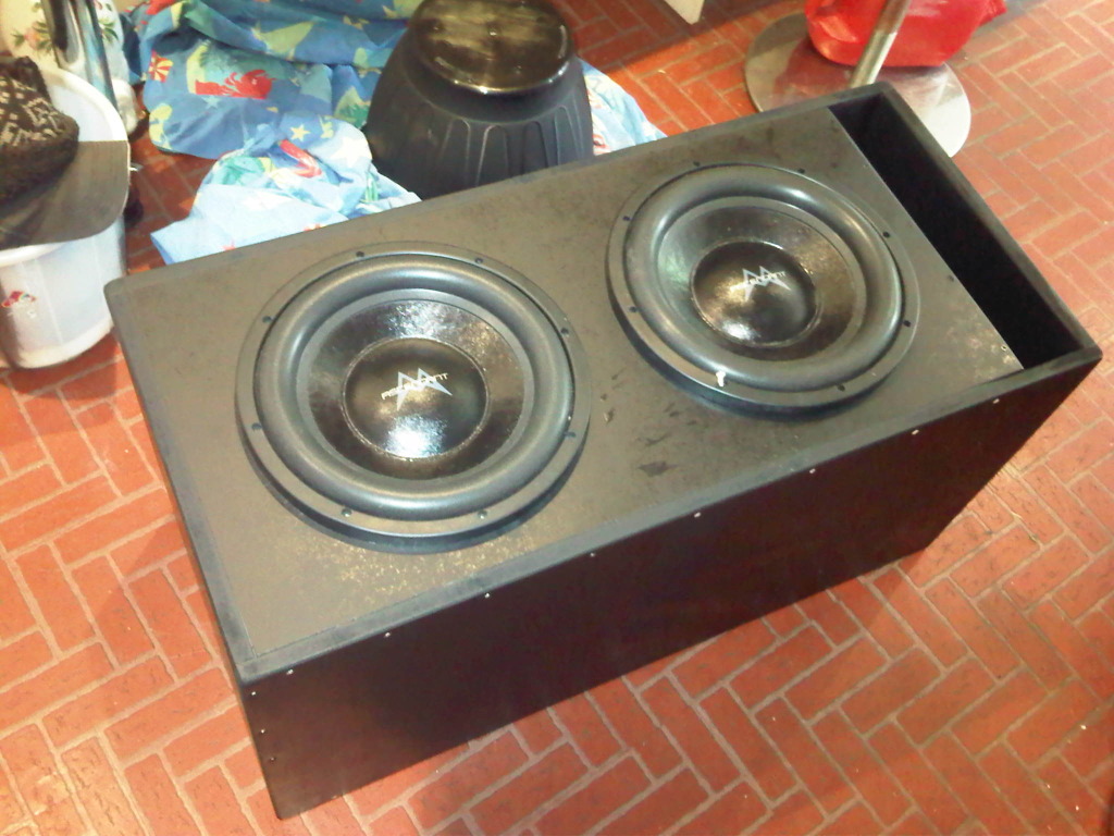

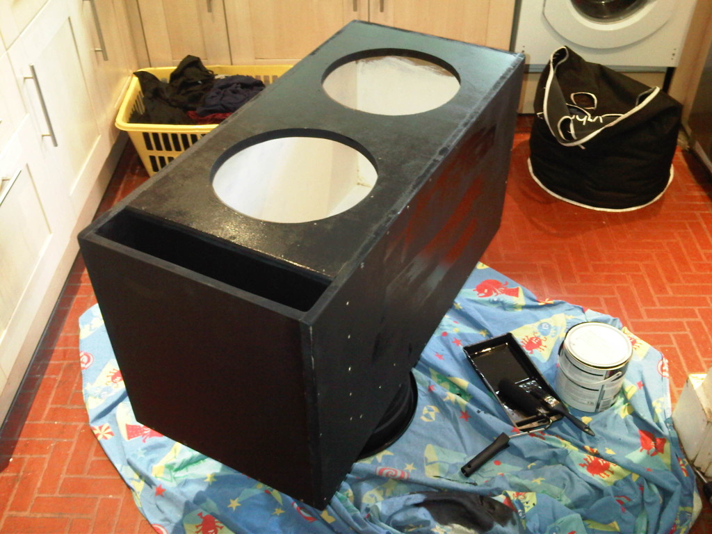

It fit perfectly so I got out the power sander and made all the edges smooth including the port then painted it black in the kitchen LOL

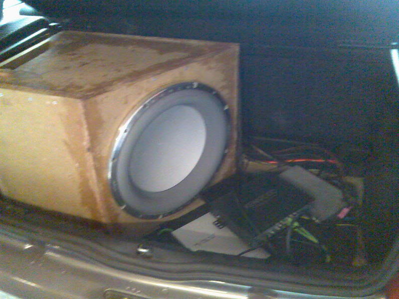

Finished for now...
In the car from my seat...
Just incase any of you were unsure of the wiring I used, I used 70mm welding cable for positive and negative and upgraded the wiring from the alt to the battery too...

a 70a alternator can keep them on charge but it will take longer i have 4 batteries and i now need an upgrade since my power supply drops on certain songs
really? i drained a yellow top with a 90A alt in my clio with a single JL amp
because its 1 battery if you have a secondary battery it will take less strain over both of them then it is on 1 of them
(All this talk of alternators etc, I had a massive PG amp running two JL's and 2 mtx amps running the front and rear components and all I ever had was a standard battery and alternator. Are we saying that with a bigger/better battery/alternator It would have been louder?!?!)
in some way yes you will be louder as amps are powered by the battery which in turn is charged by a alternator so if a battery is 1000w rms on 14.4volts if your playing full tilt and your voltage drops to lets say 12.0volts you have lost quite abit of power from the amp so if your power supply is more stable then your power your making from the amp will be better
Yes I'll be at Pure Carma mate but I might be in my dads car with the HCCA sub LOL...in regards to voltage in only really dips when the car stops, when im driving keeping the car above 2000 rpm it doesn't drop below 13.7v but at the lights it can drop all the way to 12.7 but no lower...when I try to pull away you hear the alternator belt squealing LOL.. (Only on very deep songs 23-35Hz)
