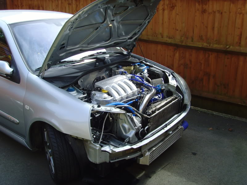

Stripped 172 Turbo
I keep reading this, I guess I should comment LOL!!

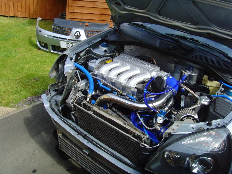

Great work buddy, that engine bay is superb... looking bloody amazing!!

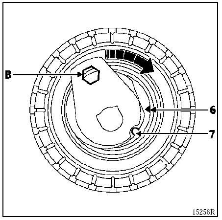

thats a gates/QH cambelt kit as that isn't a renault oe tensioner, but i'm 100% sure that belt tension is wrong
the little sticky out bit on the back of the tensioner is in the correct slot i assume?
oh i will!!! its my hobby ;) haha only joking
Mine looks the same as that
here you go
Yes mate, 'sticky out bit' is in the correct slot, only one place it can go iirc. As far as the make, I haven't got a clue, kit was bought from Renault but may not be oe tensioner.
there's 2 types of oe tensioner, yours is one I've seen a few of so that's not an issue. does look like it's the wrong way up, but if the cut out is lined up, it wont cause an issue, the tensioner works on an eccentric cam, just looks like you've gone past the point of maximum tension and back down.
Cut outs are 100% lined up, checked, double checked and even took it all off and started again. Every time the allen key point (B) endded up in that position to get points 6&7 to be aligned correctly. Don't think there will be any issues ( will be kept very quiet if there is now though:o lol)

you only align cut out B and point 7, you ignore 6!!
have you aligned 6 and 7?? thats incorrect
eh?
I initially did mine aligning B and 7, but was told this was wrong (and the belt wasn't very tight) and so I re-did it aligning 6 & 7...
oops, yeah i'm talking s**t, appologies! haven't done one for a few months
note - always refer back to the manual!
6 and 7 align and you ignore B

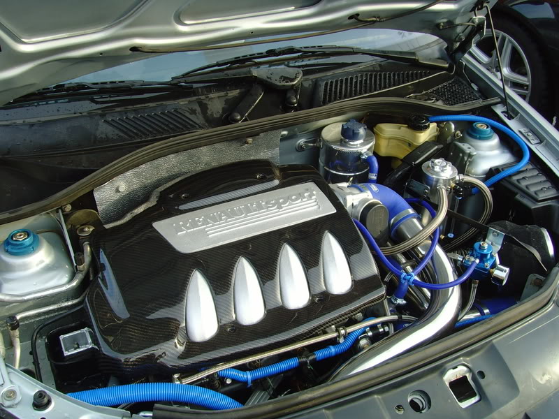

Finished engine bay:D

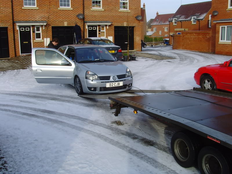

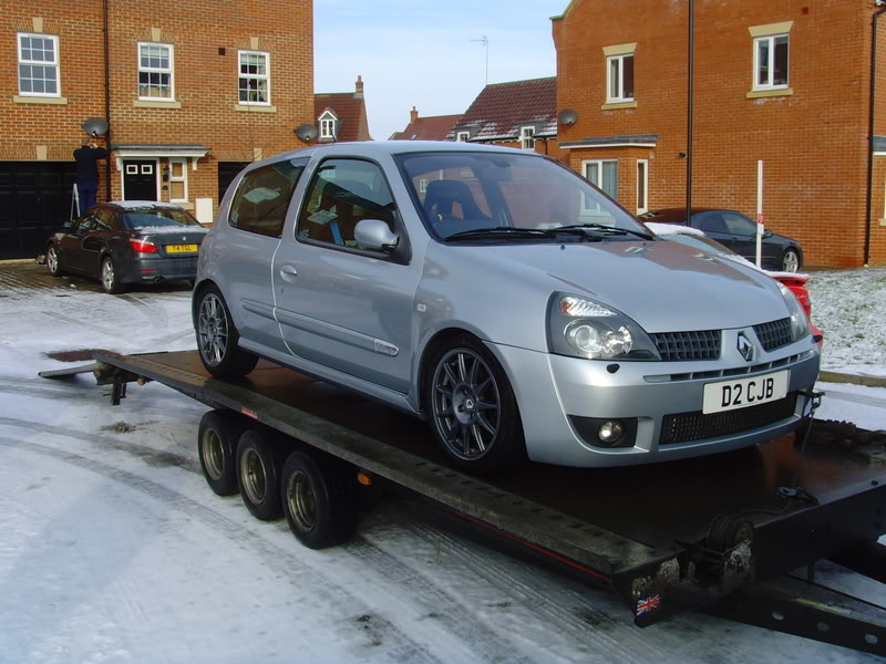

And finally on her way to K-tec. Only just left and already can't wait to get it back and drive it for the first time.
Has come a long way since I go it just over a year ago but there is still loads to do.

Hope you get some screws in that carbon engine cover before going for a drive :rasp:
Carbon splitter is in my loft awaiting her return, wouldn't have gone on the trailer if I had fitted before;)
Looking ace! Fairplay to you mate for the amount of time/work that you have put into it!
Lol, yeah, cover was only placed on for the picture:o. will fit properly once finished
