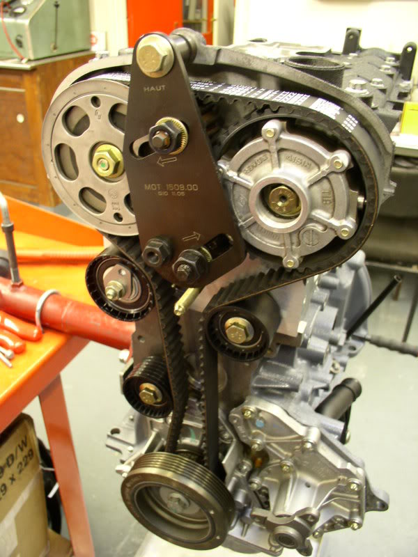

that tensioner looks like its in the wrong position
this is how it should look
did you ever check the tension?

Fred, yes I did re check the timing/ tension and everything looked to be as it should be. Thanks for you advise though mate and if it all goes wrong please don't say told you so!!
