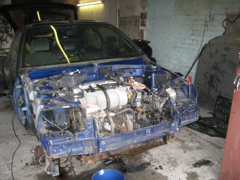

Stripped Mk1 Project
  Clio 1.4 Maxim
can i use my original driveshafts and hubs etc, dont really want the wide track on front if possible?? maybe even my gearbox or will the power just kill them??
thanks
  Rb 182
thanks
The 16v dont have wider track. Only the willy so just use the 16v parts.
The 1.4 shafts prob will fit and be ok. But if you have the 16v bits they are tried and tested.
:D
  Clio 1.4 Maxim
thanks
:D
oh smart if its not widetrack that helps just need to find a donor now :)
Djw John
Scotland - South
I hope your right Dave!
Are you sure its not a bit wider what with the arches and all? Even if its just slightly longer wishbones. We should look into that!

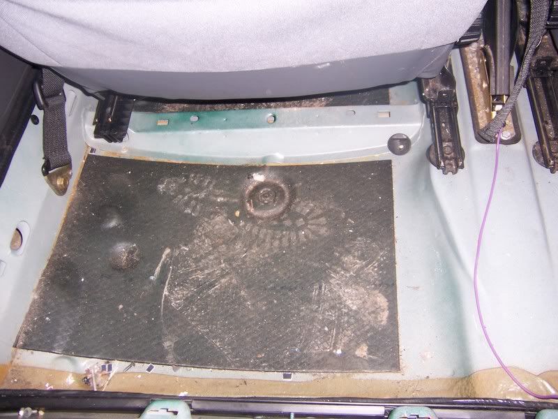

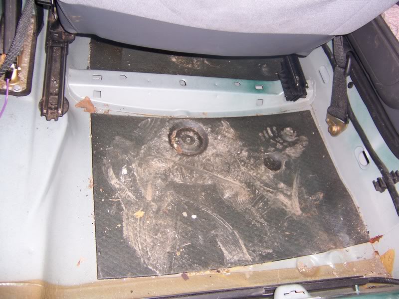

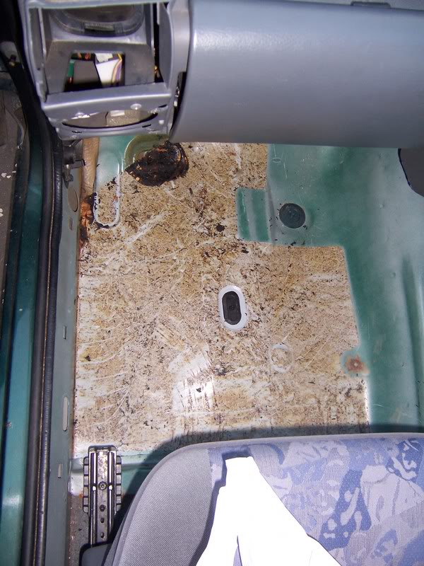

Quickie from the clio on a diet!

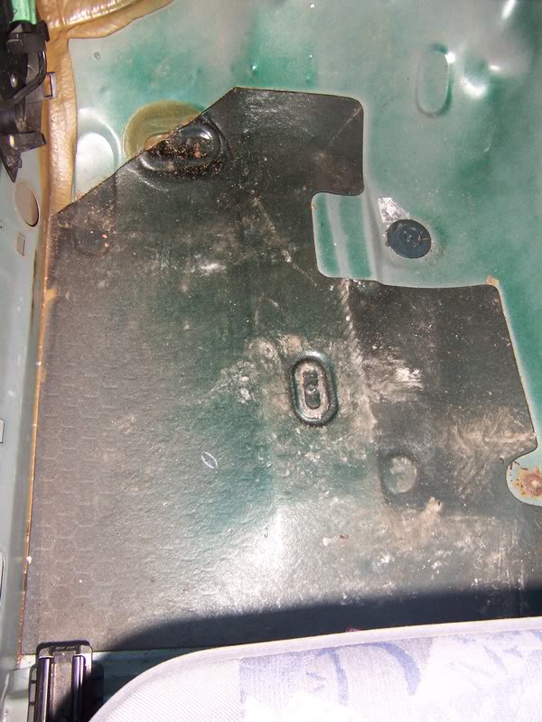

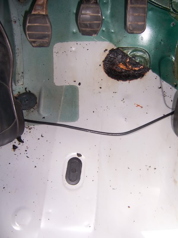

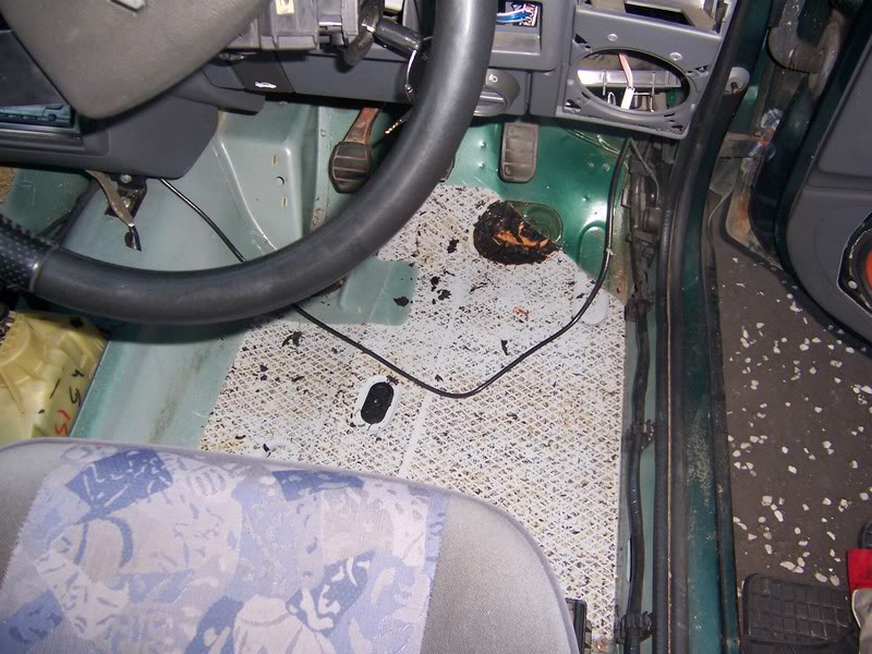

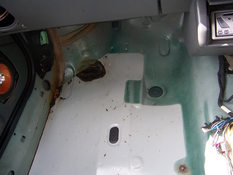

Removed the tar from pass side
Before
After

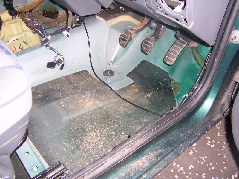

And then the drivers side
Before
After
Ill get some tar and glue on it tommorrow :)
More strippage to come!!11

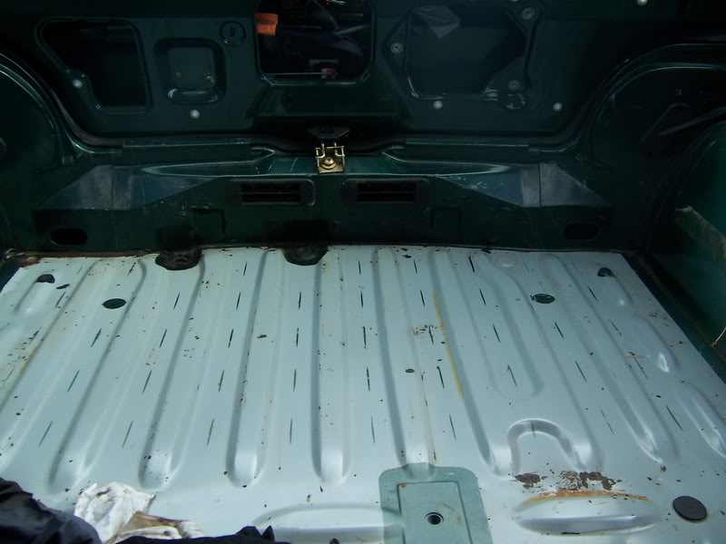

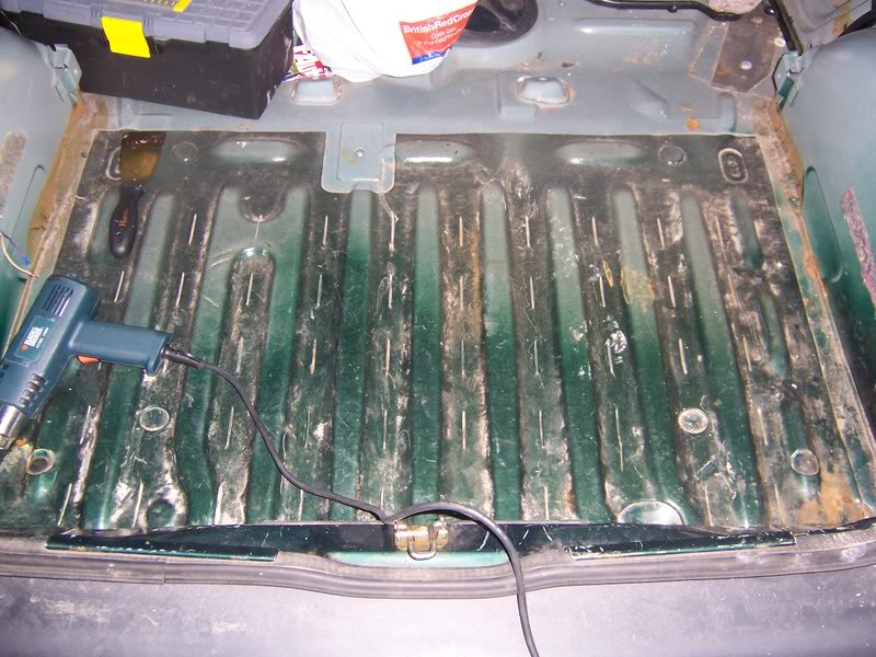

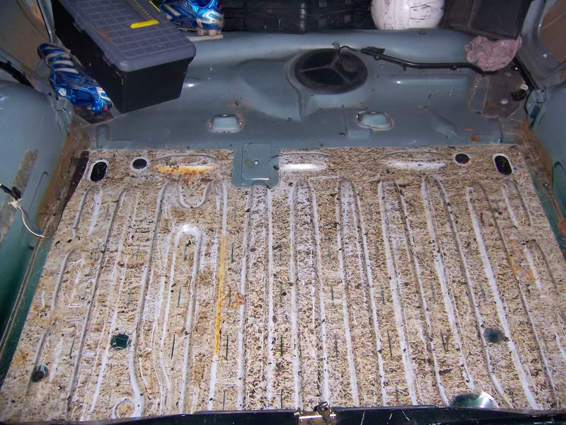

Boot
Before
after
Still more to come out from under the seats, but ran out of light :(
Coming on though. How many weeks to Fcs :eek:

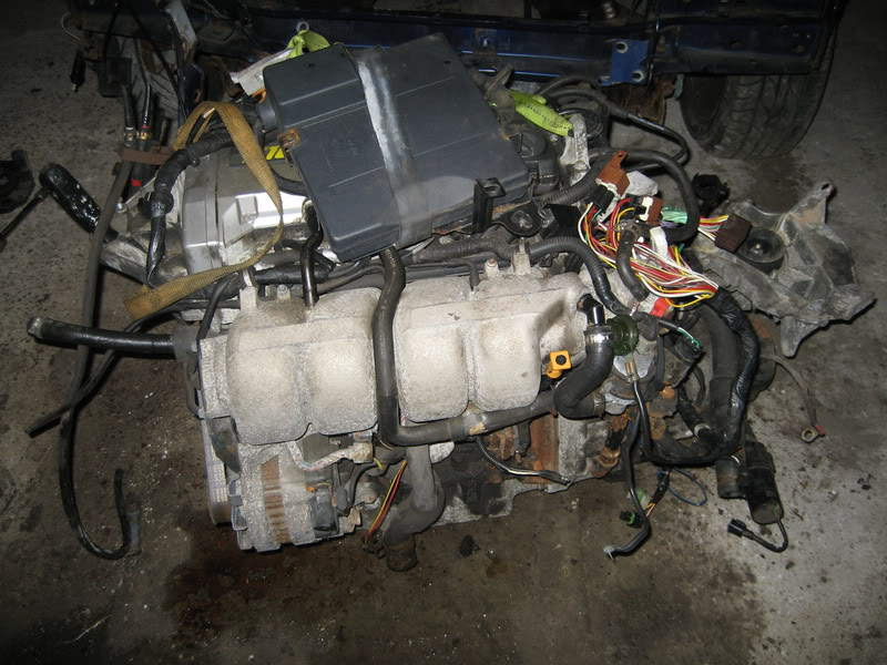

  Some of a Clio 1.8 16v

does this actually affect the weight of the car?? and how the hell dya get it out?
Yeah, i think it saves a few Kg, big power with little weight is the idea here.
Using a heat gun and wall paper scraper. :0

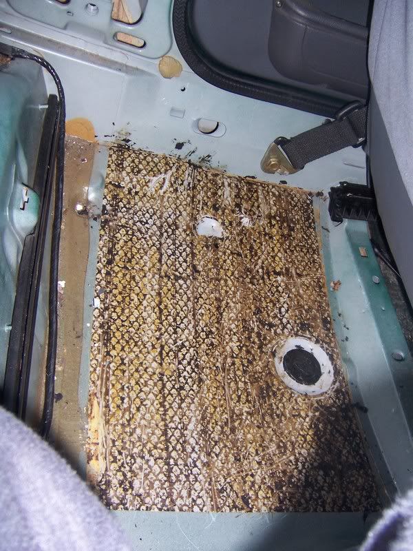

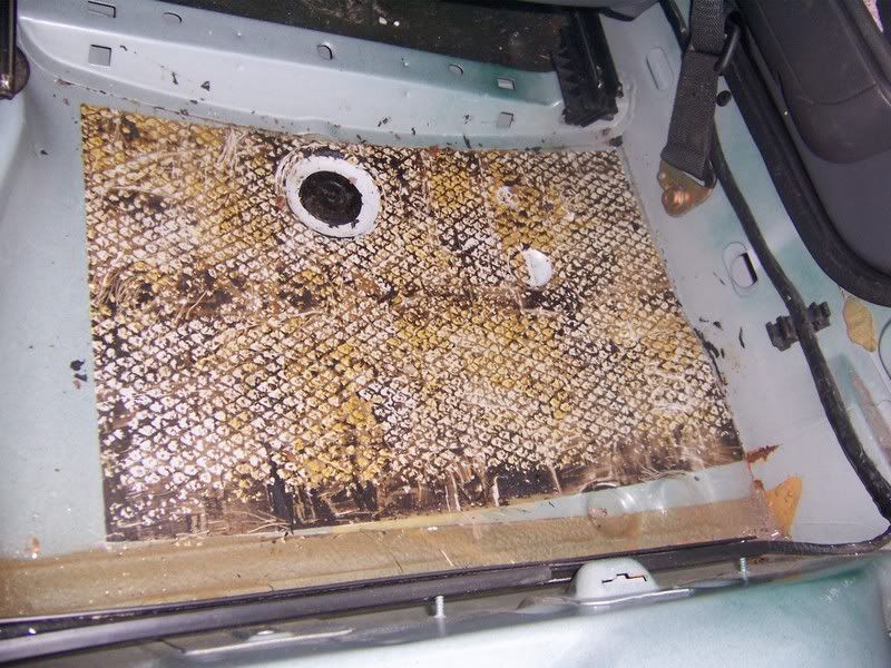

Few pics from my 5 mins i put into the car today.
More tar out, this time from behind the rear seats.
Before
After
Only tar left is under the seats but that will be out soon, along with a few other changes ;)
