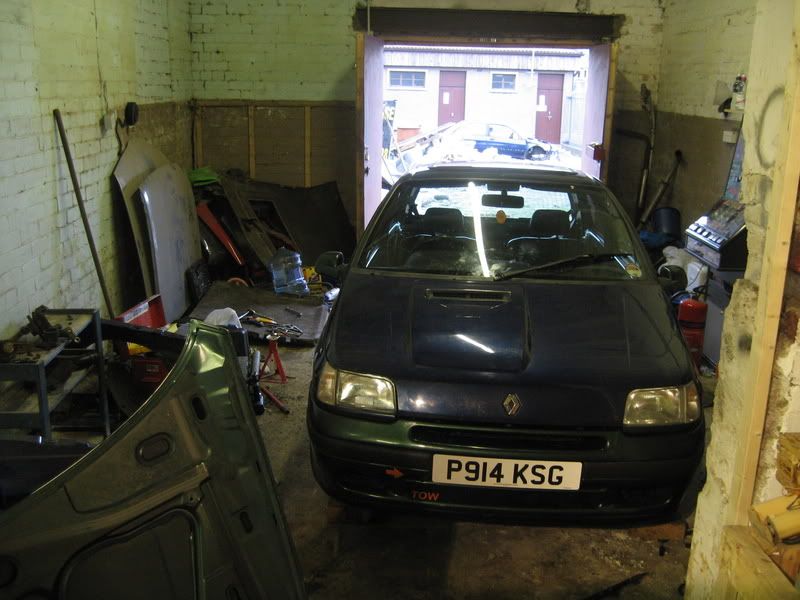

Well it runs! It stops and it turns.
Need to adjust the gear linkage as it isnt getting all the gears and the throttle cable is mullered so has jammed a couple of times. Just niggles that need sorted really but is making it very hard to drive anywhere!

Throttle cable is now in my possesion.
Having some scran then we're gonna go down and fit it, adjust the gear selecter rod and drive it home :D:D
  Rb 182
New throttle cable fitted, clutch cable sorted and gear linkage sorted.
On first test runs, its quick!
But a bad earth meant that the battery has died **sigh**
More to fix :)

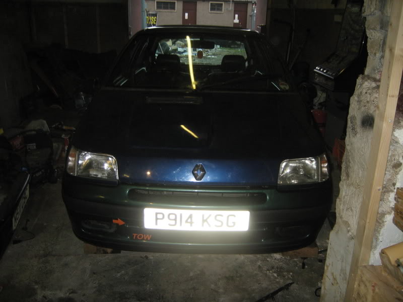

Well the road isnt looking too healthy! Gonna head up in 5 and sort it out, new battery is a cert but we have spares! Dave wiped teh acid off last night in the dark but will hopefully be ok.
Green Chic, Dave has wanted the rt bonnet but then we put this on firstly for ease but now he loves it!
PH Mongrel ftw tbqfh
  e60 M5 -172- dciheid
fingers crossed.
looks superb with valver bonnet on, id defo keep that. Hope you get the batery sorted out.

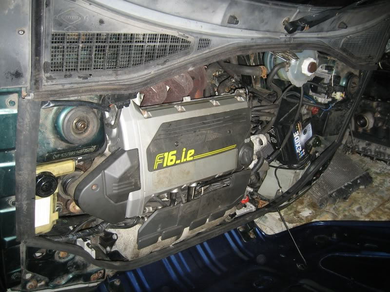

The 16v dont have wider track. Only the willy so just use the 16v parts.
The 1.4 shafts prob will fit and be ok. But if you have the 16v bits they are tried and tested.
:D
oh smart if its not widetrack that helps just need to find a donor now :)
now the conversion is almost done, did you guys use all the hubs and stuff from 16v and widetrack or keep the ones from the 1.4??
  Clio 1.4 Maxim
so basically i can use all my old bits no problem, dont wonna have to use 16v hubs and then need to get new brakes and coilovers thats all lol,
One side is 16v and the other is rt. Only reason is we need to put a new cv joint on the valver shaft. Can defo pick and choose though
  Clio 1.4 Maxim
that has made me a very happy chappy, how long has it taken you to do the swap then?? gonna have to look out for a donor now, got me thinkin, mk1 ph3 1.8 16v running on ITB's :cool::cool:;)

We took the 1.4 out on Friday night, worked like *****s and it ran on Sunday morning. Would have been sooneer if we had a ph1 ecu to start with.
Not driving it yet as the throttle cable ( that we fitted oops!) has snapped and the alternator is overcharging the battery :(
