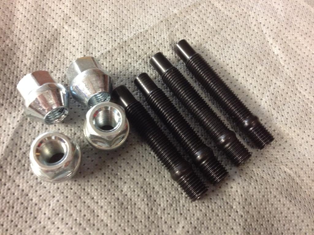

I had the ones from M.A.P.S ages ago, I brought the set for a BMW with 10 at 75mm long and 10 at 82mm long iirc and the 82mm long ones will take a 16mm spacer.
Just use some loctite 271 to fix them in

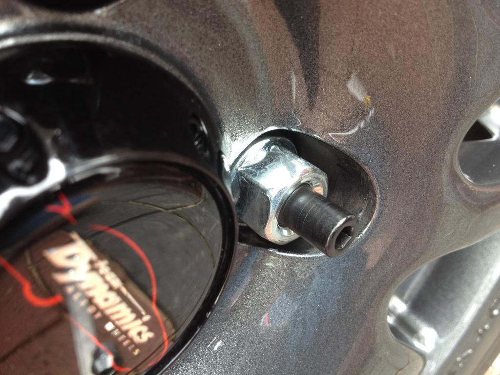

on the rear wheel

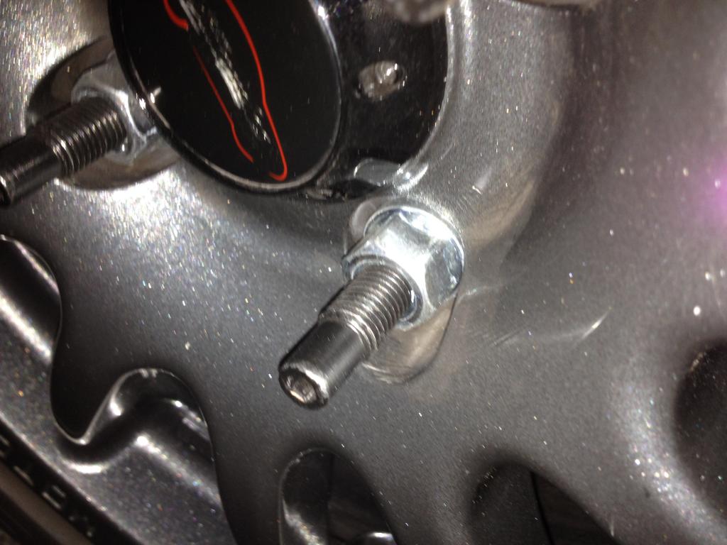

on the front wheel with 16mm spacer

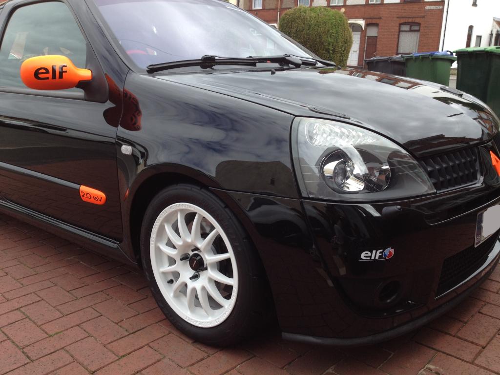

on the car with no spacers
on the rear wheel
so the rear has no spacer and has about 30mm sticking out after the nut? cheers for the pics
