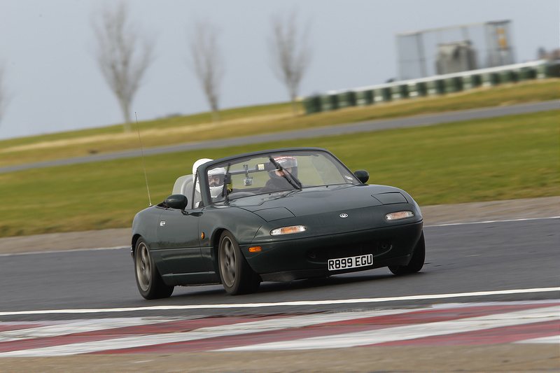

Only picture I got at bedford.

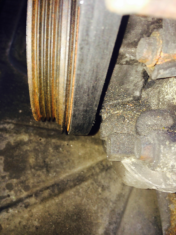

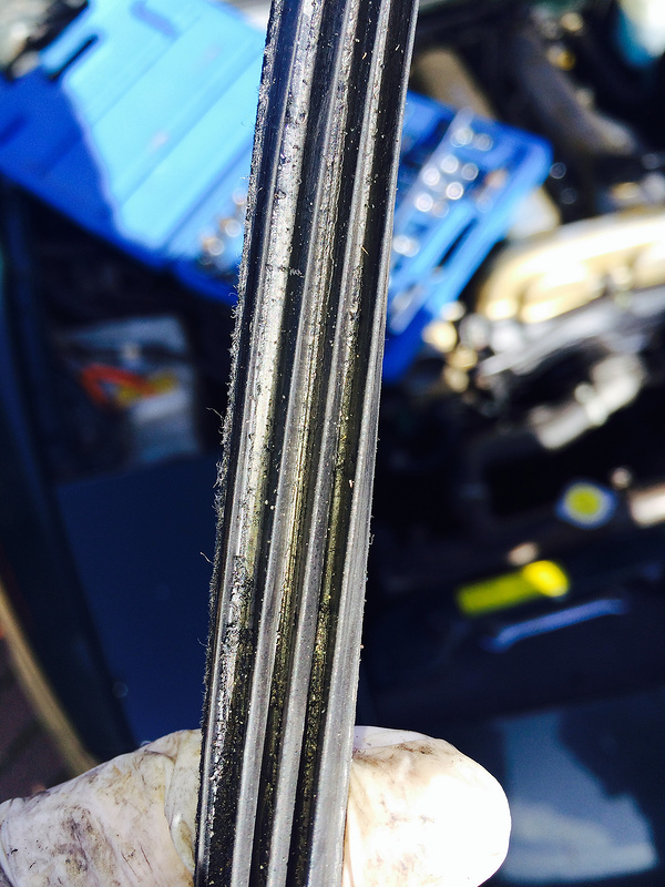

So post trackday I had a few things to do, the aux belt had been squeaking for a while so I decided to check it out and see if I could figure out why.
Spotted that it was fitted incorrectly, this was after a specialist changed the cambelt too! Shocking.
IMG_1062 by sbridgey, on Flickr
This meant the inner ridge of the belt was a bit worn.
IMG_1066 by sbridgey, on Flickr
But I reset it and re-tensioned and low and behold no more squeak!

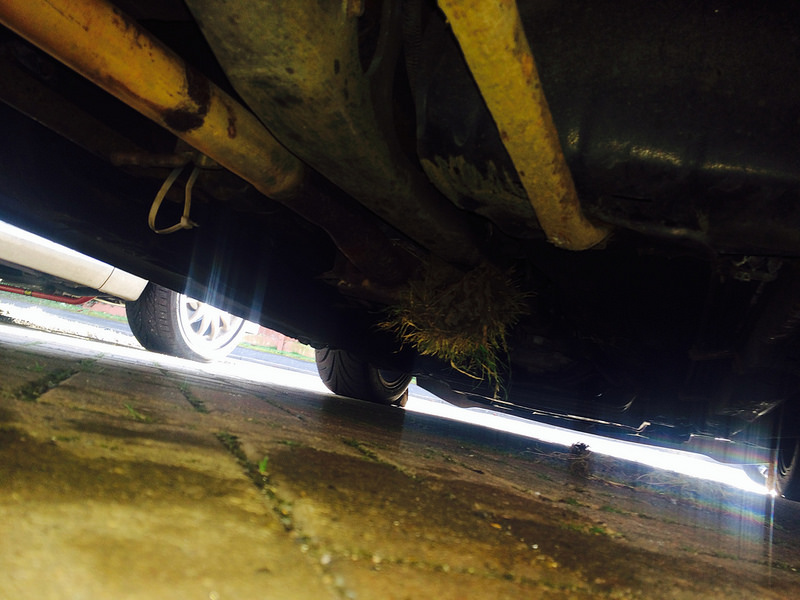

I managed to run over some grass on track and it had got caught and knocked my exhaust hanger (Cable tie) off.

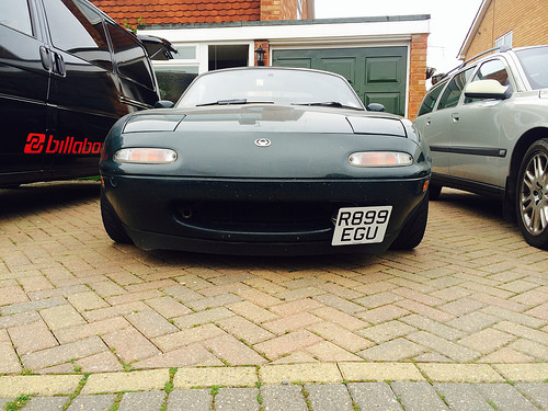

Finally got round to fitting my offset number plate, i think it makes the front end look much better
IMG_1638 by sbridgey, on Flickr
