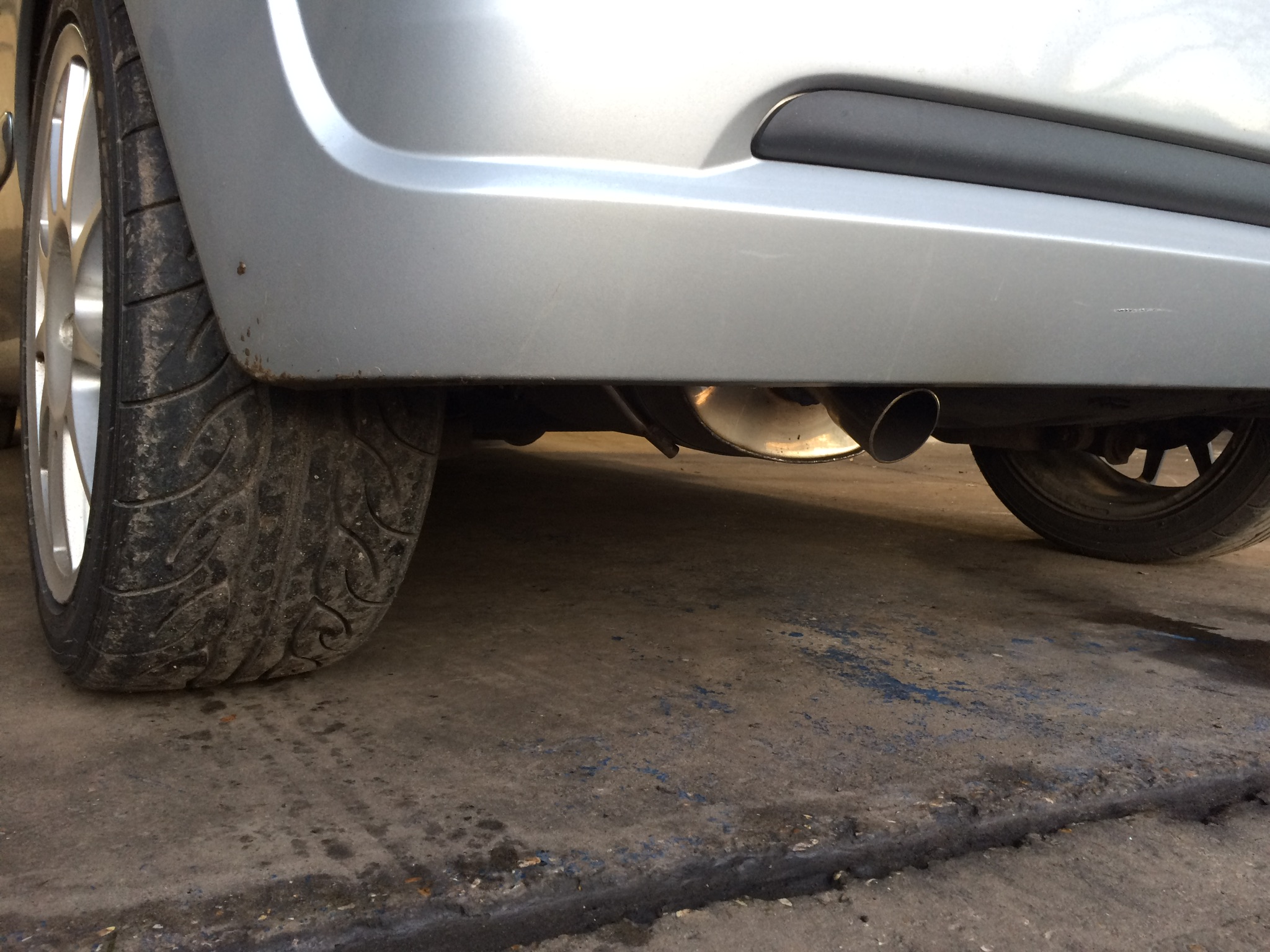

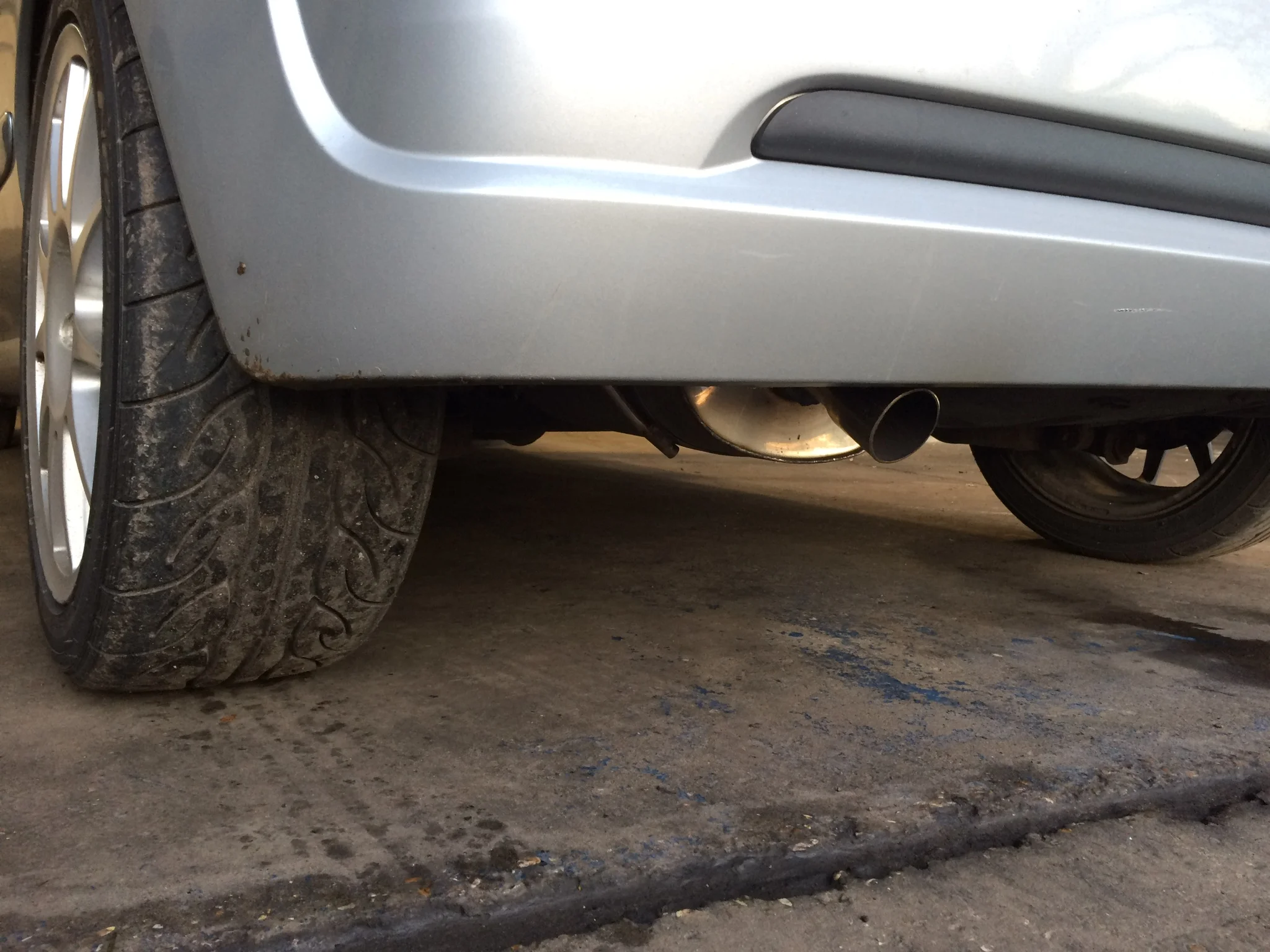

I got a tip made up on my stealth & it made a bit of a difference,but i still get the drone nosie at 75/80mph on motorways etc.
To me it sounds like it comes from the front like fire wall part or centre section.
But i guess it doesnt help when mine is a cup with no sound deading.

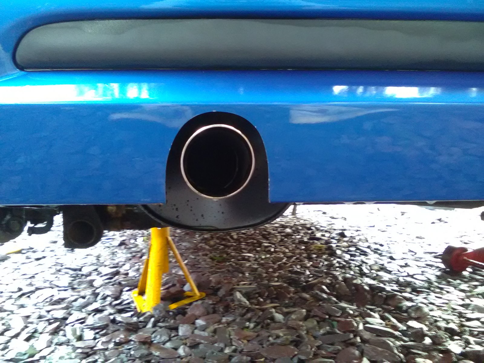

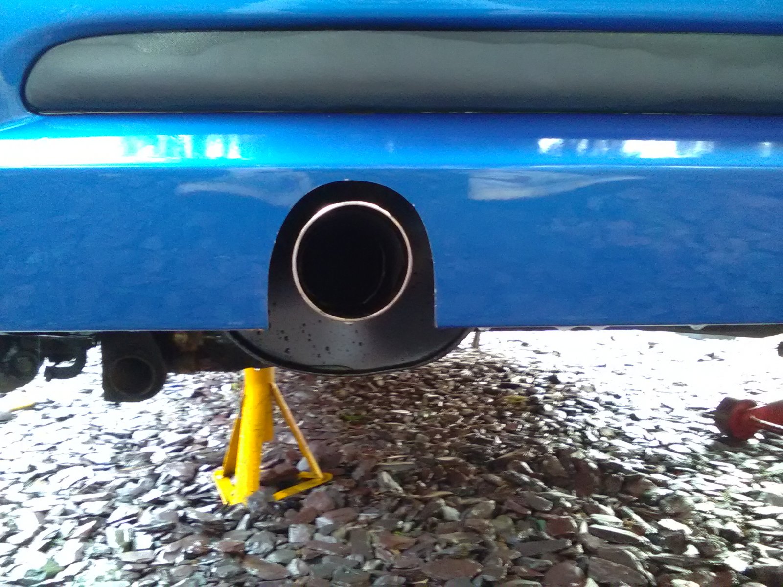

View attachment 1347661 View attachment 1347662
Looks awesome that. How much did it cost? What tip did you use?
I wish I'd just bought the recessed in the first placed by liked the idea of a stealth at the Time
Its only cost £60 & i went to a custom exhaust place,i just wanted him to cut the stealth pipe off and weld on a straight cut pipe.
I wasnt to sure at first but i like it now.
@hipwell
That's not bad at all.
It'd look better with a 182 trim around it though but the cut out may be a bit big for the now
Yeah ive tried a number of different trims,rubber etc & nothing looks good or fits.So will leave it like that unless i come across anything that will do the job.

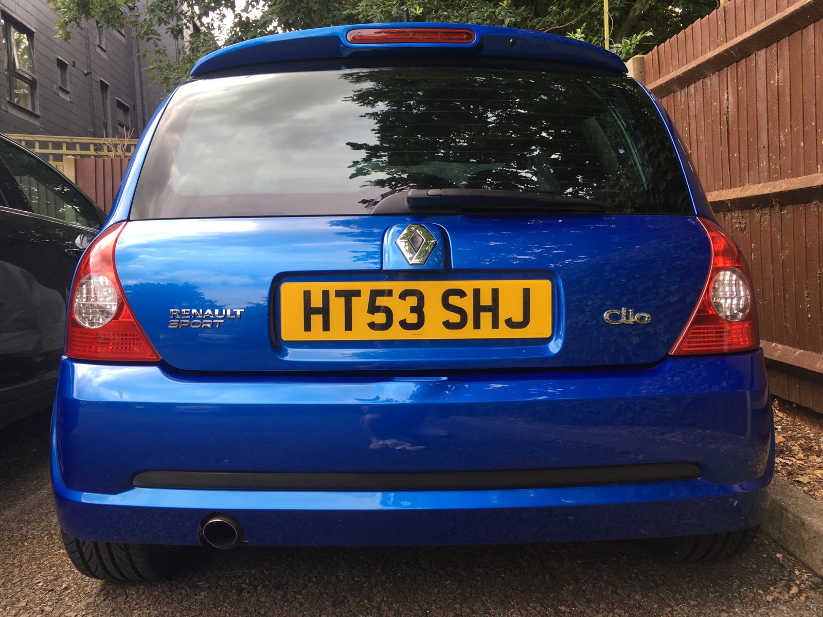

Had a 2.25 inch pipe welded on. It sticks out by less than an inch, sits perfectly in a small recess and has made a MASSIVE difference.
No drome, none of that headache inducing resonance, night and day. Bit of rasp around 3k and more after 5, so much quieter inside the car.
This is the Supersport version, 182 manifold and decat link pipe.
Pics of it fitted once I fit my PMS carbon fibre surround.
So looks like 2.25inch maybe the answer.I might change the centre section to that size if i can,but then the rear box is still 2.5inch,but would be a start.
