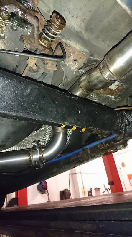

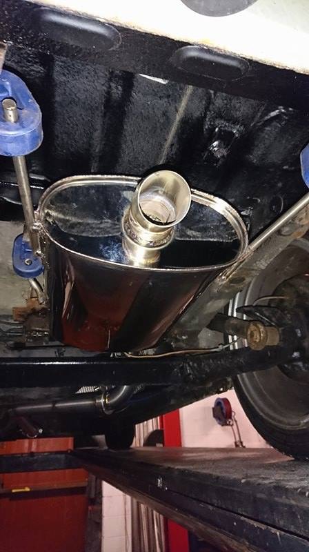

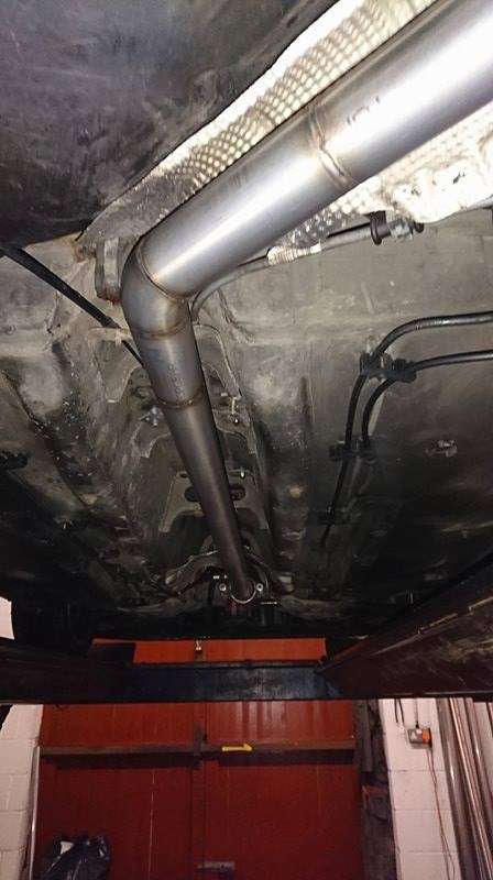

Im changing the rear box for ktec super quiet one i think,waiting on an email back from James at ktec
Did you get a price on this?
Should imagine there quite expensive because of the work that goes into them.
Not many people run the super quiet exhaust because it hasn't been out long.
MrBlonde
Yes mate ive now got the super quiet system on & having the tailpipe custom made at the moment,also have removed the backbox heat shield which has helped with reducing the noise,as it was pretty lose,so it resonated.
