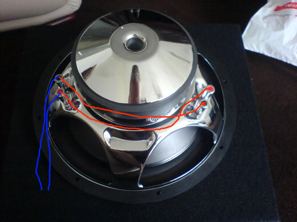

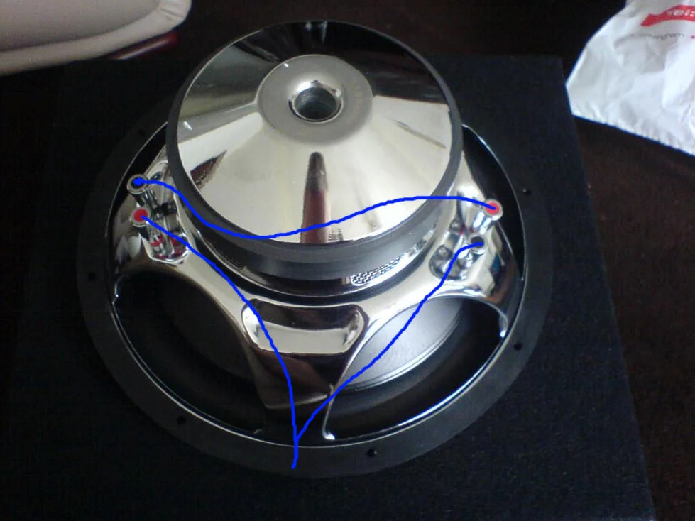

sub help
like one of these
not a good combo there as you need the sub to show the amp 4 ohms ideally
and that website is s**t don't buy anything from them
like the sub shows as 1100wRMS when it's actually 500

gonna wire it like the first diagram then get a different sub later on
just don't turn the amp up too much trying to get more out of it
as i can't find the specs for the amp i'd say you are only going to get about 100w out of it

yeah but the sub is a dual 4 ohm
so either 2 or 8 ohms (you are going to wire it to 8 ohms)
What you really need is a 2ohm stable mono amp instead like this JBL, and wire the voice coils parallel like this to show the amp 2ohms.
You should get just over 500wrms (It says 580wrms but probably not that much in reality) out of it then which should be plenty for the sub.

That Alpine is a good choice because each voice coil is 2 ohms so you'd be able to bridge your amp and still get full power from it.
