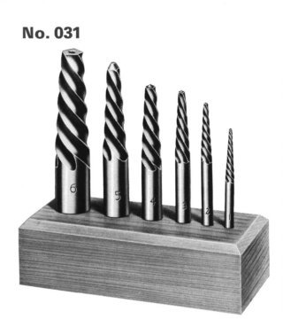

Couldnt you use easy out bits and a shifter to get off rounded bolts >
Thats what i use, just drill the bolt and use these to ease them out?
