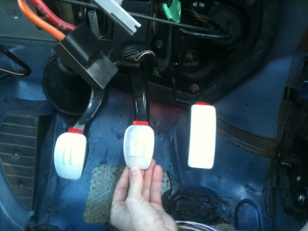

Dannys 22nd birthday present from me :)

Twingo 'Power Pedals', Pause - Stop - Play

I was going to take a better picture tonight but that one will do. Cheers dude!
  E36 328
Re: Mk1 Hybrid rebuild
Wow i love those pedals i want some :D
Has it got an mot? They wont pass cos u need rubber on the brake and clutch :S

LOL @ that being an MOT failure.
80-90% of hot hatches/performance cars have metal pedals.

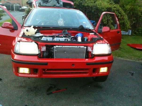

Last night Danny and I spend a few hours sorting the loom. Danny purchased a new loom (ph2) as we thought the 'cup spec' ph1 loom was fubar'd.
We fitted the new loom only to find that alot less worked and some connectors are differnt than on the cut down ph1! Certain parts worked on the ph2 that didnt on the ph1 so I spent ages tracking and copying wires that worked on the ph2 onto the ph1 and managed to get the ph1 working bar the hazard switch (even tho the indicators work and the relay 'ticks') and the ignition lights but the fuel pump primes and the starter turns so we know it will run!
Just need to sort the roof loom and both door looms for the central locking (doors are de-locked) and the wiring is done!

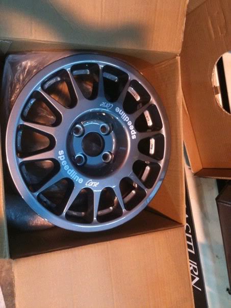

Still waiting on wheels from Speedline! been told the 7th of june

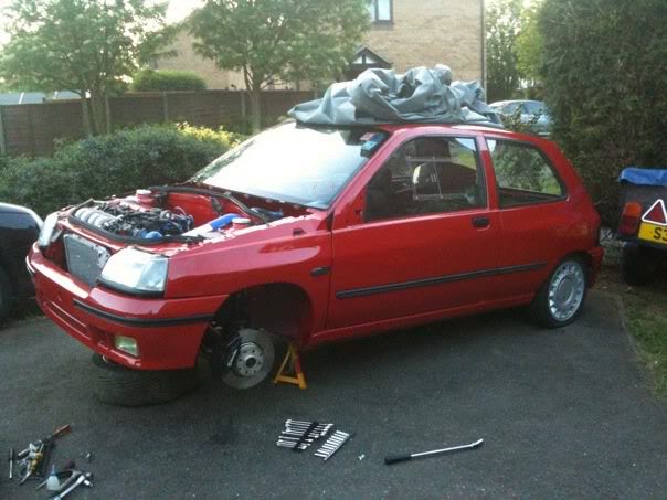

Bit of an update, no pics sadly

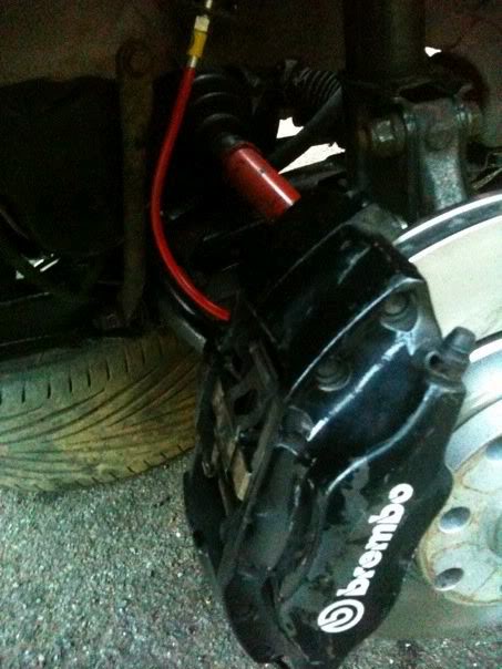

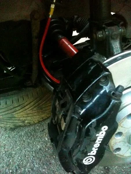

All the brake lines are connected up, 1.2 heat shield on which looks a million times better than the 16v one! Also because danny has got rid of the heater matrix hes running a 1.2 header tank and one of the outlets on the head has been blocked up. Water system has been filled and only had a slight leak but all fixed. Loom to be fitted back in, sparks out, crank over to get pressure, sparks back in, FIRE IT UP! all window seals back in.
All thats needed now:
Connect brake vacume pipe and tidy a few clips and wires up.
Sercure front polycarbs.
Bleed brakes.
Wheels.
Seats.
Tax, MOT and insurance.
DONE!
Wont be ready for Rockingham on the 14th but deffinatly Cadwell on the 7th of July.

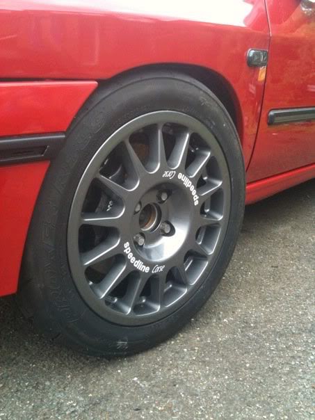

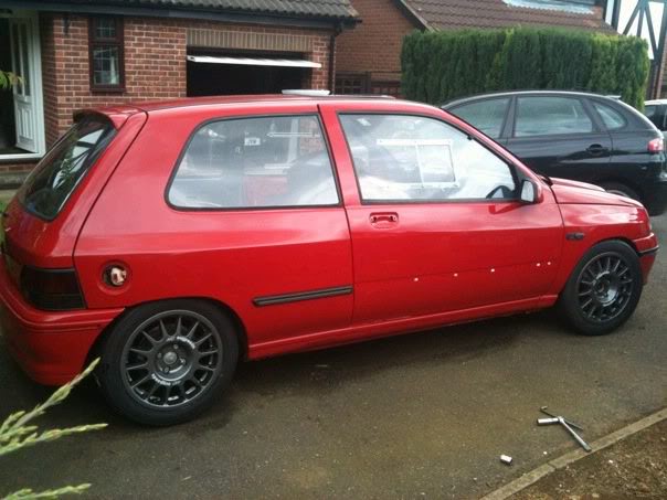

Crumbs I can't believe I am about to say I don't like those wheels on that!
I'd be running the std turbines all the time personally - I think the 6.5j would suit it better too.
Have to agree on the wheels, Looks so good on the Turbines, dont think the wheels suit it at all :(

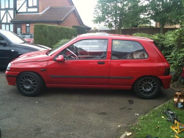

Car moved under its own power for the first time in nearly 2 years!
Also the wheels now fit further inside the arches after a bit of fiddling, very similar width to 1*2 track now. Car makes brilliant pressure, currently running on my old valvers ECU as Danny has 'misplaced' his remaped williams one so is a bit lumpy... but sounds epic! Danny also got annoyed with people messing him about trying to buy some 2nd hand rear calipers so splashed out on brand new ones! Typical Danny tbh
