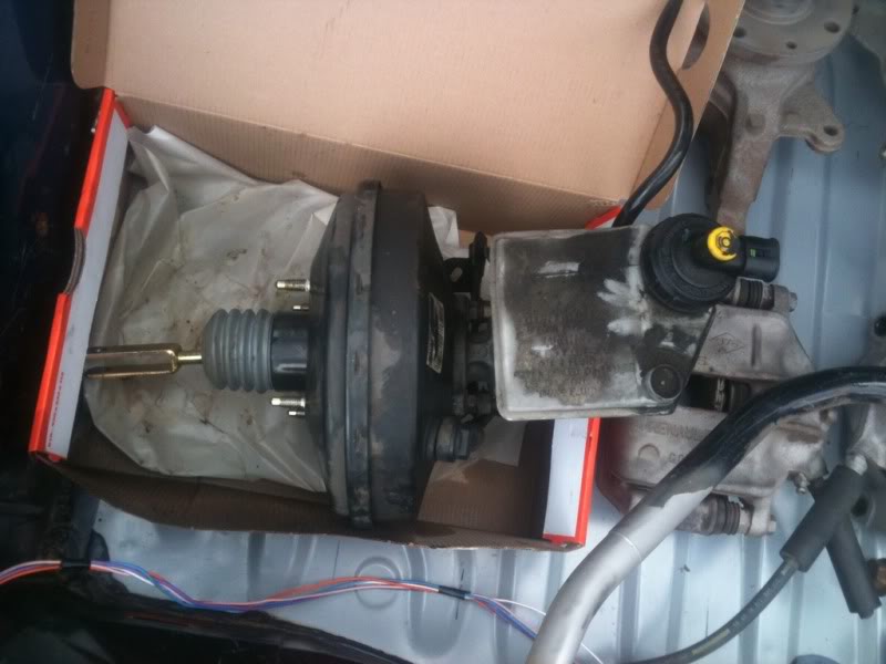

any idea on what the brake pedal travel is like with those brembos? Im debating picking up a 172 master cylinder and servo fro mine.

I would probably buy one mate. I think I'm going to. I have a fair bit of travel.

Its drivable, feels like an extra 10-15% travel compaired to standard but I think it may need a rebleed as it feels a little soft.

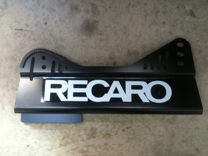

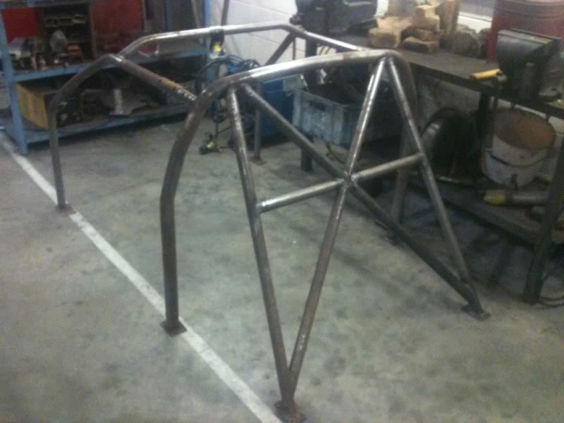

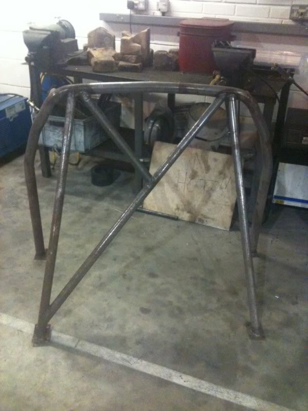

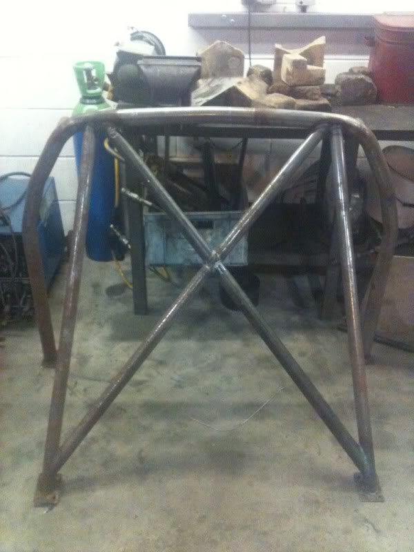

Ok, I have been shopping. Bought a pair of these with black side mounts
I have also bought an OMP 6 point roll cage.
I have to wait 2 weeks for my seats but my cage will be here tomorrow hopefully so ill get some pictures of it when it's in.

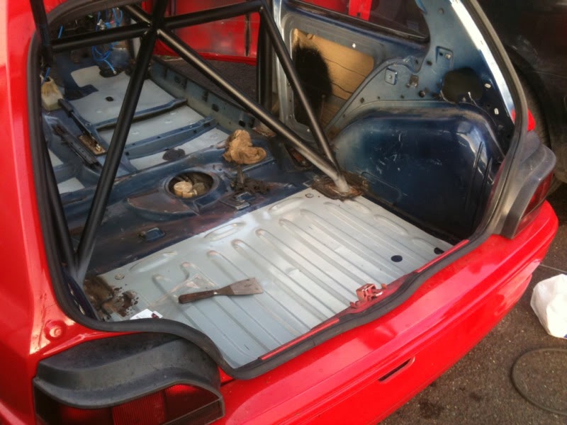

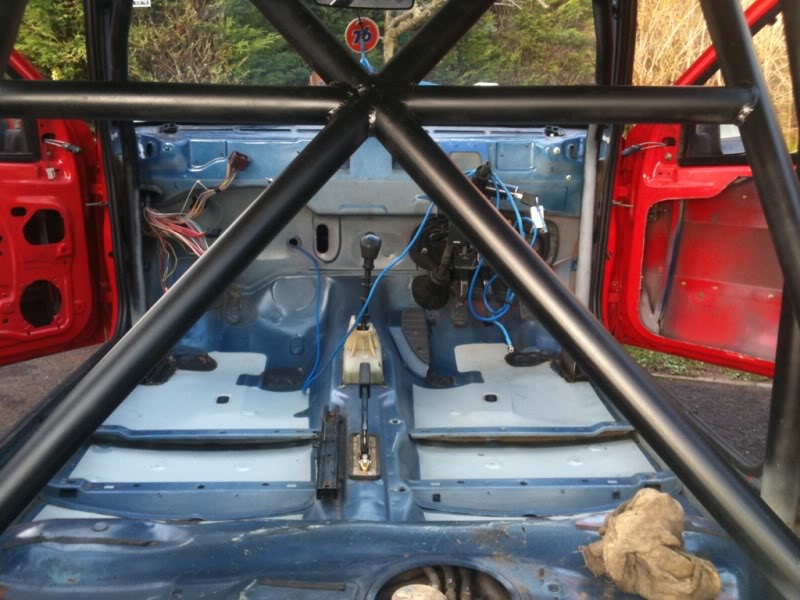

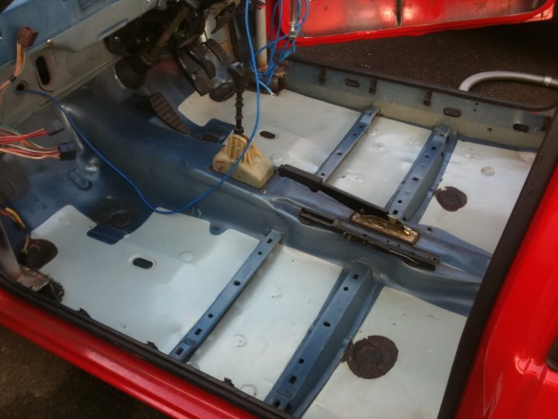

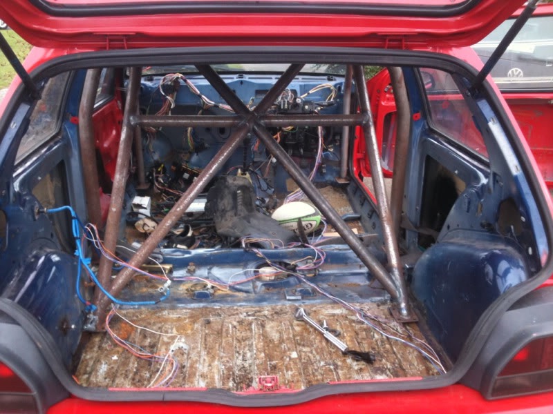

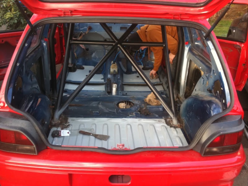

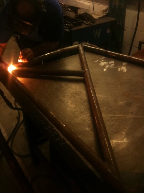

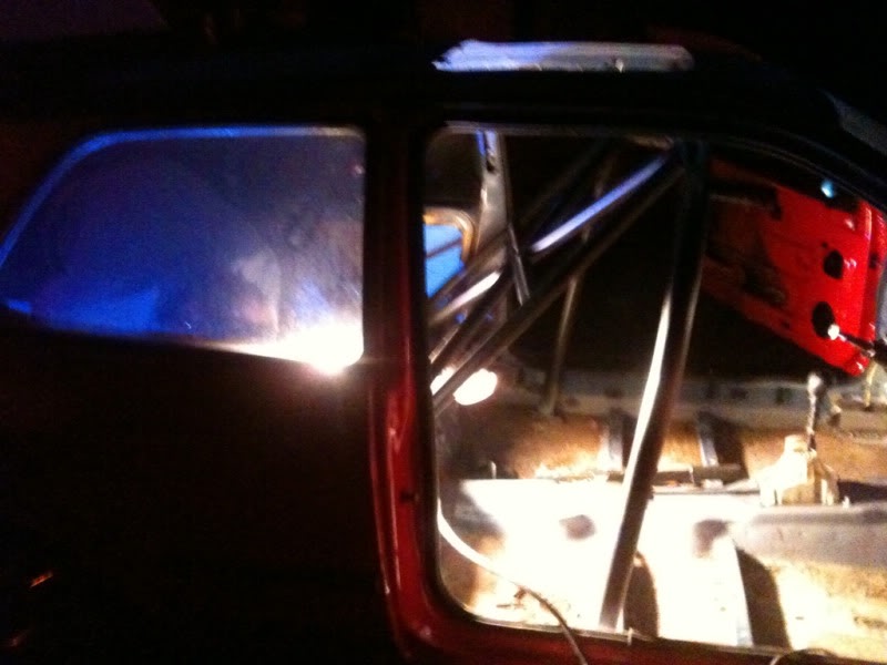

Progress from the weekend
Cage trial fitted to make sure it was ok.
Weld the beaut in.
Clear all the tar off the floor and generally tidy it up.
Hopefully my seats will be here next week and I can make up some subframes and get them mounted in. Then i'll fit my harnesses that I got this week. Getting there! I need to make a trip to a scrap yard to get a few little bits and bobs.

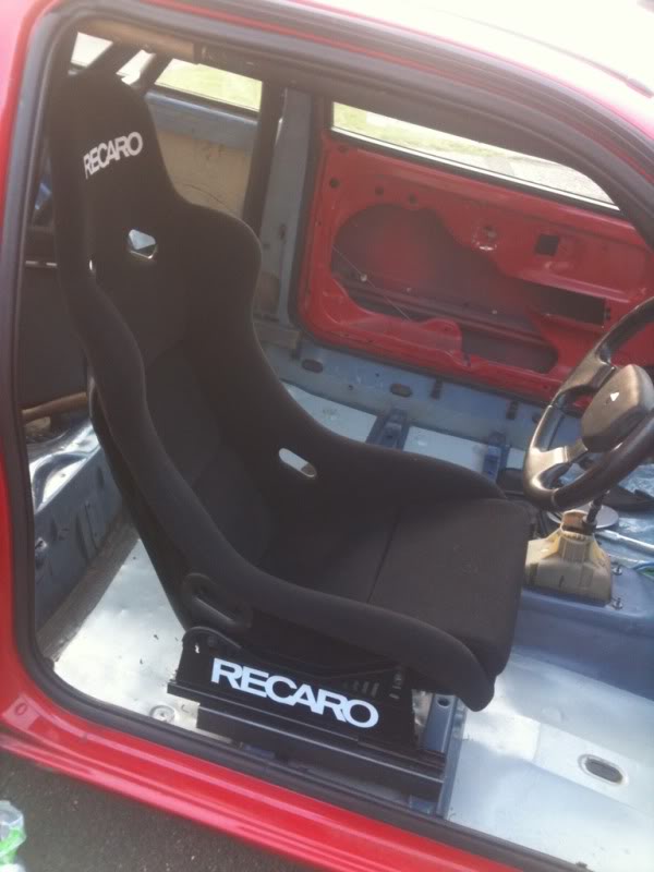

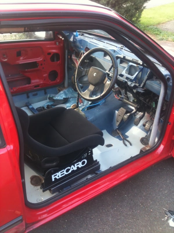

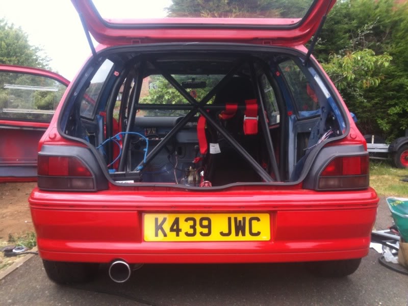

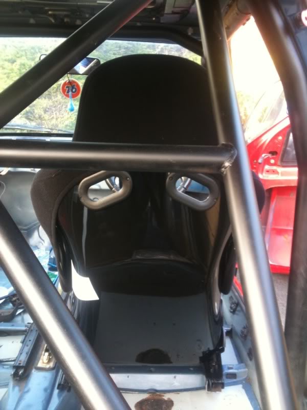

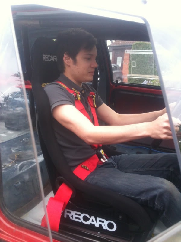

Update.

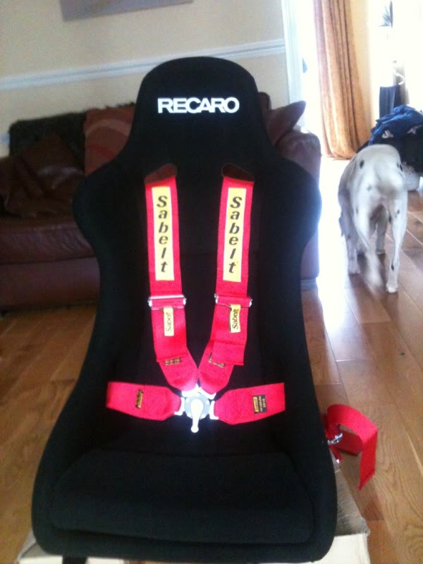

Seats arrived so i put them with the harnesses to see what they looked like.
Made a subframe up today and fitted one seat in.

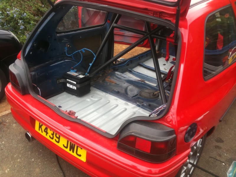

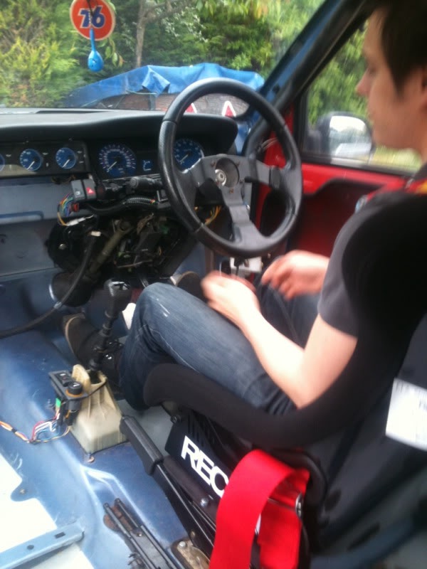

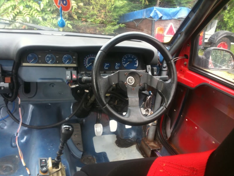

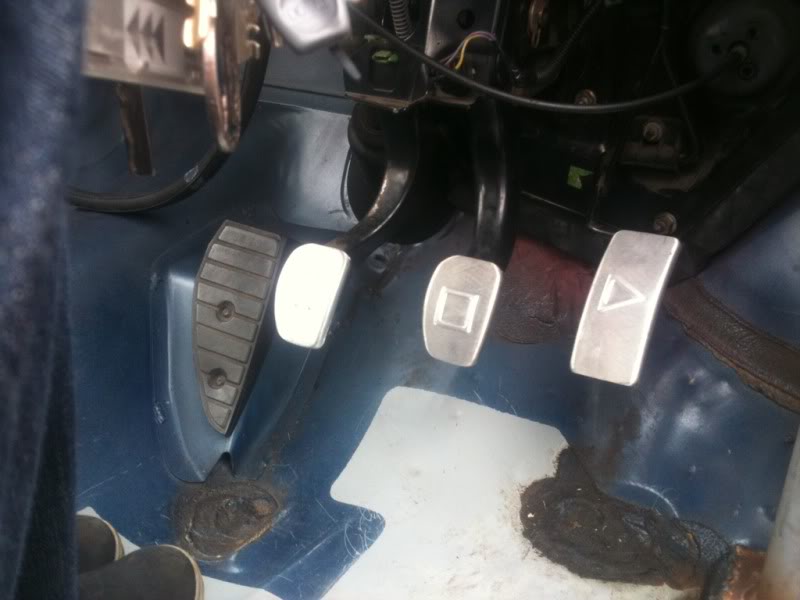

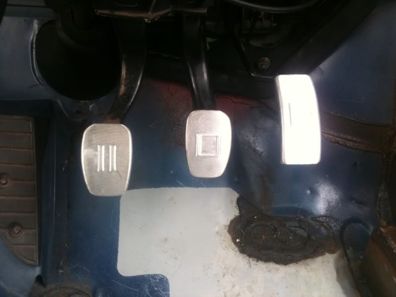

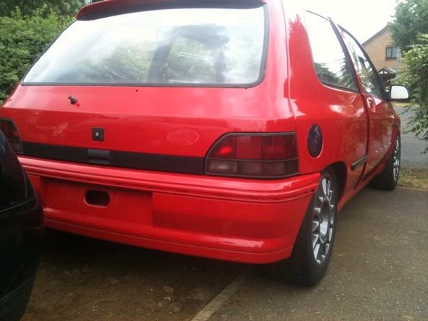

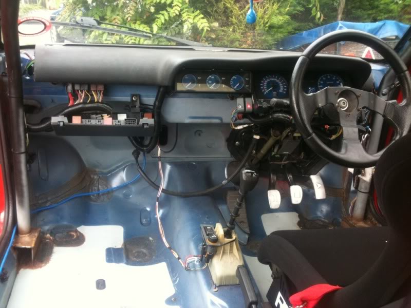

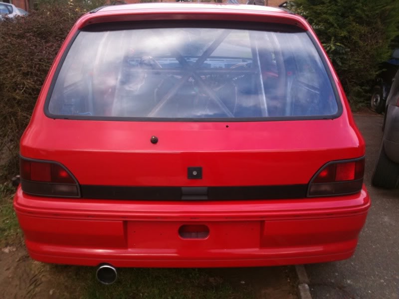

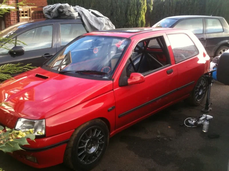

Ok, so the MOT is tomorrow. Finished it off today. Here are the pictures as it is now.
Made up a battery bracket and bolted it to the rear arch.
Here are the Twingo pedals fitted. I think they look awesome. Thanks Nath!
Lets see what happens tomorrow then!

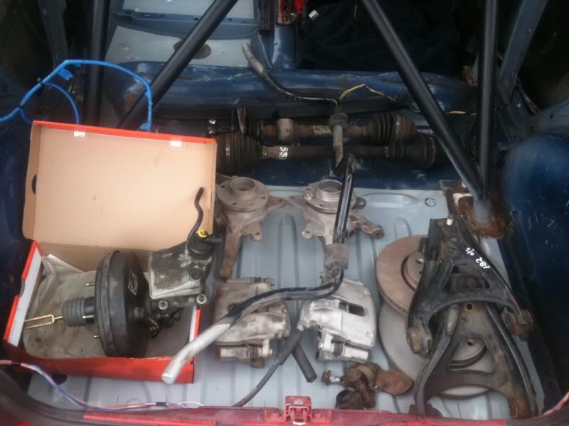

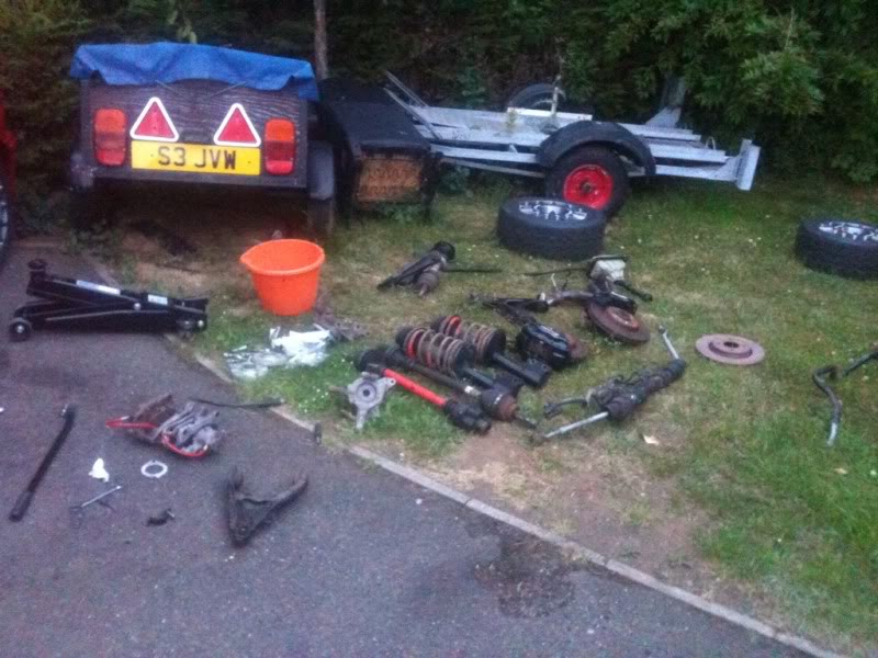

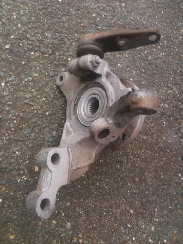

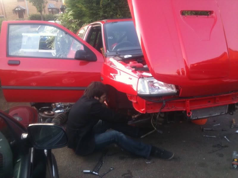

172 bits blasted and cleaned up.
Machined hubs to fit mk1 struts
172 cup servo and master cylinder
  Mk1 F4R

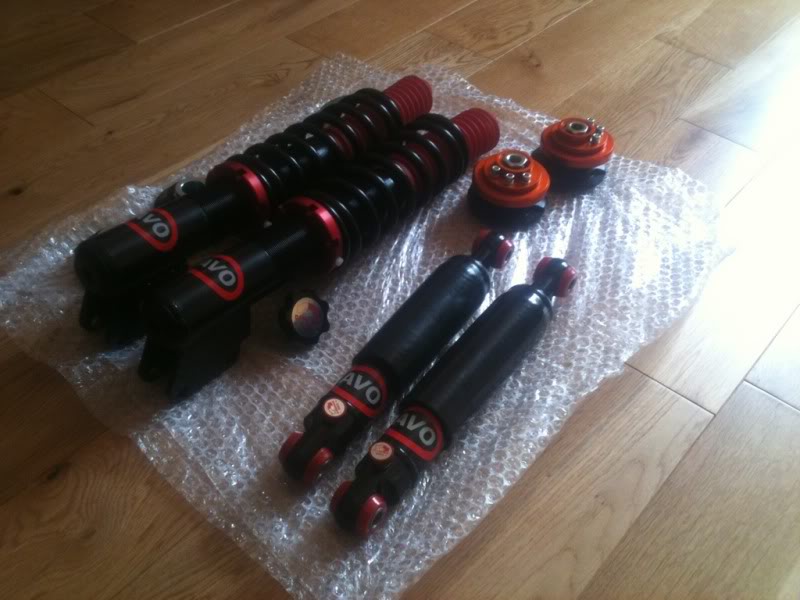

Hi Tom, Its still the same engine spec really. Nothings changed there, no need to really. Its an awesome engine.
I recieved my coilovers today. I opened the box and noticed that it said "Clio 16v 90>" so I checked out the part numbers on AVO's site to find that they were the wrong ones.
I phoned up and the guy I spoke to was like "but the Williams is a 16v, its just a 2.0 instead of a 1.8" :headno:
After he checked the parts numbers he agreed to pick the coilovers up and send me out the right ones. Dunno how long they will take. Im thinking of getting the whole lot powder coated while its all off. Dunno if its worth it though.

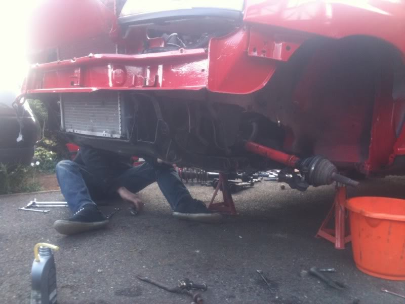

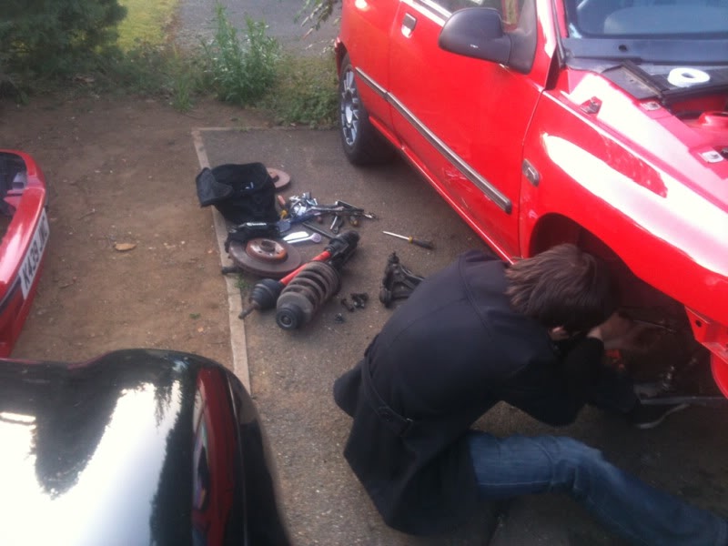

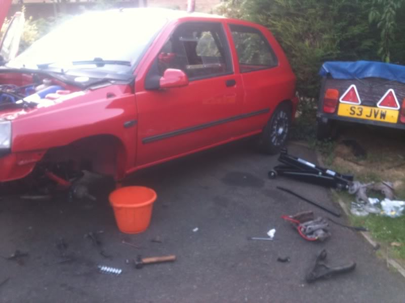

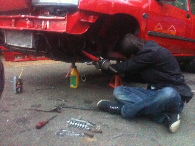

So, I discovered the 172 ARB doesnt fit. :( I was told it would to begin with.
I think I am going to make one up. Not sure yet. Might just use the Williams ARB for now. This is what happened today.
Ready to assemble when my coilovers arrive.

Coilovers arrived today. Earlier than expected....
2 problems to overcome.
1. The spring cups for my ASTs are too big to fit inside the springs. Need to dremmel the springs a bit to make them fit.
2. There doesnt seem to be a lot of meat around the strut to hub holes. I think I will have to sleeve the hubs, making the holes smaller to take the MK1 bolts.
