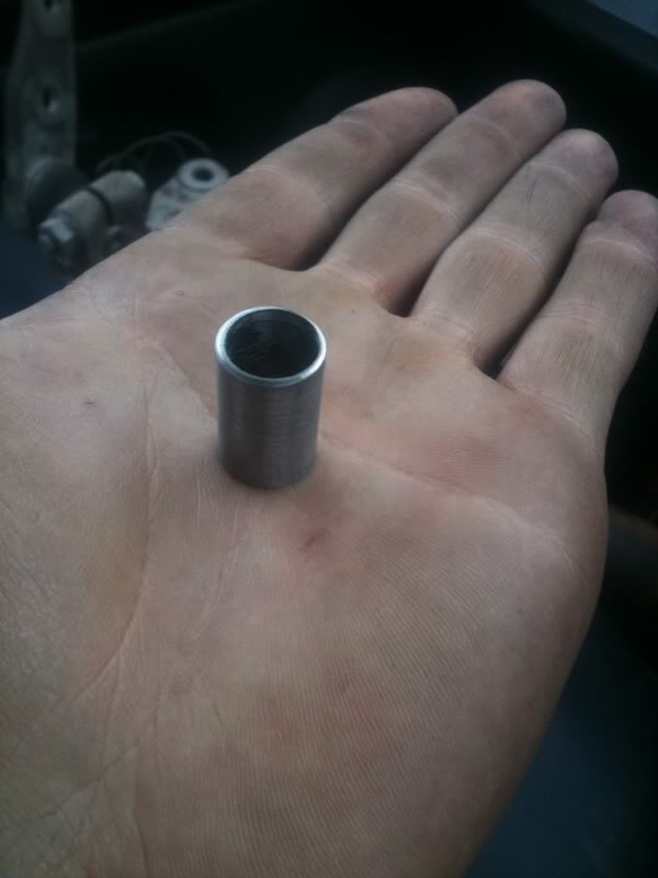

Sleeves made for 172 hubs.
I also managed to get the srping cups to fit in the end. Used a flap wheel on a drill and took some metal off the spring.

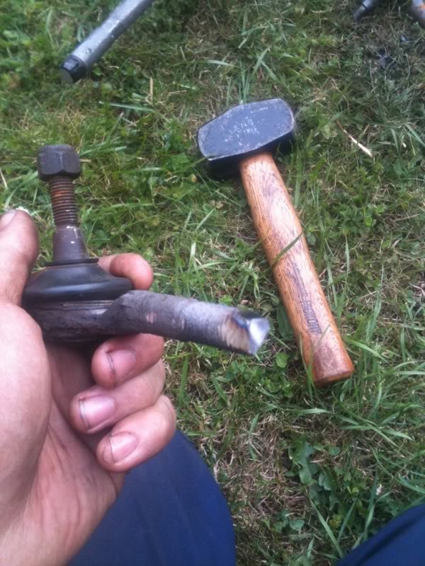

b****cks!

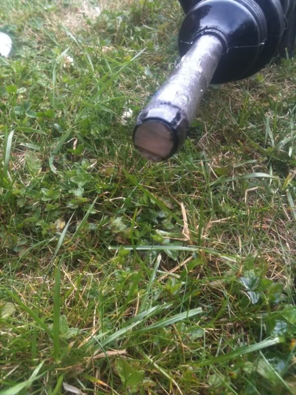

Snapped a track rod end off in my Williams rack. Ill drill it out at work tomorrow.

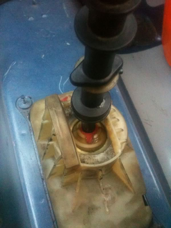

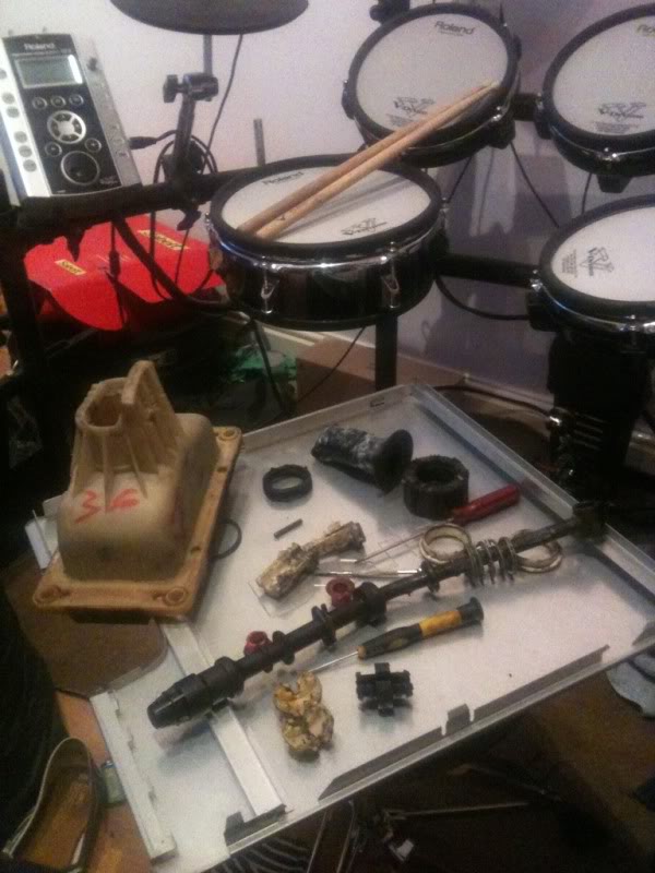

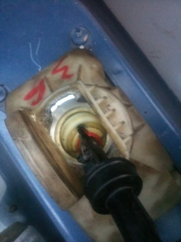

While I was stuck with assembling the rest of my car, I decided to fit my stiff shift to my gear shifter.
In bits!
In the car all fitted.
Took about half an hour, a bit fidily, but its done!

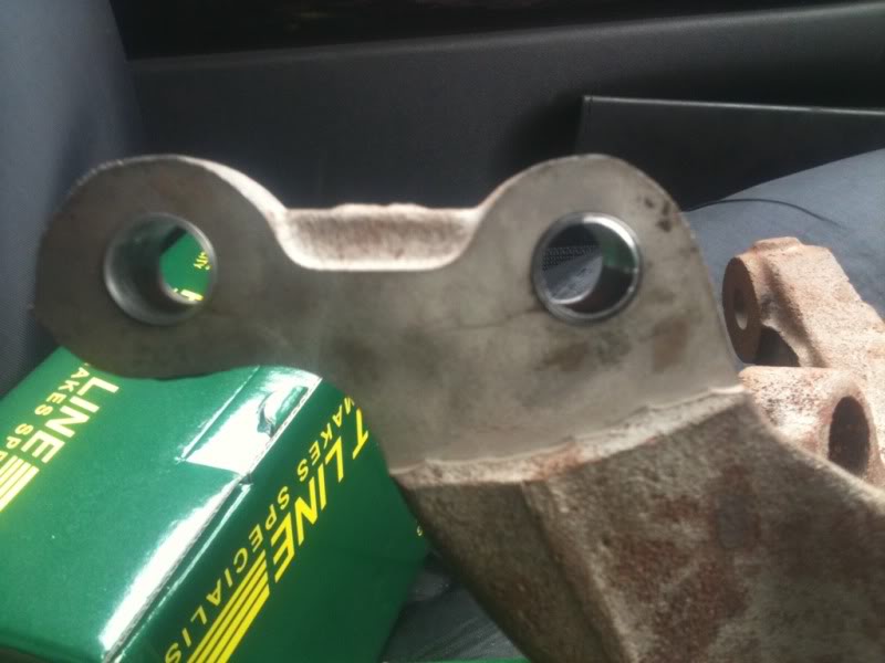

Me and nathan had a good day putting all the new stuff on the car today. got quite a lot done, just need to put the brakes system on. then its done. Just one problem, the coilovers are the wrong ones again!
I fit them today and noticed that a few things were wrong. The thickness of my machioned hubs are 22mm. This is the MK1 thickness, the coilovers i recieved are about 26mm. also, the camber is way out. With the AST's on full neg camber, they are a little positive. I just spoke to Laine and looked at a few pictures of his AVOs to see that they are completley different. FFS!

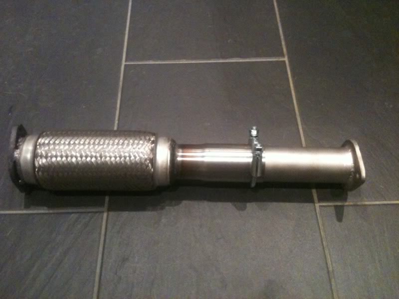

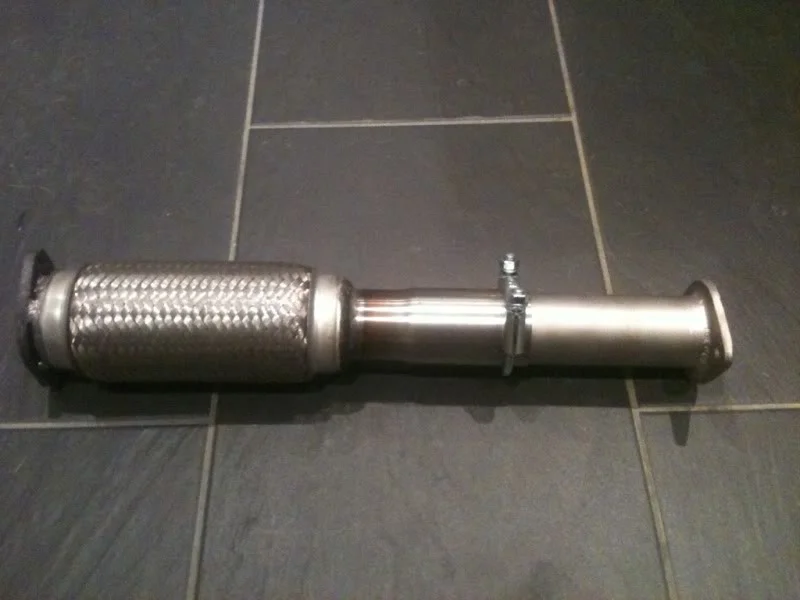

New Decat pipe made up today.
Flexi tube and it's sleeved for length adjustment.

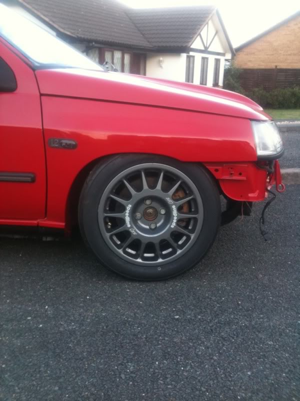

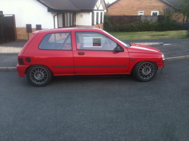

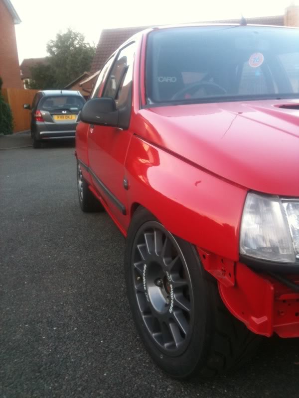

Bled it all up and lowered it to the floor with the new AVOs on it. Looks awesome but is far too low and I cant steer it really. Need to set it all up and adjust the height. Here are some pictures.

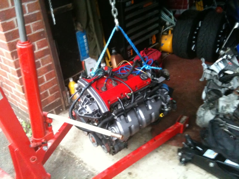

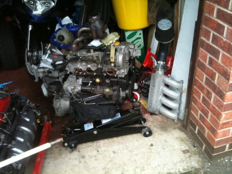

Old engine out and working parts sold.
Anyone wants a JC5-014 gearbox, £150 ono. :D
Picked up the F4R and box, somehow fitted it in the back of my Lupo as one piece. Was hilarious shoehorning it in. :D

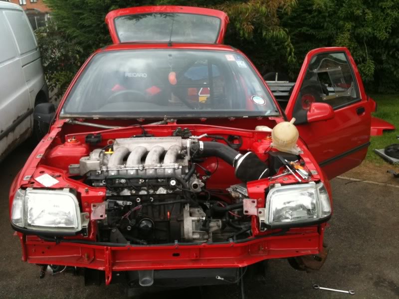

Engine in, Couldnt get it to tun properly at all. Ill have another go tomorrow.
  SG 200 Cup+F4R'd MK1
Re: MK1 F7R track car project
Wouldnt idle. Just spluttering and stalling. The only thing I didnt have connected was the lambda sensor, dunno if that would have made any difference. Need to fit the exhaust and try again tomorrow.
