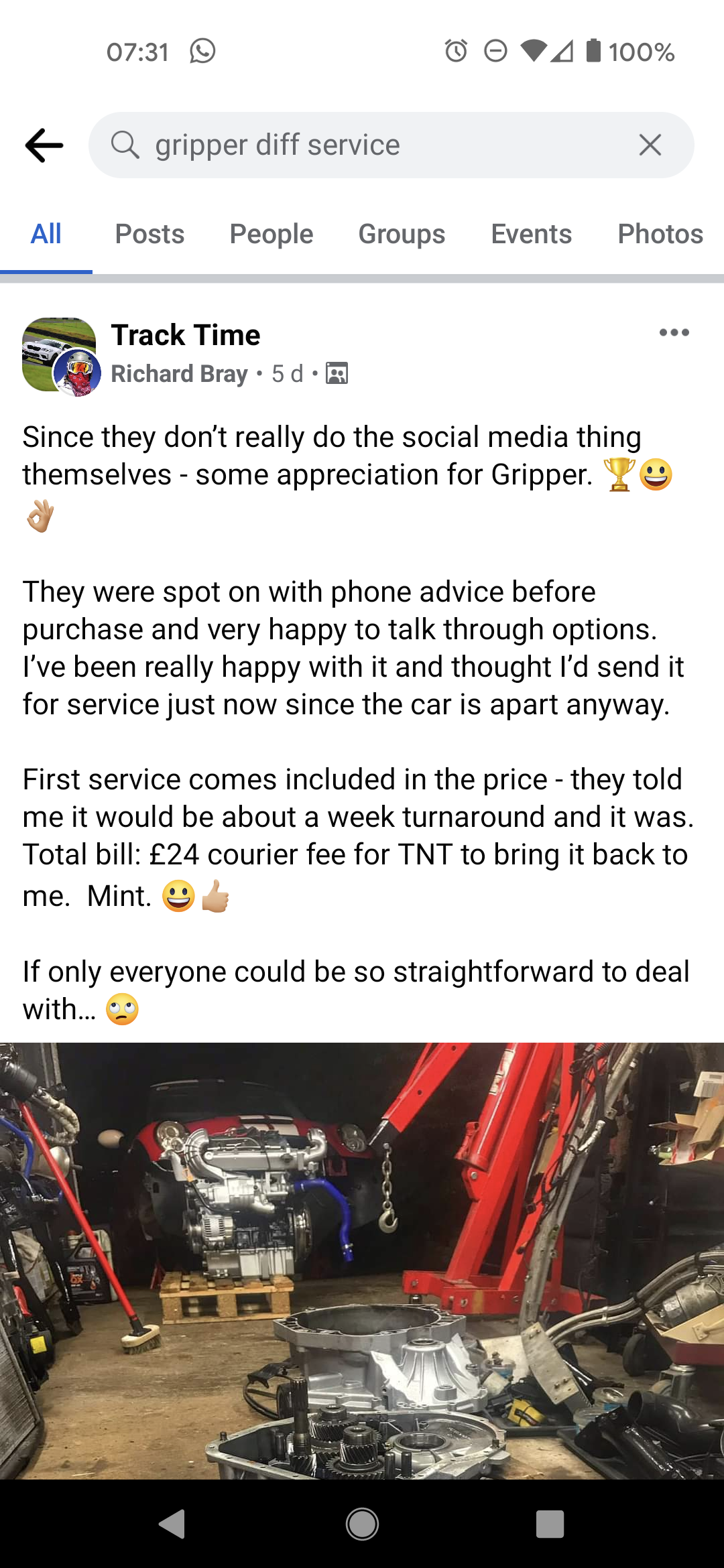

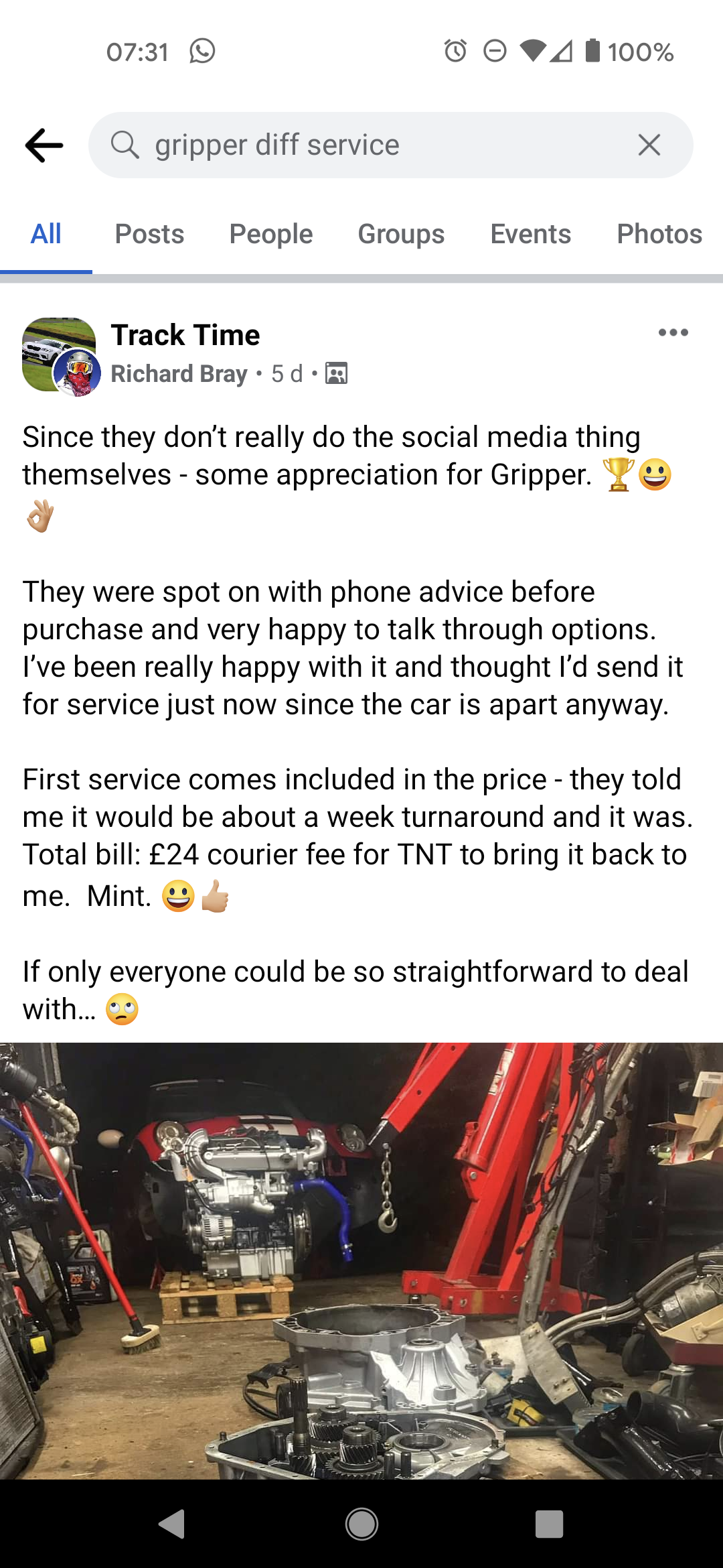

Worth noting that the Gripper will need servicing after a year or so i believe and then it's good for 2-3 years depending on which ramp setup you have.
First service is included in the price of the diff.
