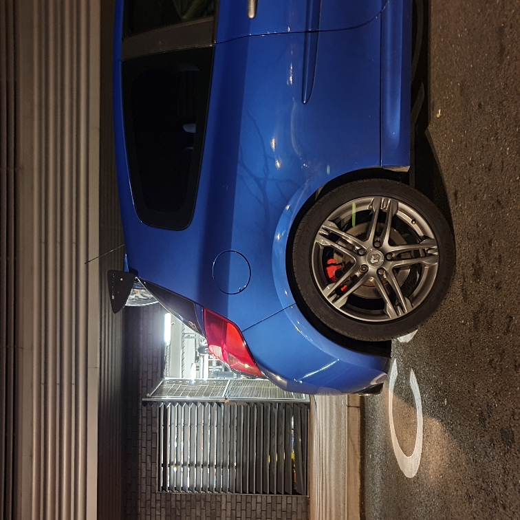

Got an RS200 with cup pack which needs full suspension refresh. I use the car as a (low mileage) daily, do most hard driving on bumpy B roads and will do a couple of track days a year max. Find the current set up a bit too harsh at times (though might be because everything's worn and I know yr the bump stops are knackered)
So was thinking of going for the non-Cup dampers with Eibach pro street springs, to improve ride and look but still allow for occasional track day
Has anyone done similar or experienced Cup Vs non-Cup chassis? Or will brand new Cup parts give a much better ride?

Quick update, still can't make my mind up [emoji51] but turns out the car was on H&R springs so
1) it's already sitting lower than it would on Eibachs
2) that explains why ride so hard as I know these springs are firm. So at least whatever I go for will be an improvement [emoji41]
