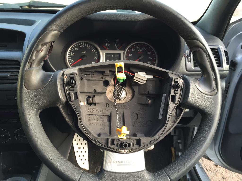

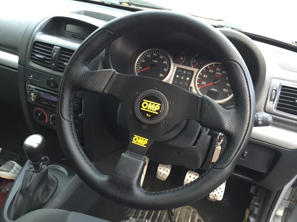

Steering wheel day today:
Managed to get the airbag off ok.

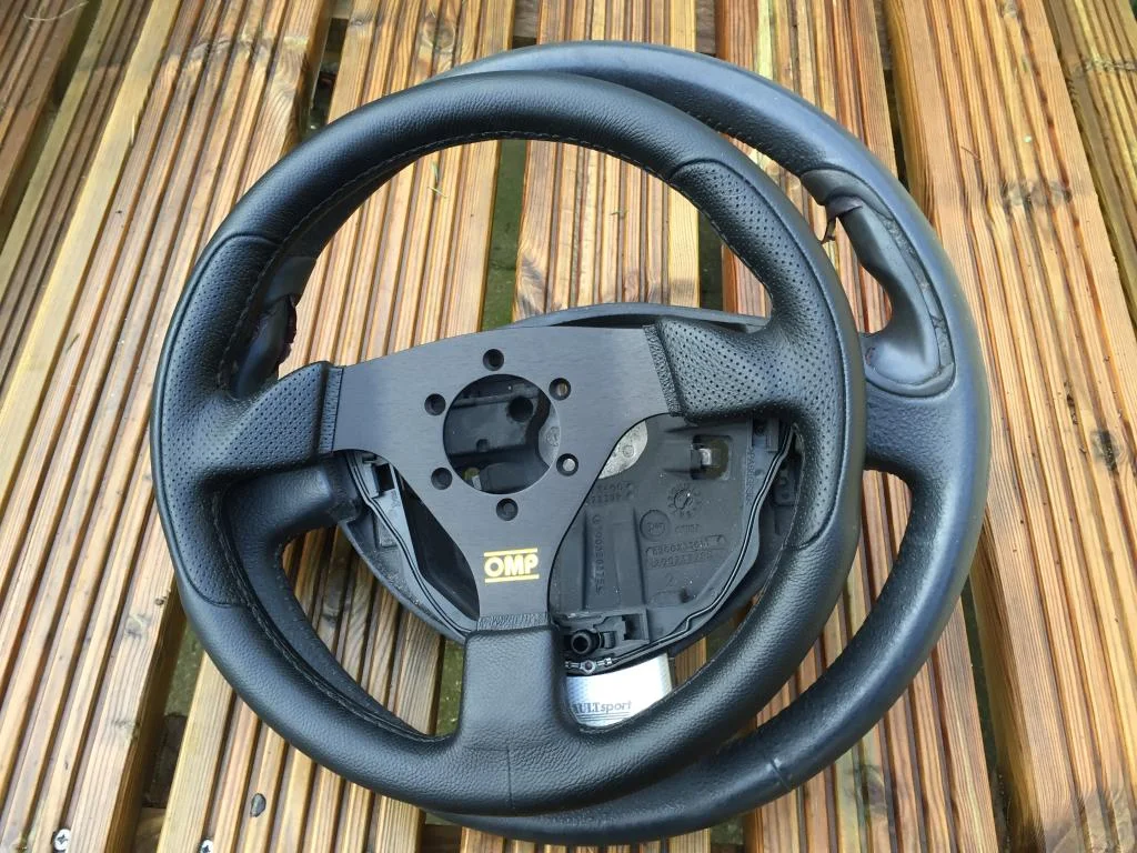

This shows the difference between standard and 330mm. I think 300 would be too small so happy I went for 330

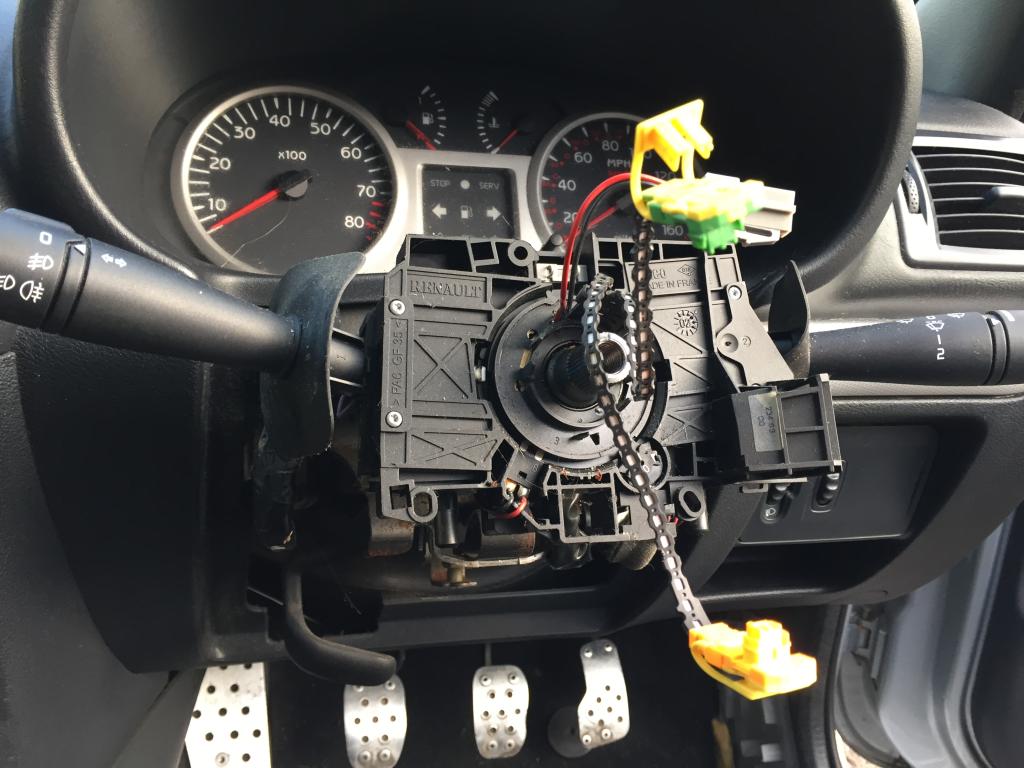

Wheel off:
So whilst this was off I decided to take the radio controls off I don't need and Hoover out all the crap that was behind there.

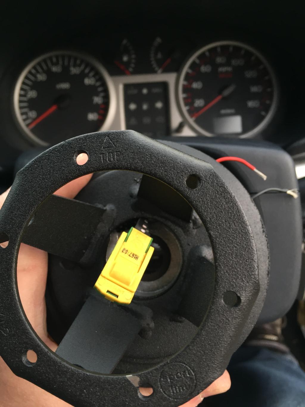

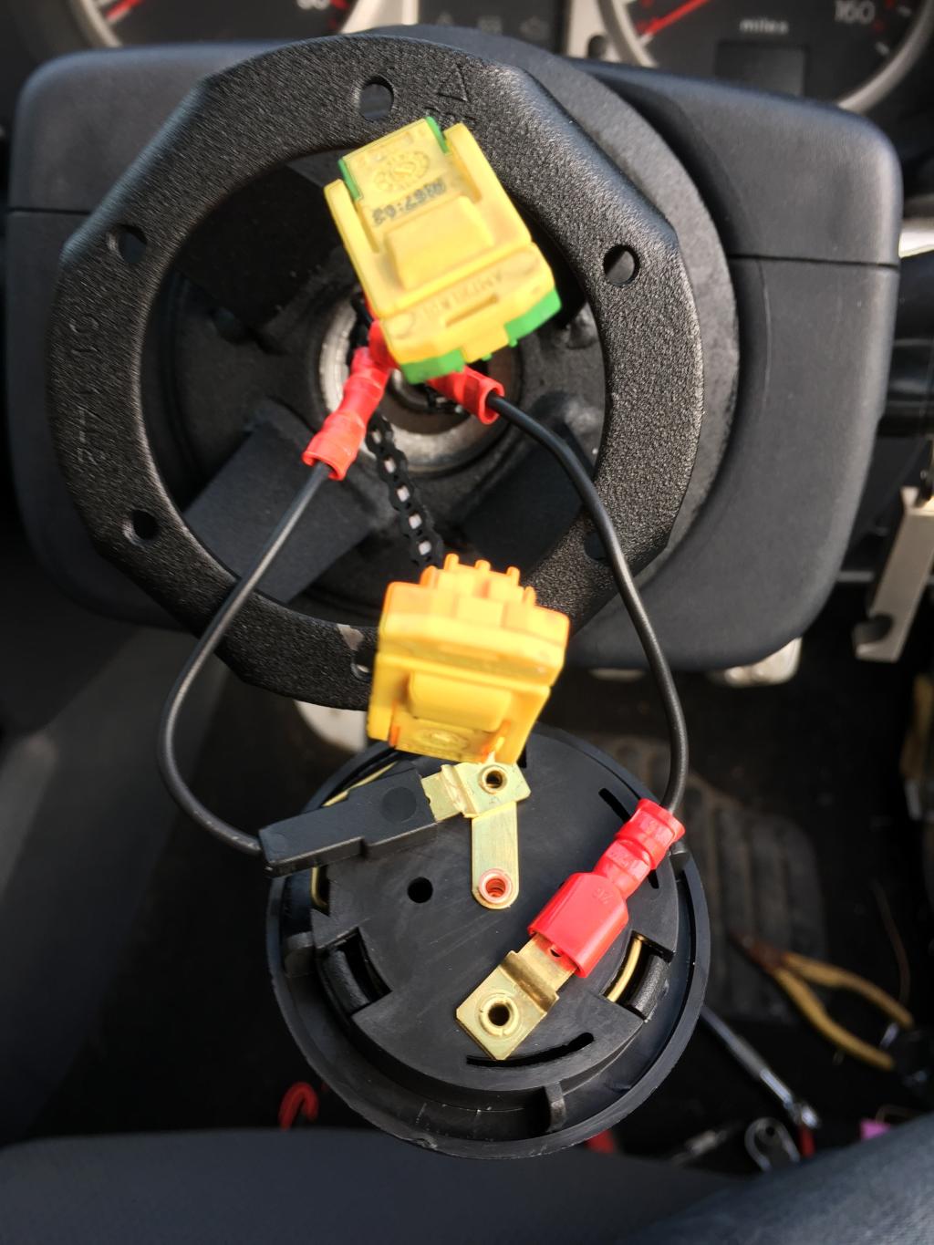

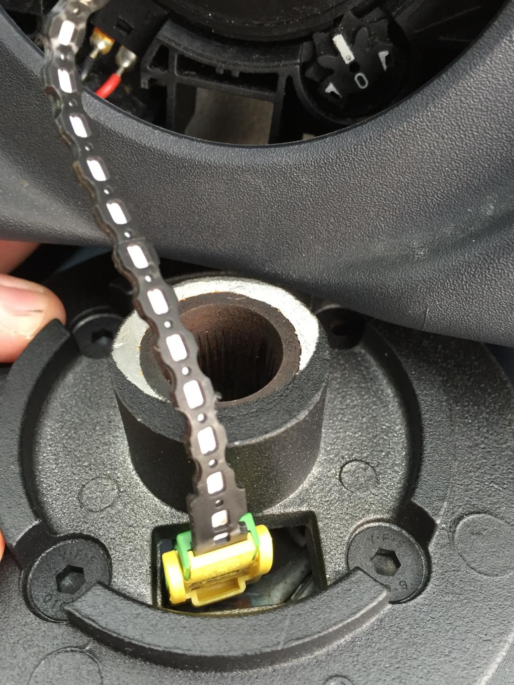

The air bag connectors were a tight fit through the boss but it is doable if you open the clip first before feeding them through.

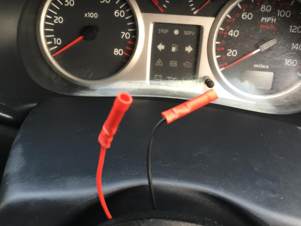

I decided I was going to extend the horn cables and use both wires rather than use the wheel as an earth.
Should have don't this bit before putting the air bag sensors through but not to worry.

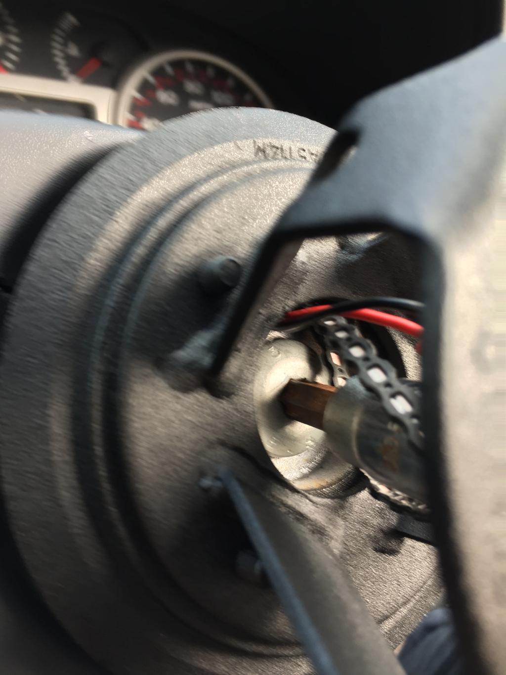

Once it was all tested I could get the boss on the splines and tighten it up.
I then put the rubber boot on, washer on and first screw in loosely:
All the screws in and connect the horn up and job done for now.

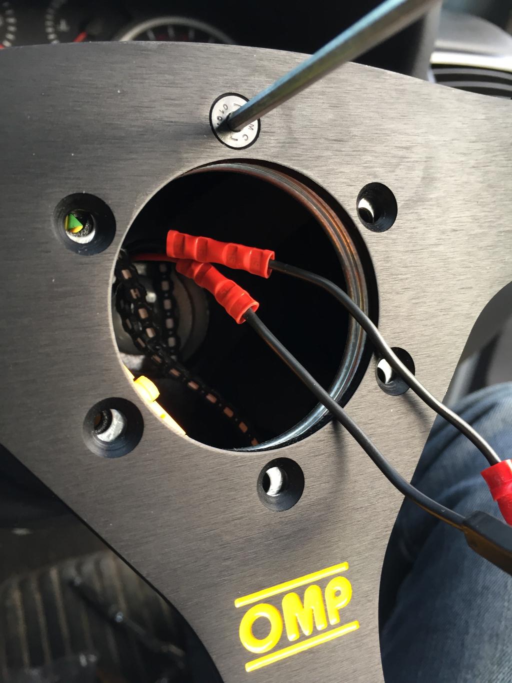

I say for now as you may have noticed I have missed a few steps there in regards to air bag resistors. There was a fused resistor with the boss but it was very loose in the connector and didn't seem to work. I tired it in both of the two air bag connectors to no avail so I have left it off at the moment and will sort something out one day. I figured all I would need to do is pull back the rubber boot on the boss and get enough space to play with it without having to remove the wheel.
When you say you tried it in both of the connectors, surely that's not going to work as you will need one in both?
Wheel looks bloody awesome though mate, how does it feel?
They only supplied one and I don't have another resistor to try so will get hold of another and try again. I know they are cheap but I might as well contact the supplier and explain they sold the boss vehicle specific and it doesn't work so please send another.
Just to confuse the matter further, the air bag light was already on before I started and the garage that sold the car said they didn't think it was the seat connections but the air bag unit on the steering wheel so was hoping this wheel change and resistors would solve this.

Wheel does look good and as I said to Daniel, 330 is the perfect size for a daily and a blast!

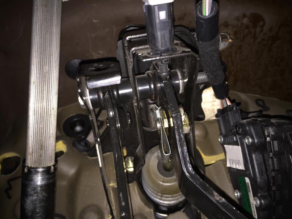

Found the brake light was on all the time before when I reversed up to the house and saw the reflection in the window. Turned out that the switch is a push to break and it wasn't touching the pedal so was made and on all the time. Scratched my head for a while and couldn't find anyway to adjust the pedal or the switch so resorted to taping cardboard to the pedal. I went to search the forum and couldn't find much until I went to start a new topic. That's when I noticed there had been a guide about how to adjust the switch. Felt really stupid when I found out you can just pull the end of the switch which moves in and out with clicks. All sorted now. :)

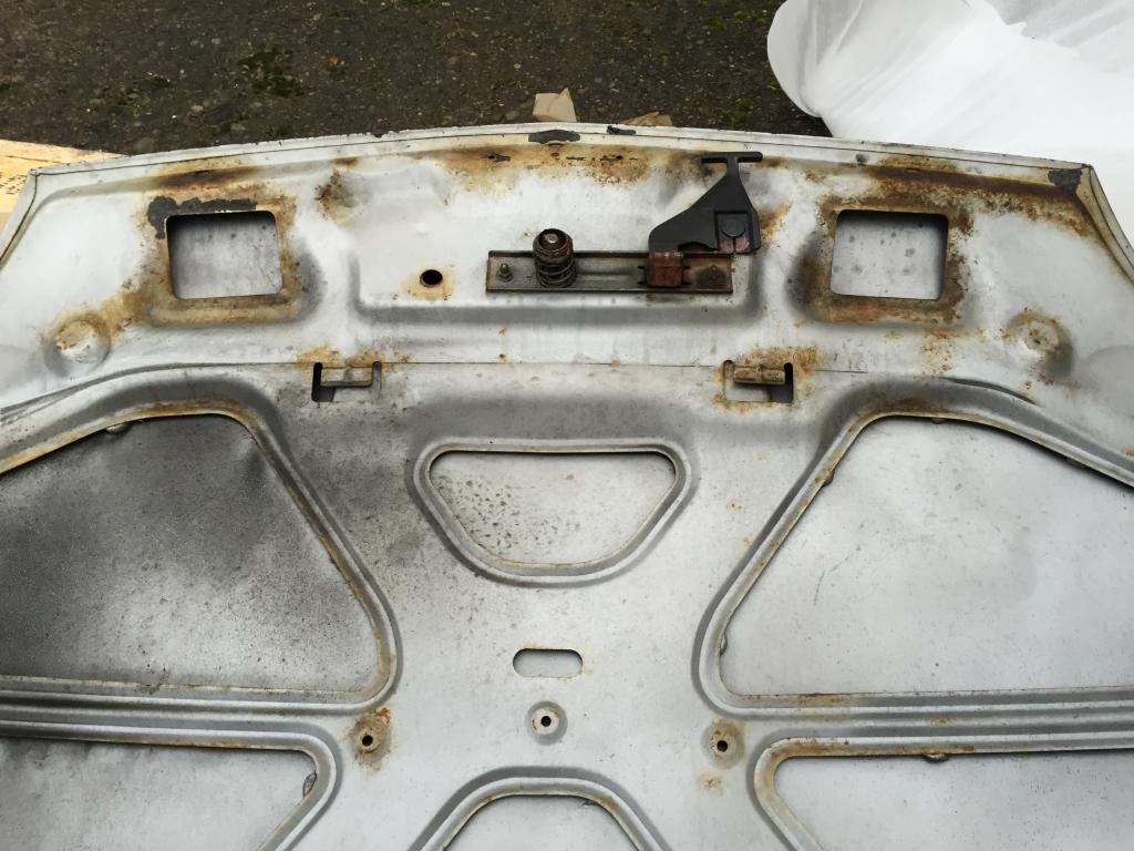

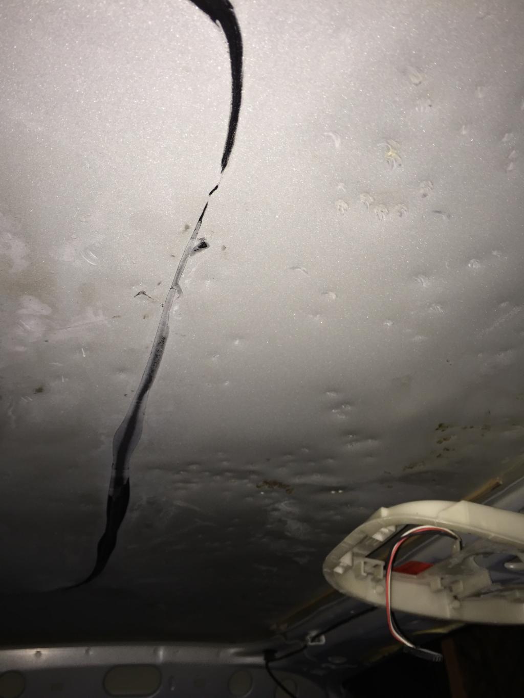

Did some more stripping this evening. Started to uncover a few strange things. Took the roof lining out to find the underside of the roof looking like this:

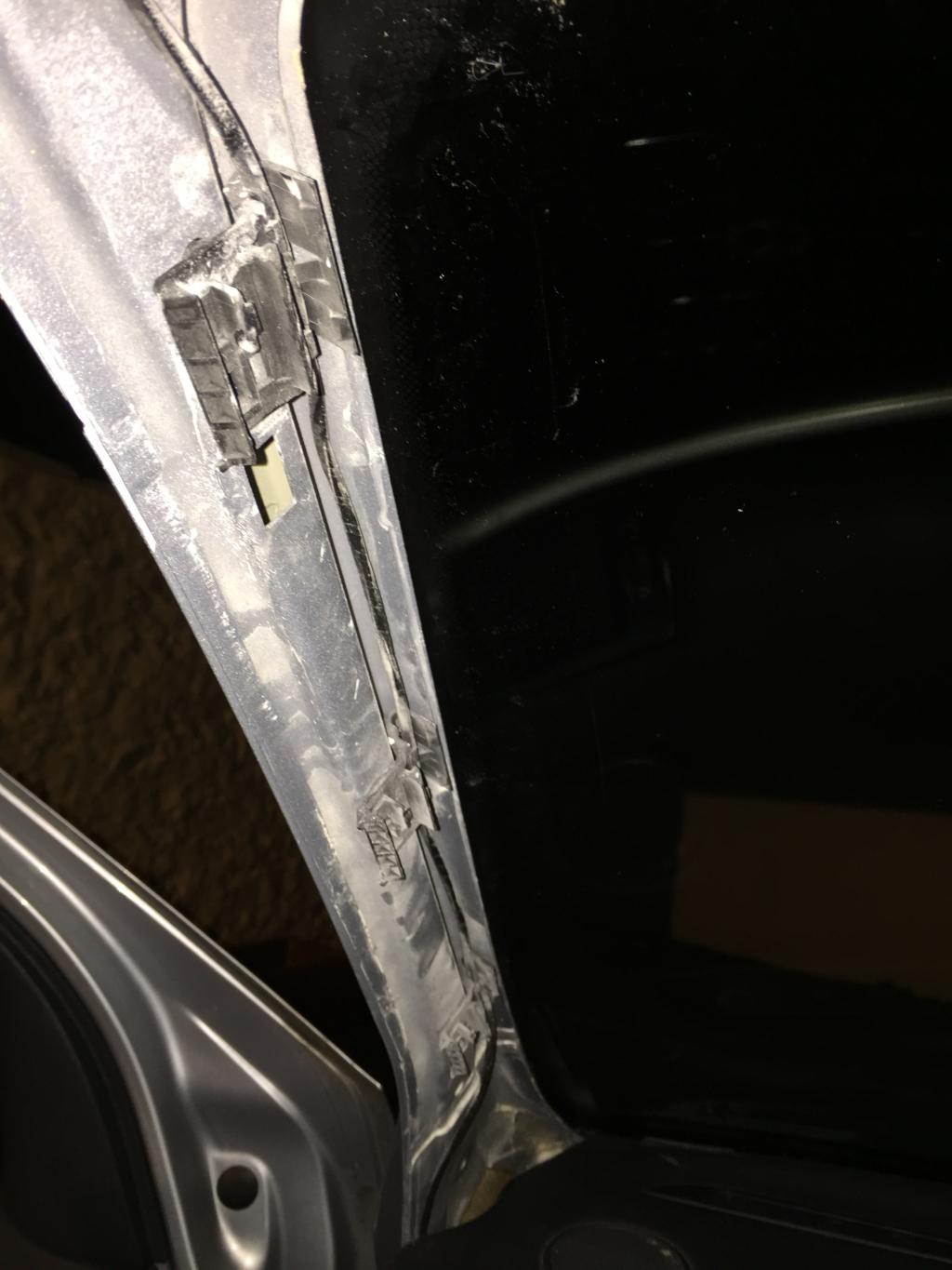

Also after taking the pillar trim off there was a lot of dust which to me indicates sanding before spraying something:

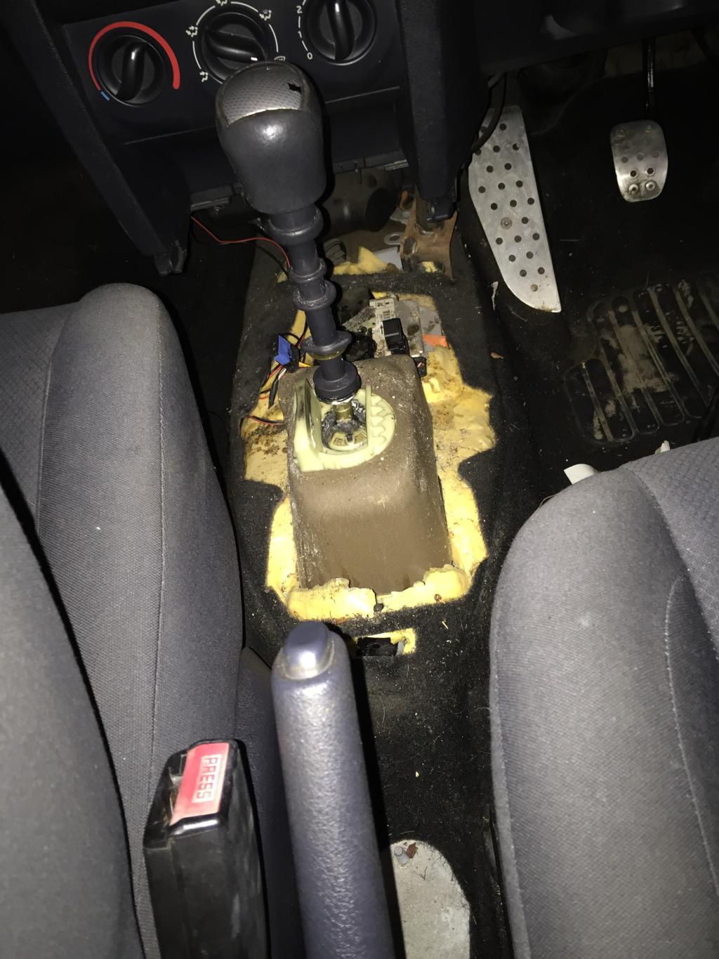

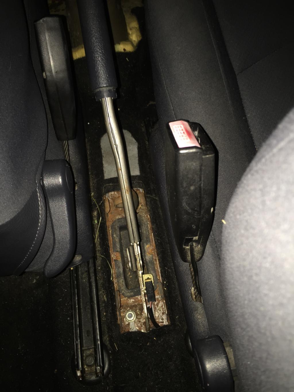

Also started taking off the centre console and handbrake cover.
It's losing weight but starting to look rough! Lol
The roof damage would be caused by the bonnet catch failing at some point.
I bet it's had another bonnet.
There may have been some work done to the roof from the outside but these dints have been made from the inside. Perhaps panel beaters knocking it back out. The bonnet is crap on the car with dents, chips. rusty patches on the underside and outside. Wonder what is in that box I posted earlier...

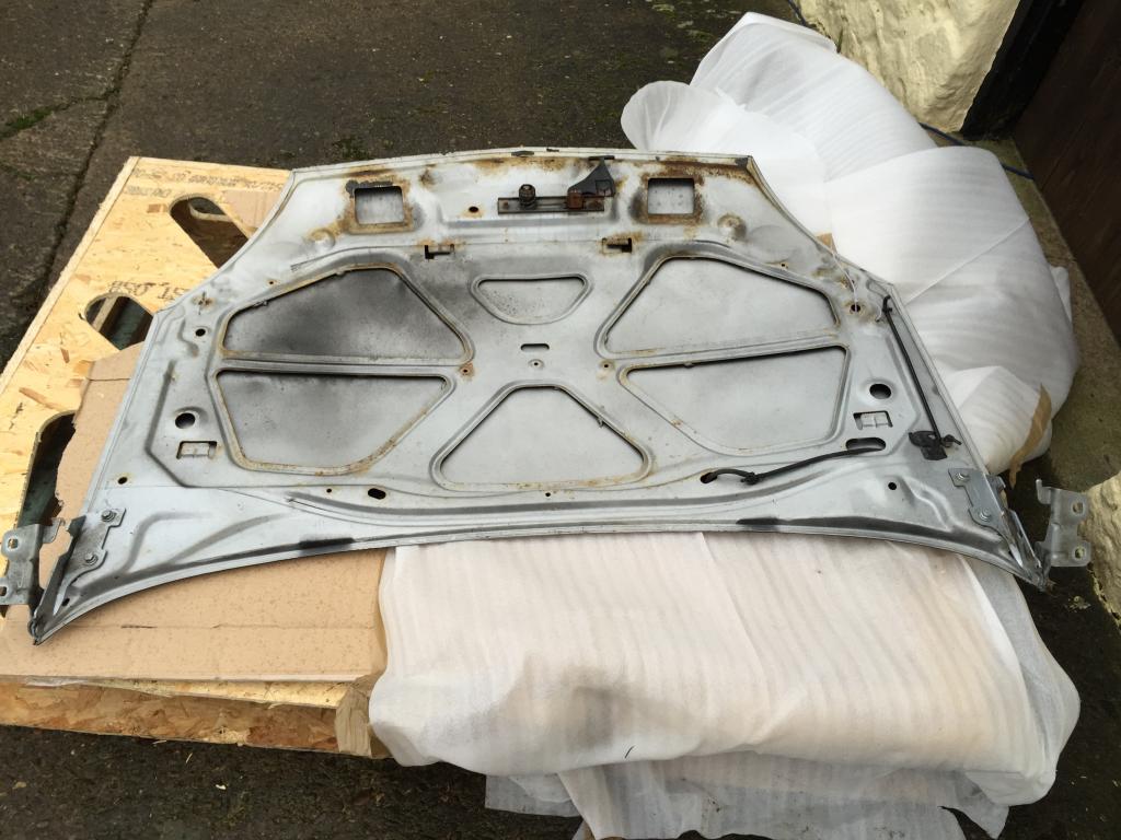

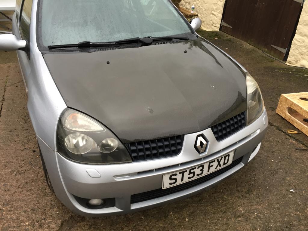

Standard bonnet was a state:

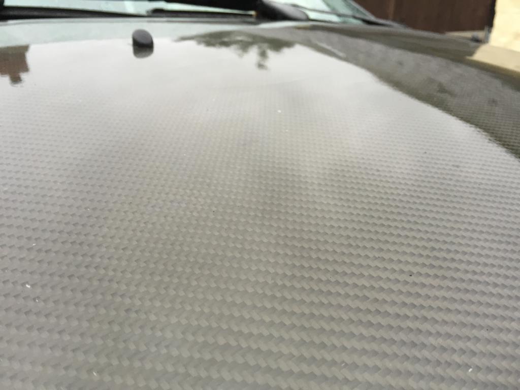

Now looks like this:
Couldn't believe the original receipt was over £1000!!!
A few blemishes in the lacquer but I will either live with it or get it sorted if my body shop man can do it. He said sometimes it can be difficult if it is pre pregnated and not lacquered.

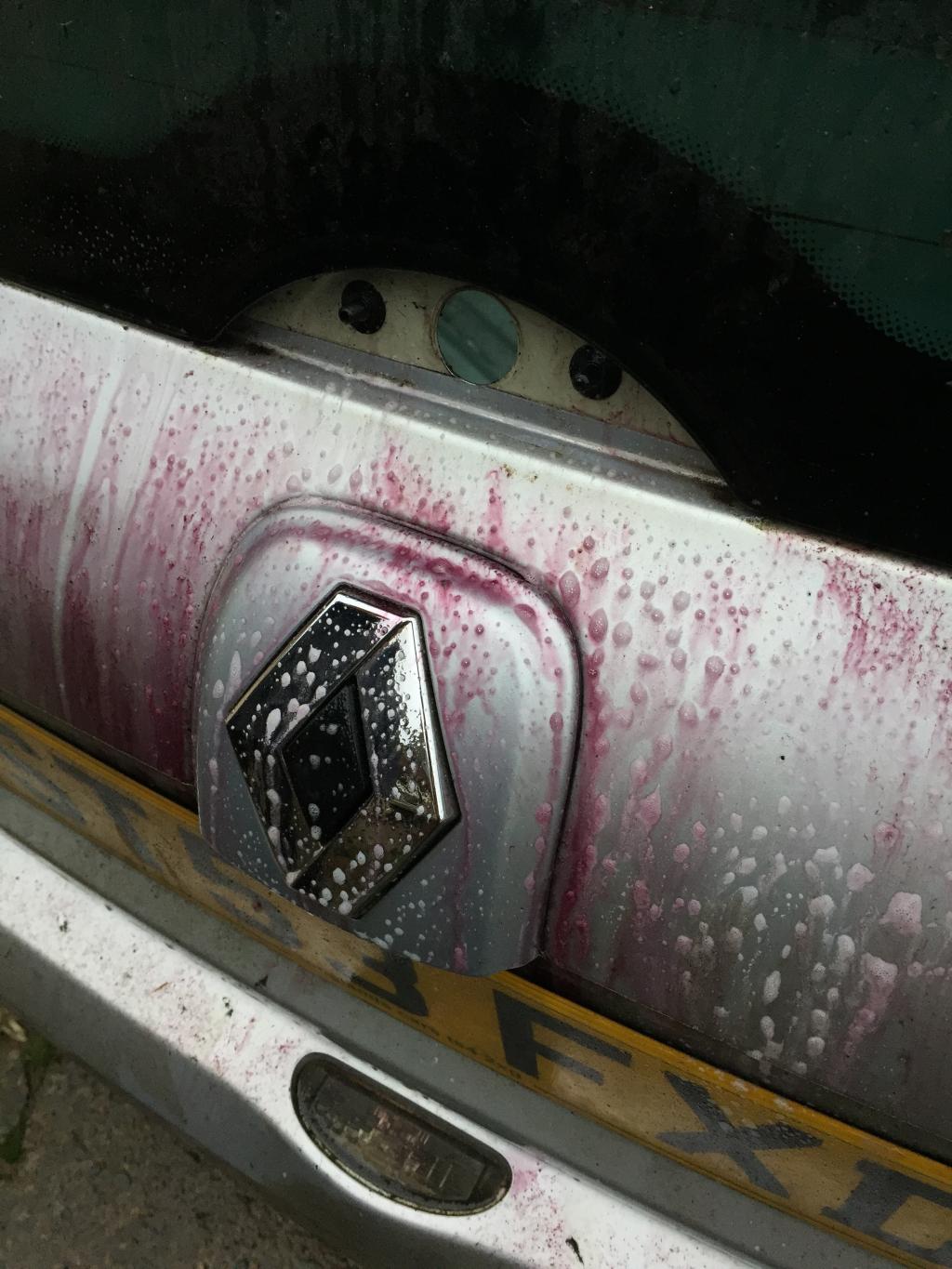

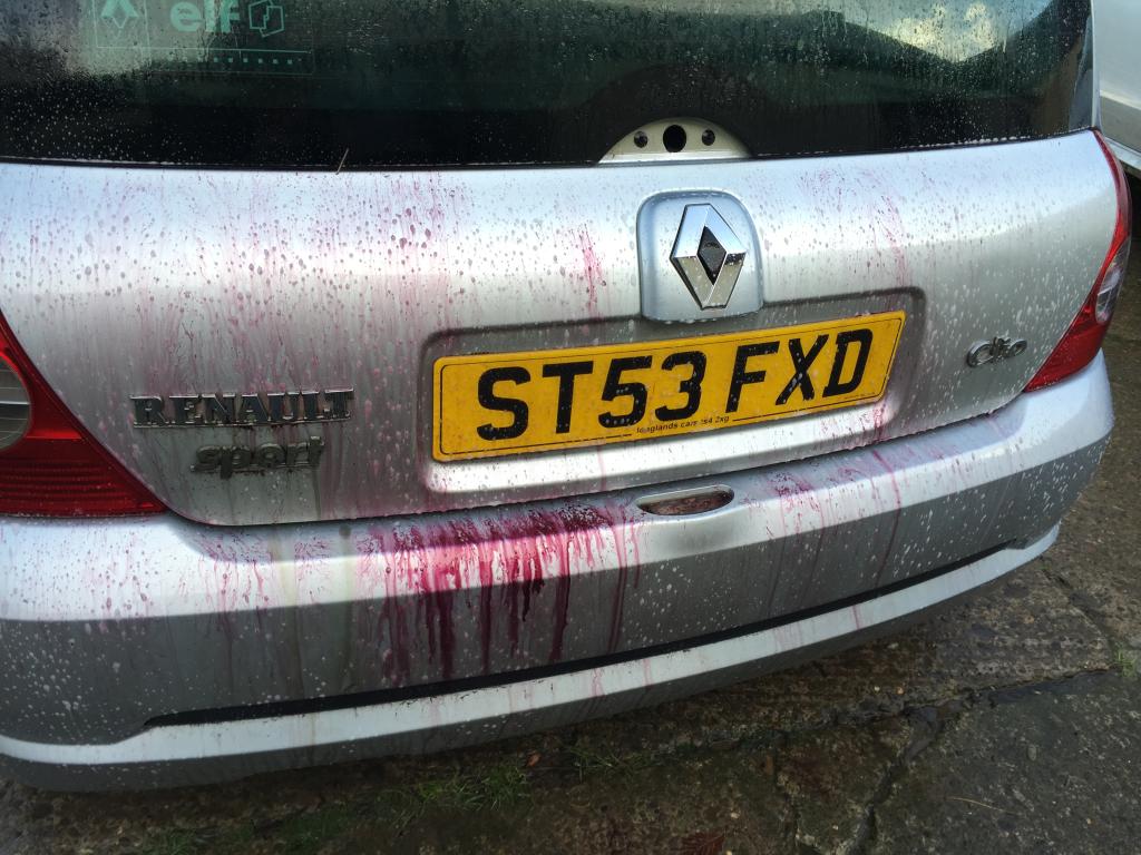

Noticed today there was still a lot of metal on the rear after cutting the wiper off! Had the IronX out again as I don't want it damaging the paintwork.

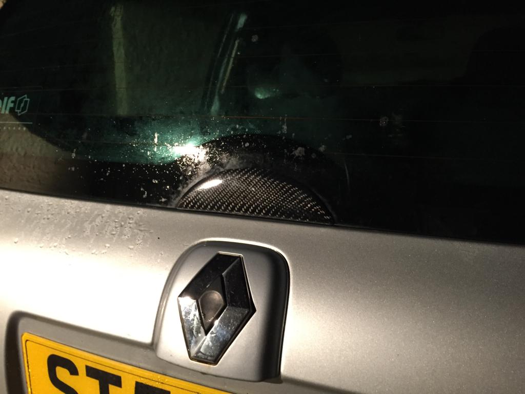

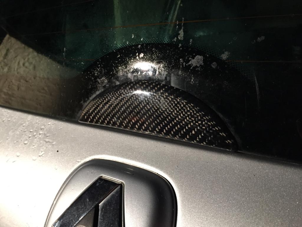

Anyway the carbon wiper cover arrived today so I have out that on for a trial fit. Needs a bit of sealant and lock tight on and to clean the window properly but it's on for now

I would have have just a black one but the fibreglass one they do requires painting so couldn't be bothered with that. With the carbon bonnet I suppose it goes ok. Still thinking of wrapping the roof and spoiler black.
