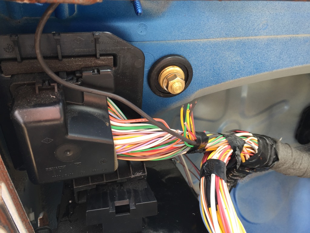

I think it's to do with the pink and white twisted wires. All mine went daft when I removed the OBD port too! I just ripped the lot out and going for a full custom race loom now.

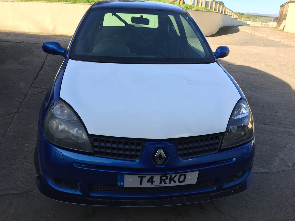

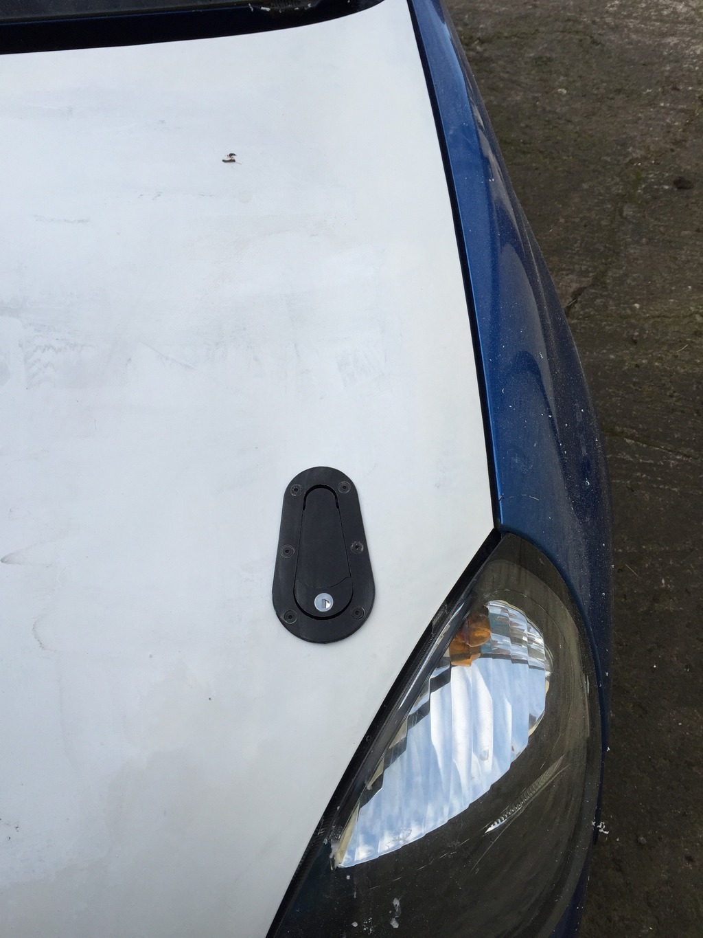

Fitted the bonnet yesterday but forgot to post it:
Not on any catches yet though just the hinges.

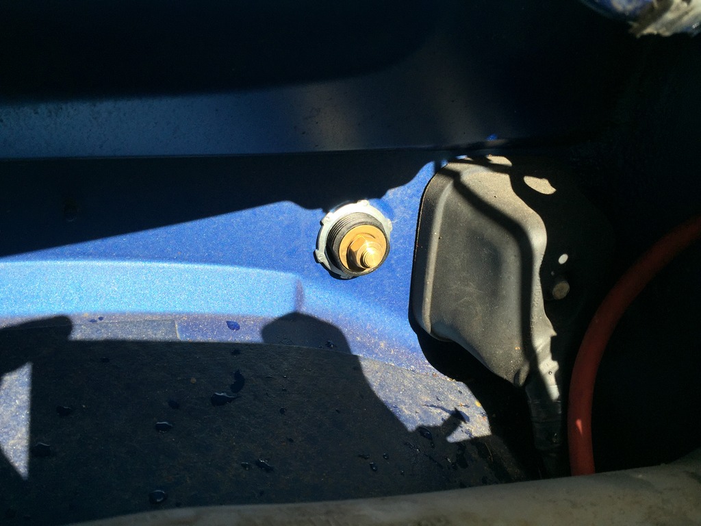

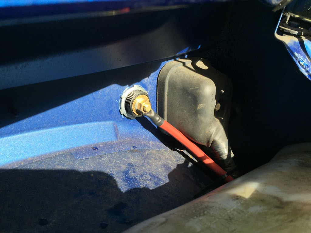

Anyway I managed to get the battery wired up this afternoon.
Inside I have just gone straight from the bulkhead to the mega fuse as I still have the dash out. Once sorted I will wire up the cut off switch properly.
Where did you get that bulkhead terminal? I Can't find one lol

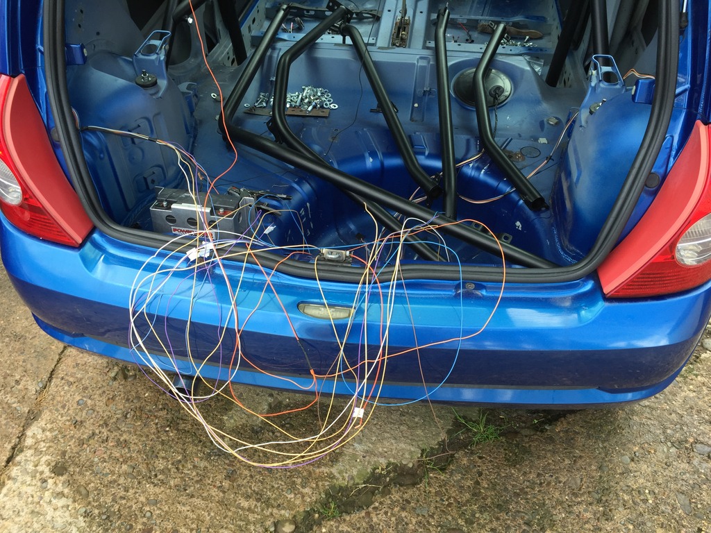

Gen90 ECU sold and DTA ECU bought which has released some funds to have the engine loom built.

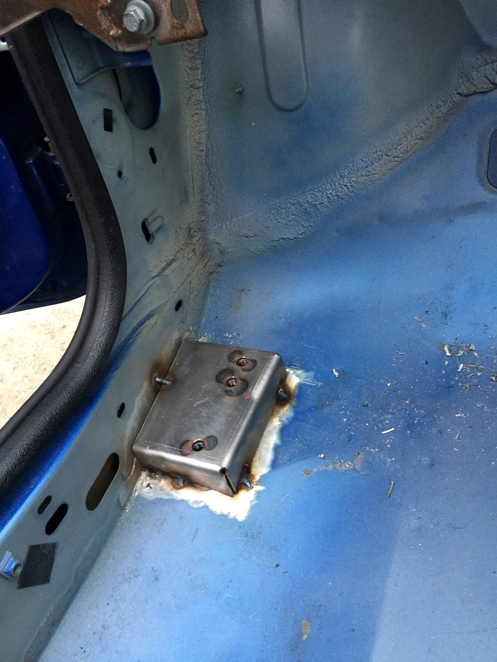

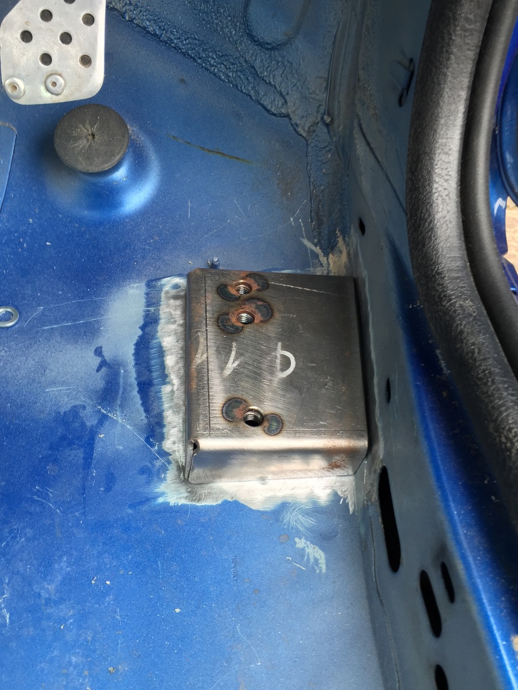

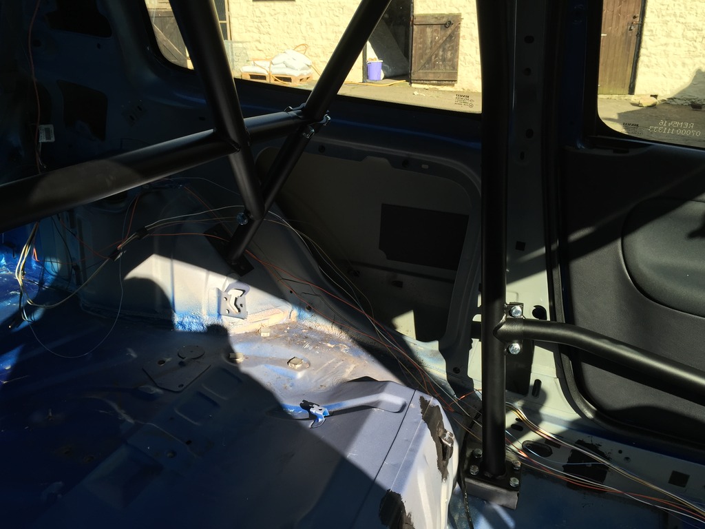

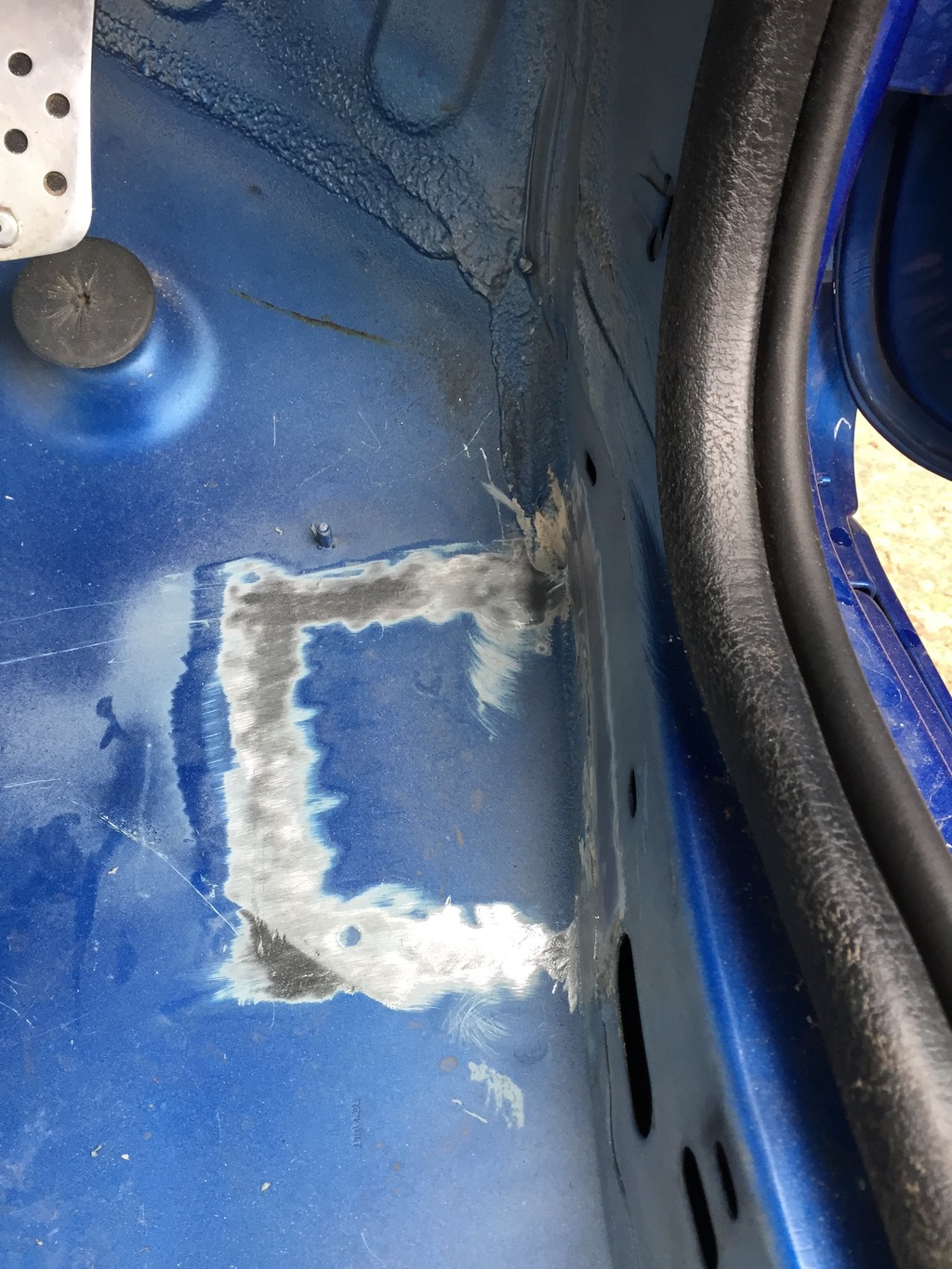

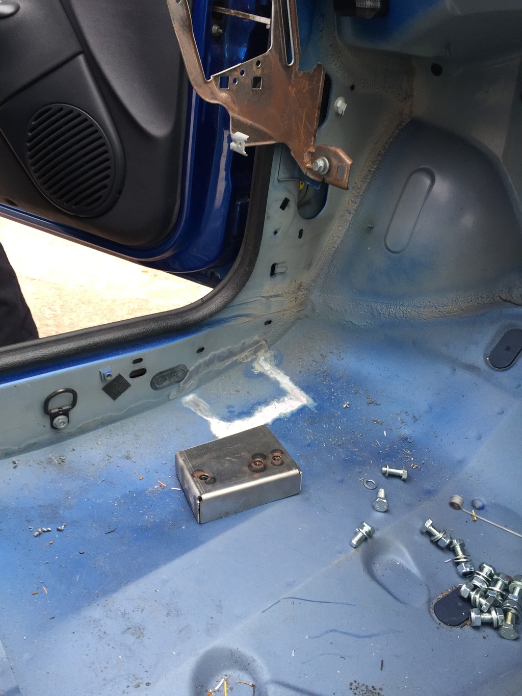

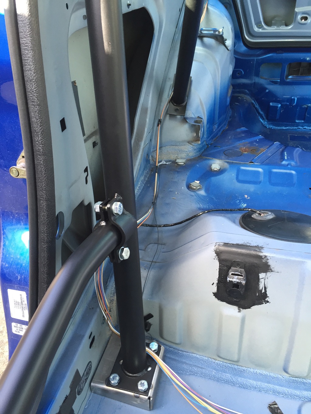

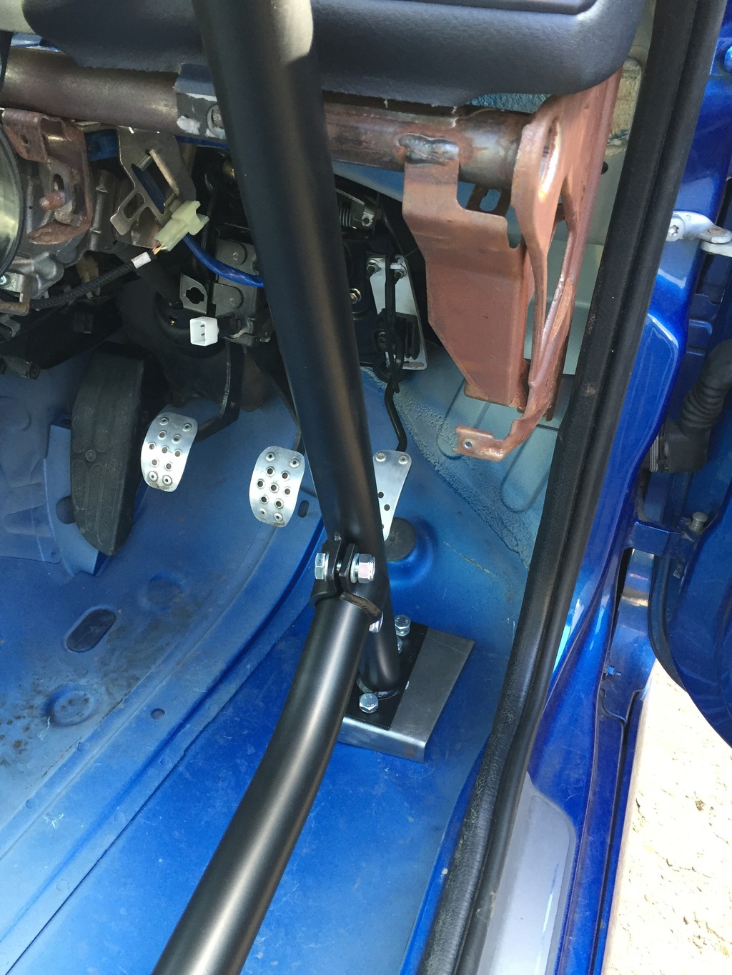

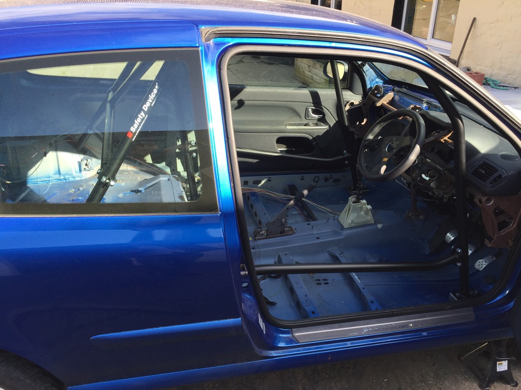

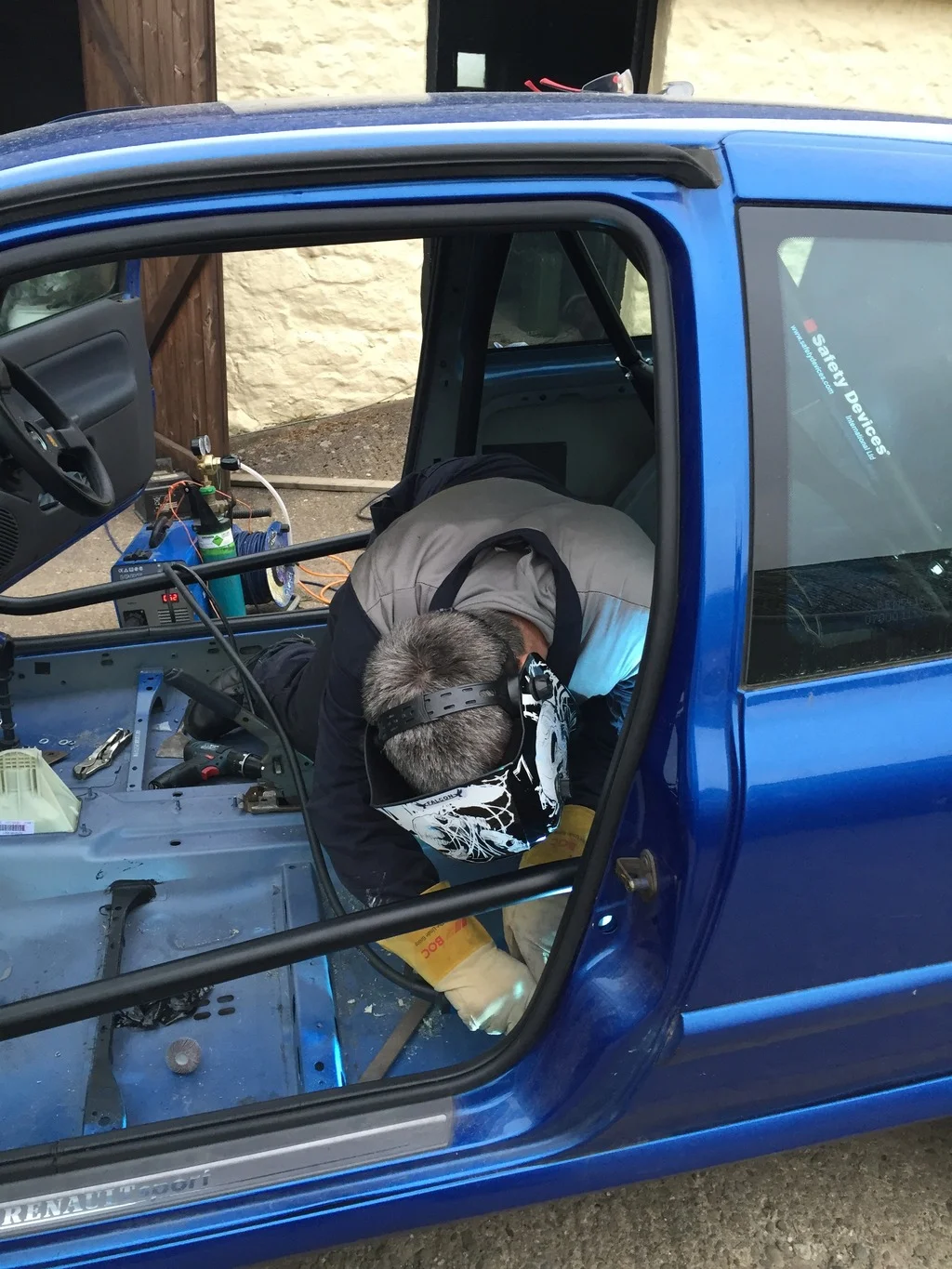

We have also started fitting the roll cage but a out of welding gas.
Now they are tacked in I am just waiting for more gas and my dad to come back and weld it all in before prep for painting.

Wiring issue, I did the exact same as you, cut through all the wiring for the airbag ecu, obd port, and all airbags, tried to start and car did nothing. No windows, hazards, wipers etc
I bought a new section of loom and soldered it in, still the same, turned out it was 2 fuses that had popped, most likely when I cut them.
The first being 5amp central locking fuse, once I changed this, I got central locking back, car would turn over for a split second. Second was hazards, which strangely is connected to the immobiliser, changed this and it seemed better, immob light doing its thing, but still not turning over properly, quick check and battery was dead, jump leads on and fired straight up
