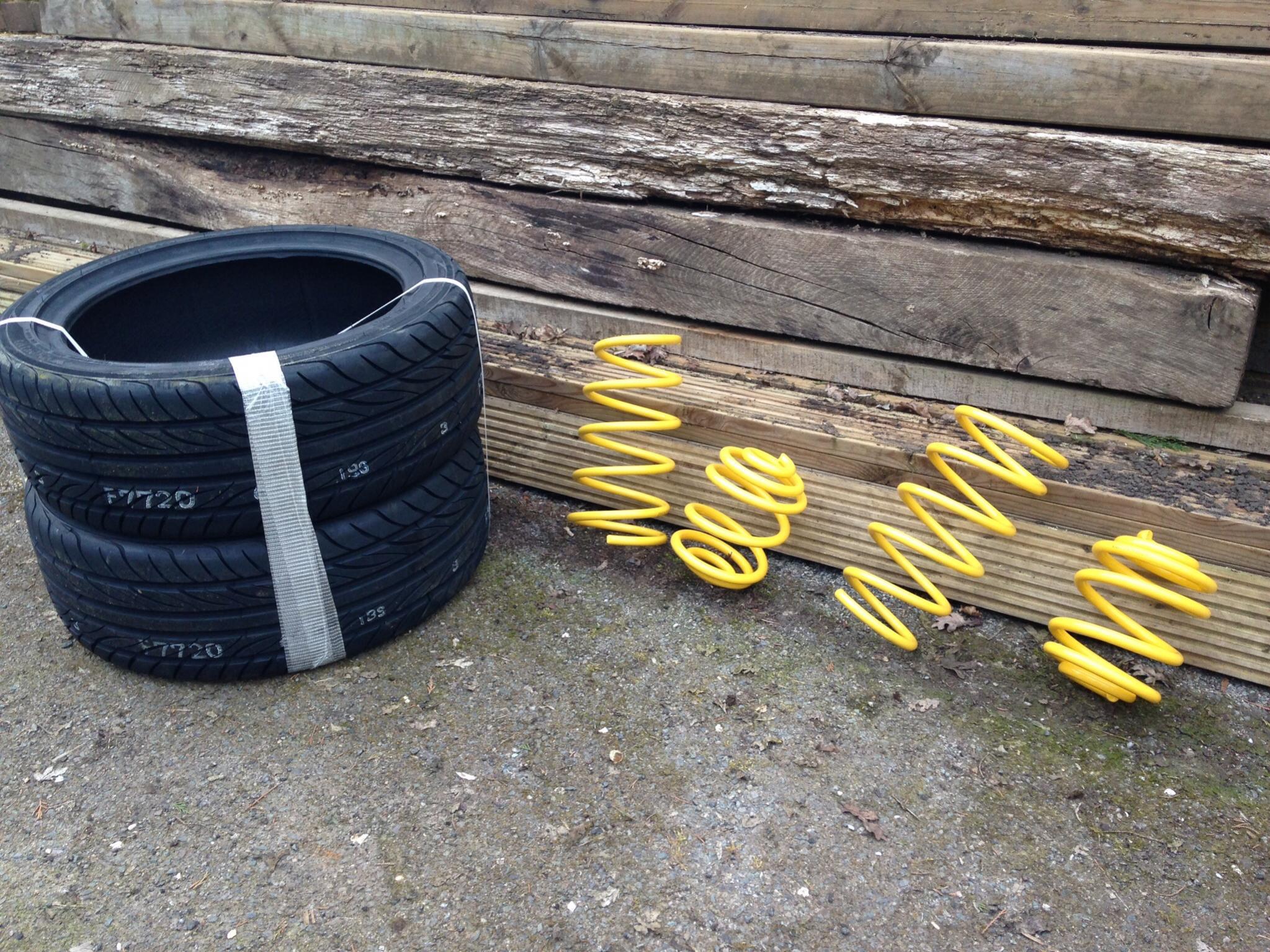

Right after having my 172 for 6 months now i thought it is about time i made a thread and gave a little story about my car and my clio history my first car was an 54 plate 1.4 dynamique which i loved such a lovely car and i was soo happy when i got it. here is a picture from the day i got it :D photo 3.JPG Sadly At the time i was mechanic apprentice and being a 1.4 at 17 it was to expensive so i had to sell it and i bought a 1.2 corsa d sxi :dead: dont get me wrong it was a nice car but i just missed my clio after goin in to car sales as a job and having a comapany i decided it was time to get another clio i always wanted a 172 and before you know it i went out and bout this one :D image.jpg some people might recognise the car as AlexW helped me get this car it had a snapped aux belt which took the cambelt with it so we bough it cheap and then alex rebuilt the engine and we did a few other bits along the way 6 months on still in love with my car there has been a few bits and bobs that have been done the list goes on and on lol but i wanted to get the car as mint as i can its still a working progress the bits i have left to do are as follows
*change my windscreen as it has a crack in :(
*De-cat :)
*lowering springs 40mm
*change my exhaust hanger

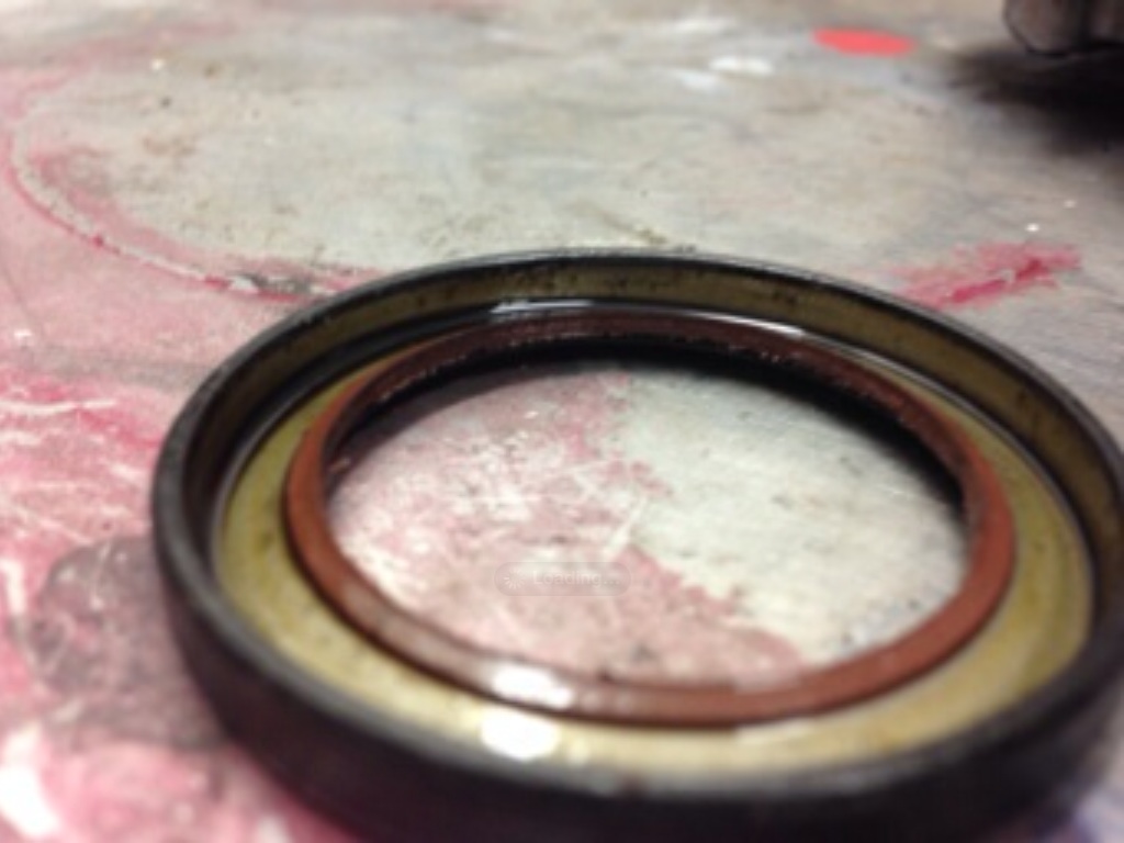

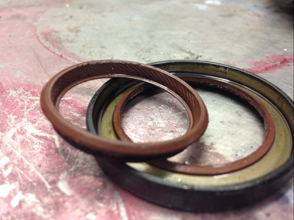

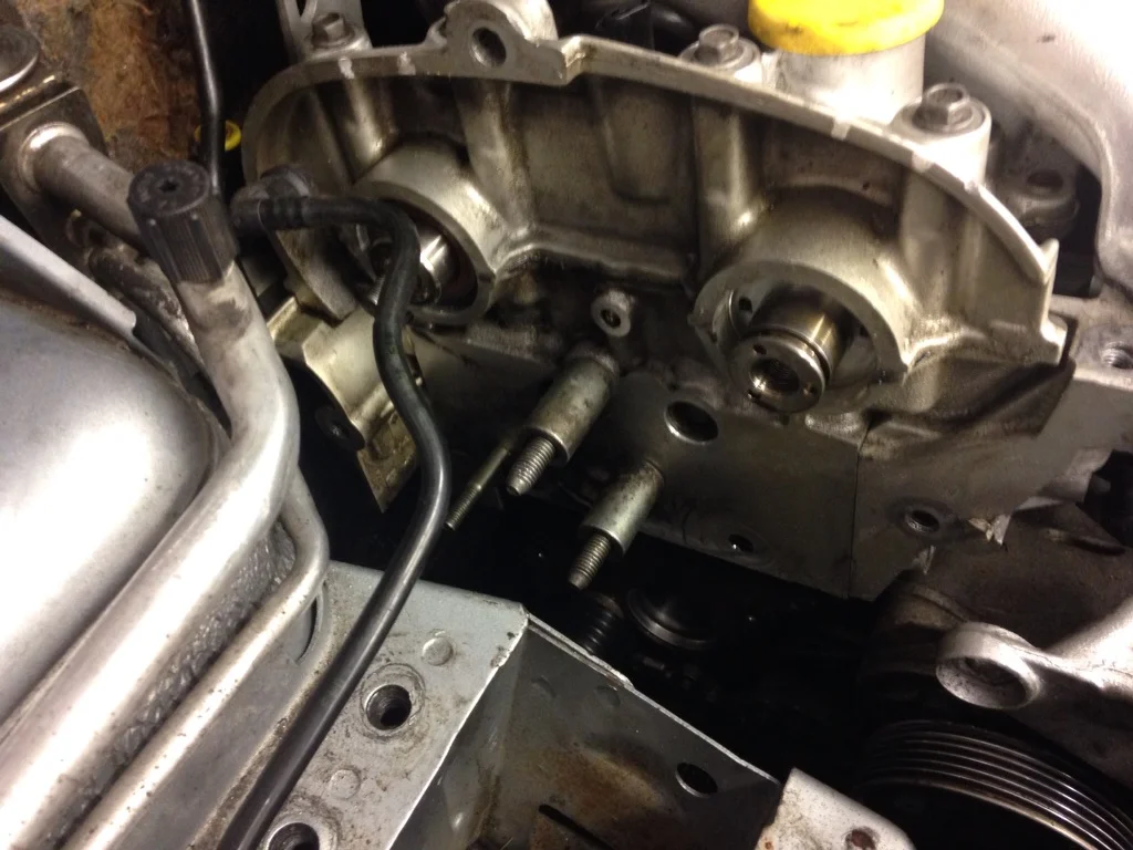

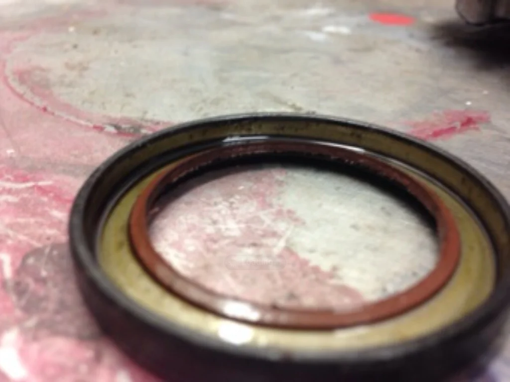

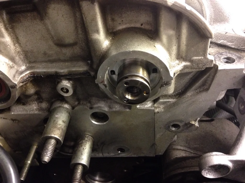

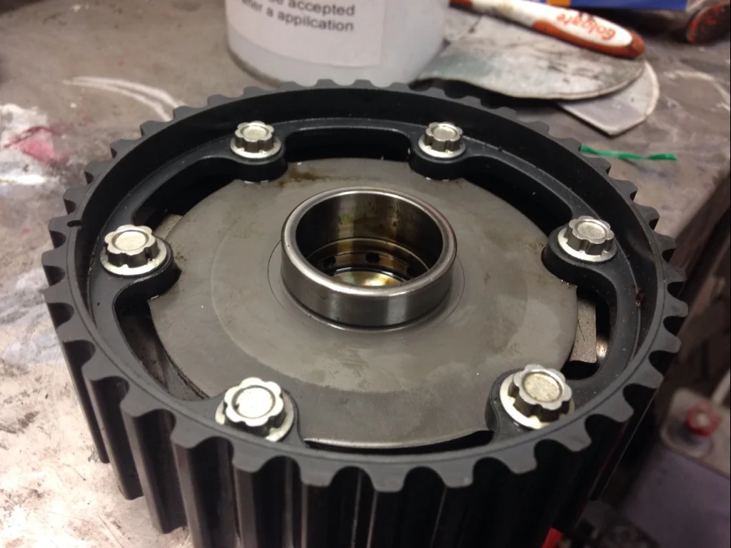

*cam seals need to be re-done as the car has an ol leak Under the cam cover :(
Hopefully all of this will be done at the end of march there is soo much mechanical bits that already have been replaced but i will tell you guys about them as and when i get the chance to update this A little bit more My aim for my car is to get it as clean as possible i dont think its bad for 102k its also on an 02 plate aswell under the private plate has full history to :) one extra alex to fit for me which i love is cruise control alex already had all the buttons i just had to get the airbag and the new squibb There is soo much i could write on here but i will stop now before i bore everyone and i will update soon until then here is some pictures of my 172 and friend ParisPeach car Thanks For Reading terry :) photo 4.jpgimage.jpgimage.jpgimage.jpgimage.jpgimage.jpgimage.jpg

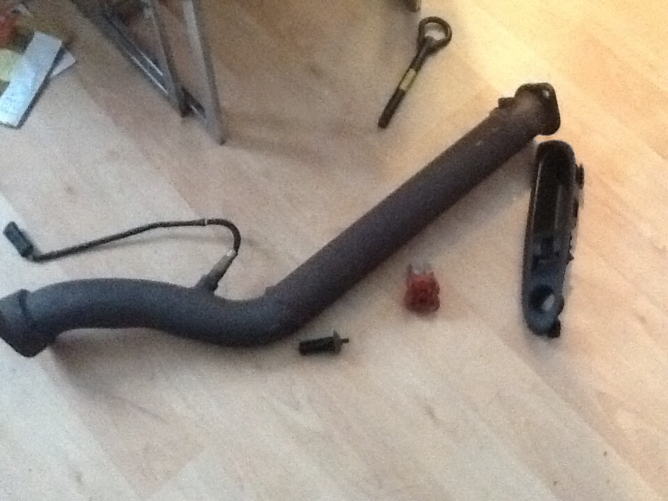

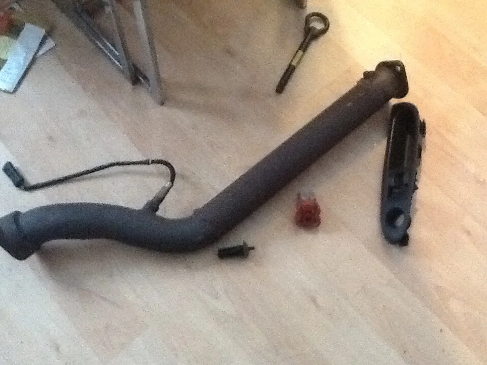

UPDATE:
so few things to update ive been so busy with work recently i havent had the time to update on here as some people know sadly My gearbox died in the 172 its believed the clips that hold the drive shaft in where missing and the killed the box i did buy another box which was in the car how ever when we had a look it had a diffrent speedo drive so i had to rebuild my old gearbox which now has the improved gears from the 182 the car was off the road for 3 weeks which left me in a 140k red combo van :( while this happend i decided that i needed to buy everything i need to finish my car of mechanically and body work wise once and for all so my parts list was as follows :)
*de-cat pipe
*centre exhaust Hanger
*x2 yokohoma S-drives
* door pull on the inside
*Bonnet sensor
*replace windscreen
*lowering Springs 40mm
*driverside re-spray
*remove all pin dents
will the car was off the road i got all these bits ordered and as soon as she was okay to drive again i set about getting here booked in :) as of this week she is now lower de-dented re-sprayed new windscreen and everything fitted (except) for the de-cat as i am struggling to remove the old cat bolts i have also changed the brake fluid (which was Black) so all is well with the clio as the week draws to an end as of next week hopefully the de-cat will be fitted and finally the cam seals will be re done :( only thing left then will be to source the knocking from the driver side Believed to either the rack bushes or ball joint and or the top of the struts pictures to follow tonight :)

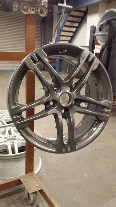

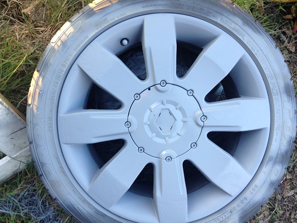

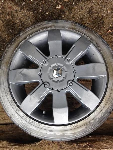

also guys the last photos i have are of the wheels that me and paris re-furbed like i said in the post last time i updated we wasnt really that fused about how they came out atm it was more to just hide the curb marks anyways here are the results
there is one spoke that ran when we put the laquer on but since then i have sanded this back and it will be re-done till next time :) Terry

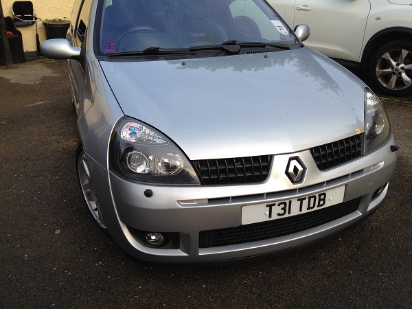

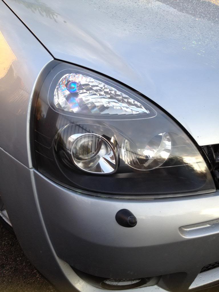

so finally bit the bullet the other night and decided to have a crack at the headlights there wern't bad in the fist place but i wanted a few of the faint lines gone
my first thought after this was uh oh but then the end result came
and i was pretty pleased with my self :) i then decided that i just could not take the shocking renault speaker any more so i bought some componets

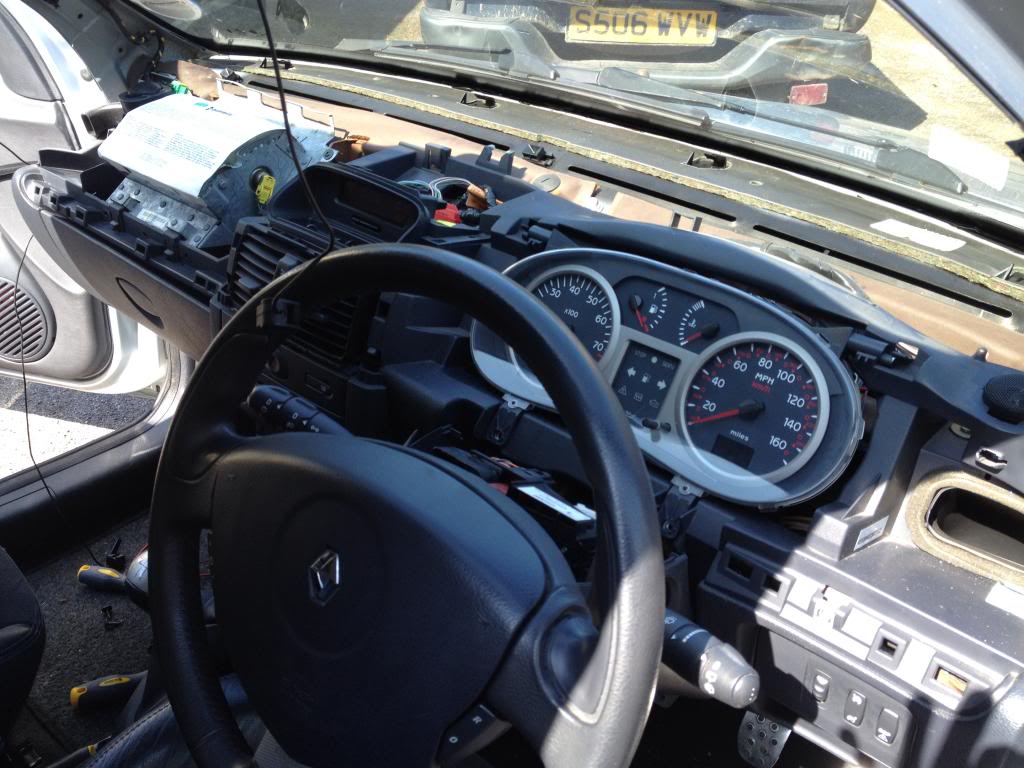

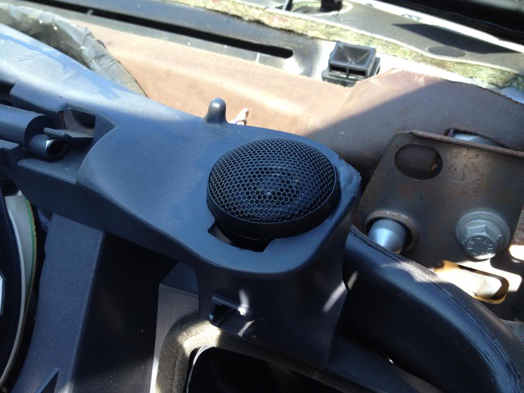

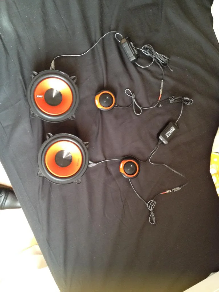

now i am no good with electronics so i bought this clever little adapter
dash out
fitted the tweeters they actually fitted was a bit snug but still :)
i must say this system i probably one of the best i had in a car before and i cannot rave enough about how good the sound quality is and value for money aswell couple of days later i then recieved this in the post :clap:

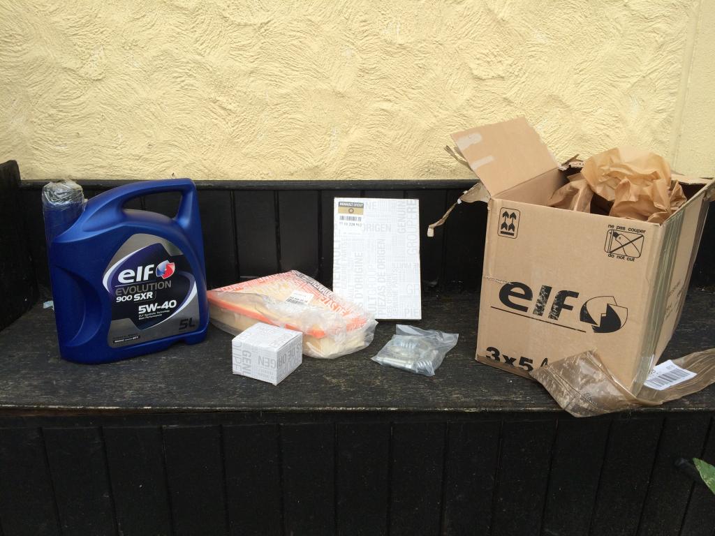

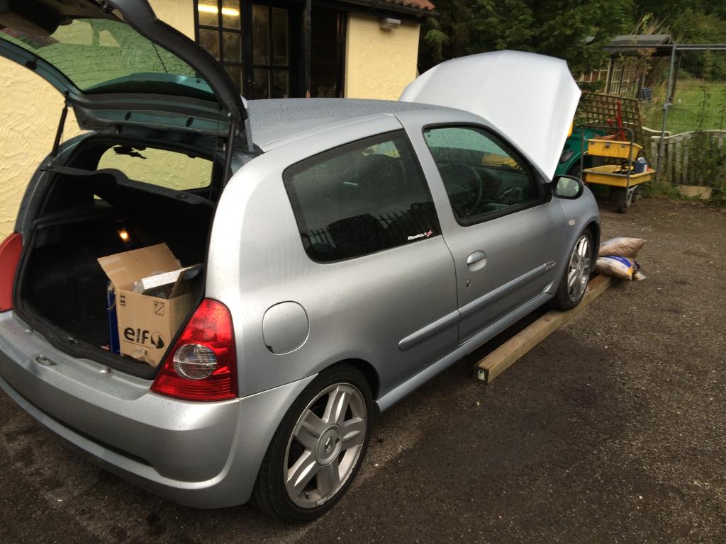

so after fitting the carpet and doing the thumb grips next up was the shock obsorber on the driverside its been leaking so when i bought the carpet i ordered shocks so i ran the car down to my old garage i use to work at unforunatly the m11 had other plans for me
4 hours i was stuck like this for which ment i had to leave the car with my old work mate for him to do the shocks and get another mode of transport to work. once the car was back shocks done and lambda out as it was making the car over fuel i had a busy monday / tuesday ahead of me with the clio first off the driverside mirror was hazed over so i mopped it back with fast cut 3m and then re laqured (sorry no pictures of these bits) then for the last week and a half i have had this loud drone sound coming from the car had this checked by a few places id had a bearing 3 months ago on the driverside after putting up a few post turns out they can go again so booked the car in with a local near me aaron smith really nice guy and did me a decent price according to aaron it was the drierside bearing ...interestingly enough the bearing i had paid to get done a few months before had not be done it was still the orignal bearing in there it took 10 tonnes to get out i do find it weird how it never made that drone noise for all that time and only came about 2 weeks ago lucky the wheel didnt come off when i drove my kid brother to school ! once this got sorted the car was as smooth as you like and no drone :clap: while this was going on i ordered the clio some presents as its now done 10k since its last service thanks to adam @renault wolverhampton :)

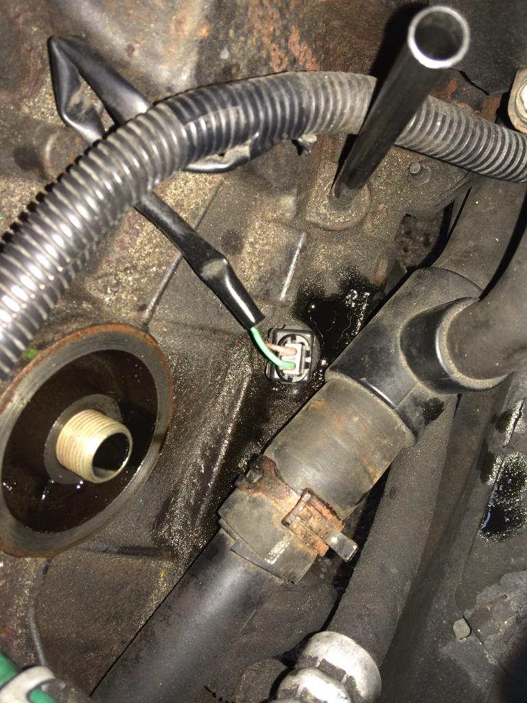

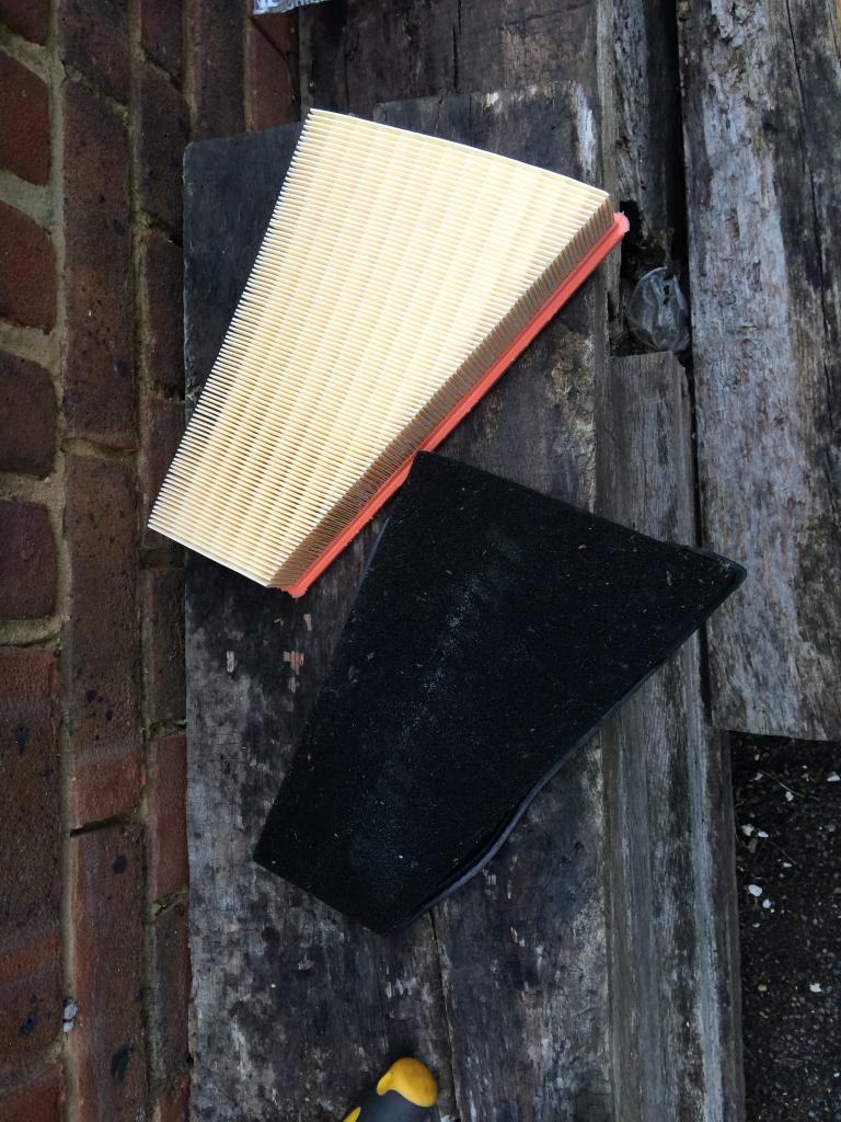

luckily the rain held off what b*****d the oil filter is to get off specially when the engine is still hot :( never the less off it came
replaced with a nice genuine filter also i decided to get rid of my piper cross filter in place a new paper one went in
my car is too low to get under so here are my special clio ramps :)
then elf oil was put in
after this my door barrells had never worked all they did was turn and this again really annoyed me so i took the door cards off barrels out and soaked in wd40 sure enough they all work perfect now so i can use the key in the door for emergencies :) then i gave the car a quick service wash :)
now the spring,bearing,lambda plug taken out and a full service has been done the car actually seems to pull a lot quicker then it did i belive this is down to the lambda to be honest as it was putting the eml light on and making the car over fuel its soo much better now :) the only thing left to do to my car is fit the new renault gasket kit i got for the exhaust which i will try and do tomorow more soon :)

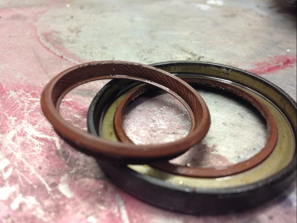

:) much better i also did buy new seals aswell ..i just forgot to picture them :( i also took a trip to mark fish for him to give the car a once over and he gave it the thumbs up which made me very happy i also spotted this little gem WILLIAMS

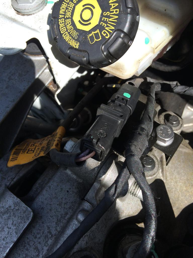

So time to do a update kind of neglected to updates this as there is any thing to do really other then a few little bits that bugged me haha i guess i start here with this sensor

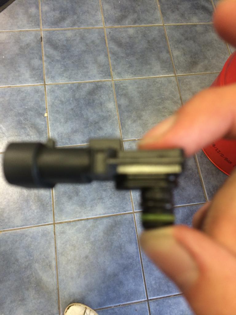

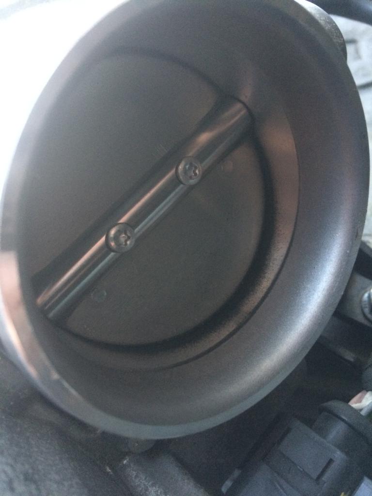

its a common thing with 197/200's that they are a bit losse and give a flat spot about 2.5k so i took it out to try and seal it but they can break no matter how careful i tried to get it out the little bugger snapped
so £50 later bought a new sensor put some sealant on just to be safe and its all good :) i then started to attack the wiper juddering that i had so cleaned them all out after finding this lovely puddle of crap and greased the arms up

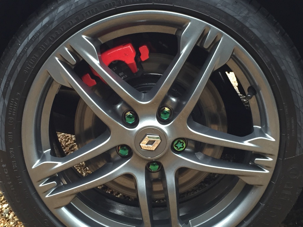

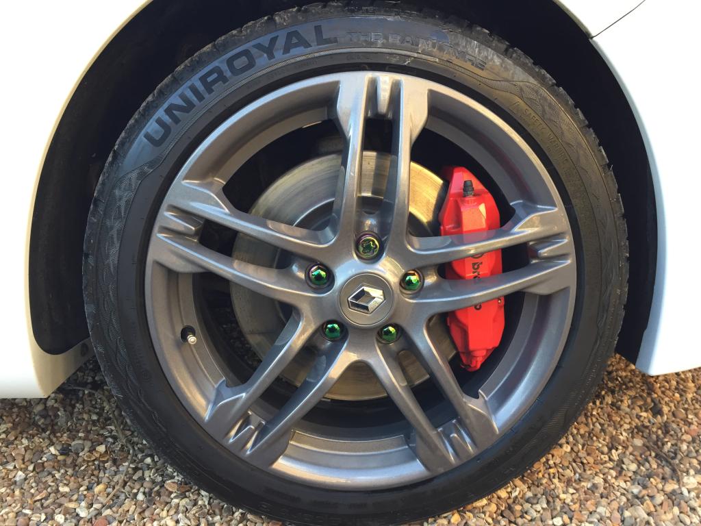

before christmas i noted that my wheel bolts were corroded and all rusty so i ordered up a set of polarised wheel bolts i got these last night and got so excited i fitted them straight away the im really pleased with them

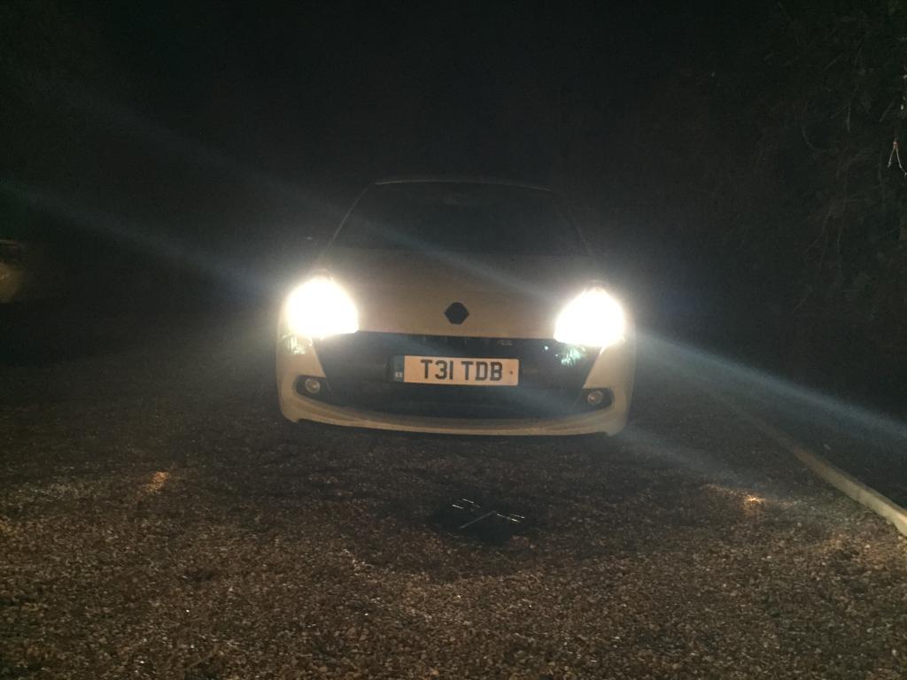

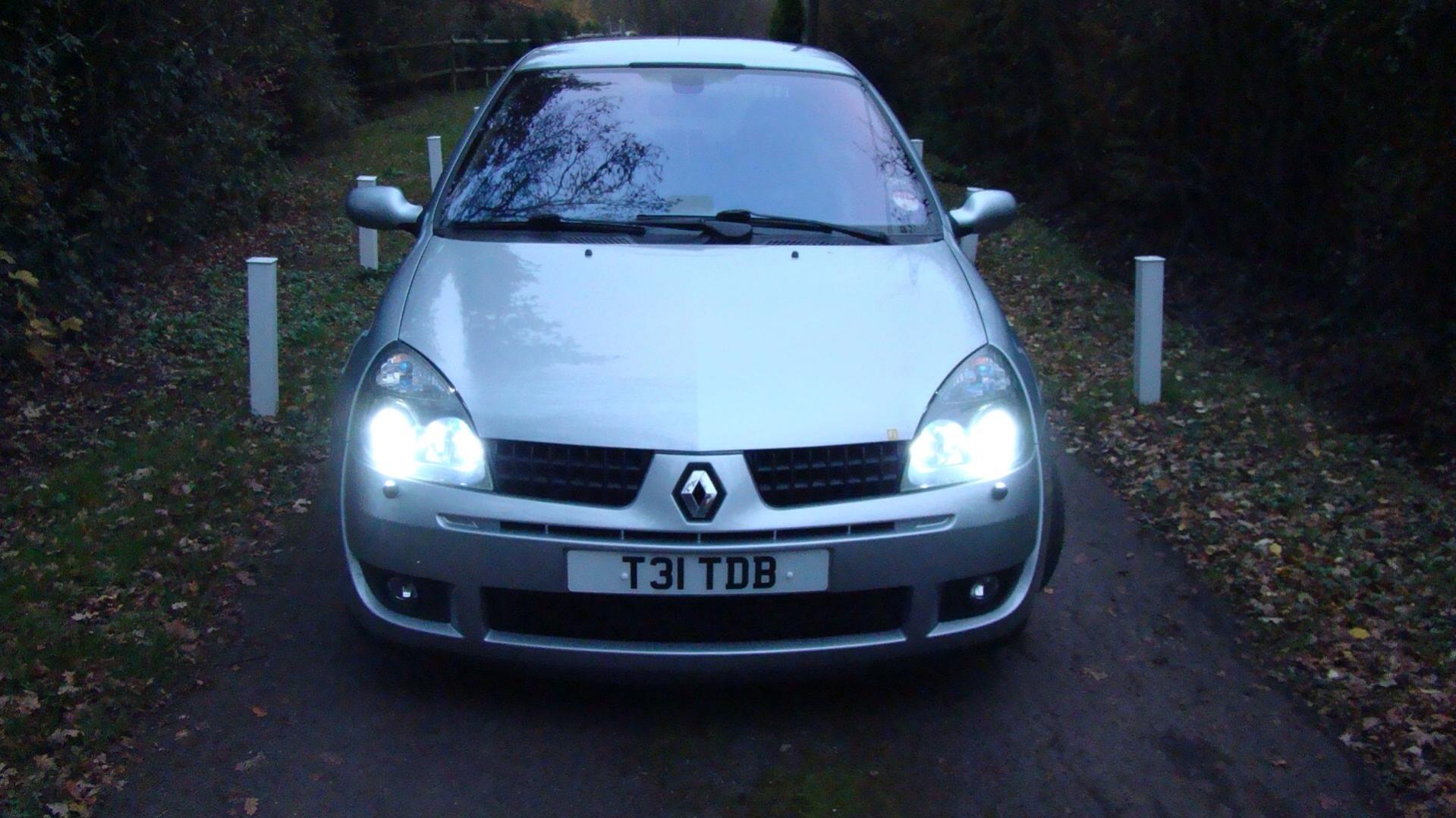

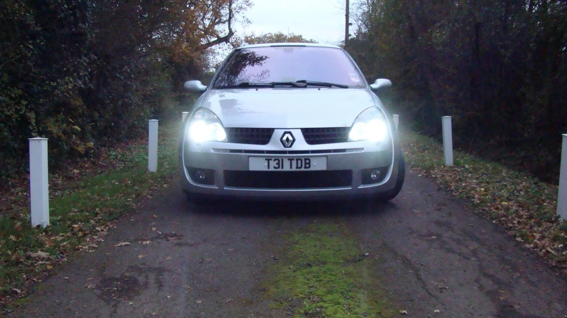

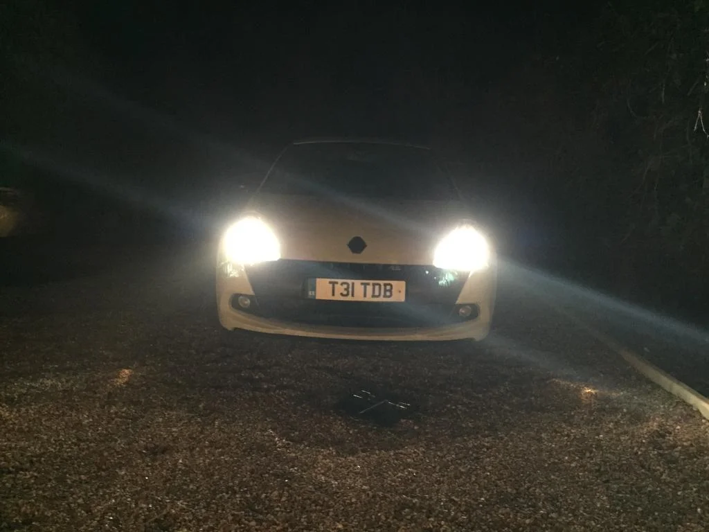

I was looking for a whiter look for my headlights I had Phipps xtreme visions in them good but I wanted it white so I got some Osram night breakers in with some led sidelights I'm really pleased with them now they look a lot better
the lights don't look best there but in the flesh they really are next was the big stuff last month I booked the Clio to get all 4 wheels powder coated and repainted in oem cup chassis colour as mine where pealing and the laquer was rubbish so yesterday I went to see the guys at ultimate alloys in wickford I was so impressed with them

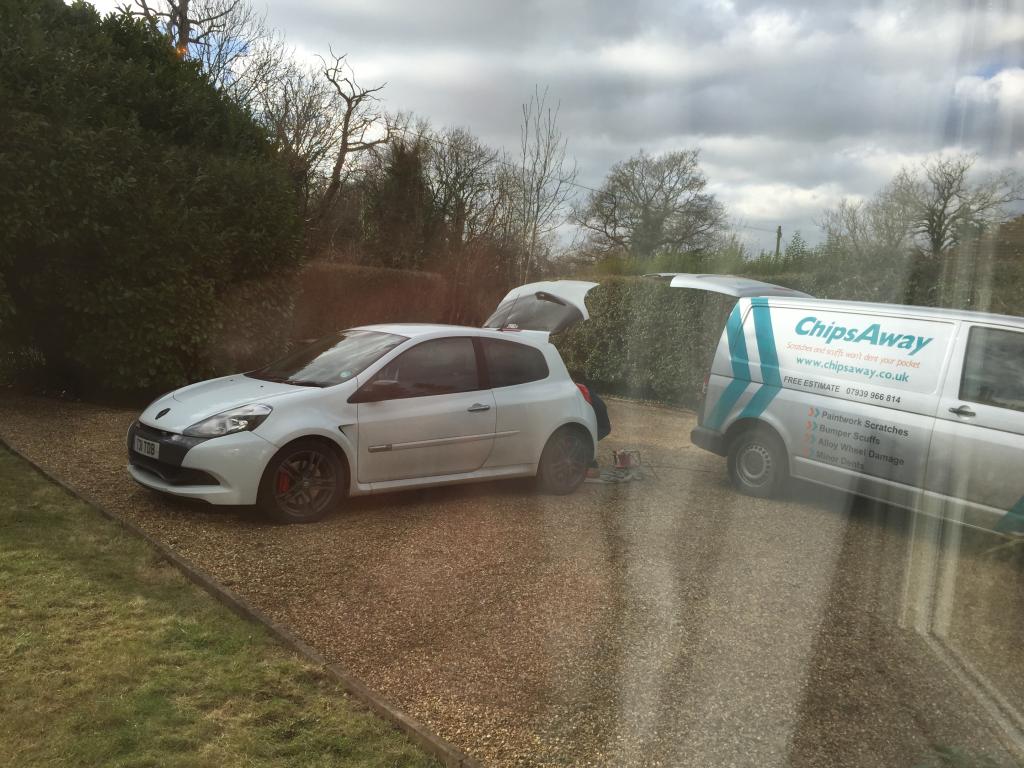

the finished product after yesterday I also had the car booked with chips away nothing major on the car it's just there was a slight mark on the rear bumper it's always been there but I thought I might aswell get it done

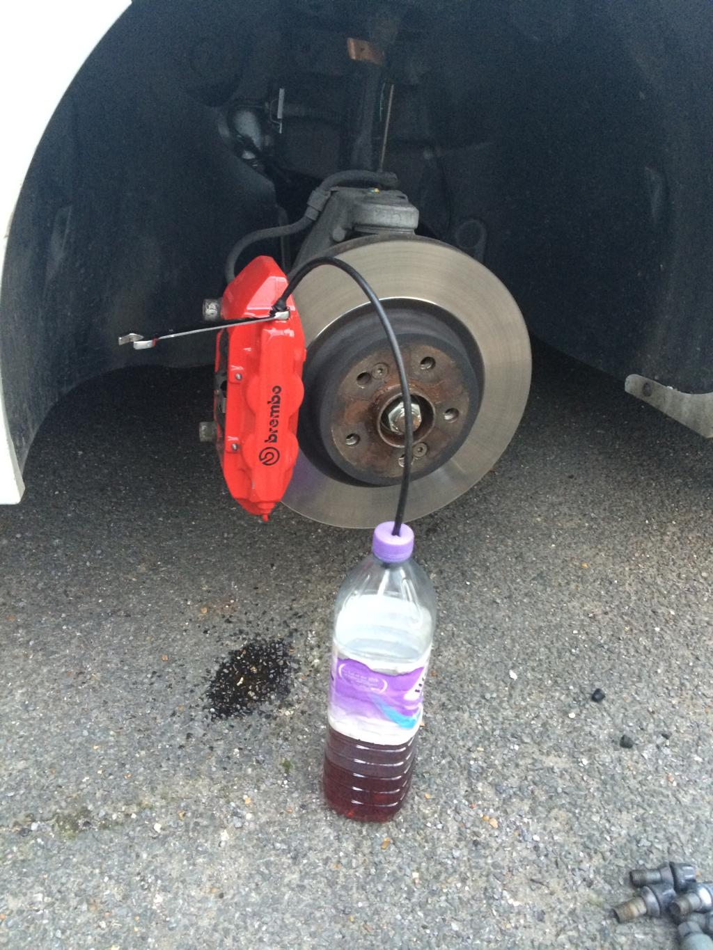

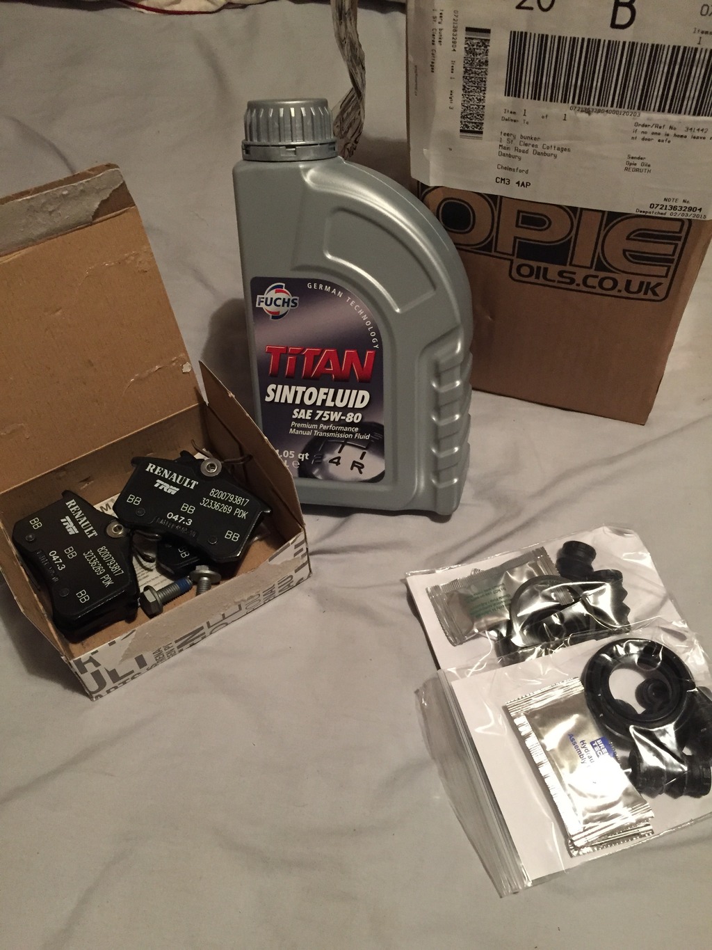

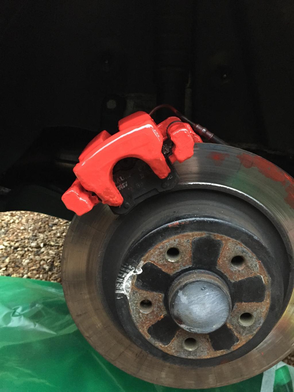

So bit of a update here the other week I ran in to a bit of a diaster when it come to my rear callipers all the paint was peeling off of them and it really bugged me so I set about painting them tbh when they was still wet they looked ok but the pint just would not settle it turned out rubbish
that picture was taking during but I decided to grease the pads while I was there I'm glad I did as when I pulled the calipers of one was seized and the other the seal had spilt so I planned on rebuilding them but as I needed the car as my daily I decided to get a pair already rebuilt while this was going on thought I will put a fresh set of pads on the car as the old ones where the original set from 2010 I always got in touch with opie oils and bought some gearbox oil to change as well I went for Fuchs Titan
late Wednesday night I took the car over to my friends so we could set about putting the new callipers on fresh pads and gearbox oil sadly no pictures on the oil from the box however it was ok no metal in there or any crap I know the 3rd gear had been fixed in my car before I bought it as its common on 197/200's but I wanted the box oil changed for peace of mind and to improve the feel from the box I've only driven the car 20miles since I did this but my word it feels a lot better to compare it to before it's like the old oil was glue sticky to get in to gears early on but now it's easy to use on cold start slips straight in to gear and from 3rd upwards light to change aswell :) defiantly recommend changing it to anyone as for my rebuilt callipers there was a few little marks i touched up on them overall they are good condition but I'm kind of ocd opinions on these guys would be great I think they look good I just think I want that brand new look anyways here are shots of the new callipers on the car and some pictures after I clayed snow foamed and waxed him today
