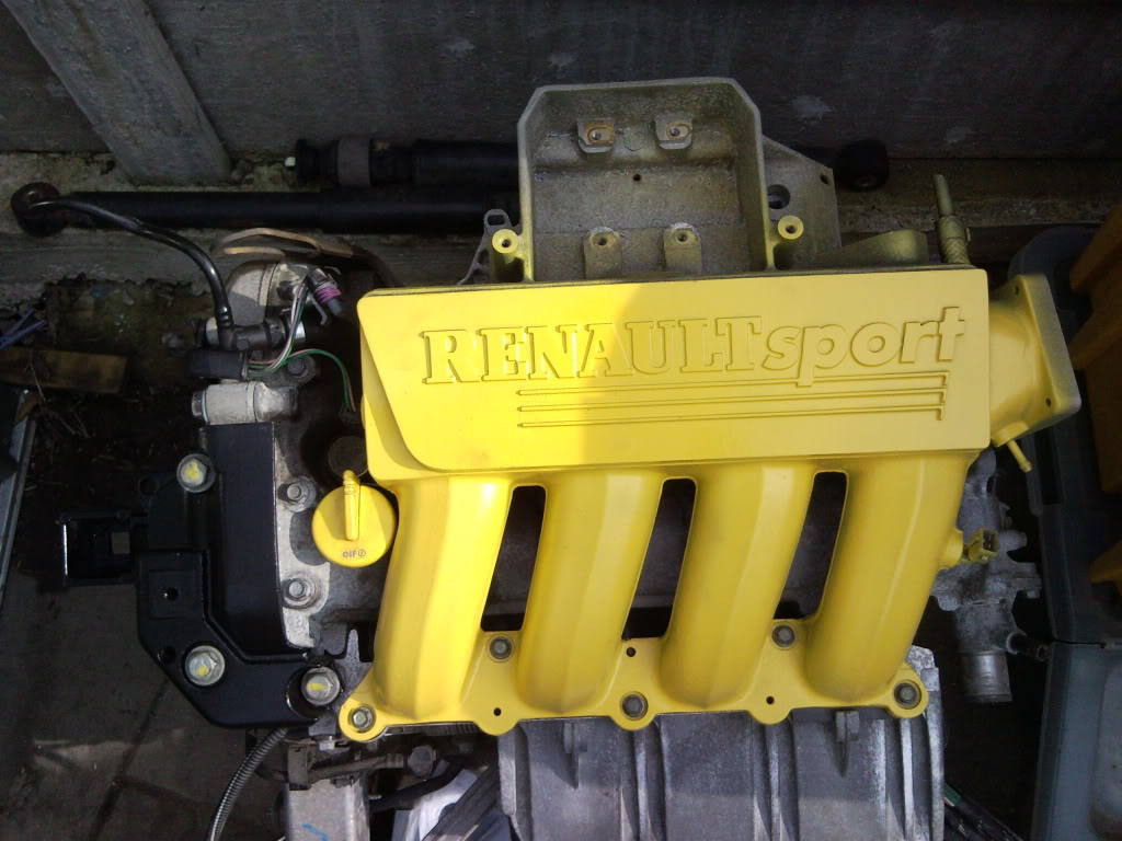

that was it for a while, so as the engine was in the back garden i decided to fiddle with it, mainly doing small comestics, like trying to polish the plenum & fuel rail guard but they ended up wrong and ended up like this
Nice Fiat yellow :)

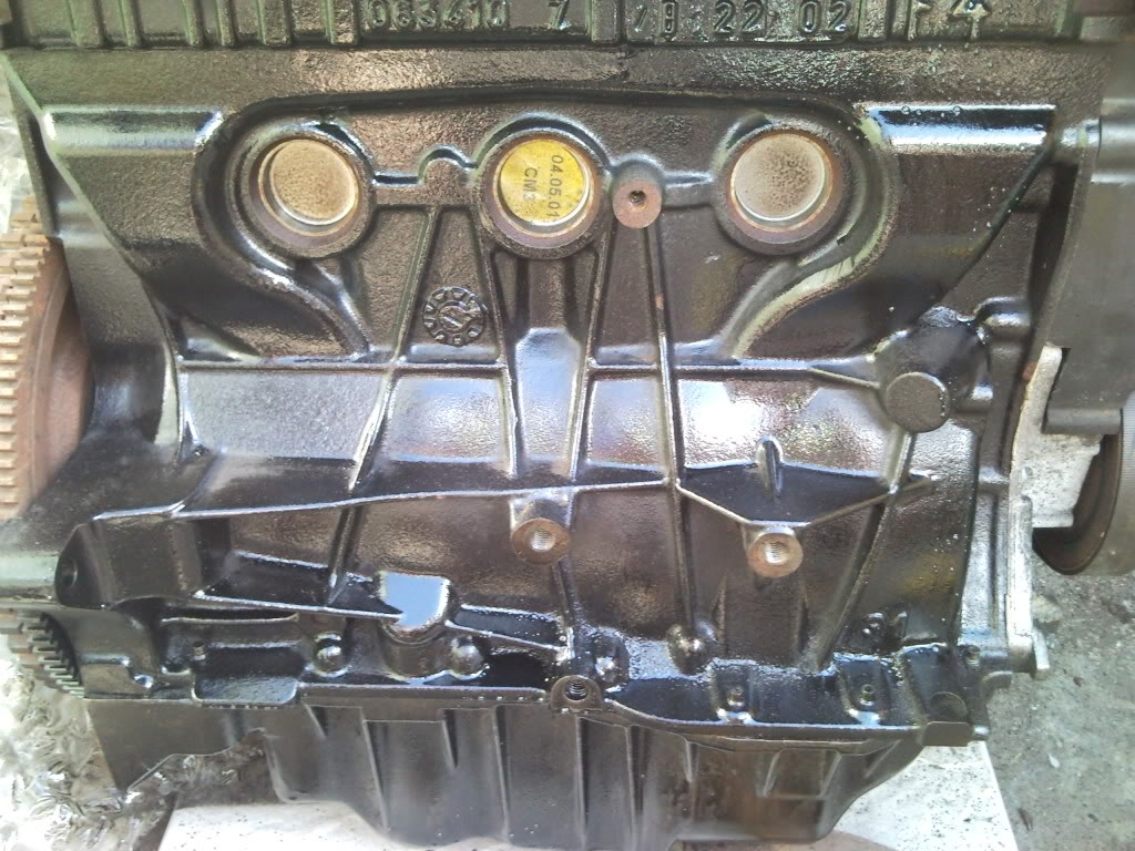

and the engine block got hammerite black

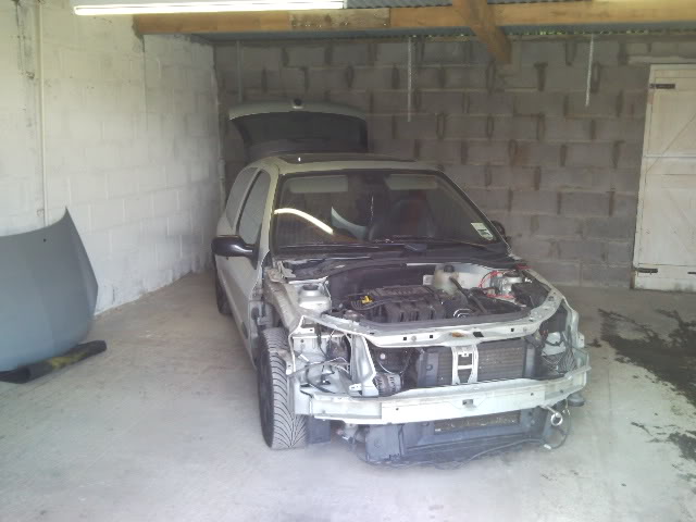

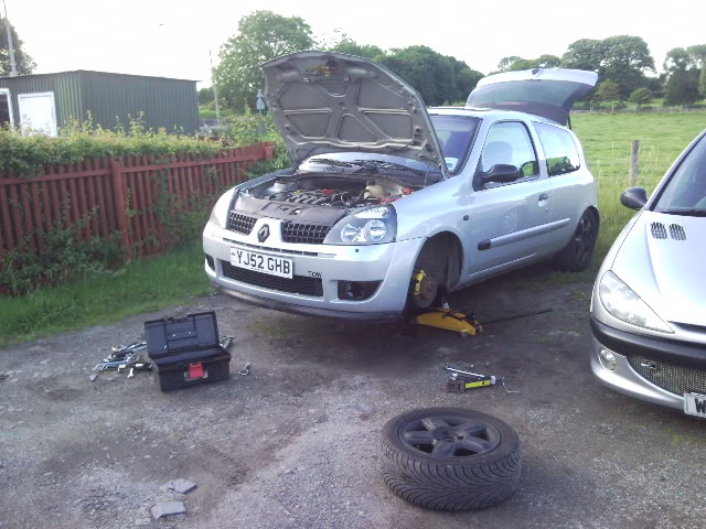

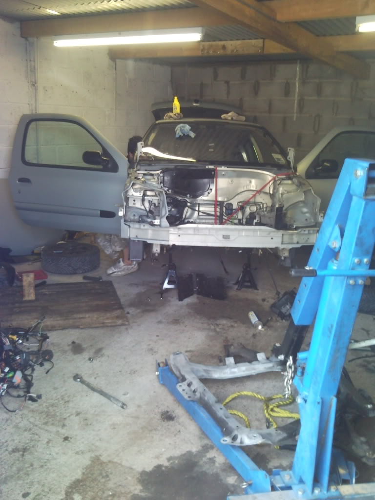

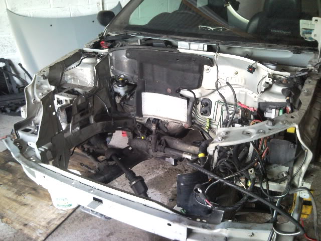

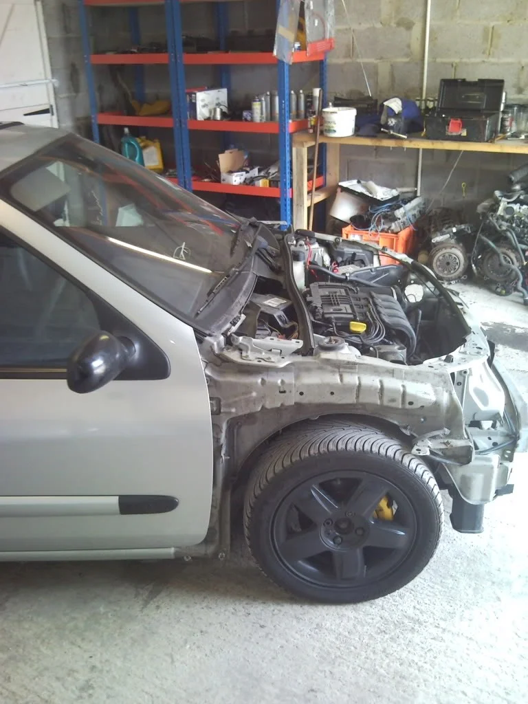

Now it began, saturday i started to rip the front end off, went from this
to this
it was finaly happening :cool:

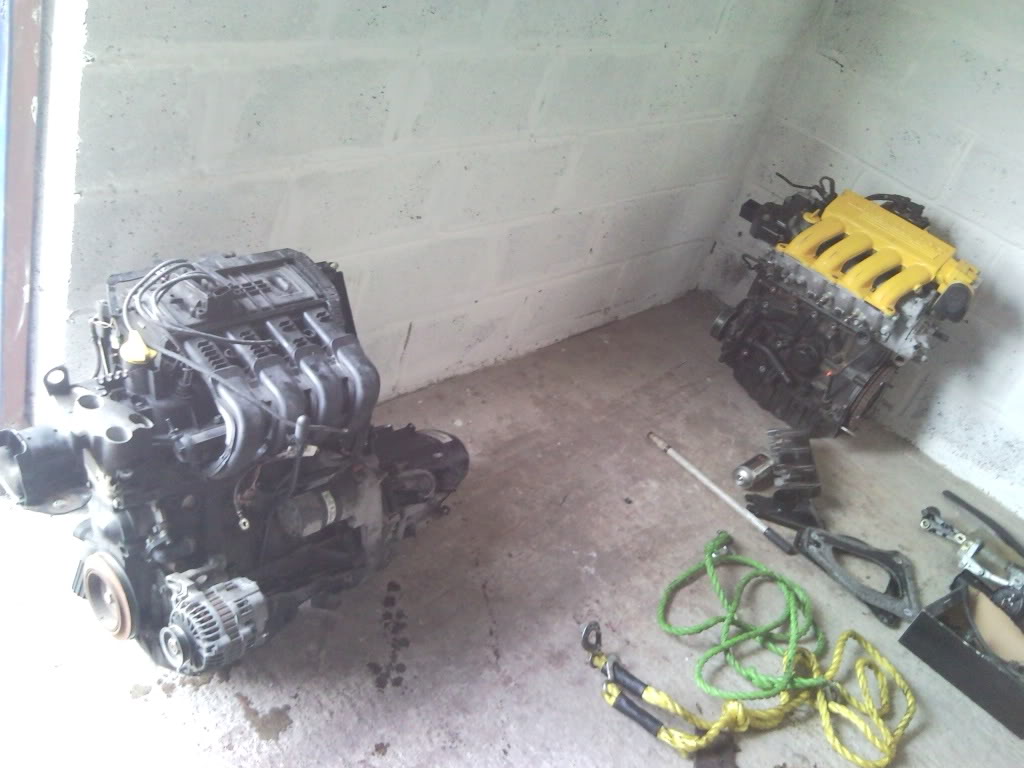

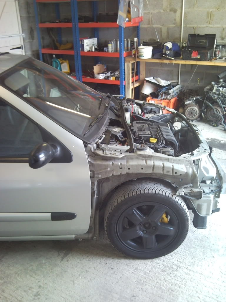

then it was quick, we managed to get the engine out in no time, this beeing my first time removing a engine it was a good way to learn, so after about 2-3 hours it ended up like this
job done :approve:

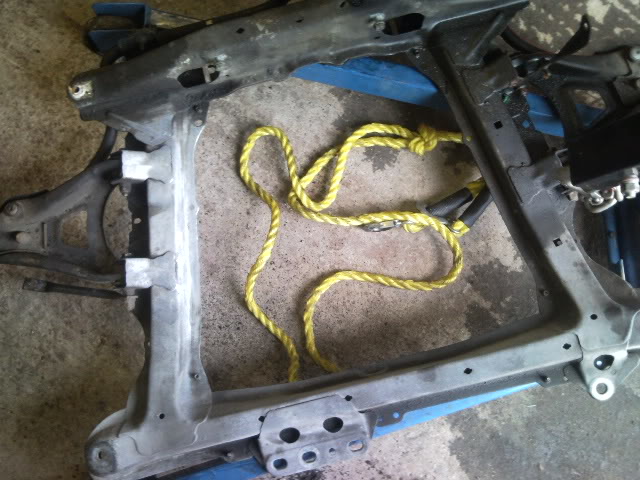

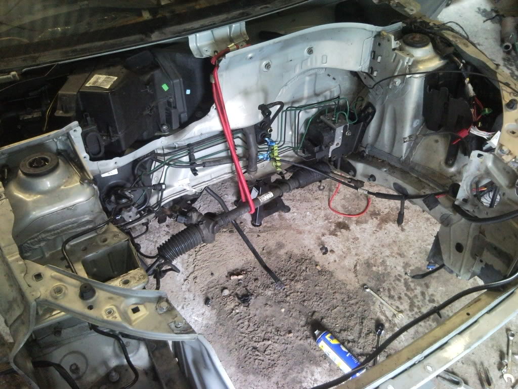

now i remeber reading on BenP's thread that the subframe had to be dropped out to get the 2l in, so off it came, was suprised to see that its only 4 bolts to hold it on, but needed a way to hold the steering arm on so a bungie cord came to the rescue
and off the subframe

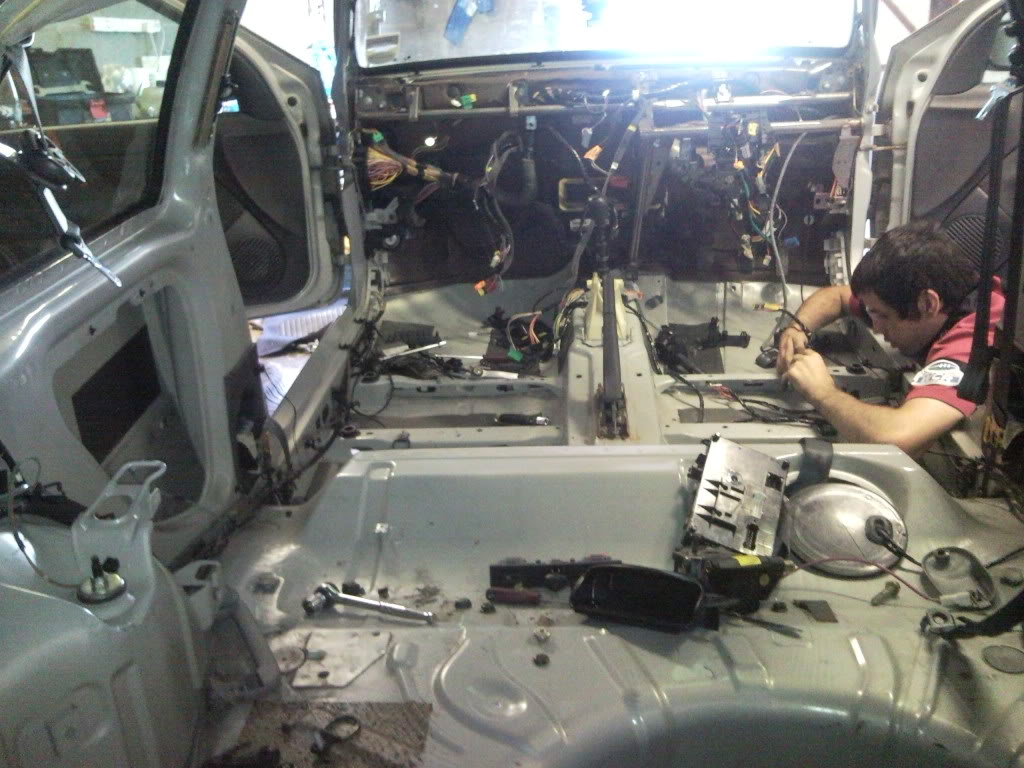

About 5.30 dajones arrived up from swansea as he was sorting the loom's inside and out,
so he cracked on straight away :)

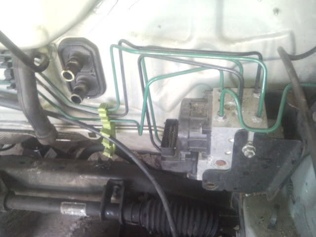

next day we started to tidy up, bit of a mess in the garage and then had a bit of a dilemma, as i wasnt sure if we had to remove the brake pot square thingy lol,
so ended up not touching it,

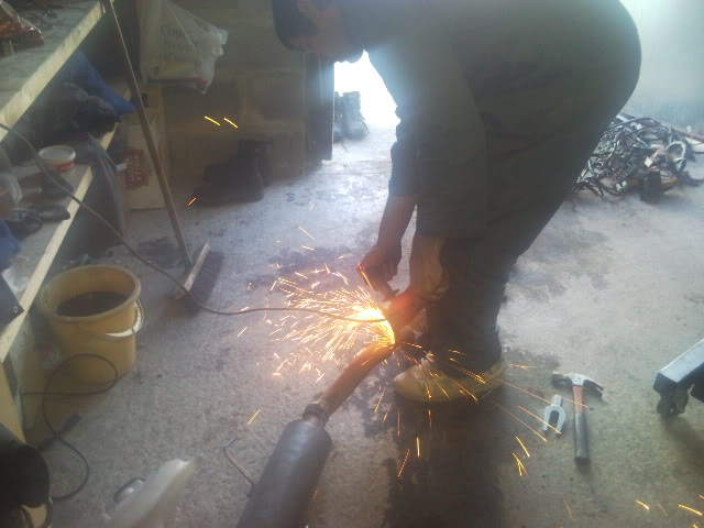

had the exhaust hangin for a while, so final got round to do it.
as the local garage had welded the back box onto the centre pipe meant i had to drop the rear axle to get it off,
and i started to angle grinde the welded joint, but dan wanted a go so

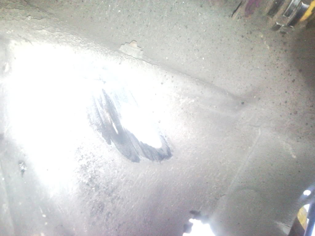

well since the subframe was out as it also need a hole drilling, i gave it a quick rub down with my wire brush, not sure wether to hammerite it bright colour or just black hmm,
Btw fred mentiond that a hole needed drilling, were abouts ?

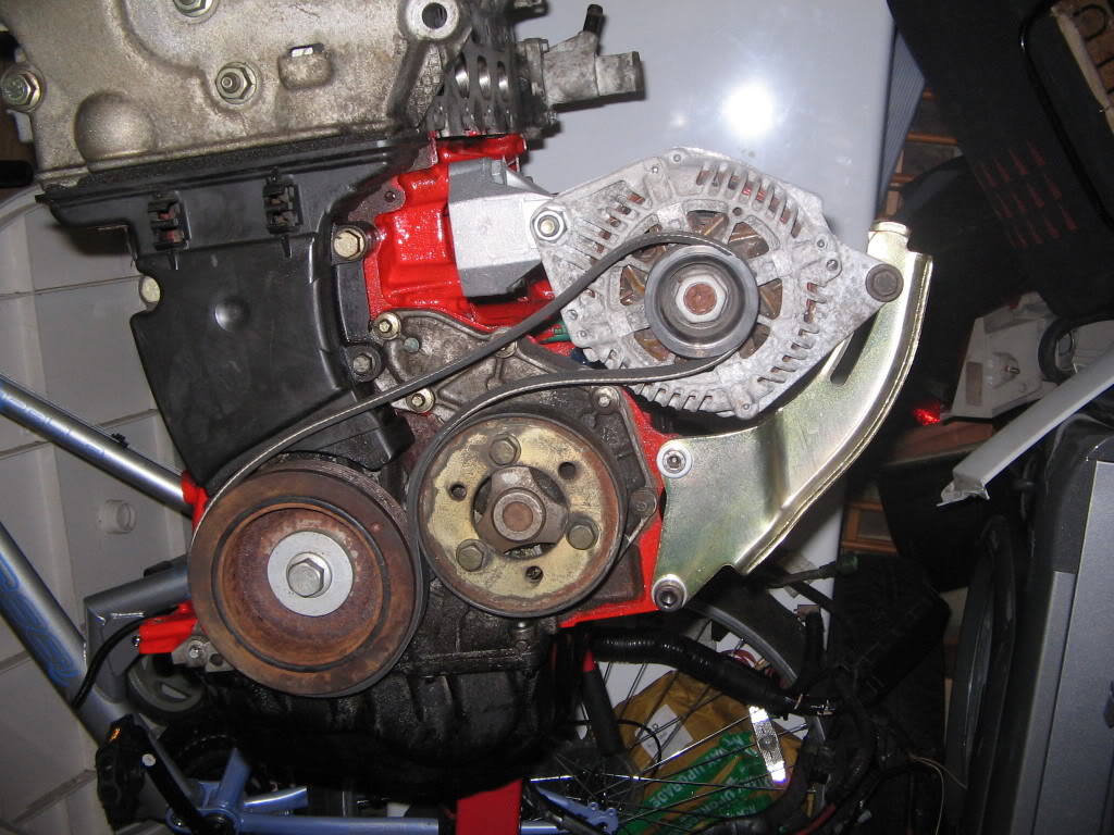

wel nothing much done really since past update, but did a trial fit on the alternator and it didnt work, so came back home and noticed that this one were James was doing into his R5 had a little mount on the engine block
now i think i can sort this out myself, so il give that a whizz today with a angle grinder.

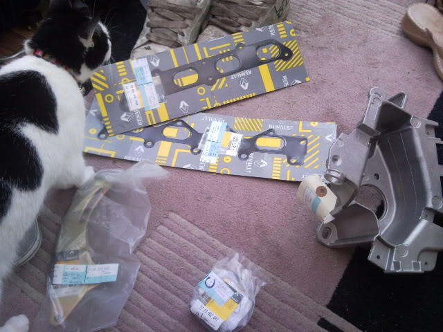

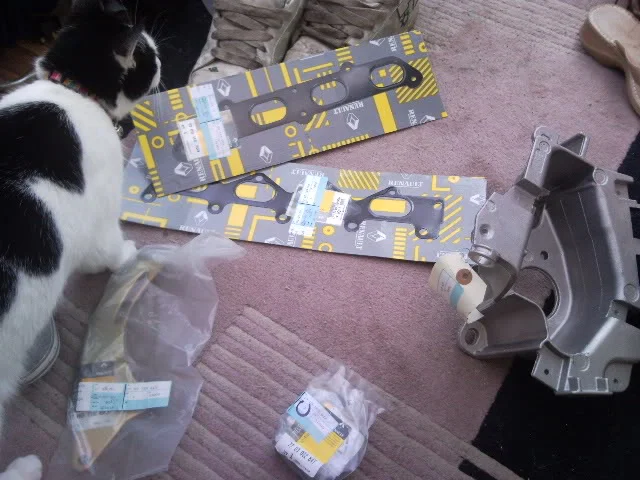

also a few parts came:

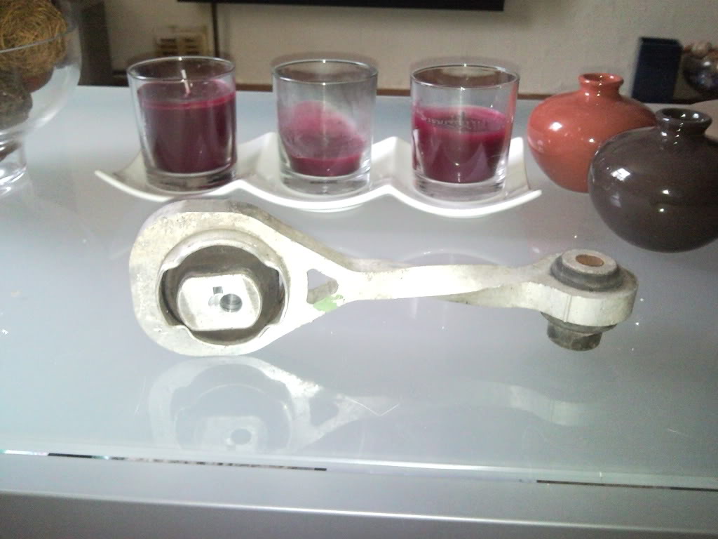

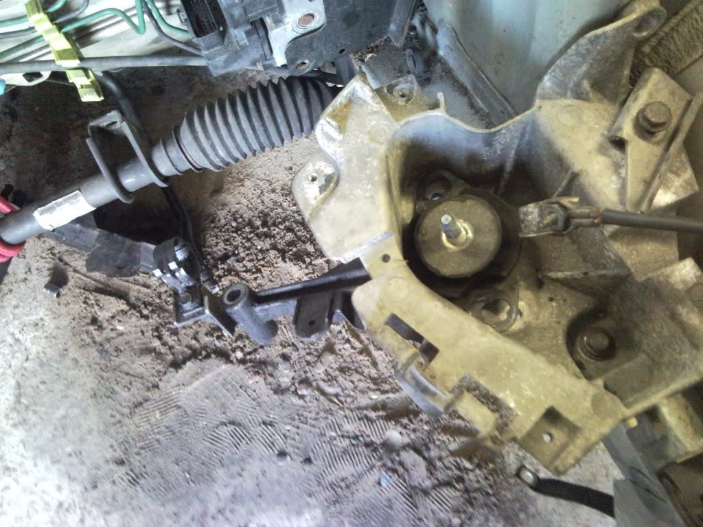

new upper gearbox mount as mine had a crack in it,
new manifold and inlet gasket
bolts and long bolt + R5 gtx alternator mount

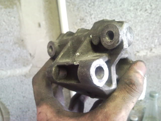

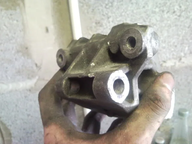

so i decided to remove the old bush from the mount today, and by crist that b**ch is hard to budge
this is the one im talkin about:
How do you remove it? theres a 18mm bolt underneath that wont budge even when iv bolted the mount back onto the car, tried using my blow torch just to heat it up abit but still no luck, so i left it at that until i could get a proper solution...

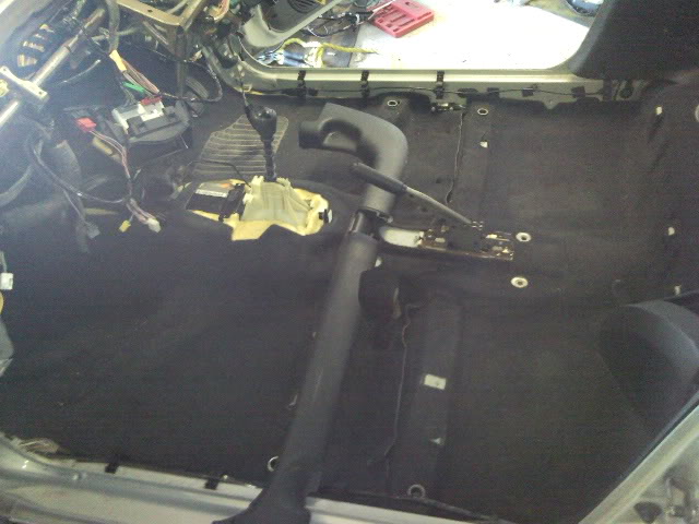

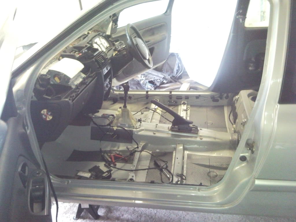

next on the job list was fitting back the inside, decided to remove all the sound deading and just use the foam that underneath saves abit of weight but still has the confort,
The foam part was wet when we removed it from the car, made me wonder if im gettin a small leak somewhere, or its just condensation :S not sure but i will keep an eye out for it tho,
cables all run through the seat brackets as there holes in them looks much tidy now

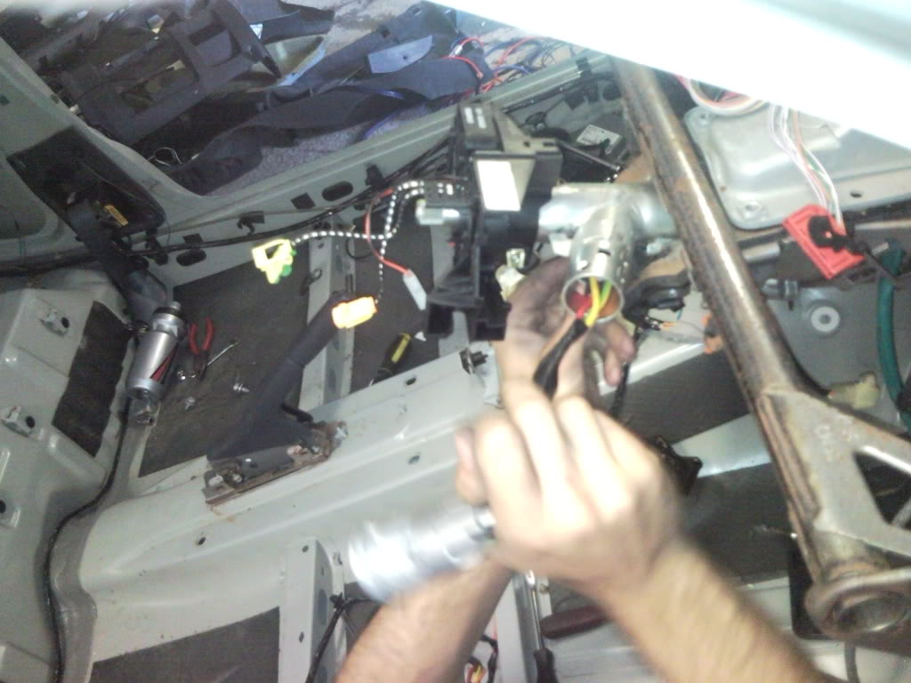

Quick question tho, how the heck do you put the bottom half of the dash back on ?
seems the stalk controllers are in the way, removed the stereo one but cant do the others,

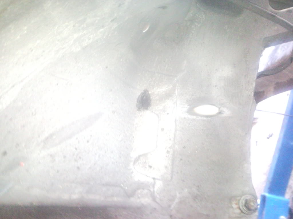

Oh and for people who have a slammed clio, you better check your inner arches ;)
this is what my tyres have done, probably if i kept it same height for about 6 more months then im sure i would have a hole tbh
passenger:
Driver:
il be deffo lifting the car up now

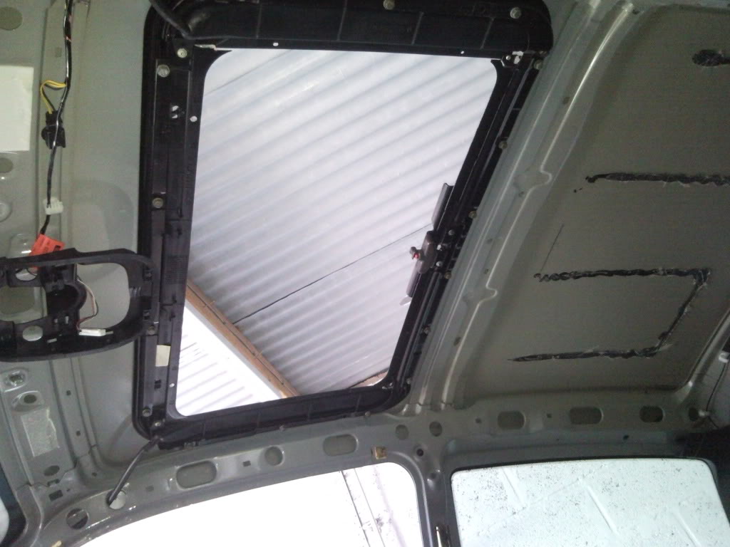

remove head liner to sort out leaky sunroof

just sent ya a text, i have the gearbox now at mine, the stalks are easy :P

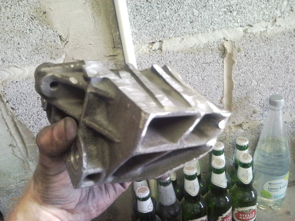

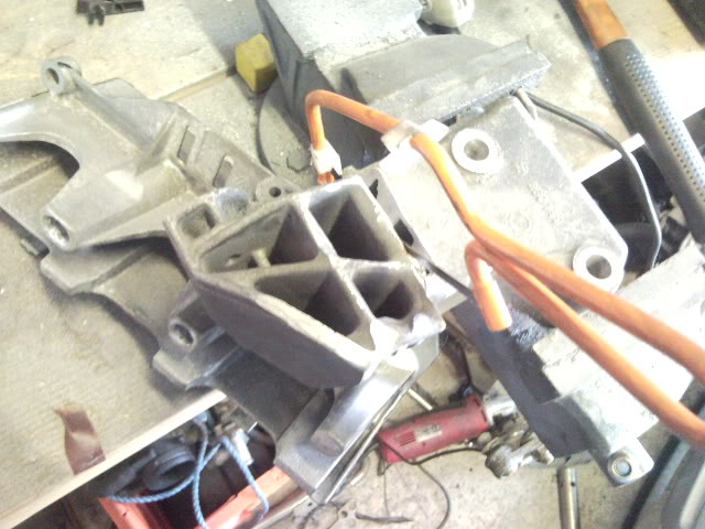

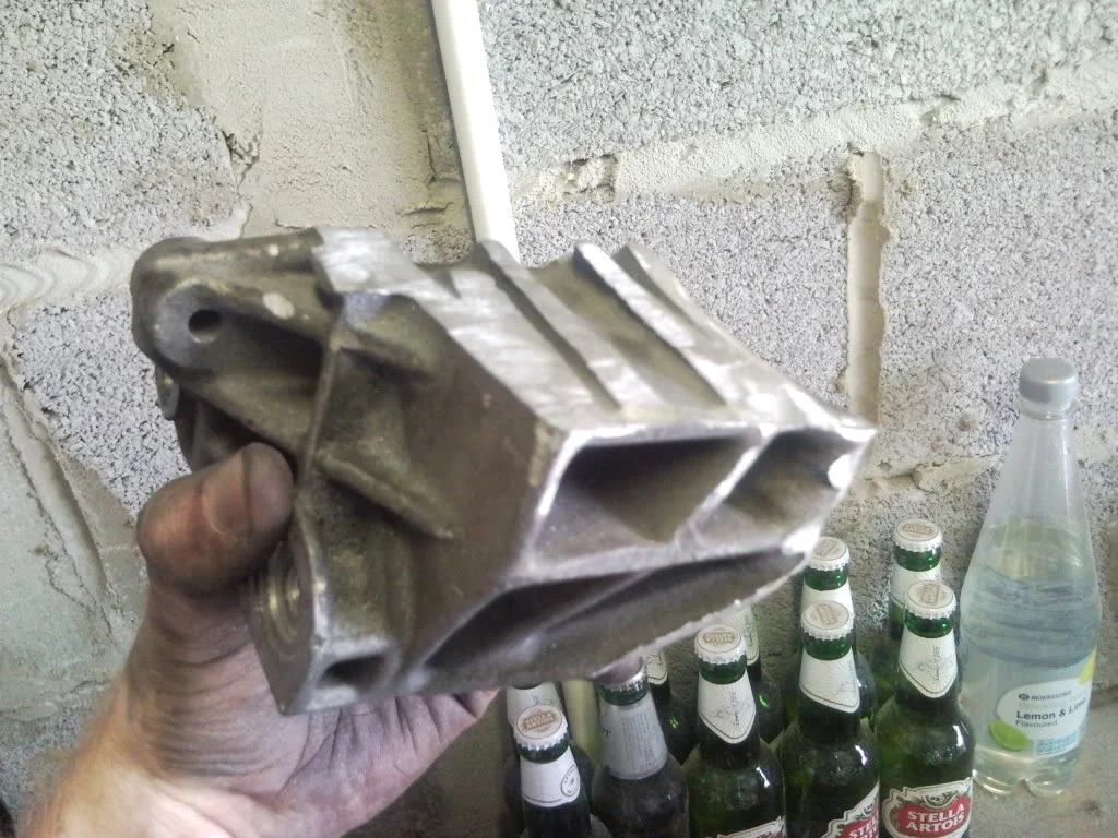

in the time i was there i decided il do a custom mount for the alternator,
started off with the mount which held on the alternator & aircon unit on a normal 172, didnt think to measure just looked and though ye that will do :)
so off i went, had to angle grinde a few parts to make the part fit in the vice,
took about 2hours with a angle grinder and saw, was abit tricky due to the disc ov the grinder beeing to small cut through but managed it
final product
[ATTACH=full]568183[/ATTACH]
[ATTACH=full]568184[/ATTACH]
not bad imo, dont like to use the grinder incase the disc flies off :o

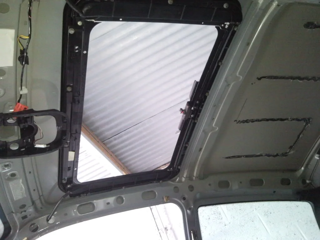

aslo i began to sort the sunroof, the fiberglass roof was light but crist was a right pain to get out,
now im thinkin of gettin another roof done, fill the roof with foam and use a dark cloth cover, not sure yet, il have to ask dear mother to sort something out :)

i had two choices with the belt, 822 or 810 and i though well if 825 is too long 810 will do and you will manage to get alternator in correct place, i have faith :D

got these through the post last couple of days :)

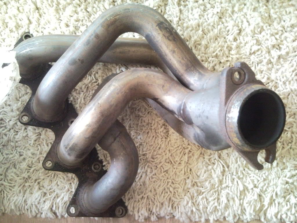

Manifold - just waitin for my cat to arrive now

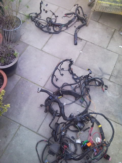

also engine loom which i had to get another one from steve as he snipped some wires off the last one lol, old one is the furthest away and new one is the biggy
My twisted dogbone mount which i got off a Cs member, have some polybushes to replace original ones
On the dogbone how do you remove the standard bushes?? seems to be well nudge in there..

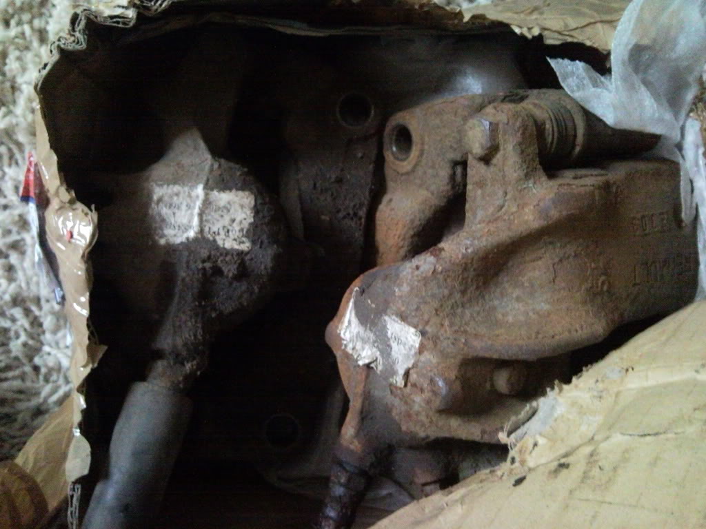

and finaly 2 sets of Cliosport Calipers :D
now just need some brackets made to fit these now..
