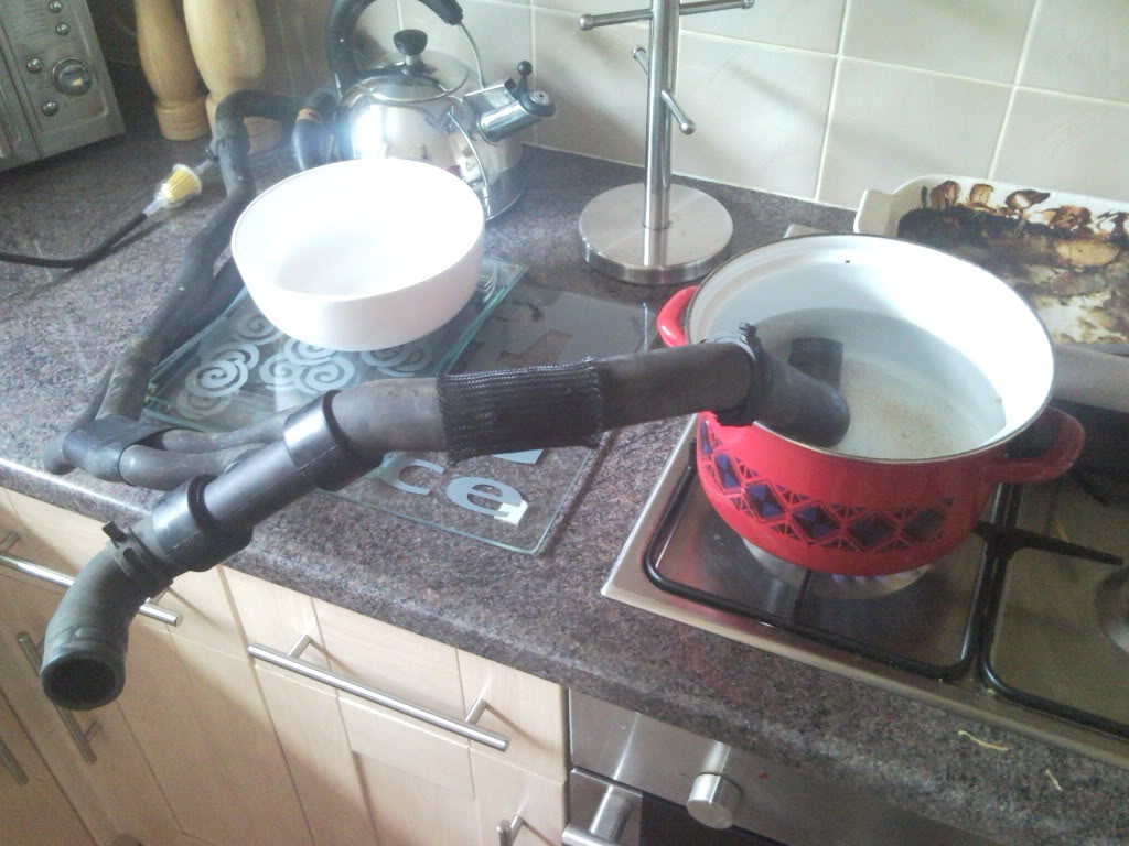

I did have 172 coolant hoses but i managed to **** one up bigstyle, so i had to improvise ;)
first off i has to cut it down to size then heat the part that needed to slip onto the block
lucky the parents are away so i used the stove and boiled the water :) worked a treat .

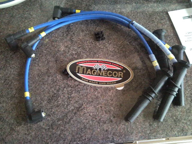

Still no spark, even tho i have replaced the spark plugs and replaced the Ht leads with some Magnecor competition leads, ,
We did test by sticking a new spark plug into a Ht lead and there wasnt a spark in-sight, so im hoping its the coilpack now :)
