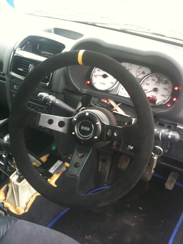

Had a delivery in the week were my group buy steering wheel arrived, and then did my Boss Kit,
Only thing that scared the s**t out of me was the horn wire + steering boss kit caused a fire, lucky there was snow about as that
put the fire off, otherwise all this would have been a waste of time if the car went up in flames..

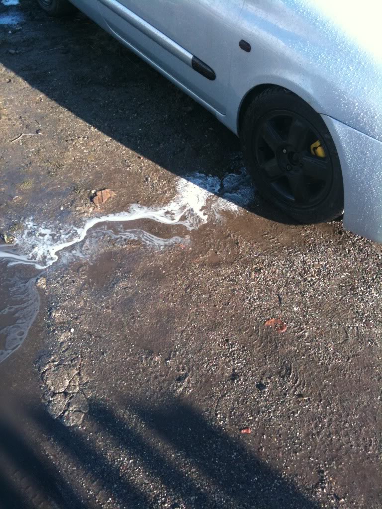

Went at the car this afternoon to be greeted with a nice leak..
flippin gearbox oil, the first thing that came to my head was drive shaft, because on the 2nd lap of the test run yesterday we heard what sounded like a driveshaft etc, but mate was sure its a warped disc.
After jacking the car up went under and noticed some nice gearbox oil underneath the Subframe, which is odd, because everywhere else was bone dry,
I have checked around the gearbox and its dry, Anyone got any suggestions to what it is ?
  Astra 1.9Cdti SRi
Nope i have checked that and its bone dry, the only place were there's any oil is on the floor and underneath the subframe, which makes me think why would there be oil underneath the subframe of all places,
Put hosepipe down side of engine and blast the subframe off...take it for a drive then leave something under the car, plastic/cardboard. Then see if it leaks any more.
If it does id be checking for cracks in the box if its not the shaft
  Astra 1.9Cdti SRi
ye iv kinda done that allready, places my old boot carpet underneath so should show.
If its a crack in the box, then i might have to contact the guy i had it from, because its the first time the gearbox has been used since i bought it in august..

i thought that was the one just wanted to confirm, what do yout hink of the wheel?? is it the dished one you have? been thinking of getting one for a month just still not sure weather to or not does it change of the car feels at all?
  Astra 1.9Cdti SRi
The boss kit is perfect fit as its a Momo one, the steering wheel is different, and i will need to get used to it, the indicator are abit further away but again you just need to get used to it.
Comparing the original and the dished wheel the weight is totally different, the original feels like a bag of cement compared to the dish which weights sweet f.a.
