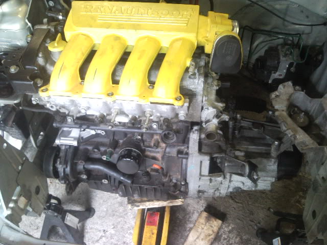

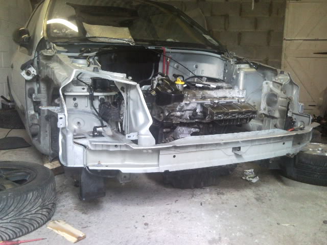

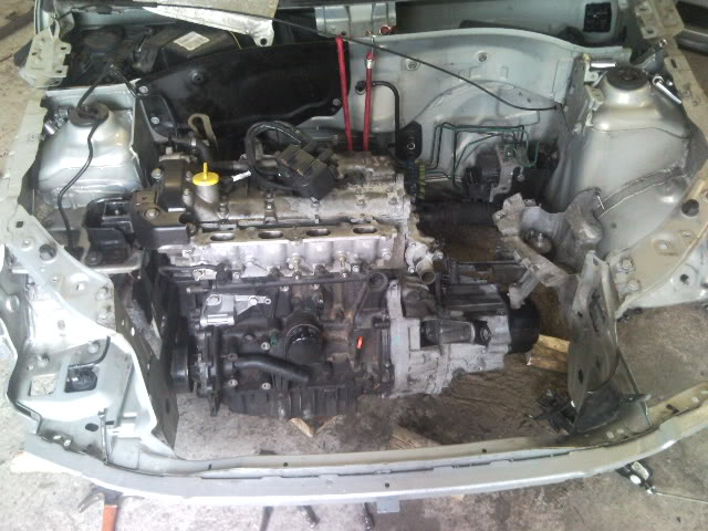

So 8am Saturday morning i was in the garage, had to get the engine in today, but having no engine crane made it very hard for a one man job, but it had to be done :)
So up it went, the car was high enough now to get the engine in from under neath, but since the engine was heavy with the gearbox etc on it all had to come off, so off came the gearbox/mani/inlet, and i started to walk the engine into the bay..
Took me roughly 4hours to get it all in, would have taken about 2 if my dad wouldnt have been so nosey etc lol,
by now your thinkin how on earth is he going to get the engine onto the mount ;) let me explain......
1, Drop the car till its on the floor, but rest it on some wood blocks.
2, wiggle the engine onto the mount,
3, connect the gearbox
4, bolt the gearbox mount on and onto the gearbox,
then lift it up
Job done, would have been easier to get it through the top with a crane but i had to take it back last week :(

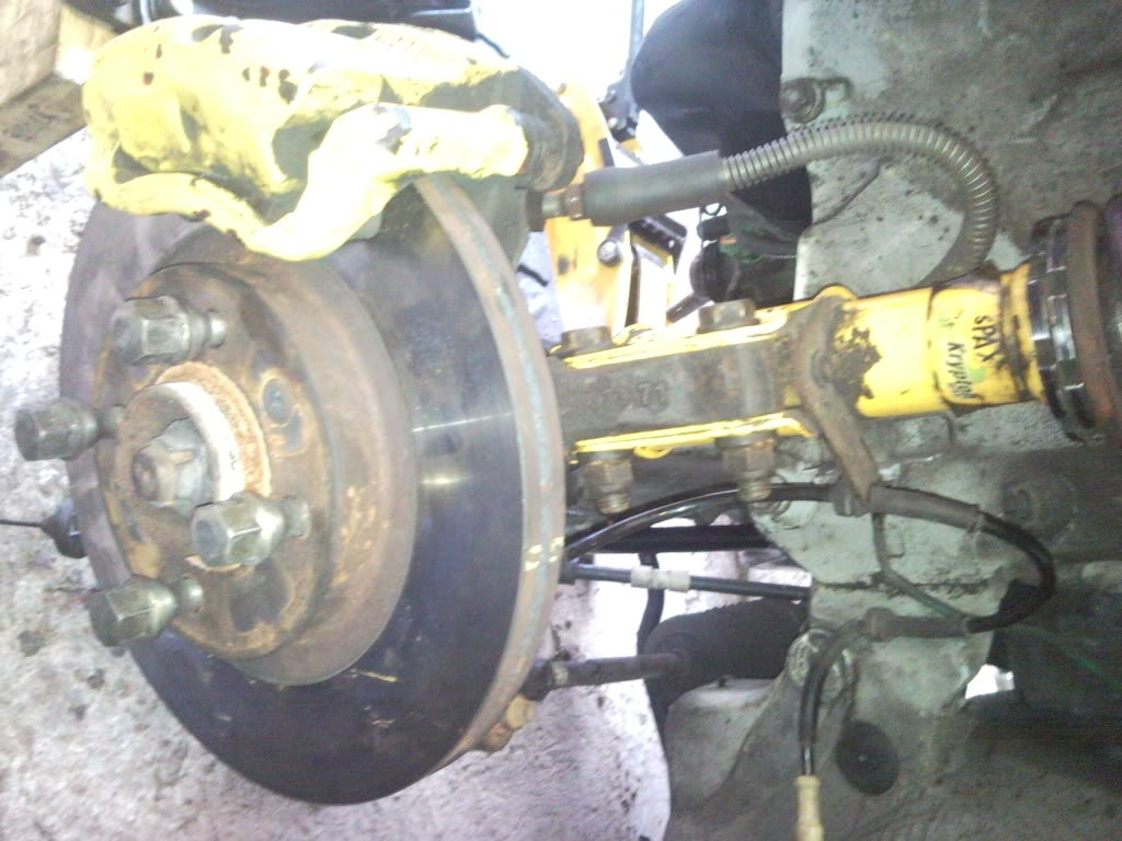

next up was do all the shafts etc, one was in easy but then i was debbating in my head that the passenger side which has a 3motion ball sortov thing had to be filled with crease and then sealed, but Luke cleard that up for me that it gets filled with gearbox oil :D sorted..
atleast its in finally
just gotta get it running now

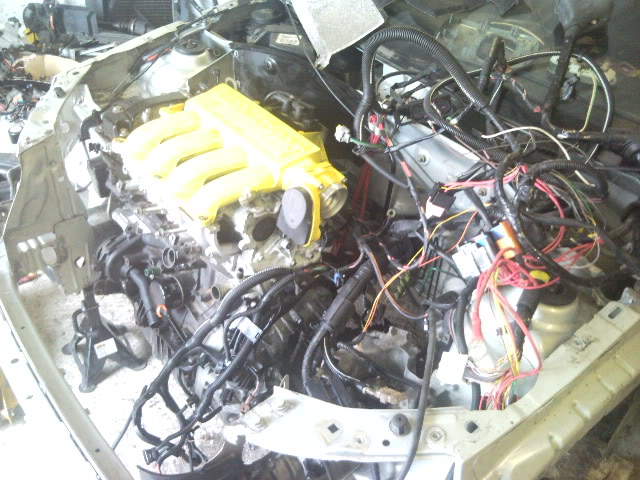

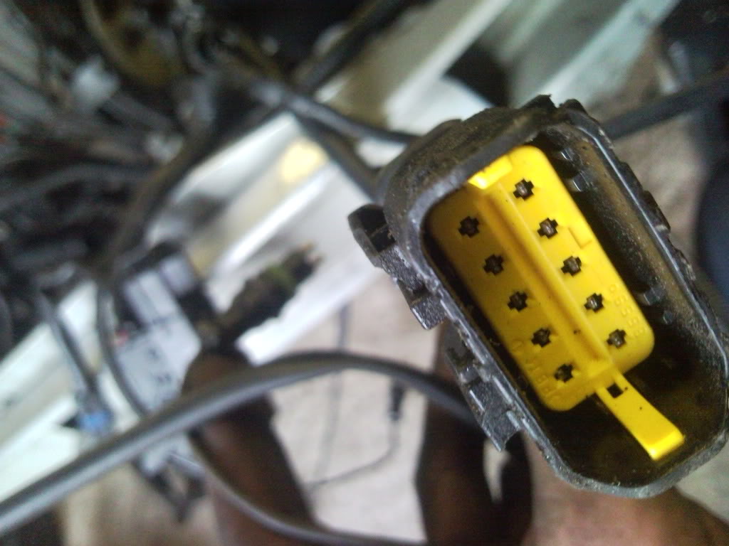

Decided then it was time for the wiring to be done, i wasnt expecting it tbh but its hell to do :(
done preety much all ov it, execept for a few and the connectors for the starter motor,

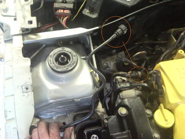

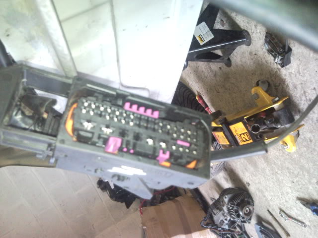

What is this plug for tho?
and this? though it was the ABS pump plug, but doesnt fit :S
Now, since my old engine was a 1.2, iv been wondering were these connect onto the 2L engine..

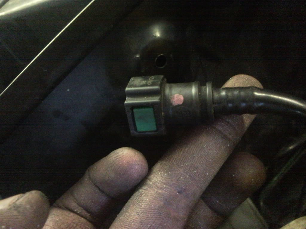

fuel line:
And this, it comes from the carbon canniester on the driver side

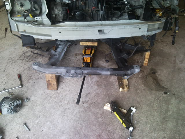

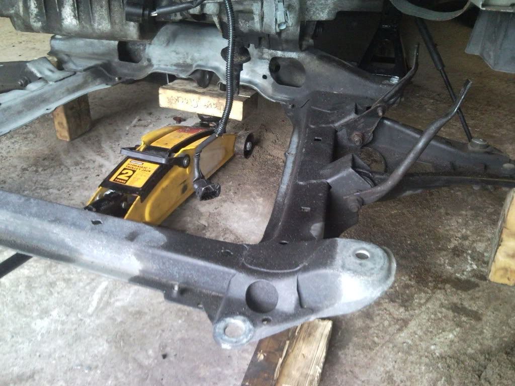

Next, subframe went back, god this fucker is heavy lol, so used my jack and feet to lign them up :)

That black and yellow block connector attaches to a loom that goes to the rear axle, I think its for the xenon adjustor etc... only I think because I vaguely remember wondering the same thing. Dont think I ever connected it though.
Carbon canister can be taken out and thrown away, no real need for it.
I think the fuel line should be ok
Hey cro,
what does the carbon cannister do anywayz? guessin its to reduce the amount of Co2 that goes into the air, hence the name lol,
ye, were abouts does the fuel line connect to tho :S
fuel line.... goes to the fuel rail
and the carbon canister for ease onnect right next to engine mountain. ffs you can see it in the same pic...
