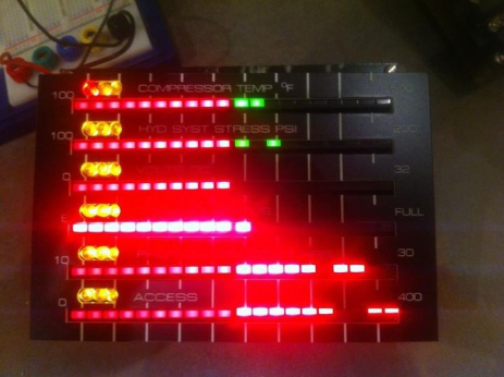

Many thanks are owed to my good friend dave who works at kirad as je has saved me a small fortune by fixing kitts scanner go me!!! Should have it back on (with sound!) by the end of the week!!

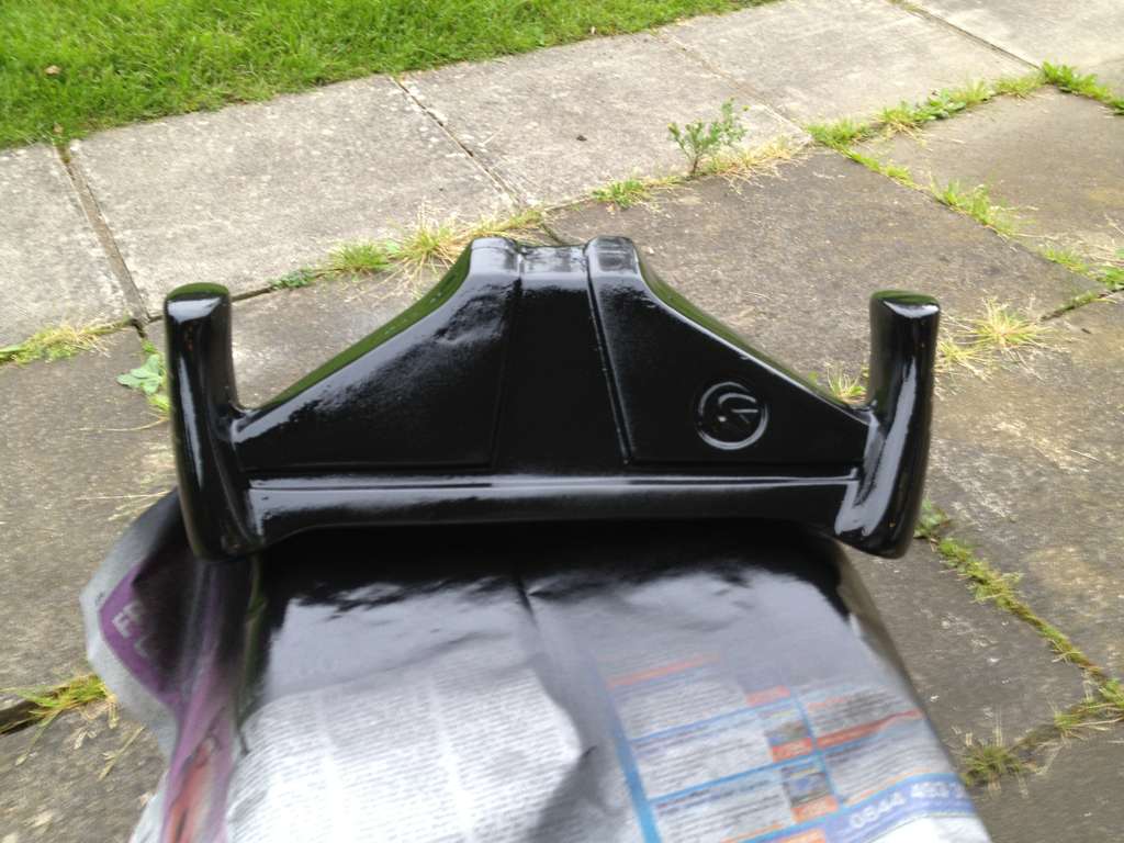

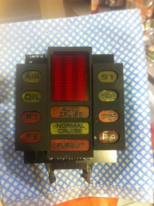

Then just need to get my electronics back from other dave who's been doing my overlays and can finally get them installed! Gullwing wheel is all prepped for primer n paint then just need a quick release steering hub (if anyone has a spare I would be eternally grateful!!!) and that can then be fitted!

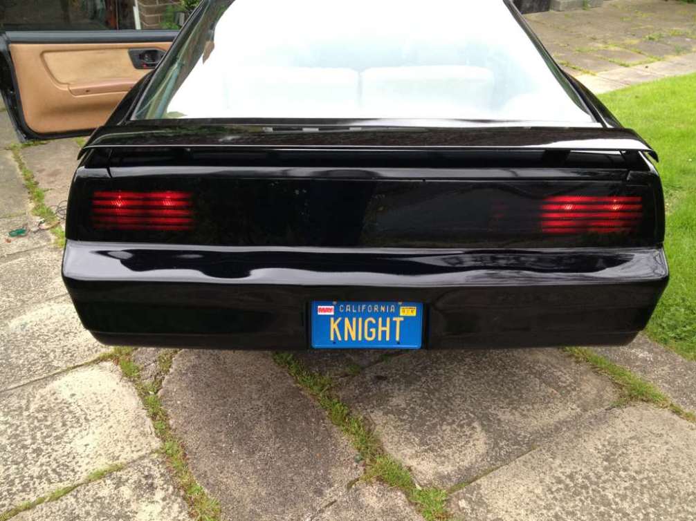

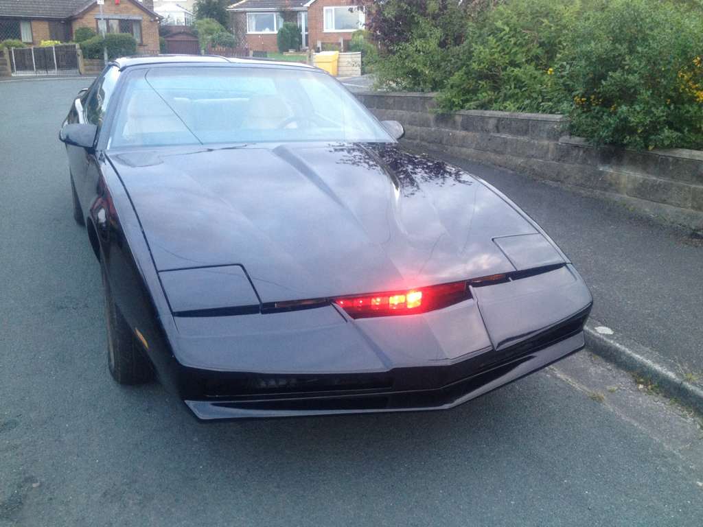

s**t horrible old scanner removed today ready for new one arriving at end of week. Also tinkered with the lights and now have properly working brake lights!

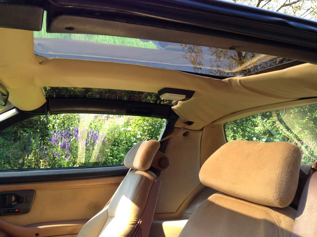

Headliner and trim all in now. Need to work out a way of holding it up properly as the original clips are fucked lol.
Pretty much all standard stuff in now. Gullwing has been sent to one of my KR forum friends to tidy up so then that can go in then big bit is the bloody dash which is a long way off being possible.

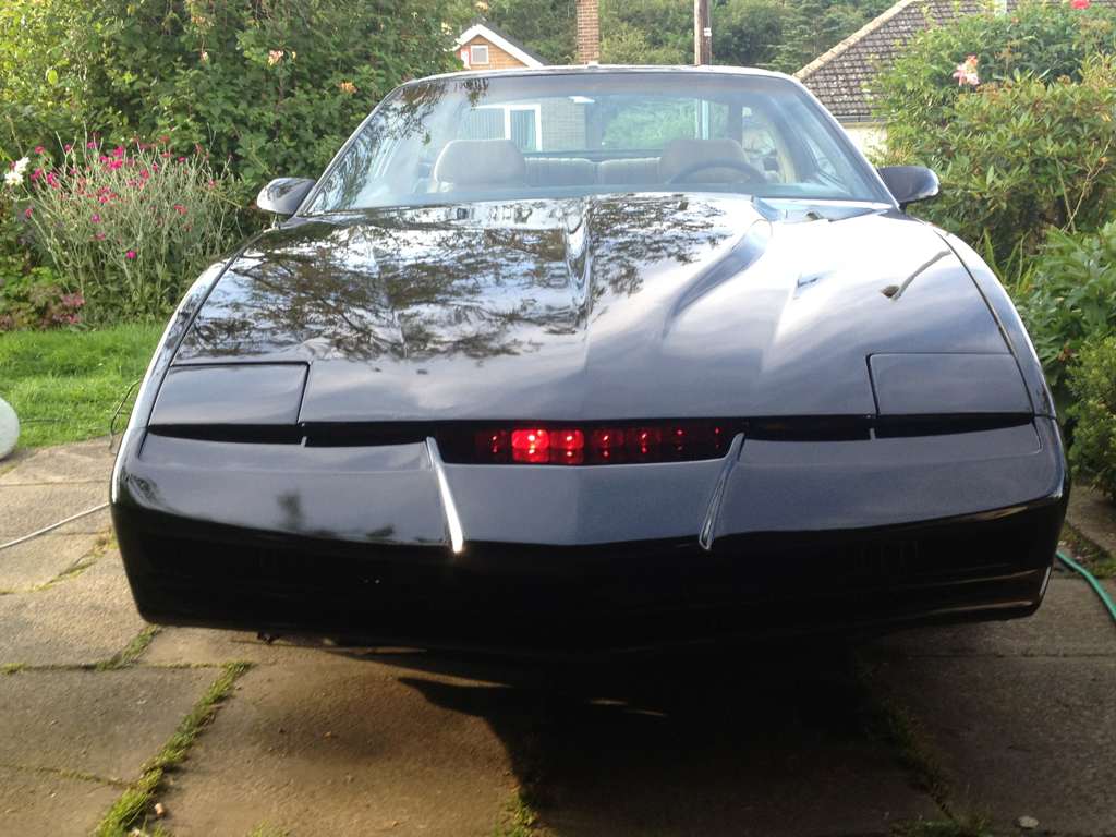

New scanner fitted today :)
Oil change and gasket change tommorrow all going to plan and assuming the couriers actually f**king deliver on time for once.

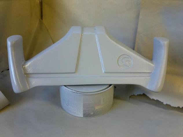

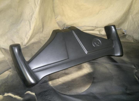

Gullwing is now sanded properly and ready for painting. Scott hopes to have it back with me next week.

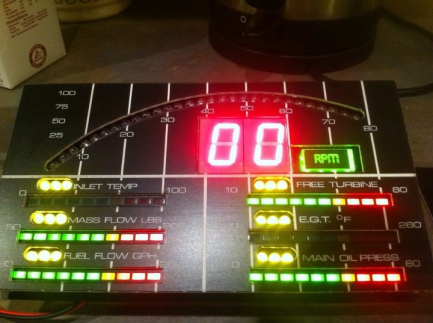

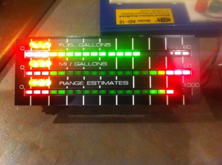

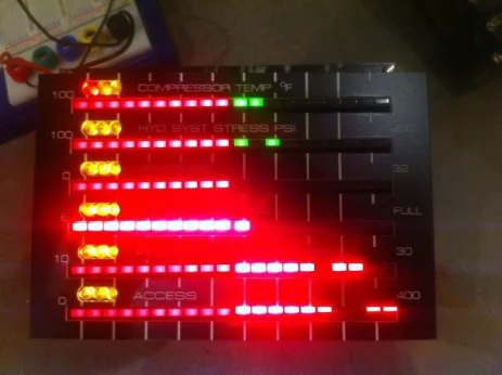

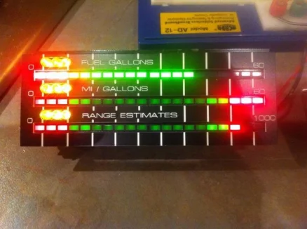

News on the dash that got broken..... I've found someone to fix it so that's all in progress now. My electronics are still being tweaked but all the overlays are all done and dusted. Can't wait to get them back!

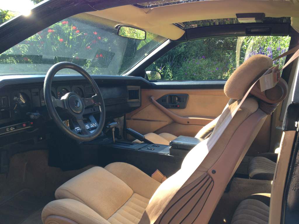

Fitted the t top weatherstrip today and think its fitted okay. Might need more sealant. Tried to get the stock wheel off to fit the gullwing but the things stuck on tight. Gonna have to invest in a steering wheel puller I think to get it off which is bloody annoying. Just another setback to get past I suppose. Took a nice dusk shot before I put him to bed though.

Awesome, steering wheel looks really great, much better now.
You've got to be pretty brutal with steering wheels sometimes, so man up ;) (or get a rubber mallet on it)
  53 Clio's & counting
Give the middle of the wheel a whack with a hammer a few times to try to break the seal, then Grab the top of the wheel with one hand, the bottom in the other - don't pull with both hands together, heave ho pulling top then bottm and really give it some stick -it will come off

Leave the nut on the shaft a few turns otherwise u will break ur nose... Just get angry with it lol, wrench top and bottom then side to side.
