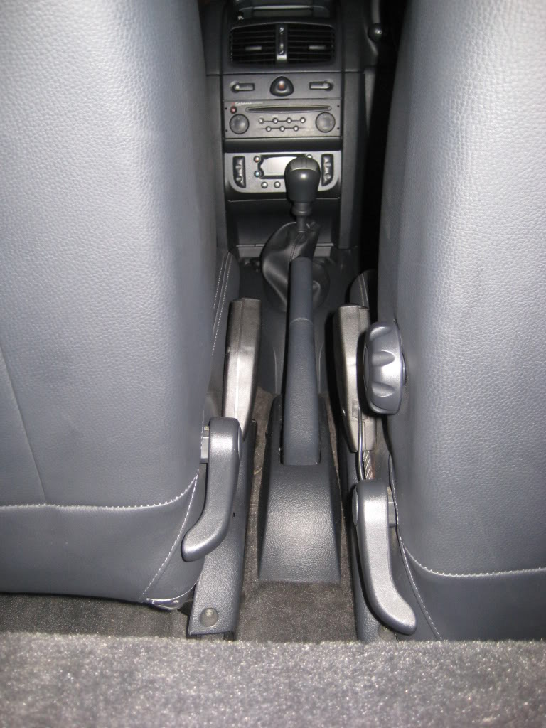

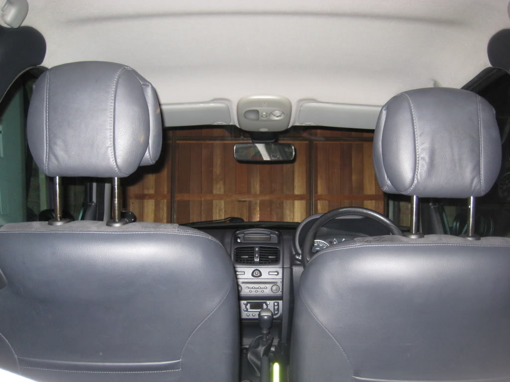

After some guys on here said about lowering the orginal seats.
I'v had a go tonight and it has been the best mod i'v made.
Here are a few pictures of just how low i have got the seat. I have lowered the drivers seat and left the passengers one for now.
I'm well happy with it :)

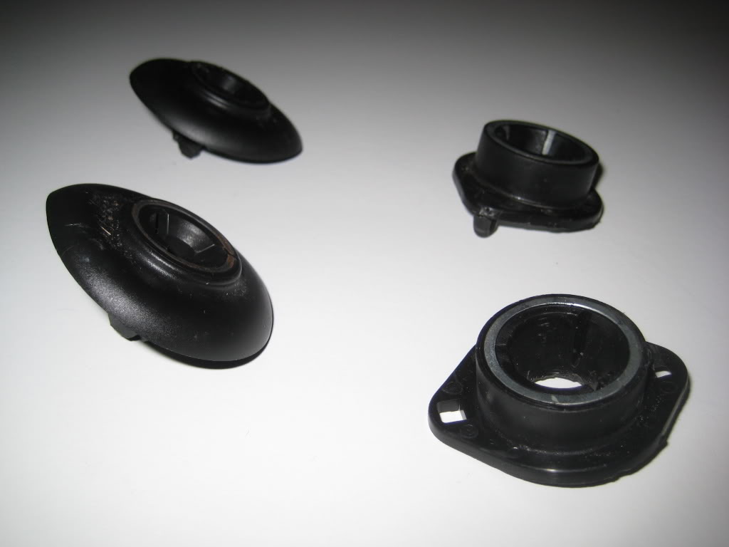

4 bolts off under the car, lift seat, remove spacers/vibration mounts ( as pictured ) re-instal seat.. Job done! although you "may" have trouble with the sliders now
Yep thats what i did.
Oh and the last bit, yeah i cant slide the seat, but currently i have on rear interiour so no need for sliding the seat. The seat is set in my driving position.
I'd recomend doing it to the drivers seat, you can allways leave the passengers seat for people to get in the back :)

As a side note, I was a passenger in my car for first time last weekend and it's like being a child in a high chair again!

What size washers shall i put under the frame so it wont catch on the carpet
I didnt use a washer so mine catches on the carpet.
A washer the size of a 20 - 50 pence peice, at least a 8mm inner diameter too.
  TrackCar & F30 330d
Yeah you can still have them sliding if you put a little washer in brings the seat up like 2mm, but i went for the impractical version and got 2mm lower :cool:

whats the point in it tho ??
Most reviews of the sports have been slated bye the driving position being too high, Saying that your sat on it, not in it :)
This mod lowers the seating position enhancing the driving positoin

How hard where the bolts on the underside of the car to get to matey???
Only got a small jack :(
  TrackCar & F30 330d
They are really easy to get to, just look where the bolts are in the car and look/feel where the bolt is. I used a 13mm socket i think :)
