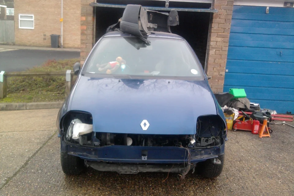

This is how she ended up:
Anyway i still popped on the forum every now and again to see if anything cheap come up that i can turn into a track car as i am never ever driving a stripped out 'Track ****' as an every day car. Plus the astra is to costly to do the odd track day as a set of decent pads is £280 and four reasonable tyres is around £500 fitted so ideally dont want to be doing that.
Anyway this little car turned up

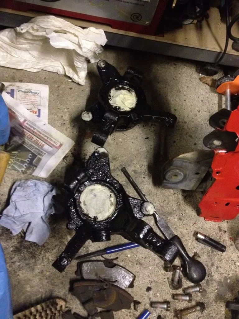

Front Hubs, Front Calipers, Front Discs and Pads, Wishbones, ARB, Subframe, Steering Rack, Front Shocks, Rear Shocks, Complete rear Beam, Handbrake Cables, Gear Lever, Gear Linkage, Speedo Clocks.

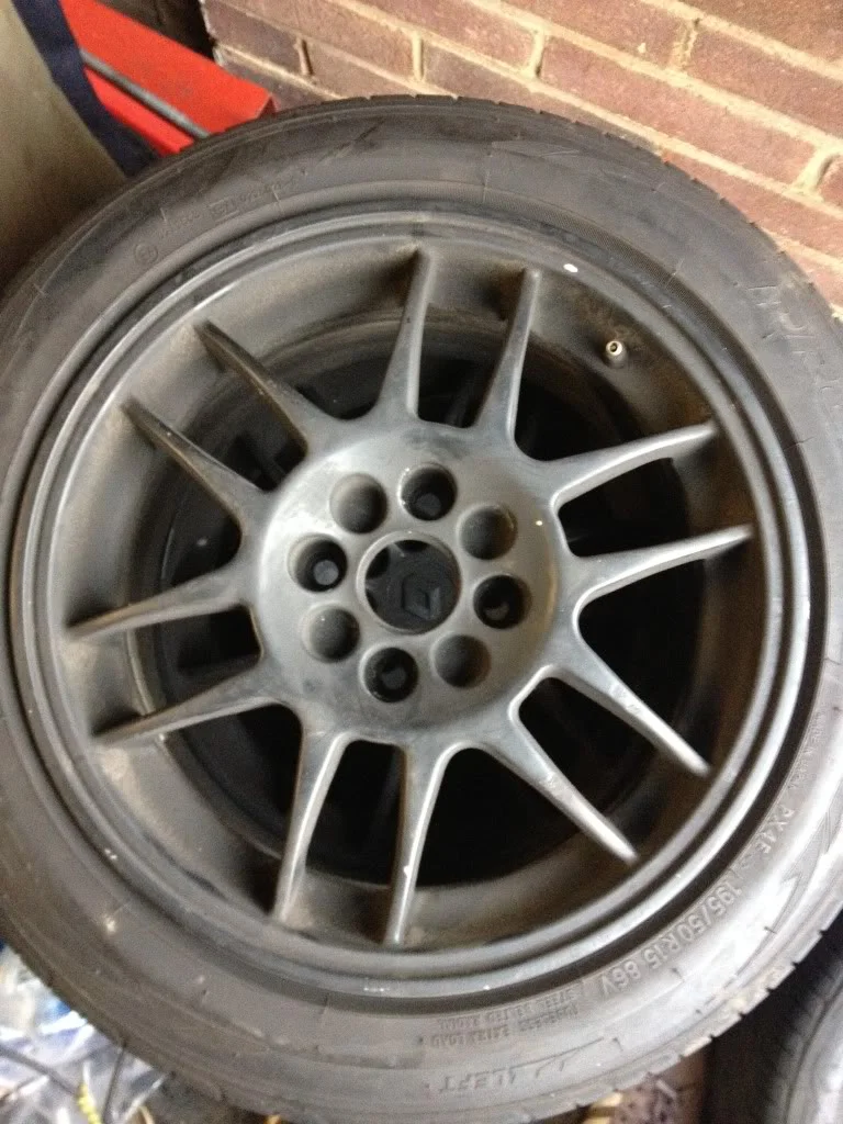

I also picked up 4 Oz F1 wheels with Toyo PX4 tyres and a PH1 172 Airbox with the Pipercross Race Filter and large fire extinguisher for £110 happy days!

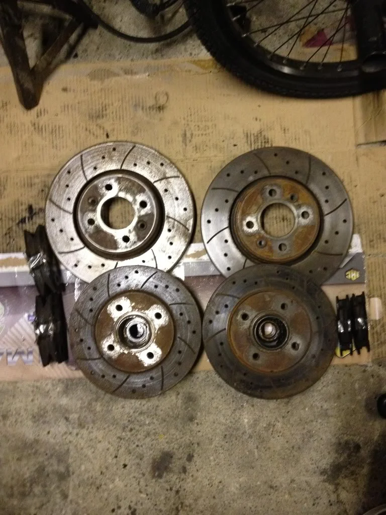

I also bought KTR front and rear discs with pads off of Bomber on CS as i was going to buy some new discs and pads for the front anyway and these
had only done 200 miles.
I also purchased a Cup master cylinder and servo the standard car had no ABS so it has the brake lines already in place. I just need to get an adaptor for two of the lines as for some reason on the cup there are two different sizes. (Gave the servo a lick of paint as it was a bit rusty.)

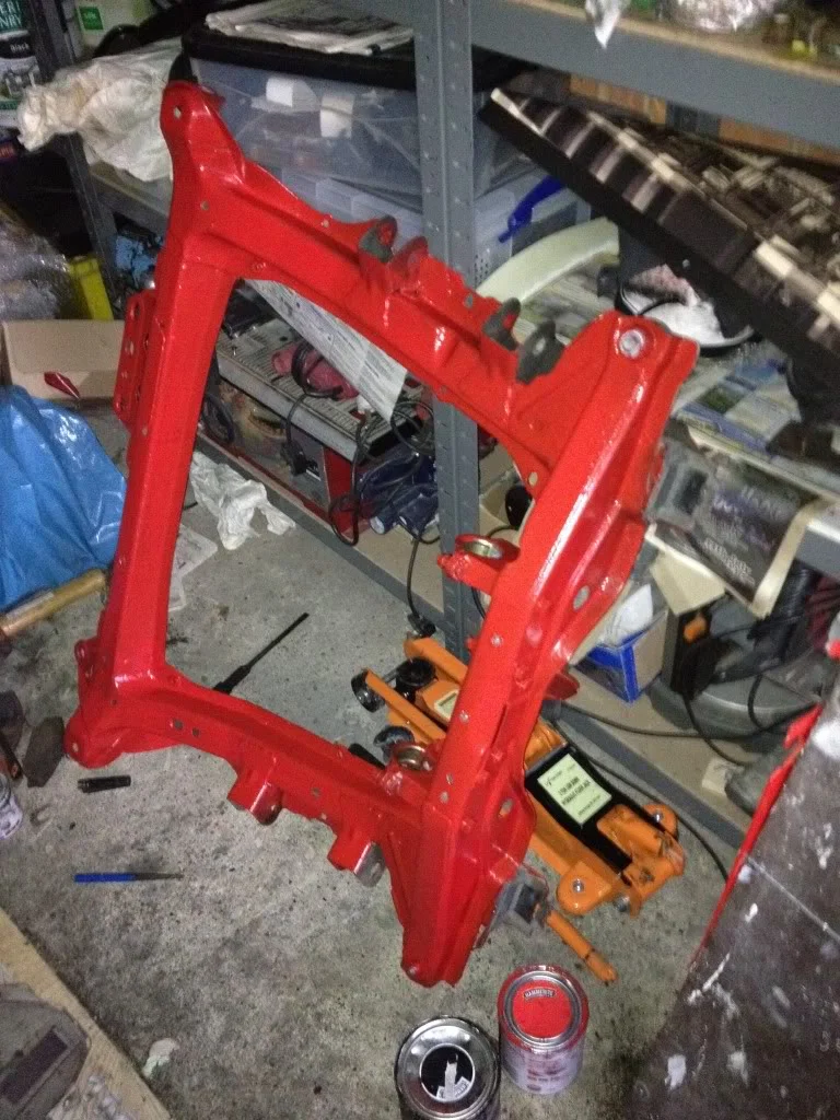

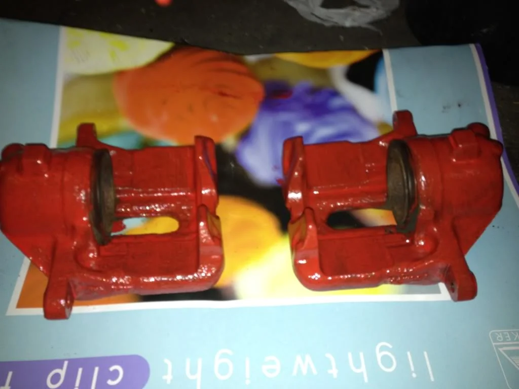

Below are a few pics of the stuff i have stripped down, cleaned up and painted.
I also have burnt out all of the bushes to make way for the full polybush set i have bought off of Deano off CS as i want to focus on the braking and handling of the car. Quick question has anyone got any pictures of the sleeves welded in for the wishbones.
More to come (not going to be an amazingly fast project due to funds and time) Also need to pay for the shelter for the car first and wait for the weather to get better so i can build it.

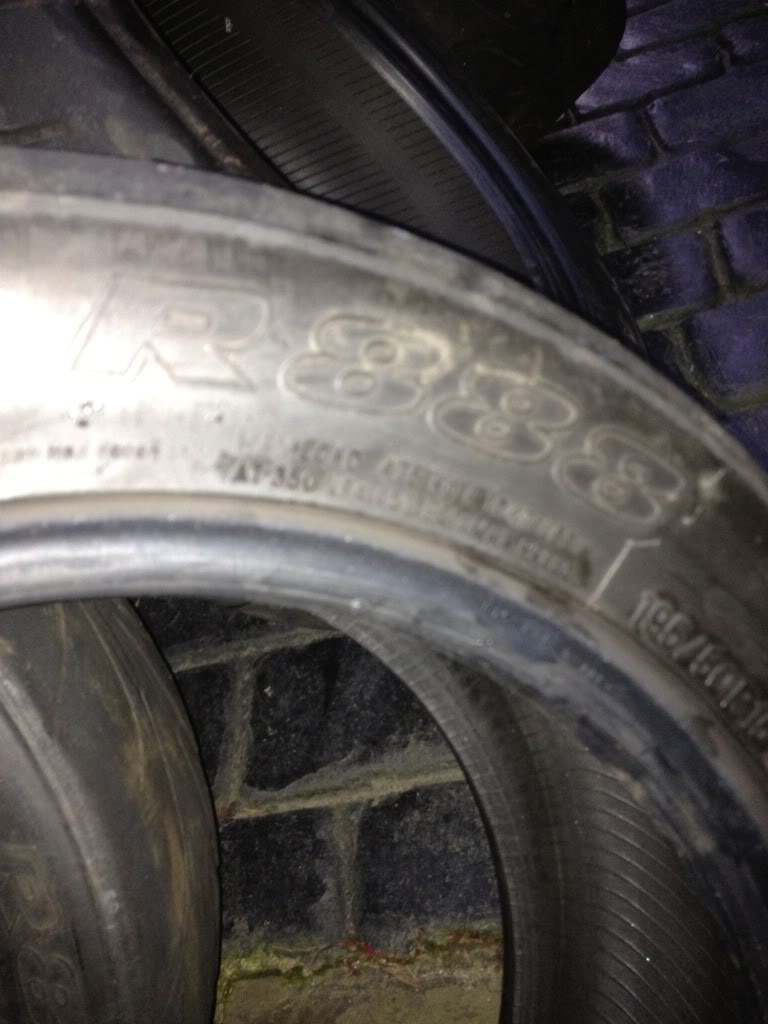

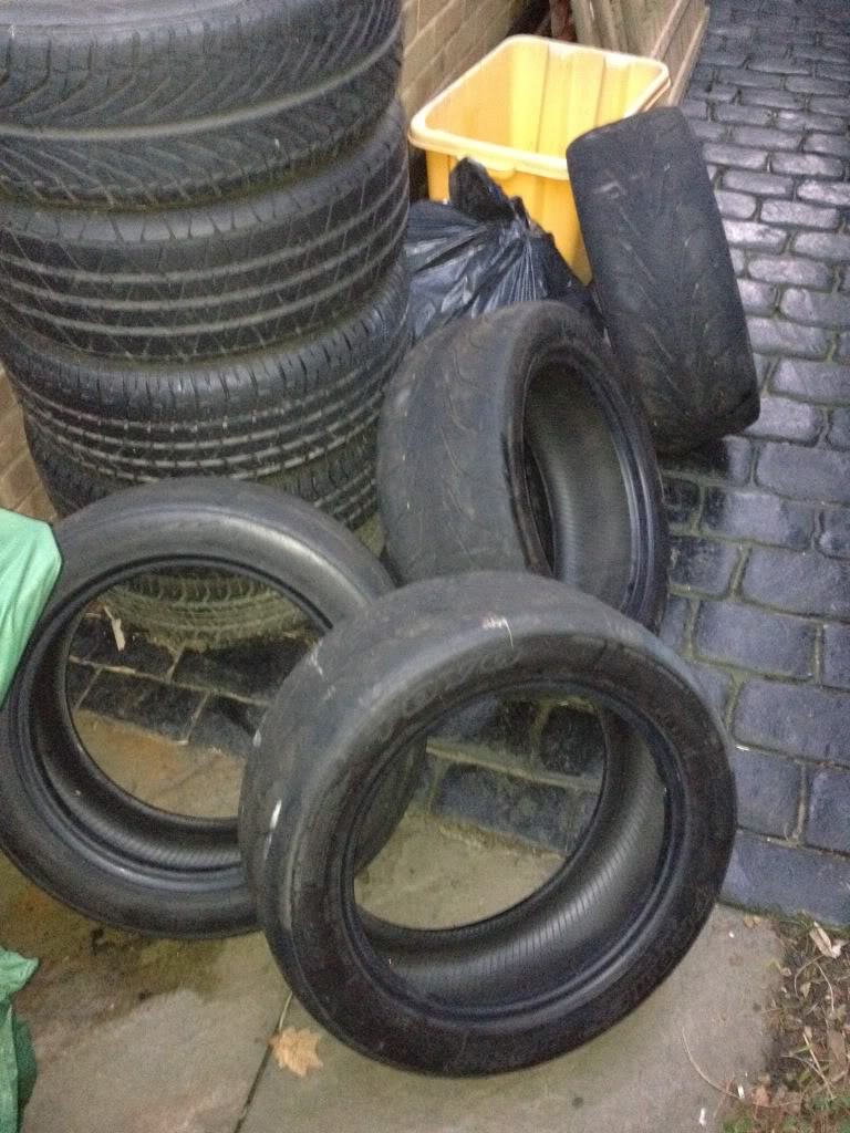

Also just purchased 4 used R888's lovely! :) (alex dont tell stacey haha)

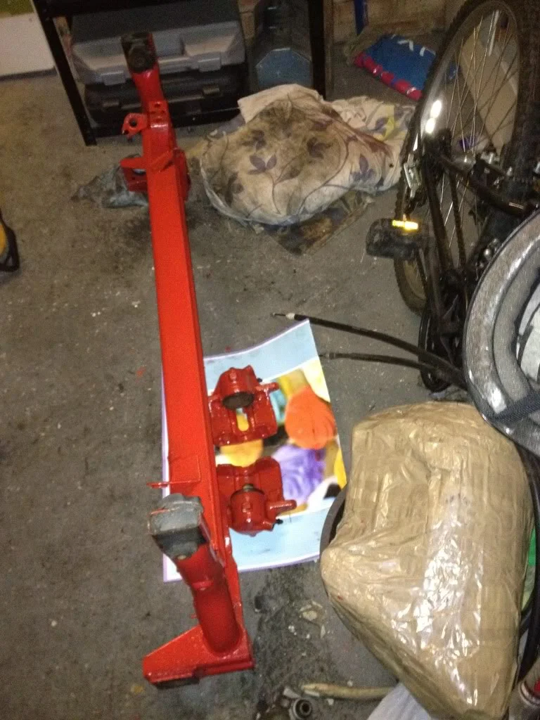

Another small boring update but an update none the less.

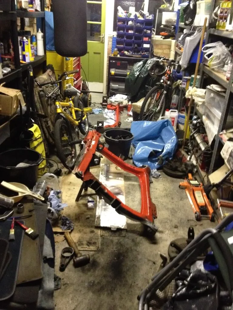

I wanted to start assembling stuff as all i seem to be doing is painting and to be honest its boring dull and not something i really enjoy doing.

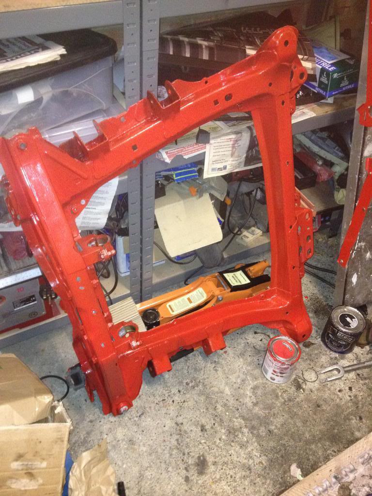

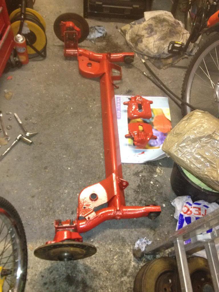

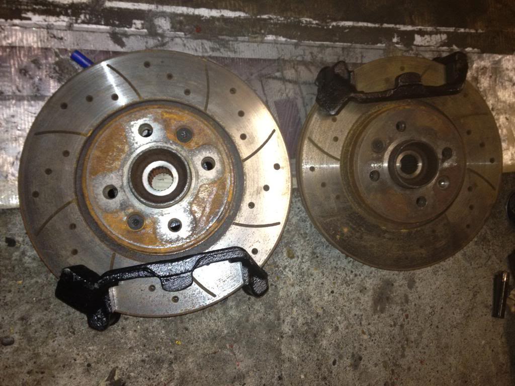

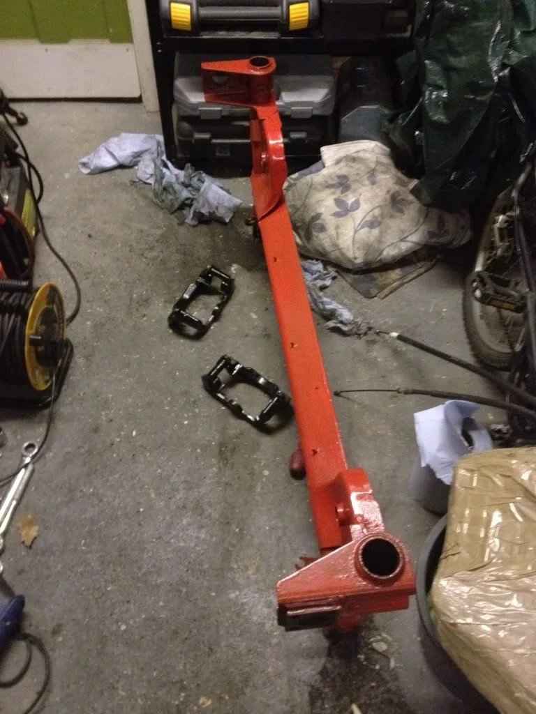

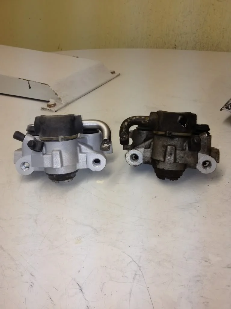

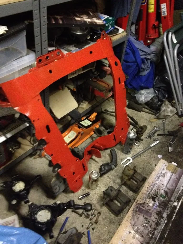

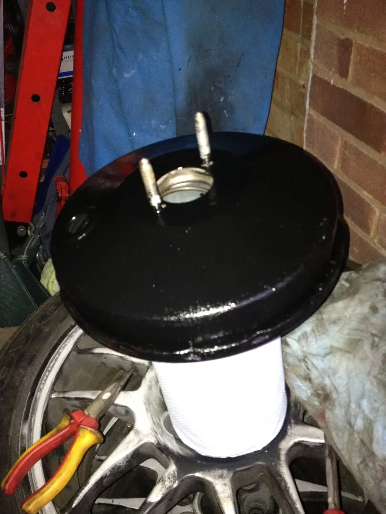

First of all i cleaned all of the mating faces to assemble the sub axle back onto the rear beam.

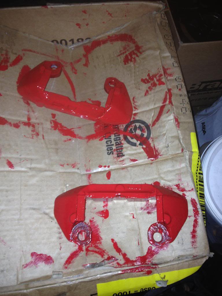

I then greased up the stub axles and bearings of the rear discs and fitted them on.
(I had also given the calipers another coat of paint.)
I also went over the subframe and rear calipers in a few places to give it a fuller colour. TBH its not perfrect but its not a show car so not worried as long as it looks red from a distance i dont mind!

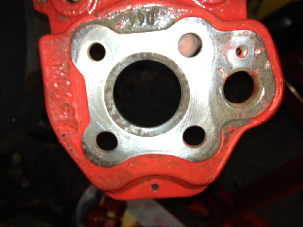

Then i fitted the Front discs to the hubs and fitted the carrier to the hub (ensuring the sliders were cleaned and regreased). Will assemble the front calipers when the paint drys.

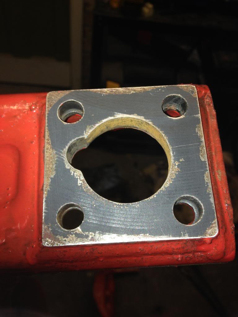

I did also clean up the wishbones a bit in preparation for welding the sleeves in for the polybushes but i didnt get any pictures of this.
Im taking them into work tomorrow to use the sand blaster. Im also taking in the rear calipers (Piston part) to get them looking nice and shiney once again.

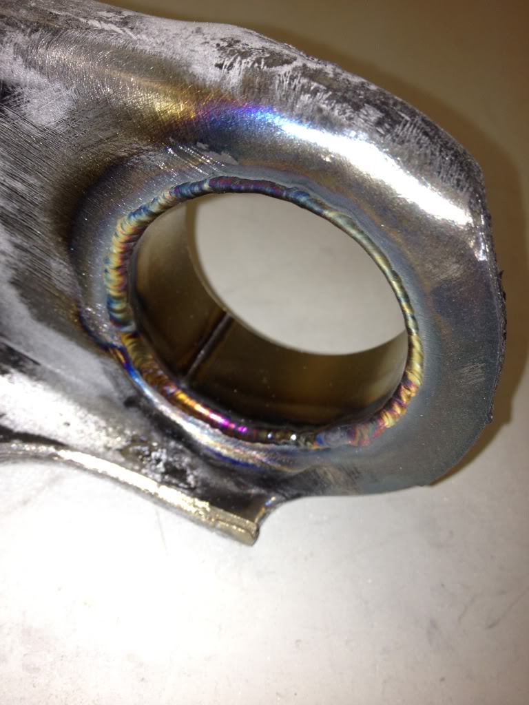

Tiny update, have done a little bit more but going to wait until I take the pictures of them.
Few pics of the work I done Friday.
Firstly got a mate to weld the sleeves in for the wishbones. Done a fantastic job as ever.

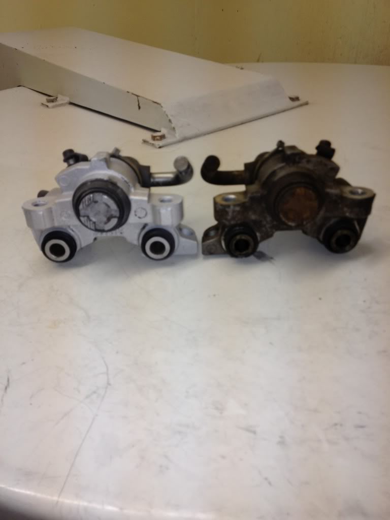

Then I made a start on the grubby rear calipers. Sand blasted on the left and dirty on the right.

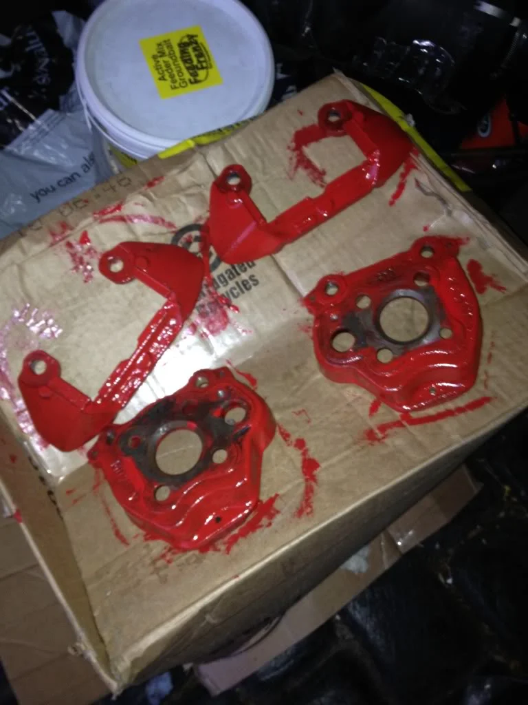

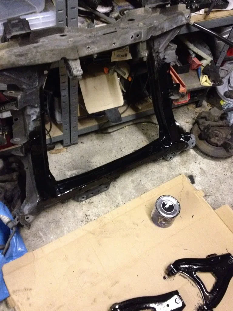

Done a little bit more last night with the sand blasting of the wishbones and also a few other parts.
I haven’t got any pictures at the moment but will get some when I get in.
I sand blasted the wishbones as best I could until no more paint would come out. I then used some of work industrial paint stripper and smeared that into the wishbones and left it to soak in.
While it was working its magic I sand blasted the dogbone mount and the arms that bolt from the subframe/wishbone to the chassis.
The plan is with all of the bare metal stuff that I have sandblasted is to give it a coat of lacquer to try and protect it. It just looks nicer than silver paint imo.
Once the dogbone and links where done I went back and gave the wishbones another go. I have go 95% of it off the wishbones with only a few bits to do. While I’m at work today my dad is going to use some paint stripper and leave it to soak in all day. With any luck tonight I can give them a coat of lacquer so I can start installing the polybushes!

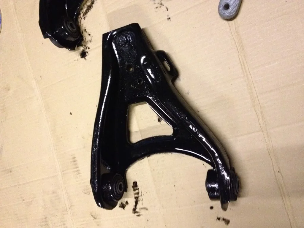

Unfortunately I had no joy with the paint stripper so had to take the wishbones back into work to continue bead blasting them. This time it took no time at all as earlier that day they had replaced the filter and put new material in. I had also taken in the 172 steering arms that I removed from the PAS rack as I will be running non PAS (plus the standard 1.2 steering arms are not long enough for the widetrack!)
With these items done I degreased them and gave them a coat of lacquer. Hopefully this will stop the bare metal oxidizing…..time will tell.
Picture of the nicely lacquered wishbone.

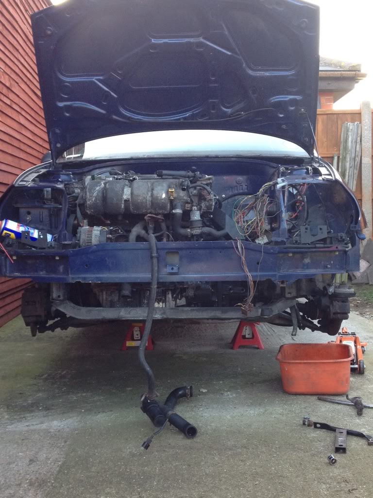

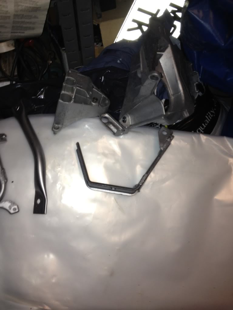

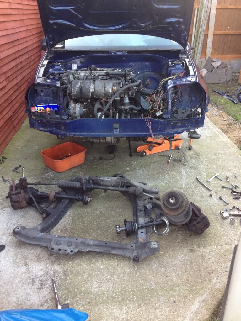

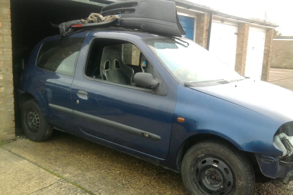

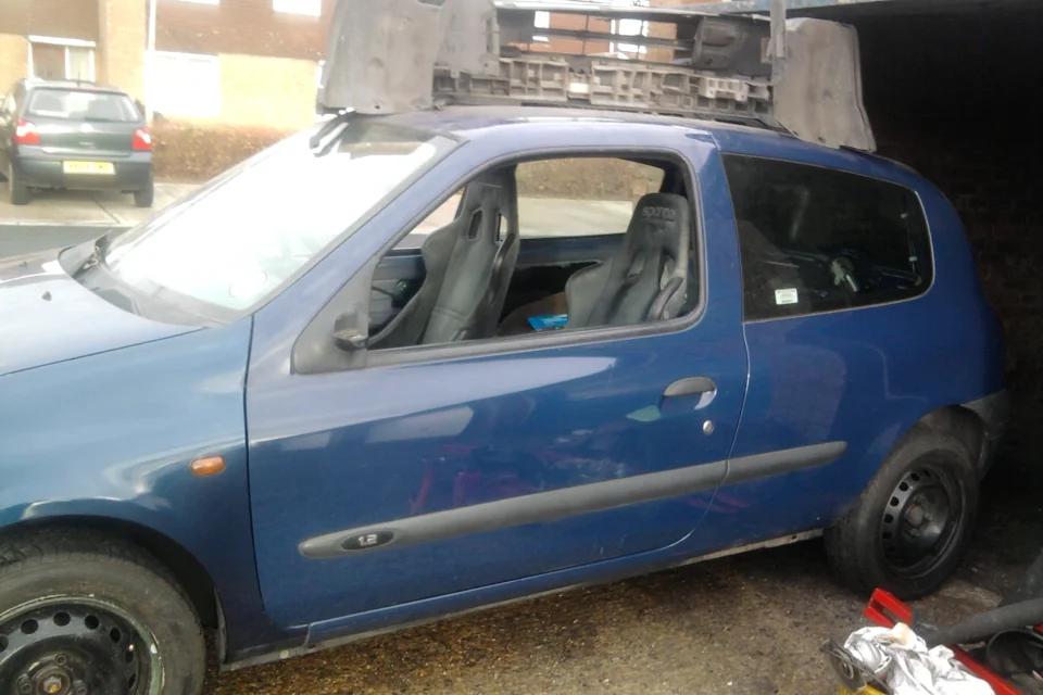

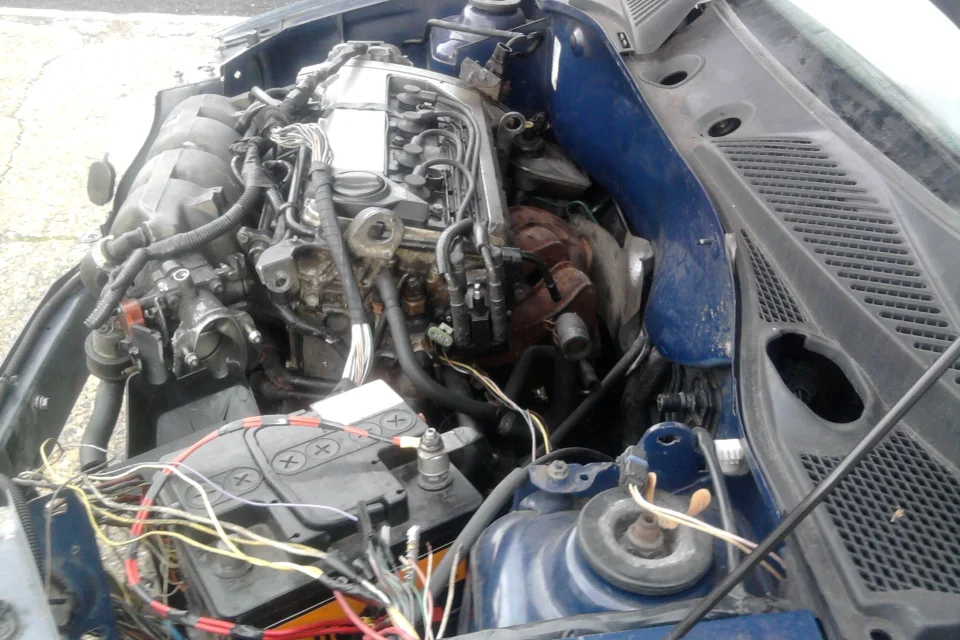

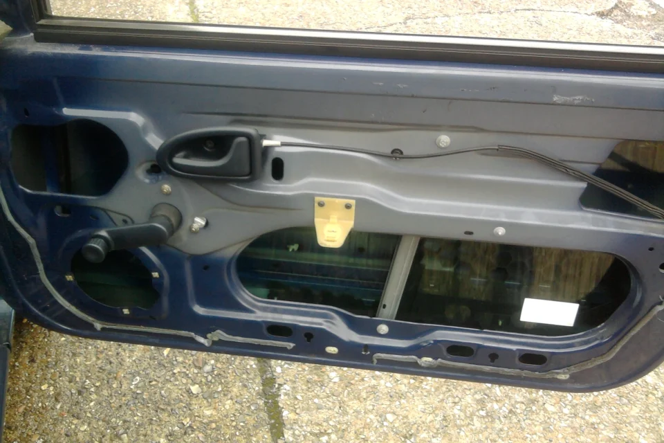

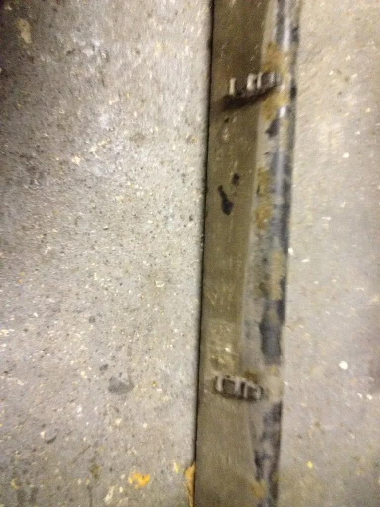

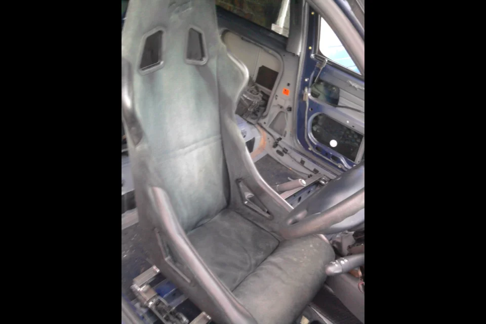

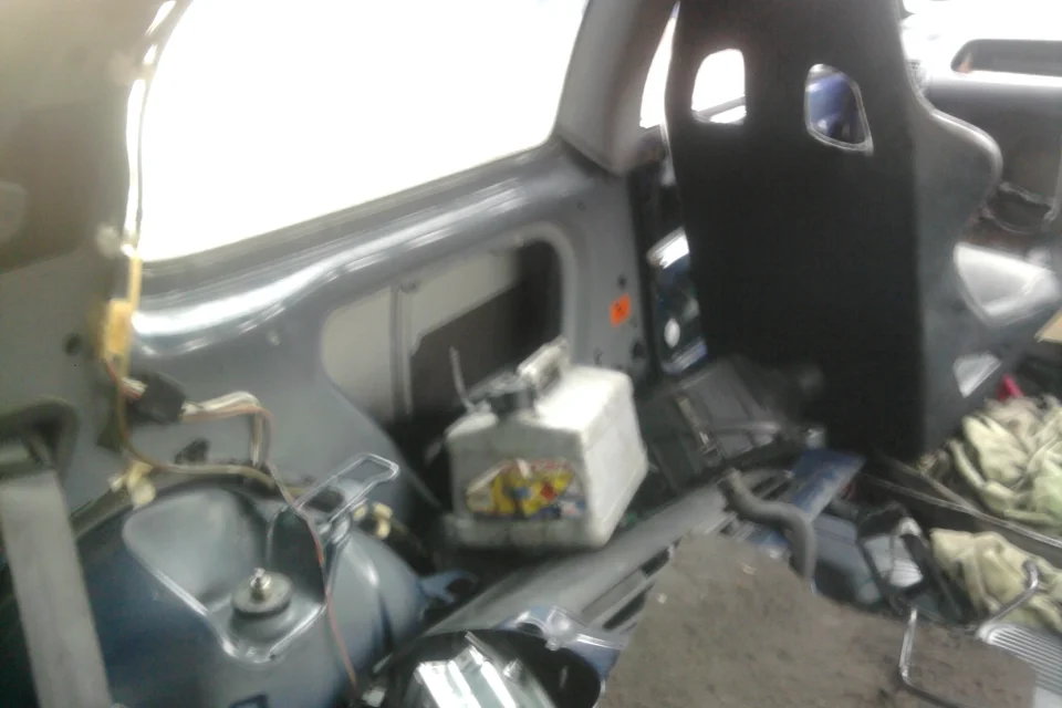

What I did do on Friday (my day off) was go down to where the car is stored and have a look at what is actually in there. Since I picked up the car I haven’t really gone down there to have a look at it, all I did was go and buy a cheap cover from argos and put it over the car during the snow. Bad really.
Anway I emptied the car out to see what I had actually been given with it. Tbh there was a lot of stuff that I am never going to use so they ended up going on the bin pile.
In my hast to get down to the car I forgot to bring my tool box (massive fail) so had to settle to some of my granddads ancient tools.
The car started off like this:
I then got it like this:
The pile of rubbish:
Bit more stripping:
The finished rubbish pile I didn’t bother weighing it but I have got some more weight out of the car! Plenty more to come!
This is how I left her:

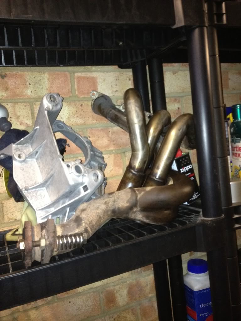

Had a chat with the owner (really nice guy). He was breaking the Williams 1 as someone had properly hit him up the arse at about 60mph. The car was a complete wreck!

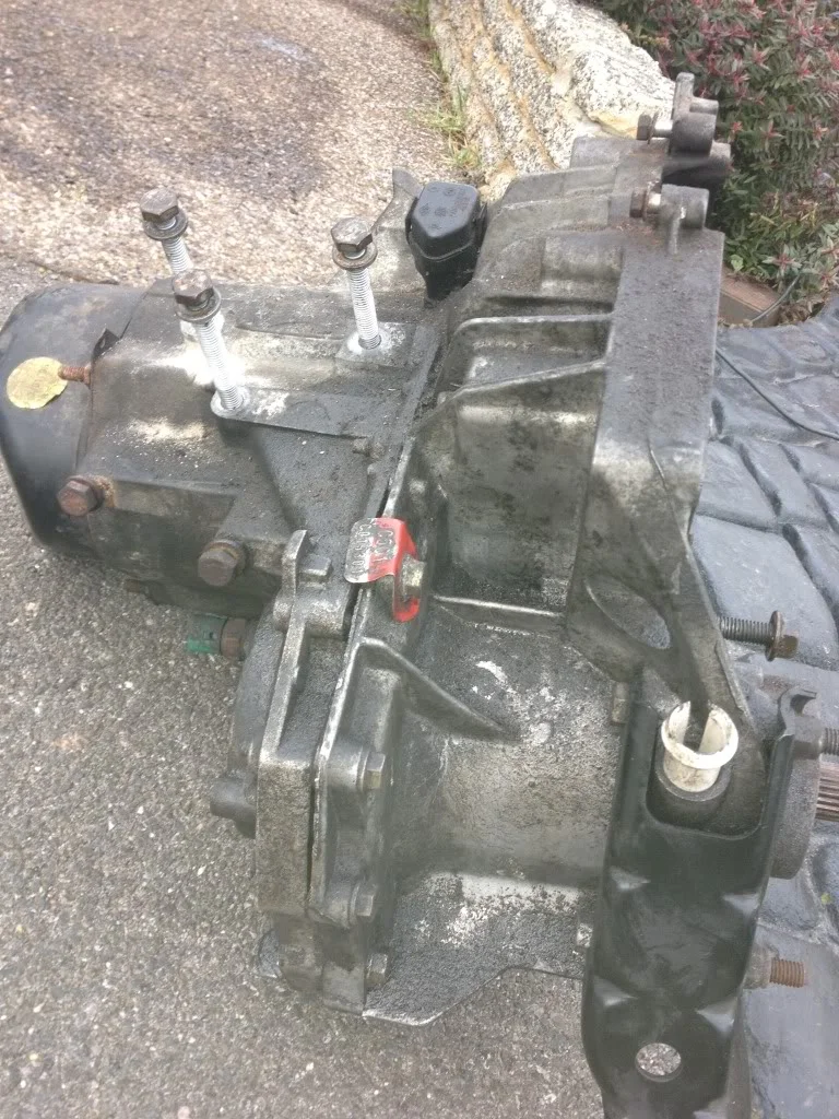

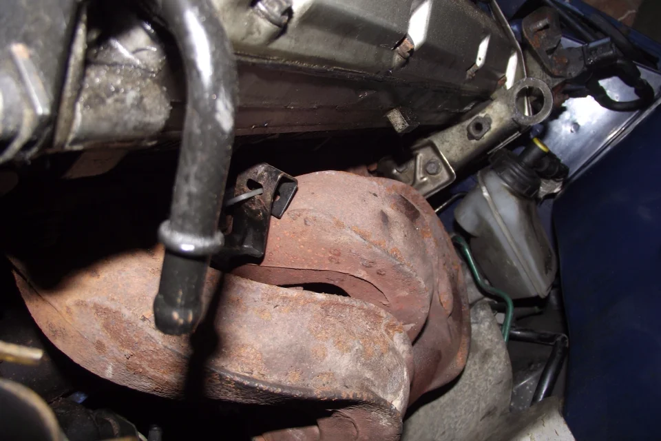

Anyway run the engine had a look around and then started removing parts!
The long and short of it was whatever could go wrong did go wrong. In the end I resorted to angle grinding off s**tty bolts and chopping the chassis leg to remove the sub frame. It was not a fun day.
This is how the van looked once we had finished loading all the parts we had got.

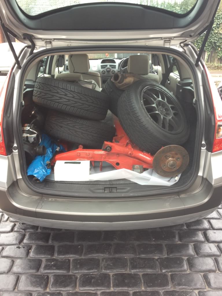

We left surrey and headed back to Bass’s garage as I had given him some parts for his help. We hit the A12 and then sat in traffic oh joy!
We unloaded all the stuff and then headed back to my garage where we unloaded the remaining stuff.
By the time we had finished unloading it was 9pm and we were both completely drained! My garage was also now full to the brim again!

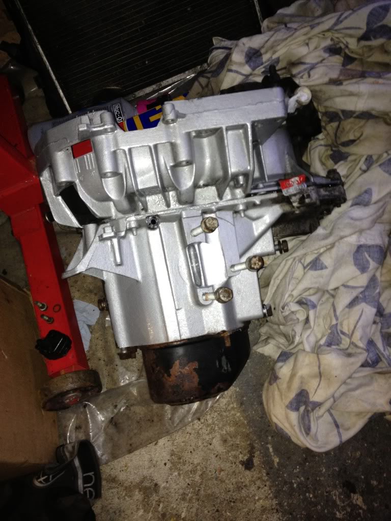

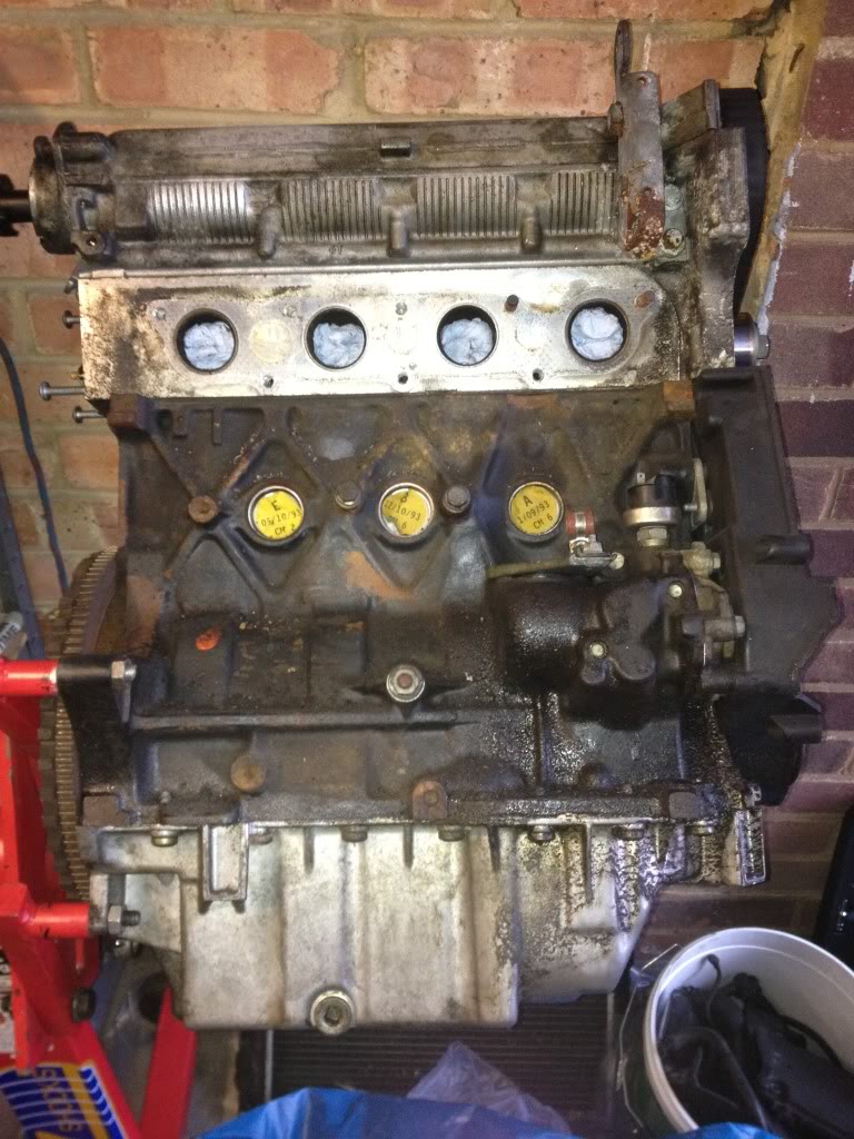

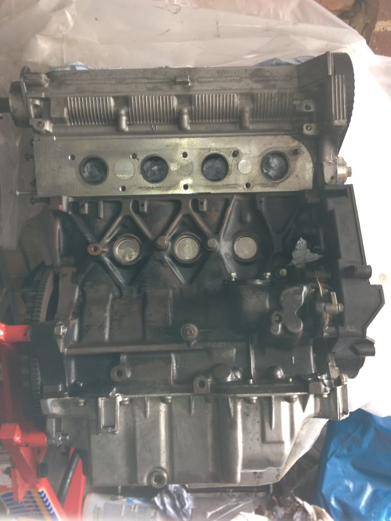

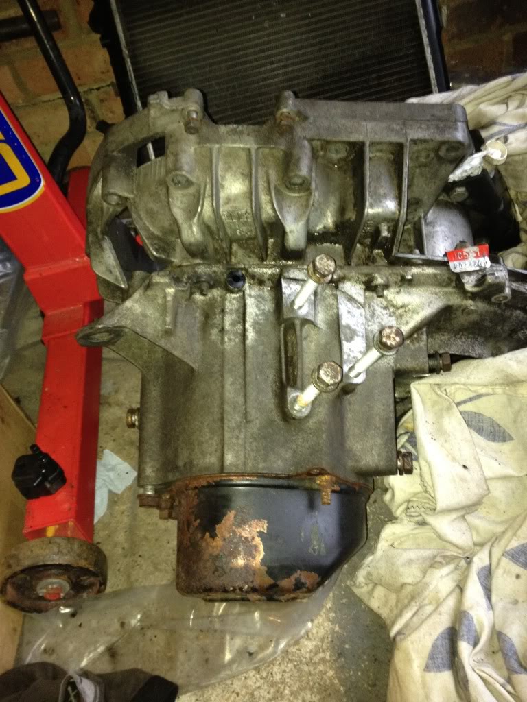

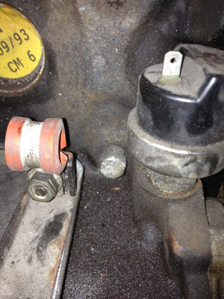

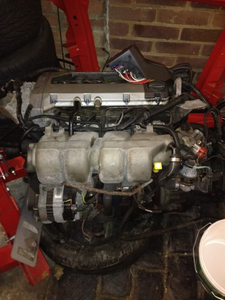

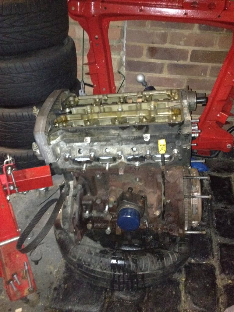

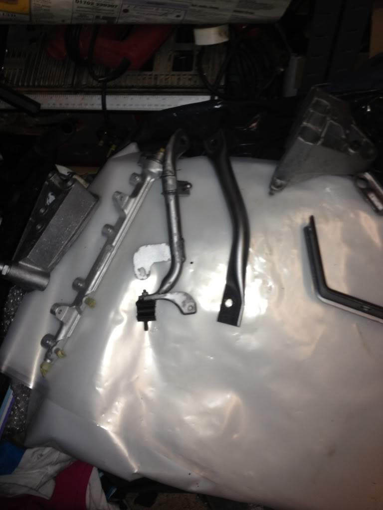

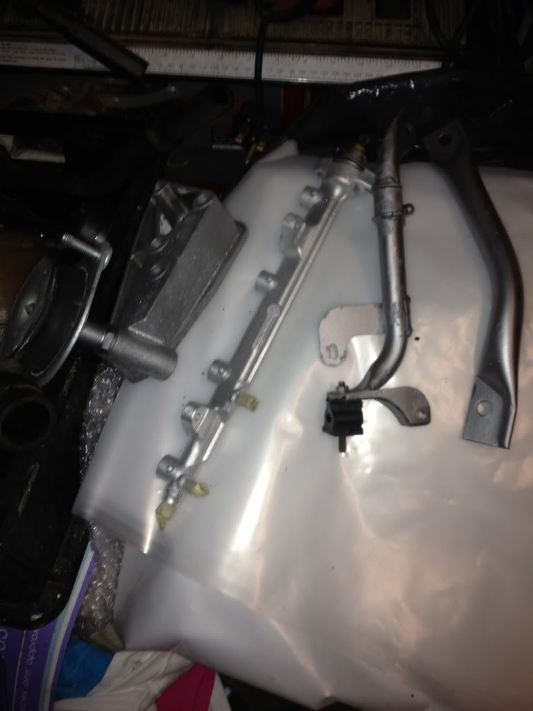

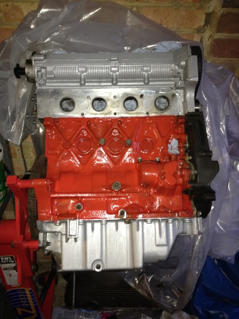

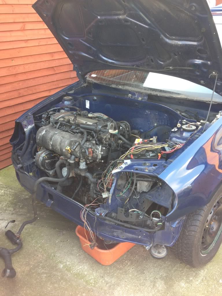

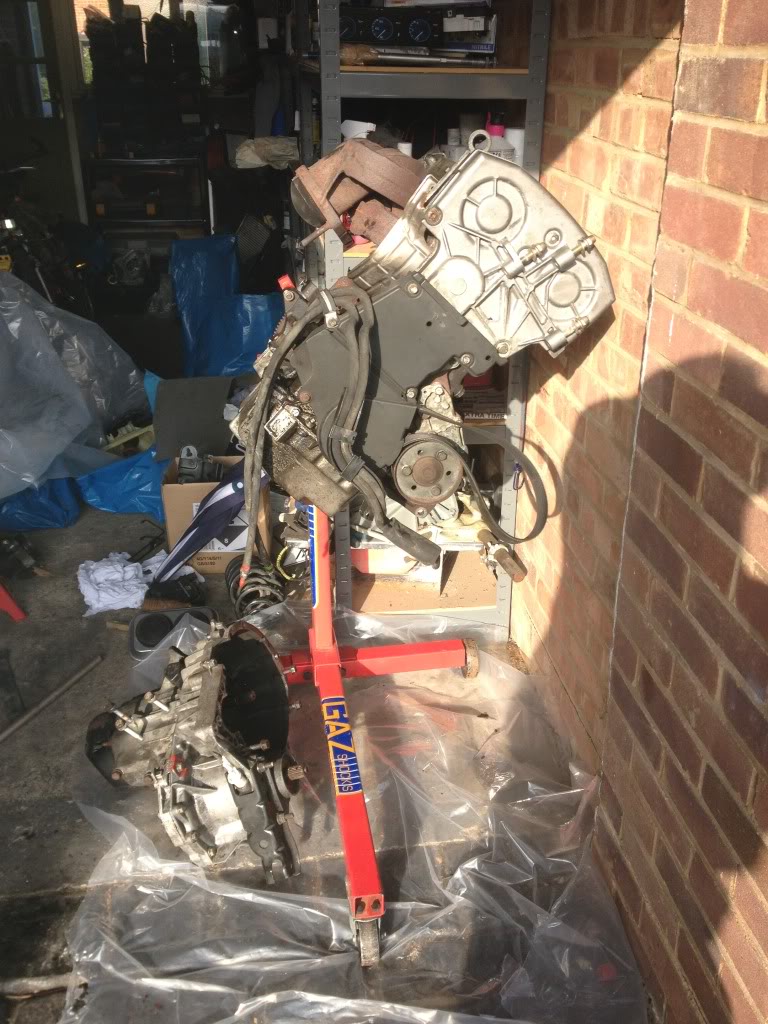

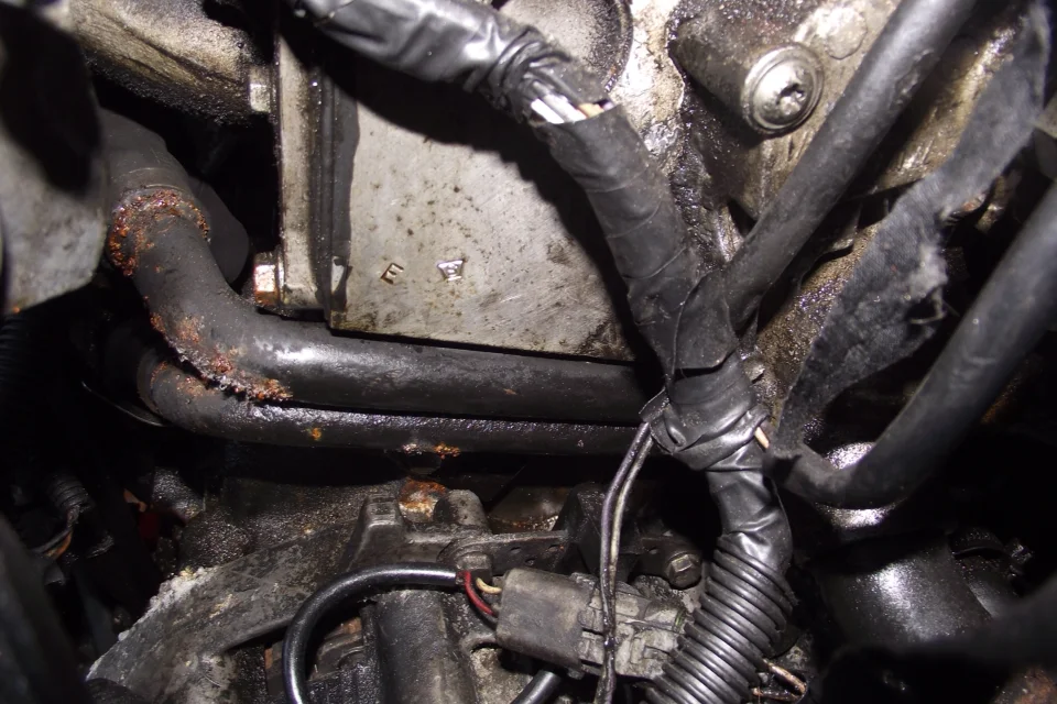

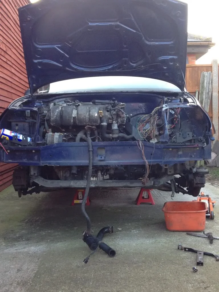

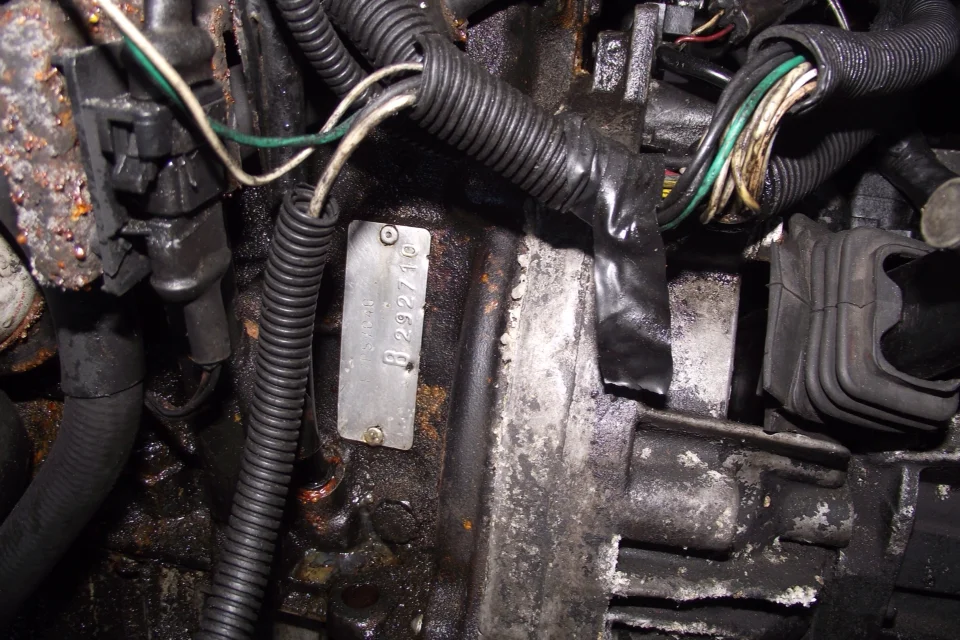

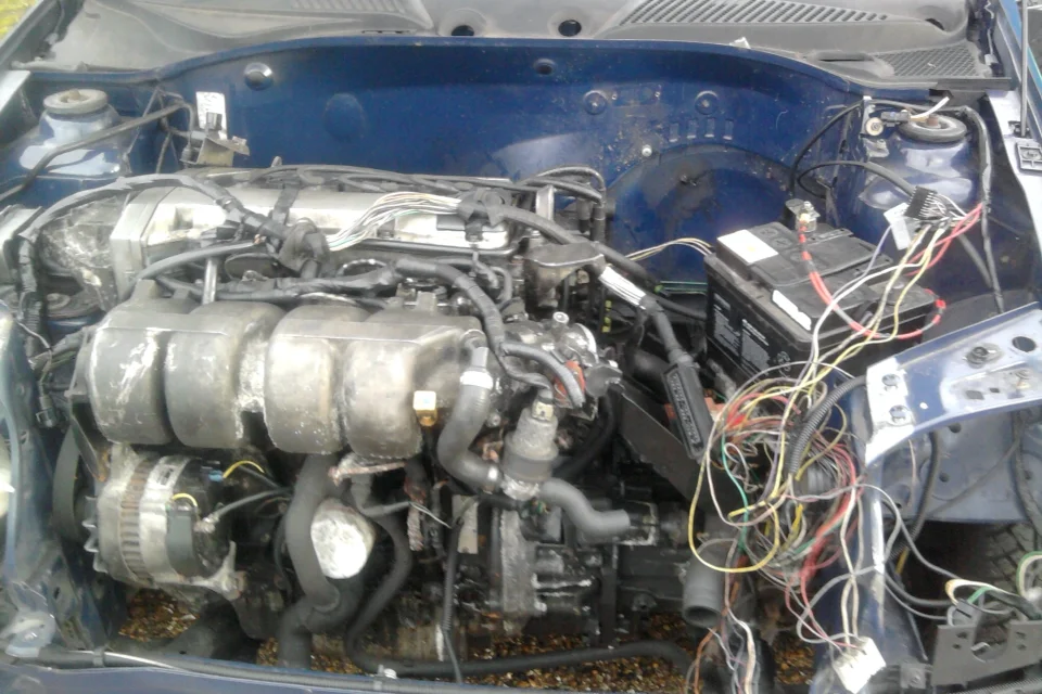

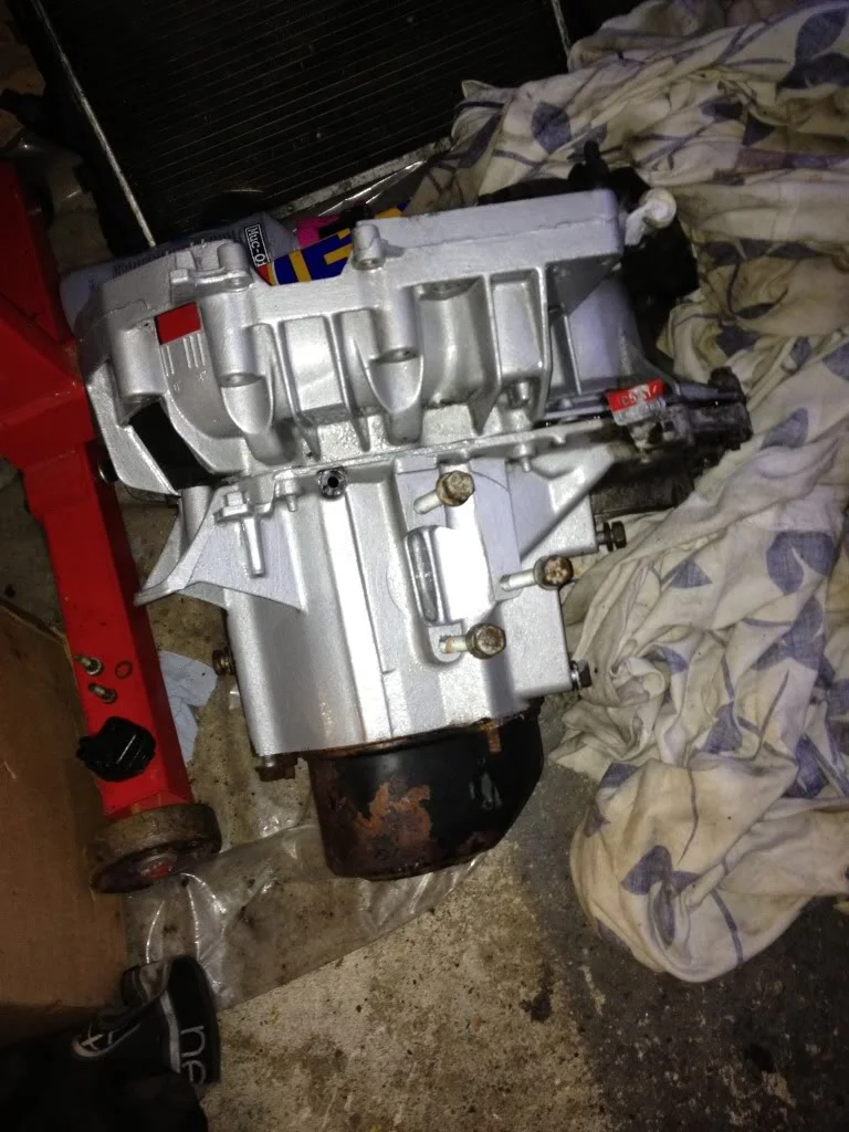

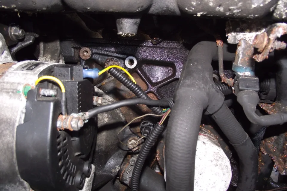

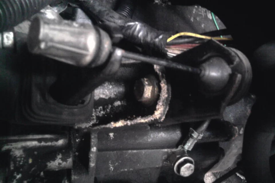

I then wanted to bring my attention to the engine as I want to clean it all up, paint a few things and do a cambelt and waterpump on it. I have been quite lucky to get hold of this engine as it has full Renault service history and has only done like 71,000 miles!
I started to strip and found that the more I stripped it the more I realized this engine is so original! It has had brackets that I have never seen before! But with original engines come troublesome bolts! After taking off a few of the mounts I got bored and my back started to hurt with working on the floor and bending down so I cleared up and called it a night. Struggler (aka Alex-clio) has said that I can borrow back my engine stand that he bought off me as he is currently not using it but trying to get hold of someone who is at Uni partying all the time is easier said than done! ;) That’s it for now.

I forgot to show some nice rubber I picked up for a nice cheap price. These will come in handy when it actually gets on track!

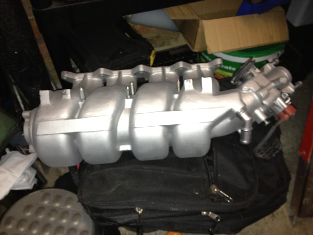

Wednesday 29[SUP]th[/SUP] February 2012
I started stripping down the engine for the parts that I wanted to sand blast and clean up just to freshen up the engine bay.
The Engine went from this:
To This:
To all these parts:
.gif
Thursday 1[SUP]st[/SUP] March 2012
Well after spending 2.5 hours in the sand blaster I got bored and called it a night as I was bloody hungry by this point. Anyway ill let the pictures do the talking. Eventually these items will be lacquered to prevent them oxidising and looking crap.
Not much more was done over the weekend as I had so many parts in my garage it was difficult to move and work in there. I did pick this up on Friday night Thanks Jay!
Saturday 3[SUP]rd[/SUP] March 2012
So I spent a few hours sat cleaning the garage and transferring the engine on to the engine stand I borrowed from Alex-clio aka Struggler. Thanks Mate!
Sunday 4[SUP]th[/SUP] March 2012
Did a bit more on Sunday and then decided to make some space so I went and transferred a load of parts down to my nans so that I could walk freely in the garage!
Got to love the company car so useful!

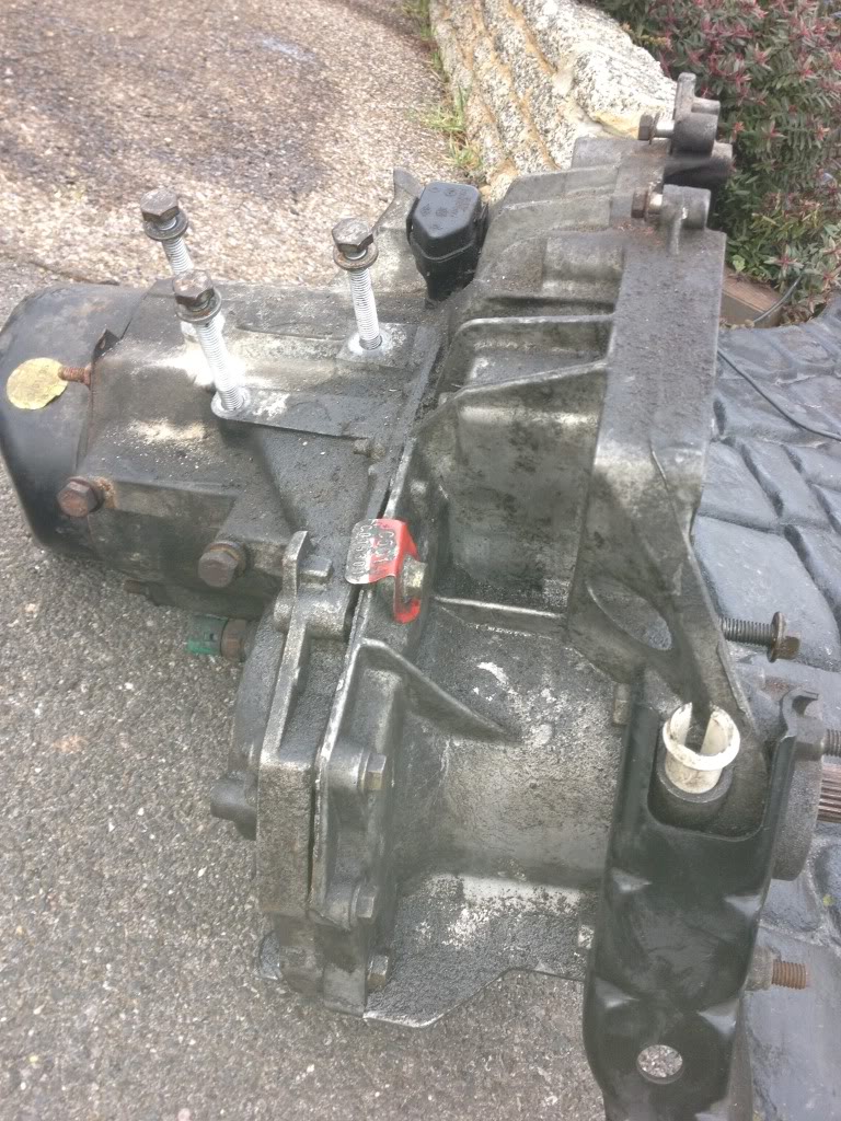

I did also give the gearbox a jet wash and remove most of the remaining parts of the engine!
Sneaky picture of the engine on the engine stand.

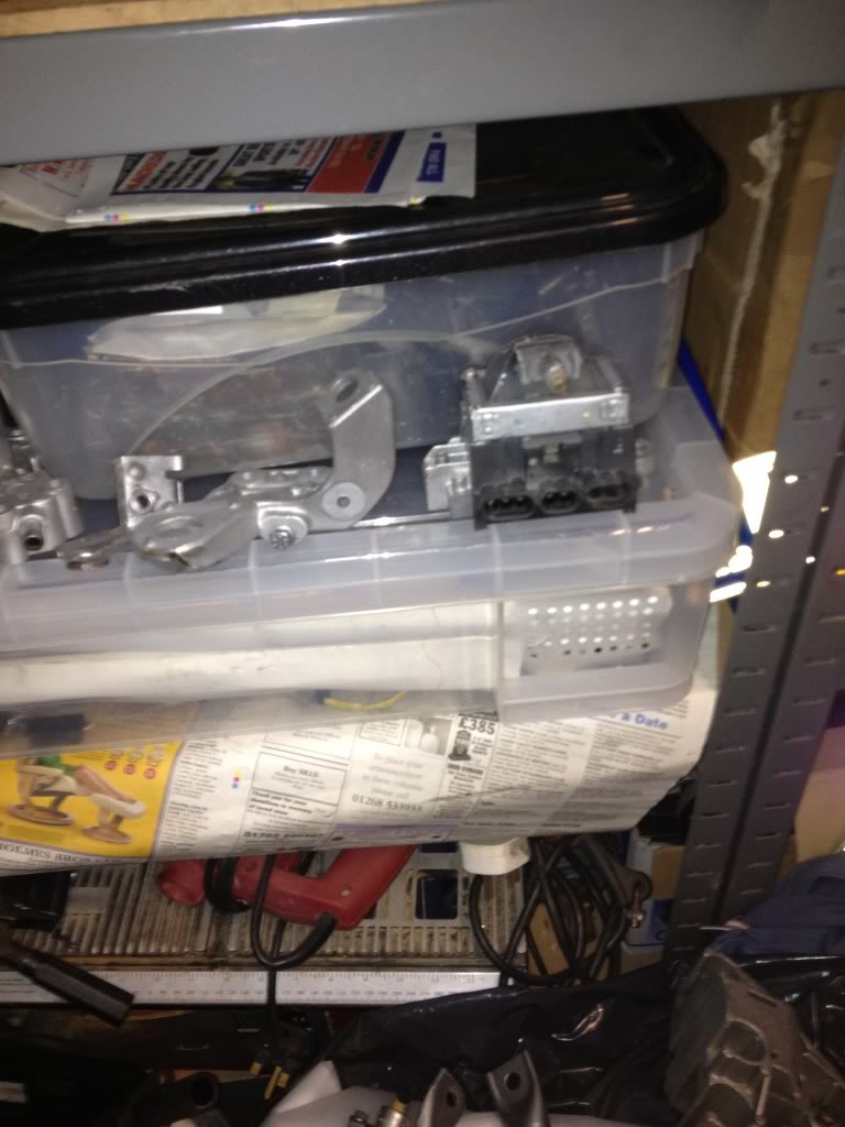

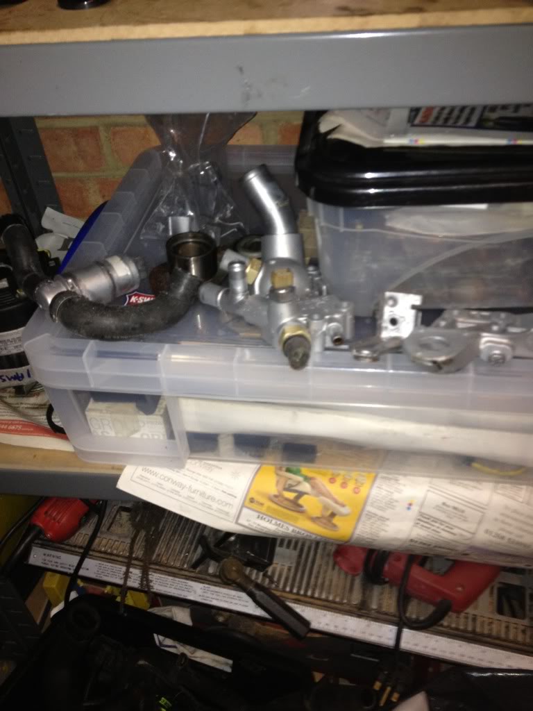

Parts Removed:

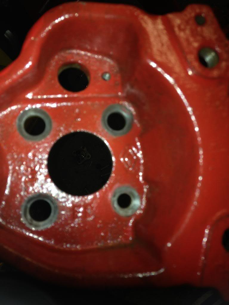

Did also spot this which I have never seen before any ideas?

Well after working away for a week in Bristol. The only good part of the trip was to see some old mates Ronee and Gaz!
I got back and thought I best start on the engine so out came the engine degreaser!
Then a quick lick of paint (im going to have to give it a few more coats to cover it properly! The red is a b*****d!!!
Then the gearbox got a lick of paint:

Well after doing his drum brakes I thought I would take the cover off the clio.
Well I had planned to be there for 5 minutes but turned out to be all day! Oops.

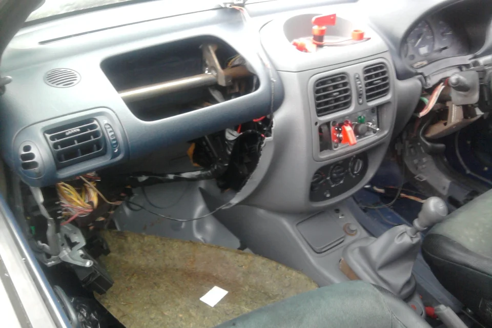

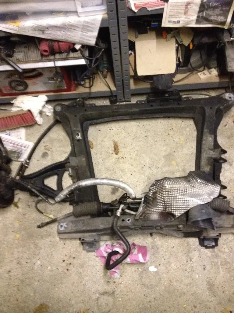

First of all I put the steering column in the correct place in the car as it would make it very difficult to move.
I then decided that I needed to get the F7P engine out (1.8 16v) so that I could 1. Put the F7R in once its complete and 2. Sell the F7P to free up some more cash for the project!
First of all I removed the front grill and the slam panel so that it would be easier access to remove the engine.
I then spent ages trying to remove the hub nuts so that the driveshafts can come out and then the engine to follow. 1 problem I brought limited tools with me as I didn’t expect to be working on the clio. The little f*****s would not budge even with a big bar on the end!
After a while I got the hump and decided to drop the subframe and the lot as I thought this would be the easiest thing to do.
Up on stands:
A Little while later after undoing all the necessary items draining the brake fluid, gearbox fluid I dropped the subframe with all the necessary bits.
I then removed all of the bits individually so that I can sell them on when I can be bothered to do a for sale thread.
Engine is planned to be out next weekend so that I can start tarting the engine bay up and running all of the necessary looms etc. More updates soon and hopefully my new eBay win will get collected soon!
