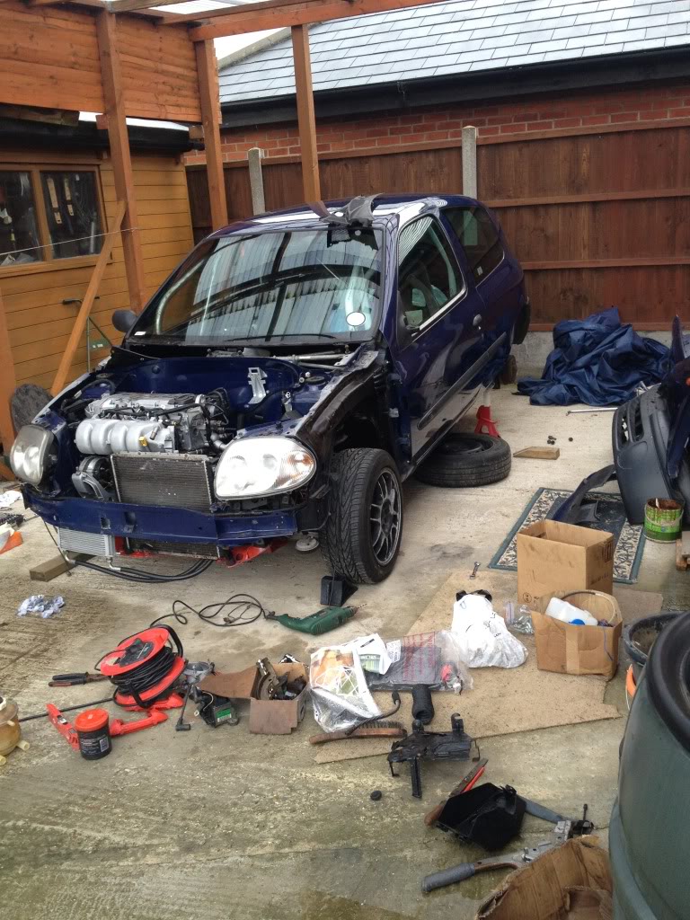

Friday 11th May 2012
First of all i decided to have a little clear out as the car was getting full up again and it was becoming a pain to work on as i had to keep removing everything and putting everything back. Whilst clearing out the car i found the F16 that goes over the HT Leads. So i did the old mod of putting in two of the white screw clips from the body (interior) into the HT lead tray so that i could use screws instead of those crappy things Renault use.

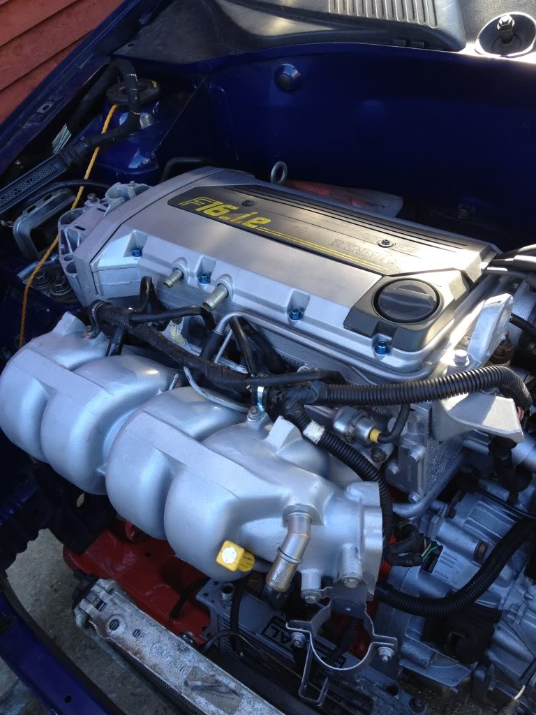

I then got the engine loom and connected it up to the engine so that it was already in place to be connected up to the main loom as and when required.
I had also remembered to bring some Moly grease down with me so that i could fill the steering rack gaiters and cable tie them in place.
I had stupidly forgot to bring some cutters with me and could not be bothered to try and find some in my granddads shed so they were left as they are.

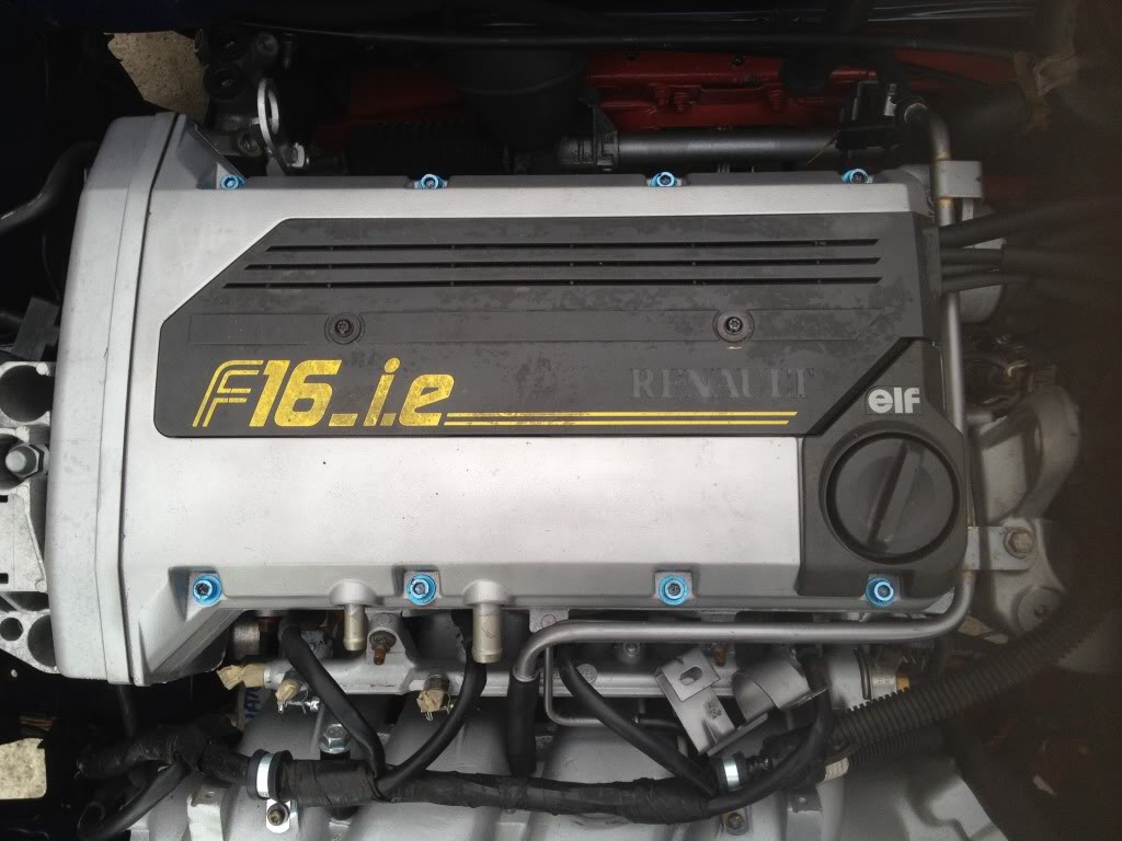

I then put the starter motor in place and all of the wiring was already connected up so hopefully it would not need to come off again. Also i need the heatshield in place later on for when i finally get around to mocking up the 172 manifold.
My non water cooled bits finally turned up! The reason i wanted this is so that i can mount my mocal straight to the engine block and i can also use the less complicated water hoses so everything is as simple as possible.

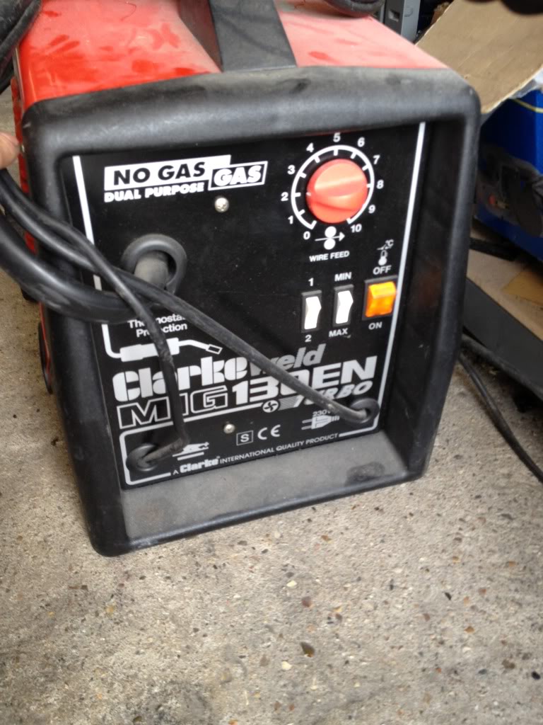

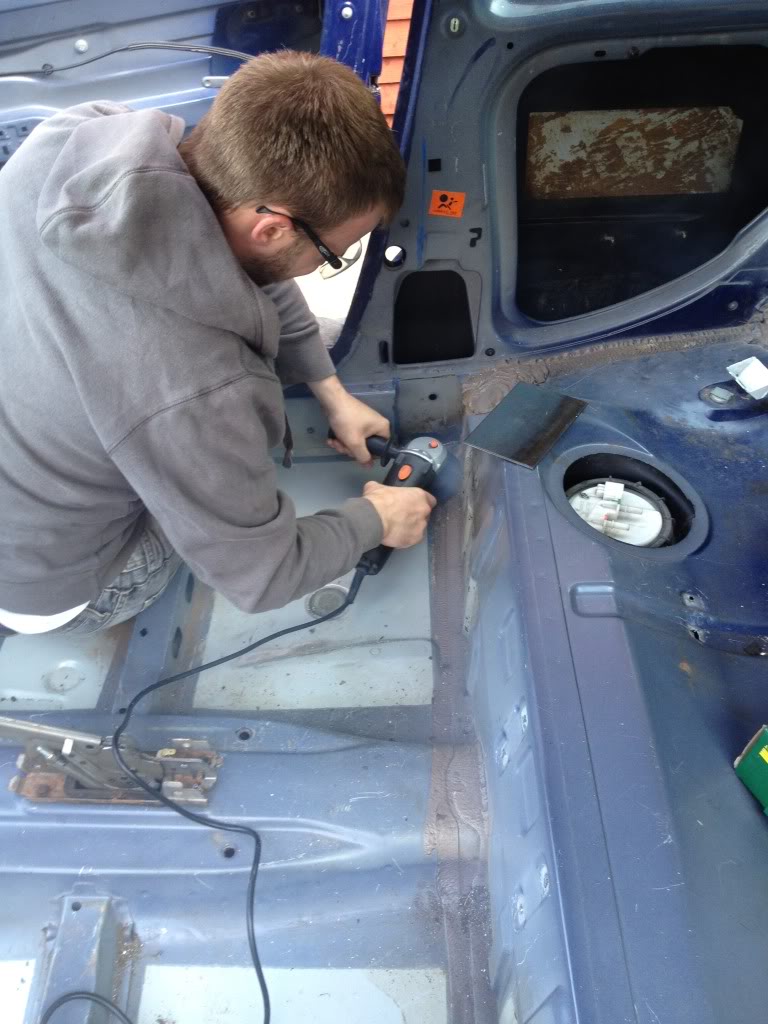

Went round to my mates house to pick up the welder my mate shall be using to weld the cage and the strength back into the structural parts. We are going to use this one as my mates one at his house is a bit on the big side so ideally just to make things easier we are going to use a portable one.
Then i got home and grabbed hold of the new angle grinder as the last one decided to blow up! This is before shot.

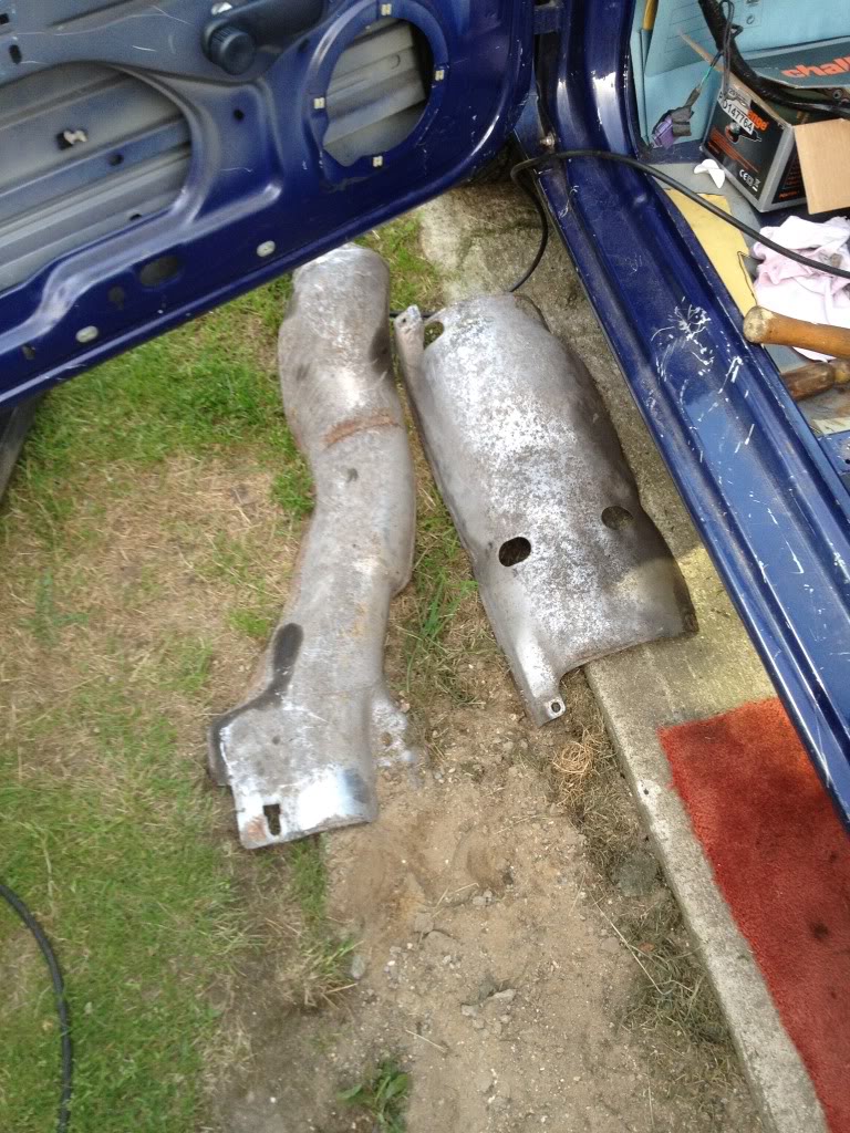

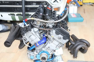

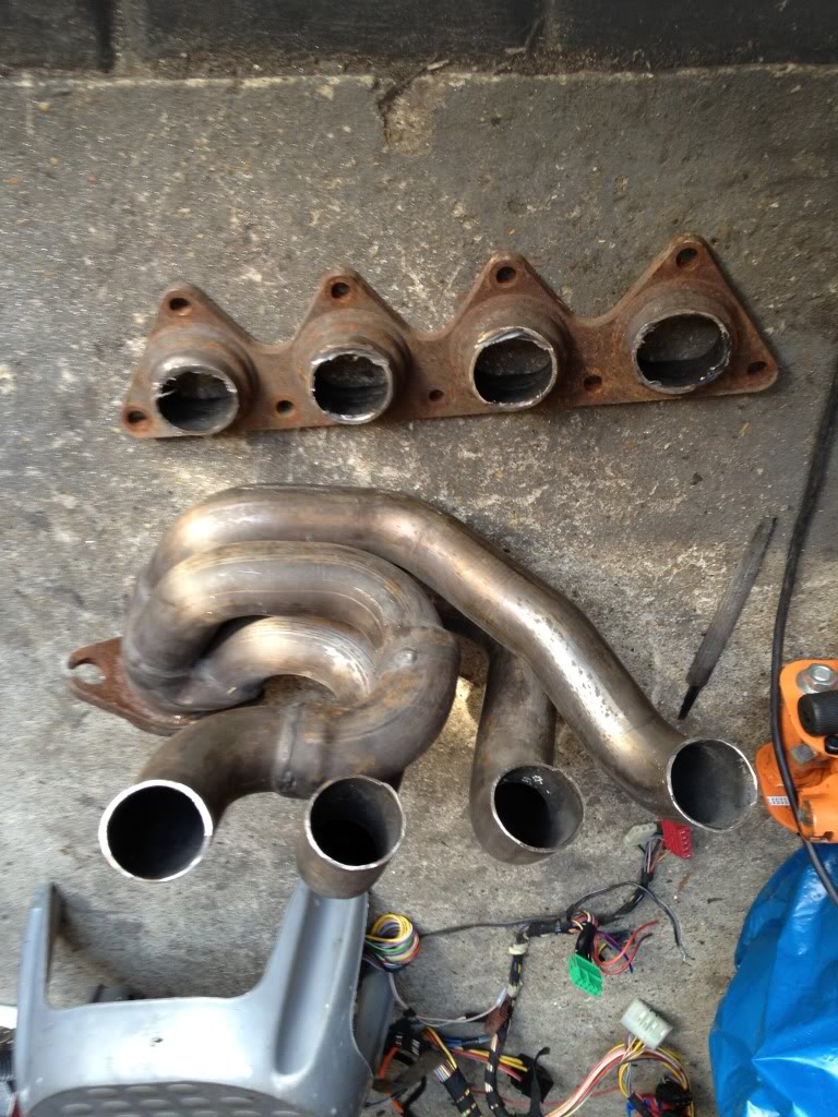

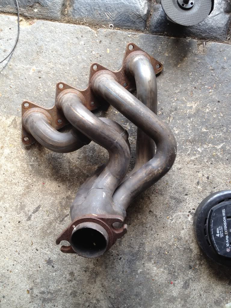

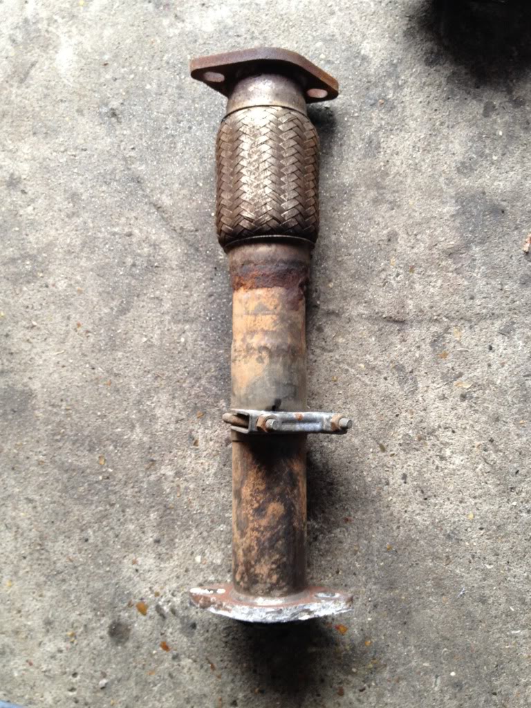

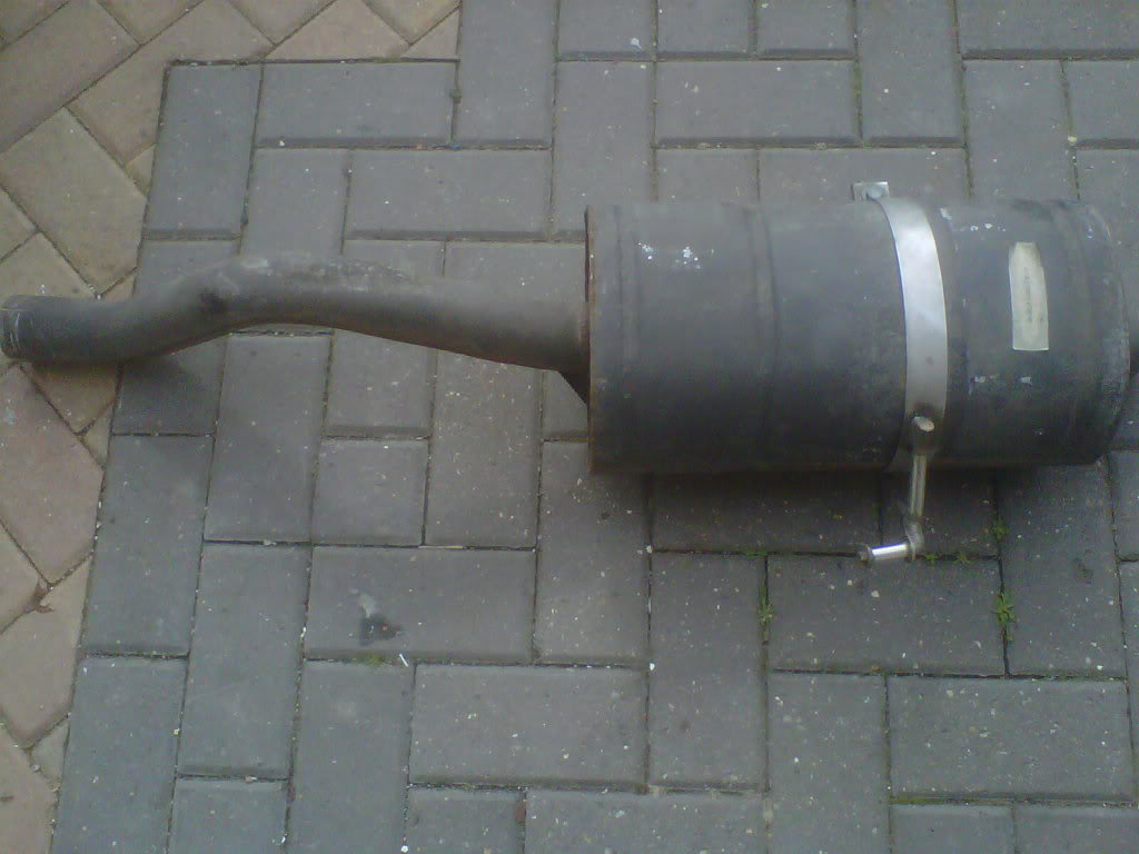

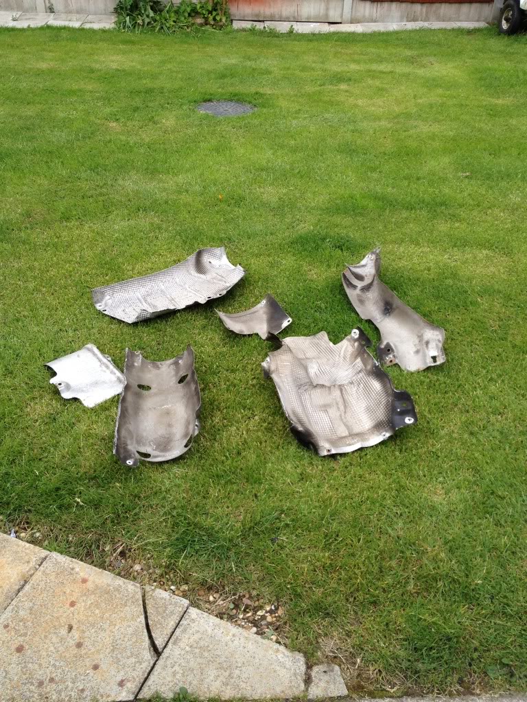

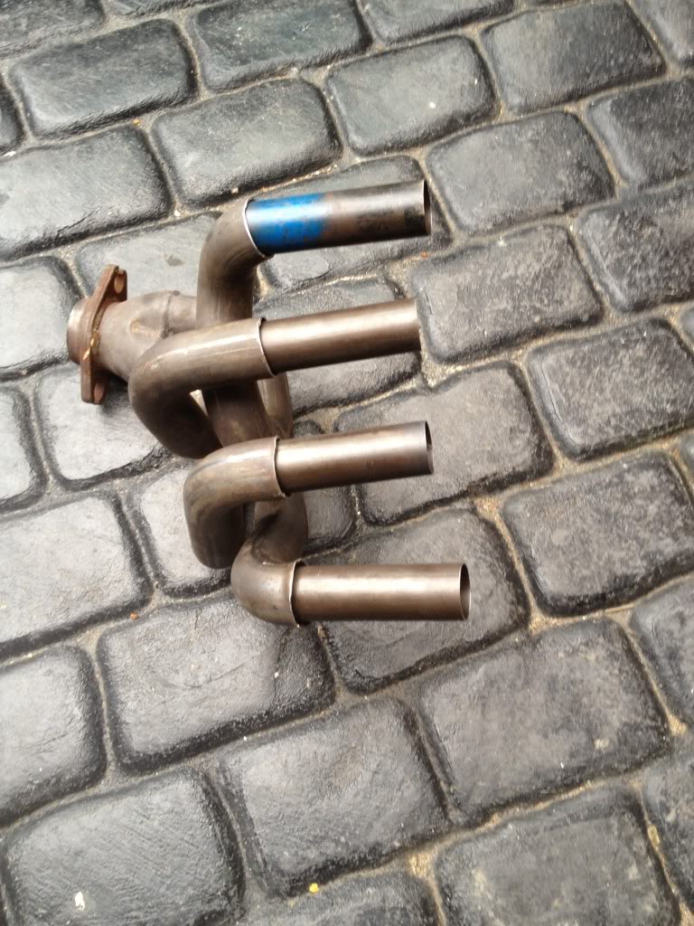

This is the manifold i am planning to use on the f7r. One problem its not designed for the F7R. The flange is not correct for the head so that is going to have to be chopped off and a new one fabricated. Also the manifold fouls against the starter motor so the pipes leading to the head shall need to be extended to miss the starter motor but not to far so that it hits the bulkhead. I know this is a lot of pissing about but i feel that this manifold will really help the F7R get a little bit more power.
This was the after shot with a little bit of help from the hacksaw with the bits that i couldn’t get into with the grinder.
It was very surprising how thick this manifold is. Its approximately 0.090” (2.3mm) thick, so for the pipes to extend it they are going to have to be around 13SWG (Standard Wire Gauge). With any luck i will be able to have a few off cuts from work but as its 13SWG im not going to hold my breathe as this is not a common size we manufacture with. If not worst comes to the work ill jump on the lathe and bore out some solid to the size i require.

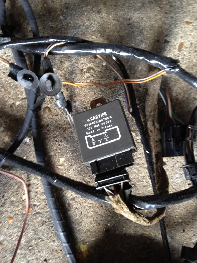

This was removed from a MK1 phase 1. Its part of the interior loom. _PAUL_ kindly let me pinch this out of his PH1 just before it went to the scrappers ;) This is the loom i am going to use to get the car working and then i can chuck my chopped down one to see if it works. If my one fails this one shall get the snip once its all running. Anyway back to the question this was removed from the offside rear quarter. It was earthed against the chassis does anyone know what it is?

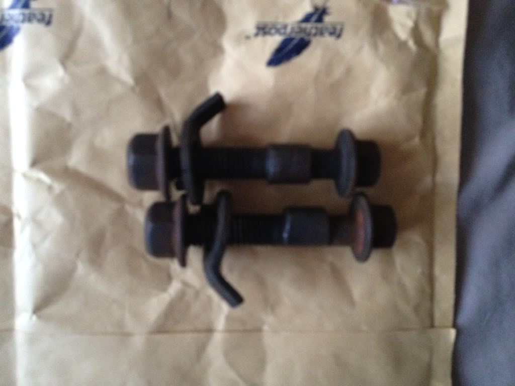

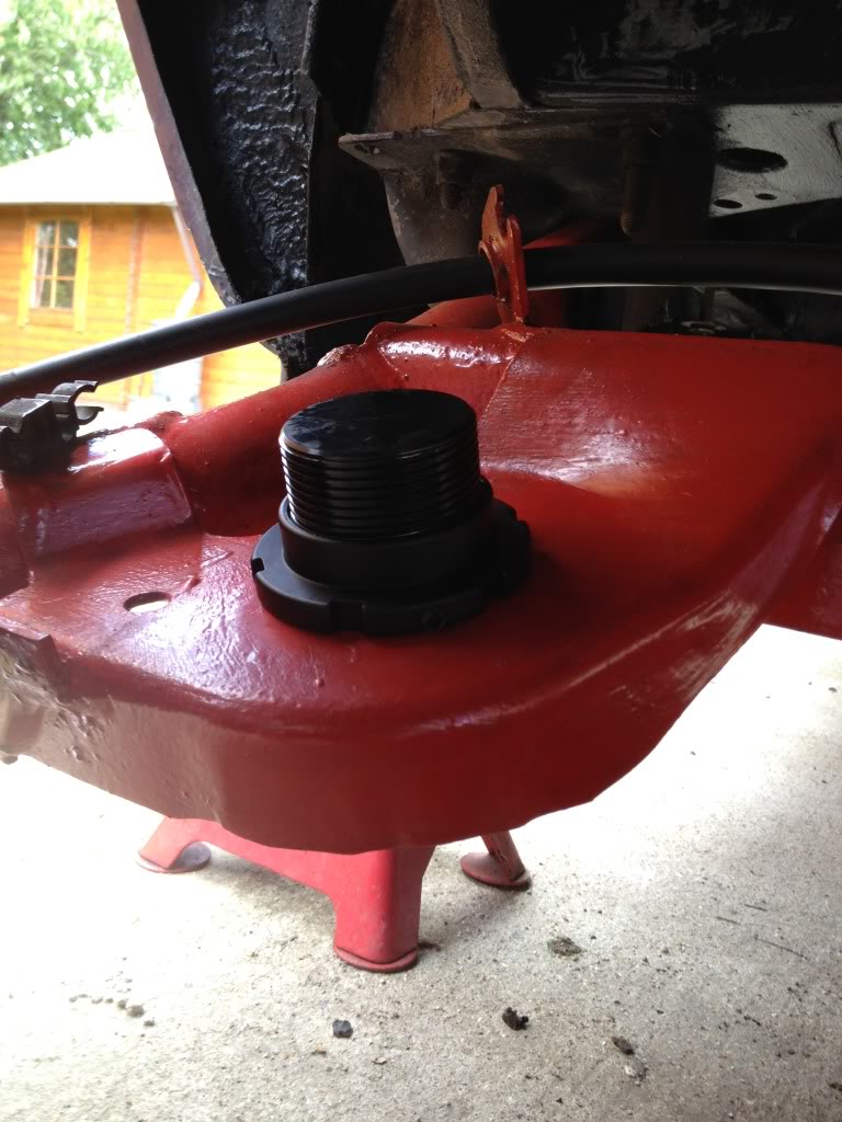

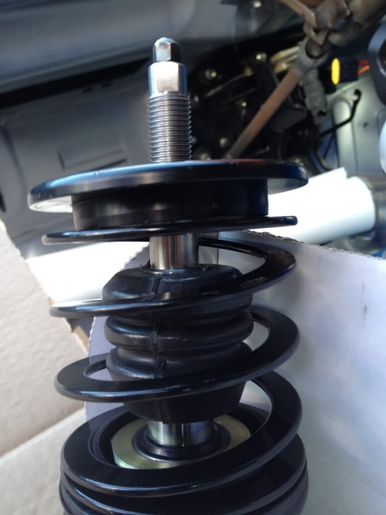

Camber bolts turned up today thank you very much Adamio.

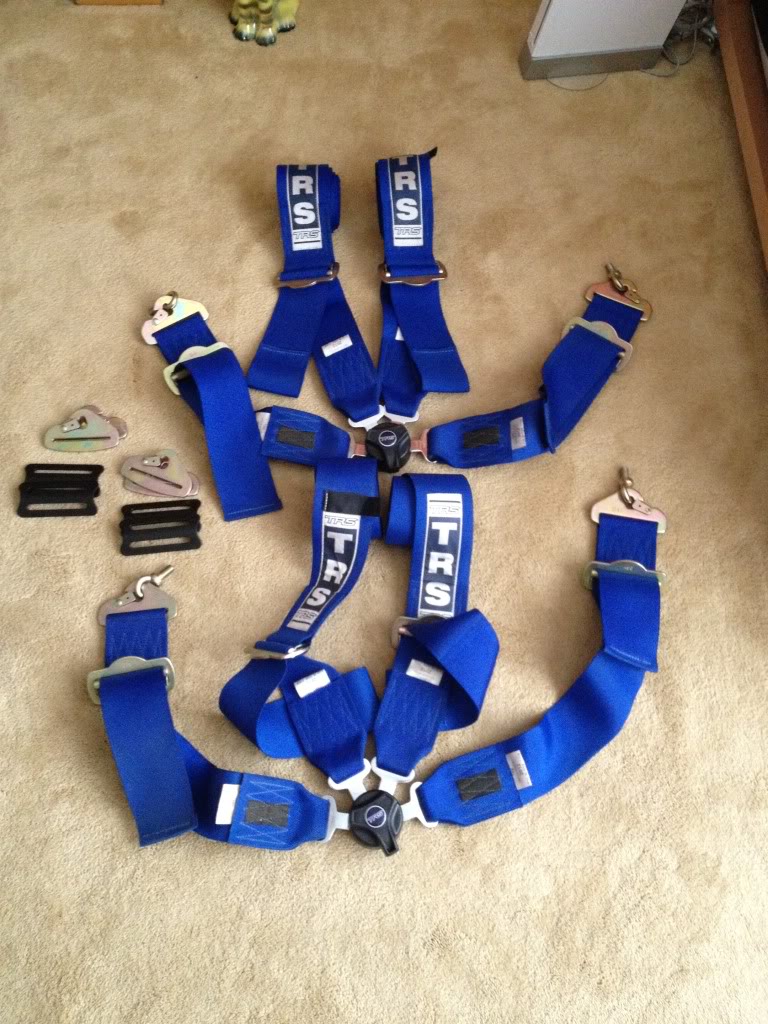

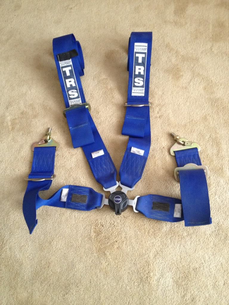

Managed to pick these beauty’s up off of ebay. I guy in Colchester was selling them. I emailed him and asked how much to end the auction early as the ones i was bidding on ebay i kept loosing!
They are 3” 4 point TRS harnesses with the option of adding a 5[SUP]th[/SUP] and 6[SUP]th[/SUP] point. They were a bit dusty when i got them but they do clean up nicely. Also not that it matters to me but they are still in date until the end of the year. Also they have only been used half a dozen times.

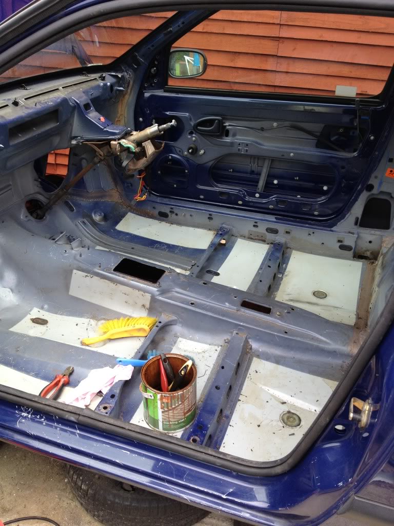

Managed to dedicate a whole day to working on the car so i was quite pleased that i could once again get stuck in!

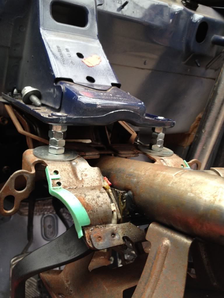

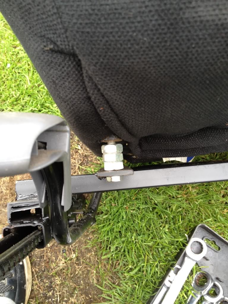

The first thing that i tackled was the height of the drivers seat on the runners. IMO i was to high up and i was worried that when wearing a lid my head may hit the cage. First of all i removed those silly plastic cups that the seats bolt into. I then flipped the seat over to find this.
Easily another inch in height i can come down if i take these off.
So i undone the bolts and removed the nuts. I then chopped the thread of the bolt down by the thickness of the three nuts to ensure that it did not bottom out on the bottom of the seat base.
I then had to bore out the holes on the base as the previous owner who had sone this hadn’t lined them up exactly right. I don’t this then refitted the bolts. Finished article below. Much better.

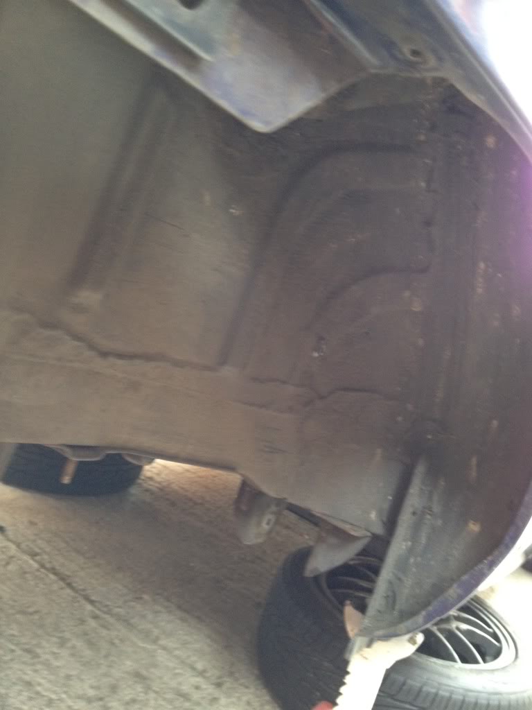

Next was the tar residue. I had done the hard work of removing the tar but not removing the horrible residue. I then brushed on some white spirit, let it soak in then mopped it up with a cloth. This was the before shot,
And after, much better

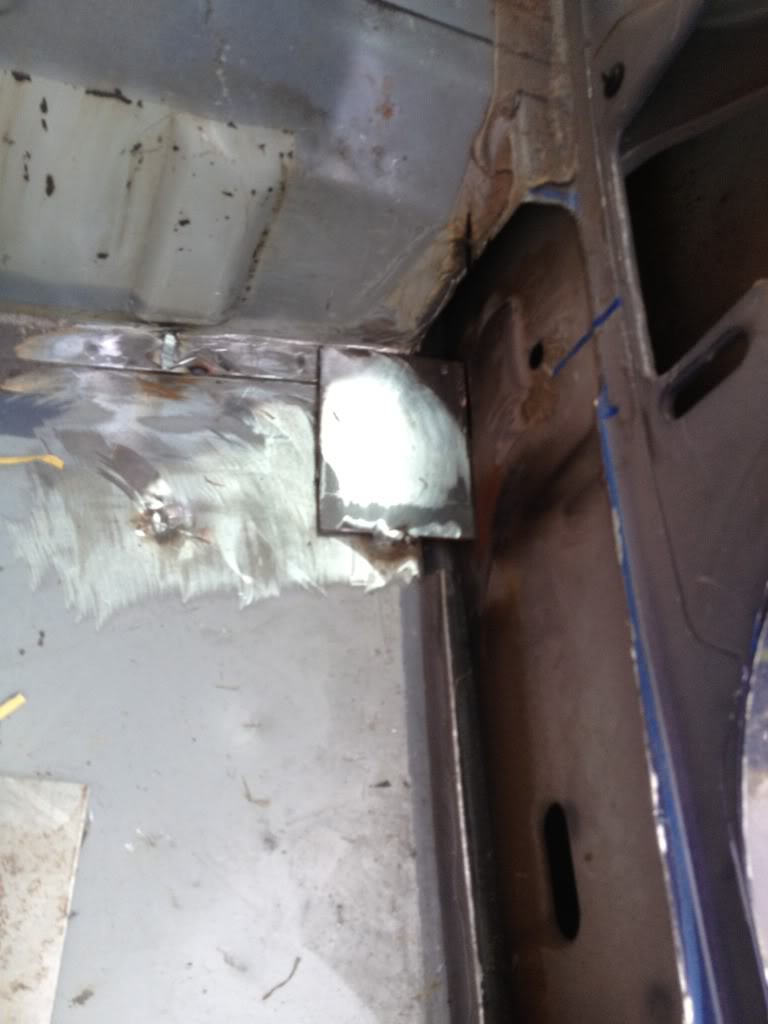

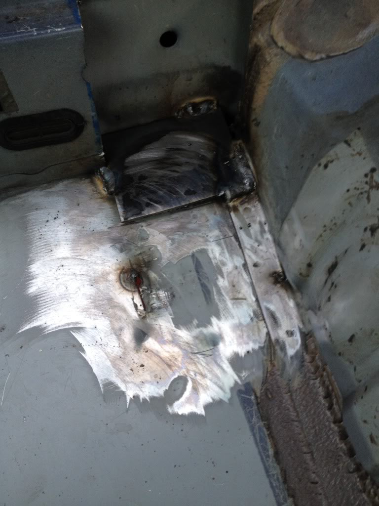

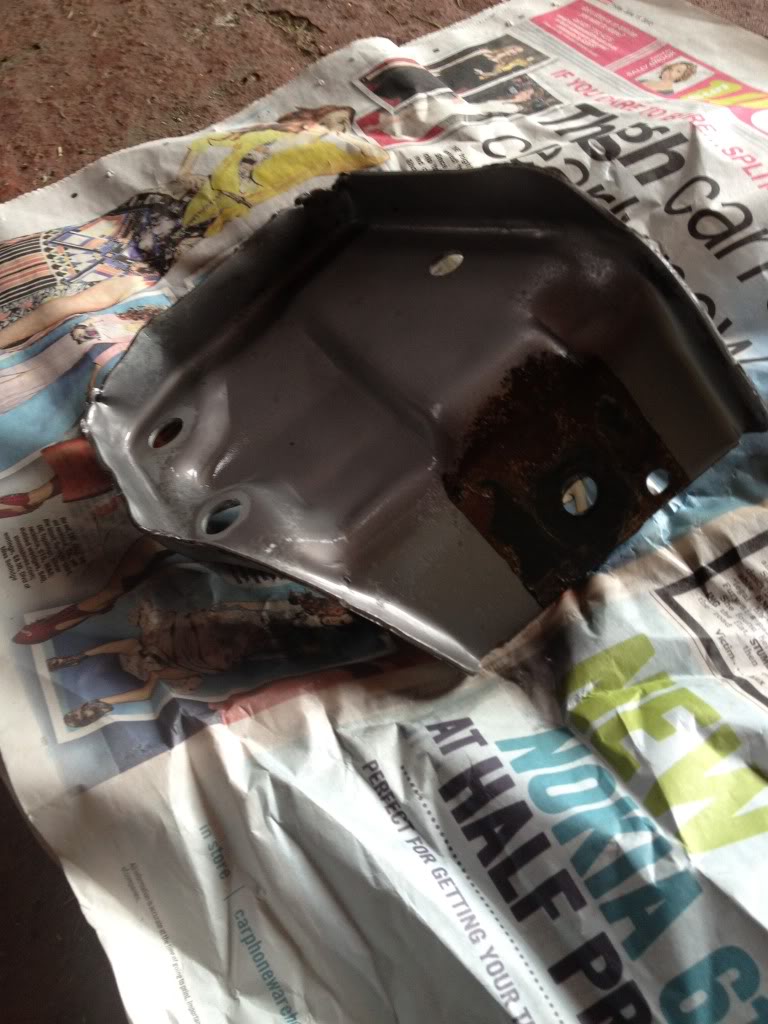

I then decided to remove the extra brackets that i did not require, more hassle than its worth and really wish i hadn’t of touched it as i now have a few small holes that i have to patch up, I did remove more than just these brackets but i forgot to take pictures of them.

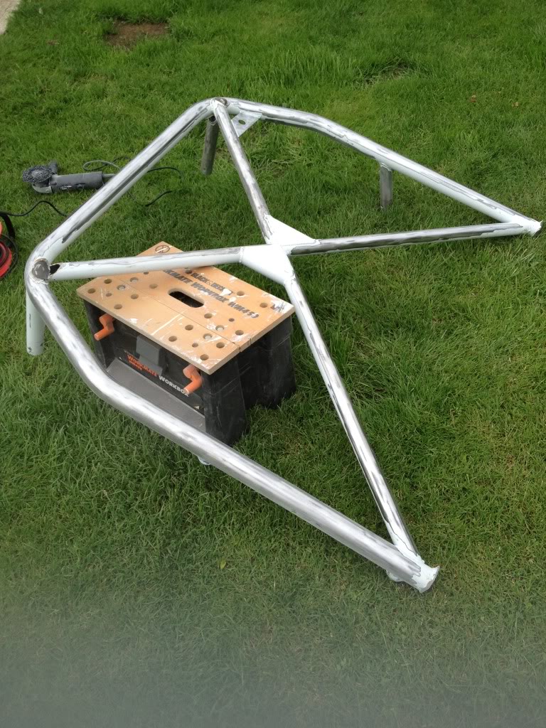

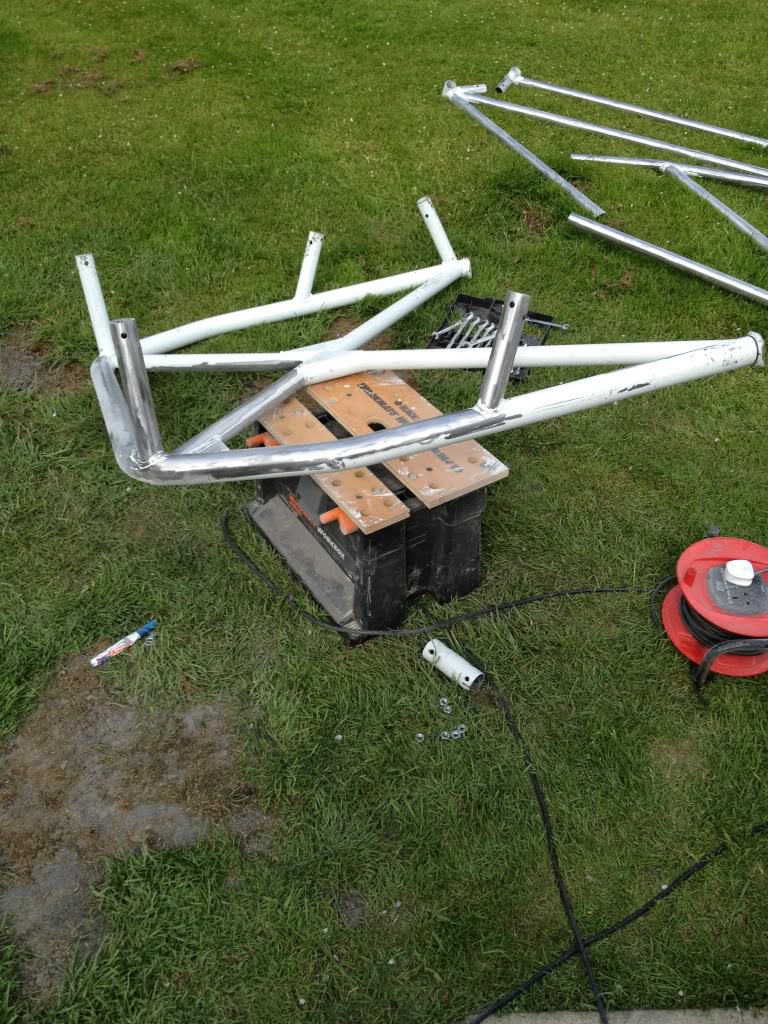

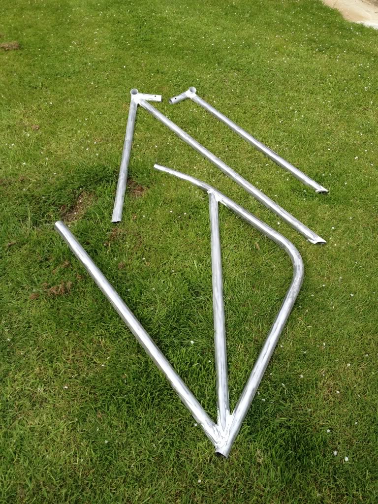

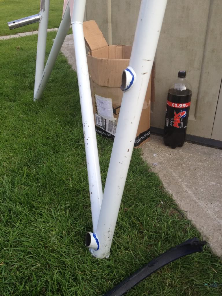

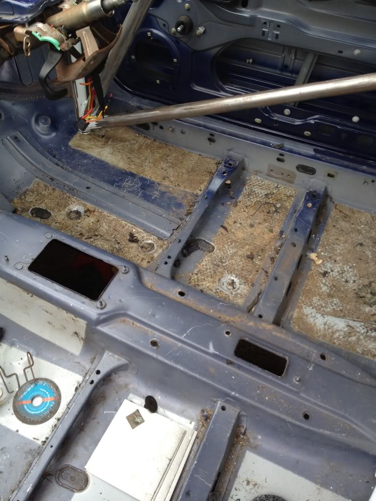

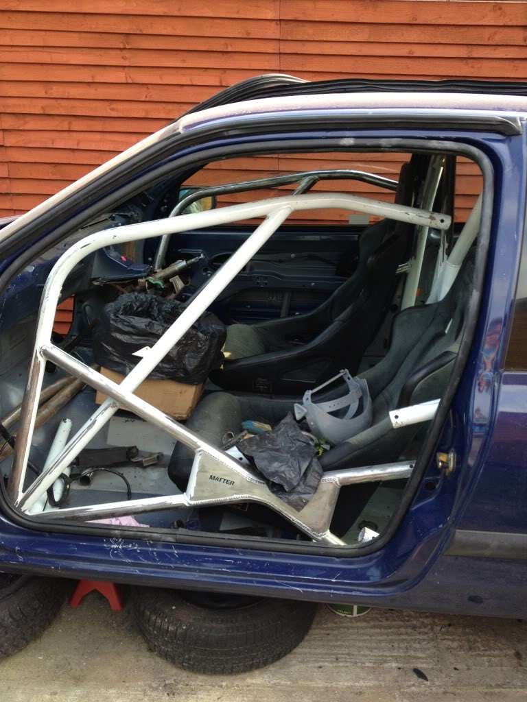

The final task of the day was to remove as much paint as possible from the roll cage in preparation for welding it al together. I know that now i have removed the coating they shall oxidise slightly but i am not to worried as some fine wet and dry shall cure that.
Anyway the pics...
Before
After
Halfway through and then my granddad grinder started making a high pitched squealing so i thought i would call it a day. Plus the fact i had a nice headache at this point.

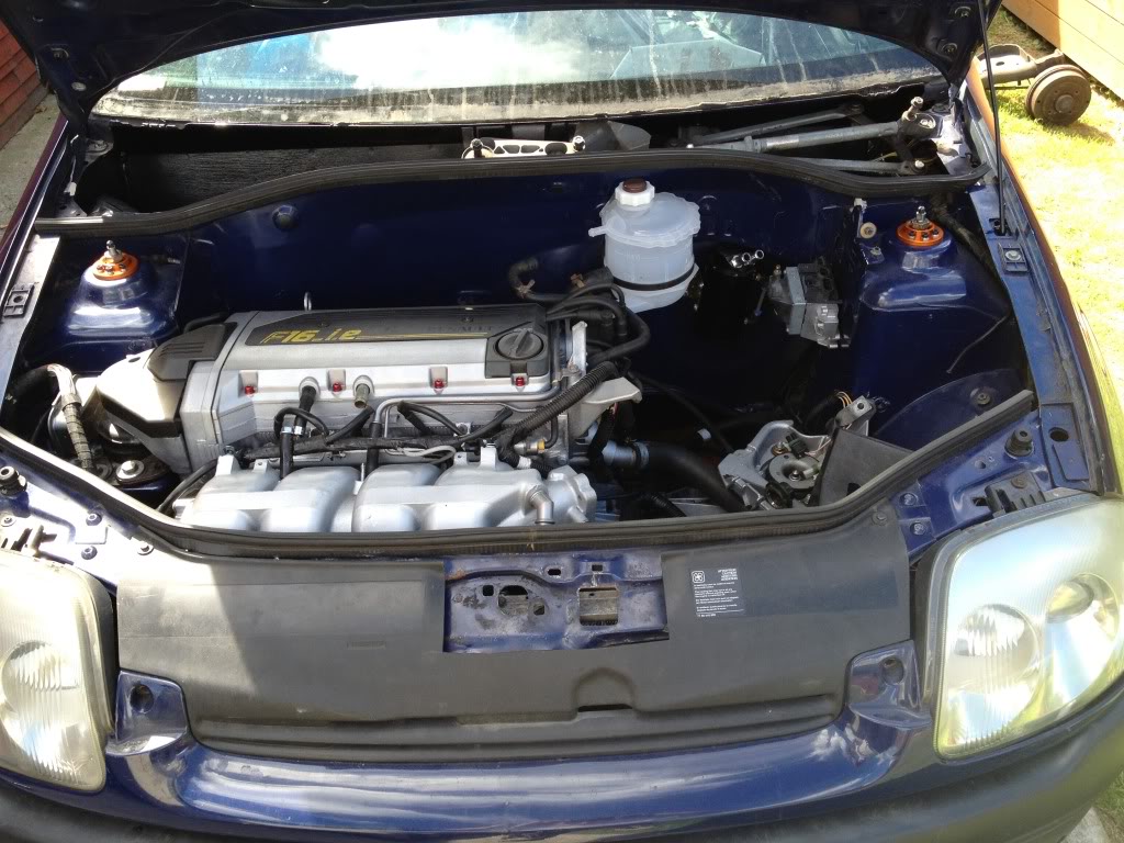

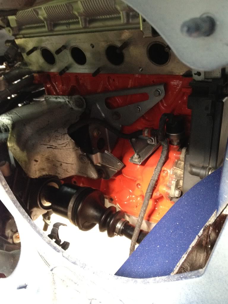

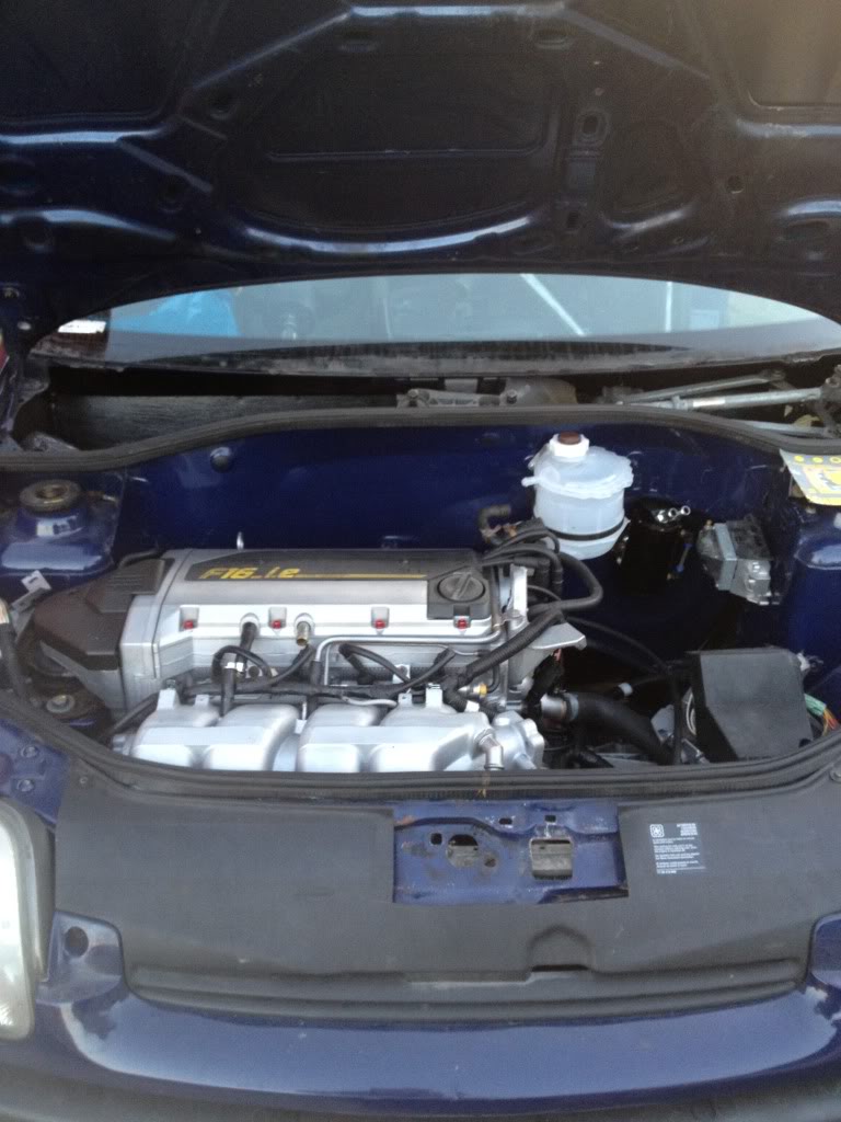

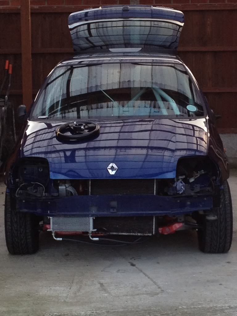

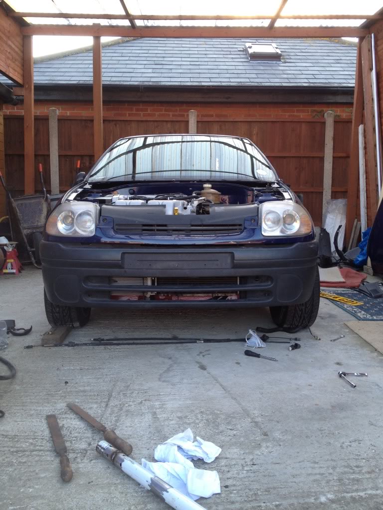

A quick snap of everything back in place (with the door rubbers now on as i was fed up with hitting my head on the inner door).

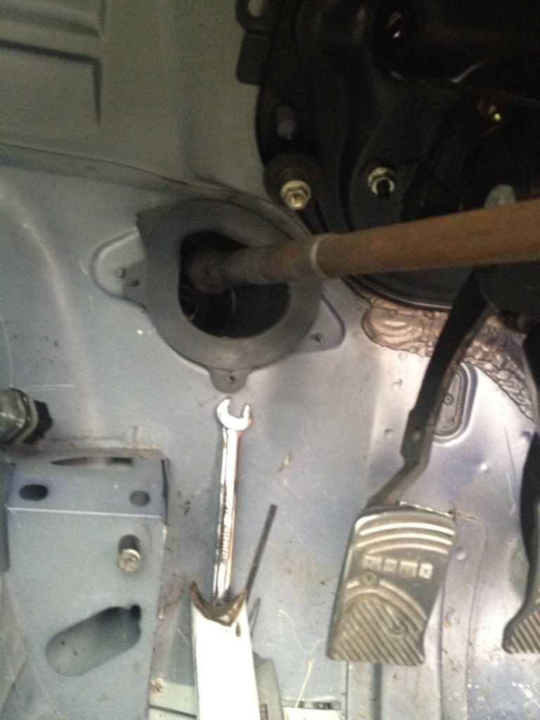

Sneaky snap shot of the back of the engine through the pedal box hole.

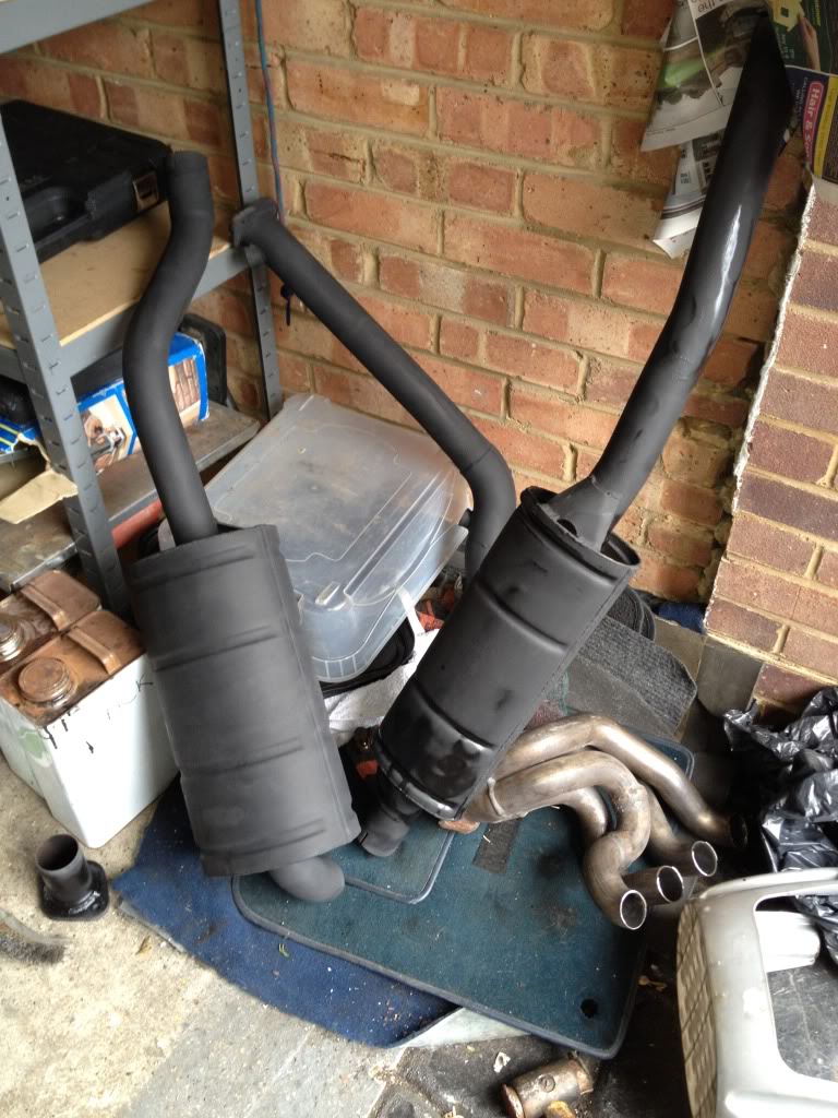

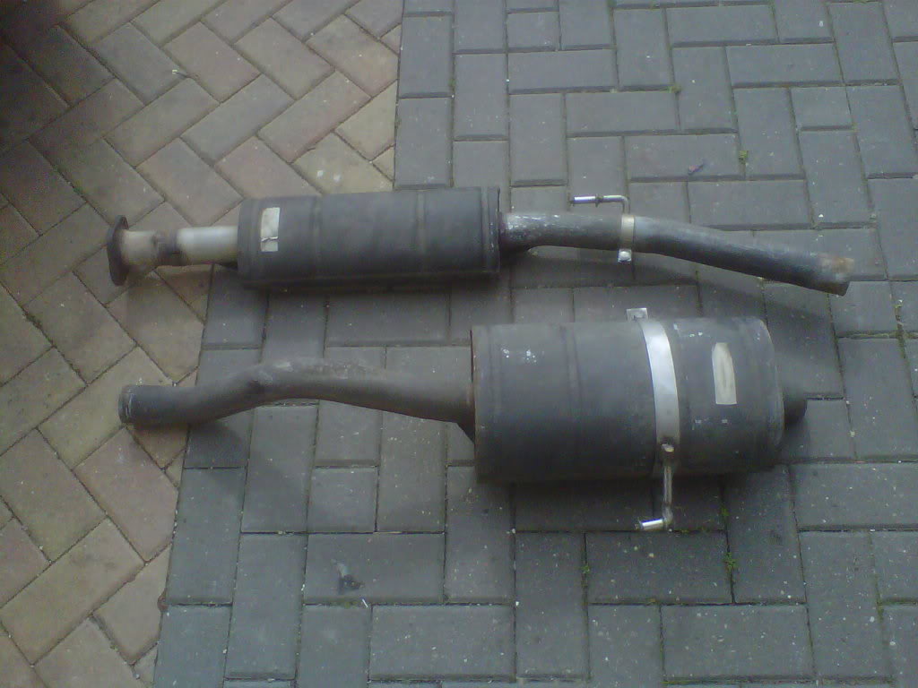

Also maybe selling this adjustable, flexi decat but probably will not be up for sale until i have done the 172 manifold and that works all ok.

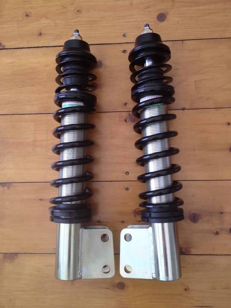

Coilovers

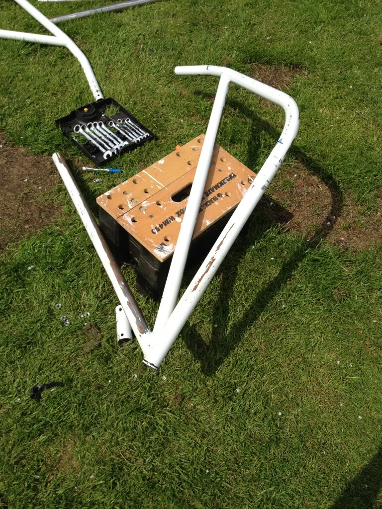

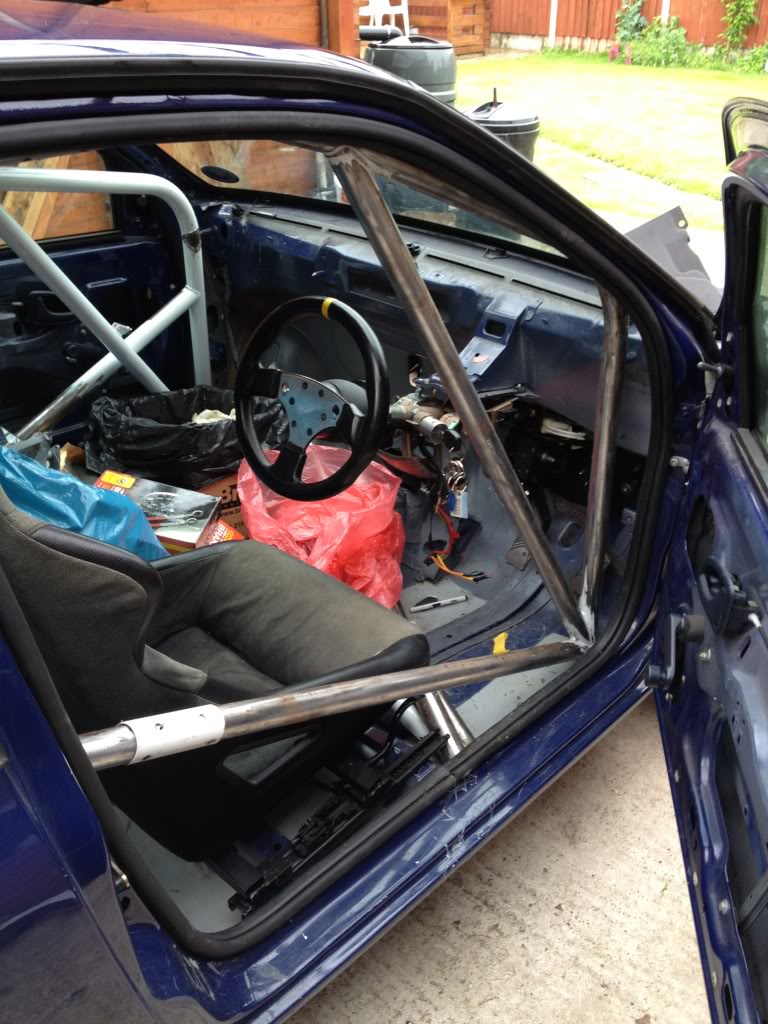

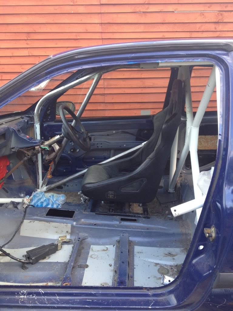

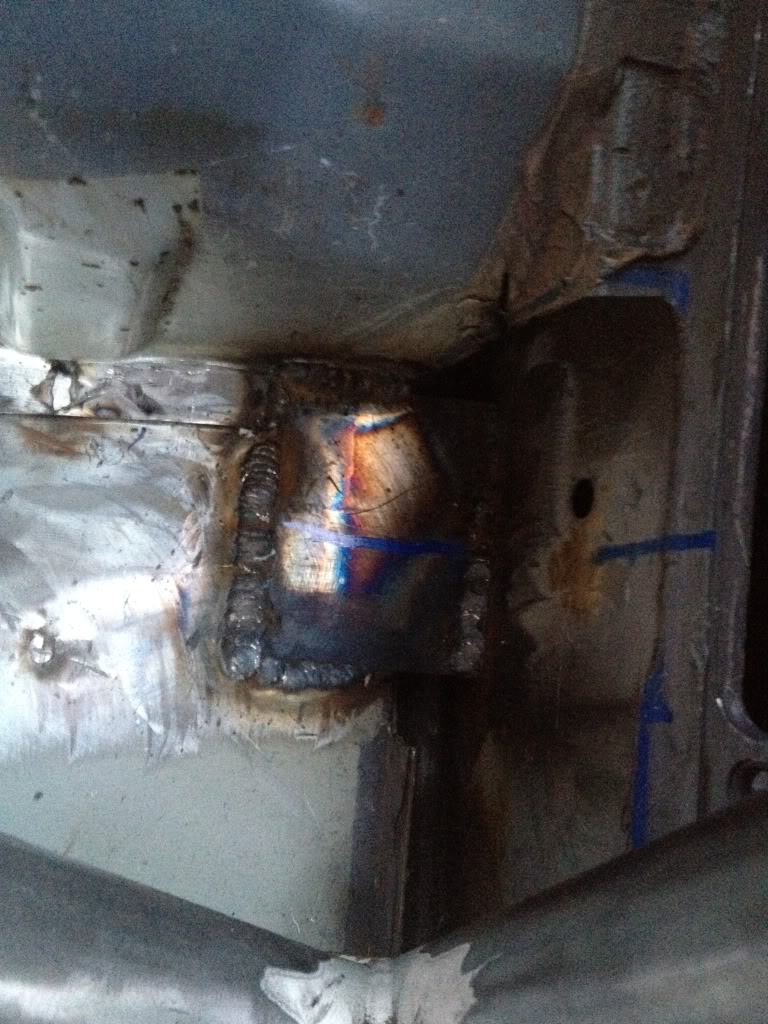

Anyway with the roll cage in place Luke and i mocked up the passenger side of the cage to see how much modification is needed to make it fit. The answer was quite a bit so we cut the cross bars off of the passenger side of the cage. I have some spare tubing that i have cut of the cage which is the same wall thickness and diameter so i am going to using this and profile some new tube.
Just after this is when the angle grinder decided to die. So out came the hacksaw this lasted about 2 minutes before i gave up using that as 1 the blade was fucked and 2 it was wayyyyyy to hoooooot.

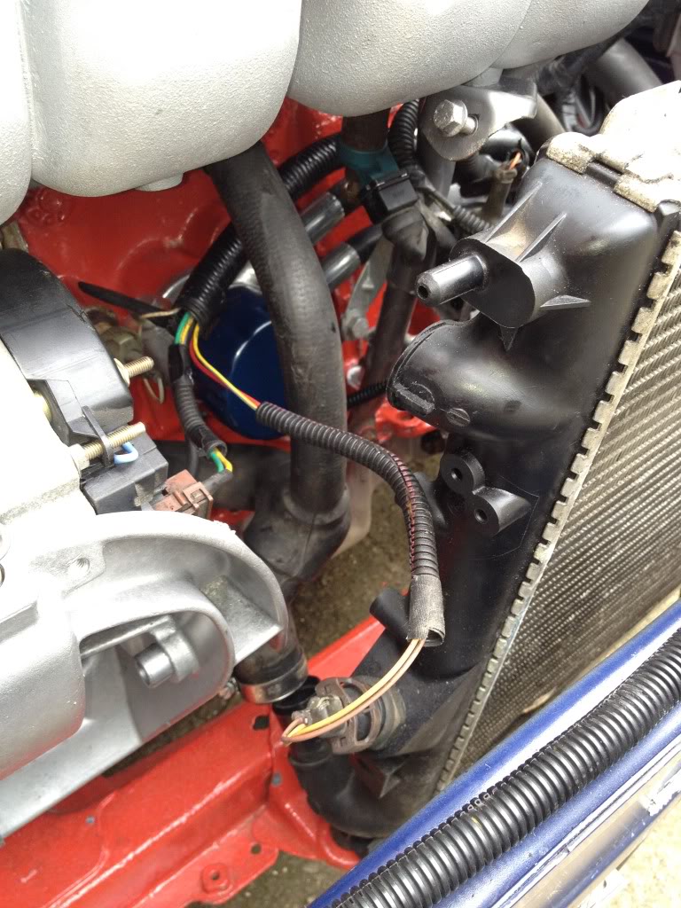

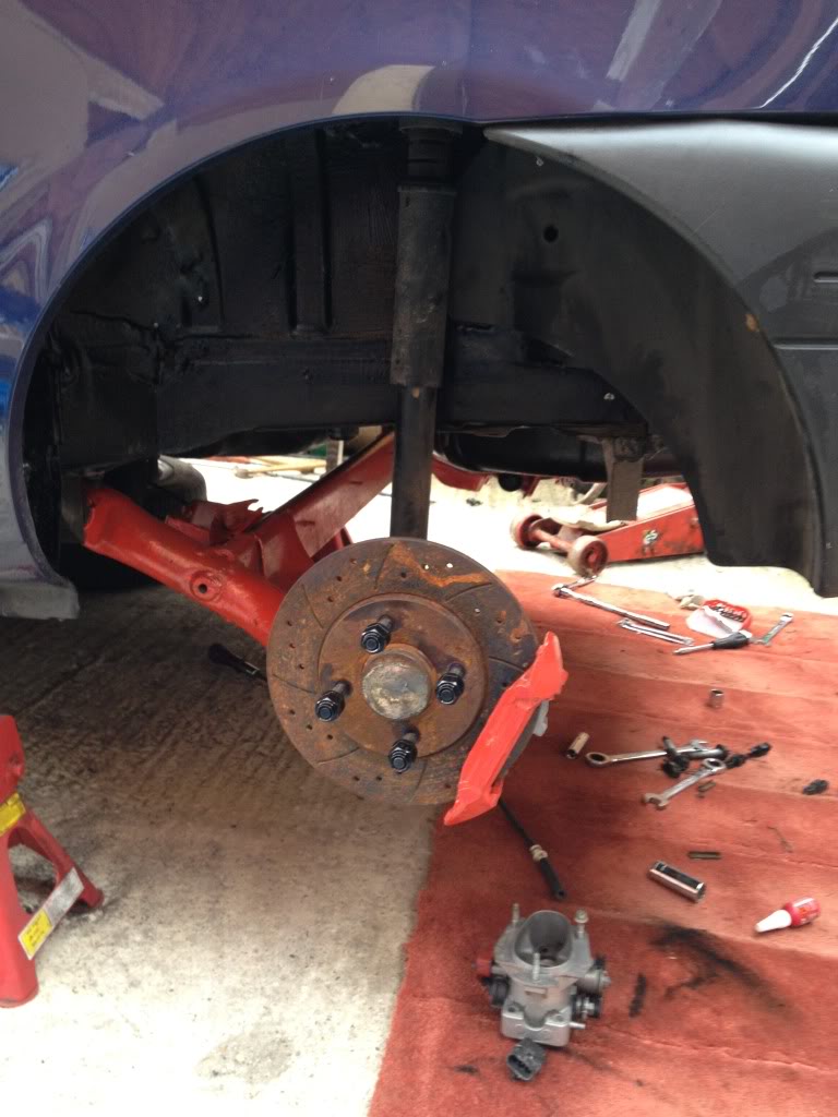

I decided to do some work on other parts of the car. This was a tad difficult as i had limited tools and all of the stuff was sprawled out in the shed which i couldn’t be bothered to go through lol.

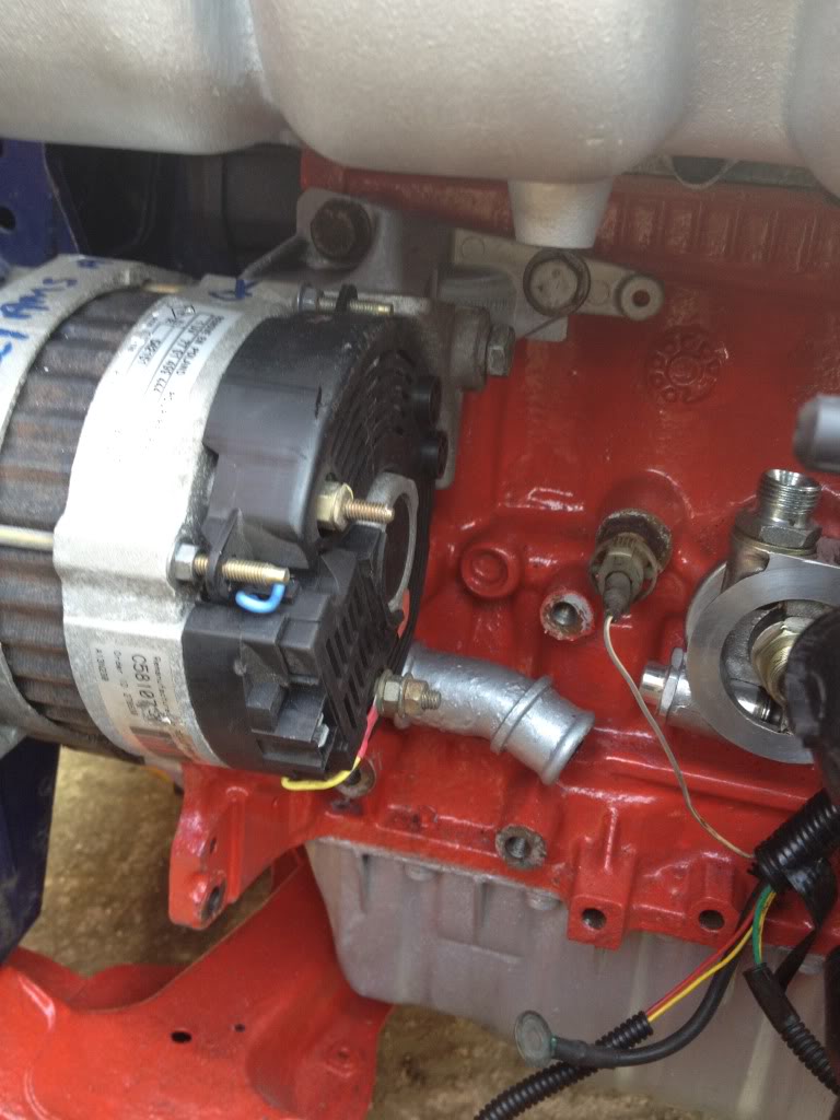

So i put the top alternator bracket that the alternator mounts to onto the engine and put the alternator in its dummy position.
Ended up calling it a night as it was hot and all i wanted to do was go home have a shower andhave a nice cold beer.

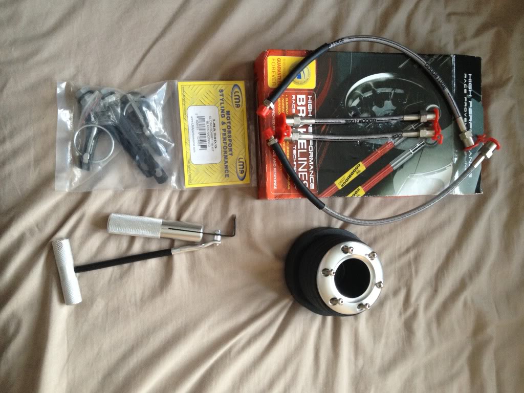

Got home to find some goodies had turned up!
PH2 Steering wheel boss and new Goodridge Braided Brake Lines. (Thanks Djw John).
Bonded Window Screen Removal Tool and some Anodised Black Bonnet Pins.

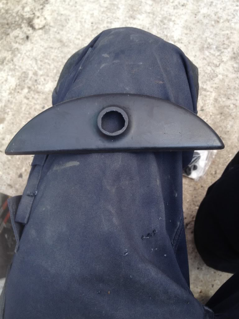

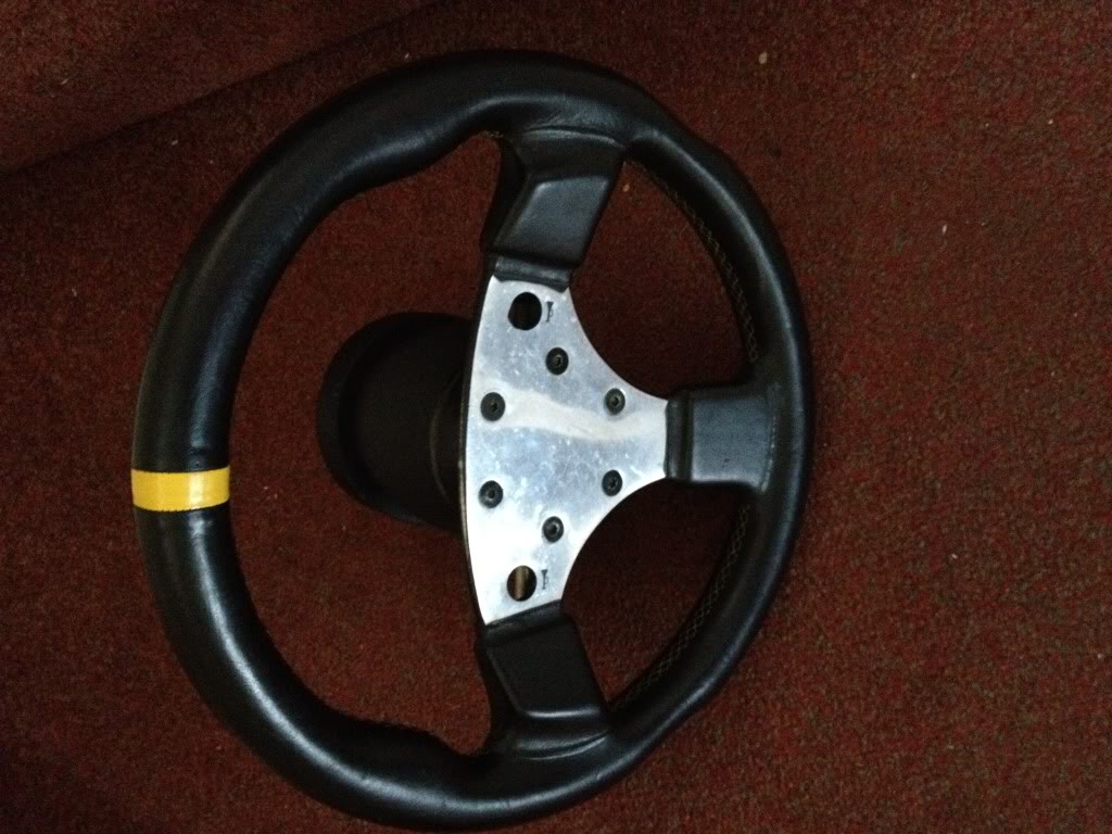

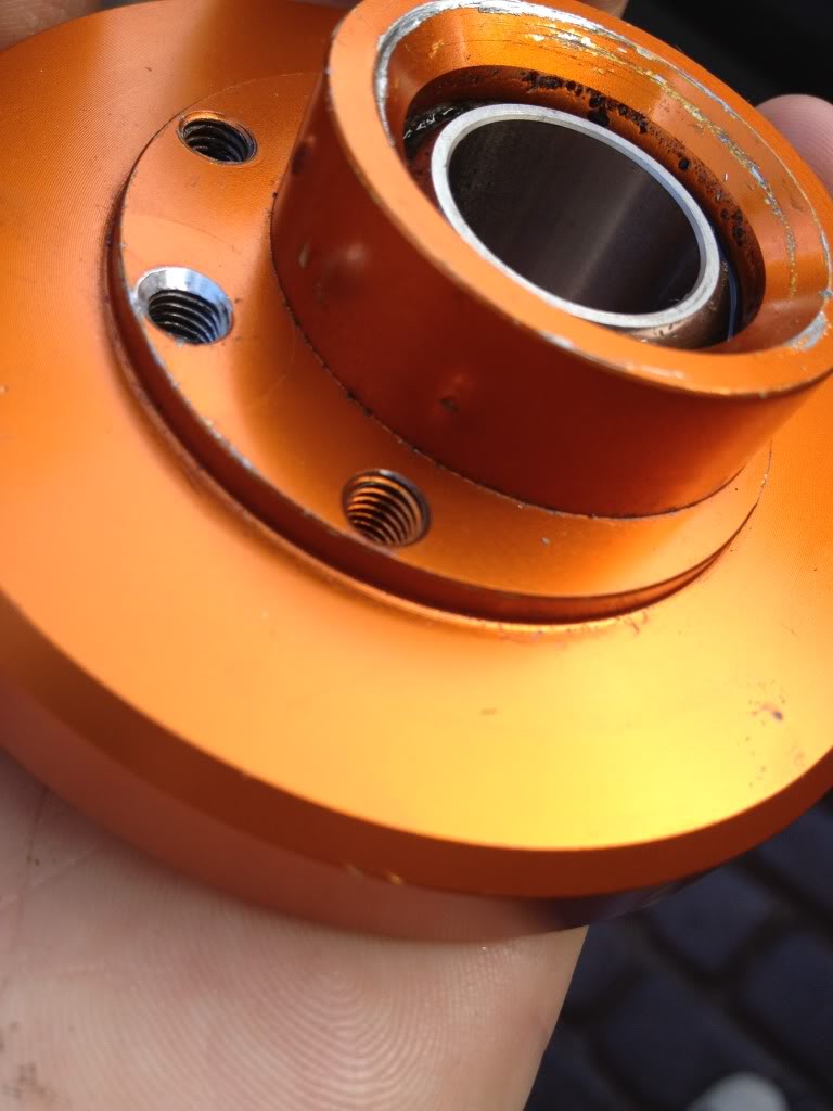

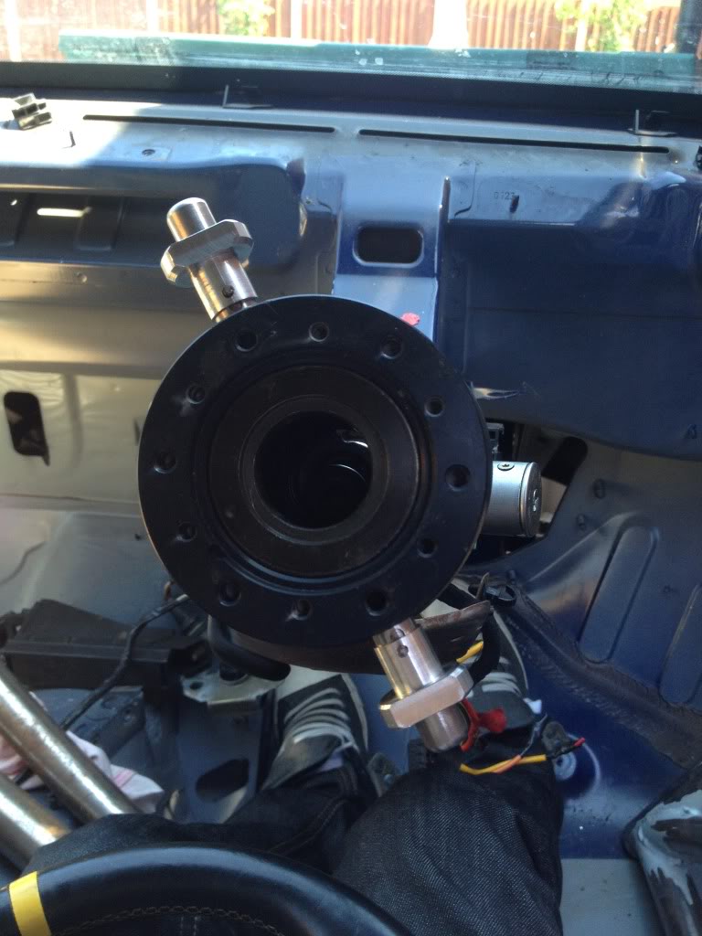

As the boss had turned up i decided to fit my steering wheel and my snap off boss kit to it.
Picture of my old steering wheel that was on GLP. All bolted up to my removable boss and PH2 boss.
This shows the two lugs that are meant to be on the boss to be able to remove the steering wheel. Unfortunately one is missing.

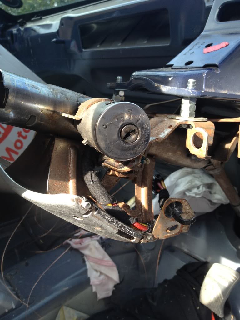

Not a massive update. Ended up taking one of the lugs for my removable boss off and took it into the training centre at work. Spoke to one of the instructors and asked if i could get a couple made up. As its very simple to manufacture he got one of the apprentices to mock it up so hopefully by the end of the day i shall have 2 lugs for my removable boss. Winner saves me getting dirty.

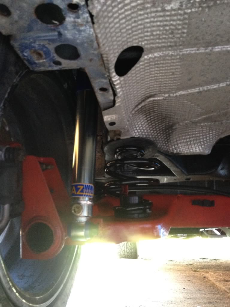

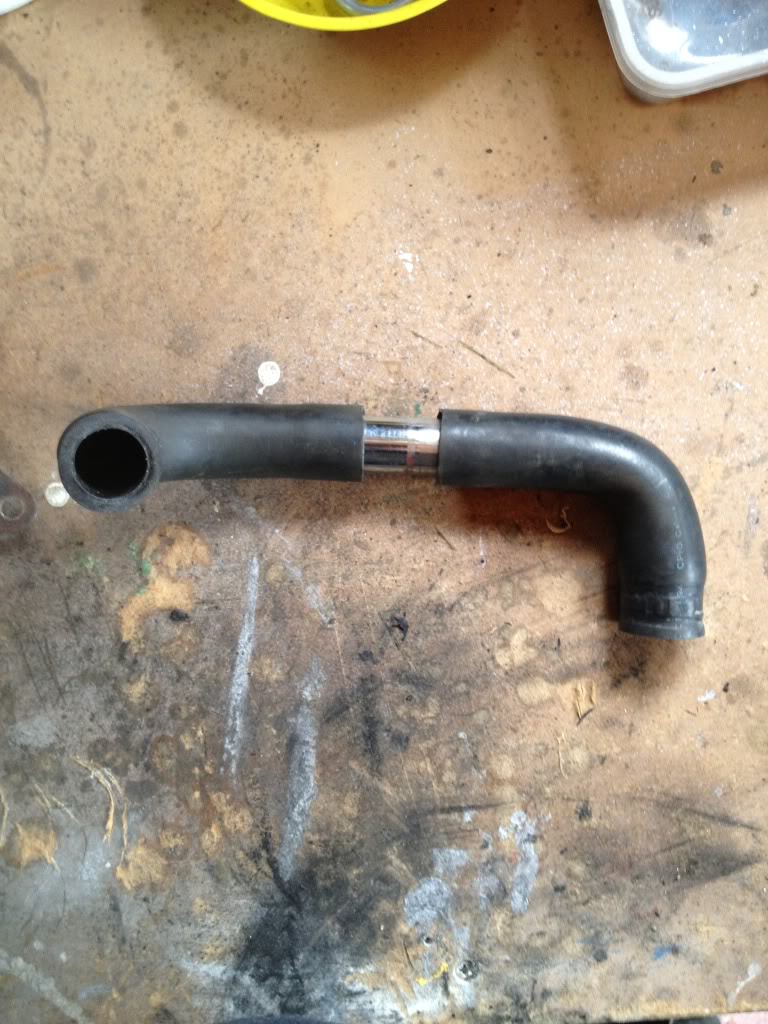

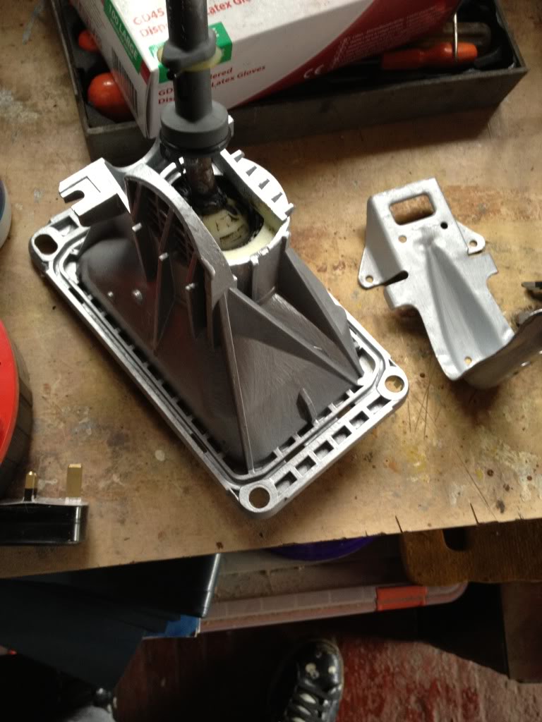

Managed to get these made up by the apprentices at work so that it looks a bit tidier and i dont have to use a different boss that was to big. Well pleased especially as i didnt have to get dirty.

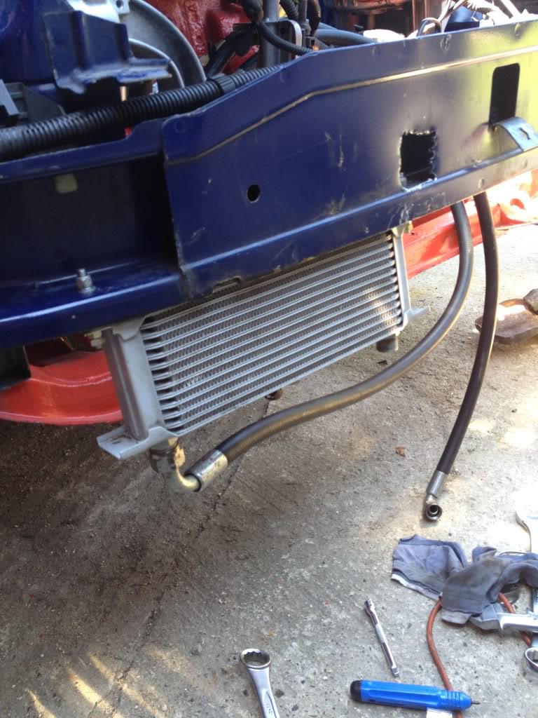

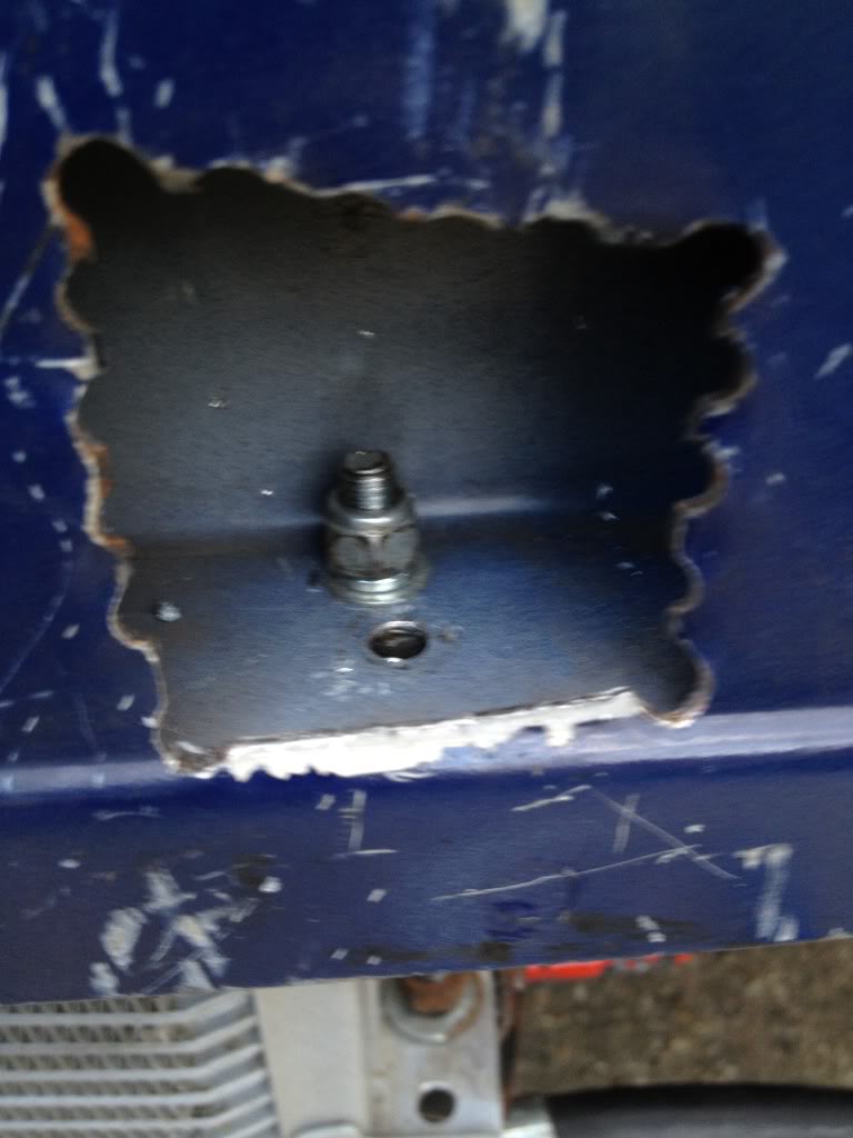

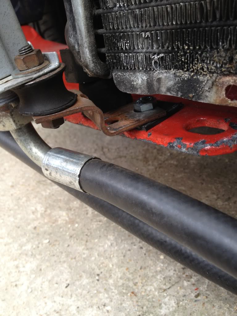

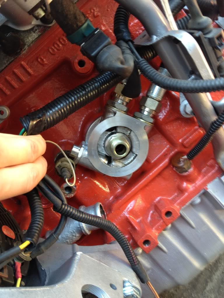

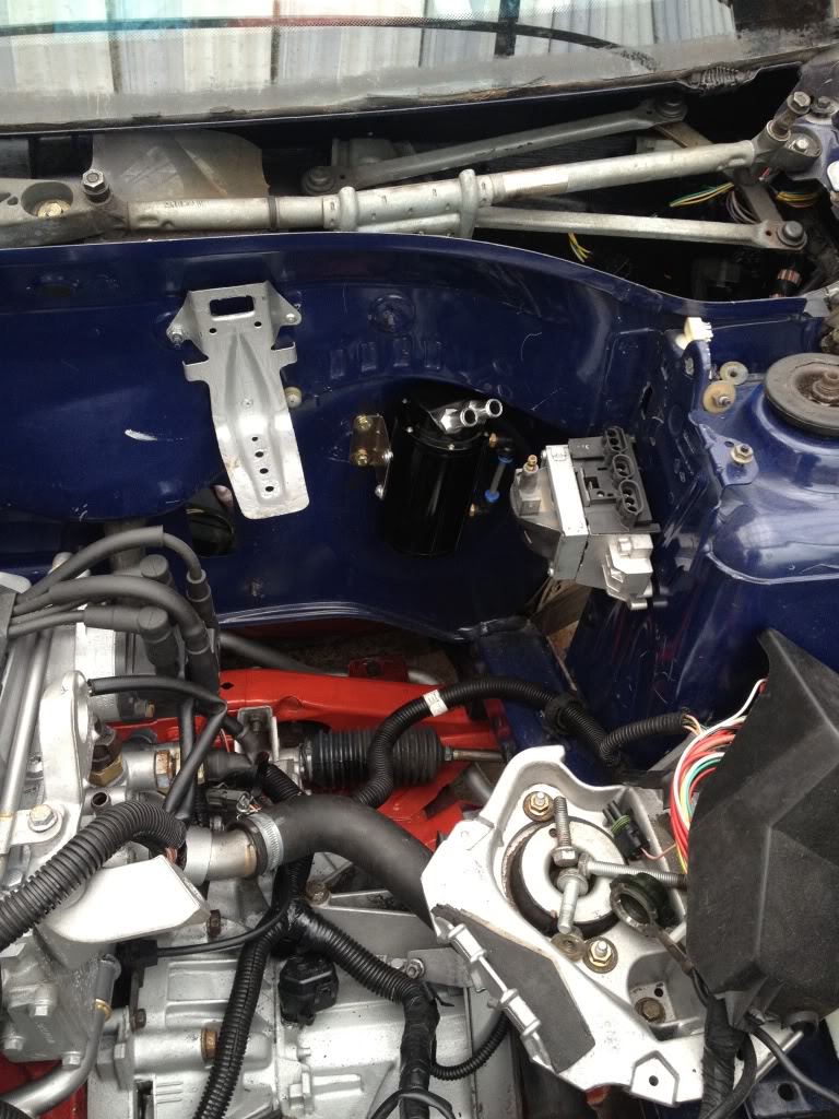

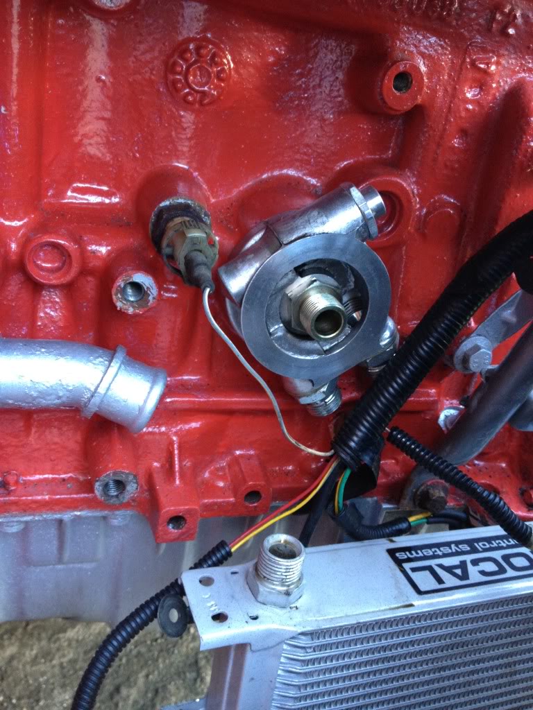

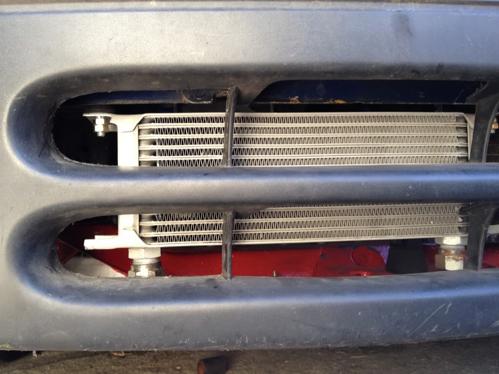

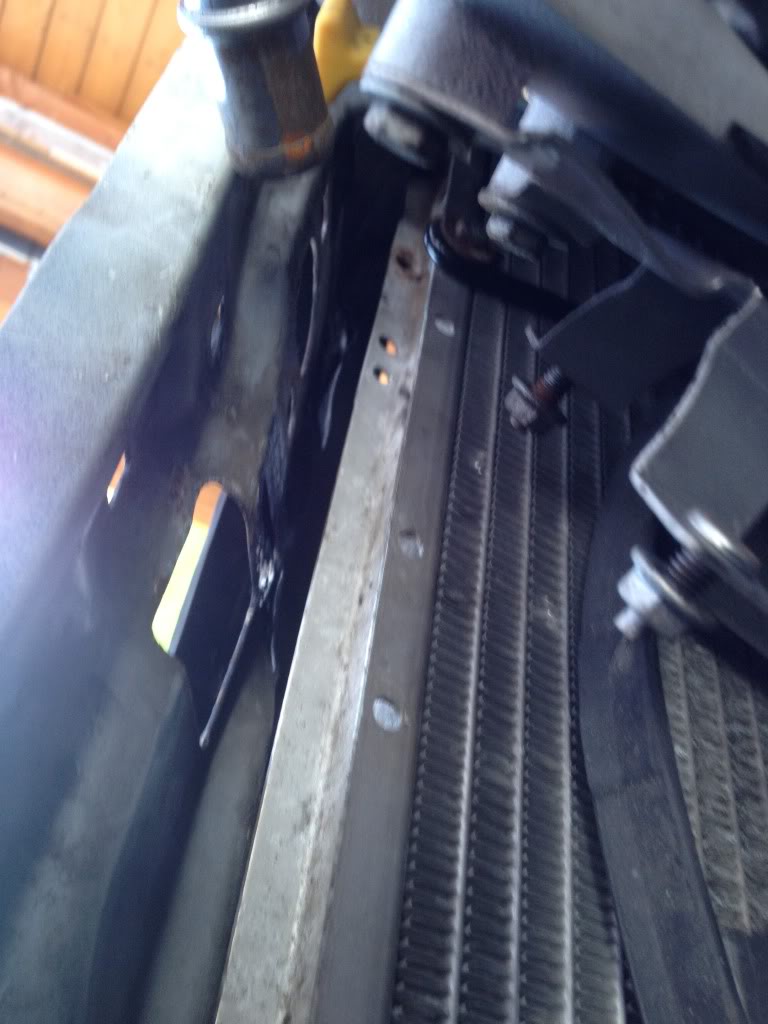

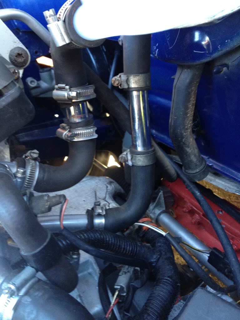

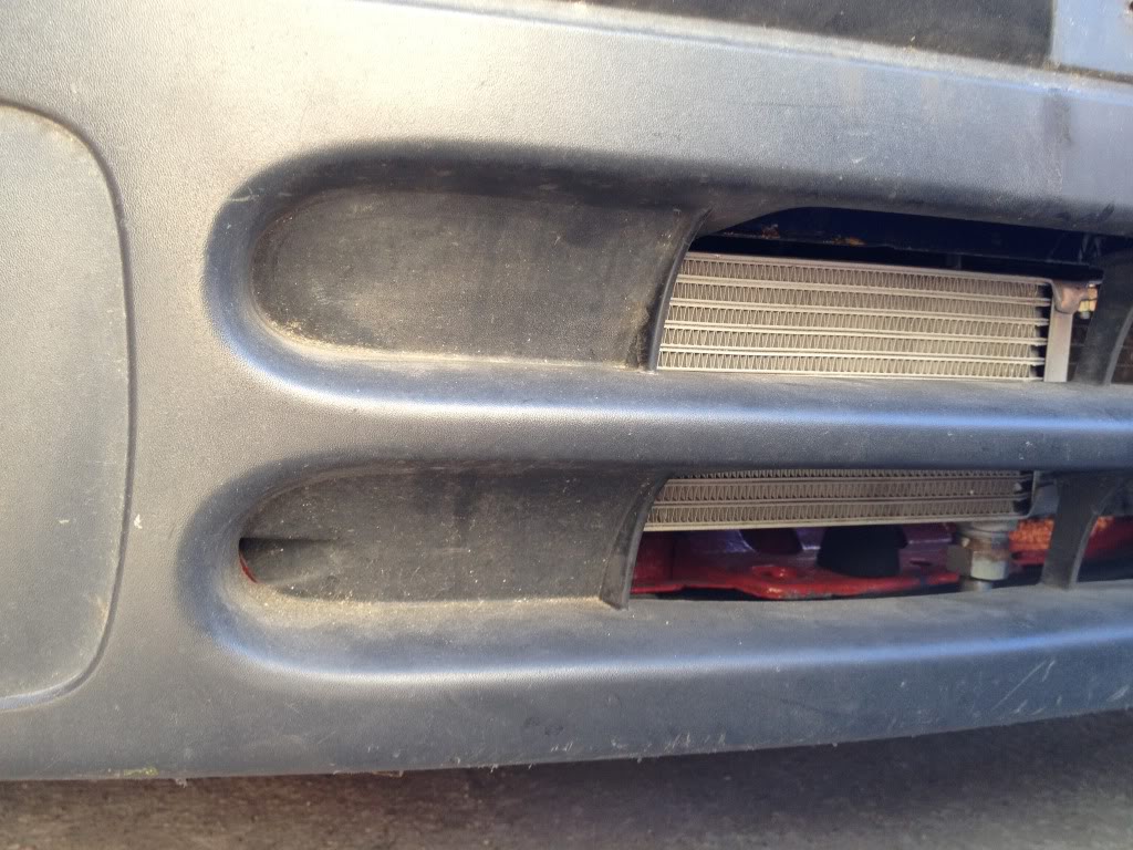

First of all i drilled and mounted the mocal oil cooler using the rubber mounts i had purchased a while ago. I did have to cut a little bit of the section out of the slam panel to do the nut up to hold the oil cooler in place. Its a bit of a shabby job atm as i dont have a working angle grinder but once i get it back i shall clean it up.

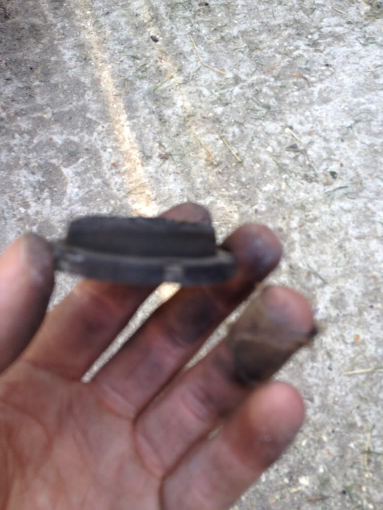

I did also fit one of the pipes. I tried the other one but the thread on the oil cooler is a bit s**t so im going to clean it up prior to putting it on as i do not want to damage the thread as the oil cooler shall be scrap. Bit of a set back and did wind me up but hey ho im still optamistic.

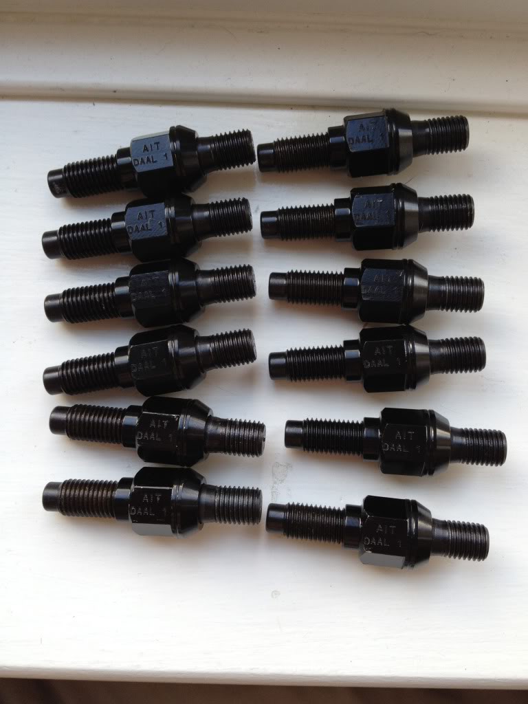

Also on Friday i had popped into my local bolt place to get some new bolts to fit my megane non PAS set up as i didnt have anything laying about. Now i had the correct bolts i could fit the alternator and all of the brackets. :)

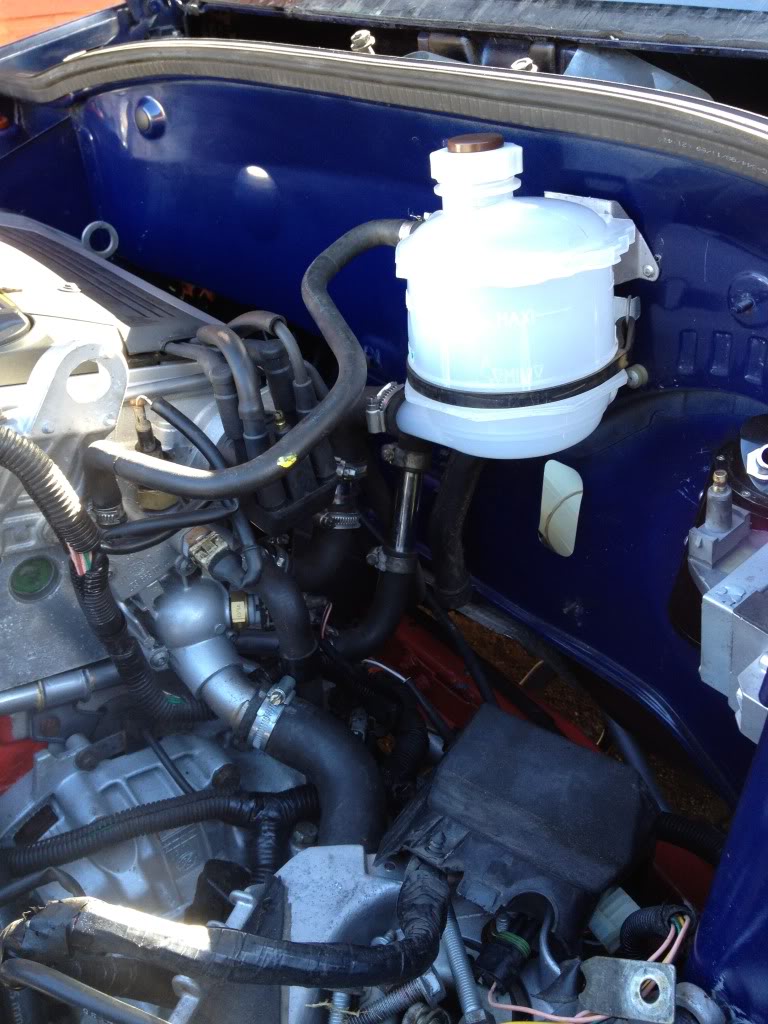

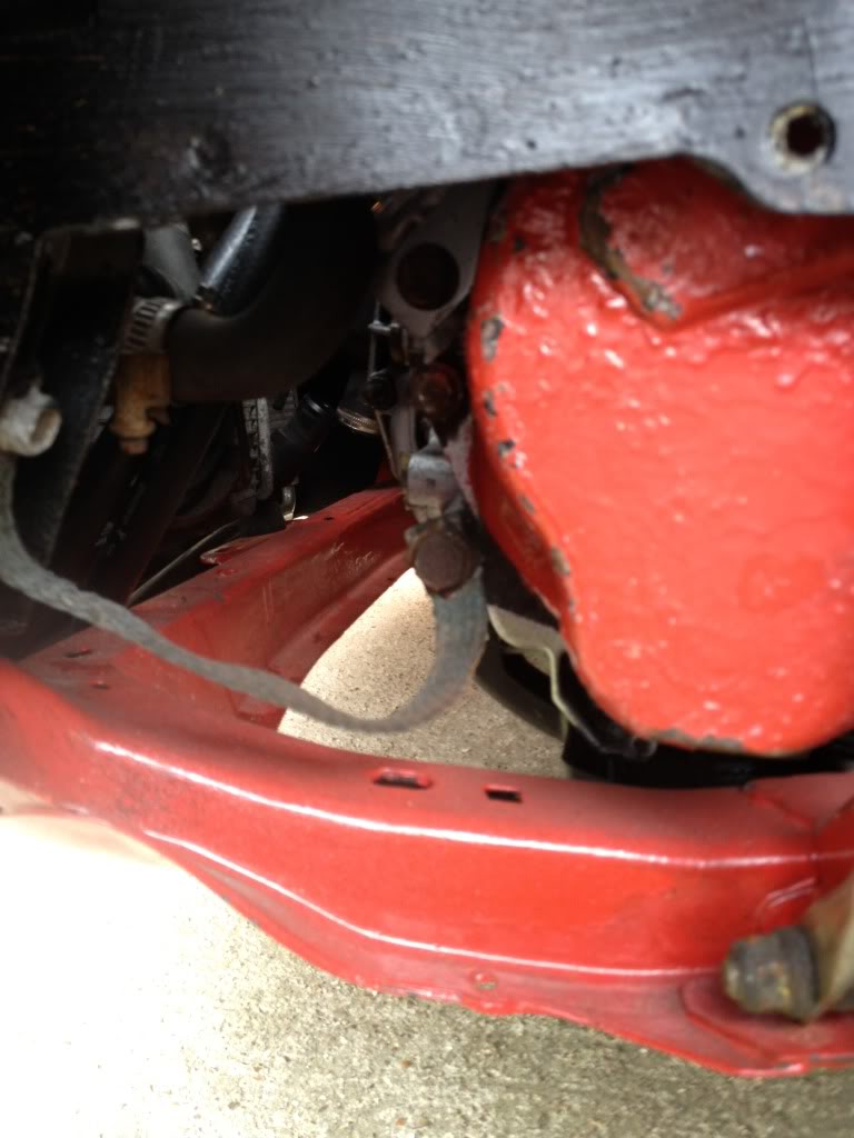

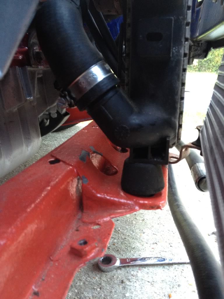

Also connected the pipes up at the thermostat end but did not fully tighten them as i may need to route the slightly when i do the other pipe at the oil cooler end.

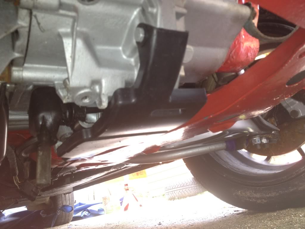

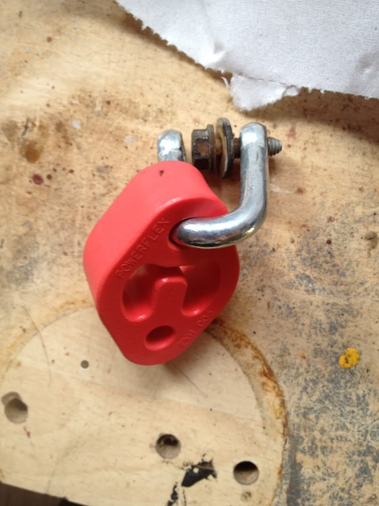

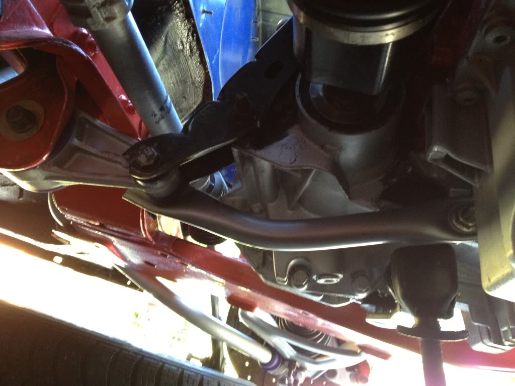

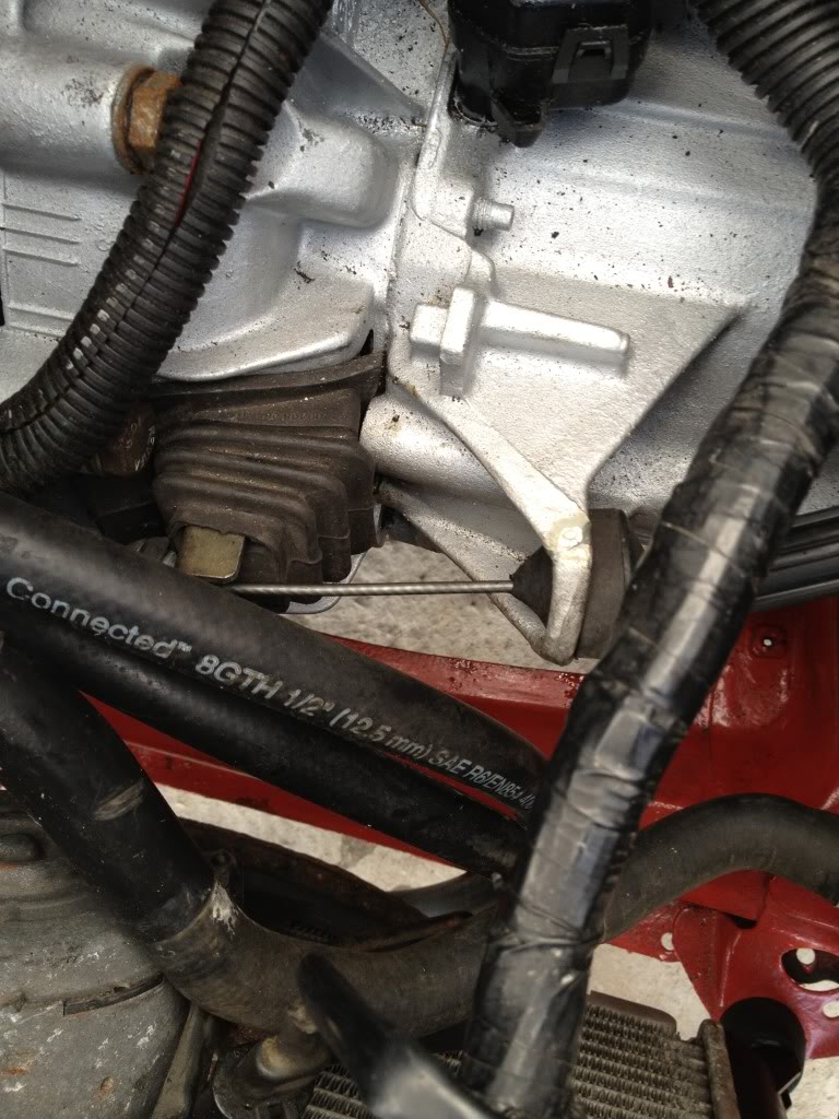

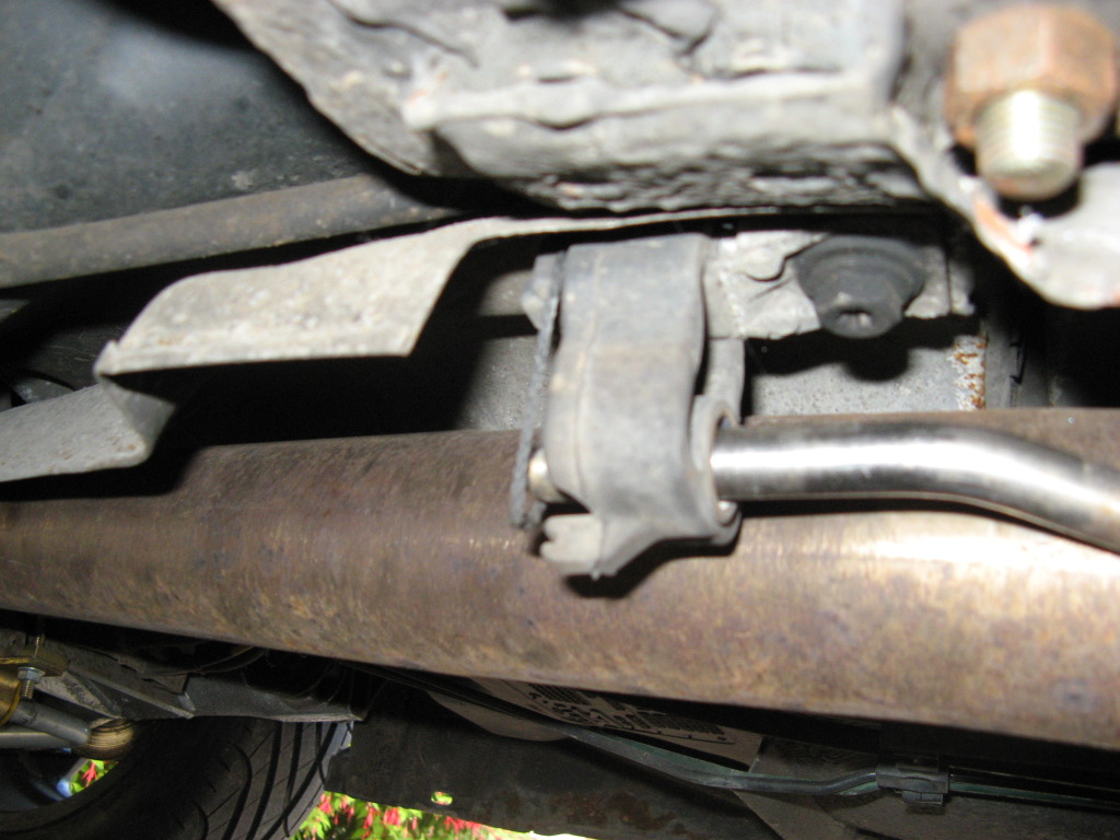

Also found the Williams dogbone stabiliser when clearing out the garage so i thought it would bre a good idea to fit it before i lost it again lol.
Final shot of the day after a quick clean up.

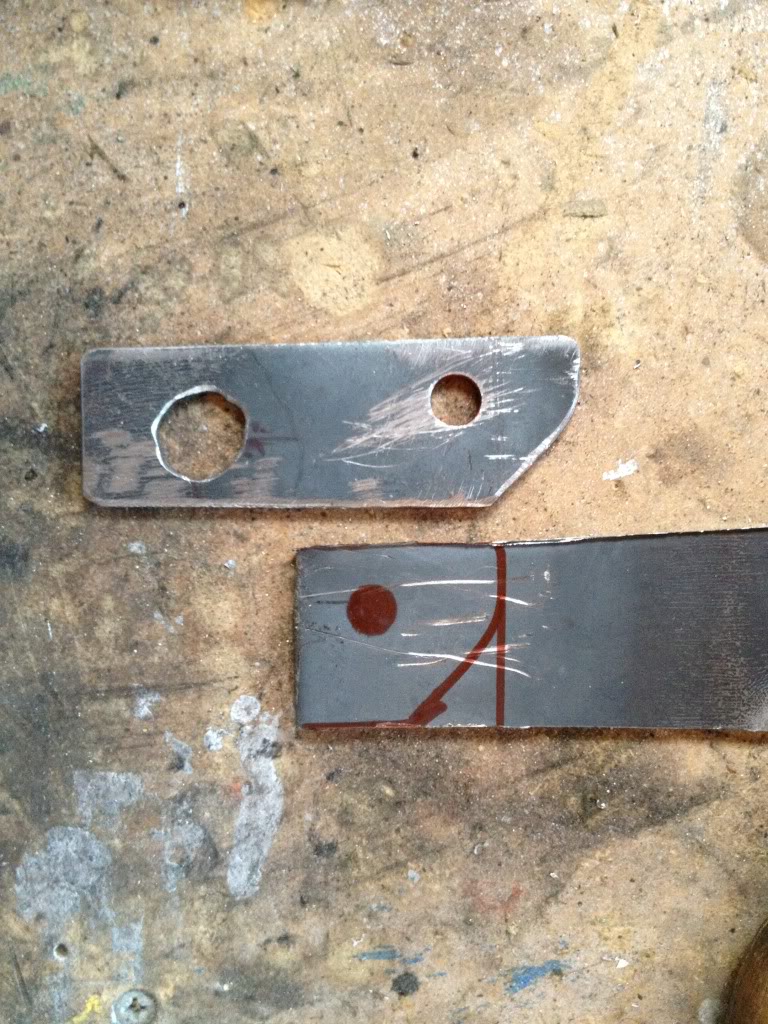

Monday 28th May 2012

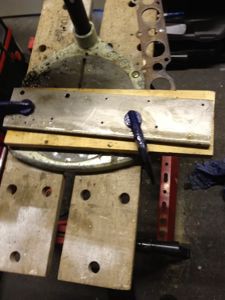

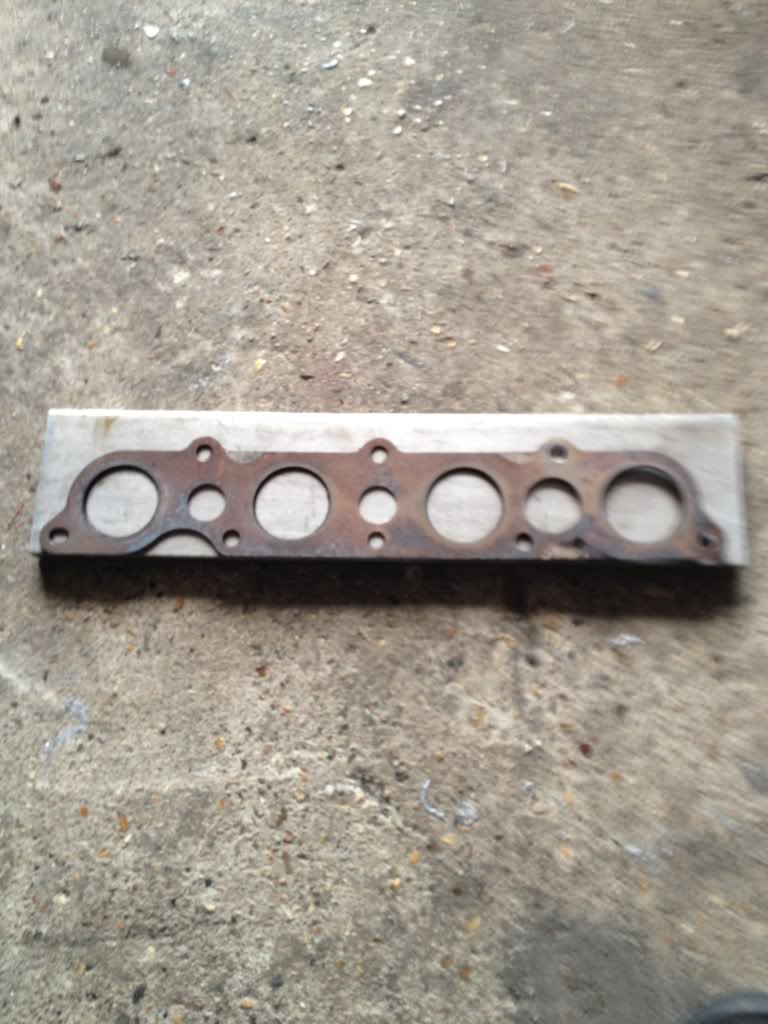

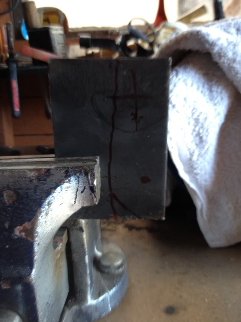

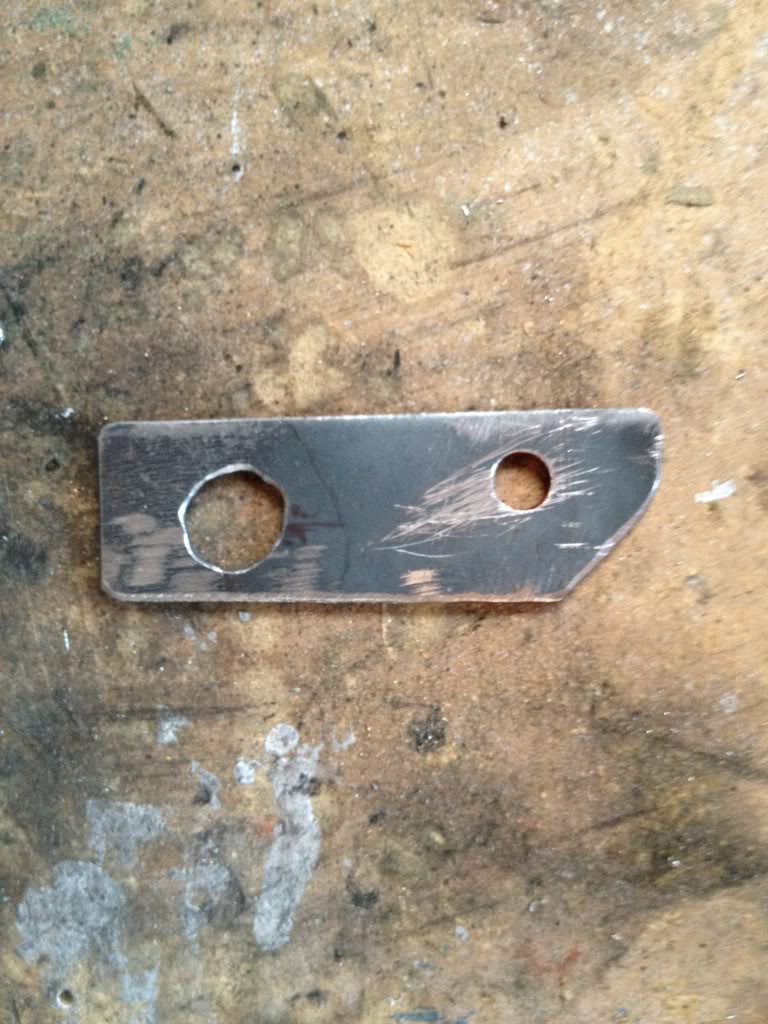

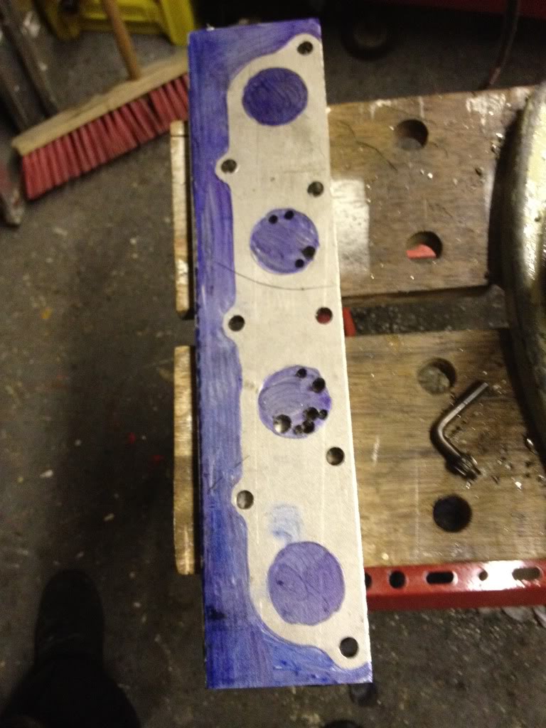

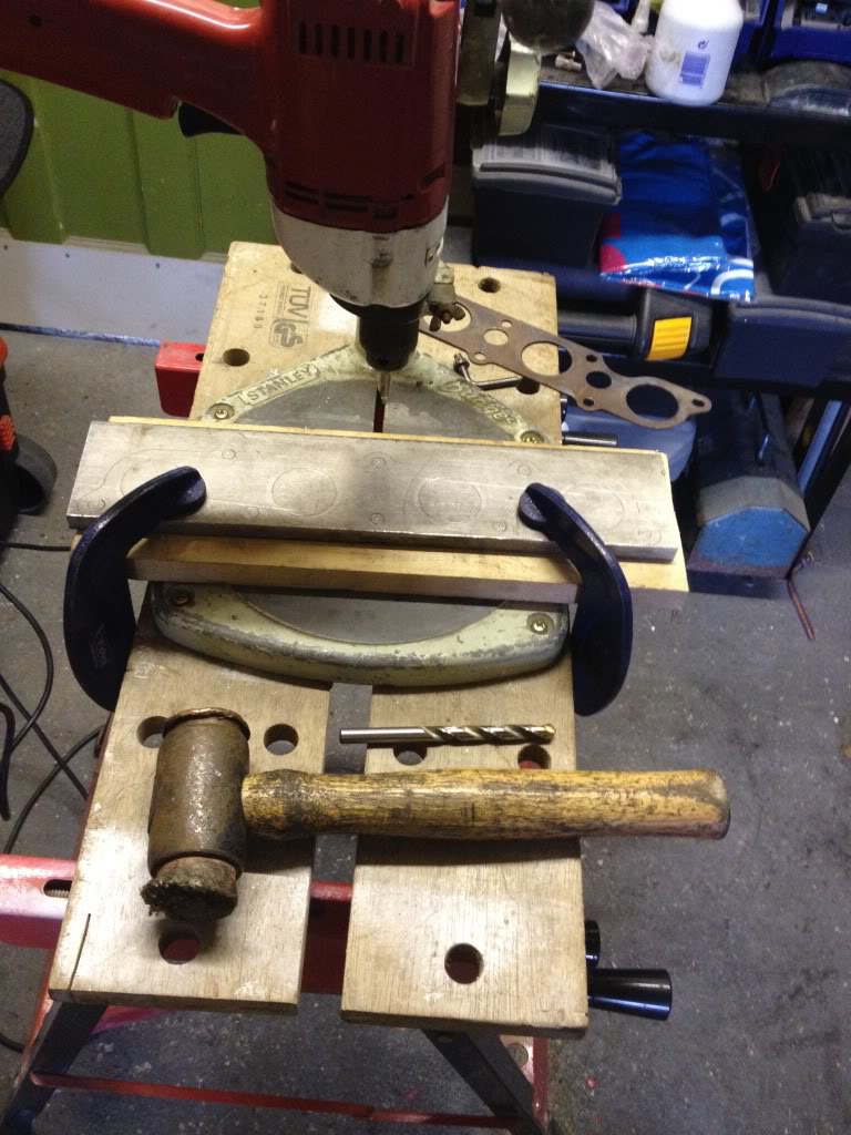

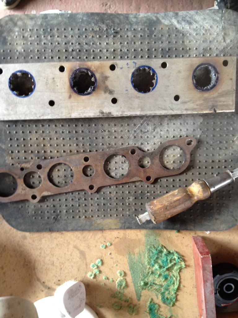

Well work kindly gave me this bit of stainless steel. 14" long, 3" wide and 0.5" thick. This is what i shall be using to make my flange for my F7R head.
Gasket in place and the profile scribed out.
Then my dad told me about an old drill that we could turn into a pillar drill which would really help me out as i do not want to be trying to hold this material whilst drilling because if that snatches that could probably break my arm lol.
Centre drilling done and 2 9mm holes (clearance holes for the studs).
Nearly there
By this point it was about 10pm so i thought i would call it a night as my neighbours would not really appreciate me drilling through the night lol. I have marked out the bits i shall be removing with a blue pen as it was very difficult to show the scribed marks. Still more to come.

Thanks dude its nothing major unfortunately. Just all the little bits that take ages! Im trying to be in a position so that once the cage is welded in there isnt still an army of things to do. Easier said than done.
When do you reckon yours will be done?
I think that is what it is called it was kind of a guess as that what it kind onf does it stabilises the gearbox and dogbone a bit more. Also if you can get old of one without being raped for it i cant see it hurting,

Seriously ??? you're going to remove all that with a pillar drill and maybe an angle grinder !?? GIVE IN NOW ! do yourself favour (and your drill), get a fabricators with a laser or water jet cutter to cut one for you, take the gasket as a template or draw the shape in CAD.
I also think you've wasted a perfectly good 197 cage, and a hobby-spec, gasless, 130 AMP MIG set isn't going to get anywhere near the penetration you need when you start rewelding it back together.
Re: The Confused Budget Track Clio! * Inc 197 Cup Cage Content*
Thank you for your comments however yes I could do all of that and get it drawn up on cad and laser cut but that would cost more money. I am quite happy spending fuxk all on the metal and spending some time fabricating it to shape.
Also I haven't wasted the cage as I am making use for it. And also that's your opinion and frankly I'm not going to listen to some keyboard warrior know it all. I'm am going by a welder who has 40 years experience in aerospace welding. If it winds you up reading my project thread then quite frankly do t read it

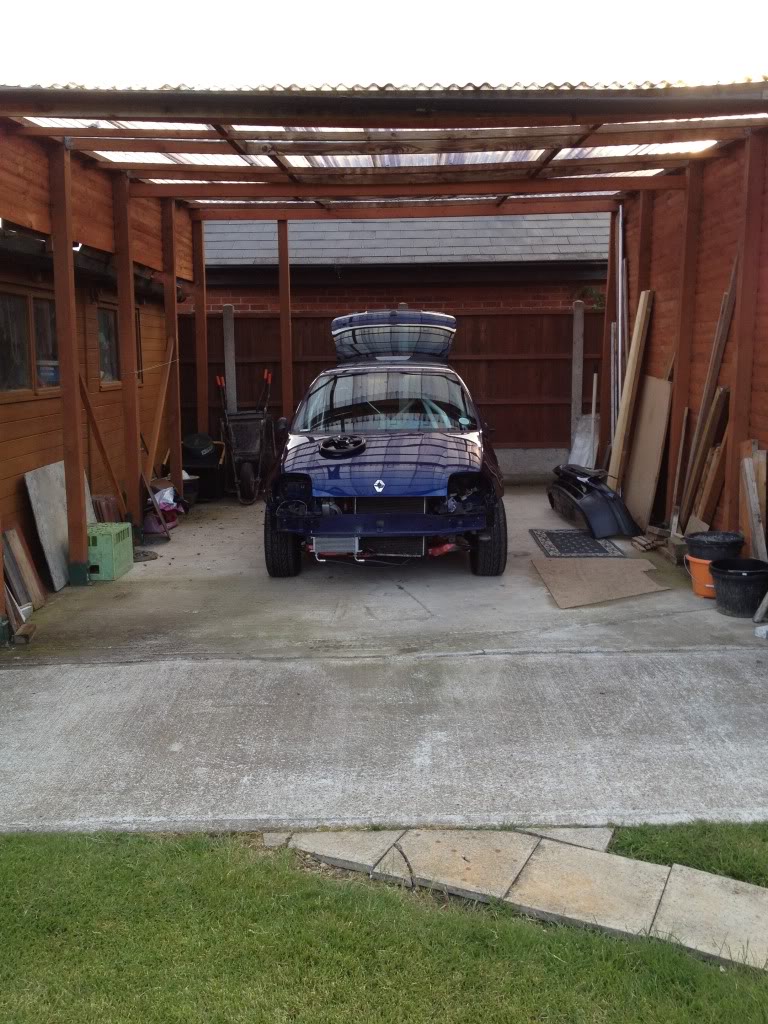

Because England weather is so shockingly crap its unreal. Managed to house the car under some shelter for a few days last week so more updates very soon just ned to write them up!

I made sure that I bought the lockable ones as one of my mates bought the non locking ones and annoying people like me wait until he is in the car and his harness all connected then you pop it just before he sets off so less learnt. (Thanks Alex)
After sorting out the thread on the oil cooler I fitted it to the car without the standard water cooled item so it’s fitted straight to the block, hopefully it won’t leak!
I also fitted the oil filter as well.

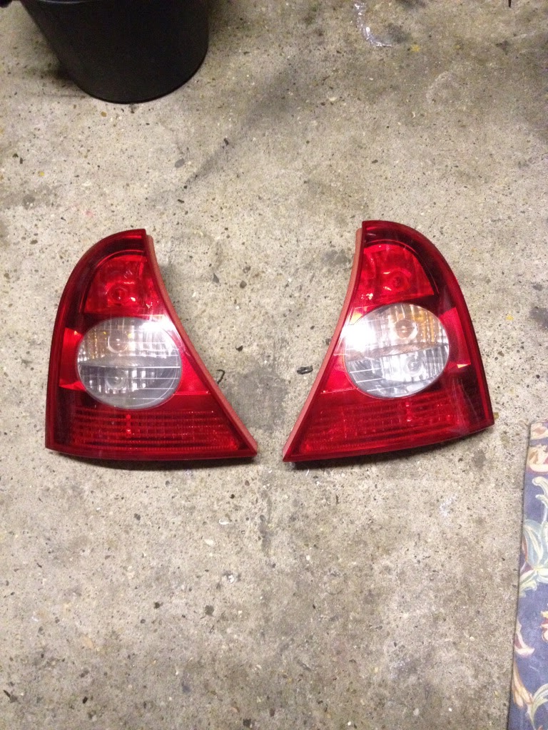

Quick shot of the rear of the car with the Phase one lights fitted.
And now with the Phase 2 lights fitted. Much better in my opinion.

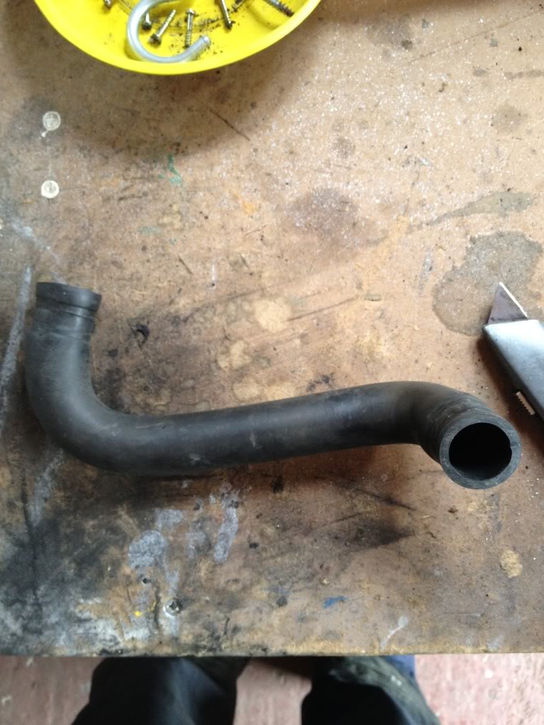

Lower rad hose fitted
Gearbox Drip Tray

Didn’t really do a lot to be honest popped round to pauls to pick up the bonnet stops and the radiator bungs that go in the sub frame (thanks again mate). It wasn’t raining so I though I would take the opportunity to move the car as my granddads shelter for his caravan wasn’t being used so I thought sod it just encase the weather is crap I can still work undercover. All I can say is don’t try moving a car on your own over grass that is dippy with flat tyres :(
This is the clios new home for a little while so hopefully now I can crack on with some work!

First of all I wanted to start fitting the stuff on the inside of the Clio so that when the cage is mocked up I know that I am not going to hit anything.
First of all was the pedal box, but before I fitted it I thought it would make sense to fit my momo pedals on the bench rather than in the footwell of
the car.
I then fitted the servo, dab of grease on the 'stick' in the 172 Cup servo and then on with my 172 Cup Master cylinder.
Pedal box fitted in the car:
I then set about TEMPORARILY adjusting the column to lower it a bit more over the standard position. This shall ensure that I will not hit my hand on the tube going from the ‘A’ Pillar to the floor. Also this shall make my driving position much more comfortable. I had put four nuts in place (I shall be making something more suitable like a spacer once I decide on the final position). After sitting in the car for a bit longer I removed one nut and went down to three. Who knows I may even go down to two at a later date.
I then went onto painting the gear stick casing and the bracket for the coolant expansion bottle. I didn’t want them going in looking naff so I thought a few coats of brushed on silver hammerite may do the trick. It’s not an ‘Andy’ job but its good enough.
I let the gear stick get tacky then set about fitting it in the car.
I then sorted out all of the parts I had scattered here there and everywhere. On my hunt I found the gaiter that I needed to fit to the steering rack to keep the water out so I fitted that. Fiddly bloody thing!

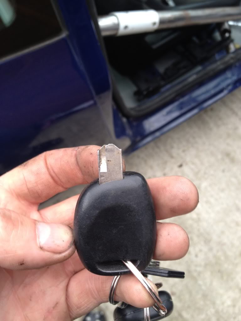

Then this happened
….. all I can say is t**t as this was my only key!
Oh well need to source a new lock set now FAIL!
I then fitted the following things:
Coolant Expansion Bottle Bracket,
Oil Catch Tank
Coil pack
I think they look quite good in the positions they are but they may change once all of the stuff is in the bay.

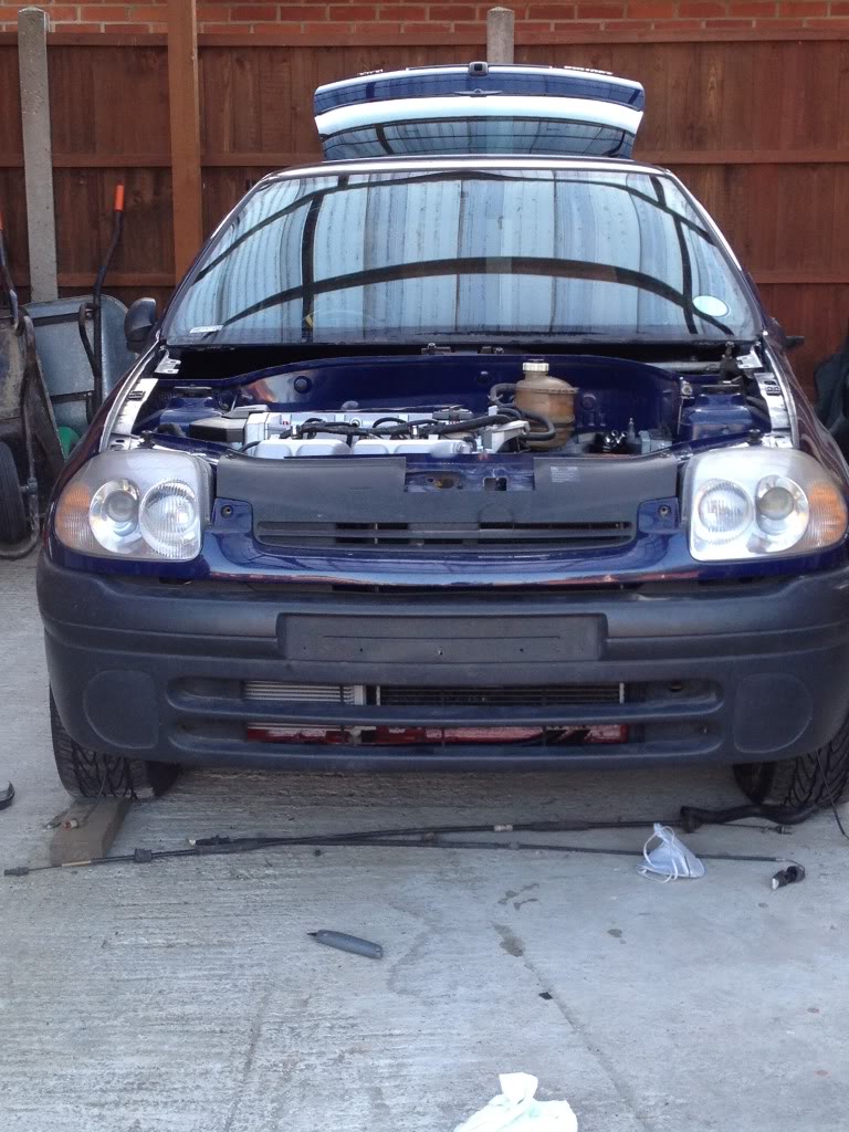

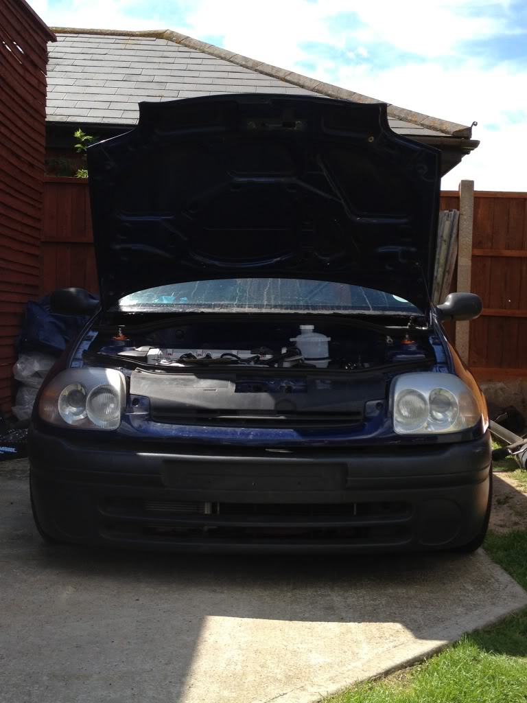

I had also dug out the front headlights that I will be fitted so I whacked a couple of bolts in them to hold them in place.

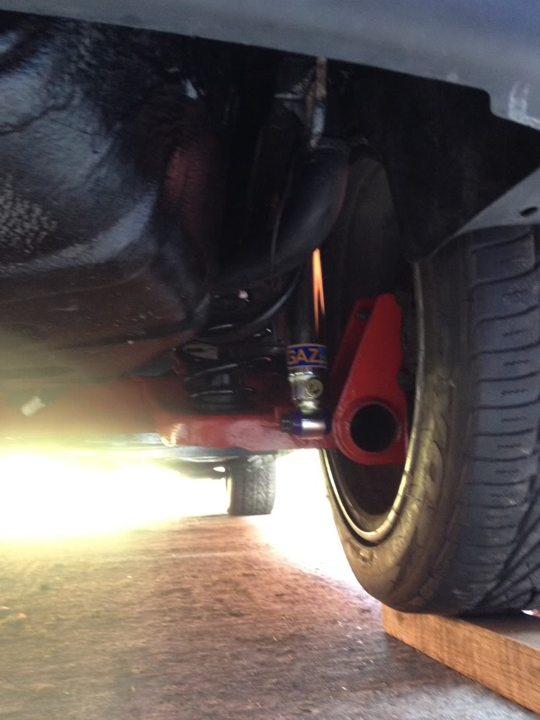

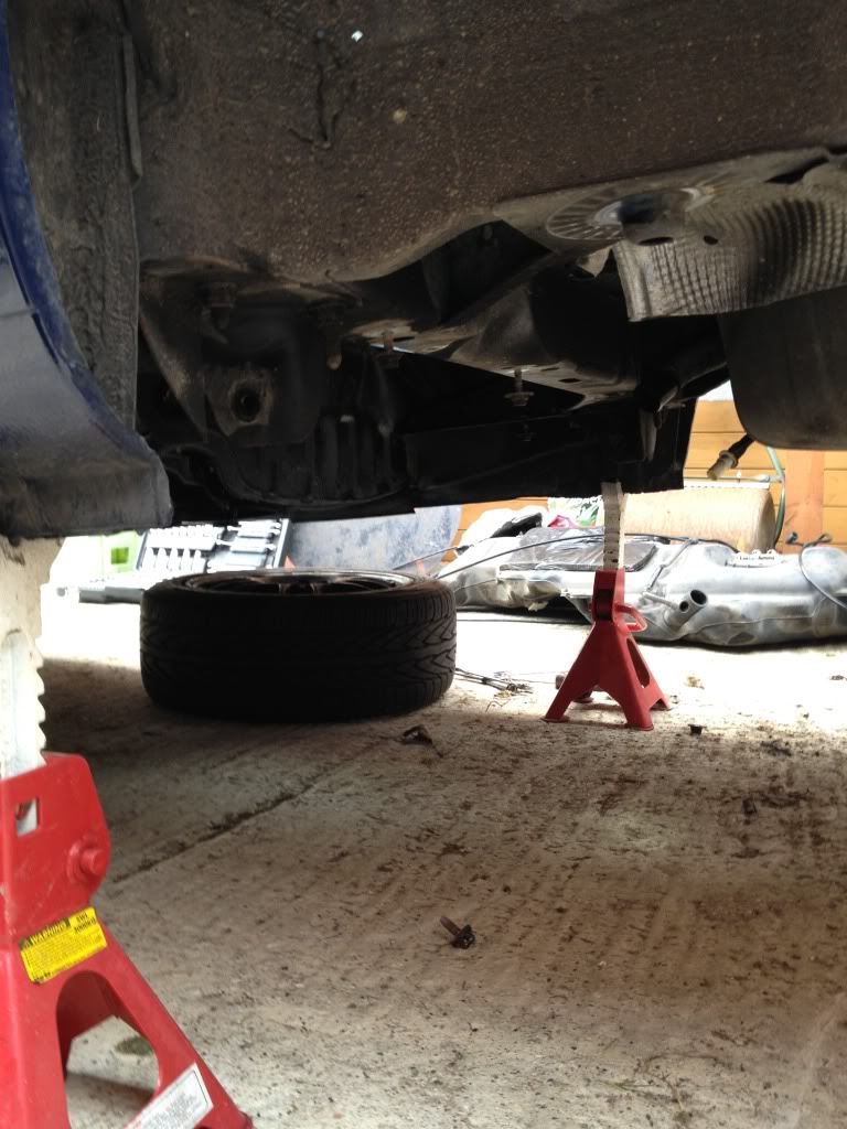

I wanted to crack on with the rear of the car so I jacked it up nice and high to try and give myself as much room as possible!
I started to remove the rear shocks but the bolts where an absolute b*****d and where seized solid so lots of WD40 later and let them soak in overnight so called it a night and went home.
Did get home to find these lovely items though. Thanks again Andy you’re a star!
Friday 8th June 2012
After a goodnights sleep and a yorkie for breakfast I managed to get the rear shock bolts out! So not long after that I had the rear beam off.

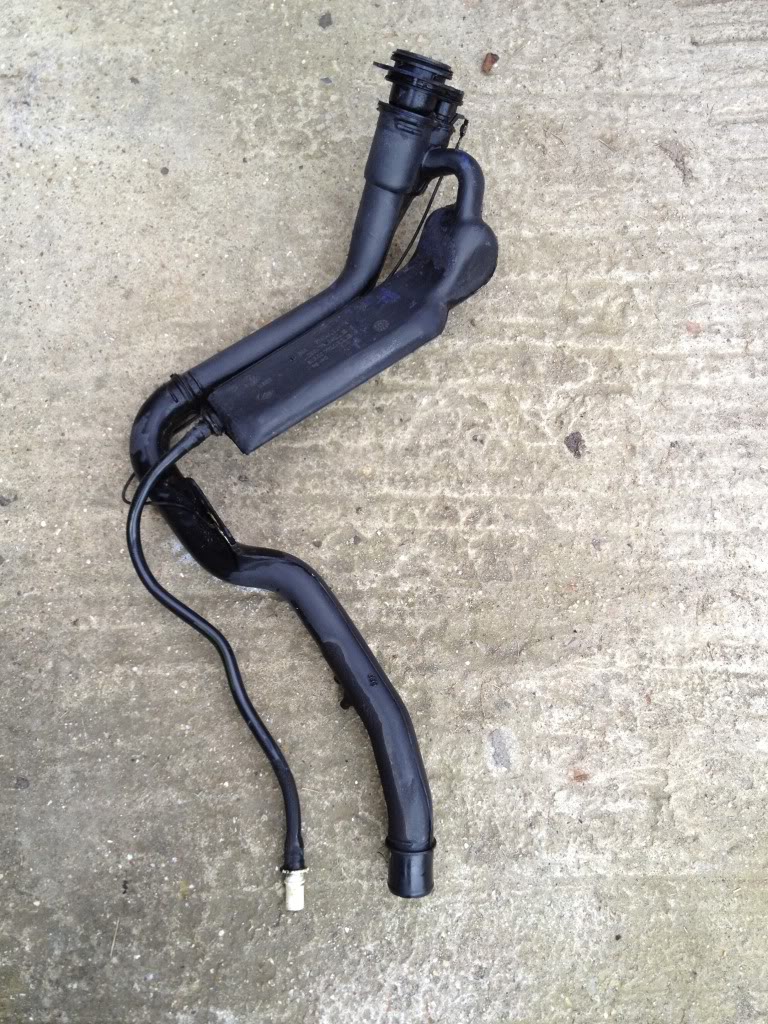

I then removed the filler neck as it was really dirty and I wanted to get into the rear arches to clean them up.

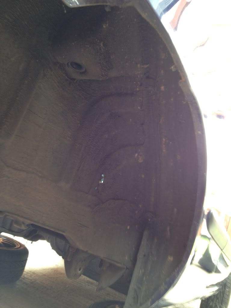

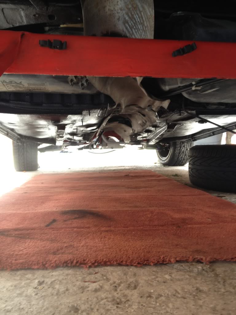

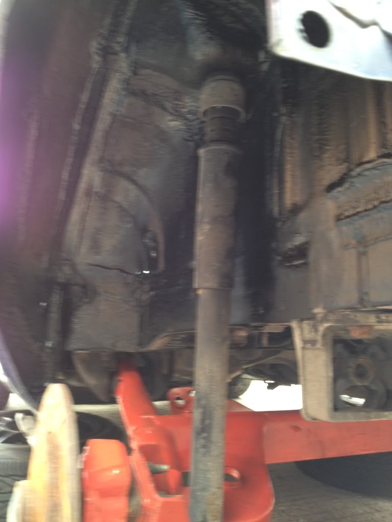

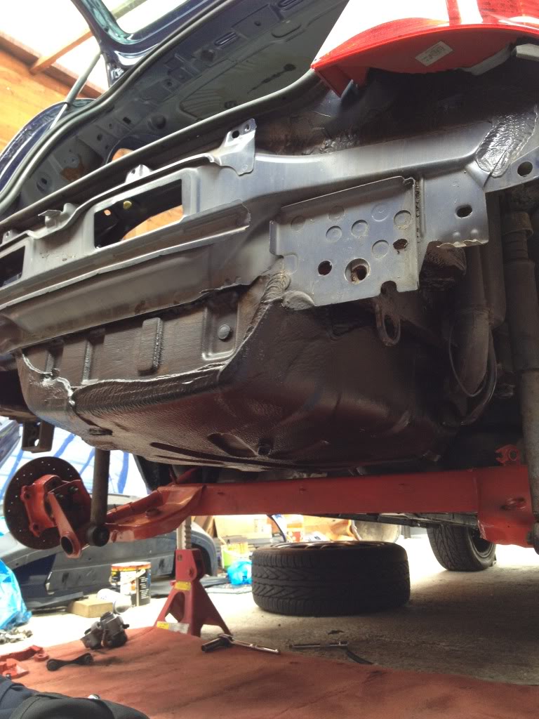

Then I took a few before pictures of the arches and the underneath rear part of the car.
Filler neck cleaned:
Nicely under sealed underneath!

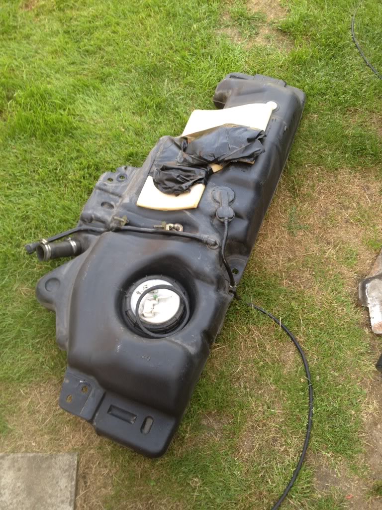

Then fuel tank given a quick clean (top side) and then fitted to the car.
Finally the rear beam fitted to the car :)
Offside rear arch under sealed
Nearside rear arch under sealed

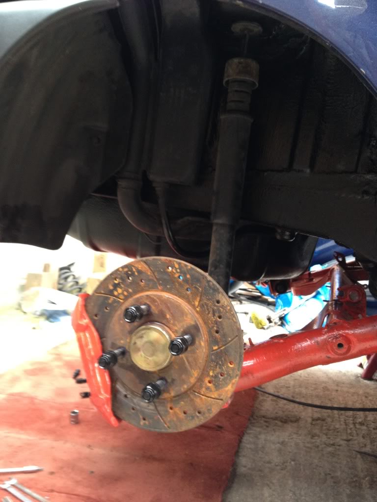

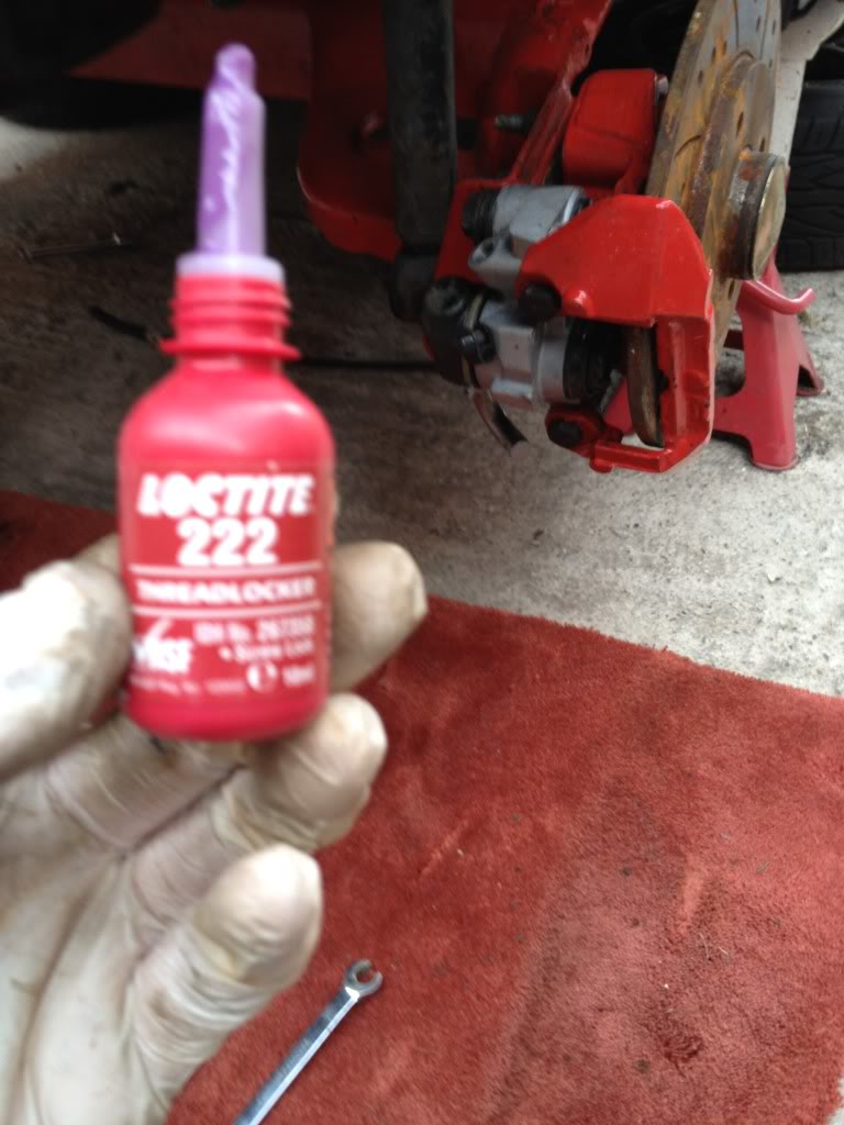

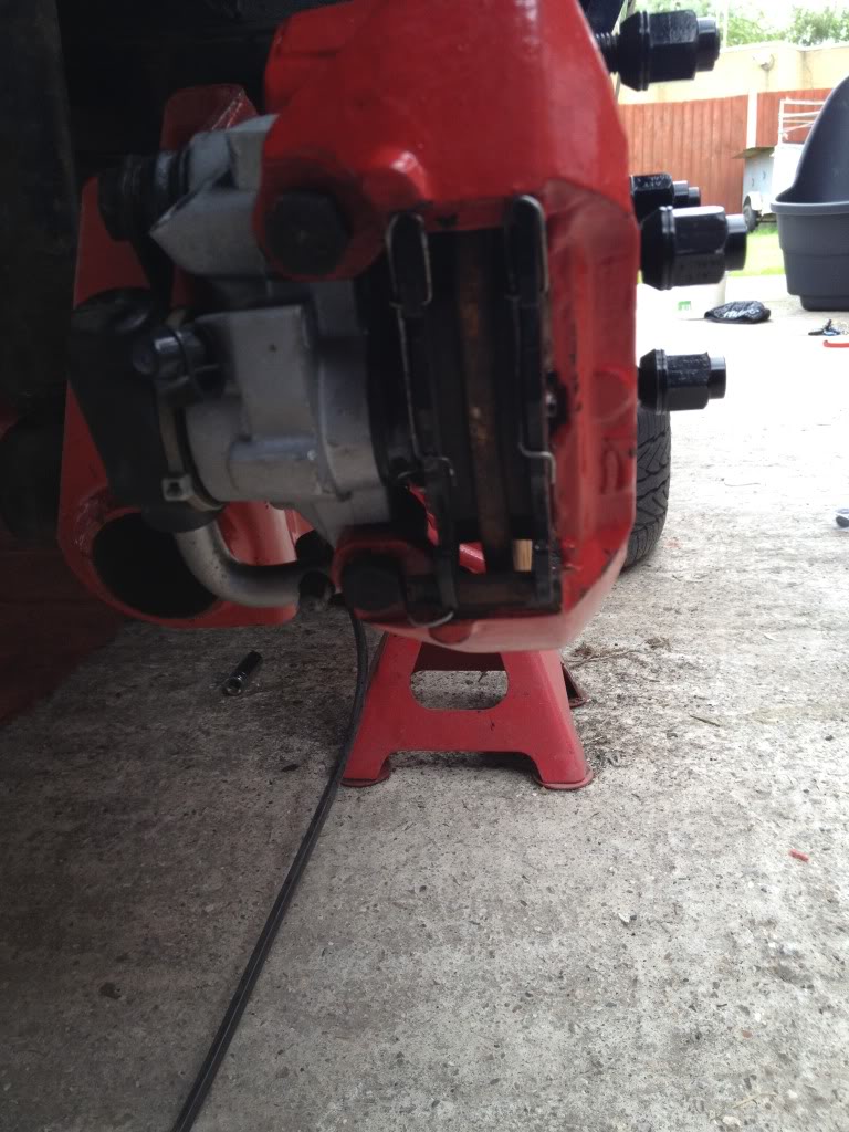

I then fitted the rear brakes whilst using a bit of Loctite 222 – This stuff is not the concrete never going to undo again stuff this is anti vibration stuff so it can still be removed it need be.
I have been using this quite a bit throughout the car. It is very handy stuff.

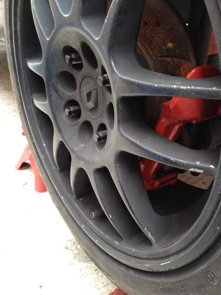

Once both sides had been done I set about putting the studs I got off Andy in. But before I loctited them in I decided to trial fit them and then put a wheel on to see how far out the studs sit.
Just the studs:

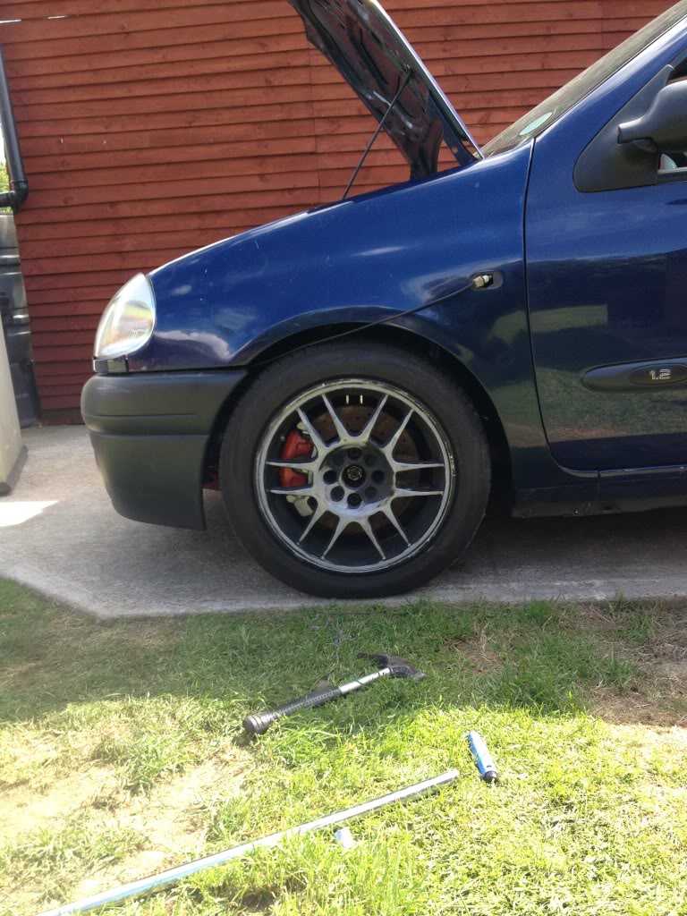

Wheel fitted:
I was really happy with how they looked they don’t stick out too far in my opinion so out came the loctite and I loctited them in place with the 222.
I then fitted the clutch cable and the vacuum pipe from the Cup Servo to the pipe that runs to the inlet manifold.

As Beeson stuck around for a little longer I asked him to help me so that I could set up the gear linkage on the car. I put the gearbox in reverse using the selector and then Beeson held it in the reverse position whilst I connected it and tightened it up.
He then helped me fit the handbrake cables to the car. I did not realise that one was longer than the other and typically the first time I fitted them the wrong way round.

First thing was first I still needed to remove all of the paint off of the roll cage so that was the first job, The only bits that remained with a lot of paint still on them was the main hoop and the passenger side bars.
Before:
After:
As some of the tubes have started to oxidise very slowly as I removed the paint such a long time ago this time I thought I would put a bit of grease on the tubes to prevent them rusting. I then chucked them in my granddads shed.
As this took a good hour to do and by this point I was covered in paint dust and my hands were numb from the vibration I thought I would do some piddly little jobs lol.

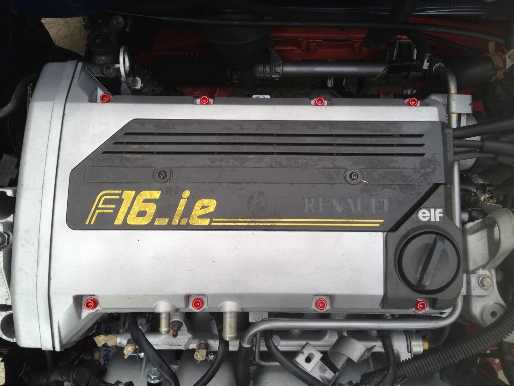

I then removed the cam cover bolts as they were blue and did not match my engine colour.
Before:
After:

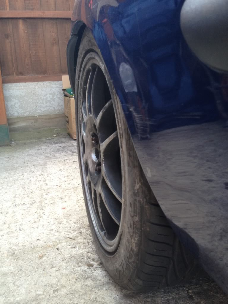

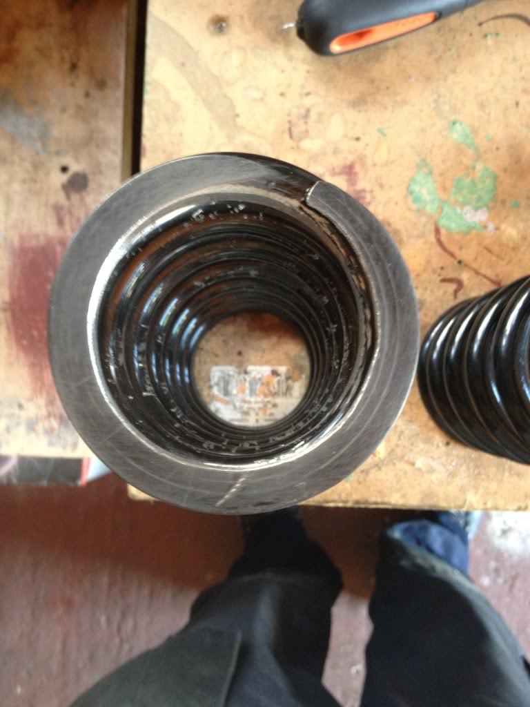

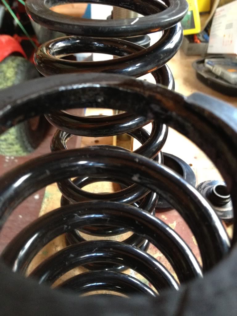

As the rear end of the car was basically done I didn’t see much point in having the rear end jacked up anymore so I fitted the rear wheels and lowered her down.
Quick shot of the rear stance with no springs in place.

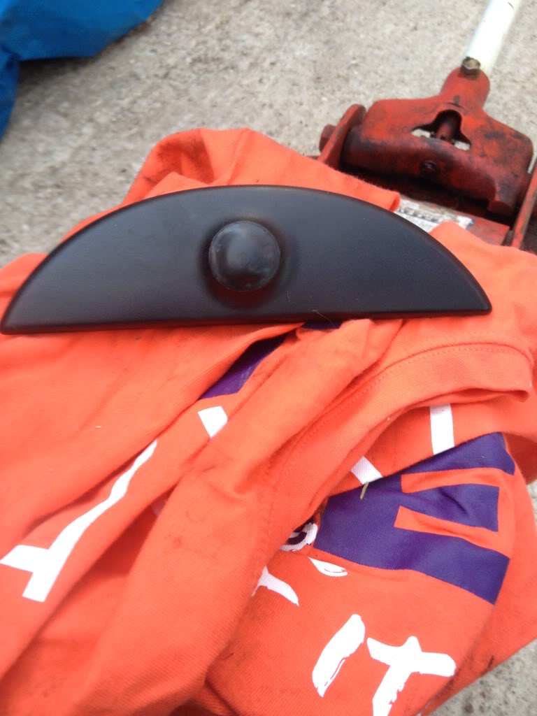

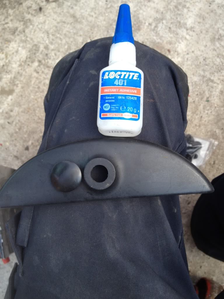

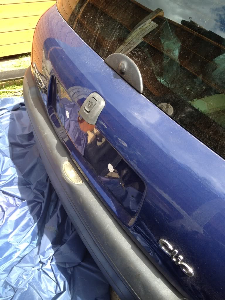

Earlier when I was rummaging for parts I came across some grommets and the rear wiper plastic so I did the following to tidy it up.
The finished article:

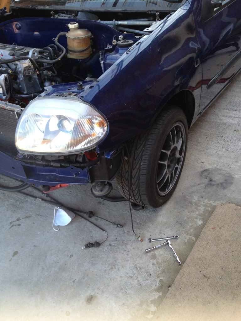

Well I managed to grab Luke for a couple of hours work on the car so we set about doing a bit of work on the roll cage. First of all we thought we would test the welder as I had managed to get some welding wire from work :) This was good as the stuff we needed they did not sell on the small spools for this welder. It comes on 15kg massive spools and they are not cheap!
While Luke was testing playing with the welder to get the right gas flow, feed rate and power I was stuck doing nothing so I set about actually bolting the front end on properly.

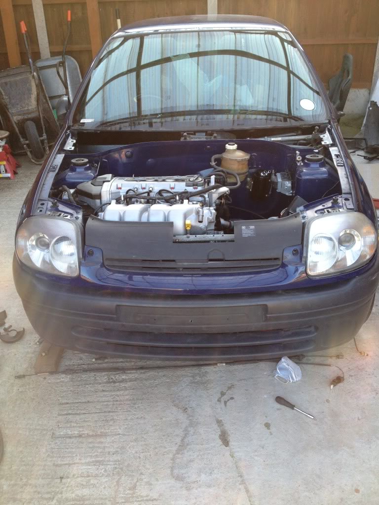

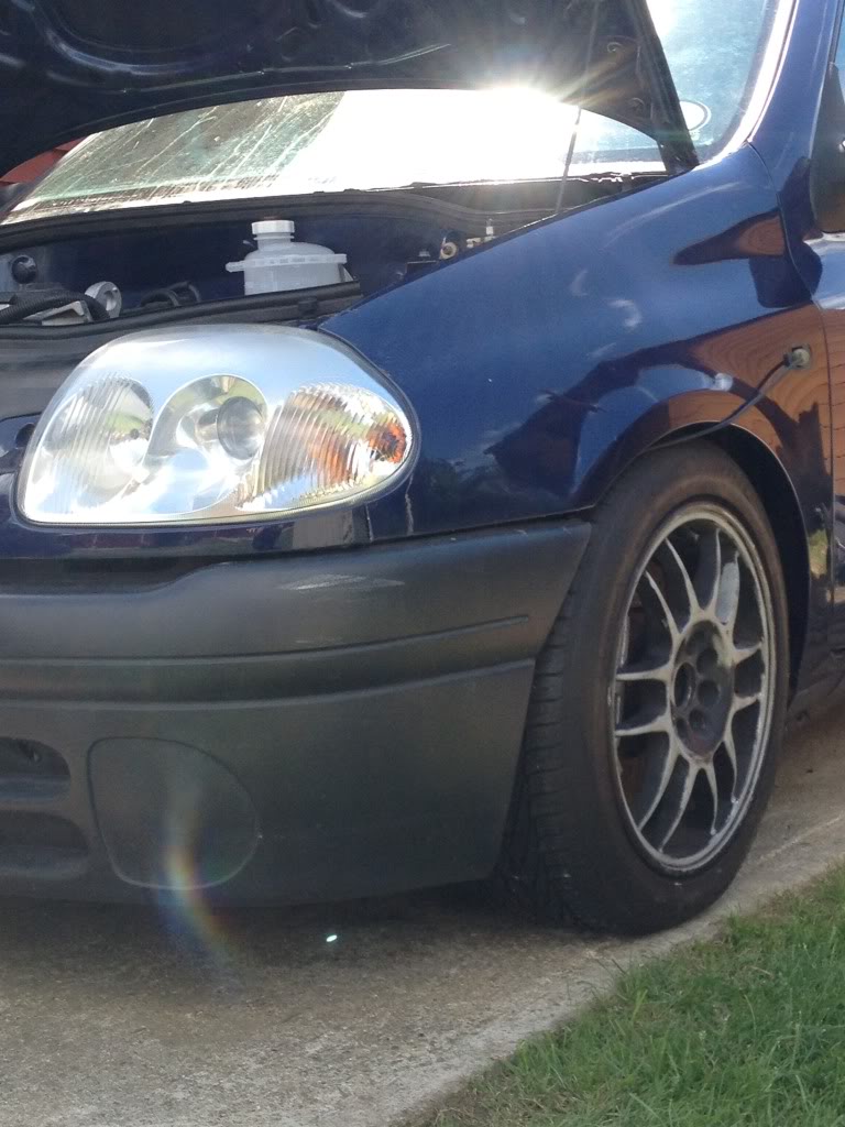

Nearside wing and nearside headlight in place :)
Once luke had finished the test pieces we then looked at the weld to ensure we had proper penetration and that the weld had not cracked or anything. It hadn’t so spot on!
Luke then started grinding off the welds off of the main hoop that we had cut through for the bars that we are going to have to reposition. As we both couldn’t do that I continued with bolting on the front body panels.

Not a massive update but I got 4 bits of stainless steel 1.5” OD by about 5 inches long cut up so that I could extend the 172 manifold away from the starter motor so it didn’t foul.
This is what it will look like eventually (a bit of imagination required)

As I already had the drill set up as I was doing the manifold flange I thought I may as well drill them out and re-tap them. The first one took about half an hour as I was taking it very steady and taking the drill up in small stages (plus trying to find the right size drill amongst 2 draws of them was difficult enough). Once I had the first one done and the drills to had the following hole took about 5 minutes and was a much neater job. Fully functional AST top mounts for £60 SORTED :).
A few snaps I took along the way.

First of all we removed the seam sealer and all of the paint in the surrounding area, we then put the plate in and offered the cage up. As soon as we did this we realised that the geometry of the cage had changed slightly so we spent the rest of the evening fiddling with that to try and get it right. Its suprising how much time this actually takes because once we got somewhere near this the time is always up :(. We will get there in the end. Anyway a few pictures.

After that hurdle i decided to fit the backbox but due to the weiht of it and the f**ked exhaust hanger i had on the it just would work so off that came and off came the old exhaust hanger. I did also notice that the middle exhaust hanger that the 172’s have i didn’t have on mine so that basically put an end to that aswell.
After this i was pretty fed up and could no longer be bothered to work on the car. The only good thing to come out of that day was I was just chatting with one of my mates who does banger racing and he told me that he recently purchased a plasma cutter so i will be using this to finish off the manifold flange. That should speed things up a little :).

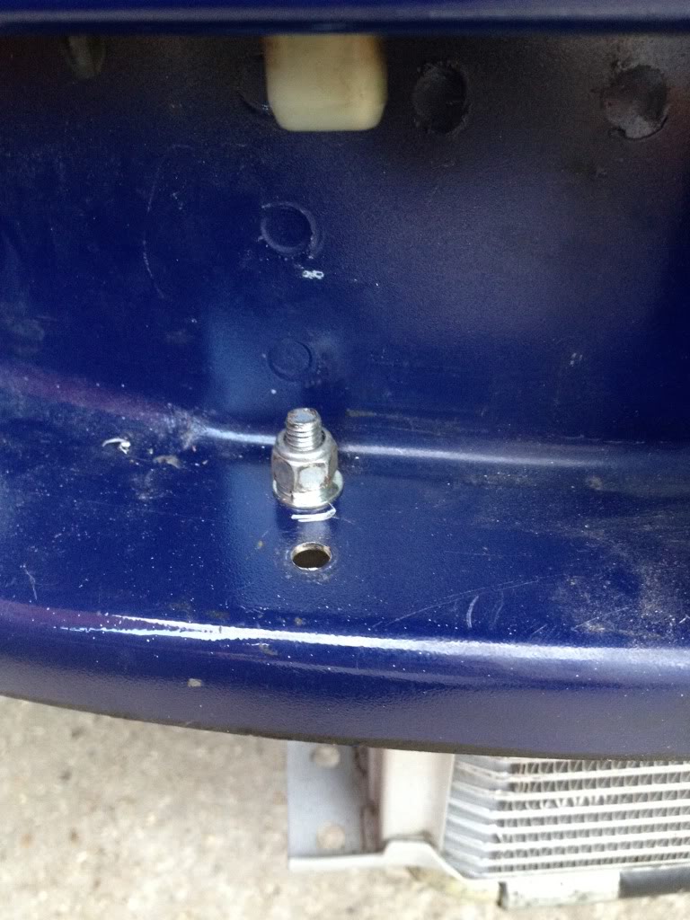

Bonnet Bolts – I have lost mine and that is the only piece of bodywork I need to attach to the car.

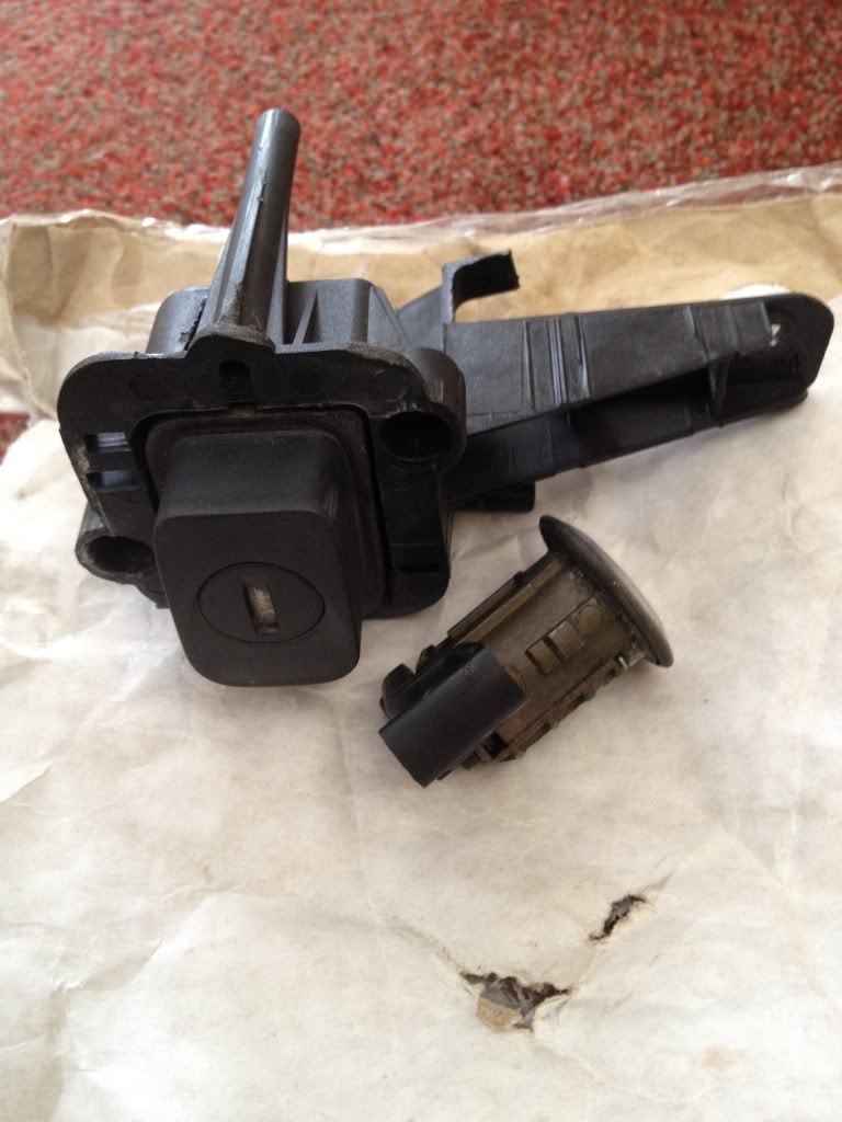

Lock Set – (well part of it) as I snapped my key in the ignition barrel.

So now I nearly have a complete lock set..... The only parts I am missing are the passenger door lock and the boot lock this is because Williams Paul bought the door and boot off Paul but Paul did not remove the locks before selling them. Anyway got in contact with Williams Paul sent him some money over and he said he would post the locks out to me. Thanks again guys!

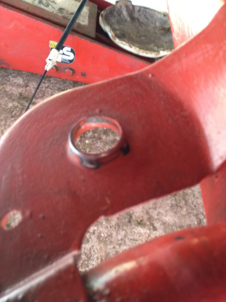

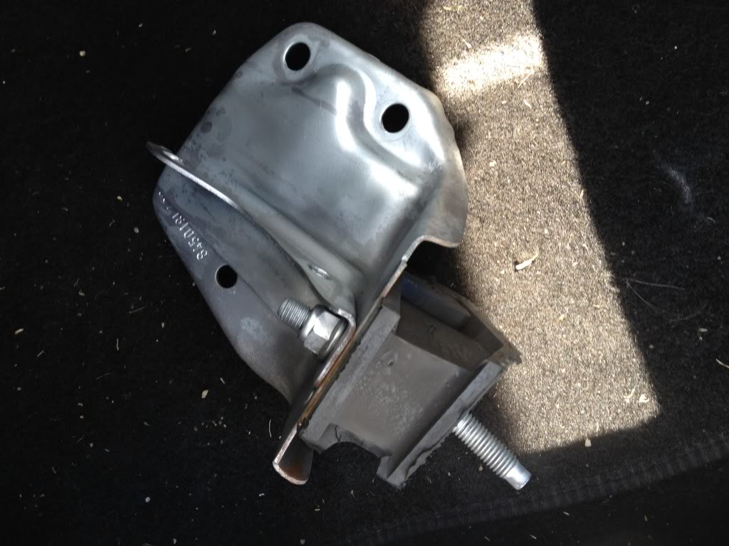

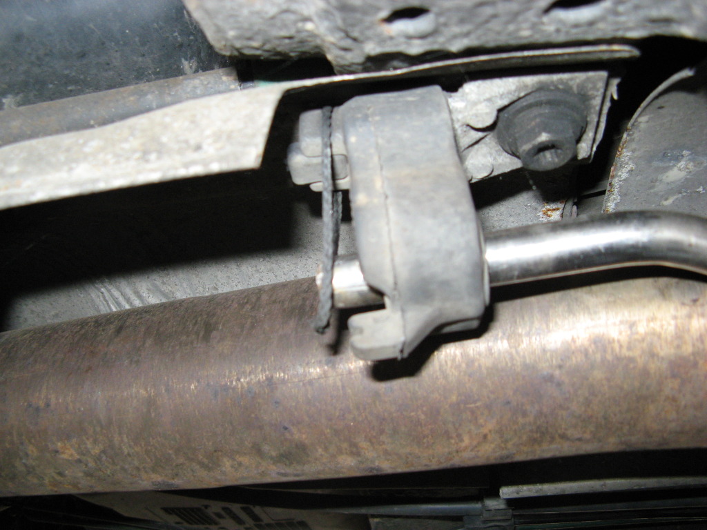

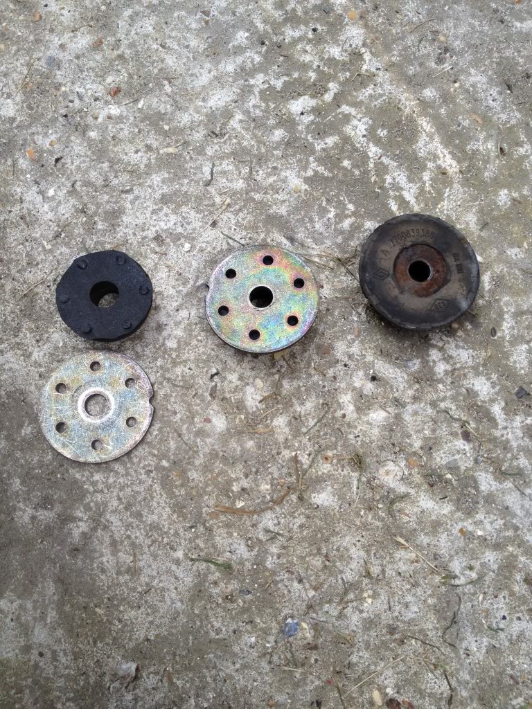

I started doing a little research on the exhaust mounts for the MK2’s as they are notoriously pony! I came across this thread. http://www.cliosport.net/forum/showthread.php?558057-Uprated-modified-exhaust-mounts (really useful thanks Yellow Dave). After having a quick read through and establishing what I needed I jumped on eBay and ordered the following bits for the rear and the centre exhaust.
Rear - http://www.ebay.co.uk/itm/POWERFLEX...arts_Vehicles_CarParts_SM&hash=item256de70734
Middle - http://www.ebay.co.uk/itm/POWERFLEX...arts_Vehicles_CarParts_SM&hash=item231adcb022
So once these turn up I’m going to make them up so I can finally get my exhaust mocked up in place so that when I put the manifold in position (because I’m extending it) I will see how far out it is going to put my exhaust all the way down the car.

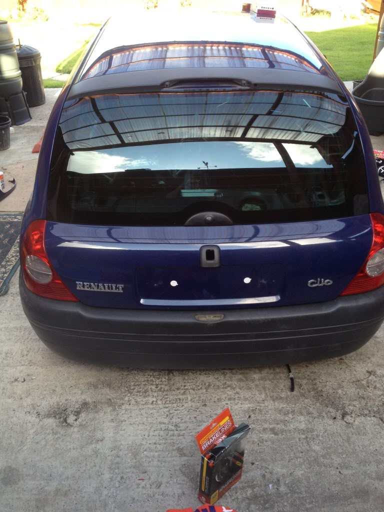

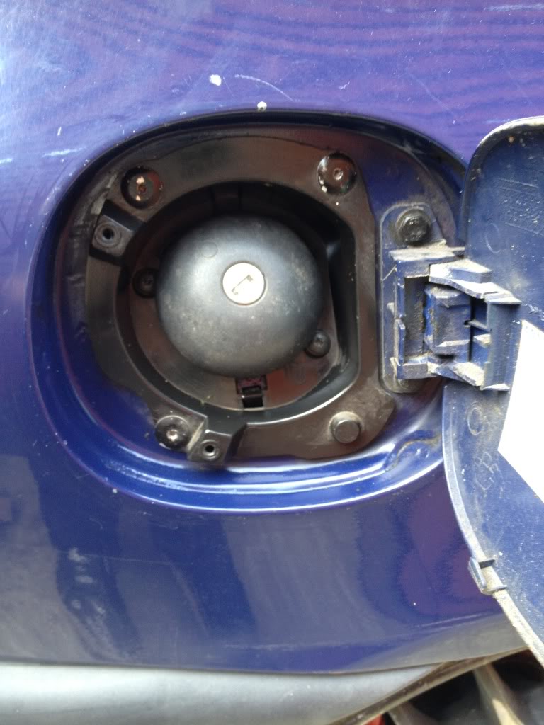

Well first of all i put the petrol cap in with my new key! Thanks Paul
Then the ignition barrel.
I did also attach the drivers door lock as well but did not picture that. I am just waiting on the passenger and boot lock to arrive in the post from WilliamsPaul Thanks again bud.

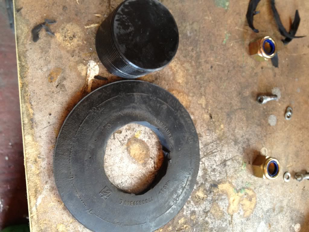

I then moved onto removing the existing rubber from the rear exhaust mount. I started but cutting it out but got really bored of that and decided to get fire involved to help the process. With any luck my exhaust mounts will turn up shortly so i can fit the exhaust in place which will help when making the manifold so i can see how far back i need to go.
Lee turned up not long after the burning had stopped. It then started to spit with rain which is bloody typical of the English weather but we carried on regardless.
I didn’t actually stop to take any pictures of this (stupidly) but what I done was mark out a template for the bits around the ‘B’ pillar I removed so that I can repair that prior to the main hoop being welded into position. That’s all that got done really as it was fine tweeking, deburring and removing paint in preparation for my mate to come down and weld it in place.

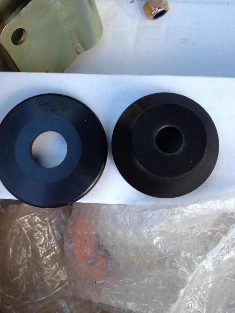

Anyway I went and picked up the big box pictured below from a local supplier and the little one with fragile wrapped around it from the post office as I missed the collection.
Behind box number one:

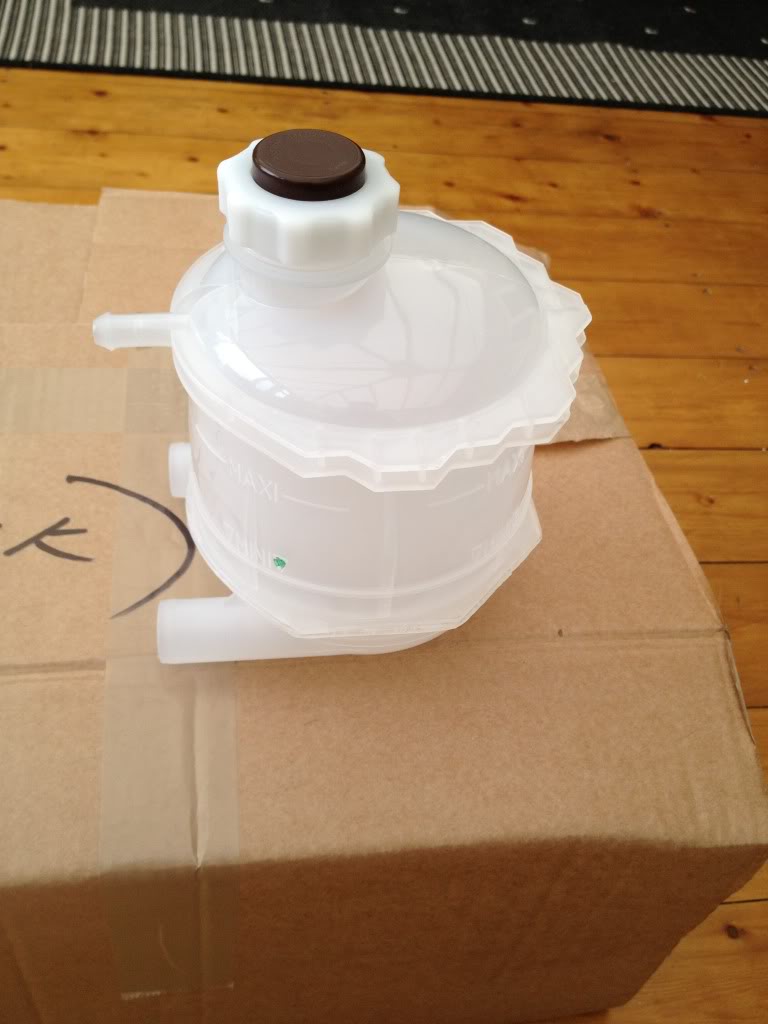

A brand new Coolant Bottle just to tart up the engine bay a little.
Behind box number 2 is the following goodies.

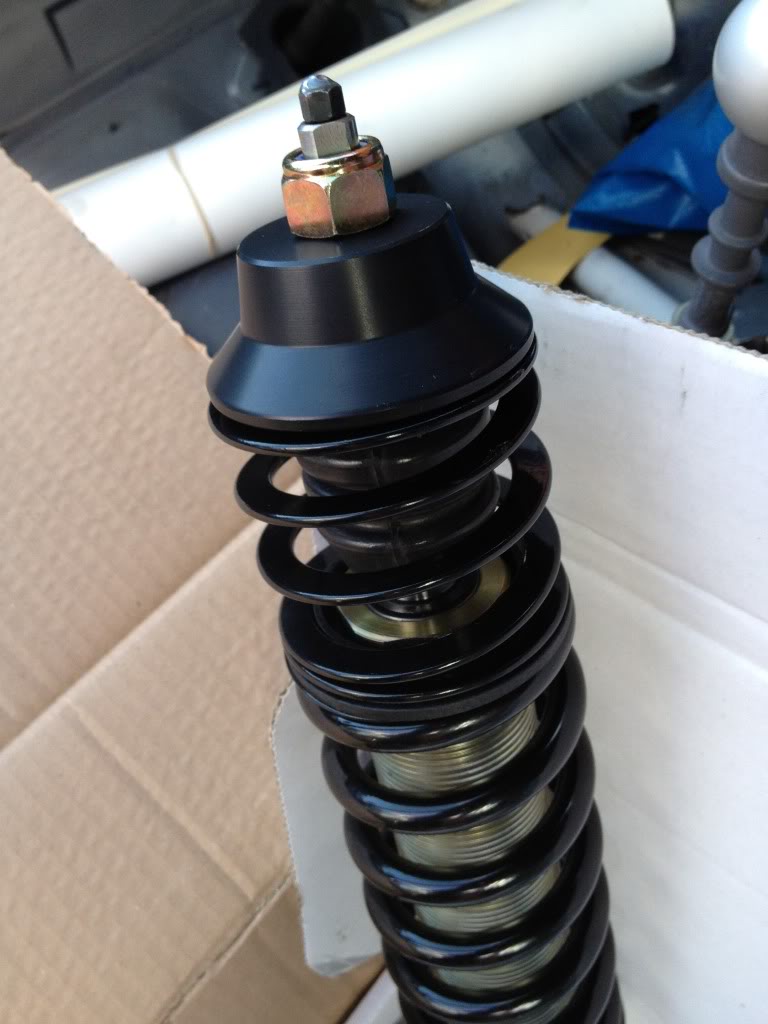

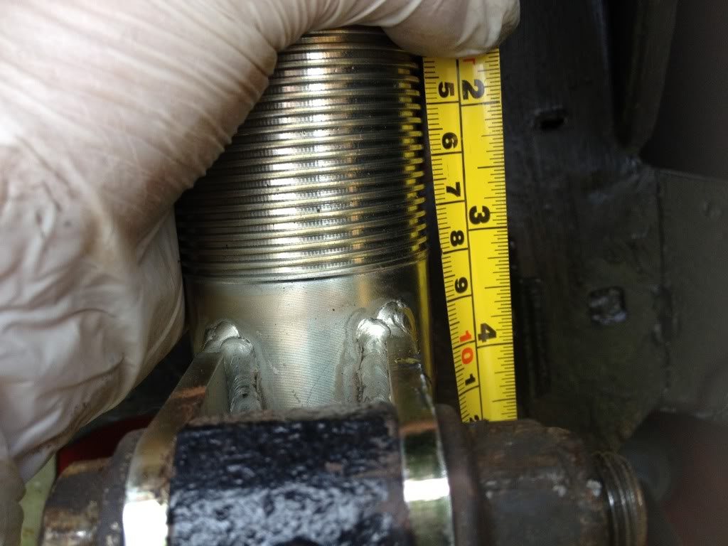

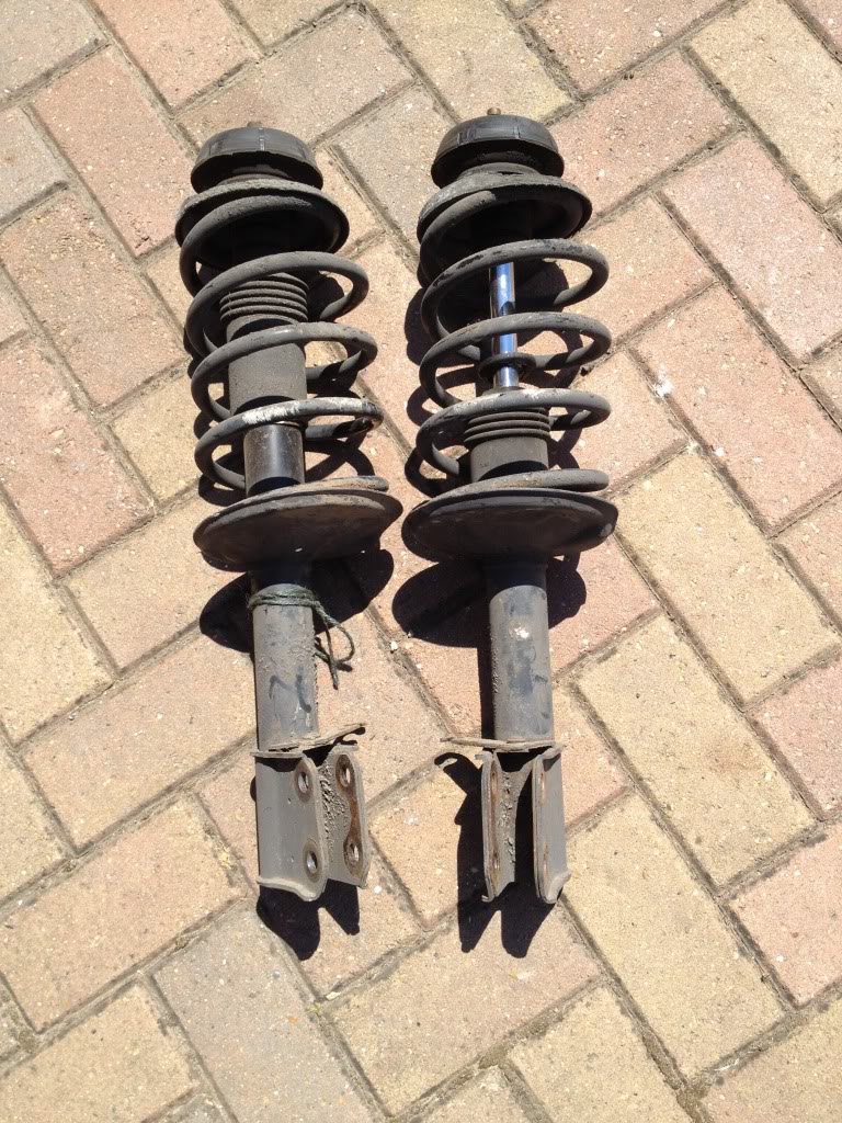

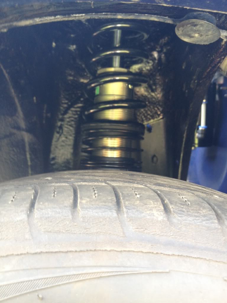

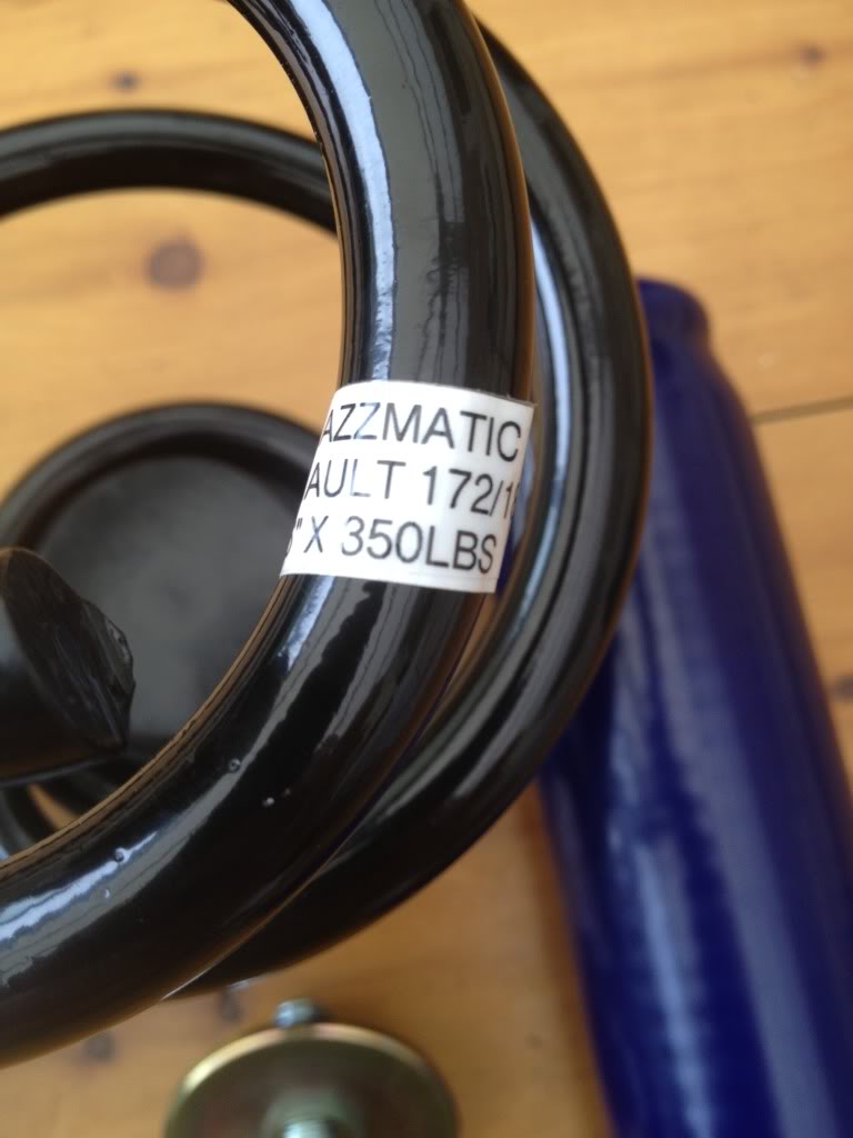

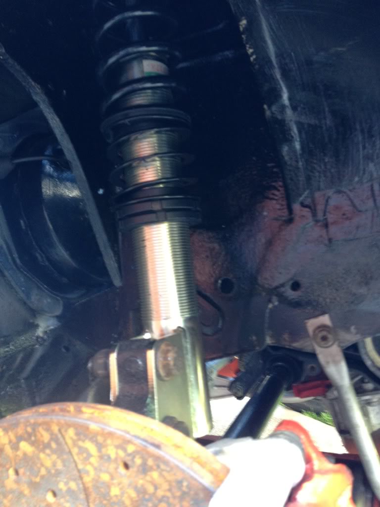

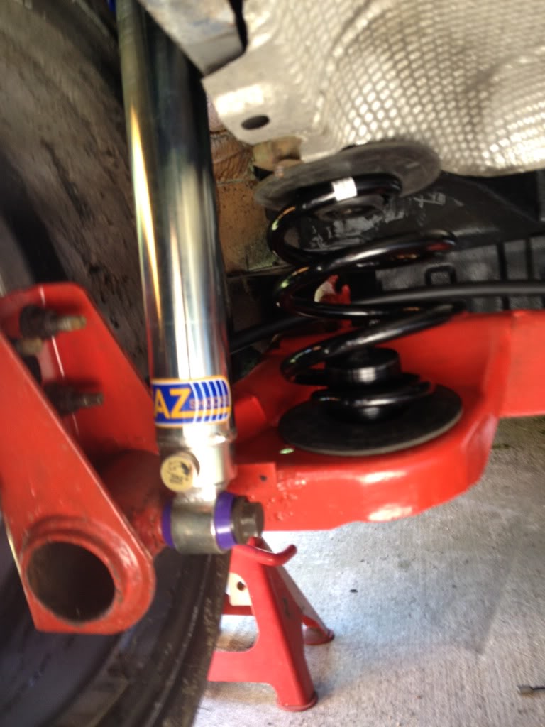

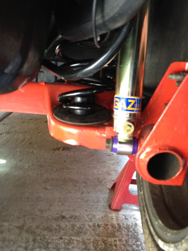

Brand new Gaz GHA coilovers. When I ordered them I advised that the car was mainly going to see track so they gave me 350lb front and rear springs. This is slightly different to the set up I got my mate for his fast road car. He got 275lb front springs and 250lb rear springs. (PH2 172).
All of the bits are starting to come together now. Just need to bolt it all together and it will be done.....if only it was that easy.

  3. Main hoop welded in the car.
  4. Front door bars and ‘A’ pillars mocked in place ready for welding in.

Well this evening after work was surprisingly productive. Although I had removed some bits I didn’t want to I really did have to once the welder came out.
Anyway first thing was first. We originally put the the feet in position for the main hoop. We had tack welded them in place and offered the main hoop up last time we were here. Once we had the main hoop in place it became apparent very quickly that the feet were too big.
First thing on the cards was to cut the feet down which is what we did,
Passenger side
Drivers side
We then got the scurfer out and started cleaning up the material ready for welding.
While my mate was doing this I was adjusting the templates Beeson and I had made earlier in the week so that it would make it easier for Luke to weld in place.
Unfortunately I forgot to take some pictures of these but you will see them once they are welded in place.
The next thing on the cards was to weld the foot plates in place. So out came the welder and Luke got welding. One thing I forgot to mention to Luke was that I had put the fuel tank back in place and that the under seal was still around the areas he was welding. I left him for two minutes come back and see pepsi max splashed on the underneath of the car. It caught fire then lol.
After that I thought it was best to remove the fuel tank as the weld was extremely close to it and I didn’t want to melt t in situ.
So off came the heatshields.
Then the hand brake cables where disconnected and finally out came the fuel tank.

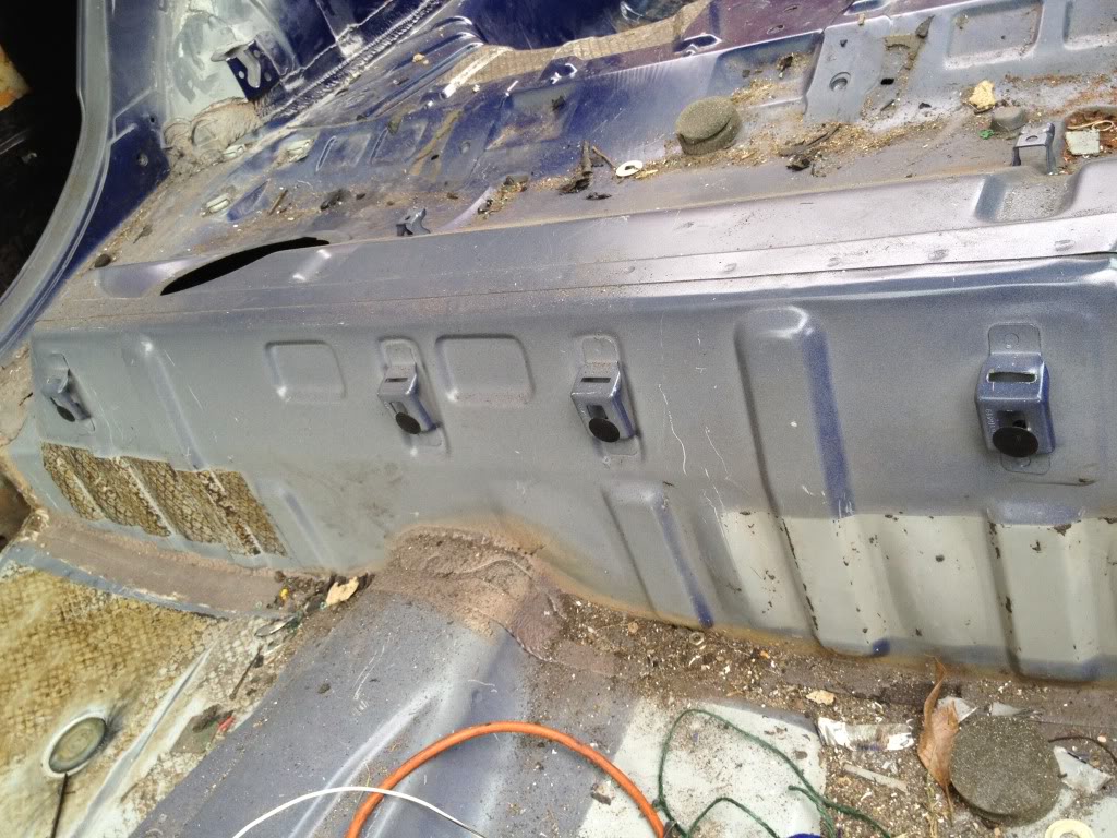

Next step was out came the scrapper and remove all of the underseal around the area that Luke was welding. After that was done the welding could begin. I was laying on the floor on fire watch whilst he welded.
This was the end result.
Passenger side: (didn’t get one of the drivers side as at this point I had packed up stuff in the car and couldn’t be bothered to remove it for one picture)
We then offered the main hoop of the cage in the car and realised that we would have to flatten I small section of the back weld so that the feet would sit properly.
It was getting late at this point so it was decided to call it a night.

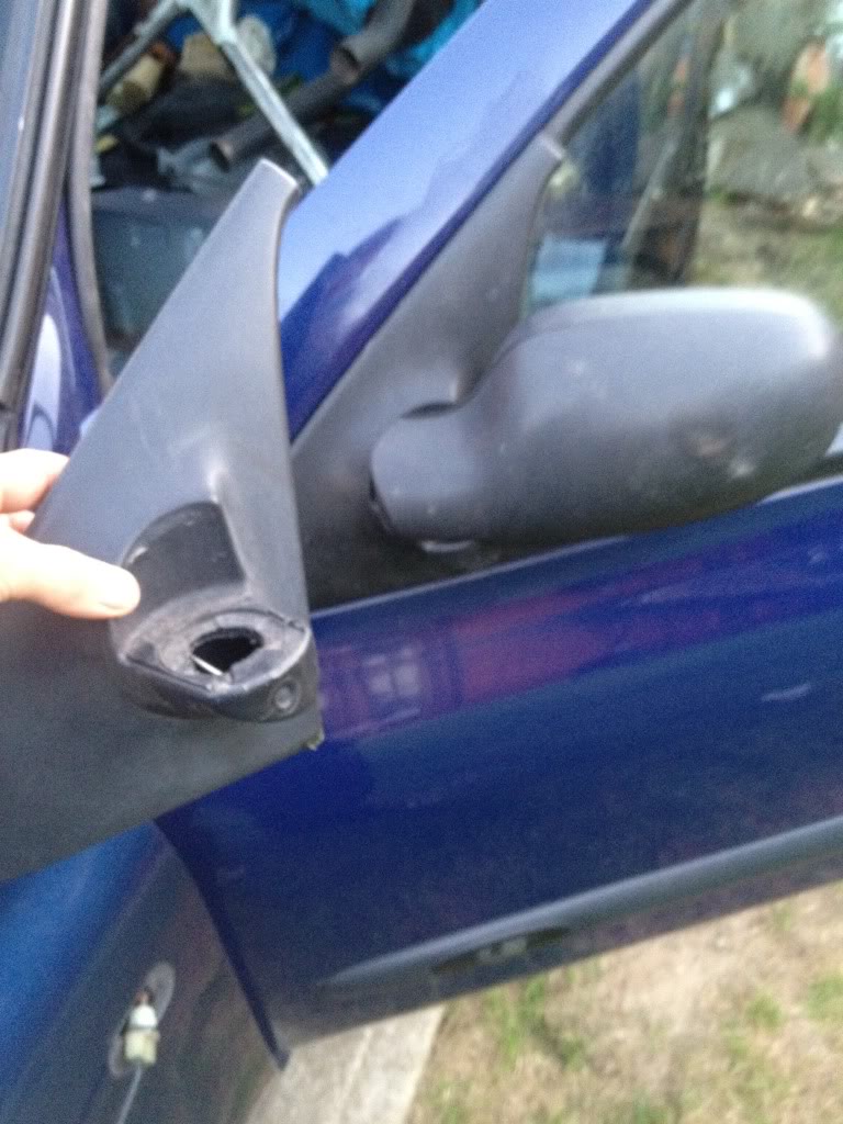

First of all I removed and cleaned behind the drivers side wing mirror and then replaced it. Then I removed the broken passenger one, gave it a quick clean on the paint work and then fitted the new passenger one I had got from the local scrappie.
Then I just put my coolant bottle in place (didn’t connect the hoses)
Much better now really finishes off the bay!

I got home and had a few parcels:
New Middle and Rear exhaust mounts!
Receipt from the stud conversion I got of Andy so I know what ones to get! Thanks again for posting it mate!

  3. Main hoop welded in the car. (Another two hours and should be done)
  4. Front door bars and ‘A’ pillars mocked in place ready for welding in. (god knows)

  7. Manifold Flange cut out ready to be surface ground at work. (If my mate gets his new compressor then I will be doing this Saturday afternoon)

in response to your text this morning mate, pictures of my centre exhaust mount,
sorry if theyre not all that good but i didnt get the jack or anything out today so had to kind of crawl under to take them!!
Thanks dude where abouts is tht behind the hand brake?

First of all I thought I would tackle the rear suspension. So I jacked the car up and put stands underneath the sills.
First thing I did was remove the rear shocks and rear springs.
I needed to fit the adjuster platform to the rear beam but as I had painted it, it didn’t fit. So I removed the paint from around the lip.
I then bolted the adjuster and the main thread to the underside of the rear beam and put the rubber on the top of the mount and placed them in the correct position.
The next step was to put the new shocks in place. I did remember from doing a mates 172 ages ago that you have to shave a little bit off of one of the rubbers to make them fit. So I did this:
I trial fitted them and had no joy so I removed them again and then got a rasp to them to take a little bit more off. This was the end result.
I trial fitted them again and had no joy. By this point I was getting the hump so I walked away from the car (this was a mistake). I very quickly got roped into removing three of their doors off of the log cabin and shaving the bottoms of them so they shut nicely as currently they are getting stuck.
After doing this I was a bit calmer and thought it would be a good idea to get stuck into the car again.
I removed the mounts and then did this to them as a last result to get them fitted.
Once this was done I fitted them once again and this time I had enough thread to get the mount through the hole! Happy days! With the mounts on I chucked the wheel back on and lowered her to the ground.
I gave the shocks a bounce up and down to try and get them to settle but instead of the shocks compressing the top rubber (inside the car) that goes between the chassis and the nut was moving on compression. I wasn’t very happy with this but left it to address at a later date as they had already pissed me off today. Another thing was that the rear ride height was way to high for me. I know I have to refit the fuel tank and a few other bits but that is not going to make that much of a difference. It looks like the rear adjuster will be coming out when I sort the shock issue.
I then turned my attention to the front shocks.

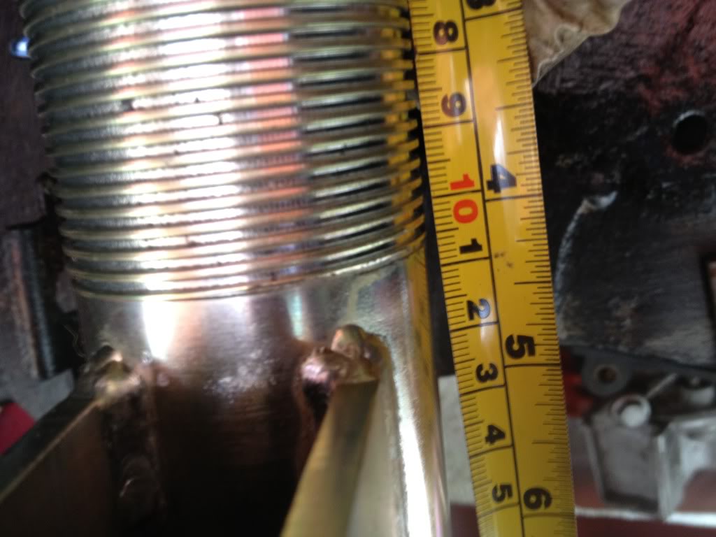

I trial fitted my AST top mount to find this:
This topped it off for me today as I couldn’t use the Gaz top hat as the diameter of the hole in the top was not big enough.....great.
I pretty much packed up for the day after that as I was on the verge of getting a hammer to make the rest of the parts fit the car.
Saturday 30[SUP]th[/SUP] June 2012
Reasonably early start for a weekend and I had the pleasure of Beeson’s help again.
First of all I showed him the problem with the AST’s and the Gaz coilovers.
He tried thinking of different ways to get around it but I wasn’t particularly happy with machining the AST top hat (as this would really weaken it). Also the Gaz top hat had strengthening on the underside so I was not really happy with drilling out the hole and doing that. The only option was to make the ID of the spring bigger. It was only 1.5mm different (approximately) so I set about using a file and enlarging the hole.
Beeson very kindly had brought two good condition rear rubbers to replace the ones I hacked so he removed them and replaced the bottom mounts with his ones and only put the washer (and not the top rubber mount) on the top. We did the suspension travel test and unlike last time the shock stayed against the chassis and the shock compressed rather than moved.
Beeson then came in and grabbed a file and set to work on the other spring. I had already been filing for about 30 minutes and could not see light at the end of the tunnel. After Beeson doing it for about 10 minutes I basically said f**k this im going into work to use one our our air compressed hand held grinders.
The plan was for Beeson to remove the rear adjusters while I was gone but before he could make a start he checked his phone and realised he was 30 mins late from picking up his other half.....OOPS.
Anyway I went into work armed with the springs and top hats. 30 minutes later and I was left with this:
Whilst I was in work I did manage to get the 4[SUP]th[/SUP] mount sand blasted to remove all of the rust and s**t. Nice and clean.
I then built up the shocks with a bit of grease and put the top mounts in place. :)

I had forgotten that Beeson had not removed the rear adjusters so whilst the jack and the axle stands where at the back of the car I thought I would remove them.
So I removed the adjusters and the threaded tube that the adjuster sits on. As the adjuster has been removed I though it would be best to put the OE rubber in place so the spring does not ruin the rear beam platform.
One OE Rubber Spring Platform and the adjustable tube that the adjuster sits on.
One hole cut:
I then did the same for the other side and fitted them to the car along with the spring.
From this:
To This:
Lowered the car back on the floor and this was the rear arch gap. Wasn’t too pleased with this as it doesn’t appear to have moved, even with the adjuster removed. Perhaps it will go back down a bit once I fit a few more things to the car.
Next I made a start on the front coilovers.
So jacked the car up, removed the front shock, replaced with the coilover and fixed the AST top mount in place as well. I had preset the measurement from the bottom thread of the coilover to the locking platform at 80mm just to see how high/low the car would be. It was a complete guess as the AST top mount is a lot shallower than the gaz item. As you can see in the below pics:
Anyway coilover in place and bolted up :)
Before jacking the car down I loctited in the four remaining wheel studs that I bought off of Andy (just because the wheel was off). I still need to buy 4 more studs and nuts for the nearside front as I had only purchased 12 off of Andy as he was going to run Locking Wheel Nuts.
I then did all this again to the nearside (apart from fitting the studs and nuts I haven’t got yet)
Lowered the car on the floor and this was the end result.
A bit low for my liking.

The remaining door locks to complete the set! Thanks a bunch Williamspaul much appreciated. Now all I need to do is fit them and get another key cut so that if I do snap it again I have a spare!

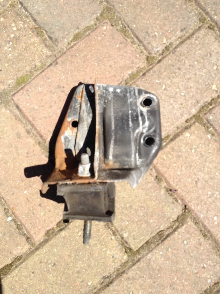

The freshly sand blasted 4[SUP]th[/SUP] mount that I had previously done at work yesterday got a little bit of the clear lacquer treatment.
Whilst that was drying it fitted the boot lock and the passenger lock to complete the set :)
I then tried to remove the remaining rubber out of the rear exhaust mount whilst the 4[SUP]th[/SUP] mount was still drying.
After about 5 minutes I got bored (didn’t have a sharp knife to remove the remaining rubber so was resorting to fire) Plus burning rubber stinks!
The 4[SUP]th[/SUP]mount was reasonably dry at this point so I fitted the rubber and here was the finished item.
As from the previous pictures you can see the front of the car is extremely low and that the wishbones are not in a good position at all! So I decided to raise them up 15mm to see how the car sits.
Before:
After:
After doing this I wanted to play with the AST’s as I didn’t really get the opportunity to do this yesterday. This is the angle of the suspension strut at the following position on the AST’s.
The reason I took this picture is because I was hoping to show a before and after shot. Unfortunately the 4[SUP]th[/SUP] mount beat me as it did not want to sit against the sub frame and gearbox in a nice enough way to bolt it together. I tried everything and eventually gave up.
I then lowered the car on the ground and was still not happy with how the car was sitting so I raised the car another 10mm.
Side Angle of the car:
Quick engine bay shot showing AST positioning:
I then turned my attention to the middle exhaust mount. I am using a ‘D’ shackle as I saw someone on Cliosport do the same thing with exactly the same powerflow exhaust rubber. I don’t mind copying a good idea if I see one lol.
Bolt in place and rubber on ‘D’ shackle:
Next thing on the agenda was the cooling system as I had a few hoses that needed to be modified to ensure that they fit the car. Plus as I am nt running a heater matrix I needed to put the pipework in such a way that it would route back on itself. My dad had recently replaced the shower. It jsut so happened that the pipe that the shower head runs up and down on was the correct size and made from copper. RESULT.
I will let the pictures do the talking:
The only remaining hose that was not fitted was the bottom rad hose but I have addressed that a bit later on.
Bit of Front bumper modification for the oil cooler.
Before:
After:
I then removed the front bumper, front slam panel and grille so I could get better access to the oil cooler and bottom rad hose.
I then made the following for the oil cooler to stop it swinging and potientially getting damaged on part of the car.
I then made the following bracket to solve my bottom rad hose problem:
I will let the pics do the talking.
The reason I had to do this is because the mounting points for the 172 rad are wider than the 16v rad. Because of the width difference the bottom rad hose was too far to the driver’s side of the car to reach the radiator. This was a nice simple fix and I was a lot happier doing it this way rather than modifying the water hoses.
The last thing I did for the night before packing up was move the oil cooler mounting holes closer to the radiatior as the rubber mounts that hold the top were constantly under tension which I did not think was ideal.
Much better now.

  7. Manifold Flange cut out ready to be surface ground at work. (If my mate gets his new compressor then I will be doing this Saturday afternoon) [50% there]
