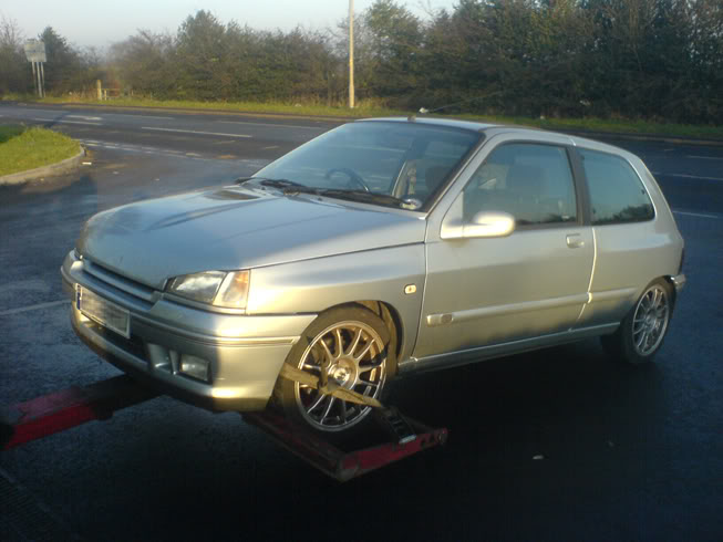

Well it was bound to happen after nearly a year and a half of trouble free motoring, she finally gave up :(
Looks as though some damp has got into the wiring and cause a shortage. Theres no power to the crank sensor therefor no fueling or spark.
So roll on tomorrow so i can get the damn thing fixed.
:dapprove:
Wish me luck!
Cheers Evryone got her sorted today. Turned of that some water had got into one of the connections on the loom that powered the crank shaft position sensor, causing it to short and blow it out. Connected it all back up and it fired up first time.
Thanks for all your concern, she lives to fight another day!

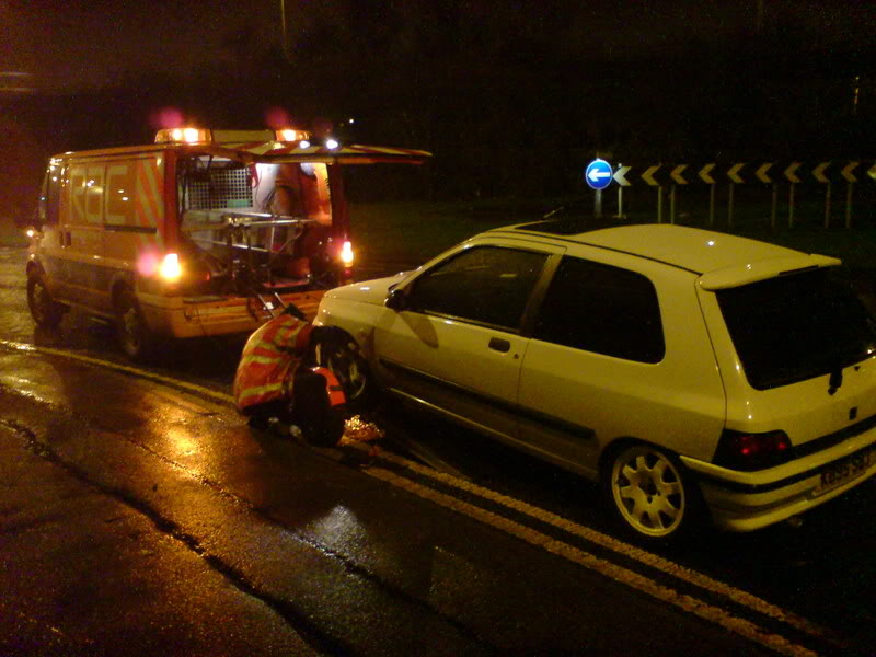

Hope you get it sorted...mine will be in pieces tomorrow, trying to disect the coil pack! Otherwise i'm pushing it down the road and calling the AA. :(
i really should get breakdown cover. i've probably paid three times more than what it costs getting towed home by a private company !!!
