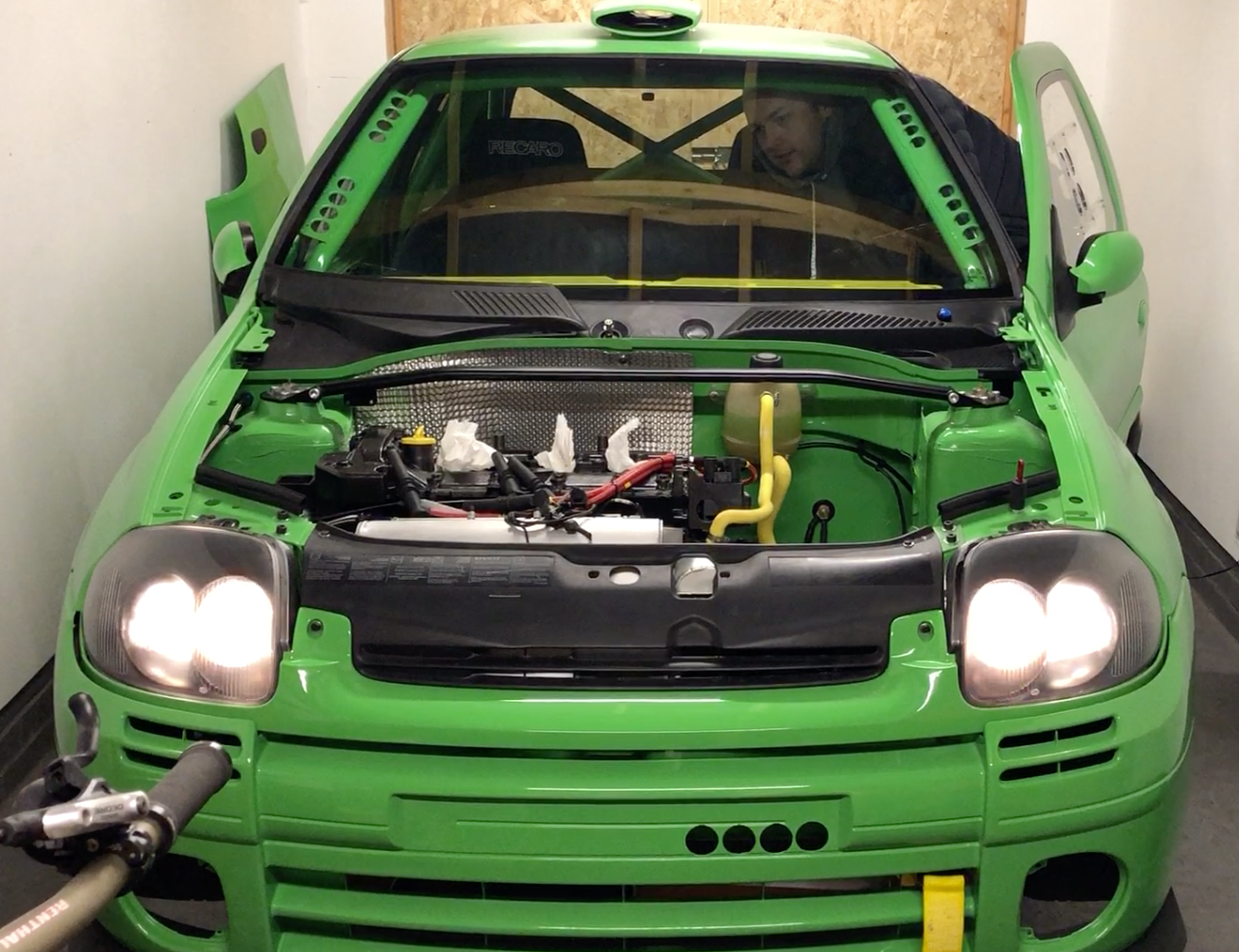

With this all done we set to the starting procedure. First up was to check the electrics:
Pressing 'on' and the dash lit up and the fuel pump kicked in, it was awesome seeing it come into life, by the fact this worked meant the external cut-off button was working (it won't run without it, but we checked it anyways and we then checked the lights...
Indicators all good, 1 rear bulb out I think and the rear numberplate light isn't working - I will look at that in due course. The headlights also worked but we had wired them up slightly wrong so the car looked crosseyed, easy to sort and a switch of pins in the connectors saw them all good.

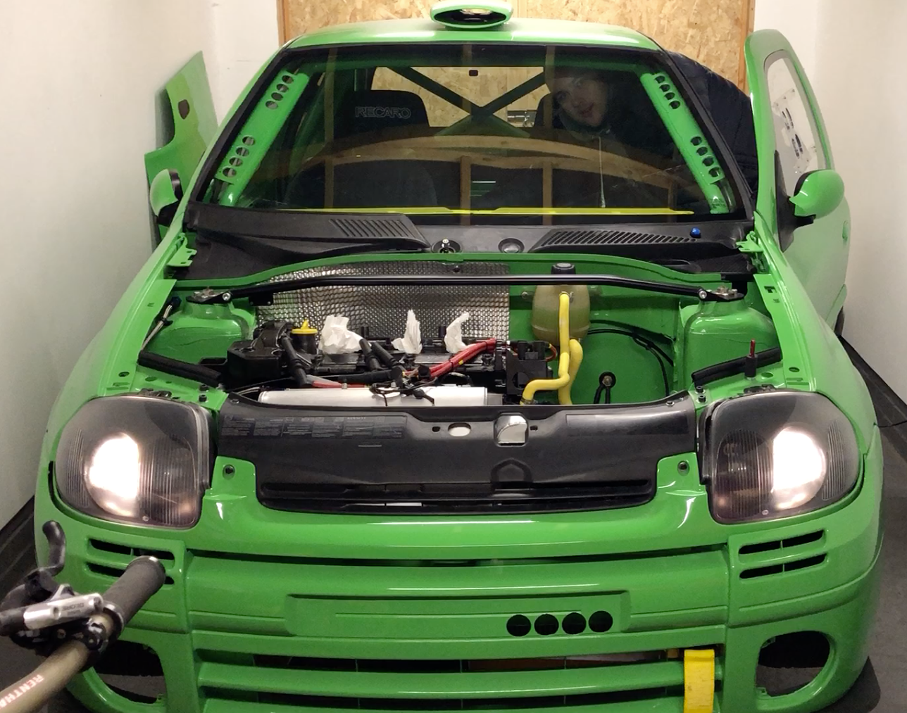

Headlights

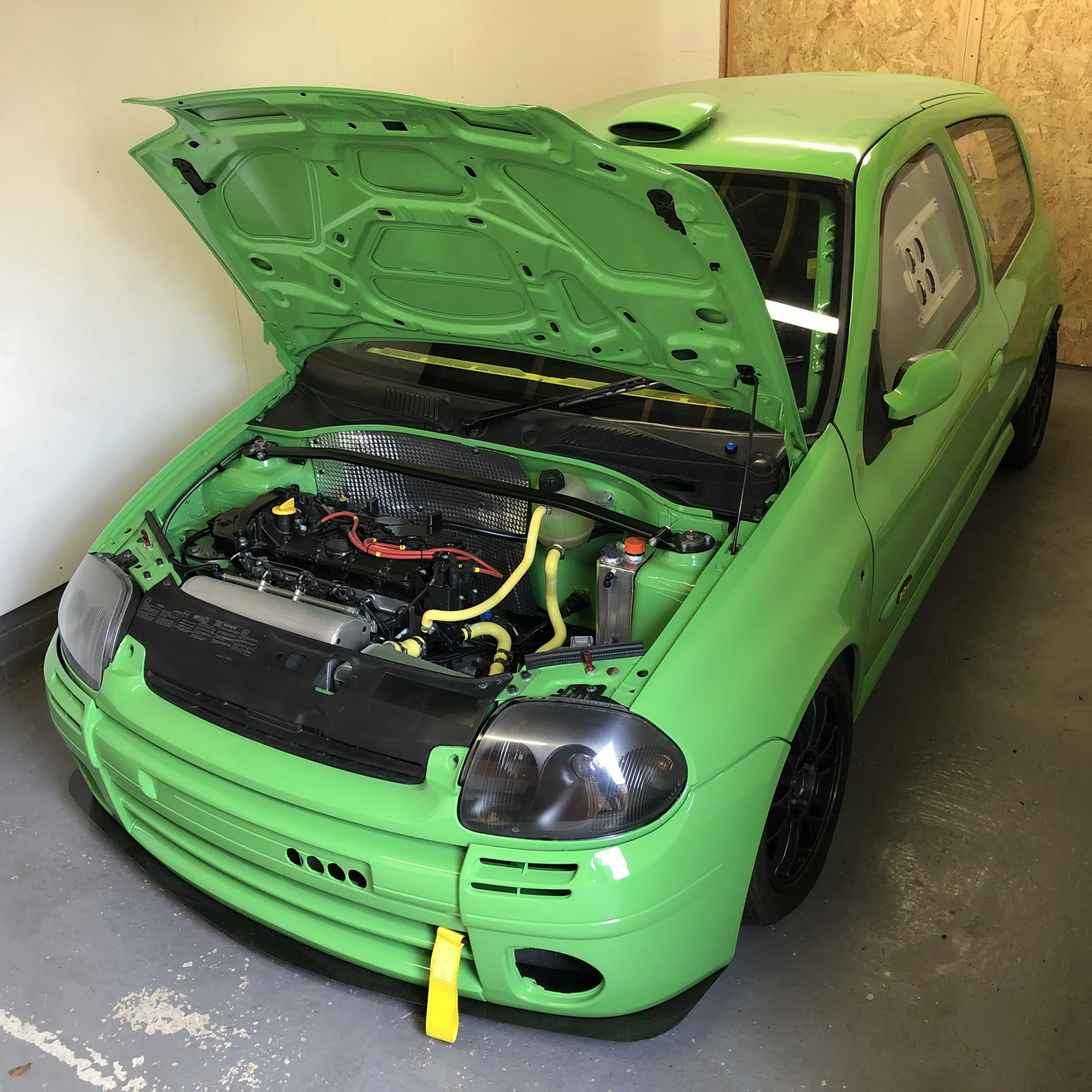

Fit bonnet

As previously mentioned there were a few bits I wanted to tie up before the car goes off for the exhaust build and then mapping. I managed to get a fair few of these done today so almost there.

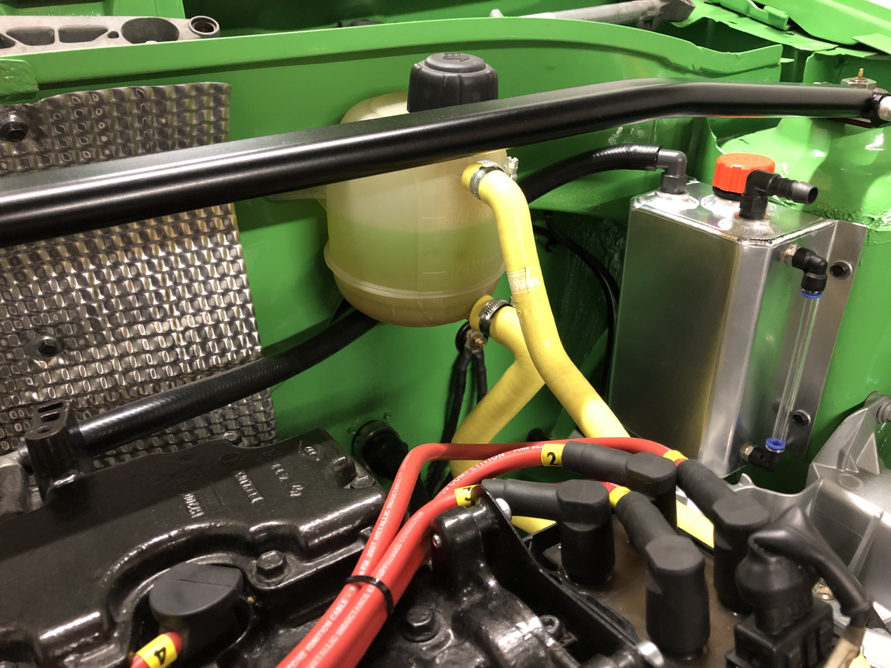

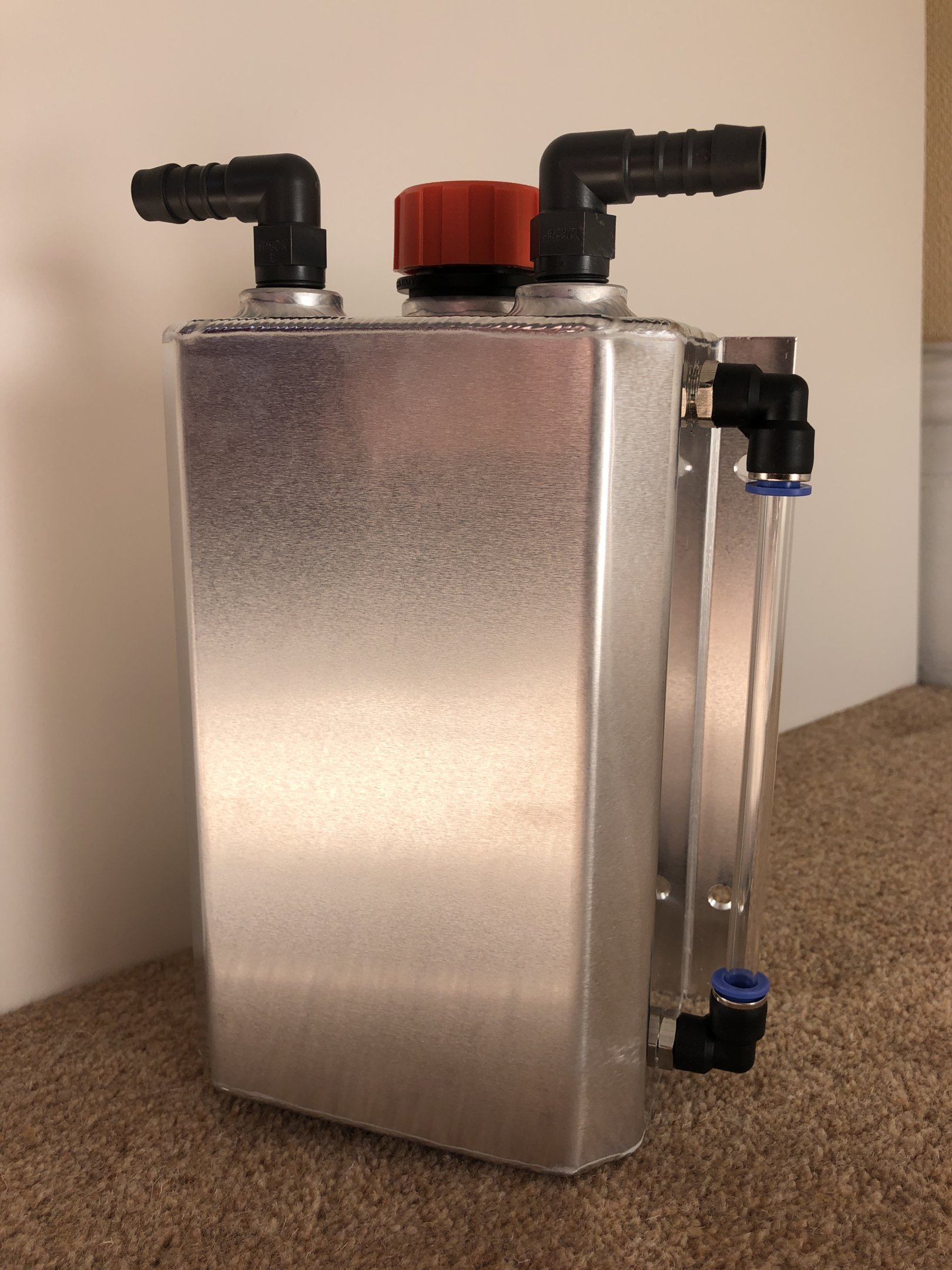

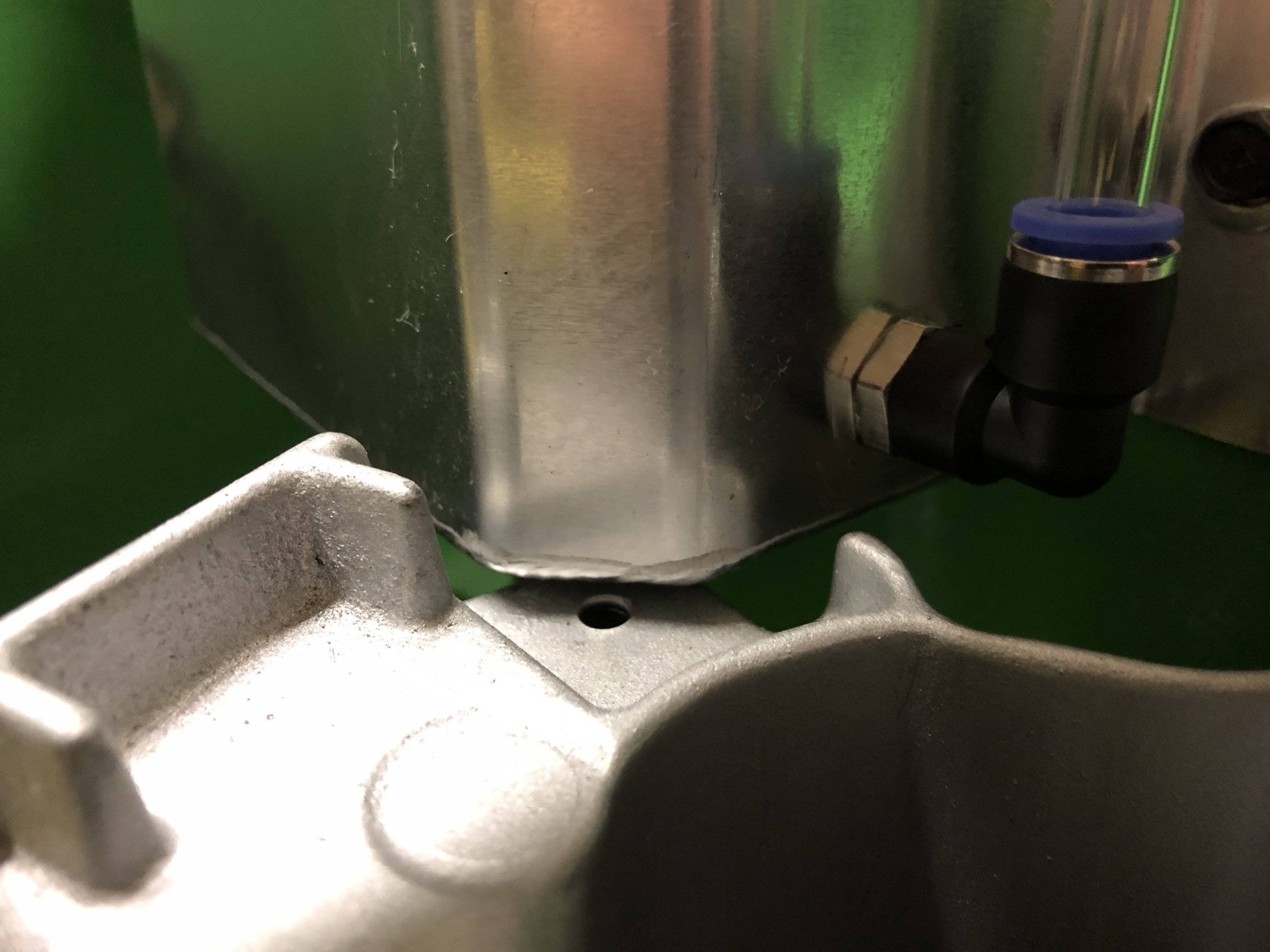

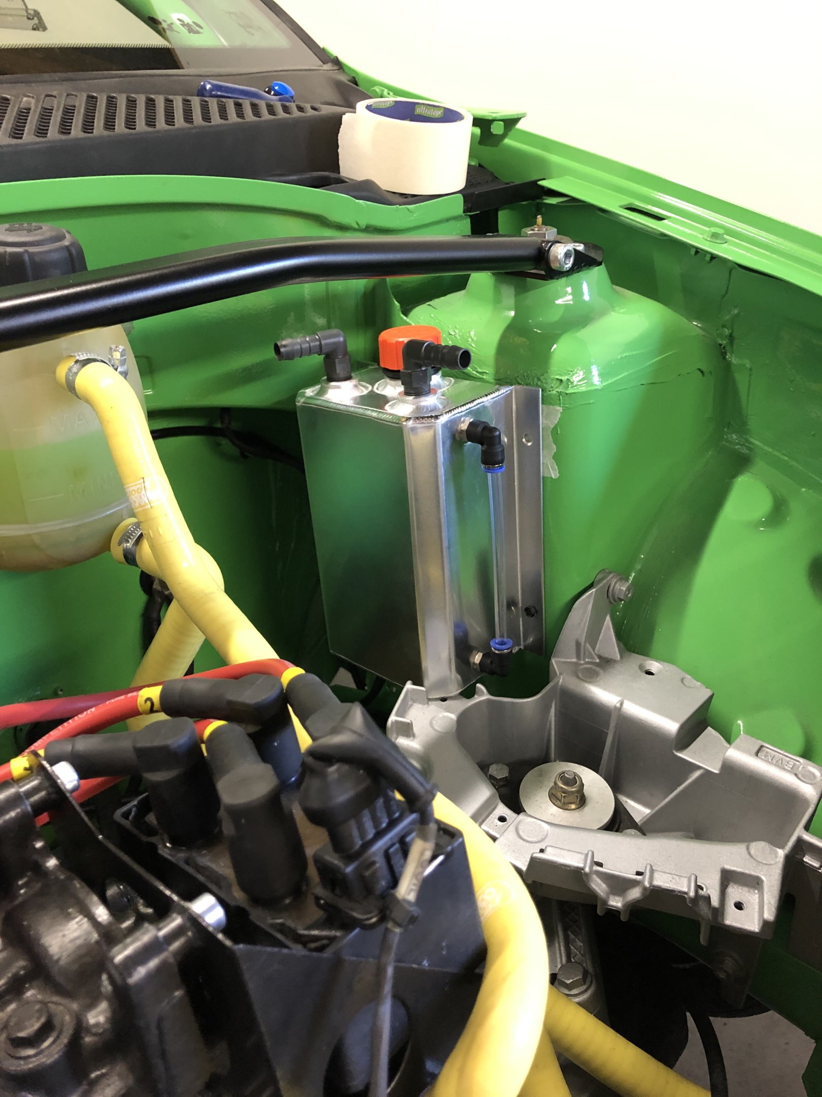

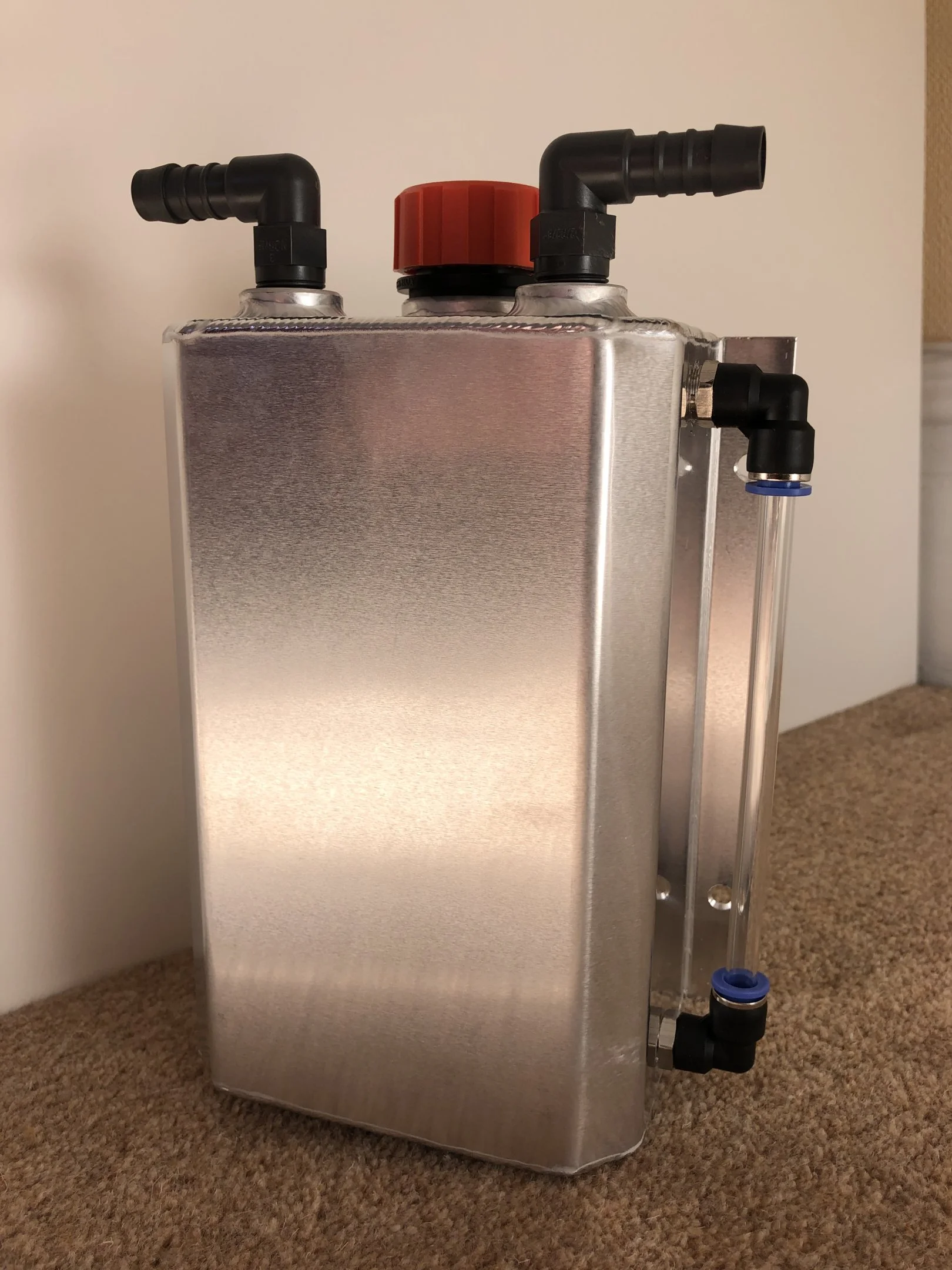

I received the Oil catch tank yesterday from Ralloy so I started up my mocking up and marking where this was going to go. The inner side of the passenger wing was the most obvious place and there was just enough room (width and height wise) literally mm's above the gearbox mount....
Once marked up the holes were drilled, painted, left to dry before all being mounted up.
New pipe to fit push on fittings also.

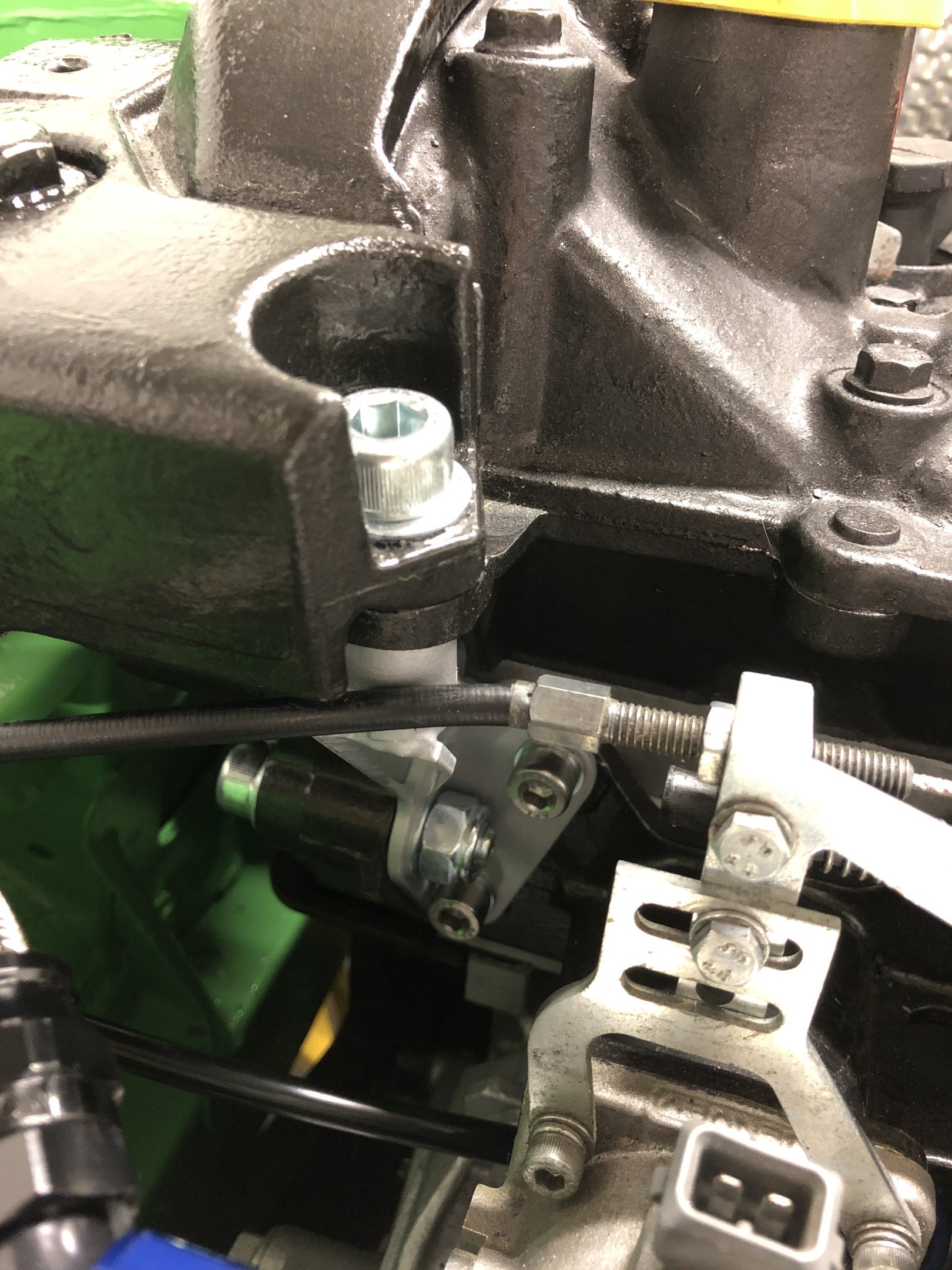

Next up was the Pure motorsport mount. I had no idea this mount even existed but I can see why it does.
A little bit of a pain to fit as the throttle body linkage had to come off, along with the engine mount, the cam case needed loosening and the engine needed jacking up.... but all good. Another tight fitment with the throttle cable - I may need to re-look at this.

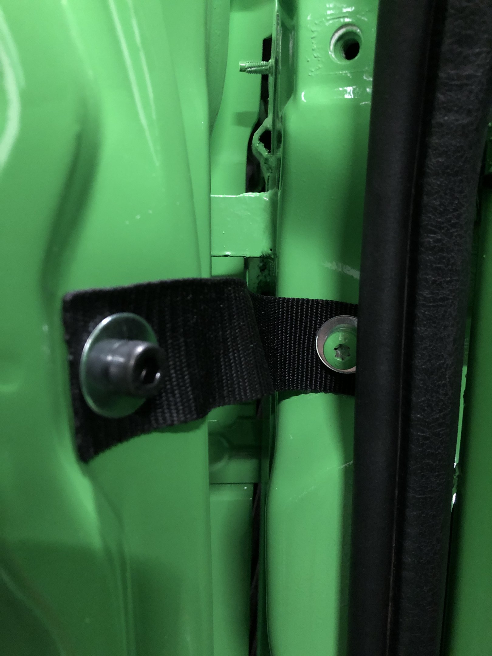

Next up was to make check straps for the doors. As the car is being transported to each place and the fact that each place will need to open the doors it was pretty important to get these done before the car left home. I managed to find some large webbed straps from my Ice hockey bag, these are a decent thickness so perfect for check straps.
I had to guestimate the length a bit as I could not open the doors very much in the garage. These were then cut, drilled and then I used a lighter to seal the edges. Then the doors were drilled and bolted through with large washers either side and on the original check strap bolt.
The wheels were all mounted up then ready to drop the car off the axle stands shortly. They are a bit of a mismatch of colours and tyres currently but thats only to move/map them on. Once moved I will then be removing them and sending them off for powdercoating.
That leaves 2 jobs, dropping the car off the axle stands and fitting the bonnet....

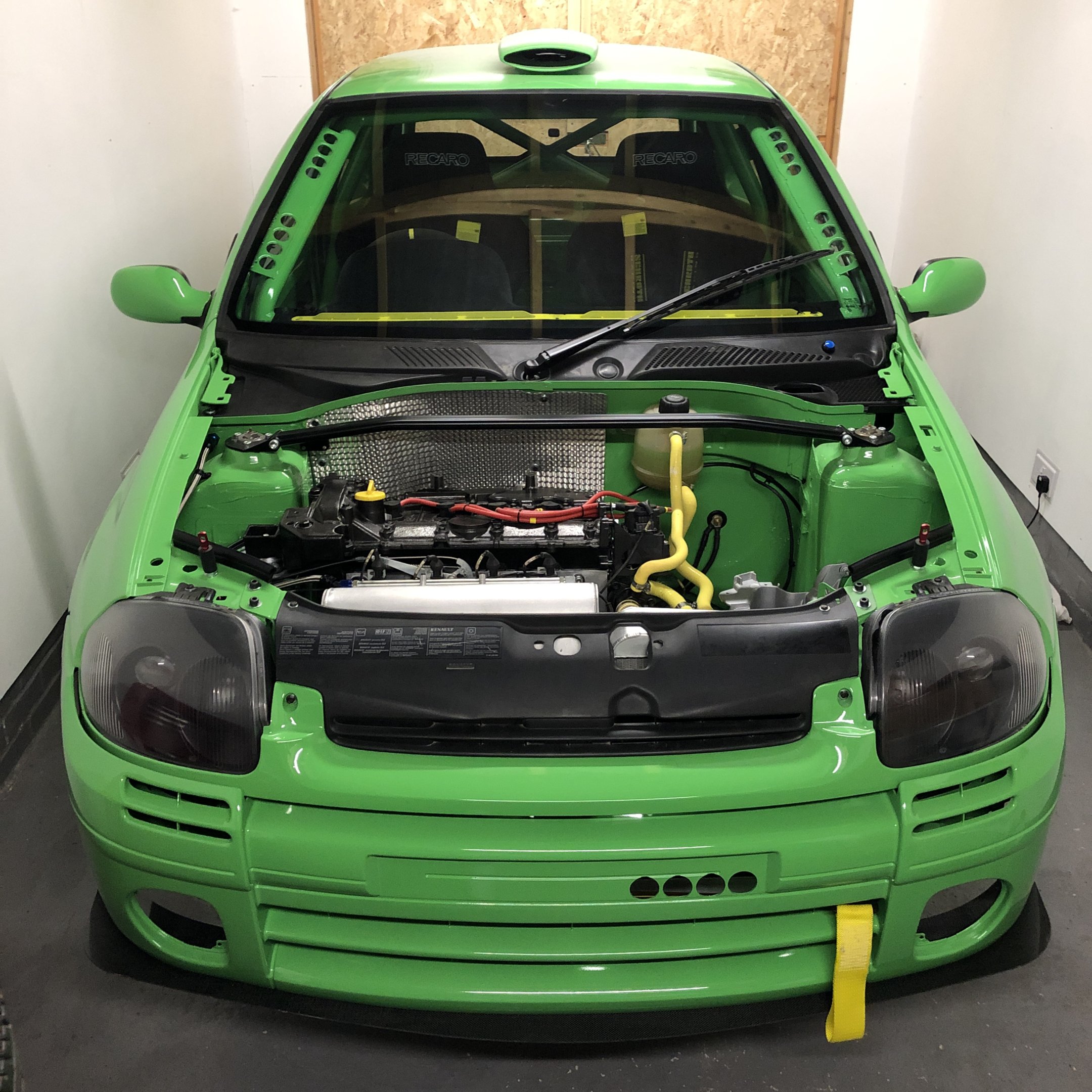

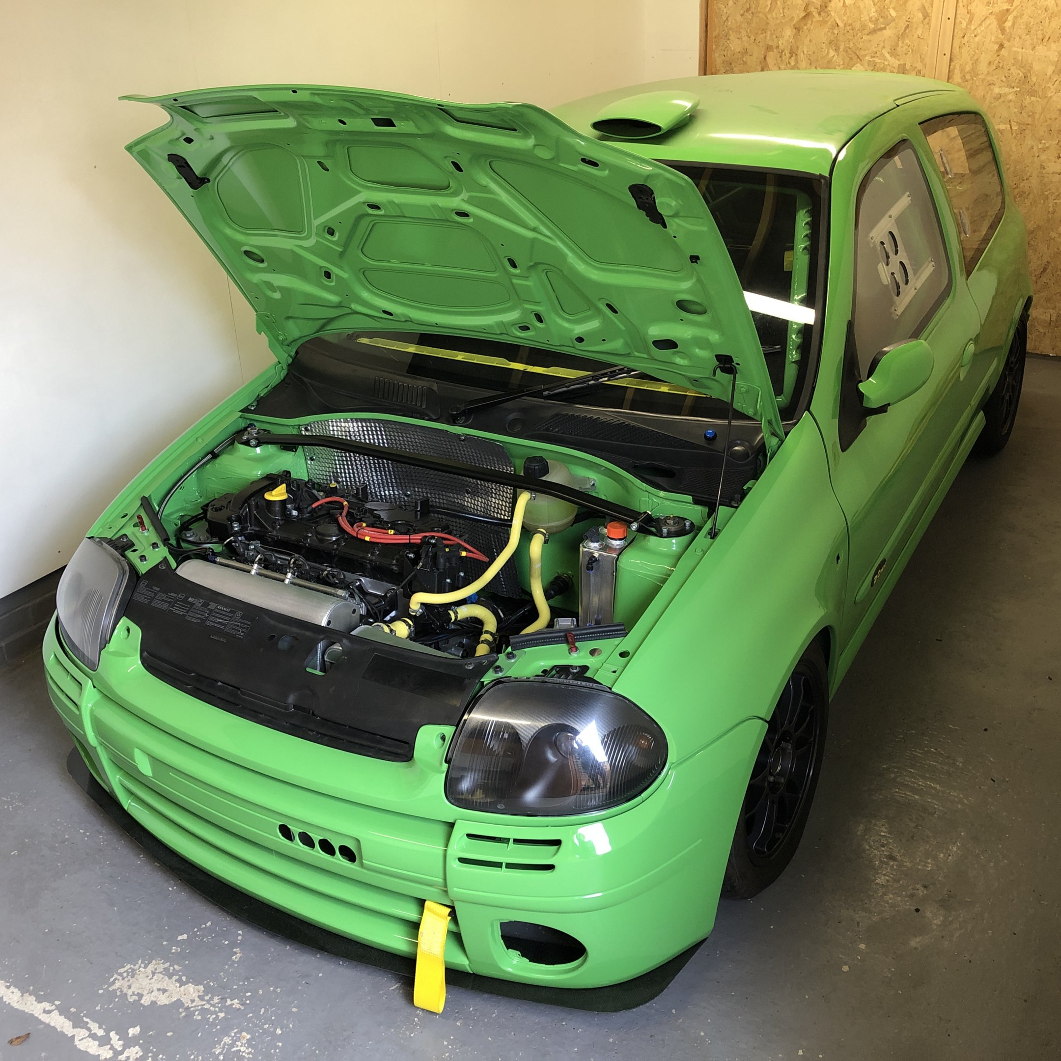

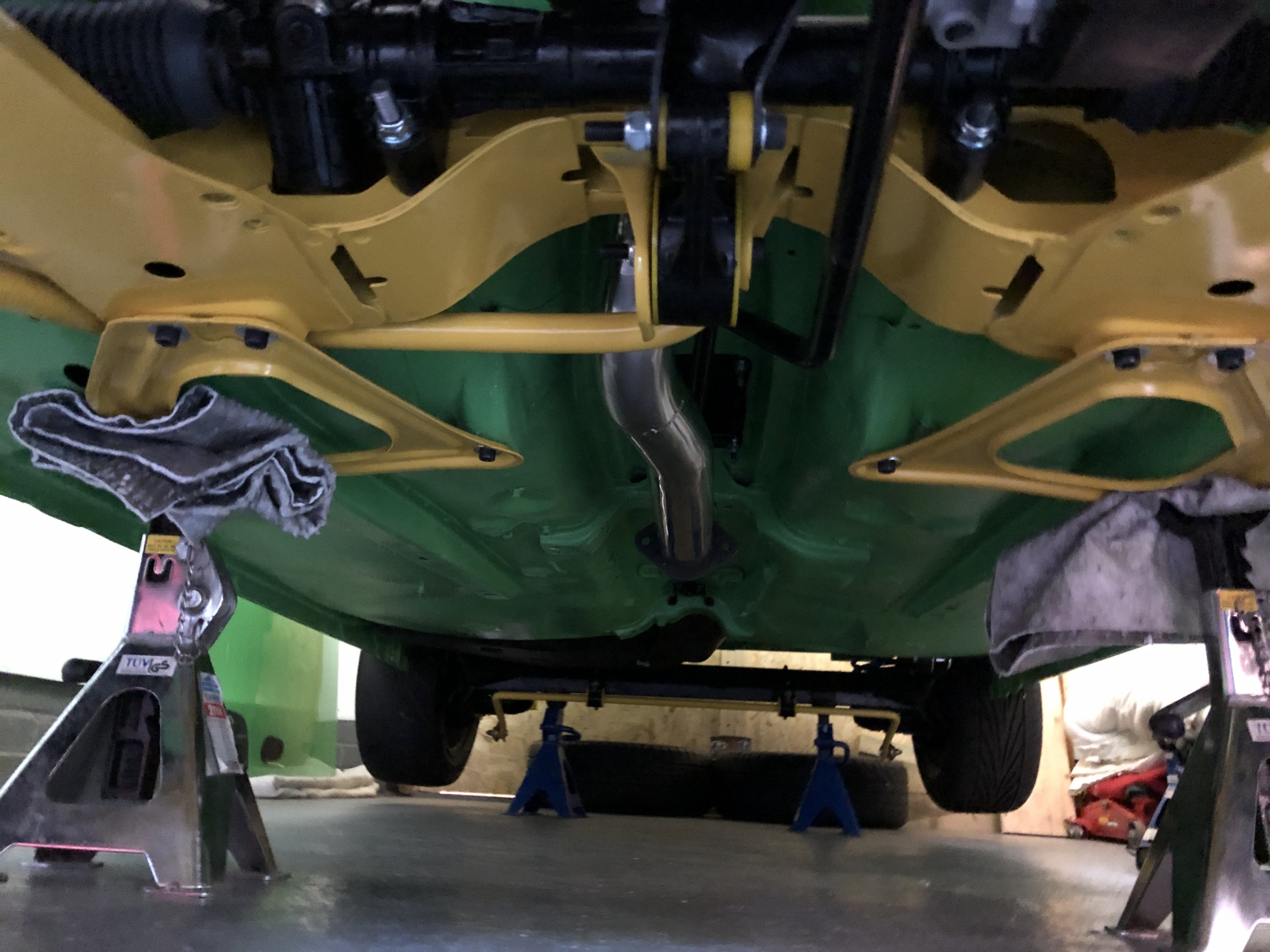

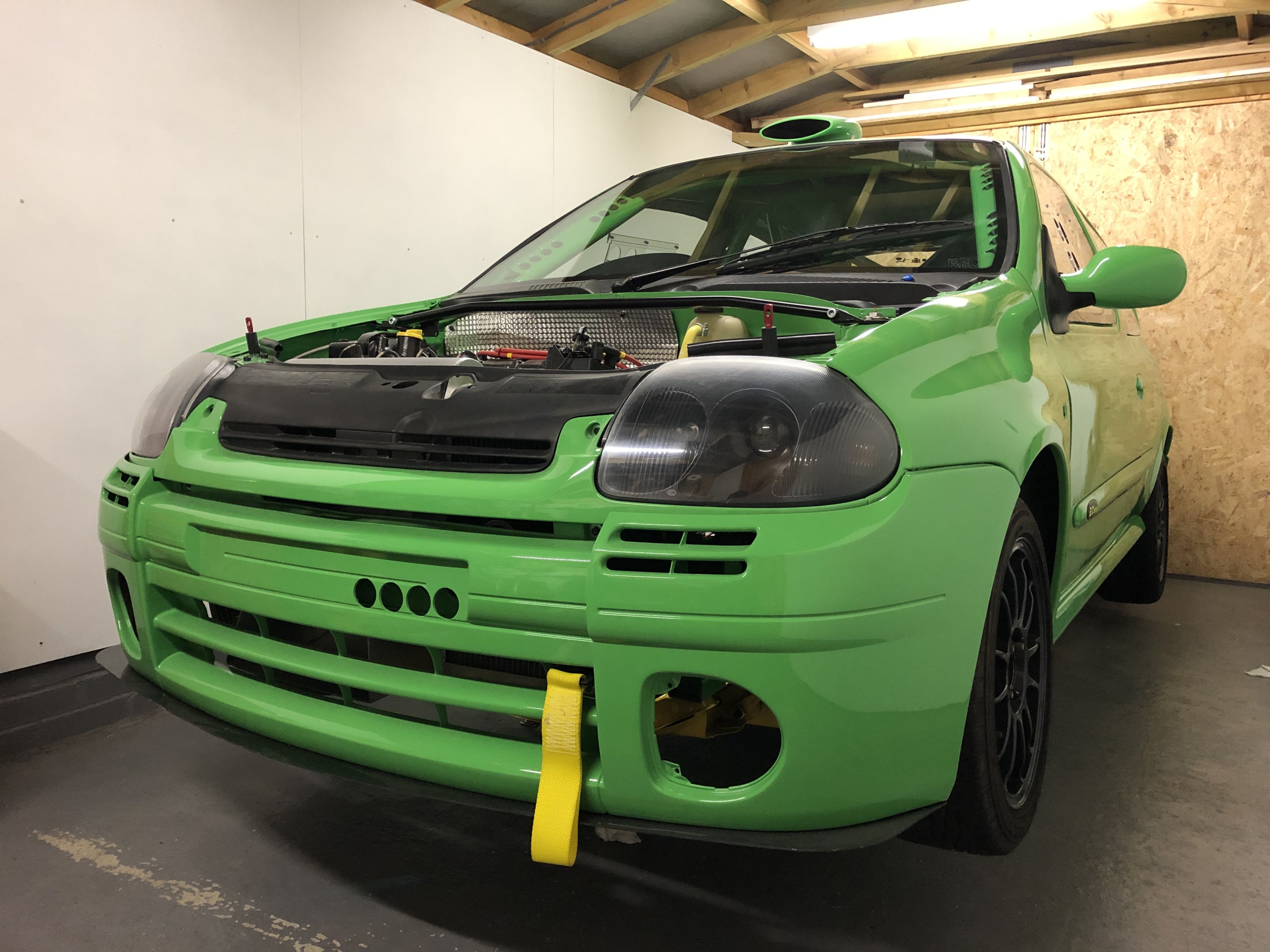

Just a couple hours spent today in prep for moving the car on tuesday.

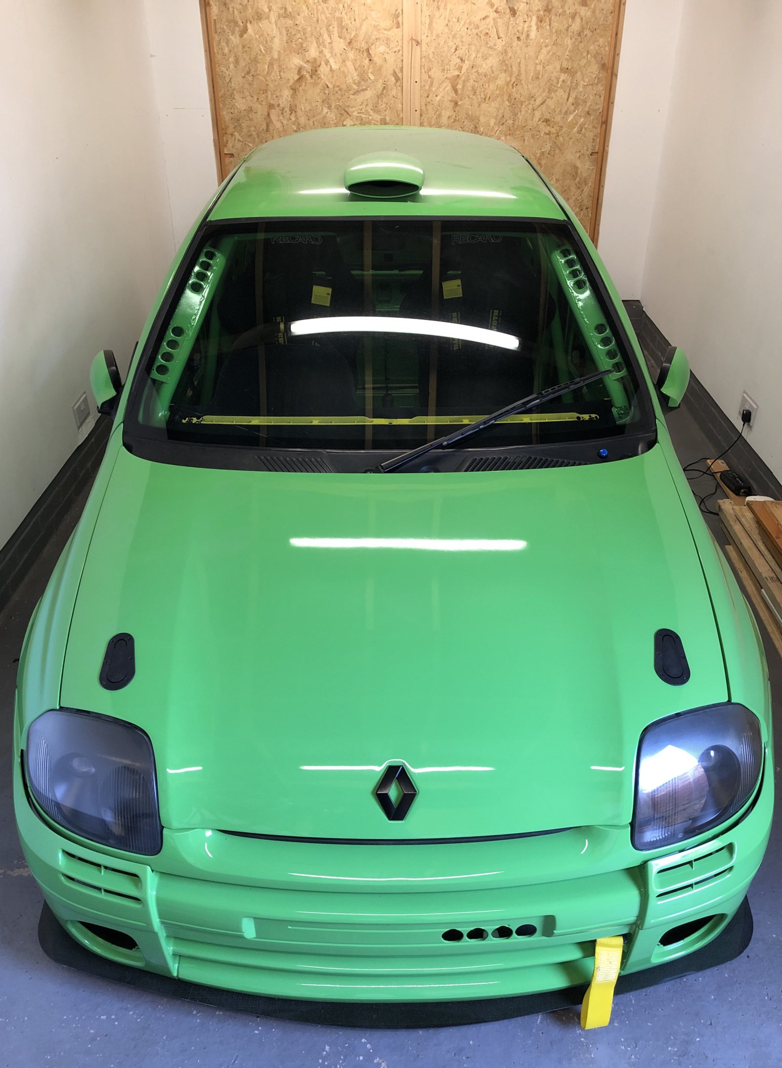

First job was to get the car off the axle stands... I thought this was going to be easy, not so much. I got the rear on the ground, chocked it and then started to lower the front drivers side, then ran into a problem, even when dropping it slowly and watching it down carefully I managed to get the car sill stuck on the pump part of the jack, this meant I couldn't jack it up to release it, or lower it off the jack to move the jack out.... After about an hour of fretting 2 neighbours (both car guys helpfully) came to the rescue with a scissor jacks, that raised it just enough to get the trolley jack out. The passenger side was then lowered onto a stack of wood.... phew, just a little to touch up on the underside of the sill, but now for the first time in a long time the car is on its own wheels.
Next up was to fit the bonnet and as I had the 2 neighbours there it made this job a darn sight easier.... a bit of man-handling of the areo-catch pins and it fits really nicely. Very very happy.

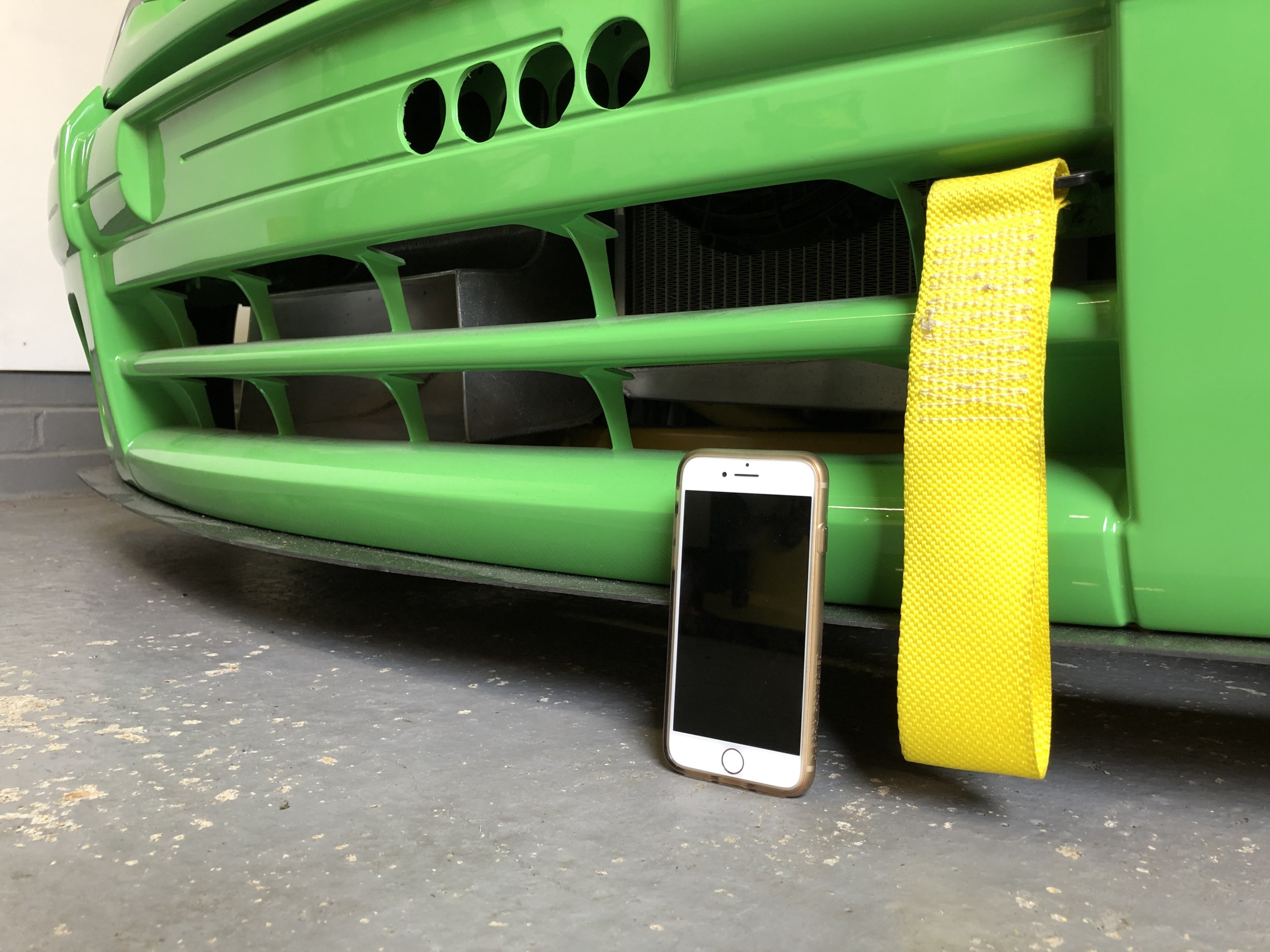

Dropping the car onto the floor though has raised some concern for tuesday. It is very very low... and there is a ramp out of the garage. I think I am going to need to try and get it raised although unsure if I can even get a jack underneath it. This is planned for tuesday morning, hopefully I can wind the coilovers up to give it a decent raise, I will also remove the front bumper to move it. To give you some idea how low it is...
Thats not an Iphone+...ha

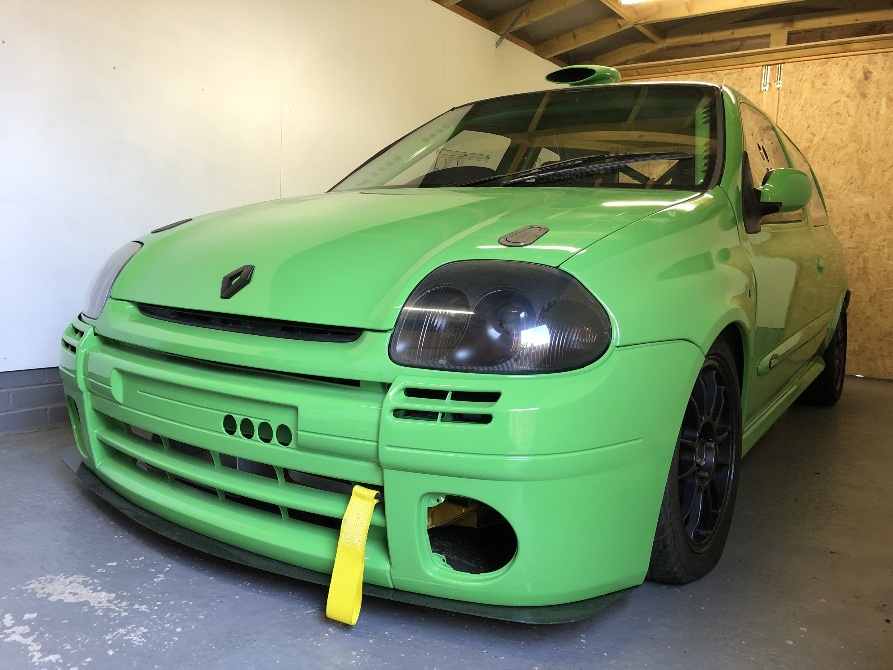

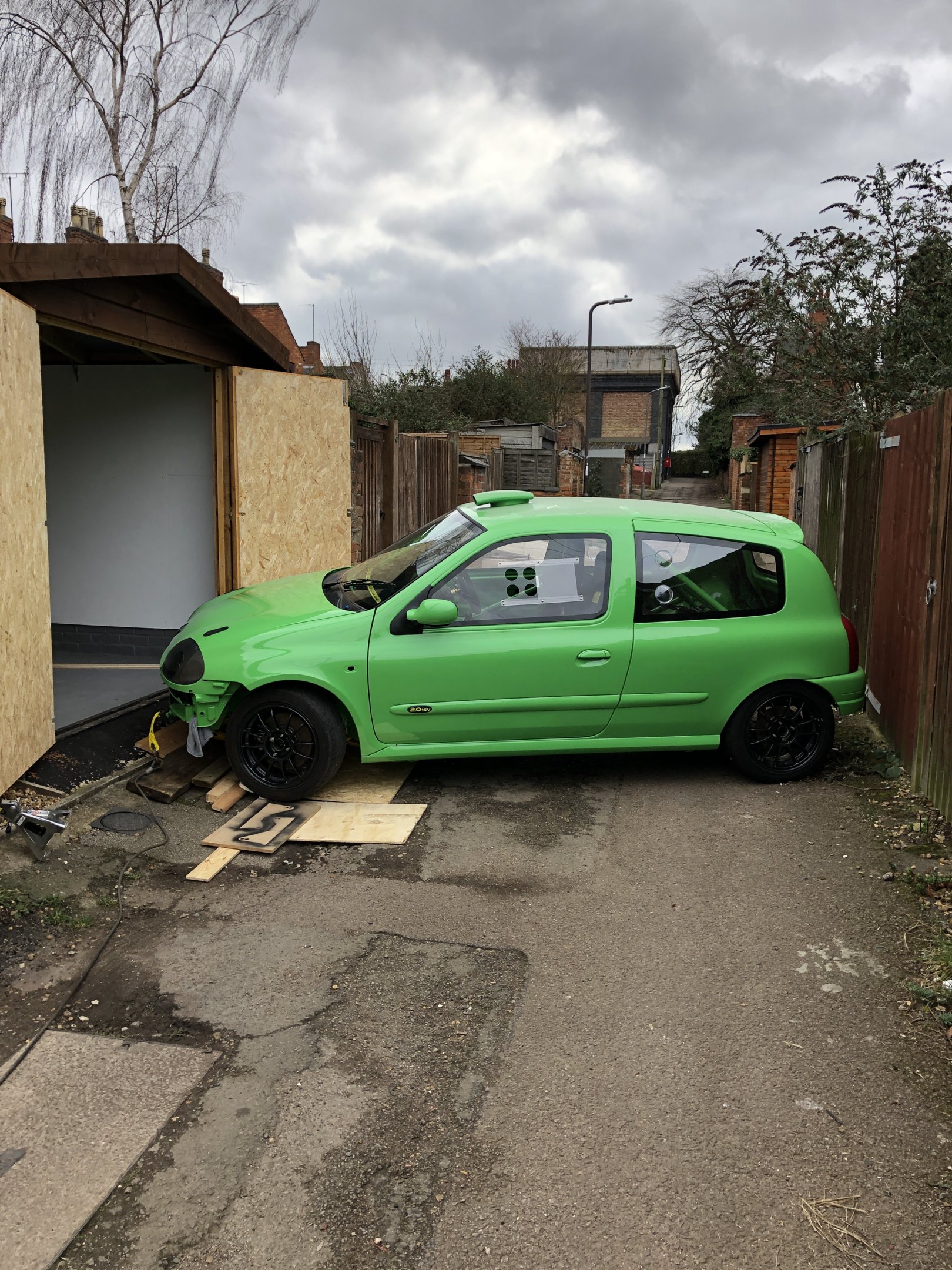

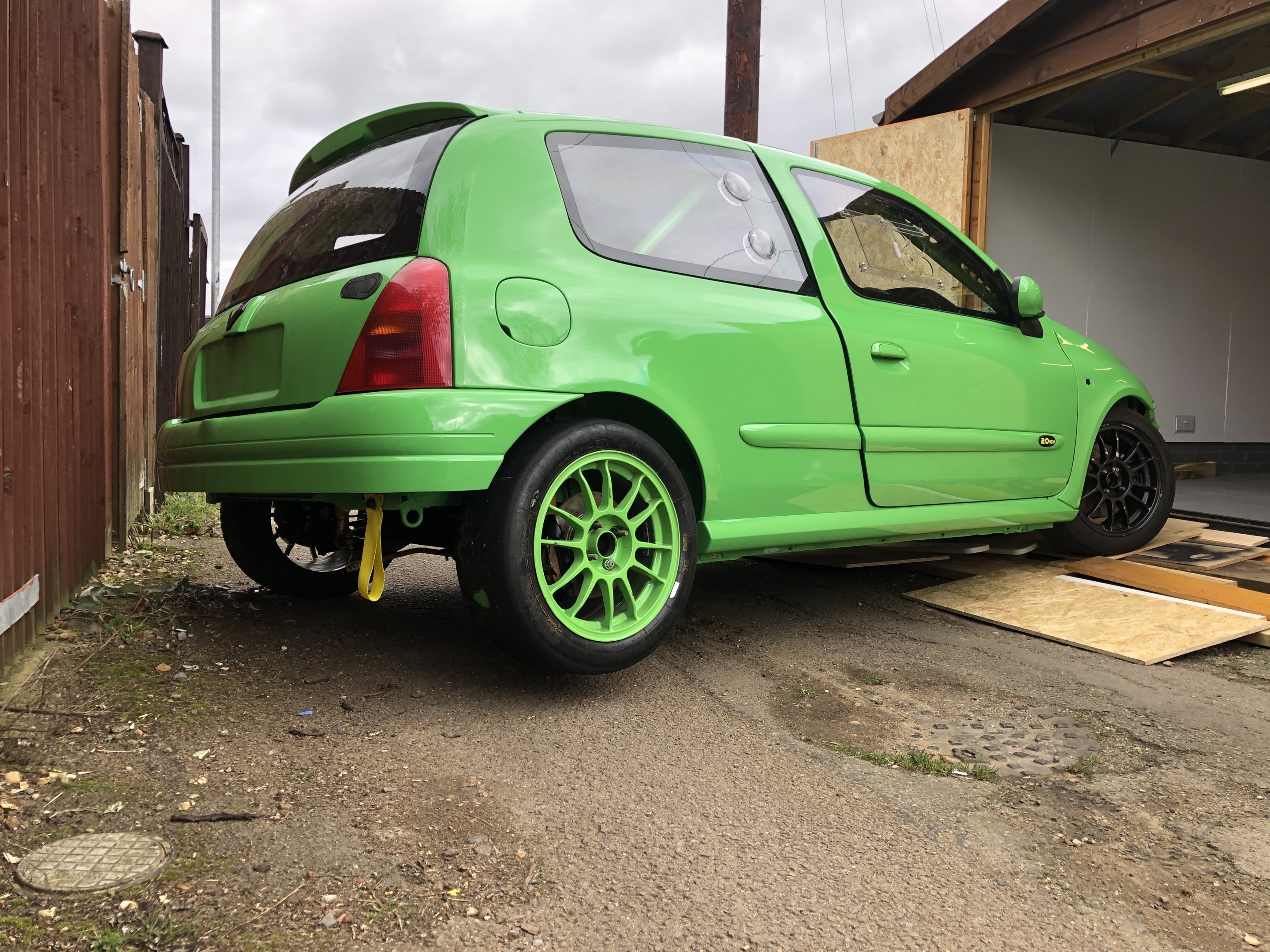

Yesterday came and went and the car didn't get moved... I had a shocker.... I drove from Birmingham to Milton Keynes only to find that I didn't have my house keys. This meant not only could I not get in the house, but I couldn't get in the garage. I had to cancel the move and put it off until today.
When I finally did get in the house yesterday and then into the garage I set about raising the car a decent amount on the front suspension. It was way too low previously and I needed to give it decent clearance to get out of the garage (bit of a ramp onto the rear alley). I also checked everything with the garage doors opening just to make sure....
I had to book someone else to move the car today and I think it worked out better that way. I think he was far more experienced than ho I had booked and just his attitude relaxed me far more about the situation with getting the car out of the garage. With only myself and him to move the vehicle I was sat in steering and hovering over the brakes whilst he pushed - luckily it is bloody light.
Turns out it is pretty stiff too...
We used a significant amount of wood to ease out the gradient out of the garage which worked a treat.
I think the fact the chassis is so stiff also massively helped. The fact that the grippiest tyre (the slick) was in the air only worked to our advantage.
Who remembers the scene in Austin Powers.....
It was a little like that.
I sat in the car holding the brakes, we left the front on wood and using the winch from the truck (parked behind me in the above photo) we dragged the front around... It worked out spot on... The car was then loaded up and taken to Deutsch Tech for its exhaust.

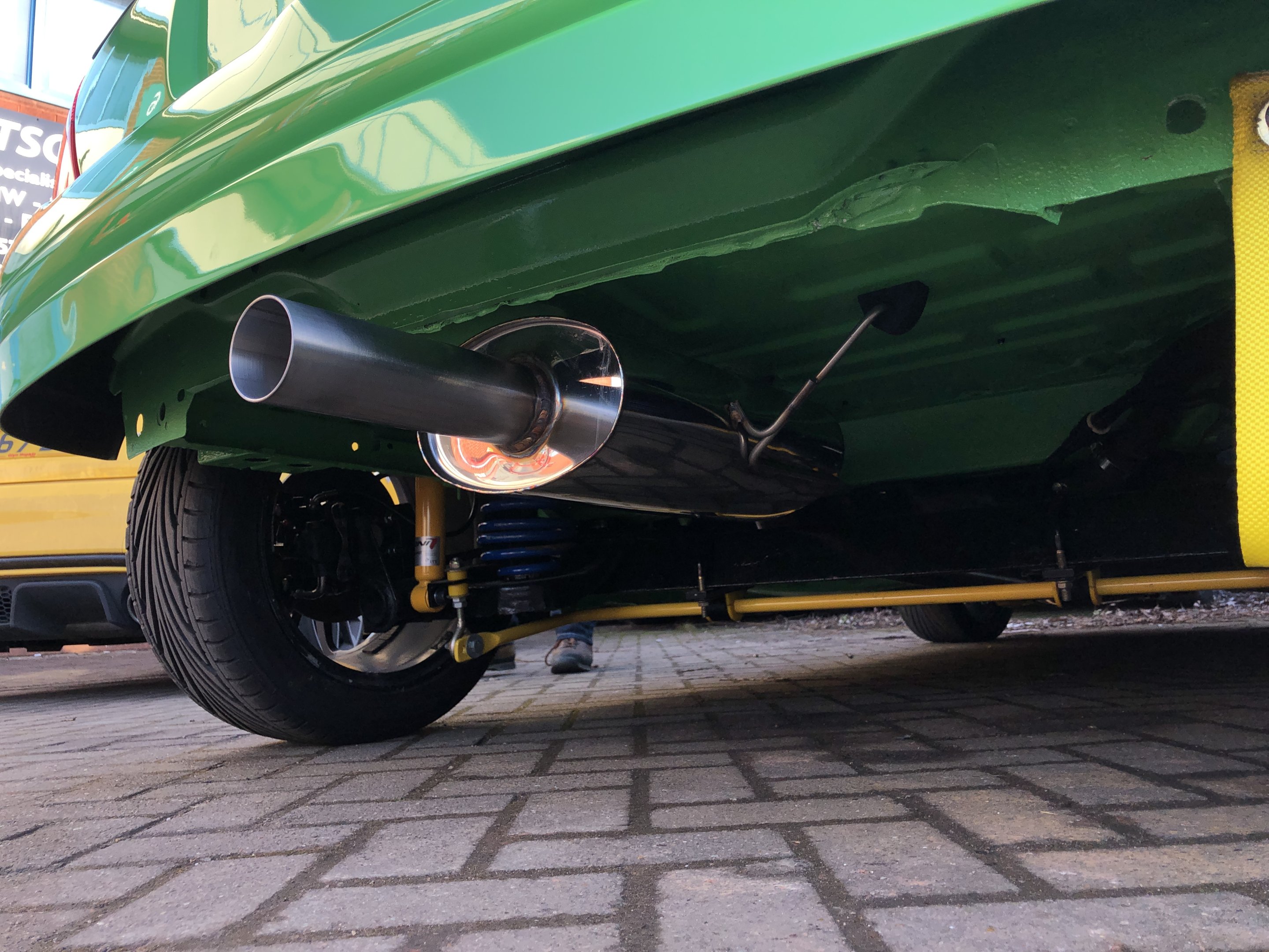

I have gone for a double box and 2.5" all the way through that will go to a centre exit straight cut 2.5" pipe at the rear. Very much looking forward to seeing it. Hopefully it will be ready to collect Friday and drop at Northampton Motorsport.
UPDATE:

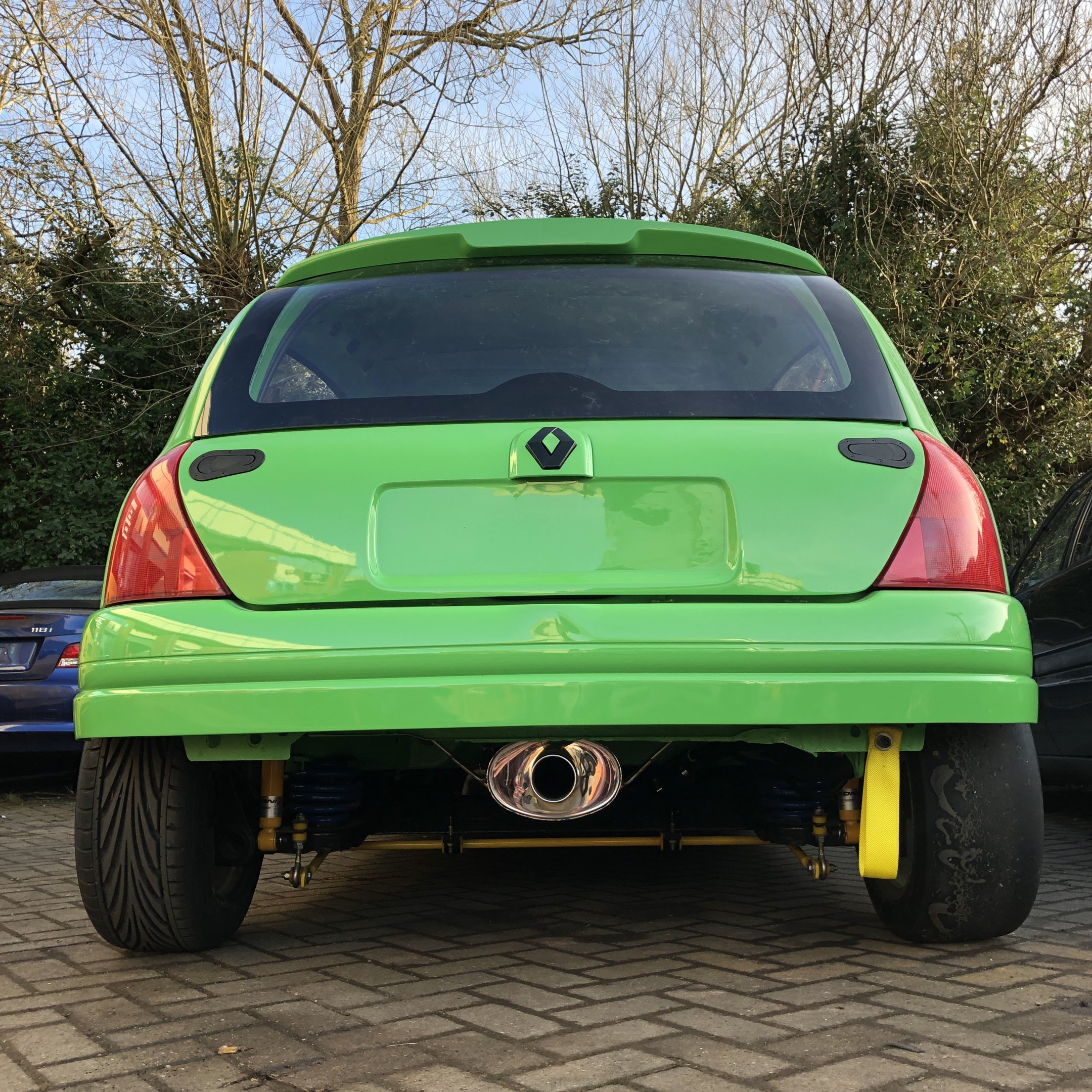

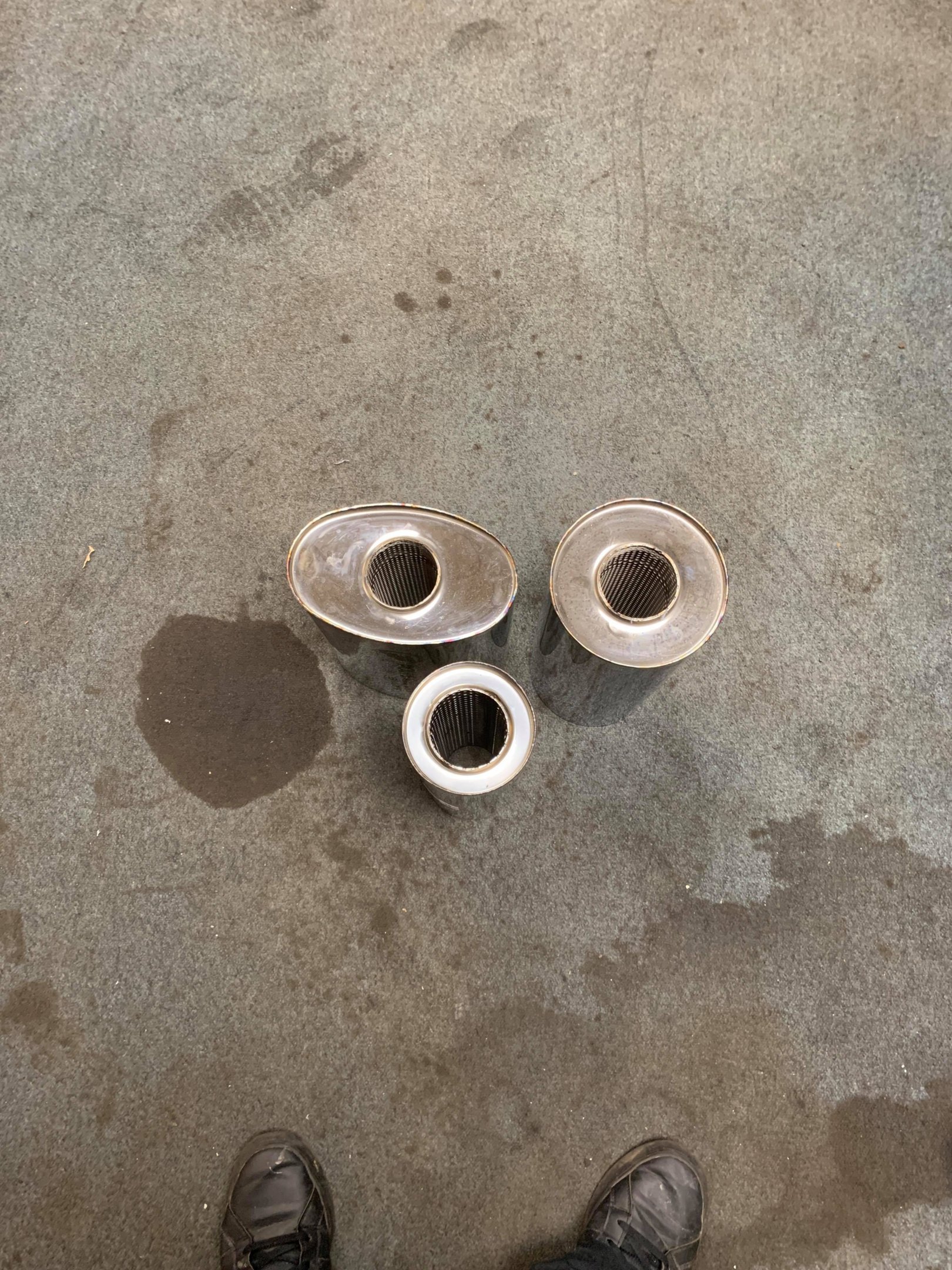

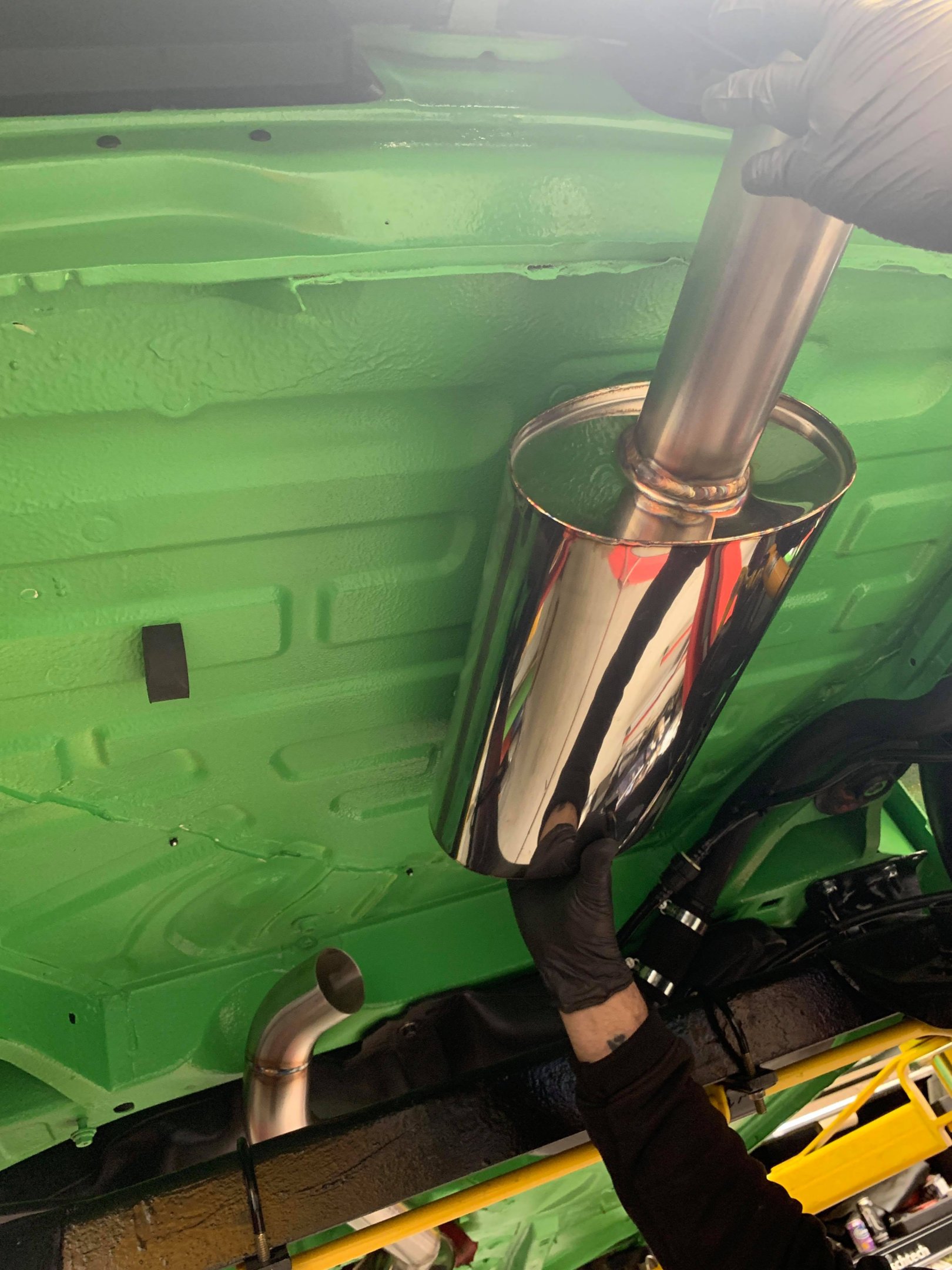

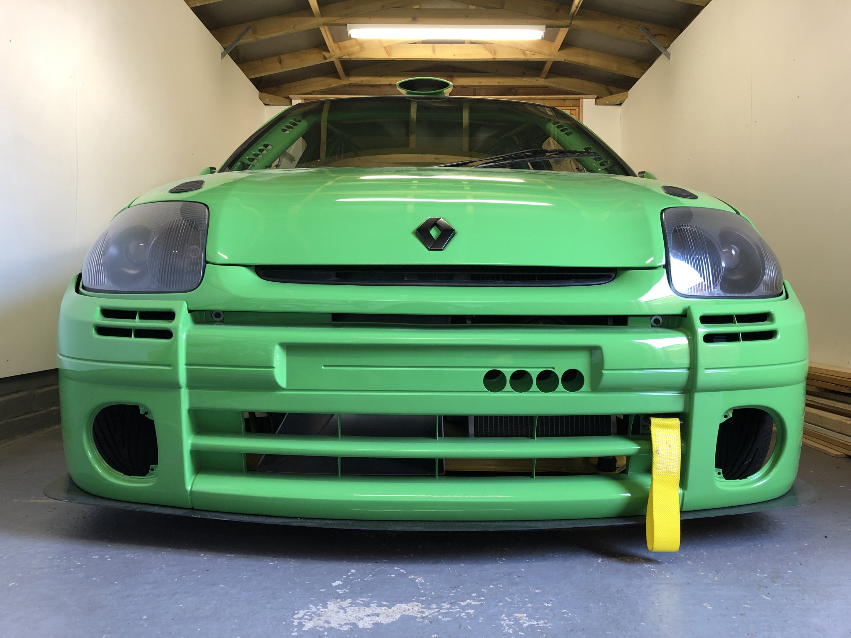

Exhaust has been completed. They had the car probably longer than they needed but it gave them a good amount of time with it and worked logistically quite well for me. I decided to go double box on it to make sure the DB's were 100% going to be under most UK track days.
I initially thought I wanted a round box on the rear but when I started chatting to the guys there we thought it could look quite funny as this could hang quite low. You can see in the picture below how different the sizes and shapes are and how that would effect the drop.
In the end we decided on an oval box and to tuck it up nice and high to the rear floor.
Mounted on 2 D rubbers that bolt directly do the floor the mounting is super neat. I picked the car up this afternoon and am very happy with how it looks.

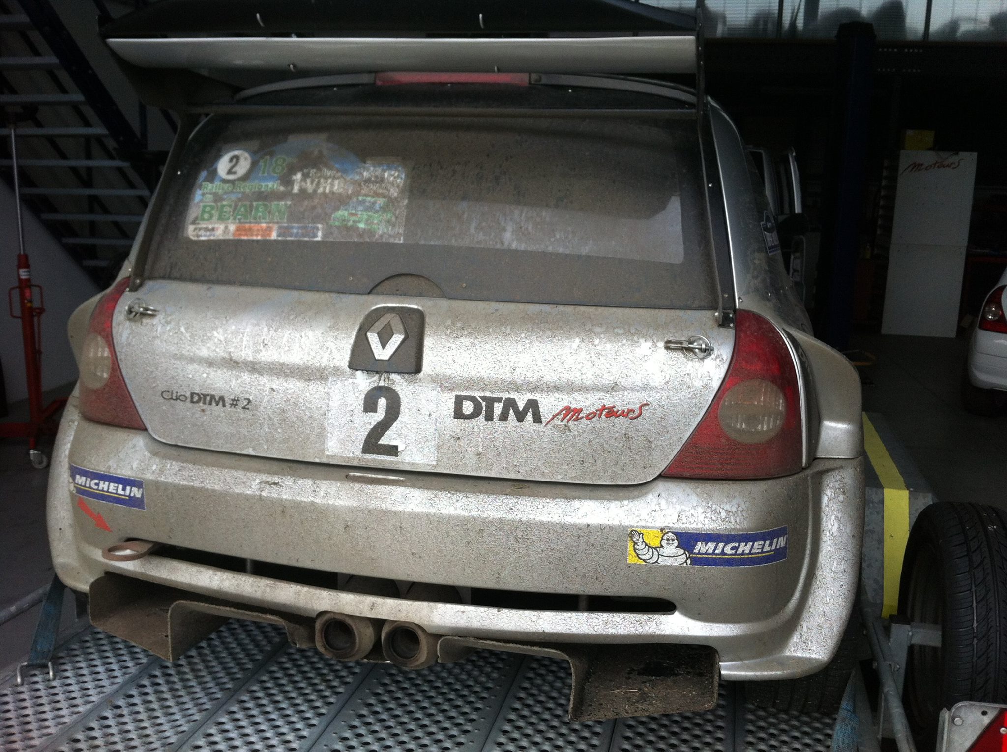

But this has now got me thinking about one of these diffusers again to really finish the back end off...
Although I am probably better off going custom I imagine.

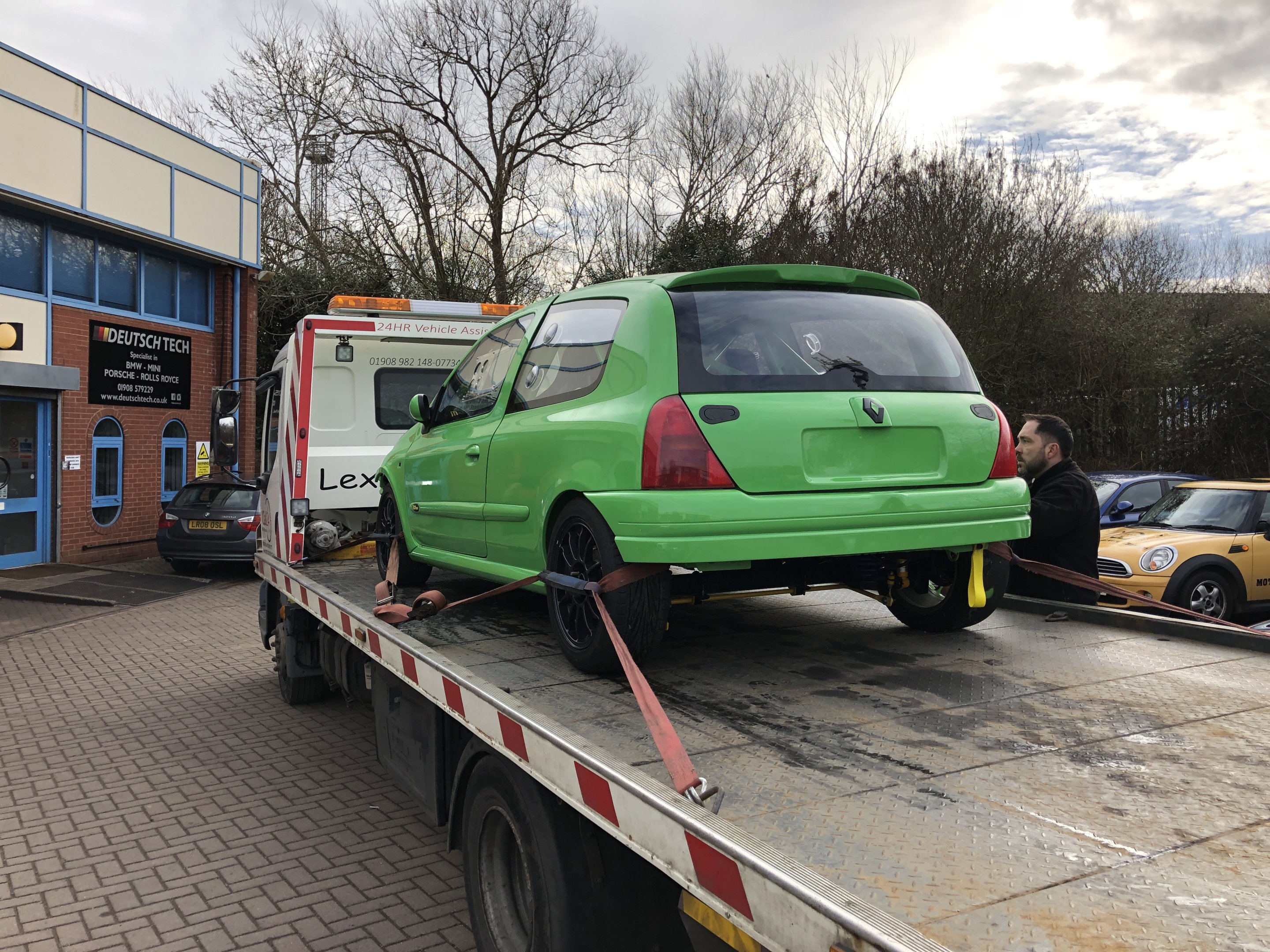

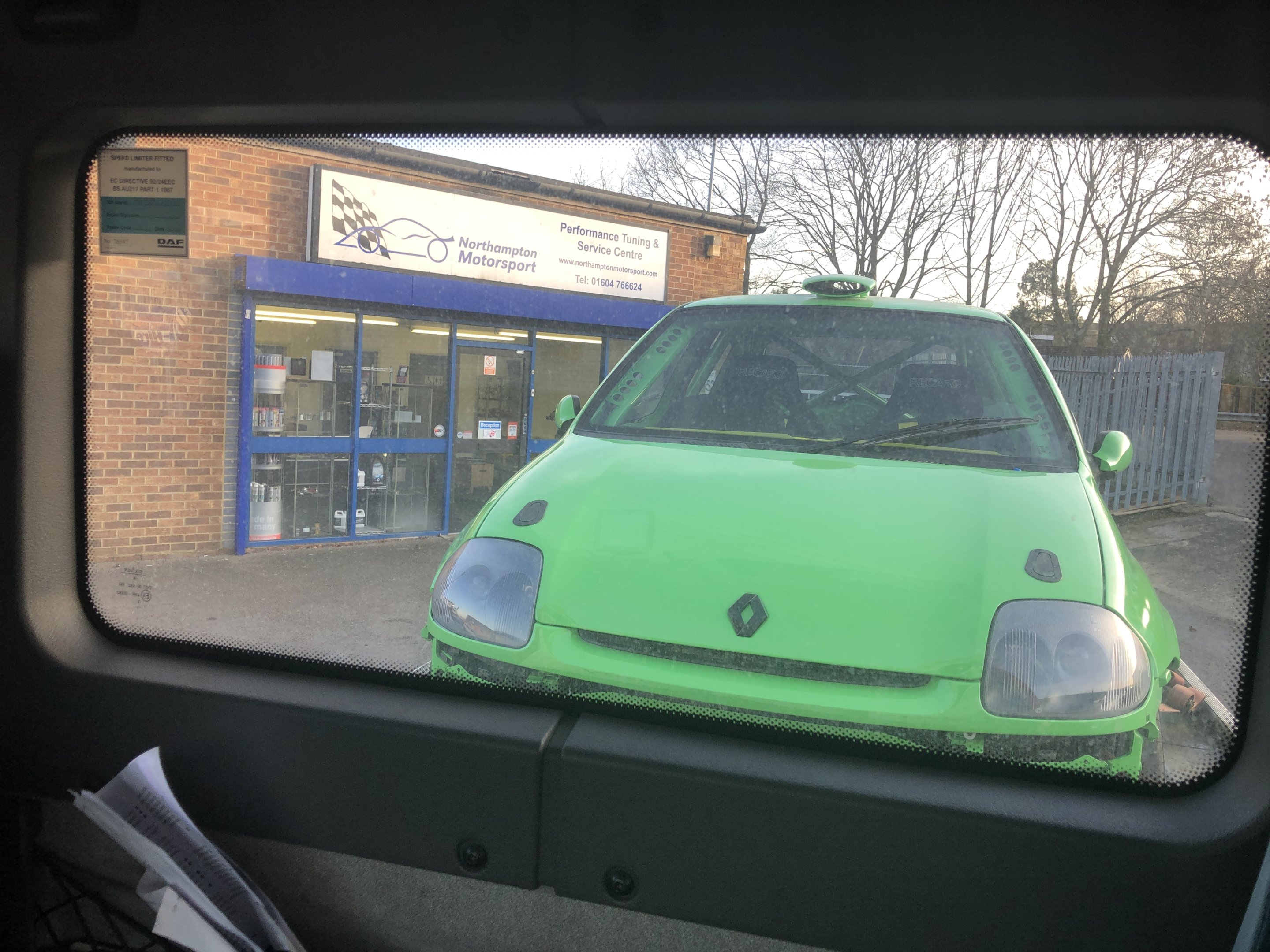

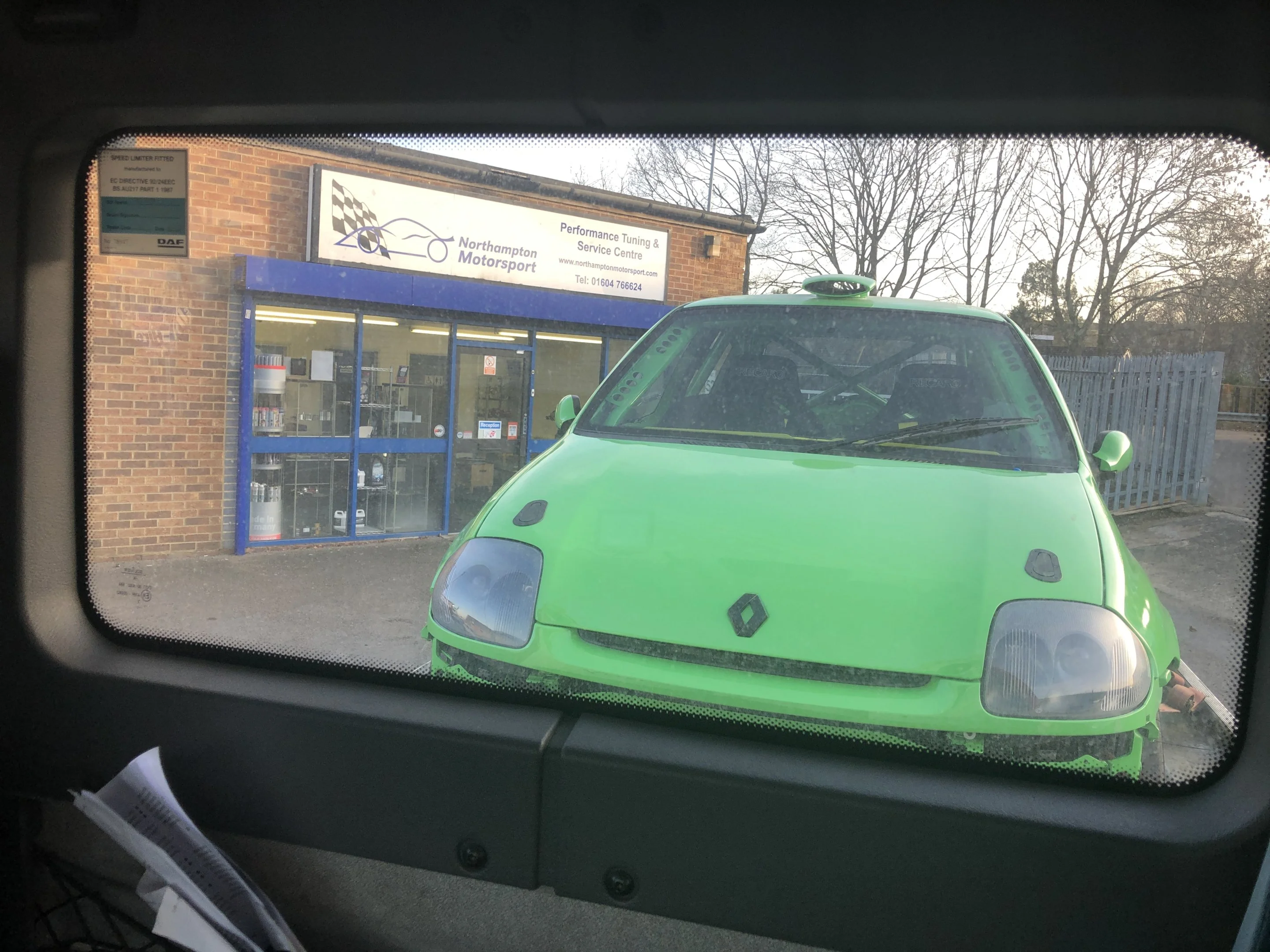

Anyways getting ahead of myself. The car was picked up and moved to Northampton Motorsport and dropped off there just before closing....
Troy seems spot on. I am nervous but excited about tomorrow. Everyone has said it should be alright, and the signs point to it being ok.... but there is part of me that thinks its going to sh*t its pants.... if it doesn't I wonder what it will make... I am heading back up in the morning so we will see
Great exhaust mate! Needs a diffuser defo! Working on a plan for my own exhaust. Hehe Good luck tommorow! It will be absolutely fine! You done a great job in it!

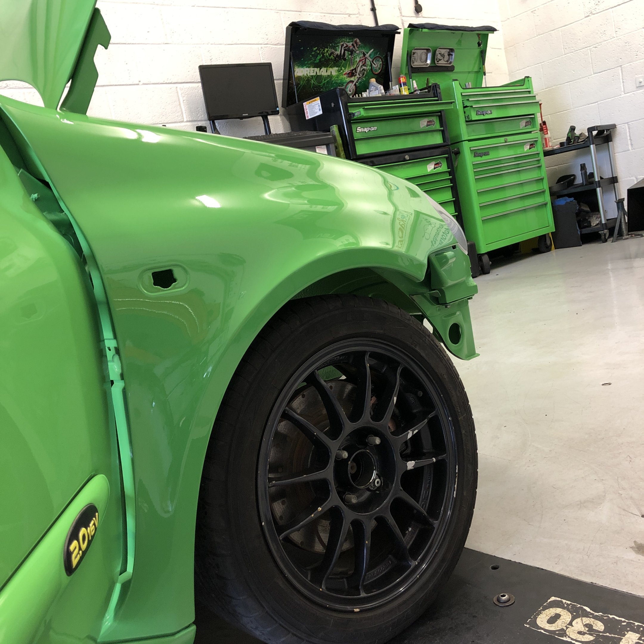

Well its not good, but its not too bad... yet
We could not get comms with the Specialist components ECU at all. We tested the pin-outs for the ECU plug, tried 2 different leads but it wasn’t playing ball. Quite frustrating to not even get it running but obviously nothing catastrophic yet.
Troy is also concerned about the balance of the ITB’s and whether these will be correct, if not even a little bit of in-balance can effect their performance. It is also a bugger to do that with all the gumph on the car. But thats the next thing to worry about.
Lastly I think the battery is shot. Not really an issue in the grand scheme of things, and we can just anderson plug a support in but another thing to add to the list.
On the bright side though, he has nice tool chests

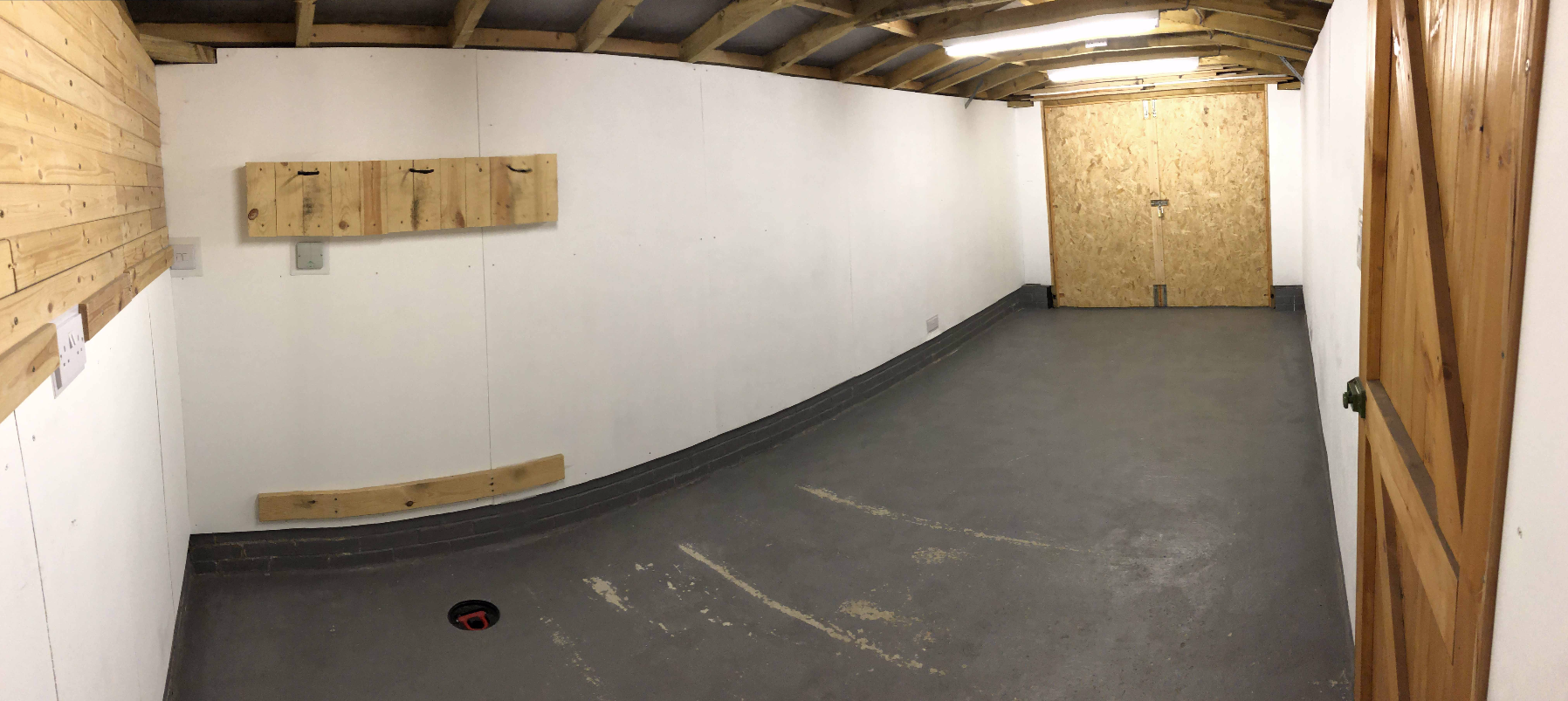

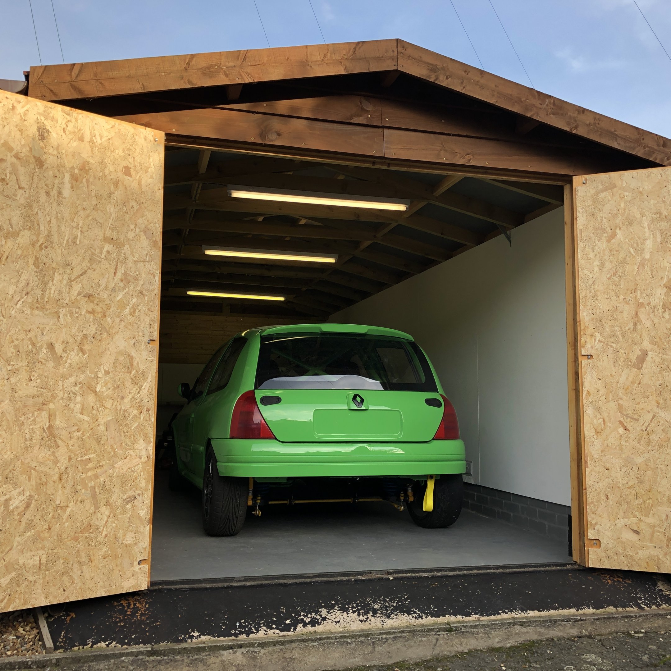

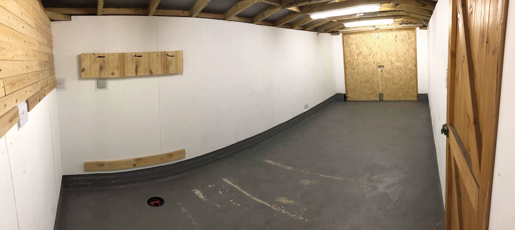

As of today we have also moved house too. Really weird seeing the garage empty.
1408324
Little bit weird leaving it as this was properly "my space". It also 100% allowed me to finish the car (or get it near finished).

UPDATE:
Had a call from Troy today at Northampton Motorsport. He let me know that the car had its initial fire up today (I wasn’t present) and they ran it for 60 seconds at approx 12k rpm. A couple of issues were apparent.
  1. Throttle pot wasn’t initially working. (Unsure what he meant by throttle pot)
  2. Was initially noisey from the top of the engine but quietened. Hopefully this is just because the engine has been sat for a while and the oil needed to circulate
  3. The 4th cylinder isn’t running. This could be down to the throttle body but they will be investigating this.
We are also going to drill and tap the throttle body manifold so we can peform Vacuum balancing on the itb’s. I think this makes a lot more sense and makes it a lot easier to balance in future rather than removing the airbox each time.
1) Throttle pot = throttle potentiometer mate.
2) yeah that’ll be because there was no oil in the hydraulic lifters
3) 4th cylinder not running I would assume it’s injector not firing or no spark?
