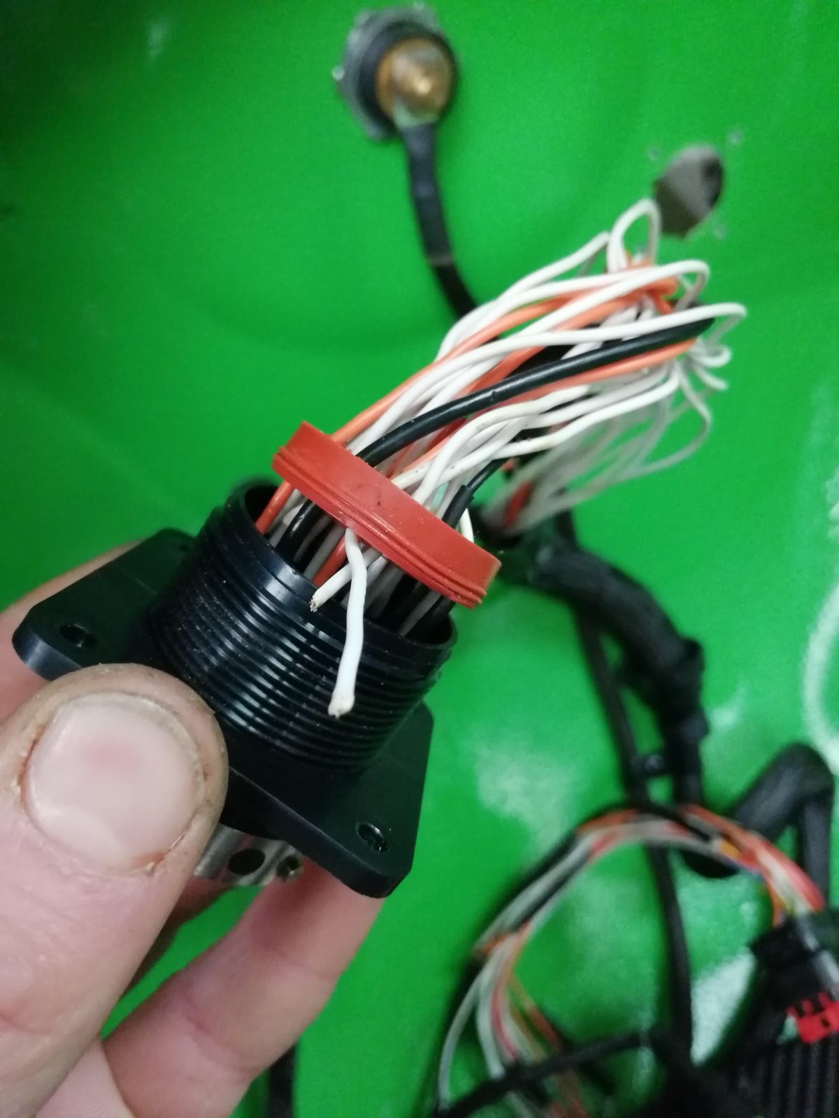

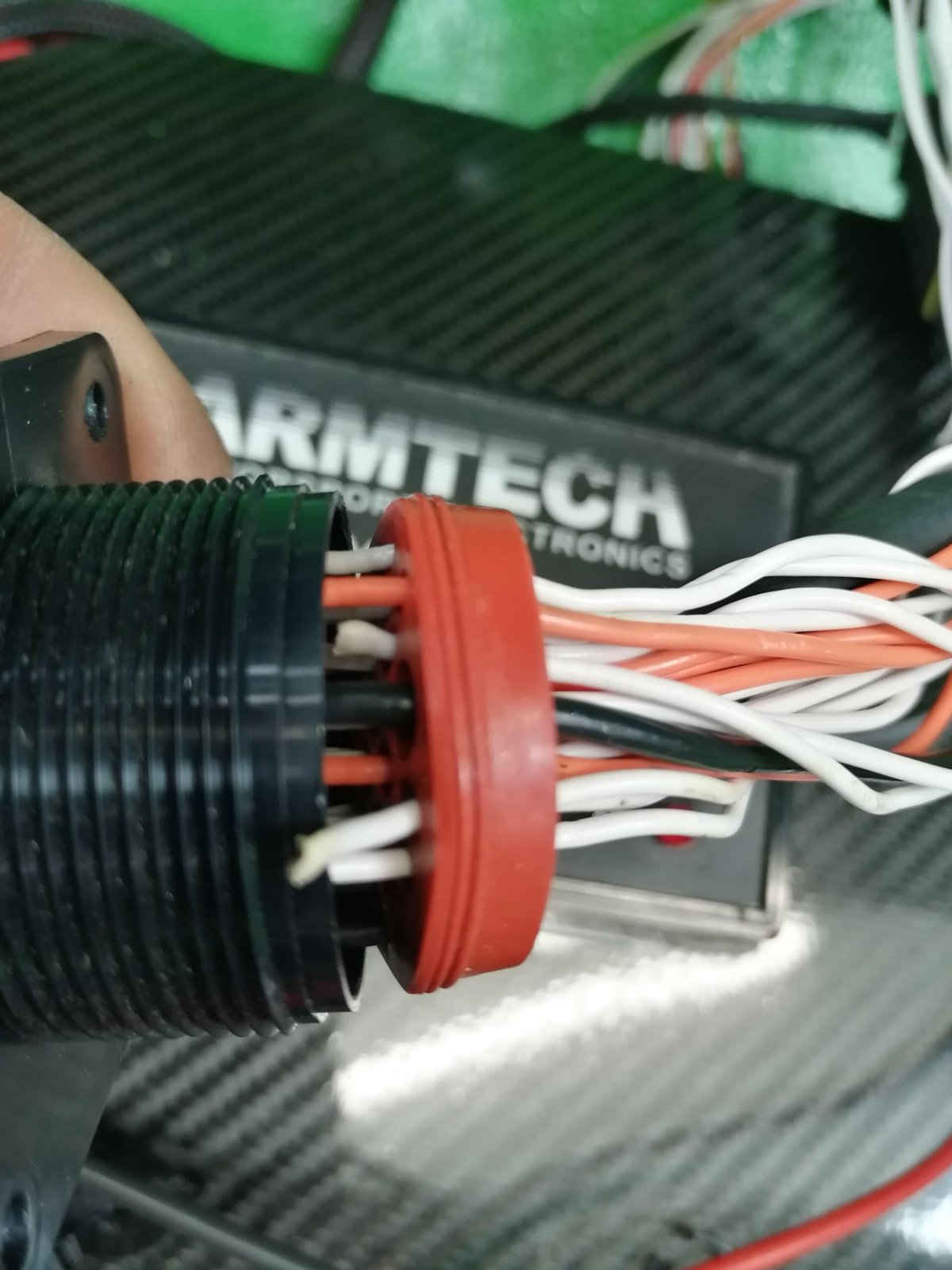

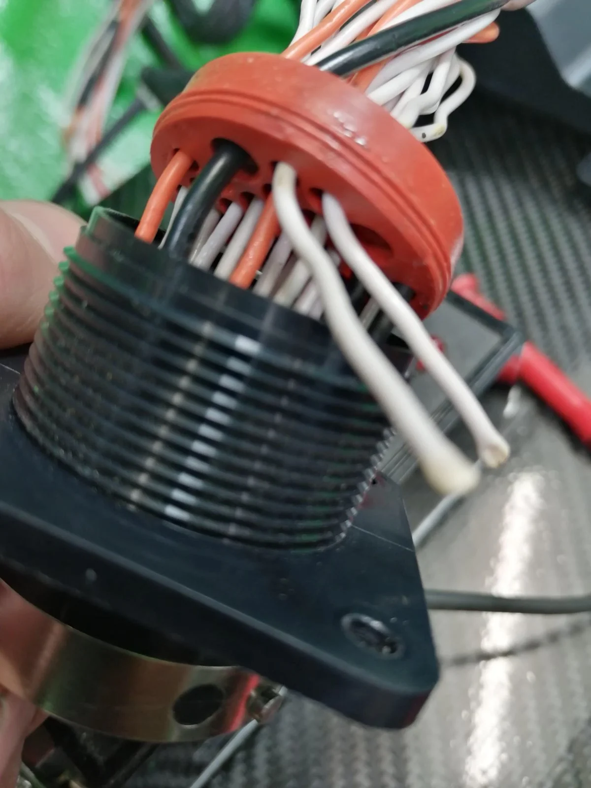

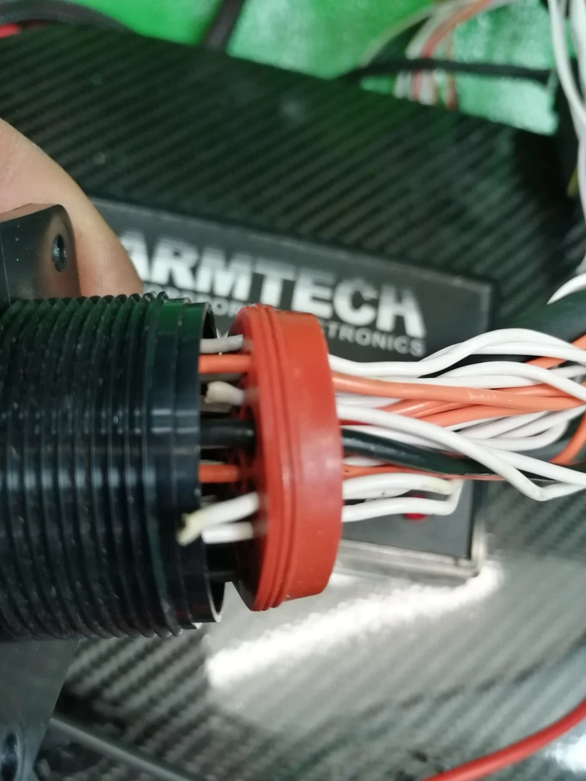

So I had contact from Troy this morning as they have been working on the car and investigating the issue with cylinder 4.
Turns out was a lack of continuity to cylinder 4 through the loom. This was the traced back to the bulkhead connector. On dis-assembling the connector it became apparent that there was an issue with 3 wires (including the one for cylinder 4). When the rubber spacer was pulled out those aforementioned 3 wires just came straight with it.
Apparently it is not easy to de-pin these plugs so I may end up needing a new one.

A new connector (this time an AS mil spec connector) has been ordered and will be fitted shortly.

I spoke with Northampton Motorsport yesterday and the new connectors have been connected to the looms and car fires up and is running on all 4-cylinders. Happy days... shame it wasn't an easier (cheaper) problem to solve but glad we have got to the bottom of it.

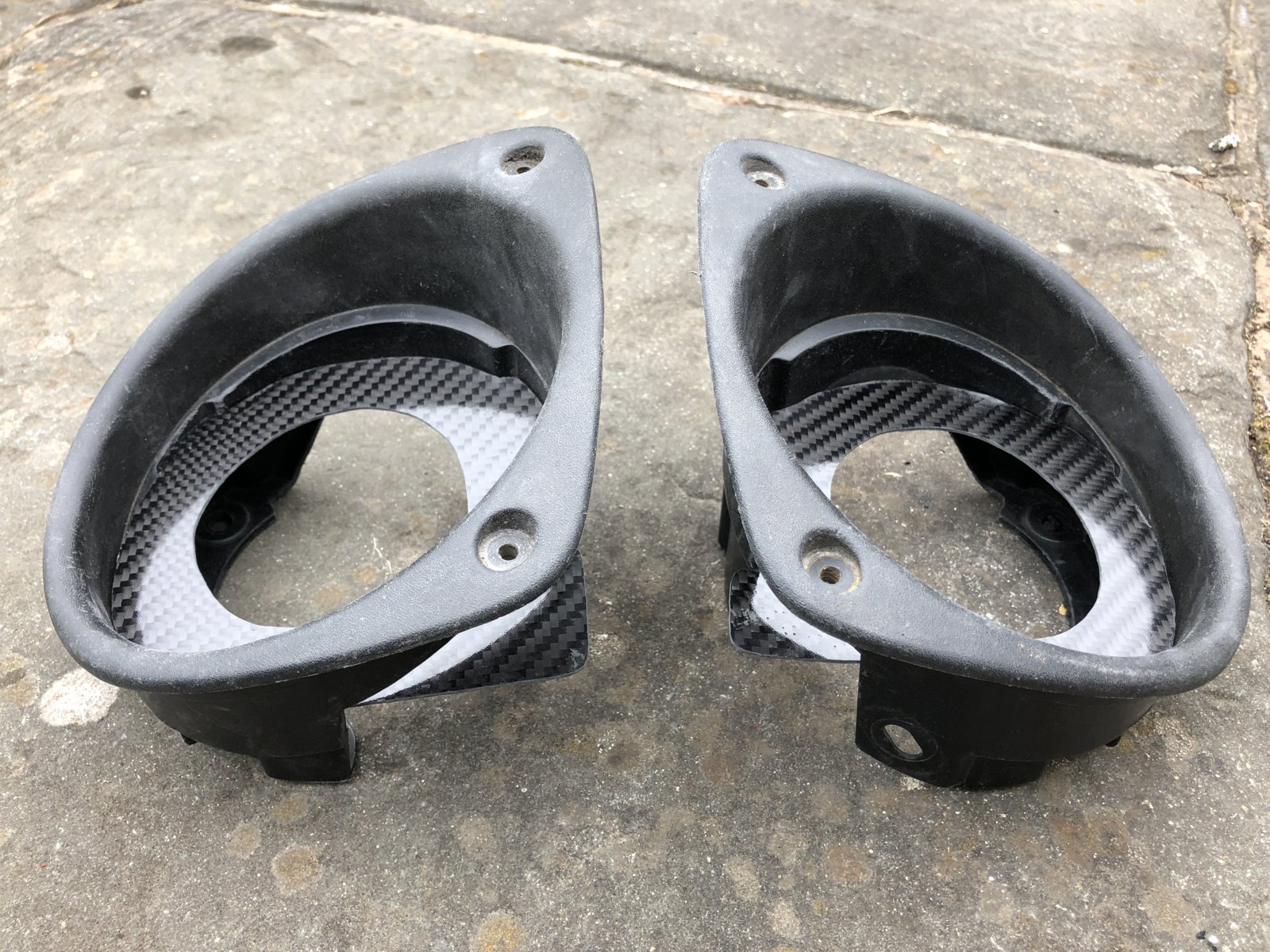

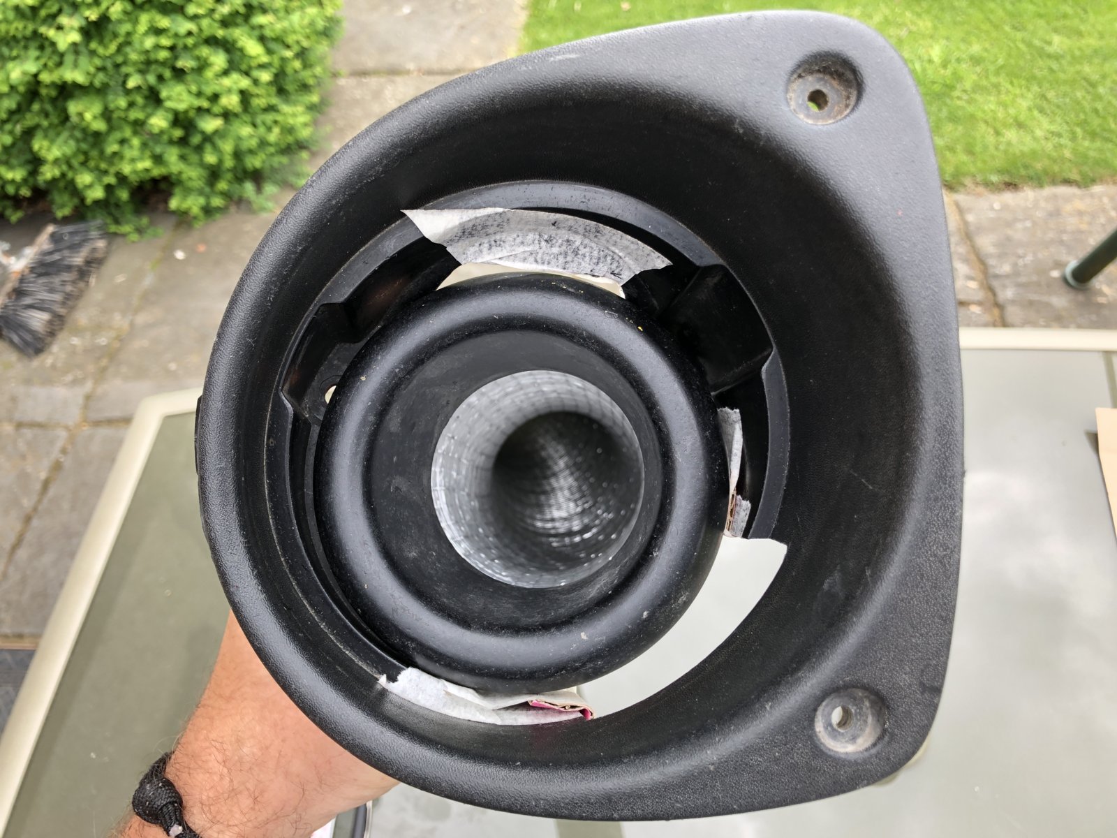

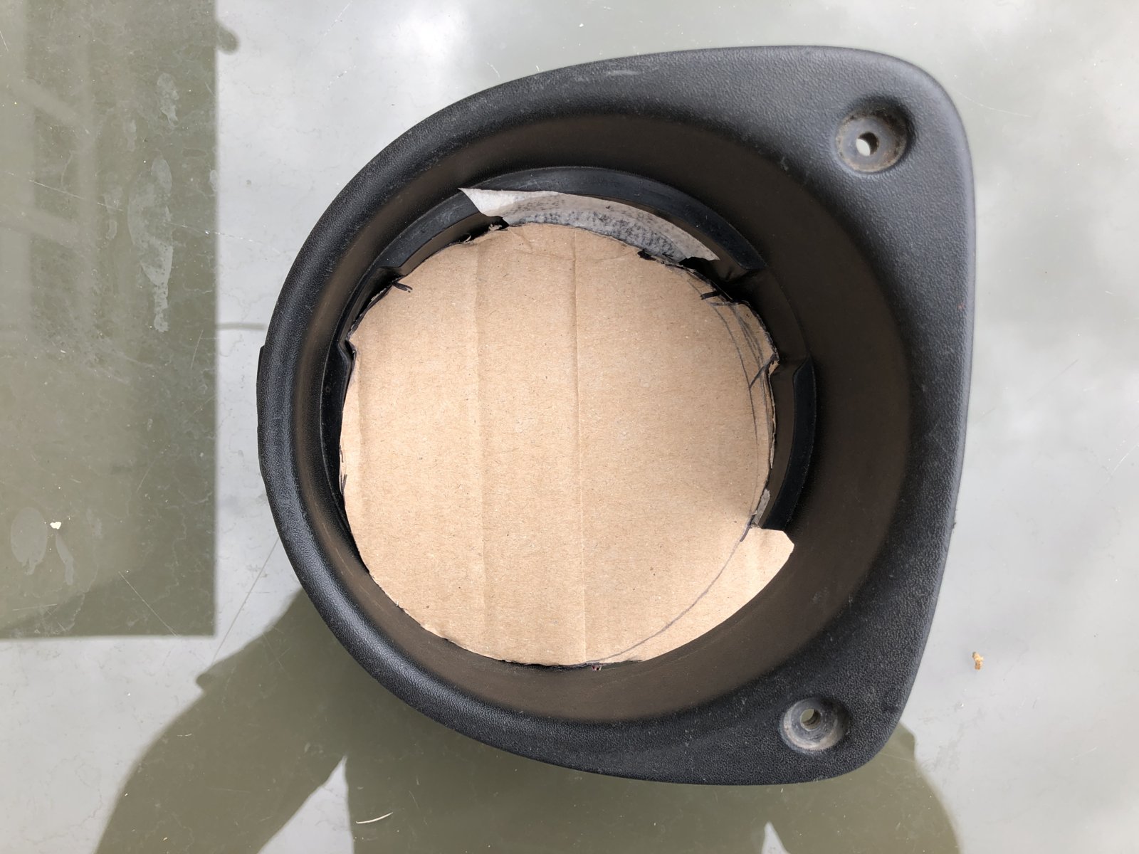

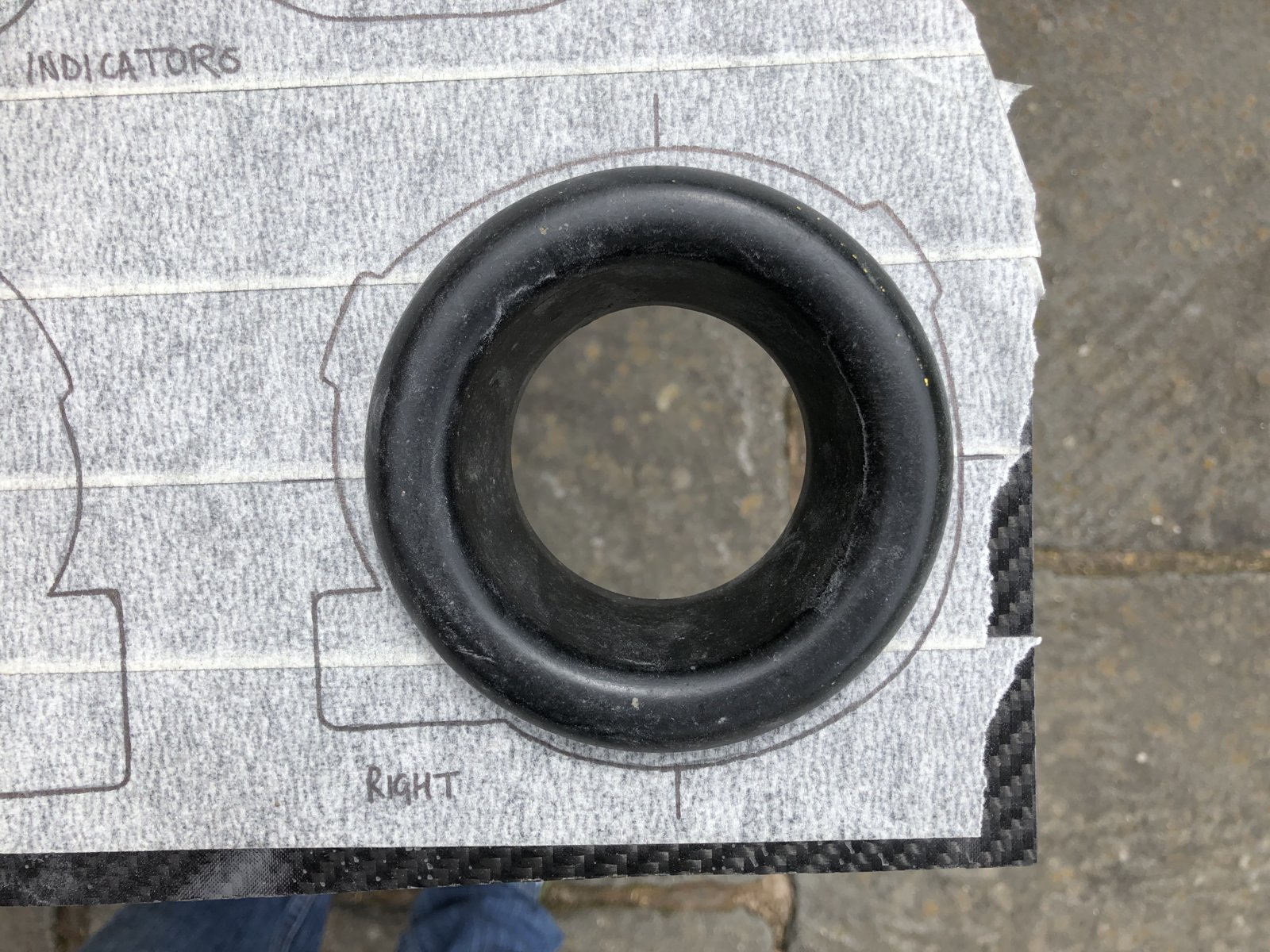

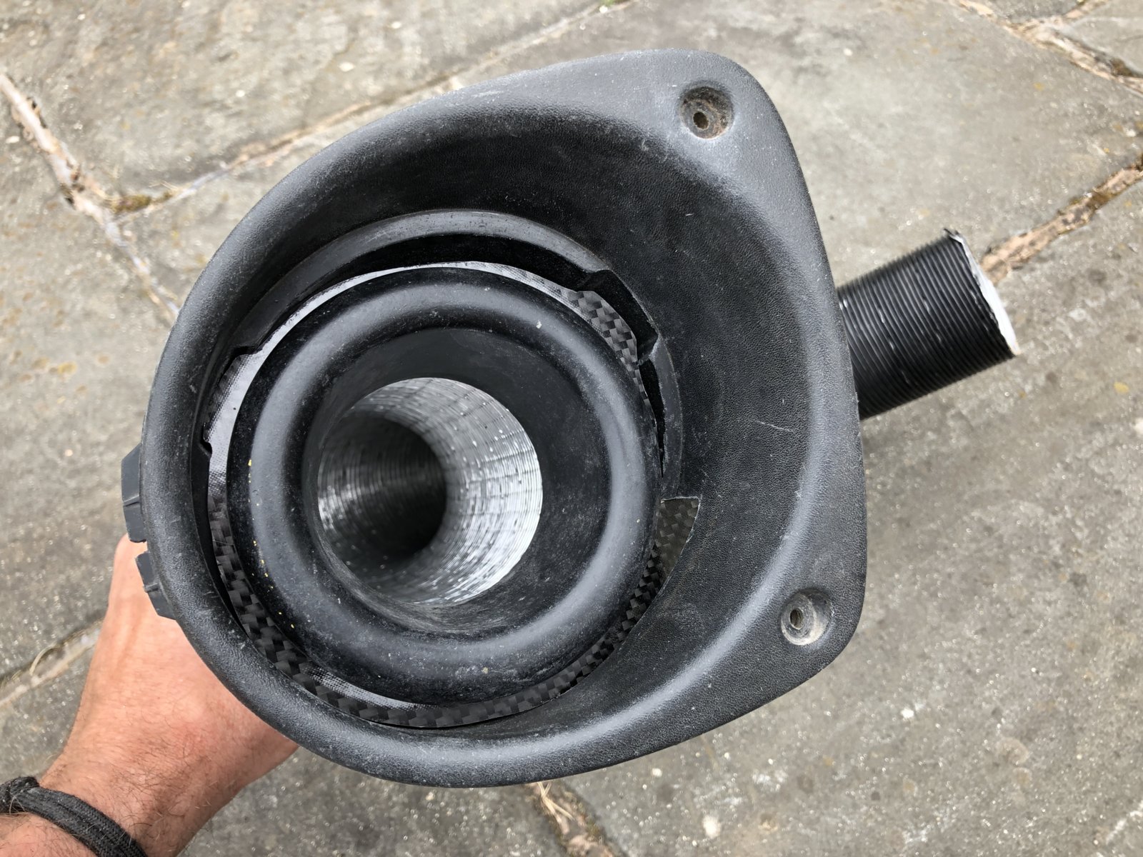

I realised a couple of days ago that I still could progress a little with the build as I do have 1 small part of the puzzle still in my company. The front bumper....
I need to sort the brake cooling and this was going to be fed by the now not in use fog light apertures in the front bumper.
I already had the trumpets and the ducting, there was just one issue - the trumpets are significantly smaller than the fog light holes.

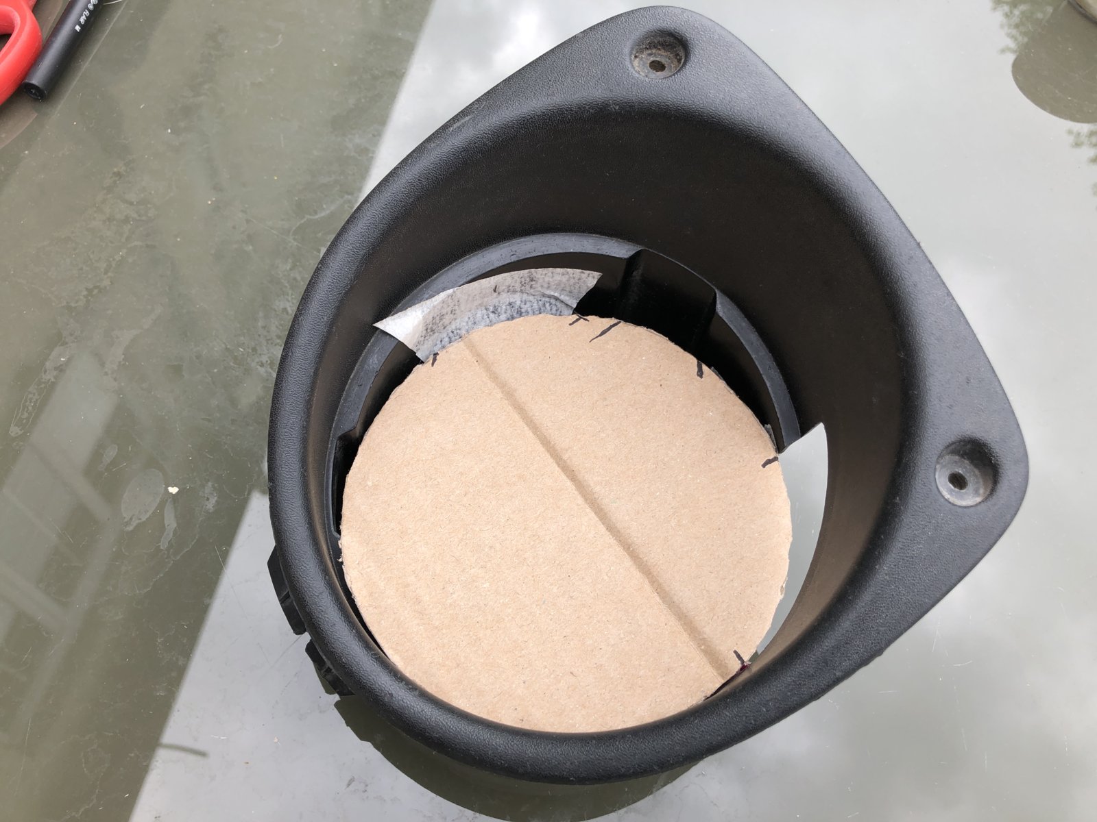

Previously I just stuck a load of sealant around the the ducting which 'kind of' held everything in place, but I wanted to make it better and more sturdy this time.

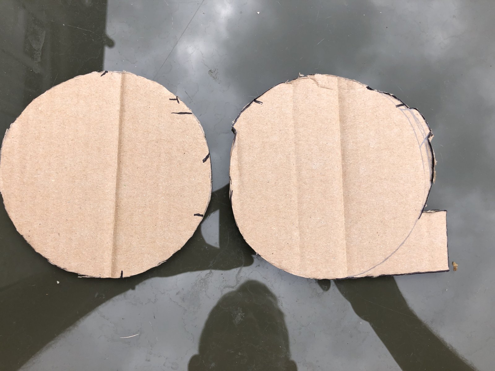

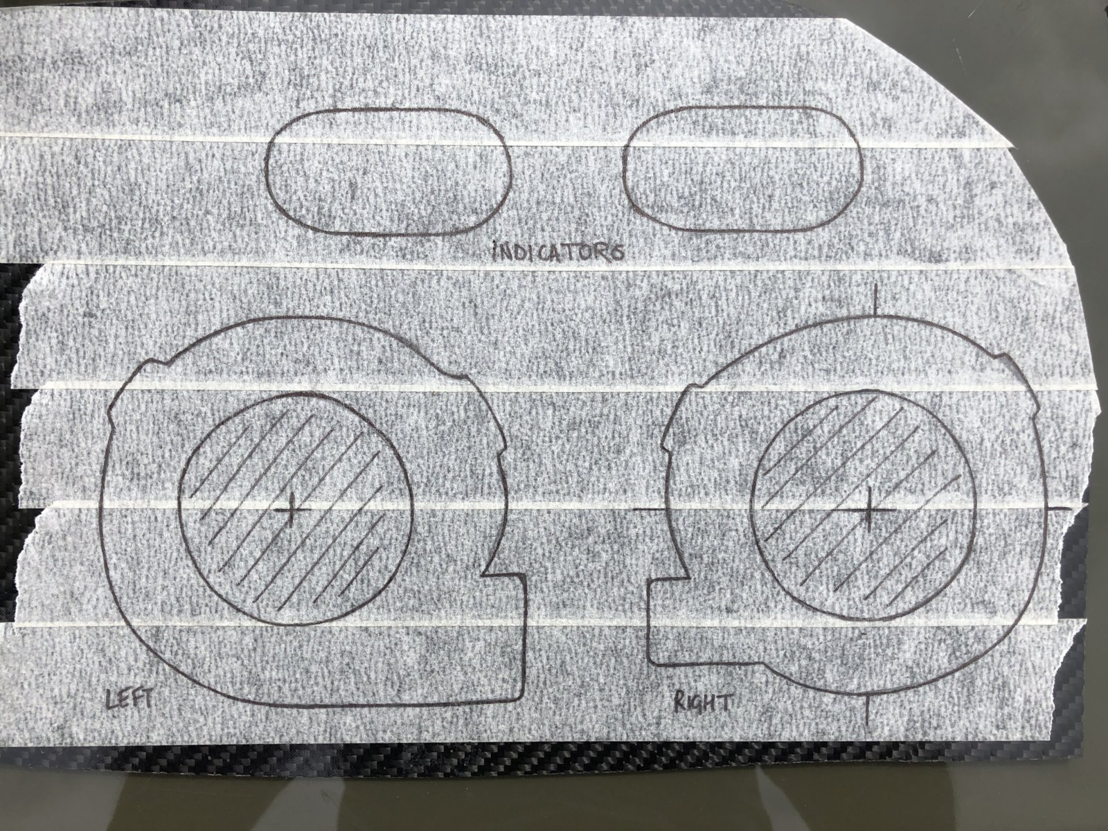

I started off by making up some templates to roughly the diameter of the aperture, with this I could then see where I could make some tabs to allow it to sit more in-place, more templates were made up...

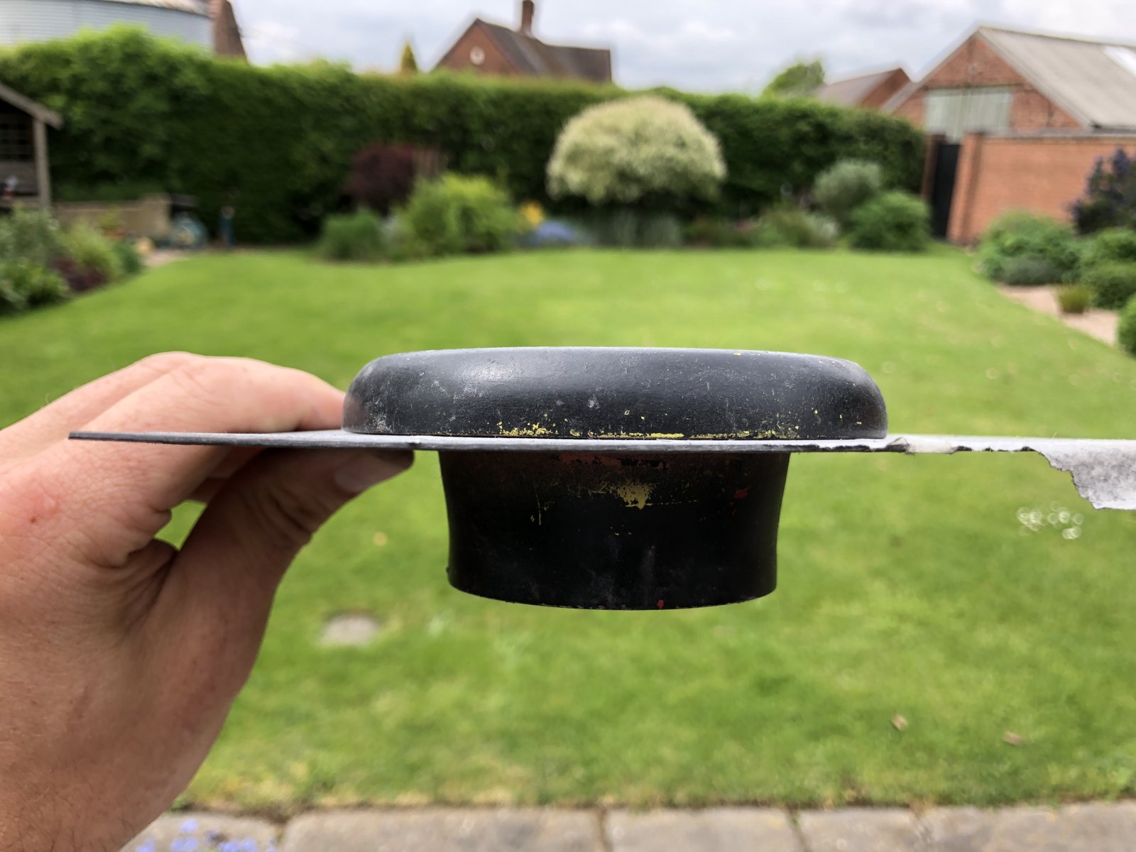

With templates drawn up for both driver and passenger sides this was then transferred to a sheet of thin carbon, the trumpet hole was cut first for easy, tested for fit before the rest were cut.
Happy with the apertures for the trumpets the rest were cut out and then fiddled with to get as close to a good fit as possible.
The fog light trims are an extremely weird shape so I couldn't get them perfect but I am going to mount them in place and then edge them with some black silicon.
Should look alright.

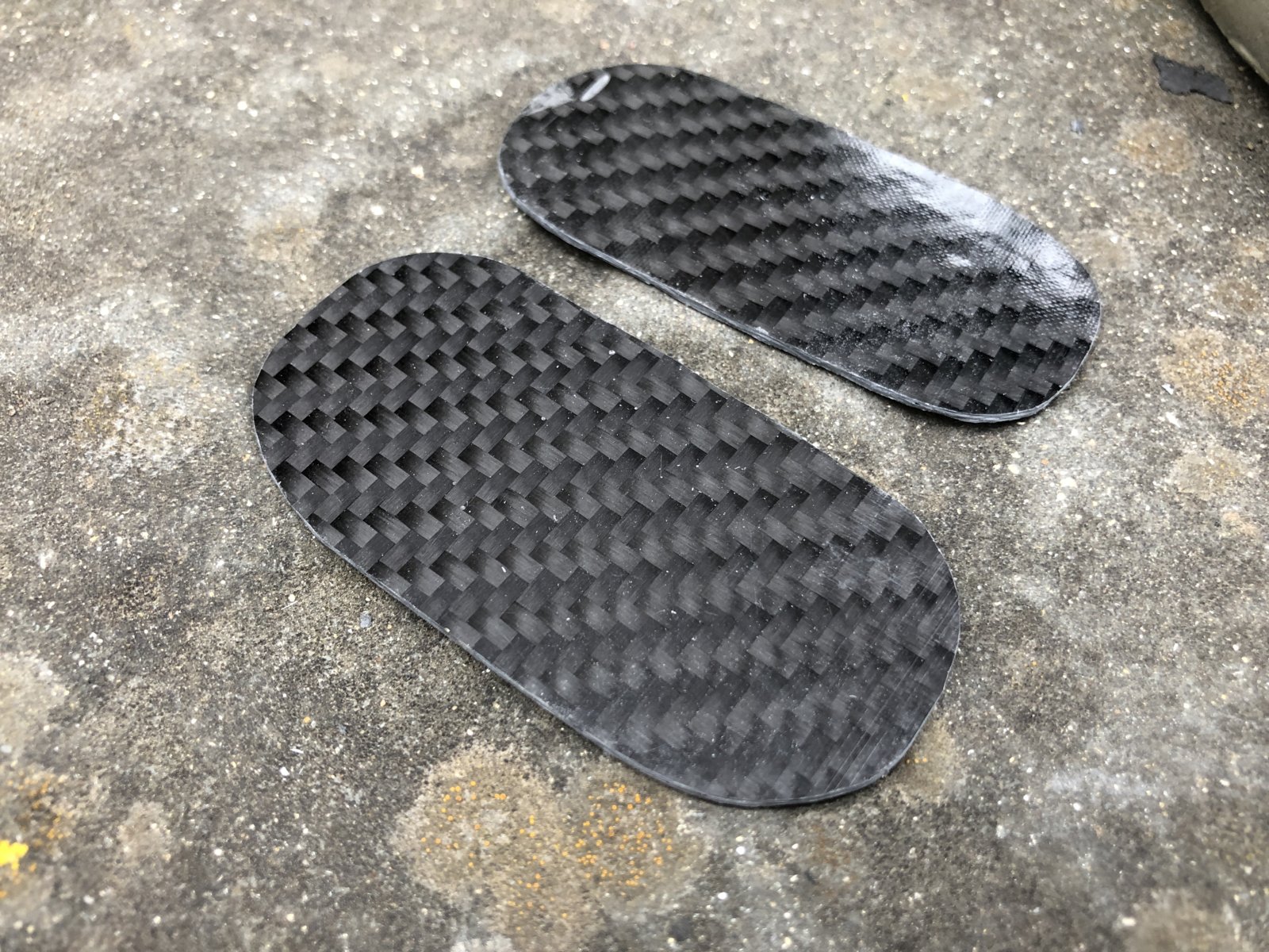

As I had the carbon out I also marked up and then cut some indicator blanks, however really not happy with them, bit of a funny shape really...

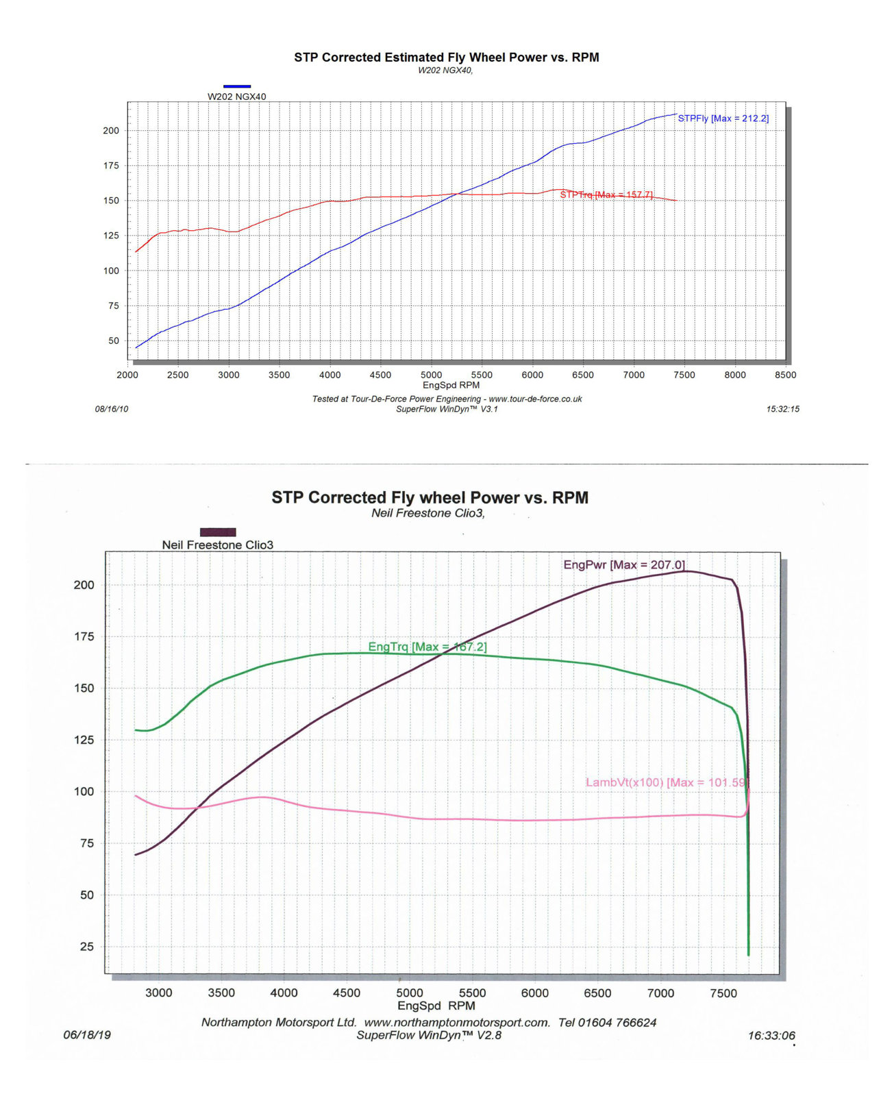

Just had a call from Troy at Northampton Motorsport and the car has now been mapped.
There are some little niggles still to sort but I guess these are small fry to now knowing the car is actually running well and it withstood the power runs.
The car was originally assembled by BTM Performance with a the loom/ECU side of things done by TDF, since then I have heard a lot of things about TDF and I did question the original results from there (and how honest it was). I was also told when the car was mapped previously that the exhaust was potentially restricting it, so since then the exhaust went from 2.25" - 2.5"
Below are the comparison graphs.
So it has made less BHP than previously 212bhp down to 20bhp but the torque is up an extra 10ftlb's to 167.2 from 157.7. Also the curves look loads better hopefully meaning the car will drive a lot better. Pretty happy for a pretty bogo engine - (Catcam 428's, ITB's with custom airbox, 2.5" exhaust no cat, no PAS/air-con, no VVT, NO PAS)
Still some annoying bits to sort and a couple things that Troy is picking up... but I am going to be broke ffs

Great to see. You must be happy even if your wallet isn’t!
Very happy with the curve, a massive improvement. Looking forward to driving it now, but it may not come out in anger for a while.
