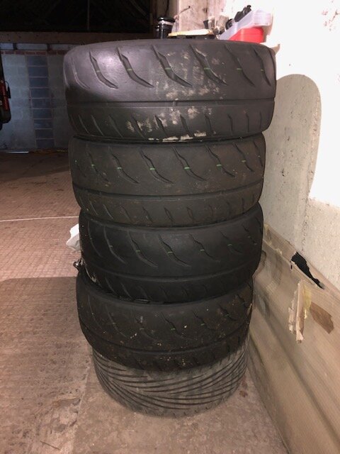

Nankang AR1 or R888 for the road.
Are the AR1's ok in the wet?
Buy some good all-weather tyres for road/wet track use, then just fit slicks for the dry track. Go hard or go home.
Exactly my thoughts. I was thinking slicks for the dry set, but I think I will be needing new suspension before I head towards slicks, something I can stiffen a lot more.

Hard to say as no real one tire does all , with your car being heavily track biased and would think geo set up for track you will ware tires fairly quick on the road. For this time of year i would go with rainsports( but i do stay in Scotland ) then use them as your wets, as long as they dont get too hot they last well and give good wet and damp grip.
I don't plan on driving it on the road much because as you say the geo is going to be quite aggressive, it would also be for the summer months really - I 100% won't be driving it until the weather turns in the new year.

Well the thoughts on what tyres to get got solved pretty quickly on Saturday when I spotted @Tomotek was selling some race scrubbed R888R.
I spoke to the wife nicely about getting some rubber as an early birthday present and she obliged and as I was on a merry little tour of the country on Sunday I swung by and picked them up.
I will look at getting the wheels refurbed in January and the new tyres fitted. These should be perfect for what I need initially (some road legal track focused tyres). I will then look at getting a set of slicks and a second set of wheels in future, but the car needs running and some miles put on it first.

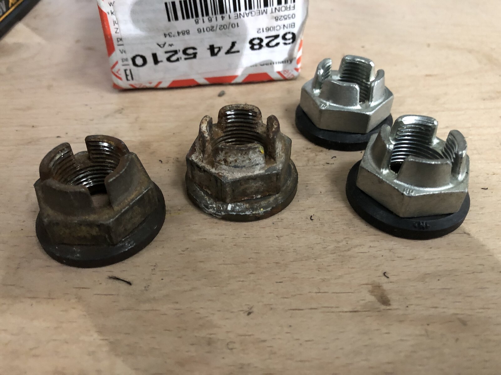

New hub nuts were fitted as the old set were pretty old

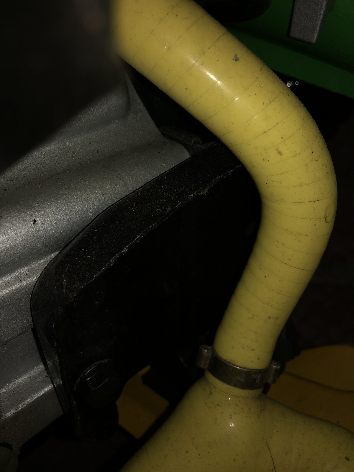

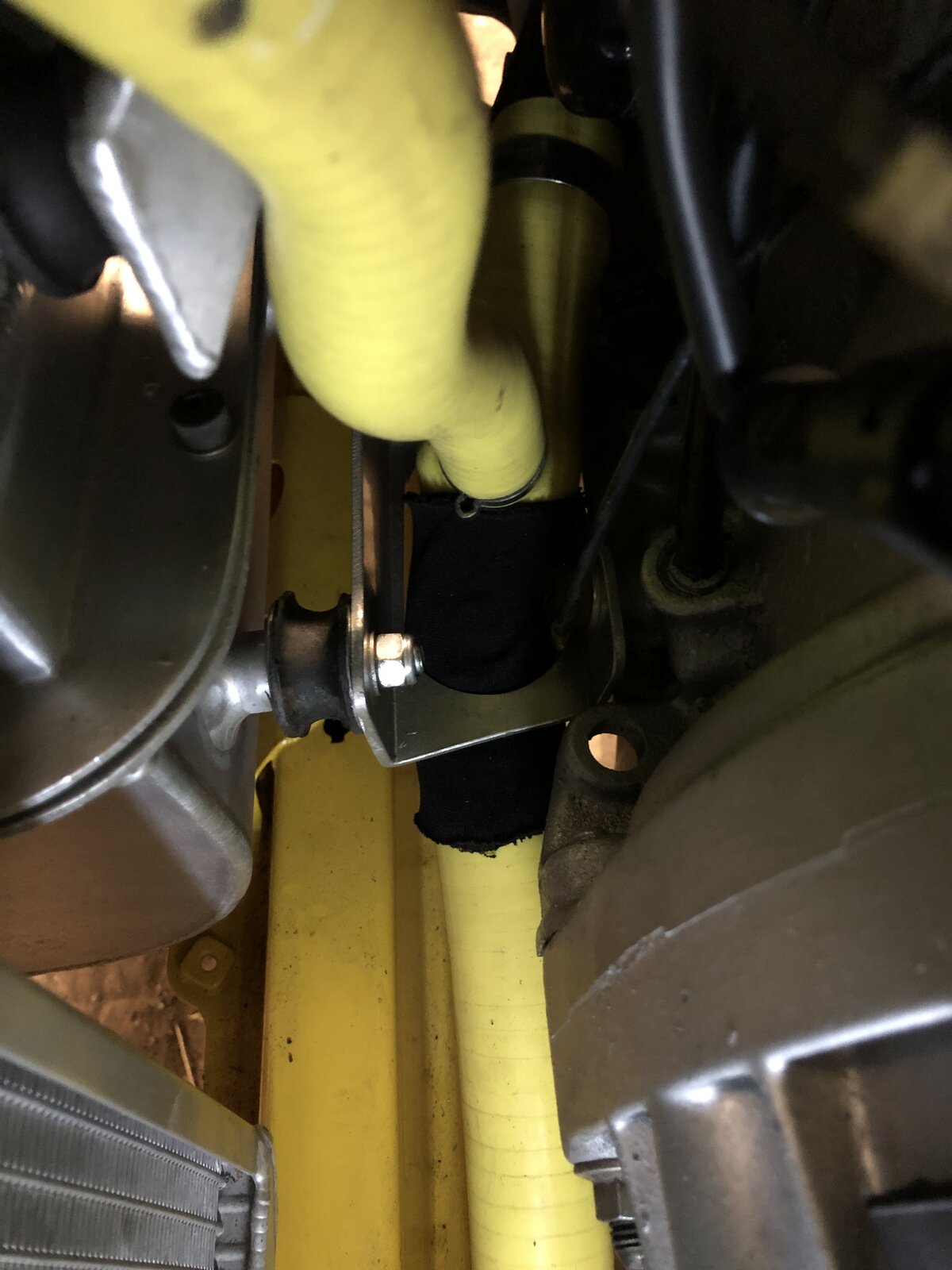

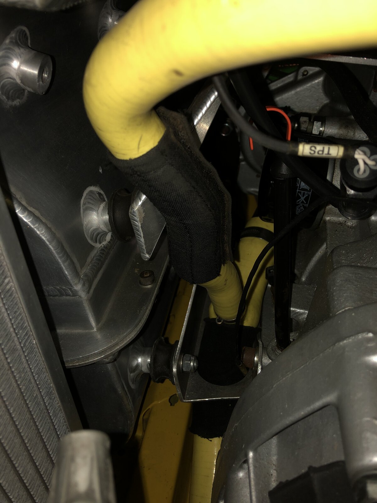

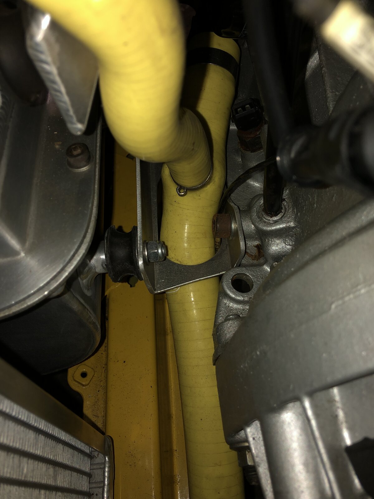

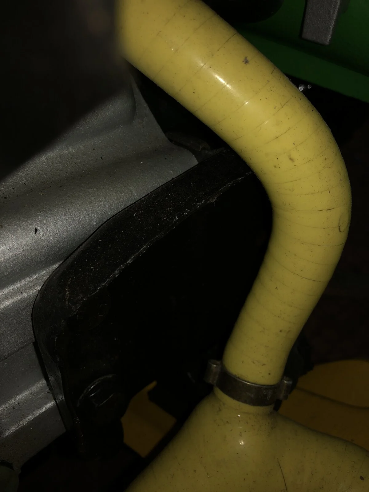

There were also a couple of area's in the engine bay where the coolant hoses were/could foul metal/sharp edges - obviously not a good thing. I thought the best way to address this was to protect them with neoprene. I remembered I had several different frame protectors in my MTB spares so I fished them out, cut them to fit and wrapped the area's/hoses in question
Should do the job nicely. I have also started to look at brake ducting for the front brakes and have a good idea how I am going to address this. More to come soon

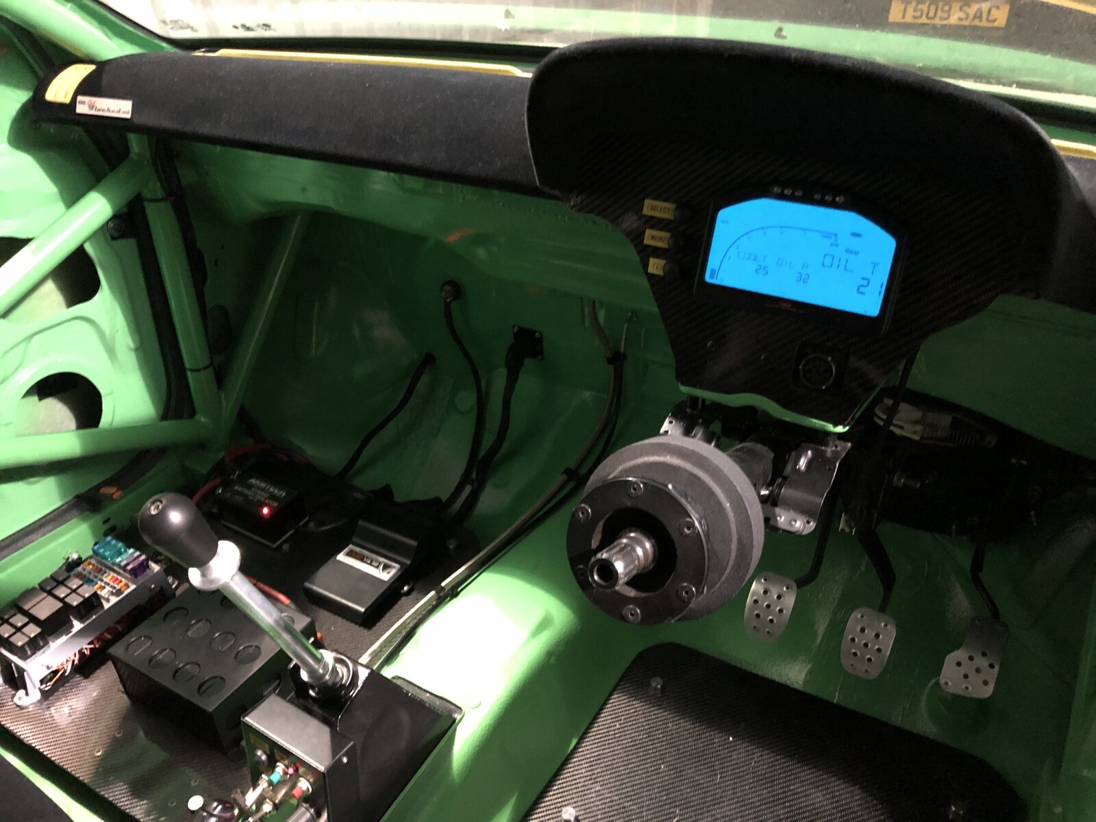

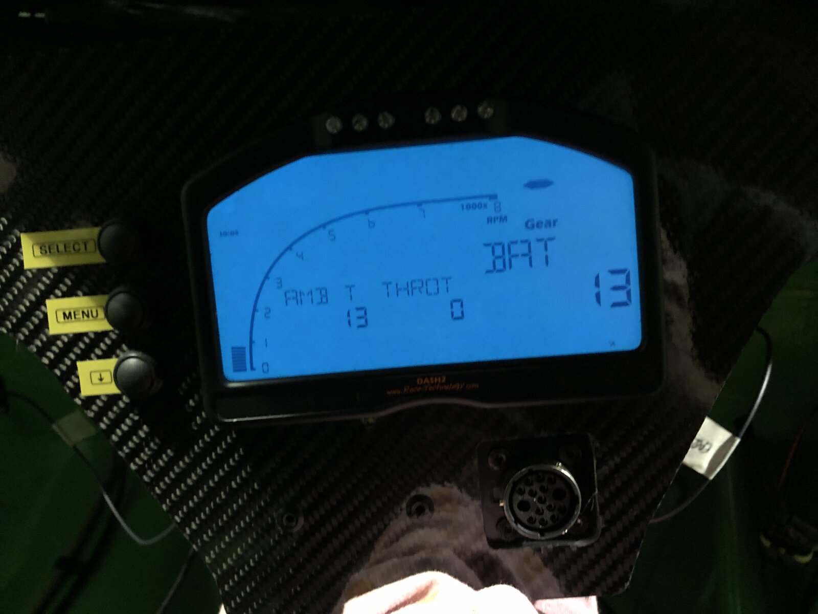

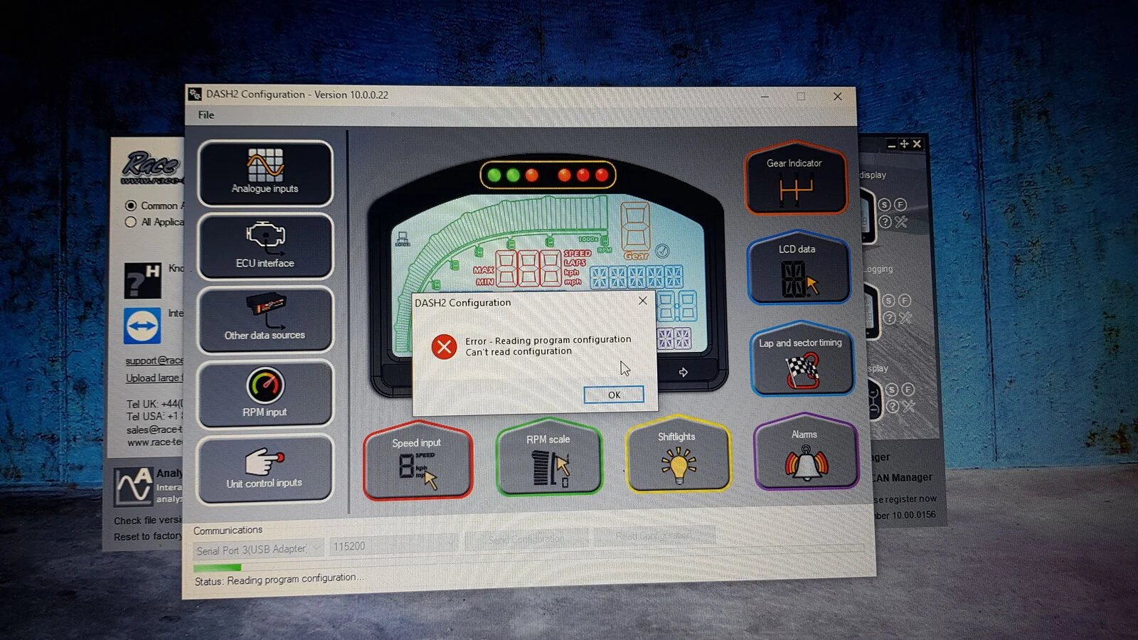

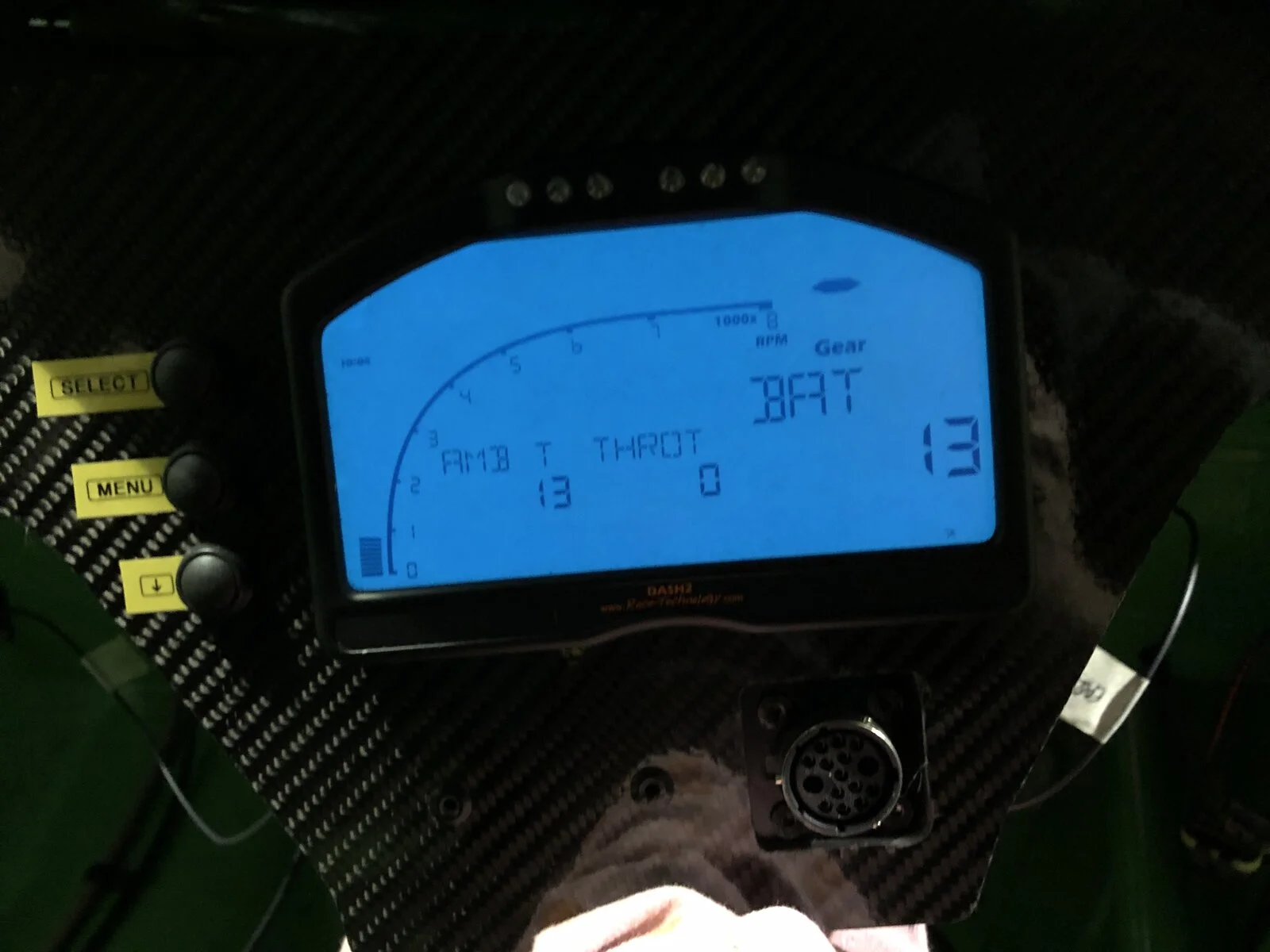

Wow, having a baby does cut your free time down somewhat, but then again so does the faff of the christmas period. The last time I posted about the dash I mentioned that I had to wire in a 12v - 5v regulator that would then power up the Oil temp and pressure sensors - I finally managed to get some time to do this over Christmas (well yesterday).

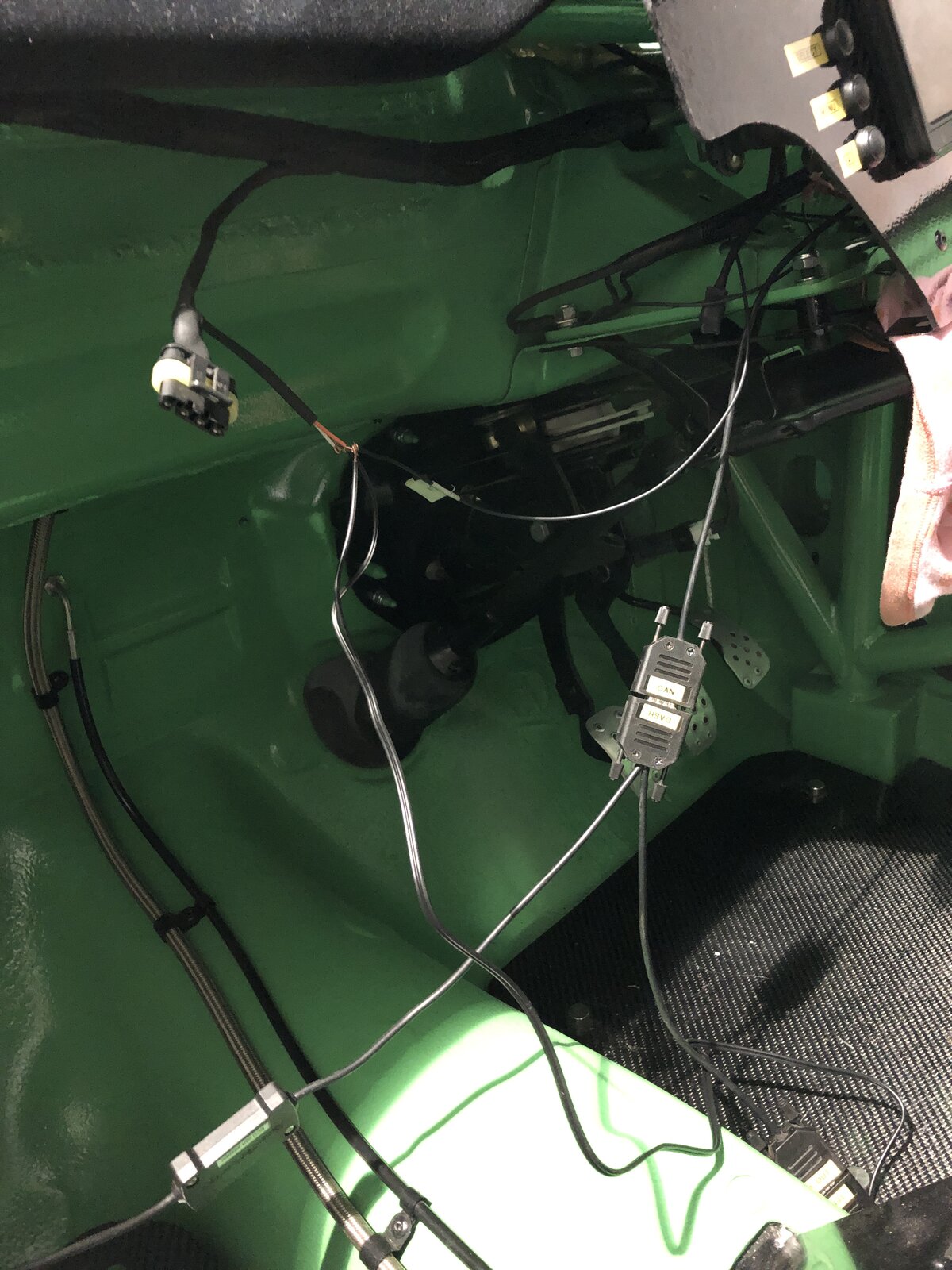

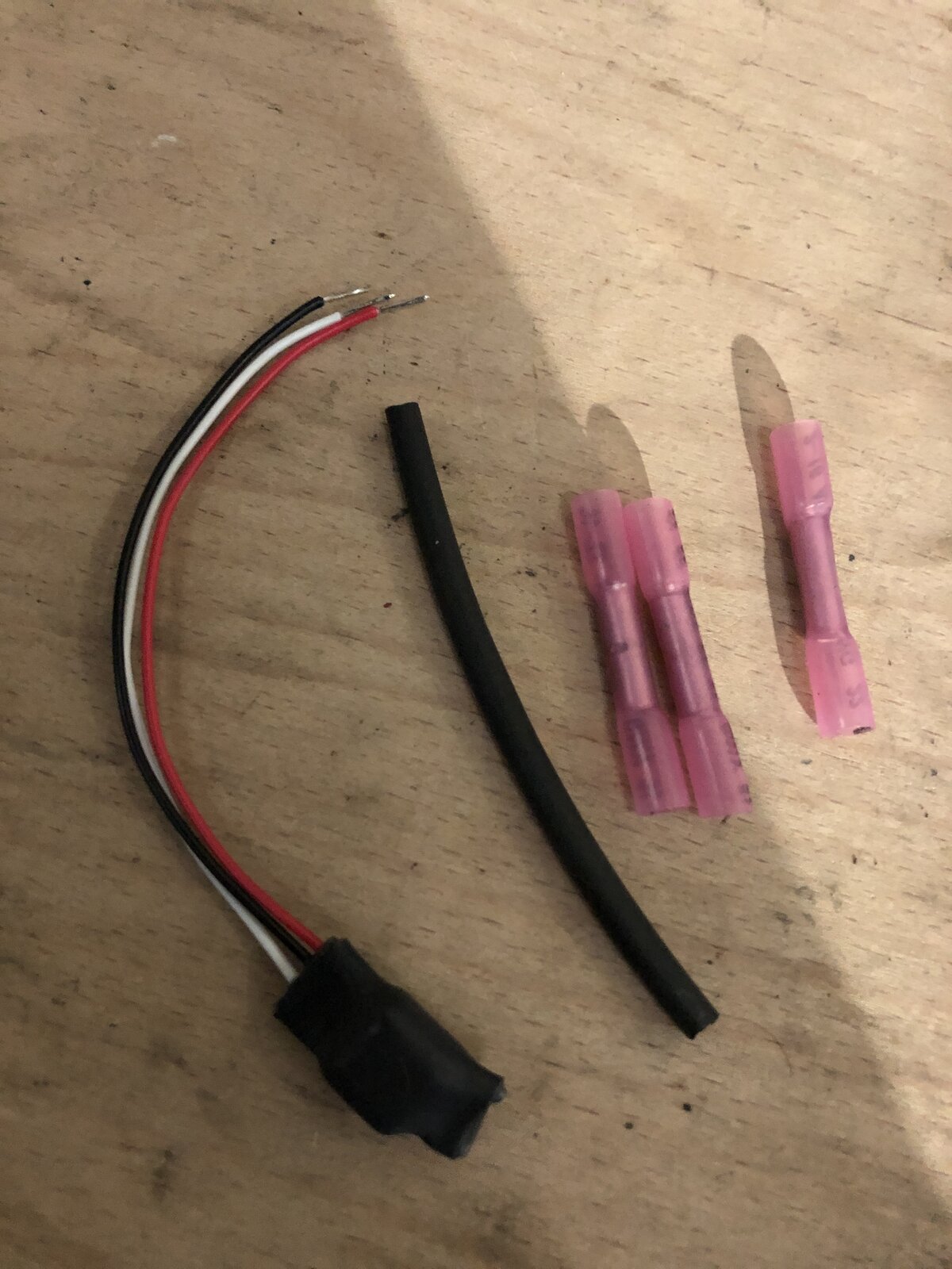

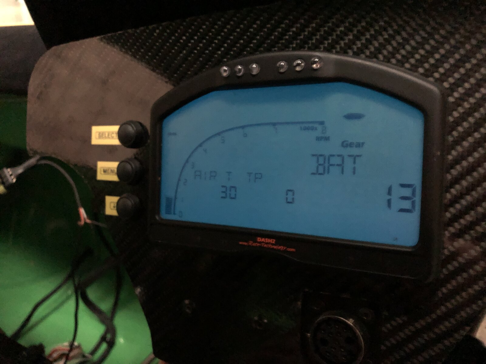

I needed to find the wire going out of the dash loom that would normally be the 5v output (the grey wire, which is redundant in my early Dash2). Once this was found it was snipped and wired to the regulator, which was then in turn wired to an earth and a 12v supply (taken from the same location as the earlier fitted Terminator 12v).
They were all fitted with heat-shrink connectors...
But guess what, for some reason they were not powering up the sensors. Frustrating.
I decided it could not be the regulator wiring as I checked this multiple times and it looked spot on.
Instead I was pretty sure it was where I spliced into the 12v supply/the Terminator supply. I decided to cut this back and re-wire but instead of heat-shrink connecting it up I initially mocked it up with just twisted wires. I checked for power multiple times at each point to make sure it was all being wired up correctly and prior to turning the dash on I was getting 4v at both the Oil temp and pressure sensors - promising.

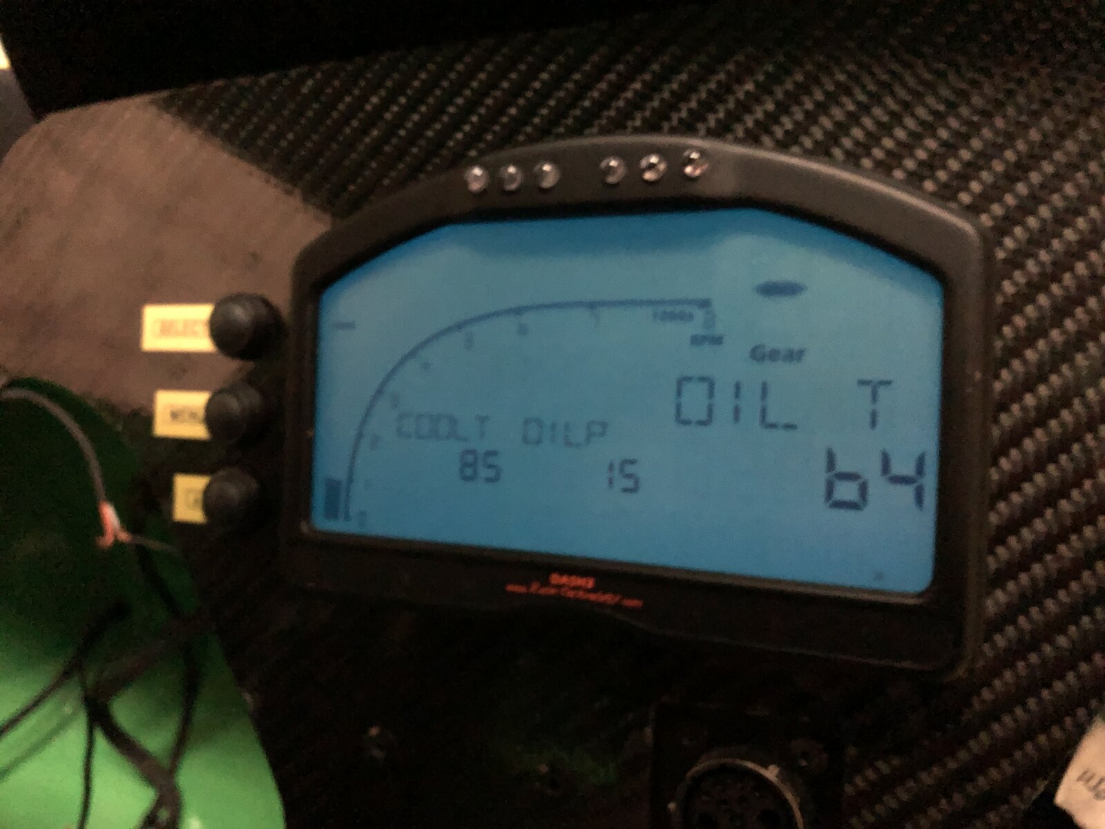

Sure enough when the dash was fired up I finally had data coming from the Oil sensors (all other data from the ECU).
There is a bit of a concern that the calibration on the Oil pressure sensor is off so I need to look at the equation for that as I am pretty sure its not power engine oil pressure, but overall I am really pleased that this is almost sorted.
There are some bits I need to tie up with it as well as the calibration, this lot needs tidying up....
This should be pretty simple as there is sensible lengths to play with, I will add the heat shrink connectors and I have also bought some loom tape to make sure any areas are nicely covered, then that will tuck up with the dash top and cage/dash bar as previous. I do still need to somehow find some 0.5a or 1a micro blade fuses
which seem pretty illusive.

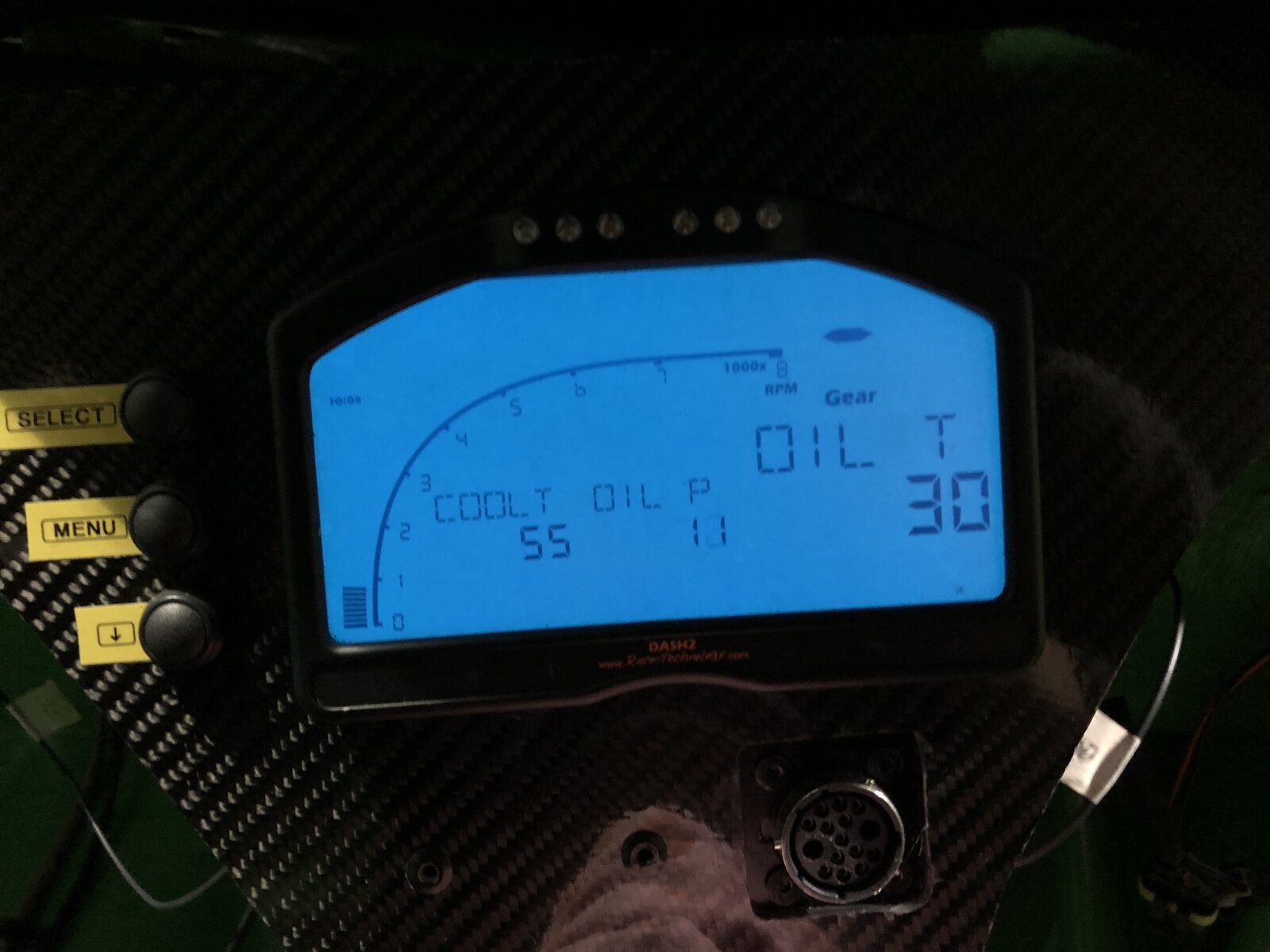

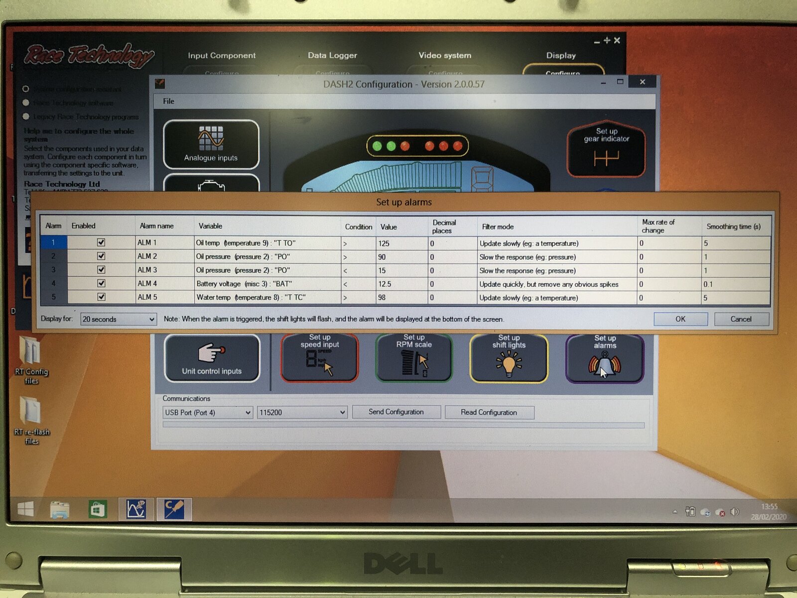

Managed to get a little bit of time on the clio again today. Extremely happy with todays outcome as I feel this was a long journey to get here.

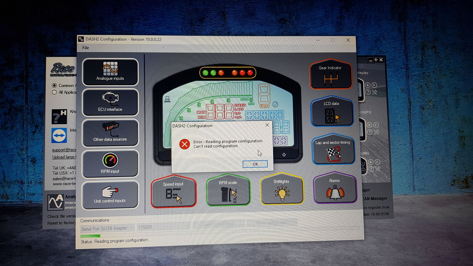

With the help of James Ashton (BigAsh) again I managed to get the calibration/set-up on the Dash2 right finally. I am now getting info/readings from all the correct sensors (as shown below):
I have also got the information about operating normal/safe operating temps, this is useful as I am now aware you can set-up alarms on the Dash2, I will likely be be doing this for the oil and battery readings. Next up now all is working is to tidy up the wires finally, very much looking forward to that and having that done.

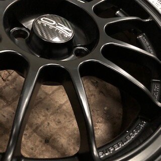

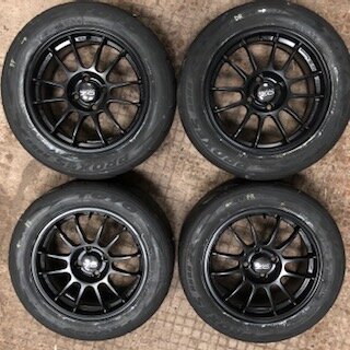

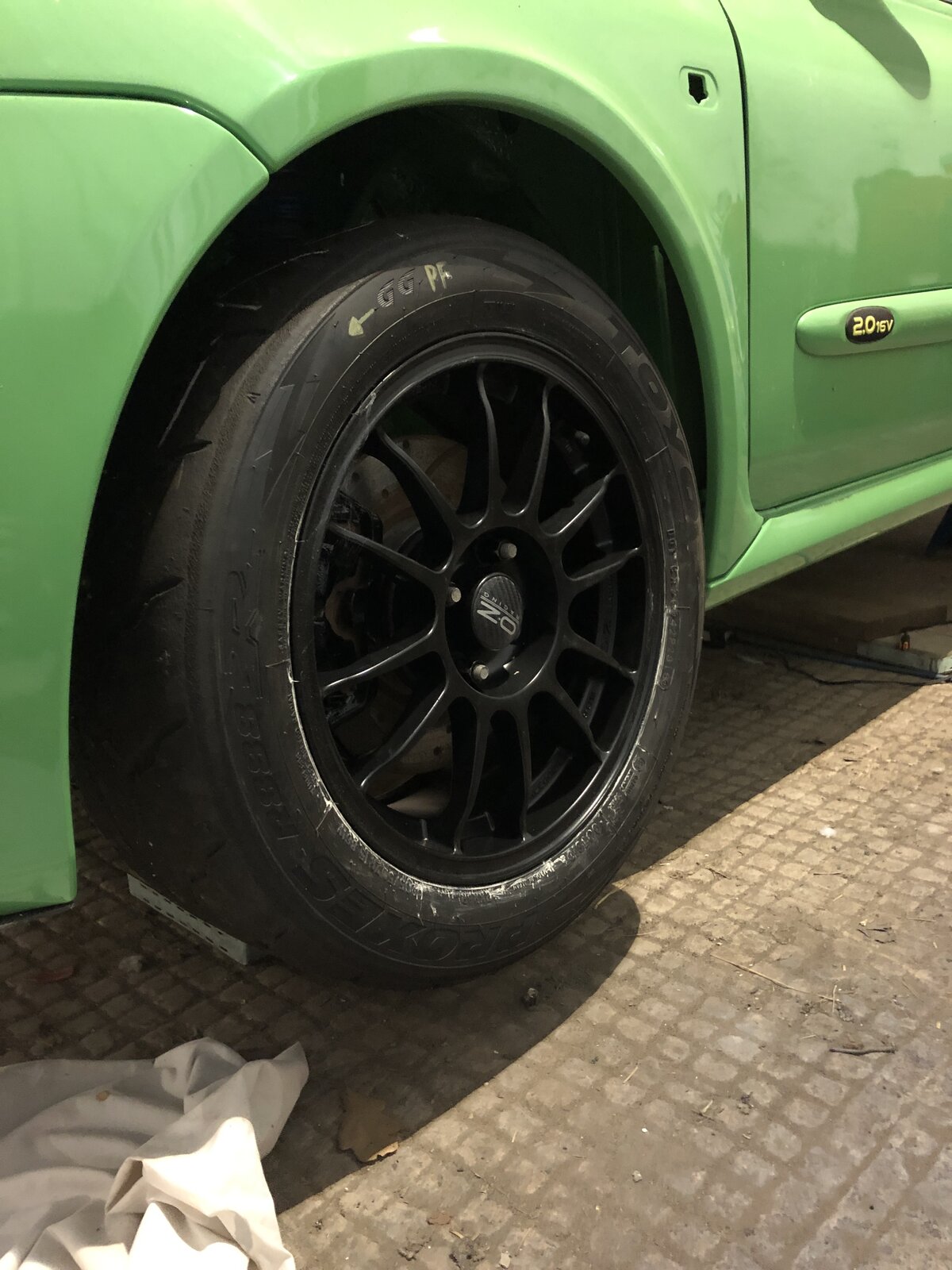

Wheels were dropped off at City Powdercoaters last week and collected today. Very lucky that they are close by to me currently which makes it a no brainer, especially at the price they charge. Extremely happy with the finish too....
I went for Satin black to match the other items throughout the car that are not either green, yellow or carbon...
Balanced, valved and all wrapped back up in the R888R
Very much looking forward to getting them back on the car. Prior to that though I want to do a couple of jobs.
View attachment 1454816 View attachment 1454817

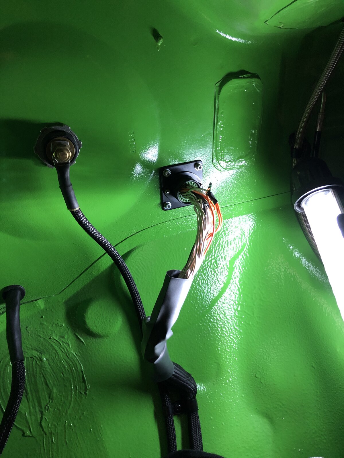

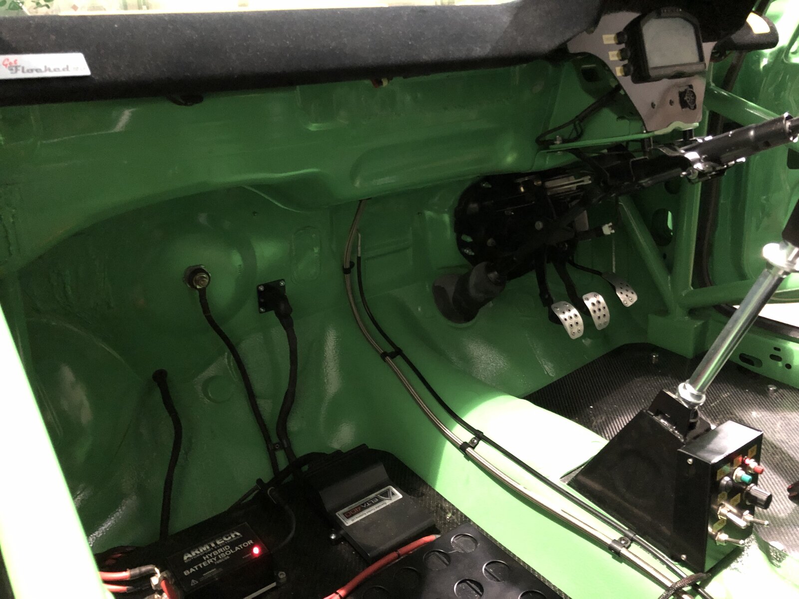

With the dash comms pretty much sorted I needed to finalise the loom (the new items were only twisted together wires).
I also needed to sort out where the bulkhead connector went into the bulkhead. Northampton Motorsport left this so I could sort the dash oil communications.
I purchased some loom tape a few weeks back but was just looking for a bit of time to do it. The new additions were taped and along with the rest of the loom was organised and tucked up under the top dash.
I had some Raychem bulkhead connector rubbers for the loom - connector, keeps it really nice and tidy and protected. The interior connector went really well but the engine bay side I heated too close to the connector and the rubber bunched up - I need to cut it off and replace, new rubber ordered....
With that pretty much done all I had to do was finalise the dash calibration by adding some alarms, pretty useful for protecting the engine.

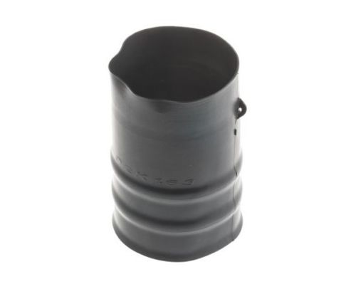

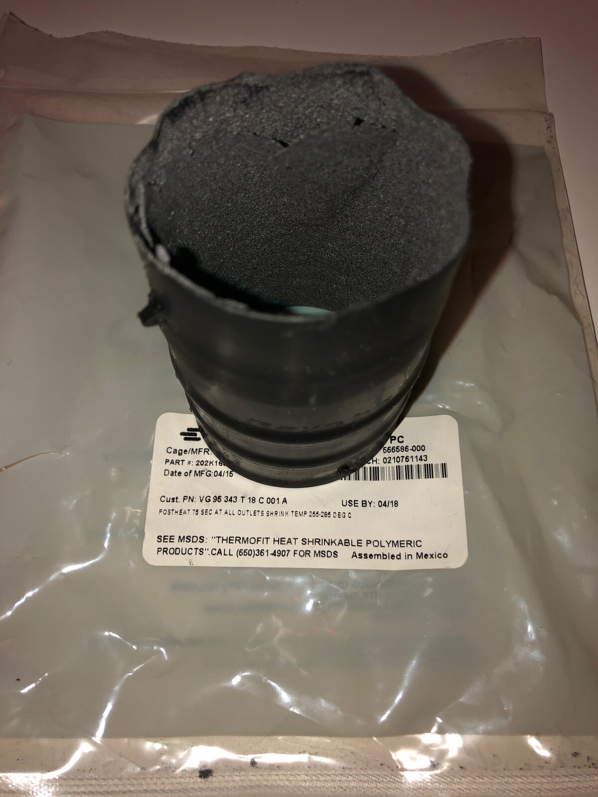

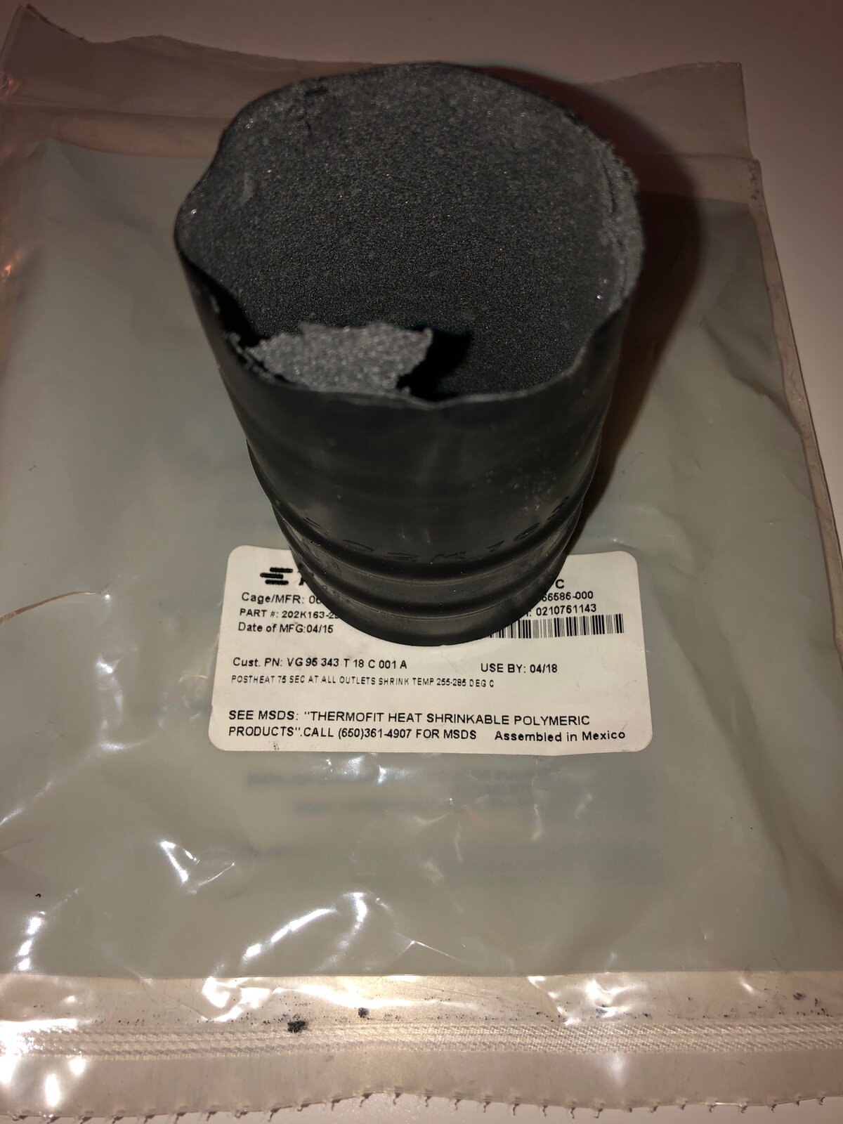

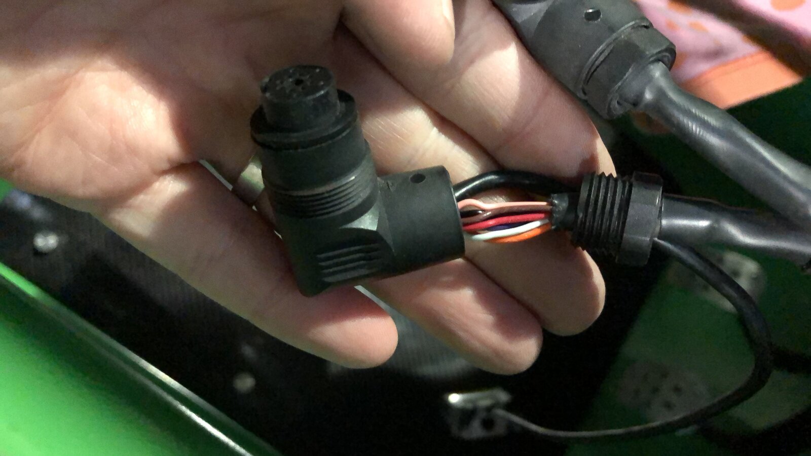

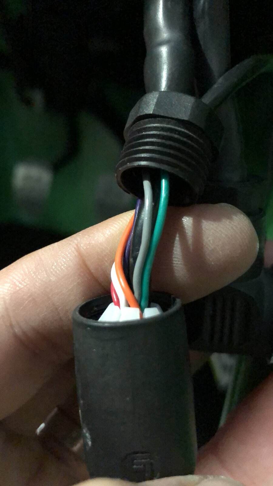

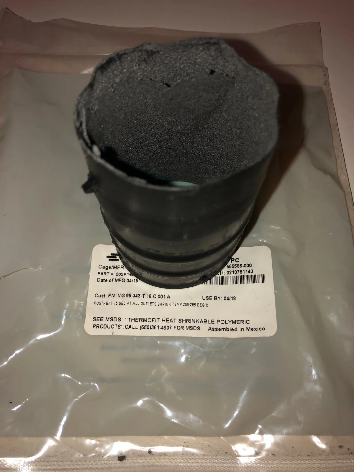

I did order a new heat shrink boot off of ebay, but I am pretty sure its a knock off jobby. It turned up with the inner lining flaking off quite badly so it is being returned straight away - jokers....
Need to try and find another one (which seems easier said then done)
VenomUK
  Clio 172
Someone has handled that while saying in their head "its not going on my car" and off it went! What jokers!
Nafoff
It has a use by date? Does it have adhesive inside?
I believe it does yeah, when you heat shrink it I believe the adhesive helps it adhere to the surface you are putting it over.
His reply:
“Hello, It looks like some of the /225 pre coated adhesive is coming away. This is fairly standard with the product you have ordered. When the parts are made in the factory they are actually coated with 2 x the required powder coat to allow for this. Having over 25years experience in the harnessing industry I can say it will work and perform exactly as expected. However, if you would still like a refund then I’d be happy to do this. Please return the item in the bag it was supplied in and I will action this for you. Kind regards”
After spending silly amounts on this car and a lot of time and money sorting this loom I am not risking it on an £8 part

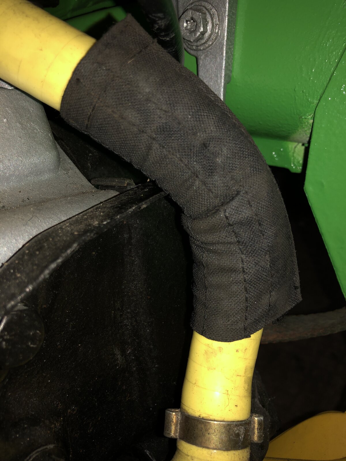

A new heatshrink boot has been ordered from FCLane, it is Hellerman rather than Raychem but reading the specs it all sounds the same. FCLane were awesome too so I will certainly being using them again if needed, once that arrives it will be sorted asap.

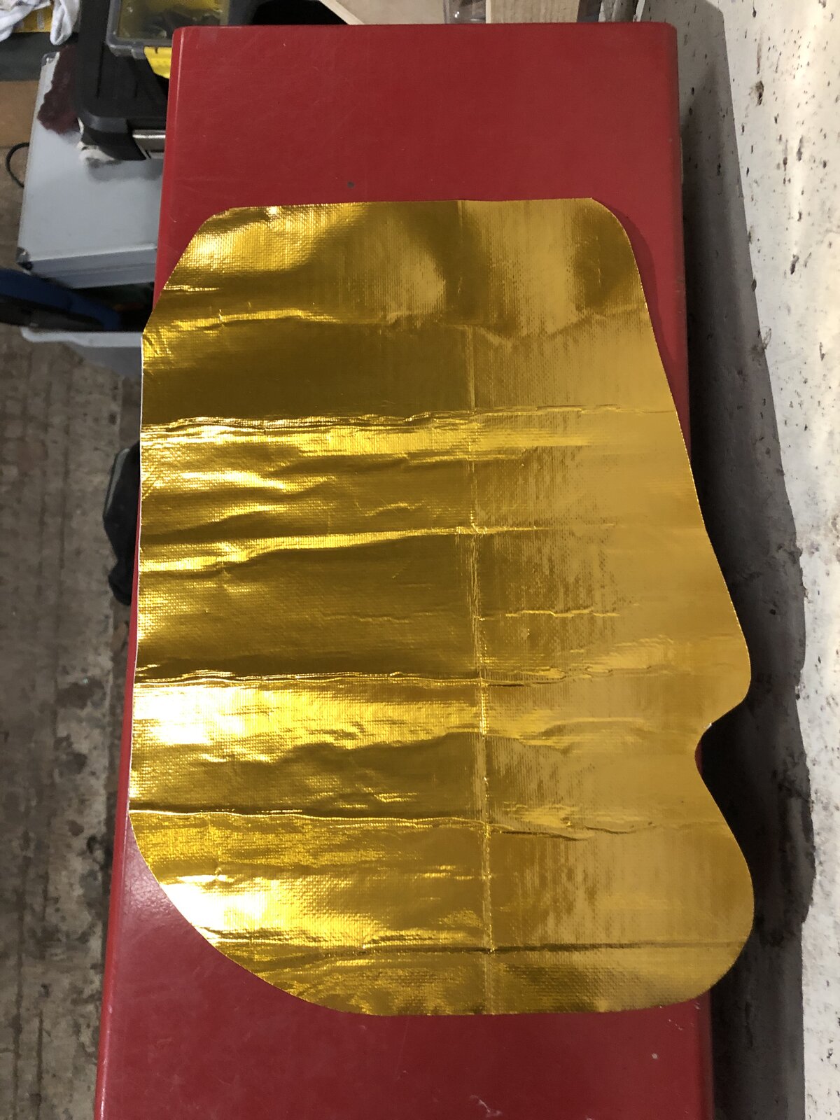

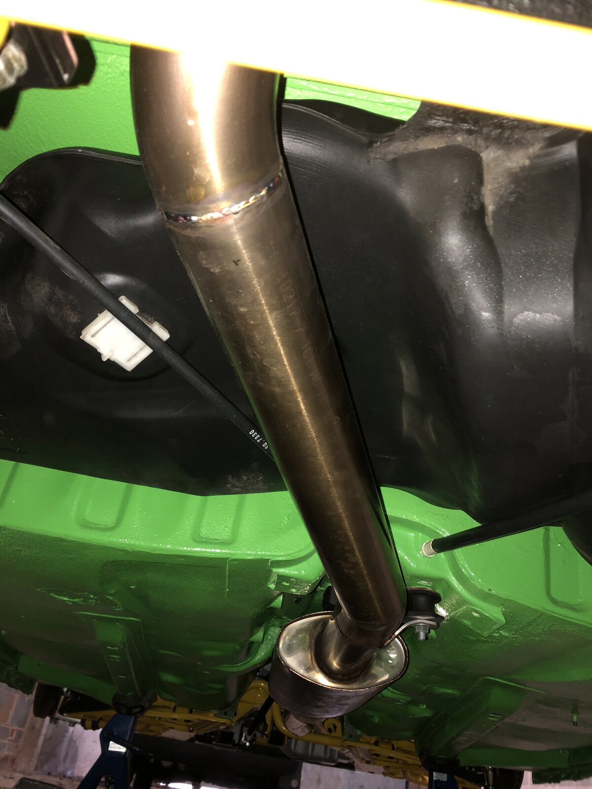

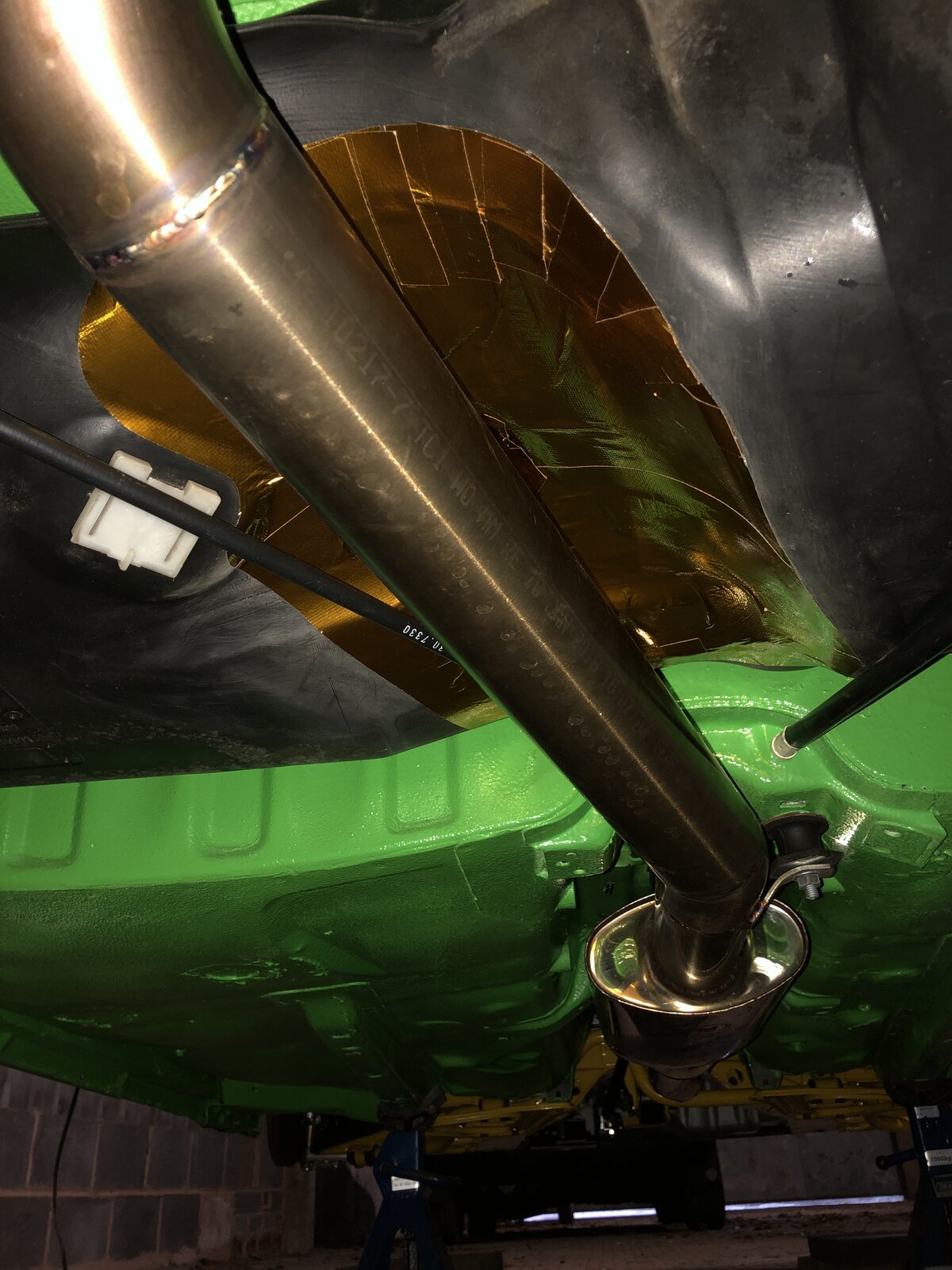

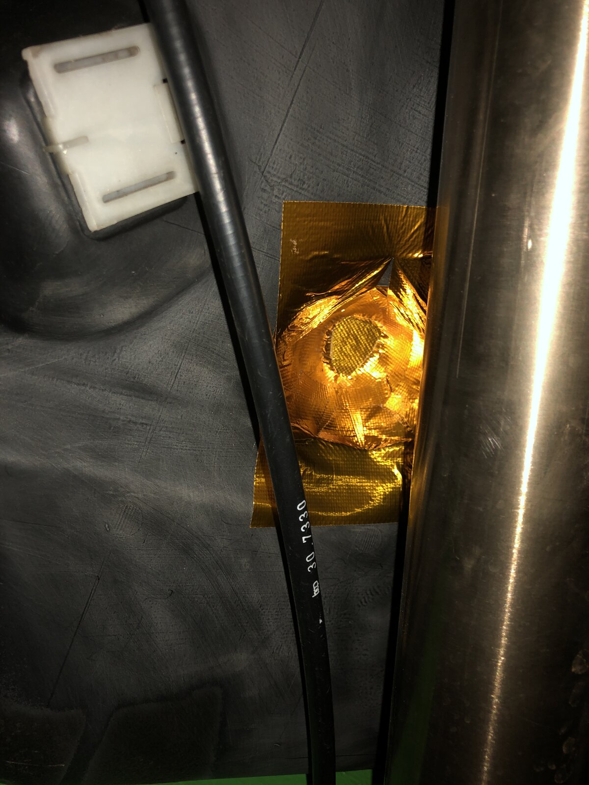

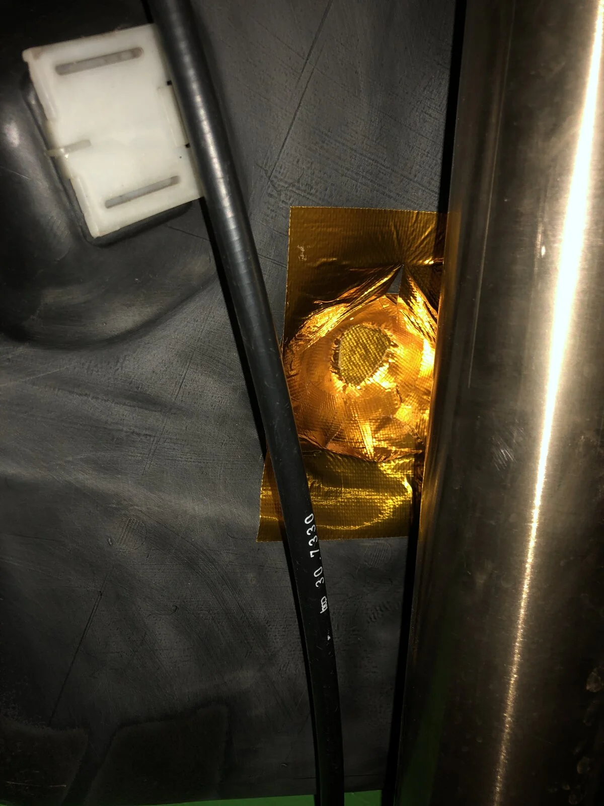

Grabbing little bits of time to do jobs is how it is now, but how does foiling something take 2.5 hours?
I ordered the A3 gold foil heat protective sheet from Funk Motorsport a few weeks back and today set about applying it to the fuel tank where the exhaust passes it - this is the only place I think it is needed currently, (the fuel and brake lines are inside the car)
The area is a bit of a weird shape with a dip in it and a fair bit of contouring. I had to clean up the tank with brake cleaner and then roughed the area slightly with some scotch pads. I then set about wrapping the dip first before making up a template and cutting it from the A3 sheet for the rest of the area.
With the shape cutout I laid underneath the car for the majority of those 2.5hrs and applied the protective sheet with as little air pockets as possible, corners were cut to allow fanning and shaping around the contours - these were then covered with a second layer so the area was fully protected - pretty happy with the final result.

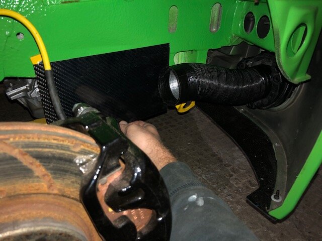

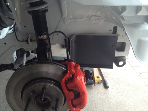

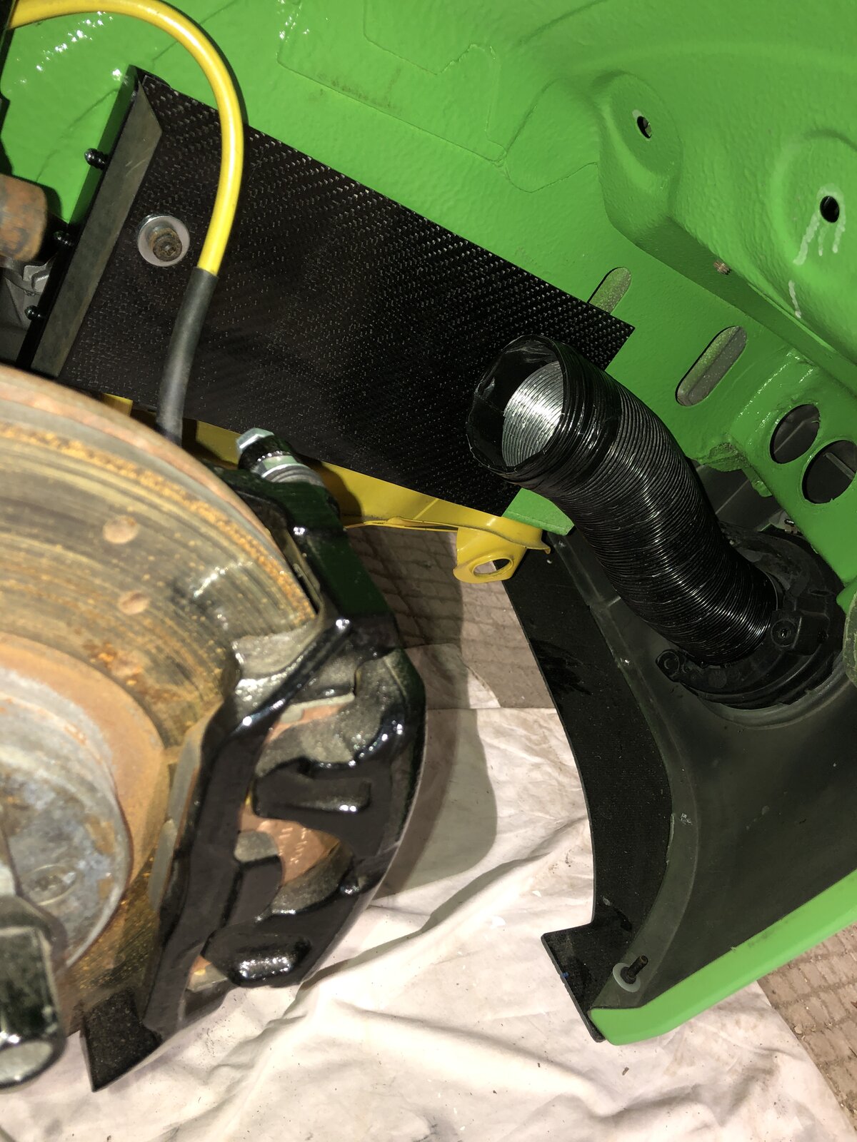

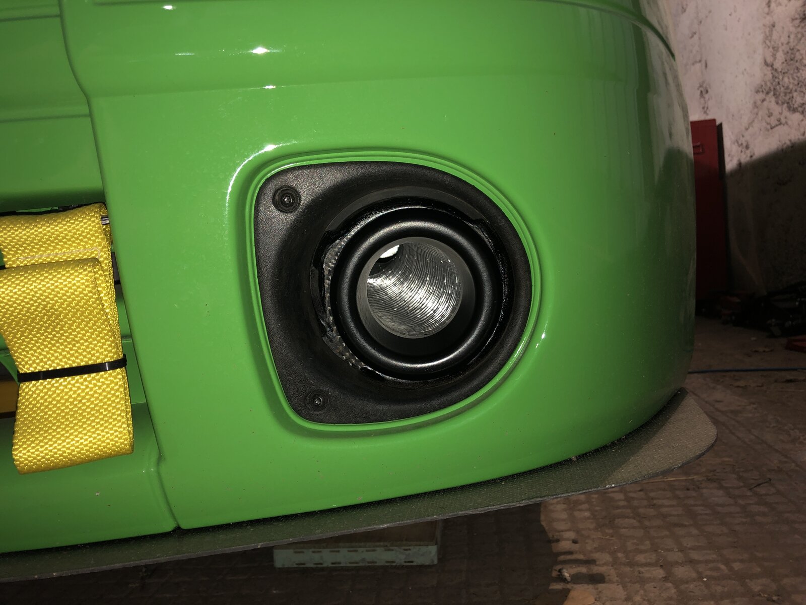

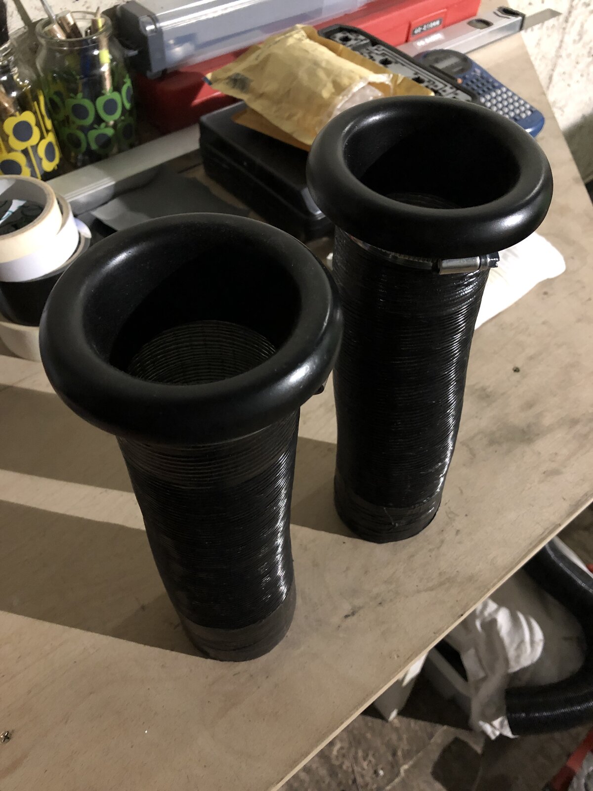

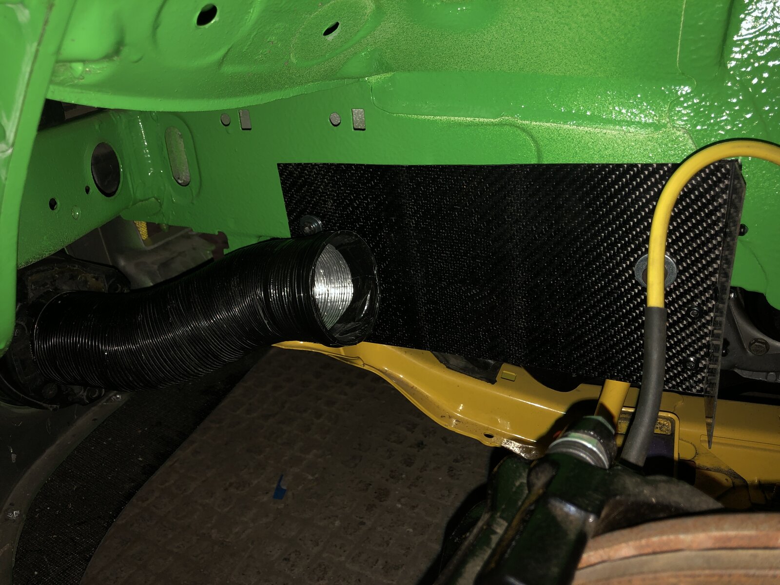

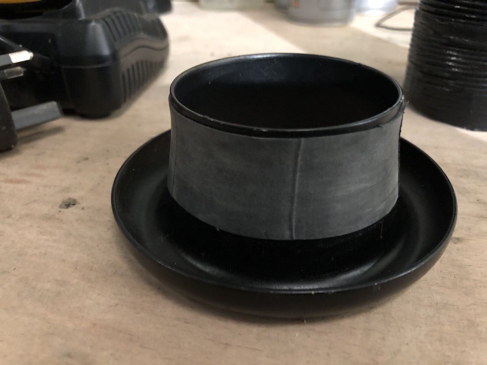

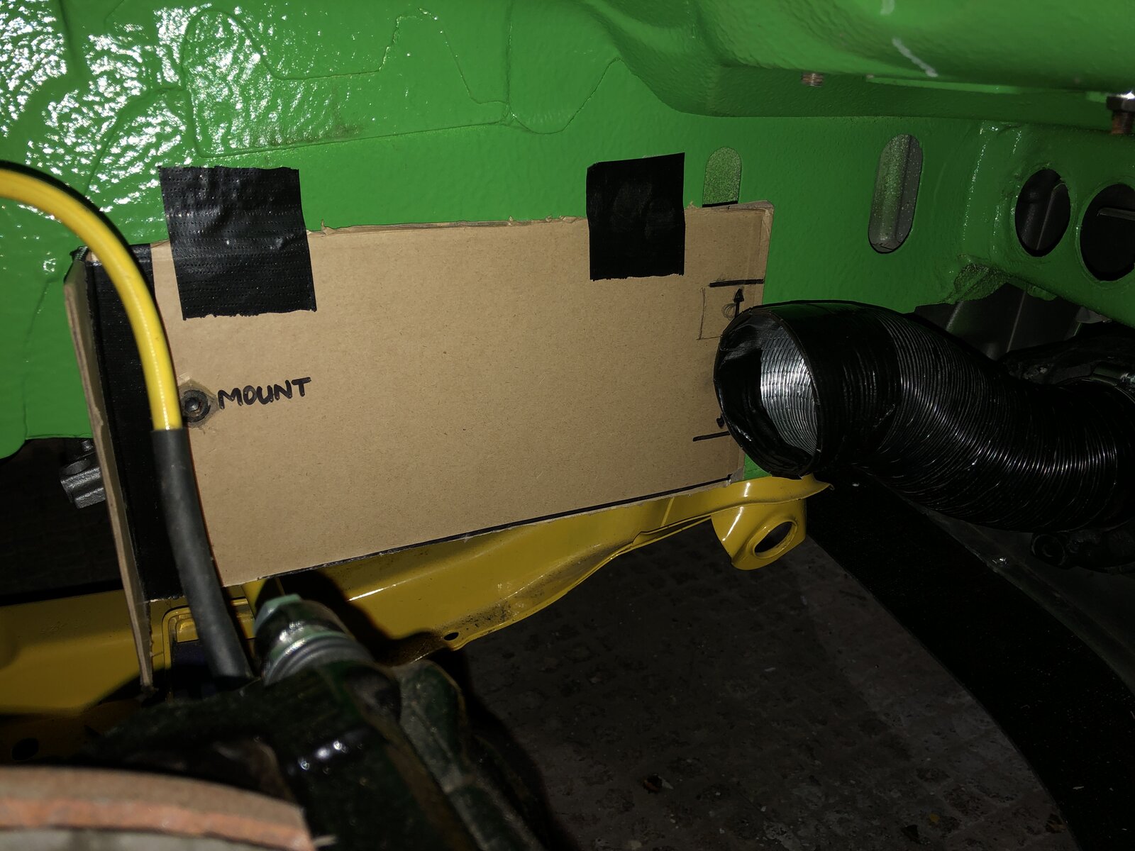

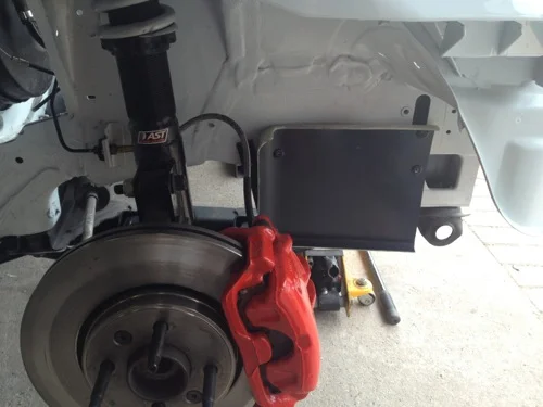

I have really wanted to get the brake ducts/deflectors sorted (as well as the new handbrake cables fitted) so I can drop the car back on the ground.
I spotted these a little while ago so using these as a reference I started to look at how I was going to make something up.
I already had the trumpets and the ducting and I think I showed a little while back in the thread the carbon plates I made up for the fog light holes to take them down to the ducting diameter. I needed to work out a way to secure the trumpets/ducting.
The ducting is wire structured plastic and when I tried jubilee clamping them down the ducting just kept pushing the trumpets out of the end, I needed to get a bit creative. I ended up plier squeezing the ducting down at the trumpet end so it was flat all the way around rather than ridged. I then had a brainwave when I was working on my bike - I could use some inner tube rubber around the trumpet end to get the ducting to grip...
Jobs a good'un....

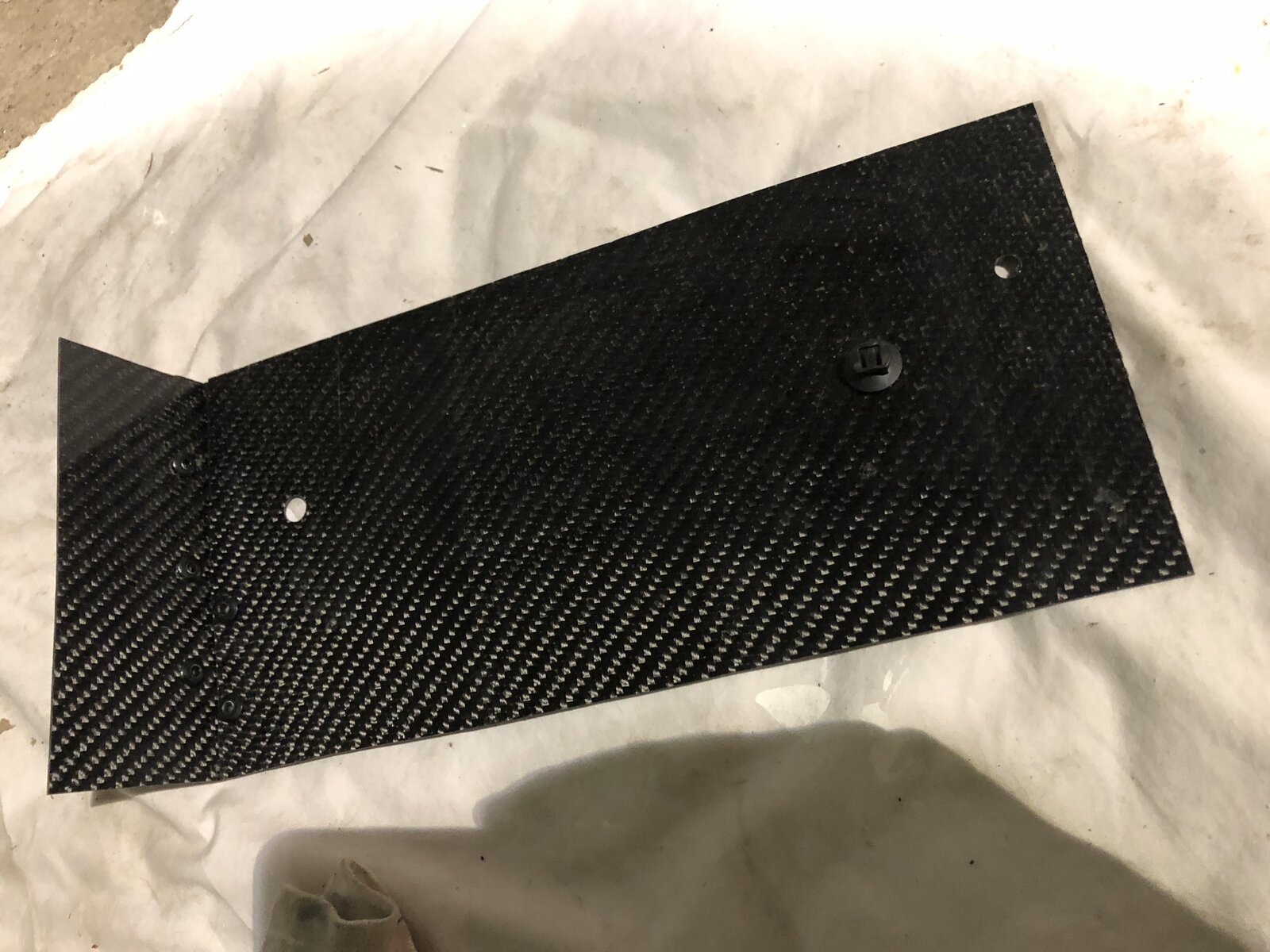

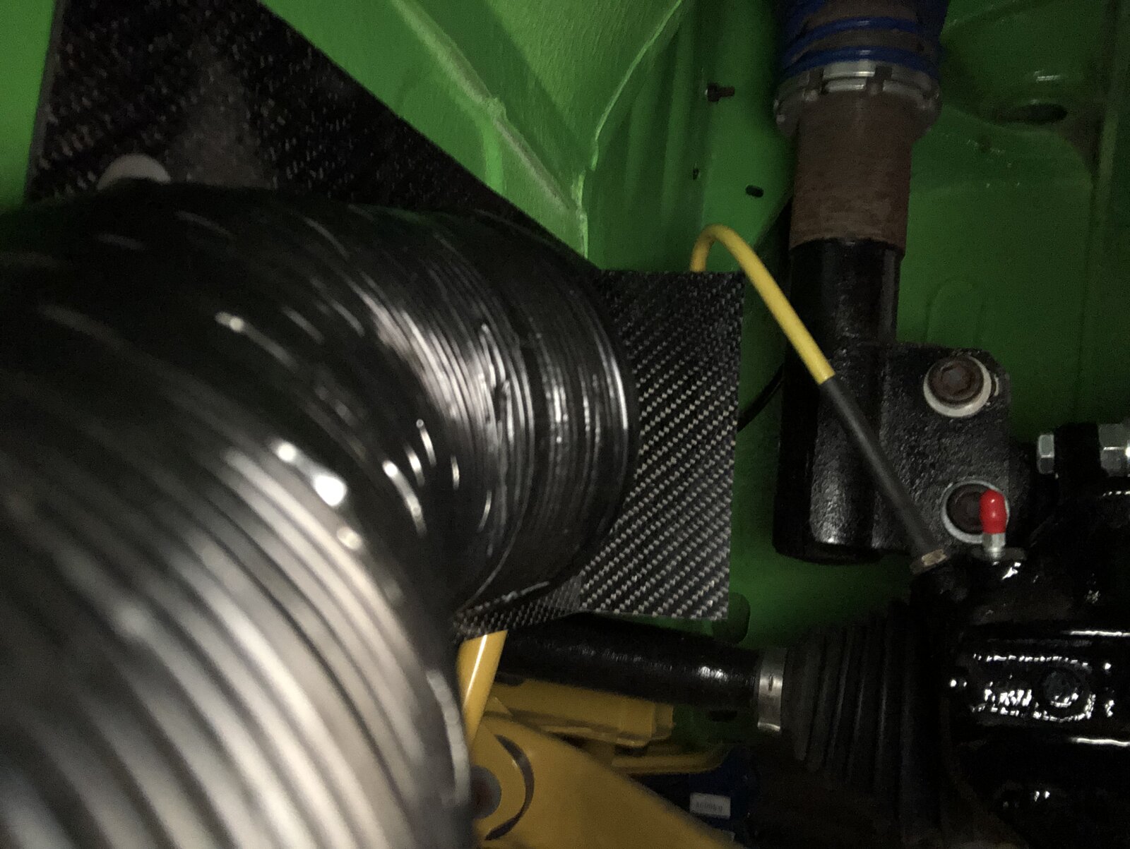

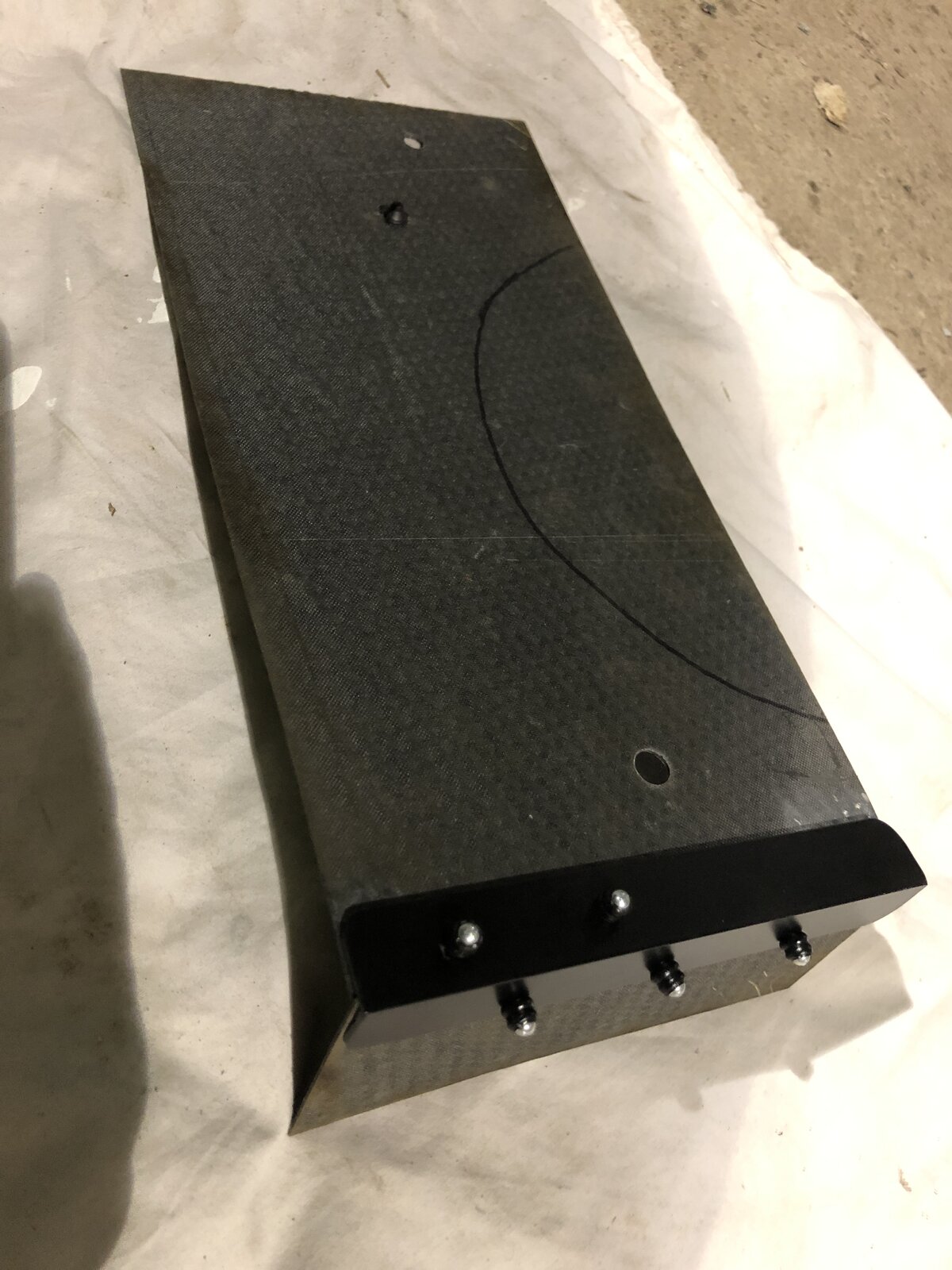

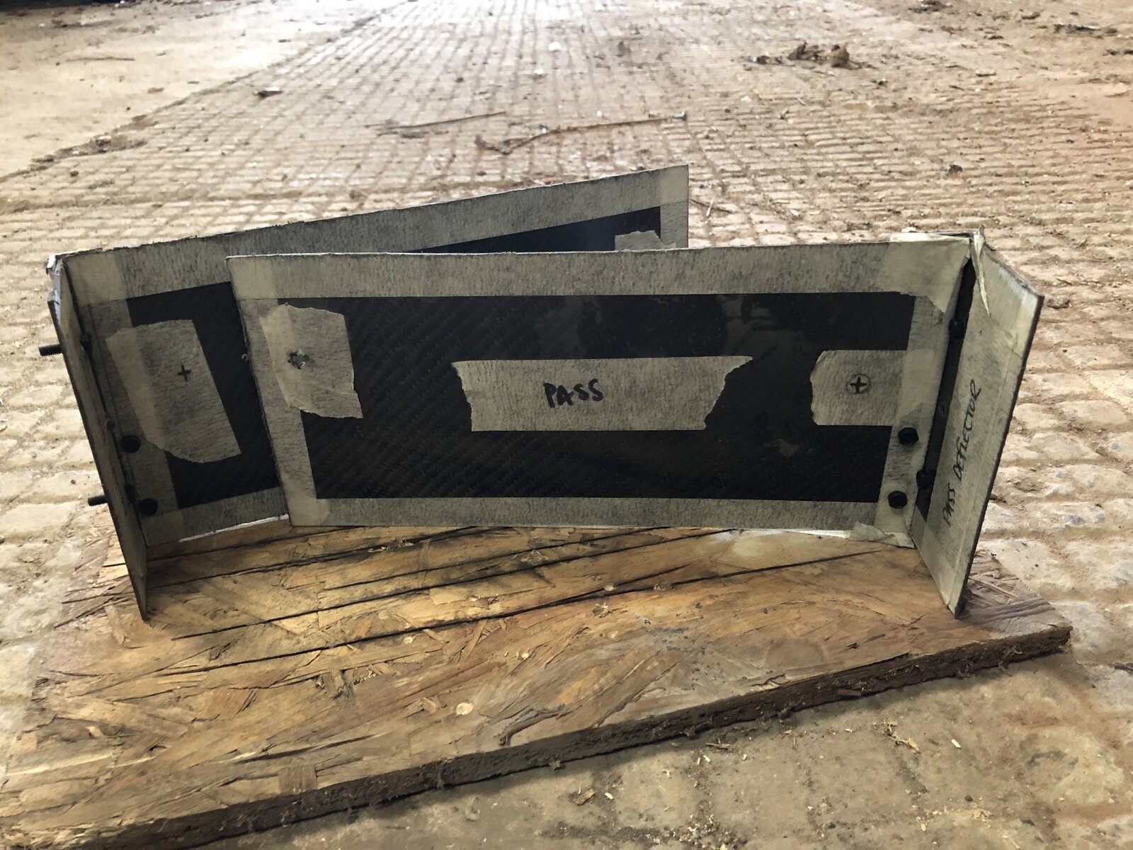

With that sorted I turned my attention to the deflector. I spent a good amount of time with my head in the wheelarch drawing up templates out of cardboard and duct tape, marking where the arch was behind it and where the potential mount points were.
I used the wishbone to arch brace as a mount point and the I planned to riv-nut the front area and bolt through there also. I looked at the right angle (actual deflector) and measured out how far I could come towards the calliper. Happy with my template I moved this to the only material I had... CARBON
Carbon is a bit pimping for this job but I do have it lying around in quite a few bits, its also nice and lightweight/thin so it does have a bit of flex (pretty useful in this area). All measurements were taken over to the carbon pieces and marked up for driver and passenger sides.
These 2 pieces are held together by ally right angle cut and drilled to take rivets - all nice and light... and then painted satin black #becausetart
On the front you can see I have added a trim clip slightly lower than the front mount, this lets a zip-tie pass through it and will be used to secure the ducting at the arch end...

With everything made up tonight and having riv-nutted the arches earlier in the week I fitted the deflectors and ducting this evening.
Pretty pleased with the result, I am also quite happy with how flexible it is, this should mean any big bumps and there is no further damage to anything - it is pretty close to the front edge of the tyre on full lock...

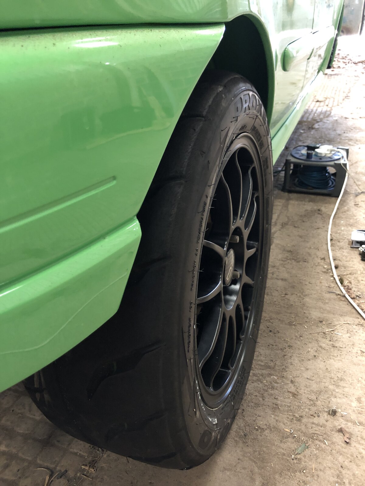

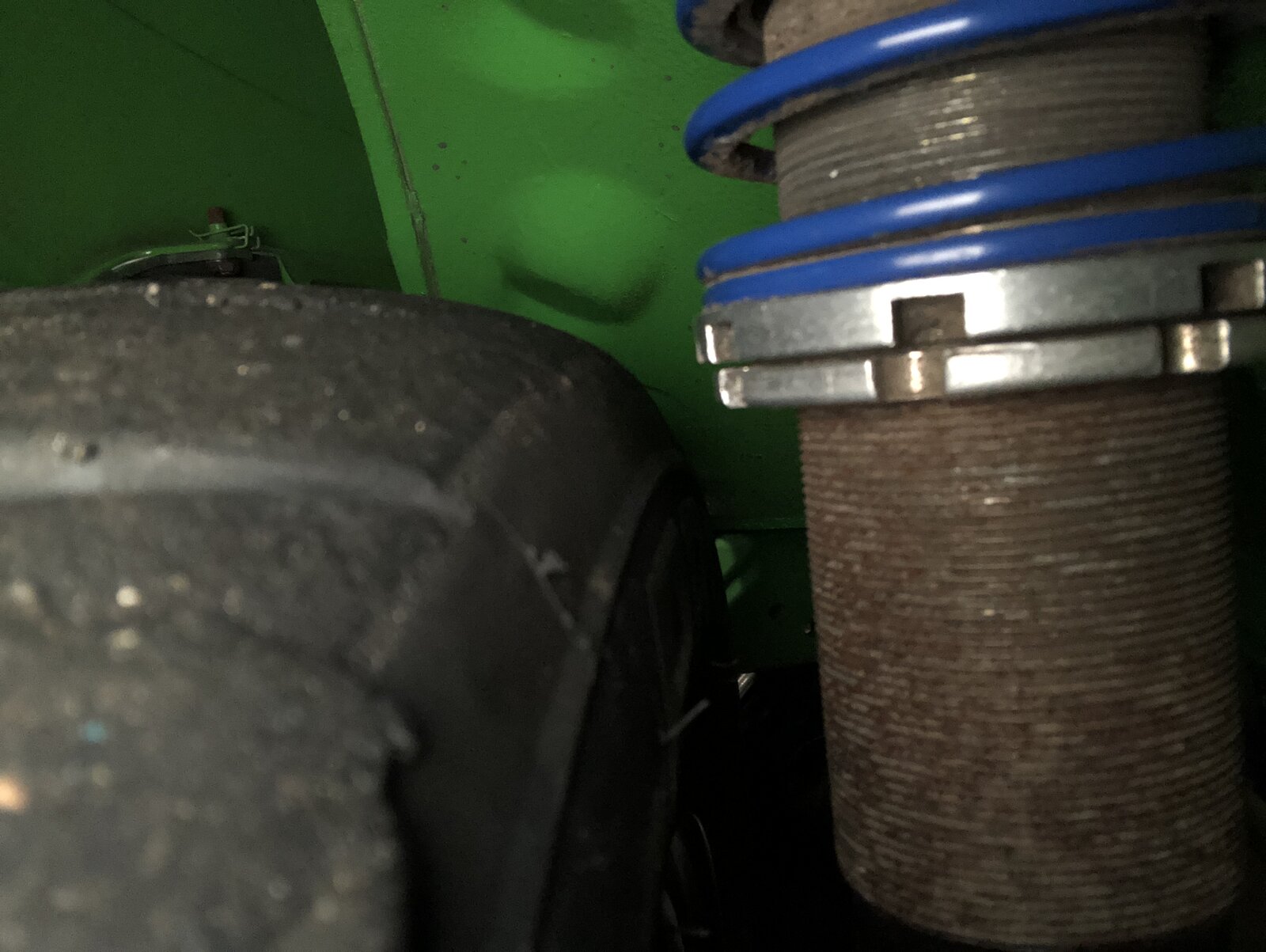

Born out of putting the front wheel on to check clearance for the deflectors it appears I now need to order some new spacers...
I am thinking this must be because of the taller/stiffer sidewalls of these new tyres as I am sure there wasn't an issue when the car was being rolled around previously on the same wheels and 5mm spacers.
I have 4 5mm spacers so this allowed me to work out spacing chucking an extra one in to figure out how far to go....
10mm seems to be about right on the front, but only just
and only just on the wheel studs too.... (they use to be real long on the Image wheels)
Once I have checked spacing on the rears I will get new hub-centric spacers ordered up for all around.

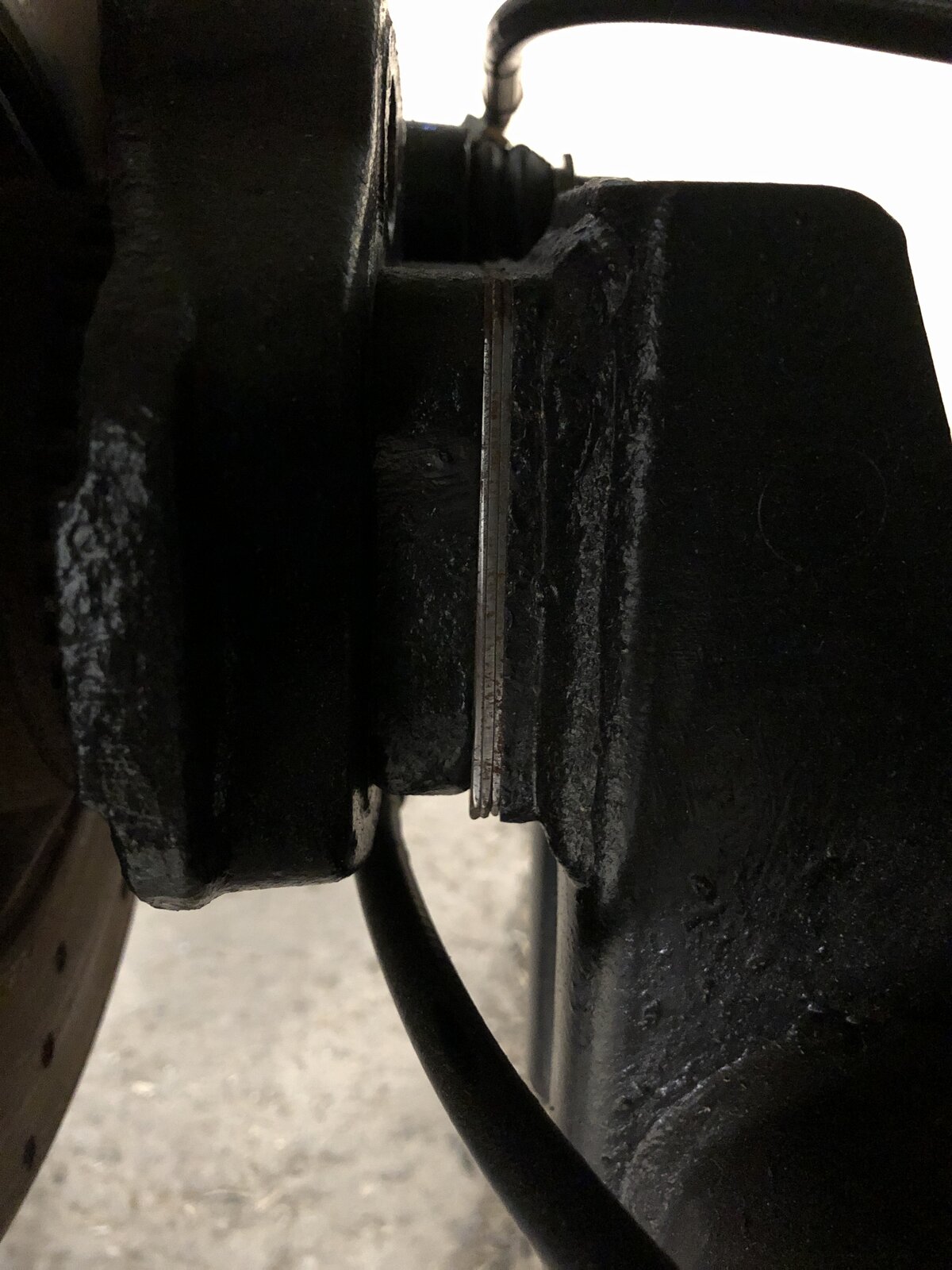

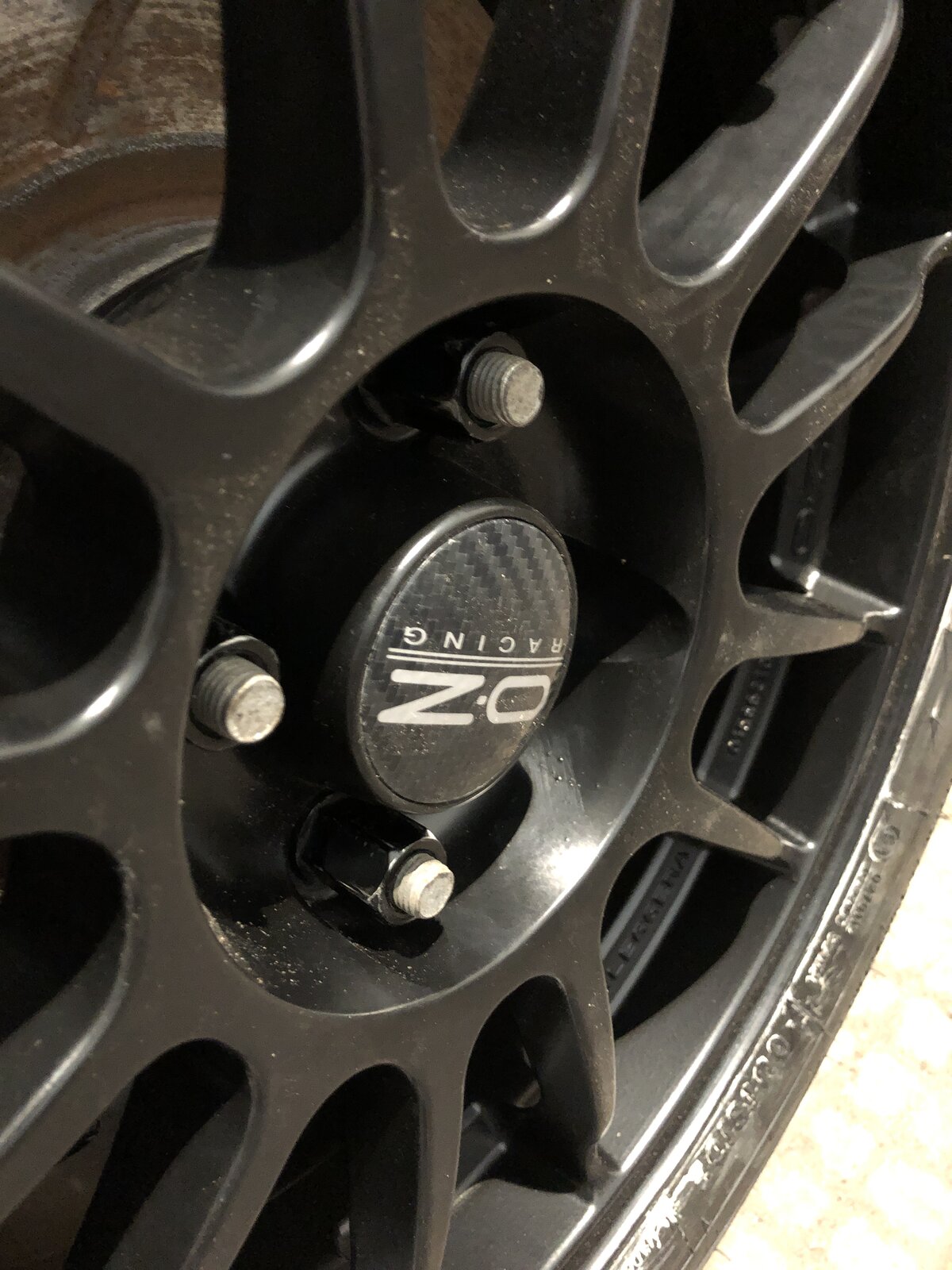

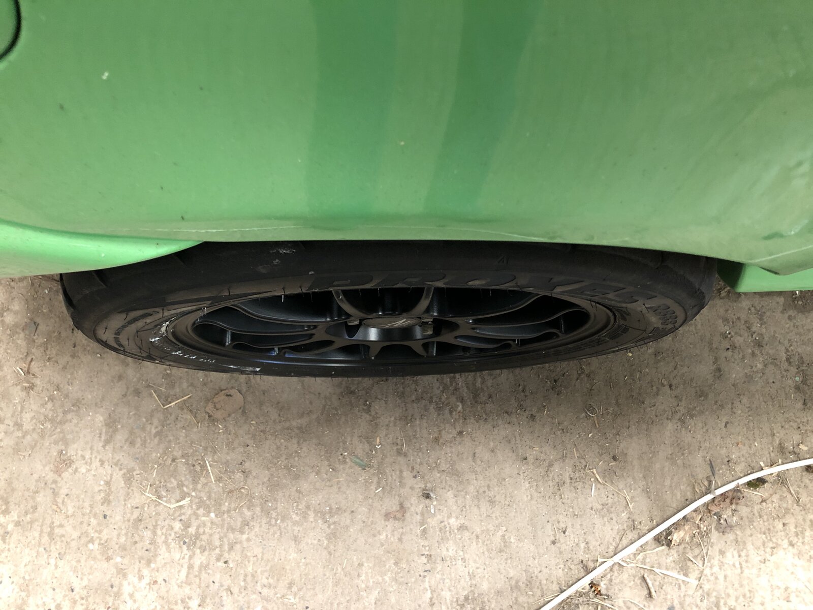

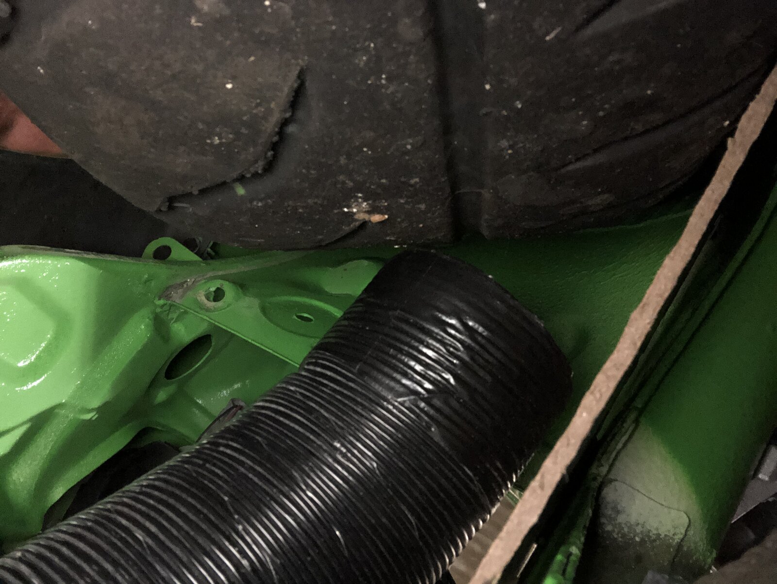

Had a little bit of time today to get back out and check spacing on the rear wheels before I put in an order with Pure Motorsport.
Previously the car had 5mm each side on the rear but I was seeing if it could go out to 10mm each side.
On putting 10mm on I was surprised at how much more they seemed to poke....
Suffice to say I will not be going 10mm each side as I am pretty sure they would not clear...
It was only when I was removing the wheel that I noticed some rubber/wear marks on the inside of the rear bumper, perhaps 5mm is even too much, I will check when I fully drop the car back on the ground.
Overall I was quite surprised as I had been speaking to @Coops Mk1 about his set-up when he tried the Superleggeras on his phase 1 with 15mm spacing up front and 10mm rear, I couldn't figure out why it was so different but then I remembered I had camber and spacer shims on the rear hubs so there is about 3mm already..... It turns out I am also on 205's rather than his 195's so there are the answers....
10mm spacers order from Pure Motorsport, quite looking forward to getting this back on the ground again...

Spacers, dont go too wide as it will ruin your scrub radius as Mark will tell you.

Couple of things I tried to note as i went along... Tyres, please dont jump straight to slicks i would hate to see this in the barrier first time out I would cry for you. 205 are too big in width and height.
For sure I won't be going to slicks for a while, I will be learning the car for quite a while first before I start looking at second sets of tyres slicks etc.
As for the 205's they do seem quite wide/high but I will see how I get on first and then look at changing them out.
Learn the car again first, its lighter faster and will change direction quicker. You can play with you suspension setup to find you best grip for your driving style and when you start pushing the limits of the tyres that's the time to move up to something sticky. Also your brake bias will need playing with. Spring rates is always a tricky one, especially now yours is so light. I have got 550lbs up front and planning 450lbs on the rears. Think springs are £22 cheap as chips. Just need the right balance.
For sure everything needs to be learnt/bedded in for quite a while, it is a completely different car. TBH I am hoping that will make it all super exciting for me and keep the feeling fresh for quite a while. With regards to suspension, I may look at spring changes but in all honesty I am unsure if these FK's are up to the job anyway - let alone being on the car so long. A good friend of mine works for AST and when I relocate there (hopefully later this year) I will potentially be looking at upgrading to full coilovers all around.
