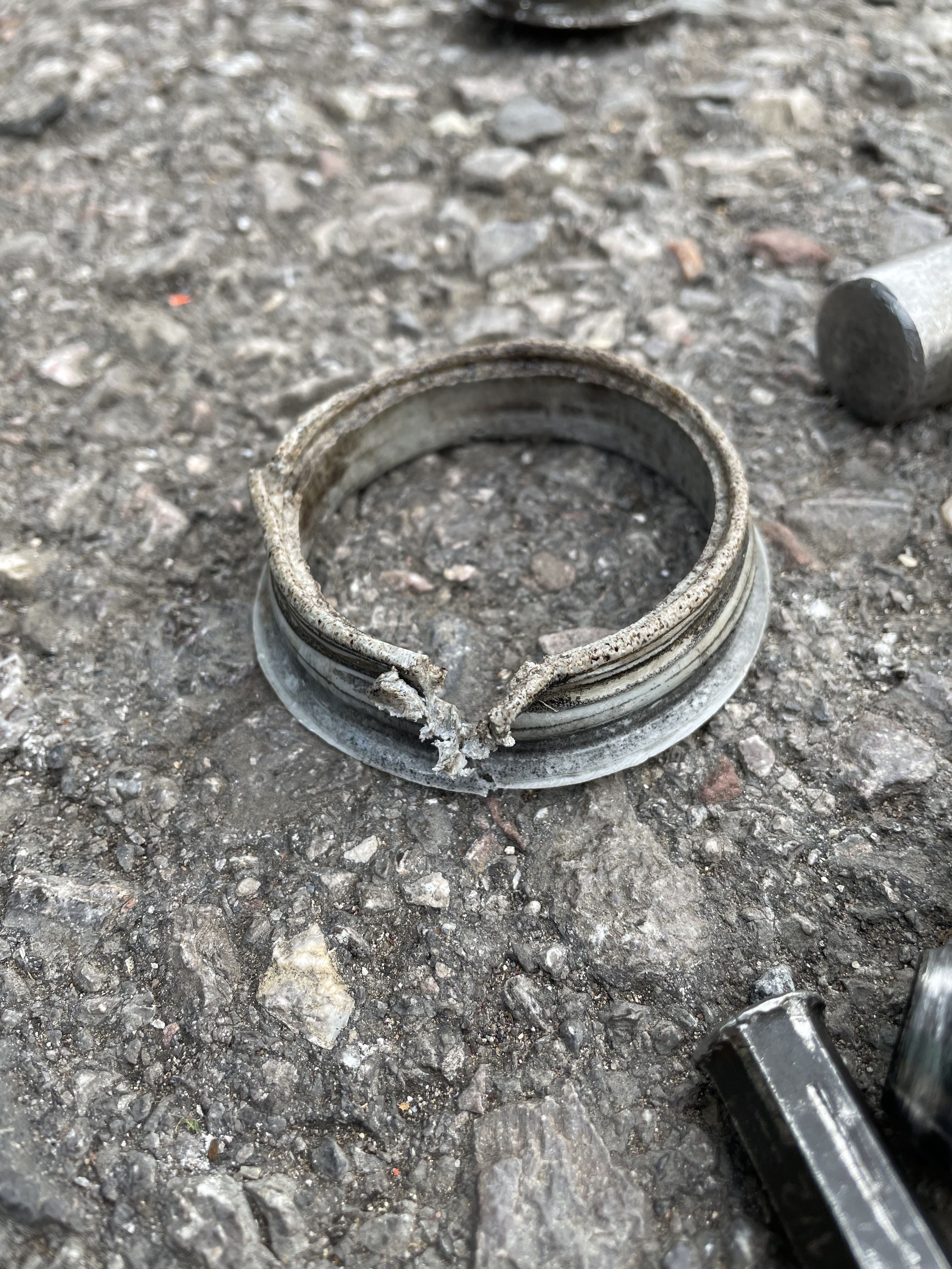

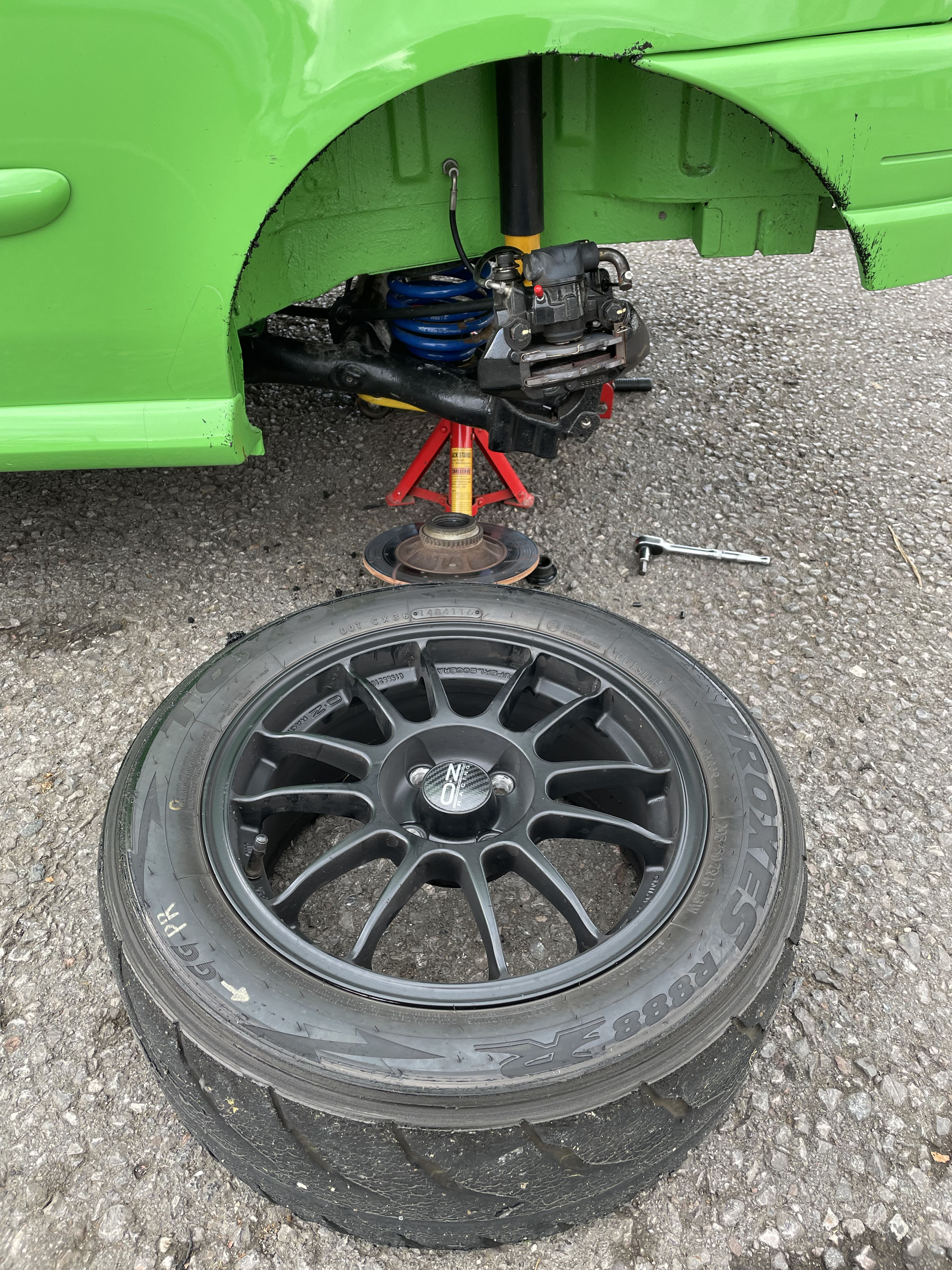

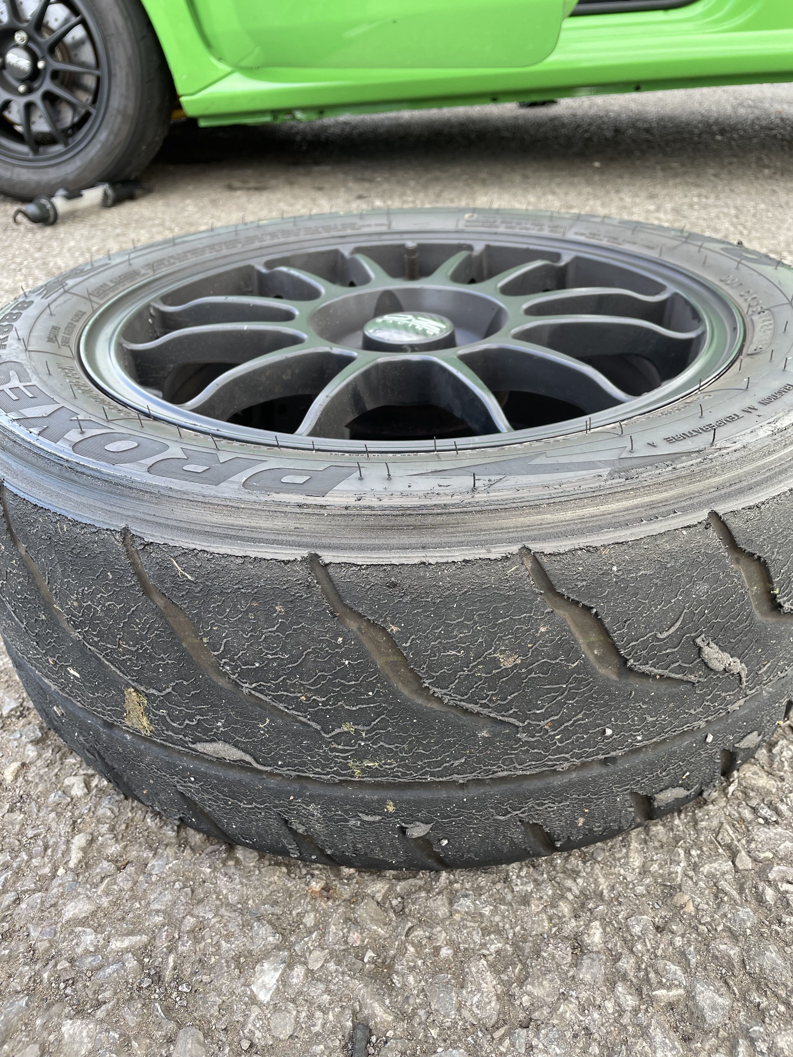

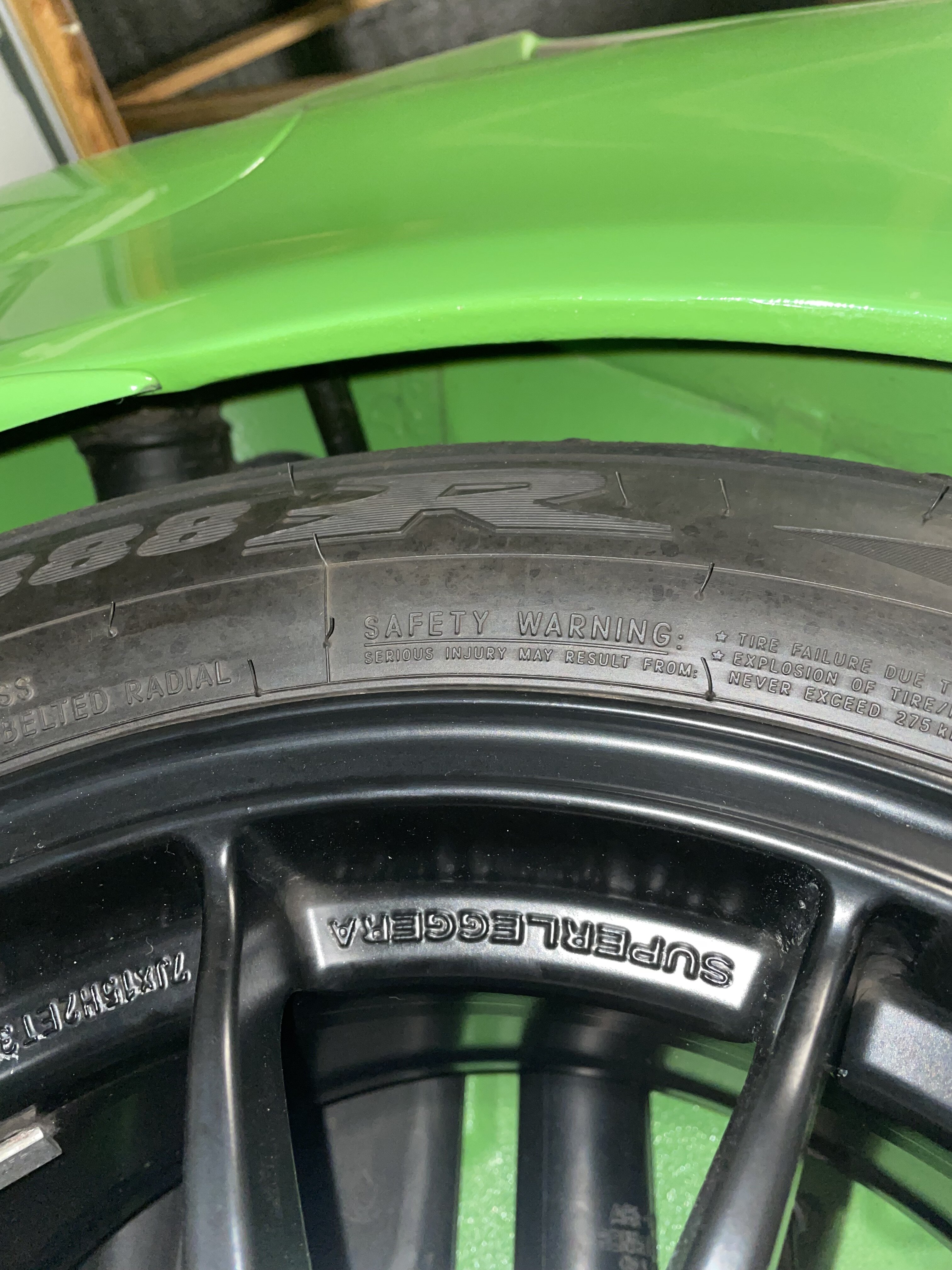

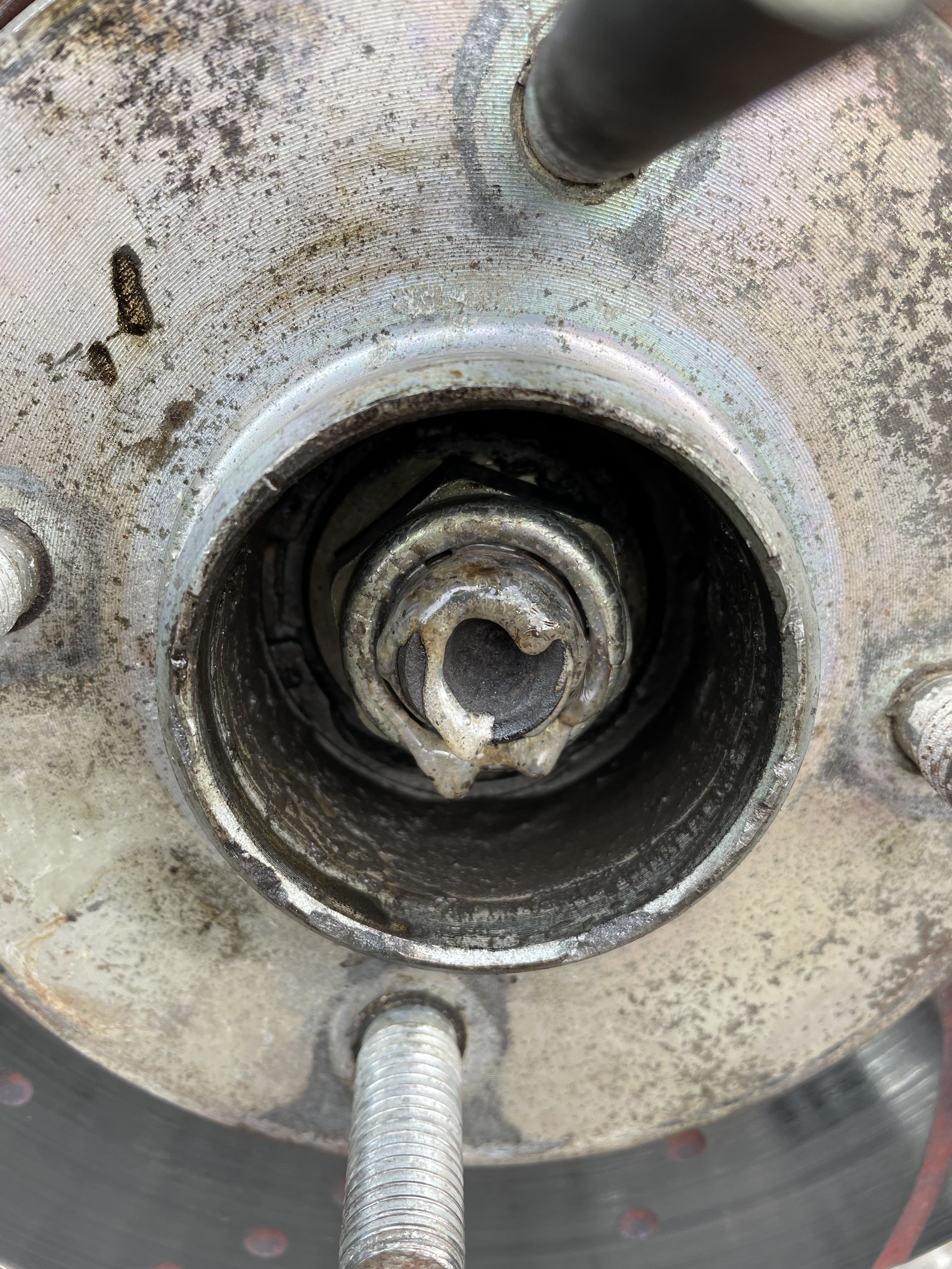

It was pretty evident that there was significant rubbing as I had basically cut a grove in the tyre edge, What wasn't so evident but spotted by @incy-spider was the positive camber the OSF rear wheel had - it needed closer inspection. I got the car in the air and as soon as it was up it was evident that there was a sh*t load of play so it was potentially a loose hub nut or collapsed bearing, oh and the spigot ring had melted
I removed the hub nut cover and this revealed the nyloc part of the hub nut had melted, but that it was tight. Then removing the calliper off the stub axle to pull the disc away and the bearing just fell apart - well at least I knew what it was now...
Time was going on now and my main concern was getting home as I needed to pick my son up. I managed to find a local motor factors with stock and my dad kindly drove me down to collect. £130 lighter I got back to the car and got the new disc/bearing fitted, I was then given some spare wheel bolts to drive home (as the studs were in the other disc). I got home fine and in time to collect my son.

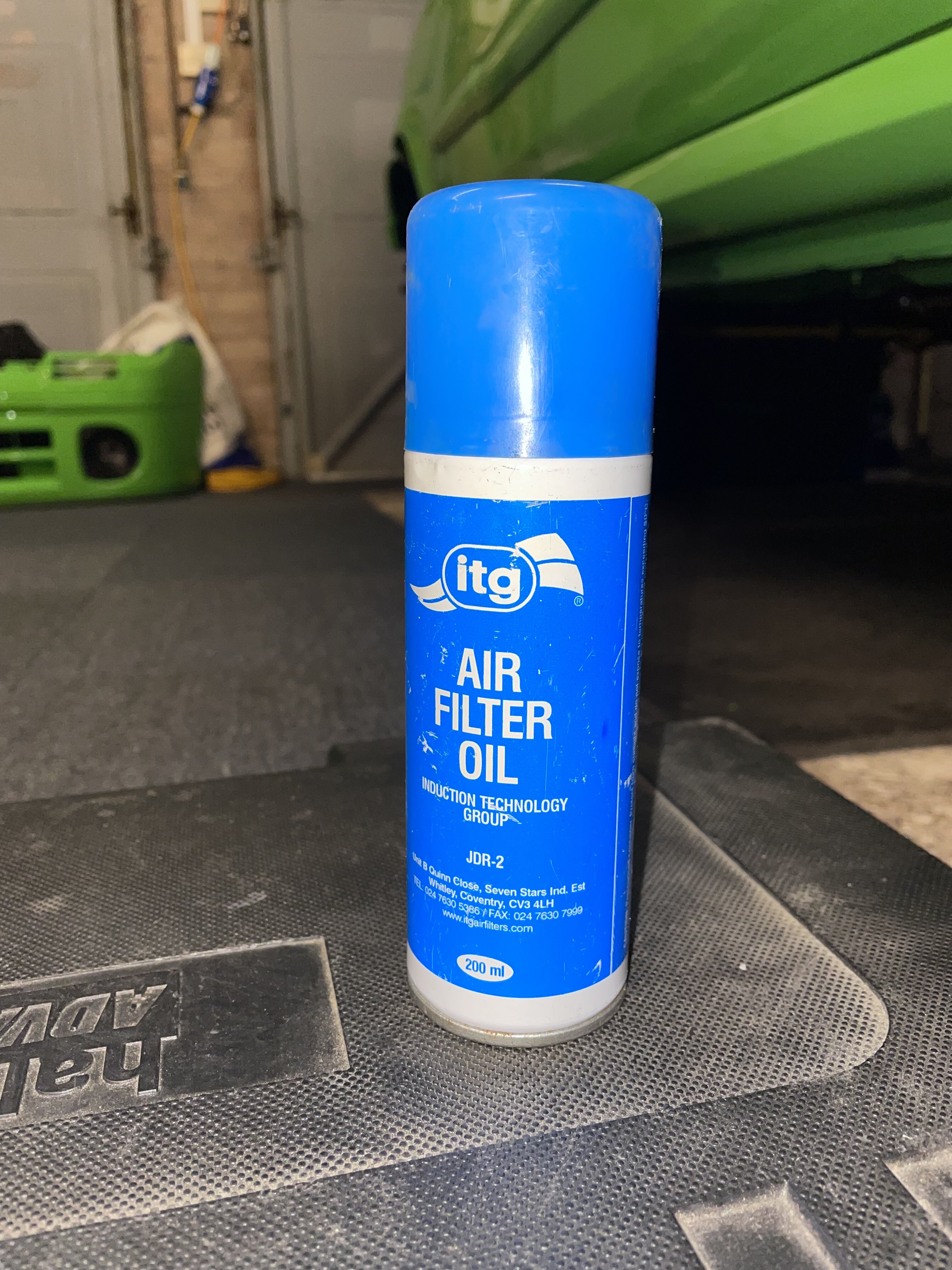

I have made a couple of purchases over winter including the Oil/filter and coolant for a service and a complete set of part worn Giti GT2 tyres as spares, quite interested to try them out as I have heard really good things.

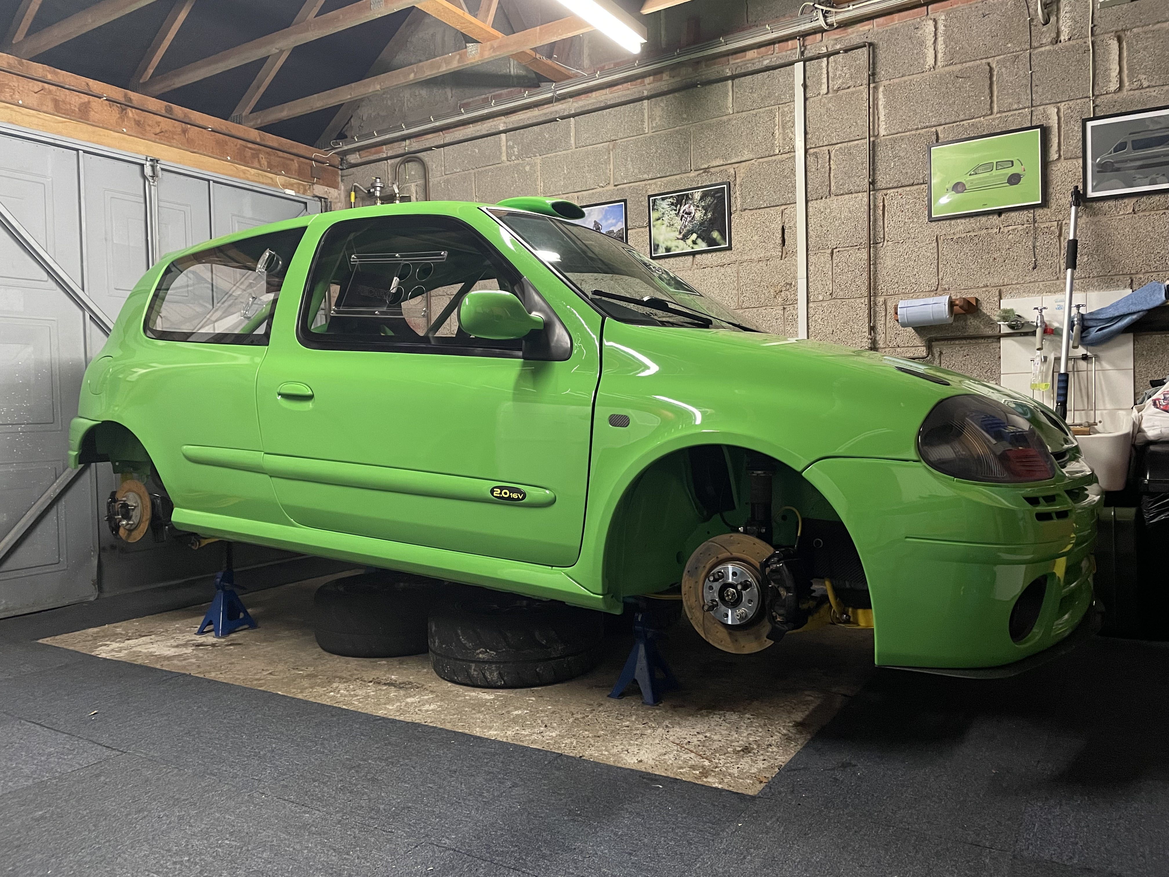

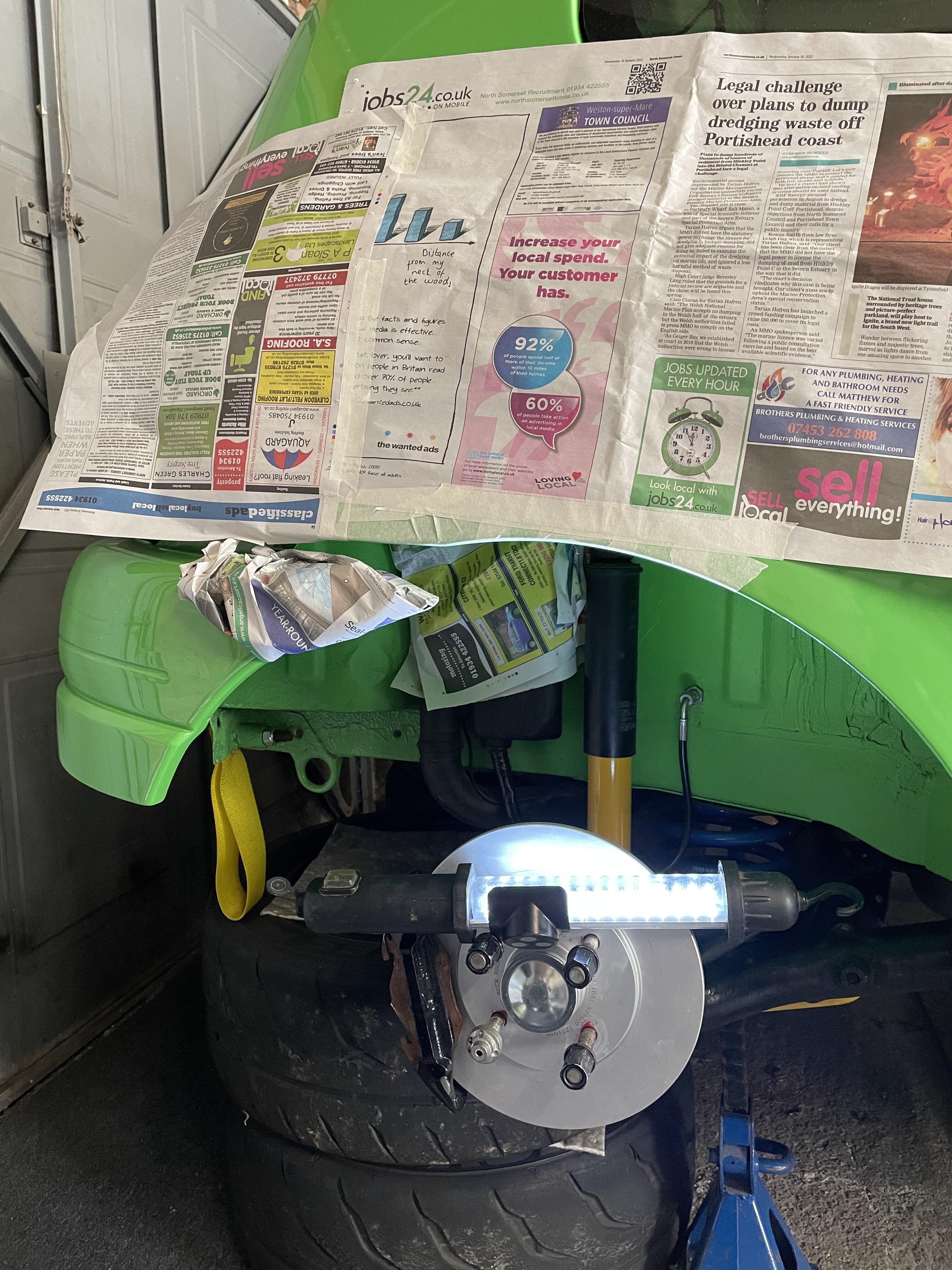

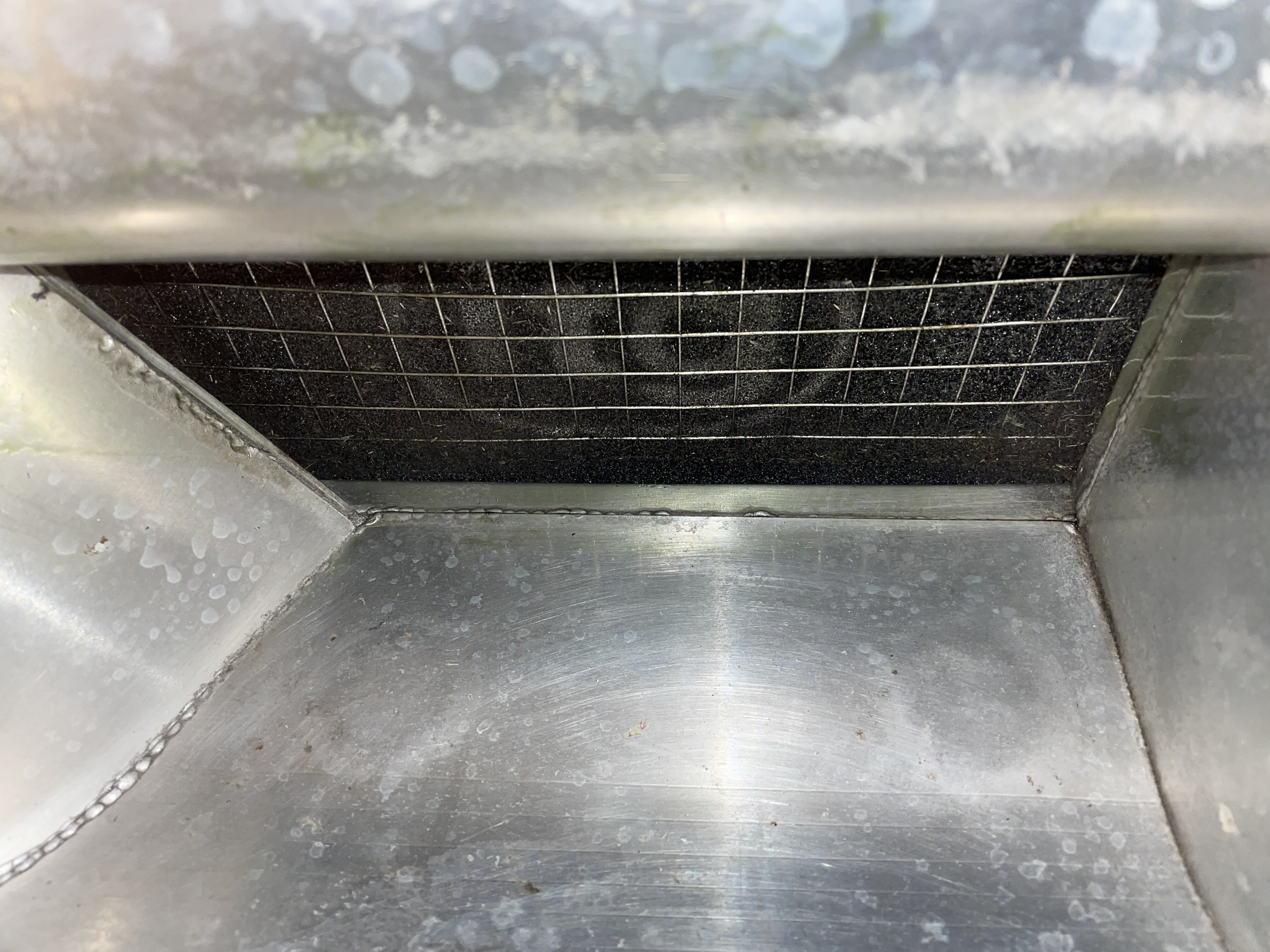

Based on the above I had some time last night so decided to get my ass in gear and service the car. The oil., filter and coolant have only covered 550ish miles and the mapping but were last changed in Feb 2019 so it was about right to change it now.

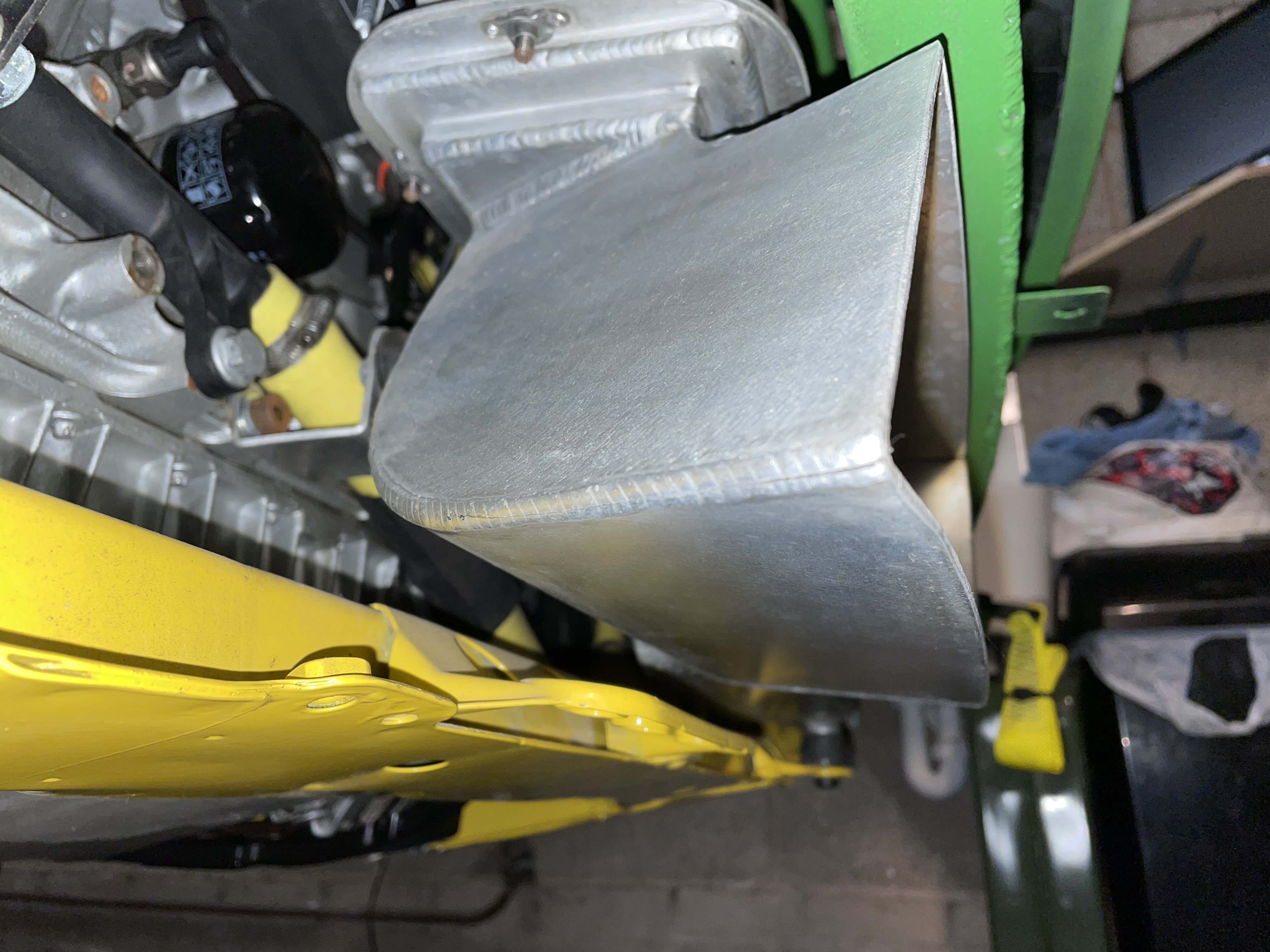

Due to my unique intake set-up I decided to remove the front bumper for ease (only 4 bolts), I was then going to remove the bottom piece section of the airbox to give me a little more access to the fuel filter, this wasn't going to be all that easy so decided to leave it on. Removing the bottom section would of allowed me to fully access the air filter also, but not to worry as I could still access it from the underside to inspect it and lube it.
It was at this point I noticed a small crack in one of the welds at the base of the airbox (shown below), this must be down to resonation. I have had a good look around the rest of the airbox and can not see anymore issues, I will need to keep an eye on it but may try some Araldite on it in the meantime.

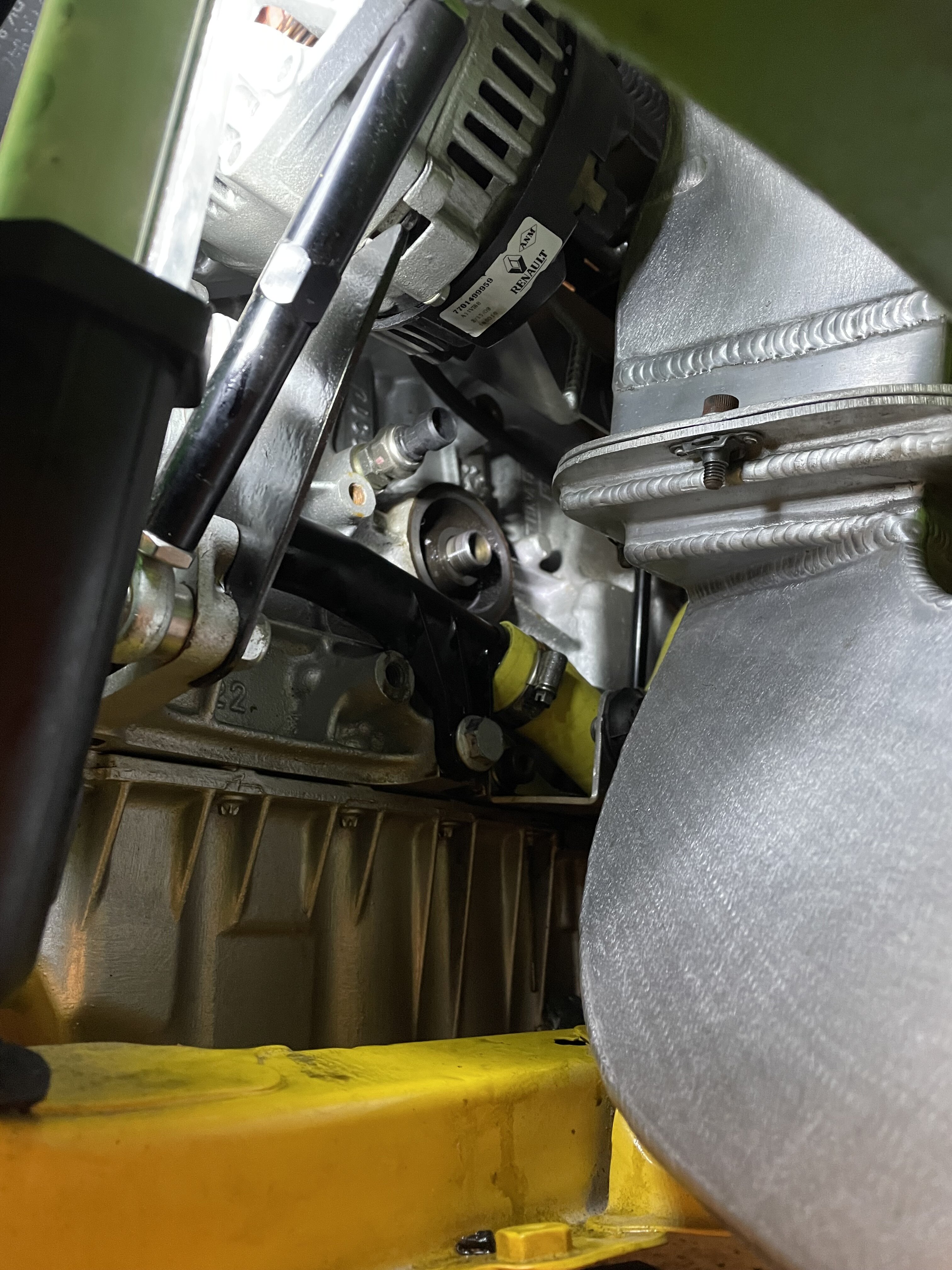

The image above pretty much shows my view of last night, this is where I spent most of the night led down trying to get to the oil filter. It wasn't that keen on budging by hand and no set of pliers were really getting around/to it, so I had to result to a bit of butchery. From this angle and from the dipstick side I could get a flat nose screwdriver and hammer in and put it through the filter and rotate it enough to twist it loose, a ballache but not too bad.

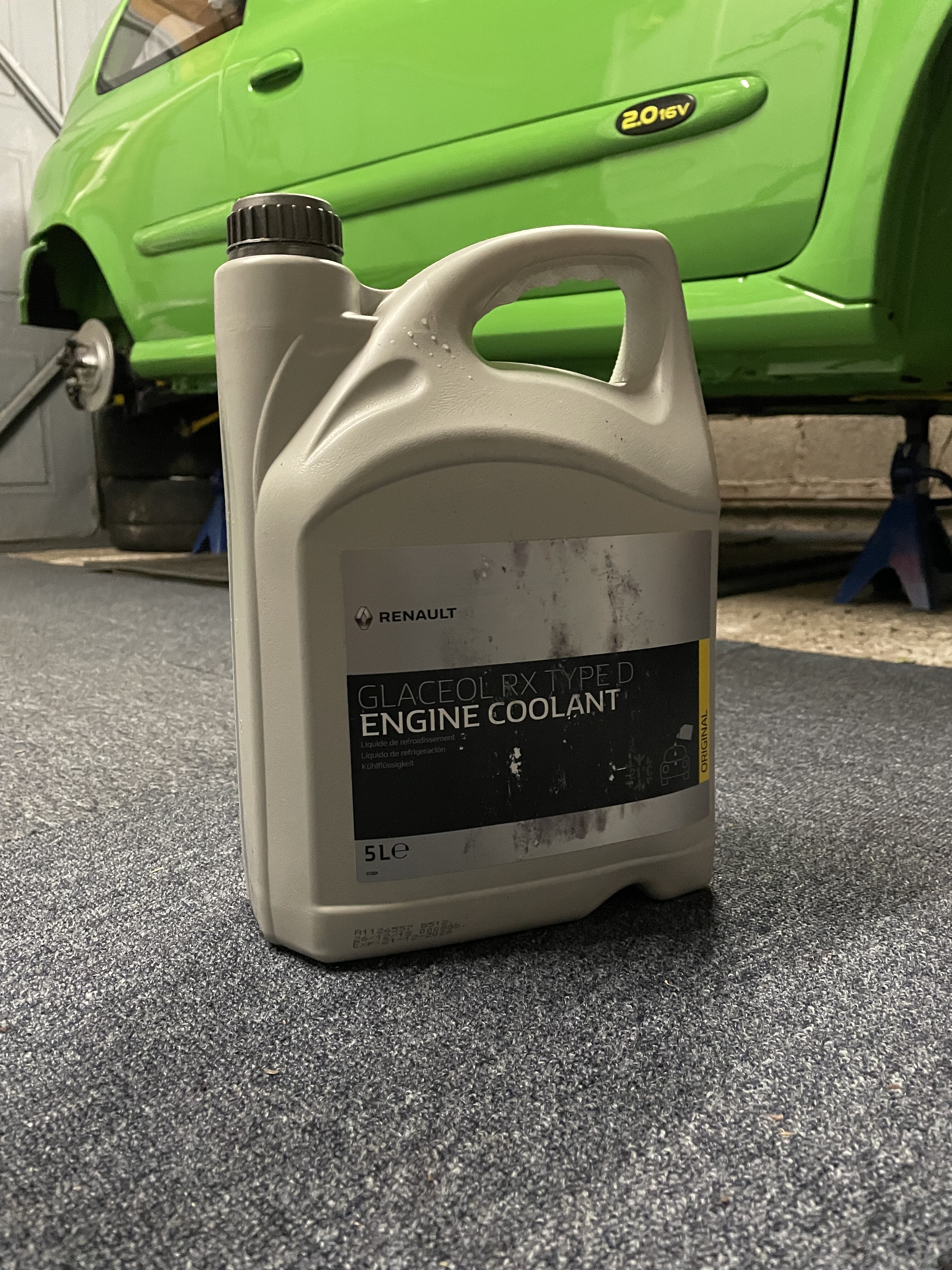

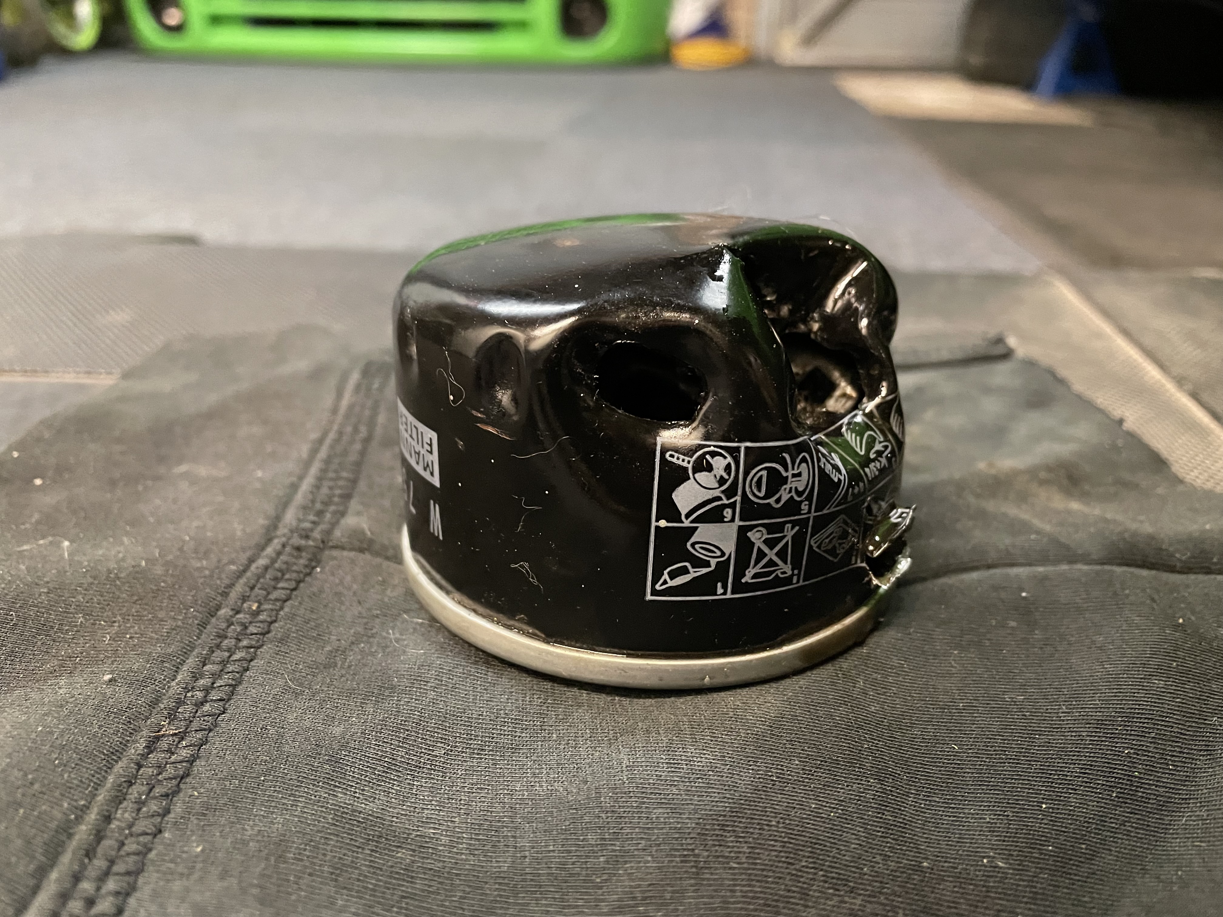

New oil in, new (primed) oil filter on and then also all the coolant drained and refilled, it takes 5ltrs with no matrix so nice and simple, just need to run the car up to temp at lunchtime today.
That is almost all of the jobs to sort before using it again. I had a fair bit of cleaning up to do of the arches after the CV boot at the front and butchering the tyre at the rear so have sorted that. When doing that I realised that the arch lips had actually gone back to bare metal with the rubbing so that is being sorted, they have been cleaned up, primed and I am now waiting on a match spray can from RS Components.

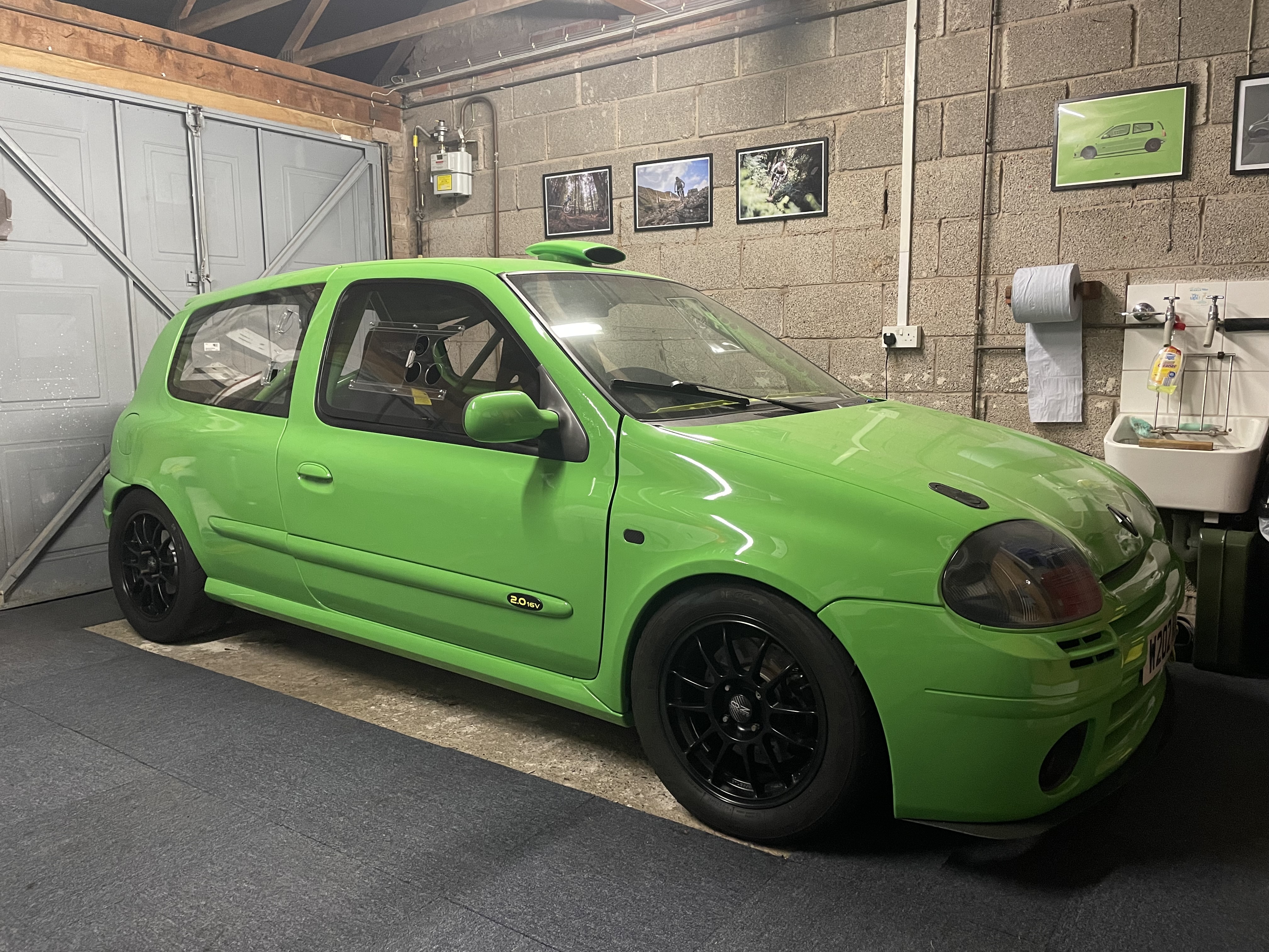

Last few bits are sorted on the car. RS Components took an age sending the paint, bit of a joke to the point I am unsure I would use them again really, but the arches are now painted again.
and with everything checked over the car is back on the ground.

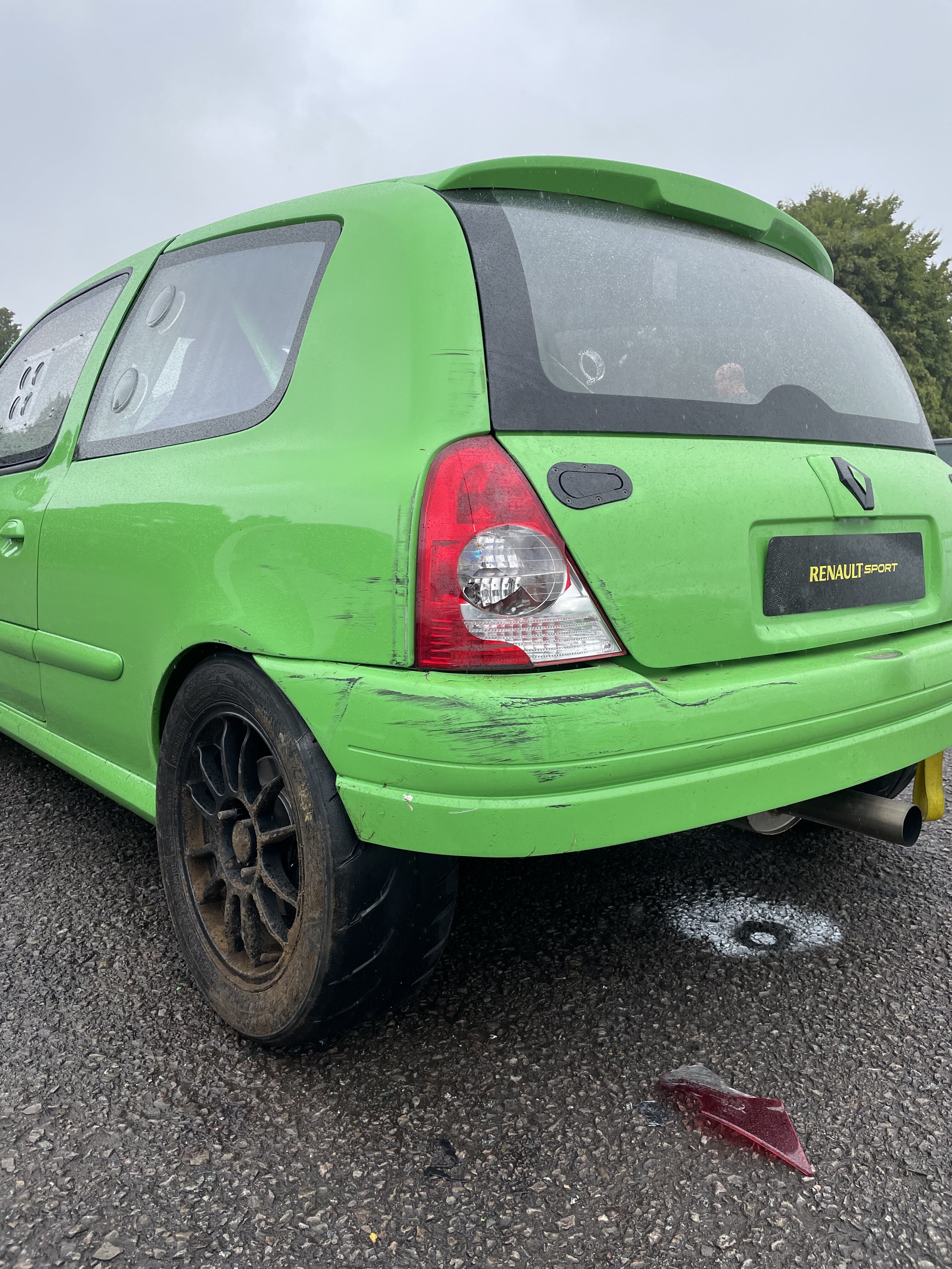

The day started with persistent drizzle through the morning, the track was pretty slippery in places and I matched my spin at Quarry from the last day with a near identical spin...and then @Daniel got behind me.

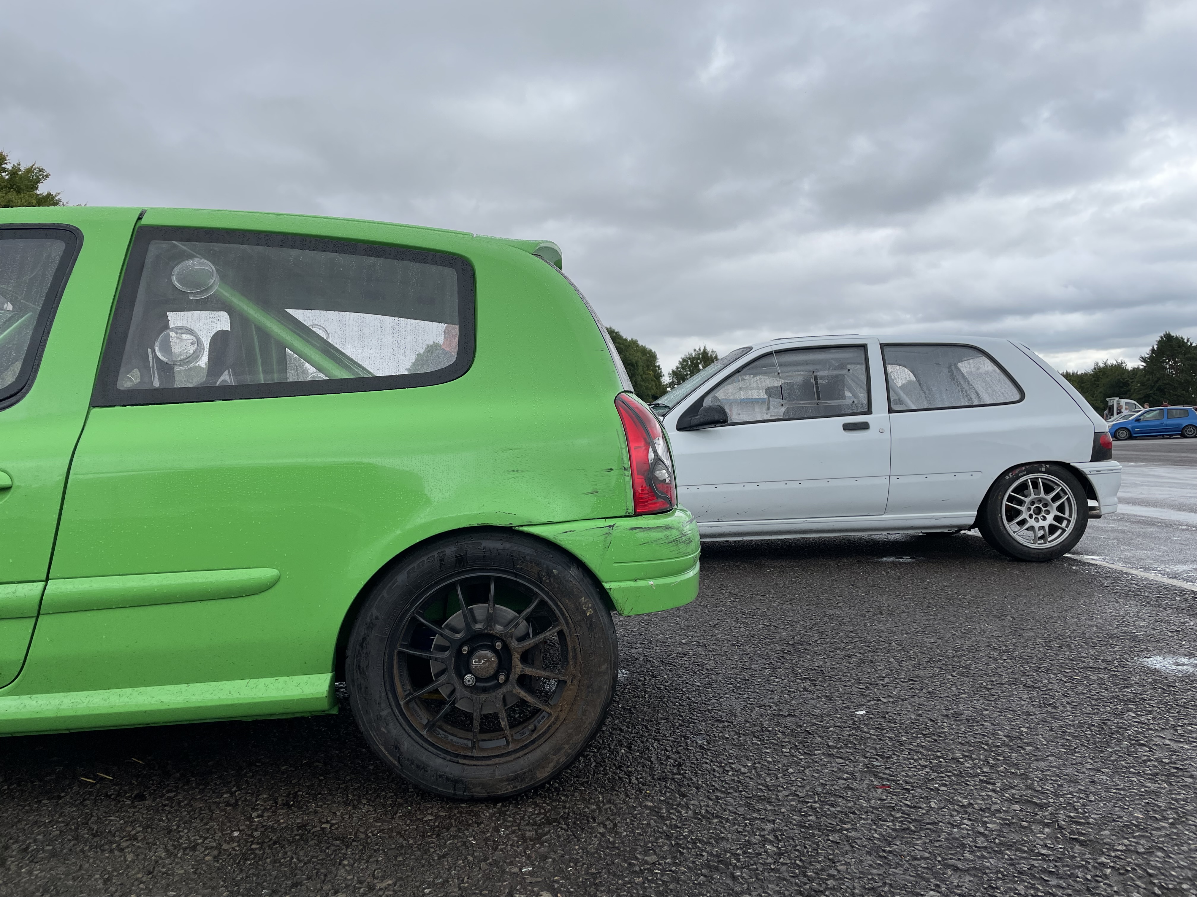

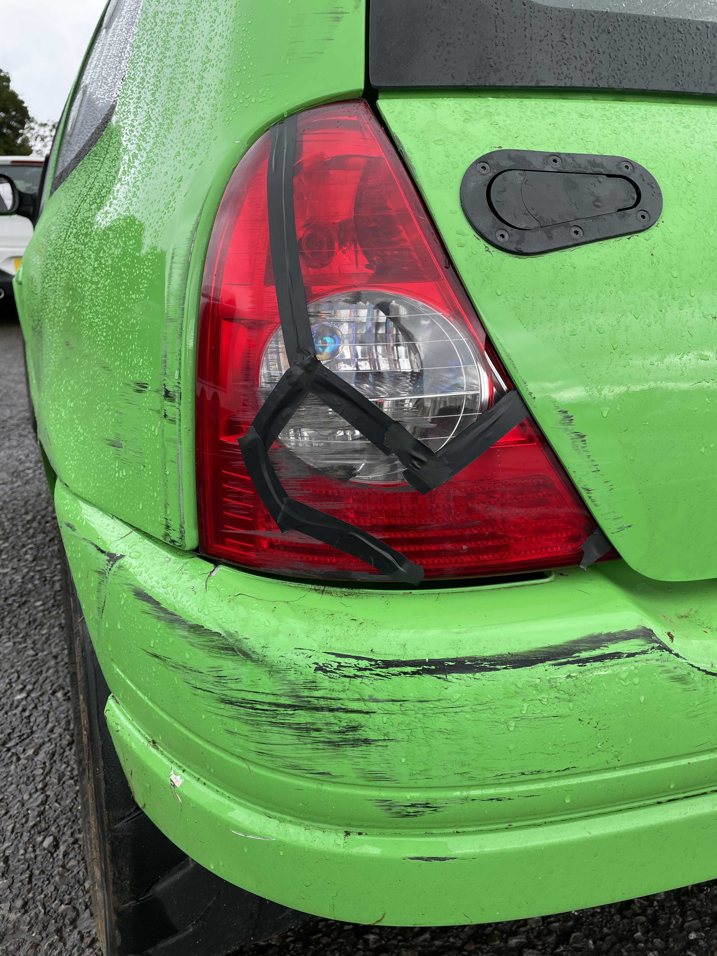

I wanted to push on a bit in an effort to test myself with Dan behind me. That was a little silly and clearly shows my lack of experience and especially on a wet/damp track. Coming into Camp a little too hot and braking later than normal (apparently) I found the back end on its way as I exited the corner, I managed to catch it, but then it stepped again with a bit more bite - I caught that with a stamp of the throttle to bring it straight.... BAD IDEA. I should have let it just spin to the infield, instead I was now pointing across the track towards the pit wall. I managed to scrub speed across the track and rumble strips and when I got onto the grass I was just a passenger.
I manage to turn the car enough to just touch the back against the wall. I was expecting a fair bit of damage... but was very very lucky.
Luckily it didn't hit the wheel so the car was straight and with some tape on the rear light I continued with the rest of the day.
The rest of the day was great and with a dry track in the afternoon the car felt so much better and planted, night and day from the morning.
When I got home I got into seeing what I may need to do with the car... I was pretty surprised. (before and after)
A new rear light is on the way, a new numberplate light is needed and the bumper will need some paint at some point. I got off very lightly.
A summary - The car performed faultlessly, the driver not so much.

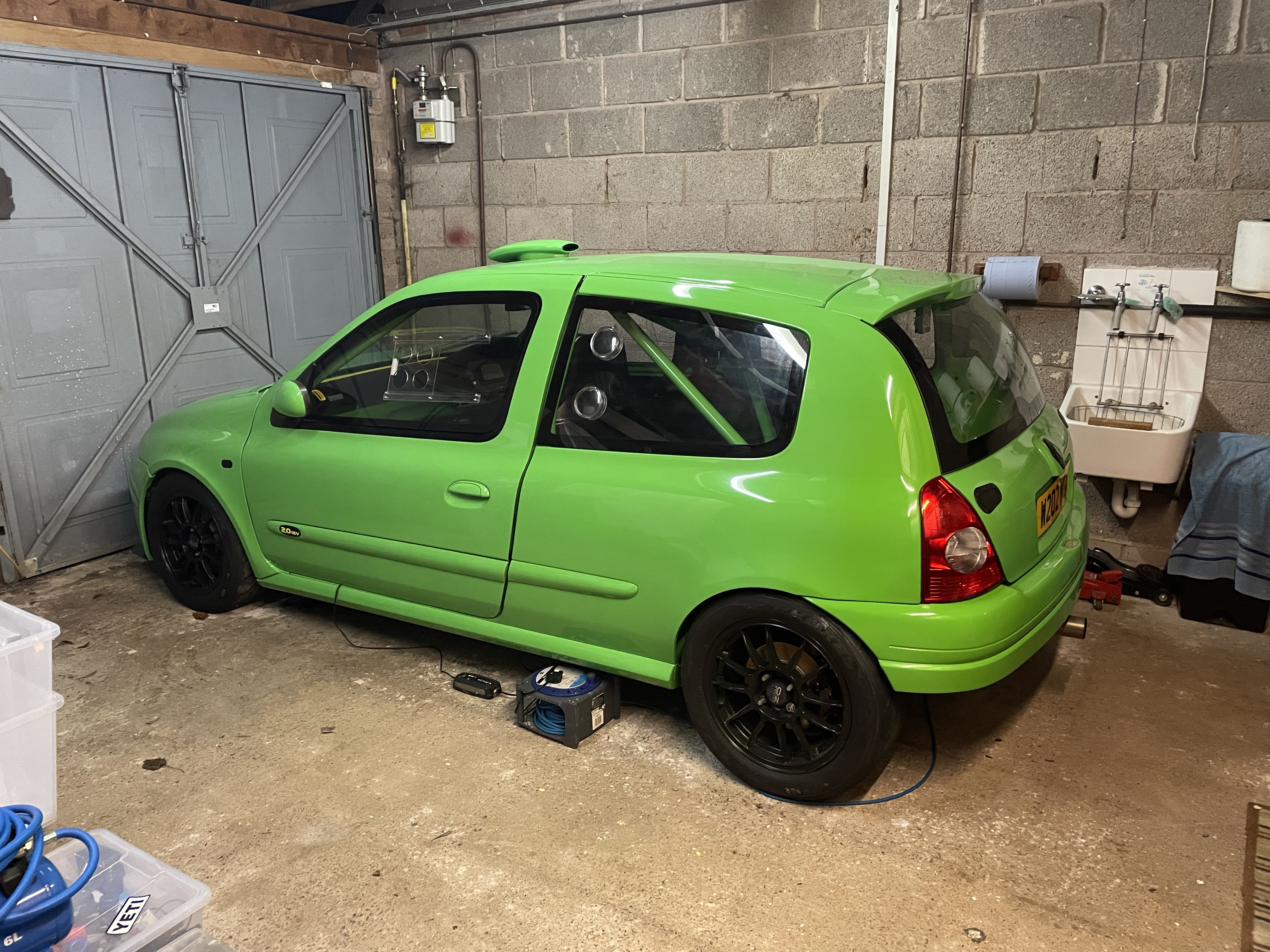

Well the car has been in the garage since the last trackday at Combe and I have been sorting the damage out.
I really wanted to get in a second trackday this year but life yet again (there is a theme in this thread) wasn't letting me. I have a lot of personal sh*t going on at the moment and I don't need the extra stress of things happening/going wrong etc etc - as much as I want to enjoy the car.

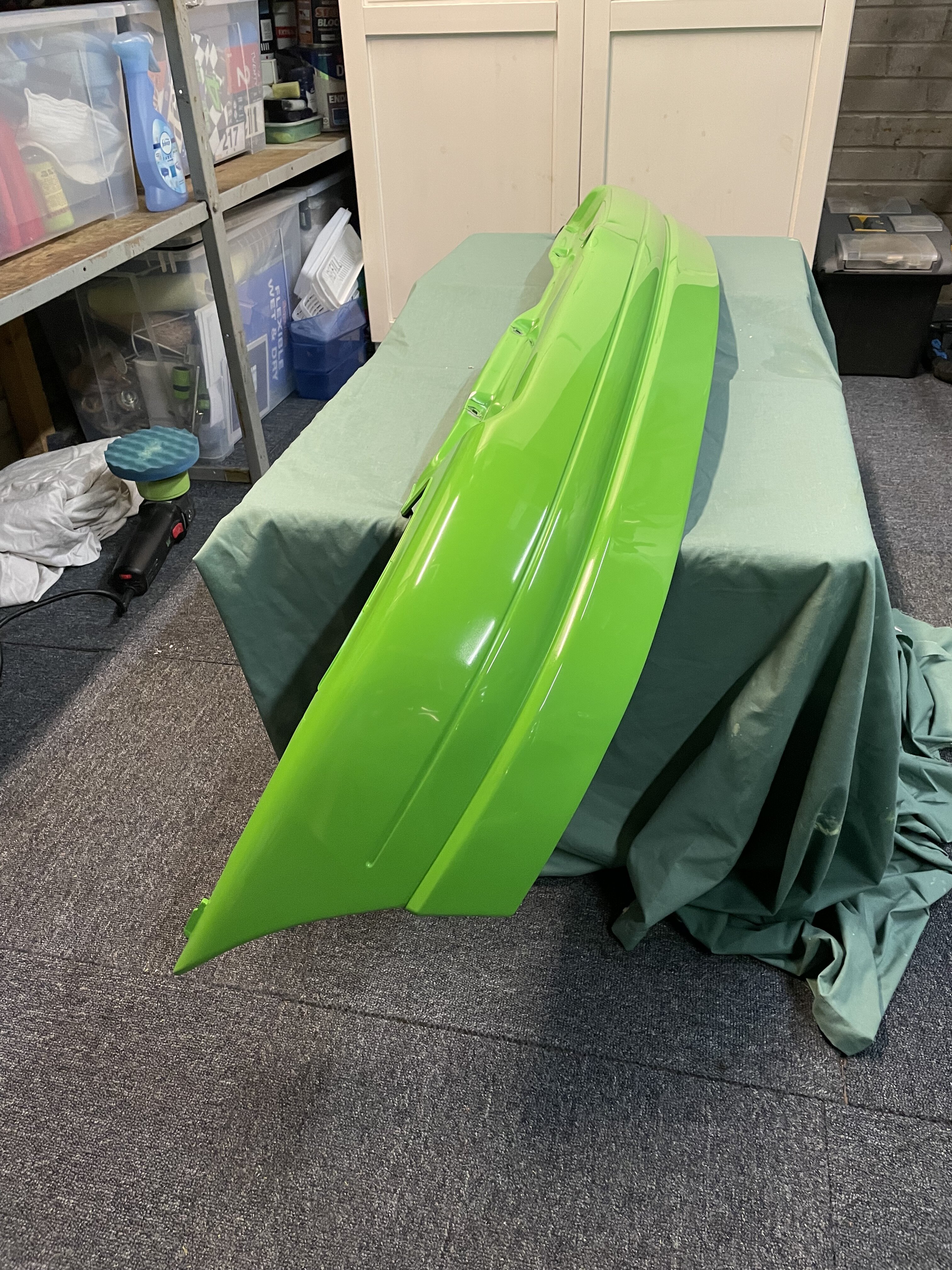

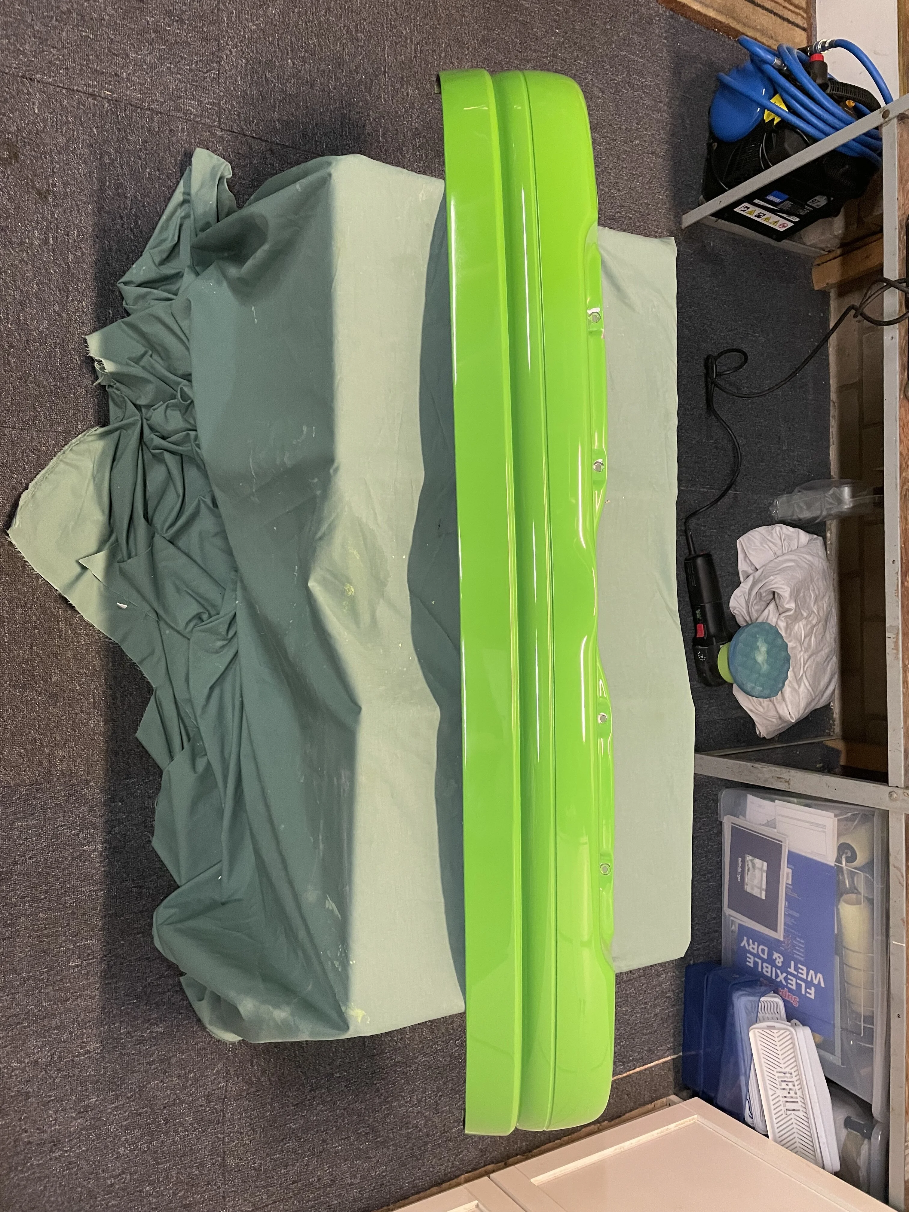

The bumper was first to be repaired. It isn't perfect but it is pretty god for a rattle can job.

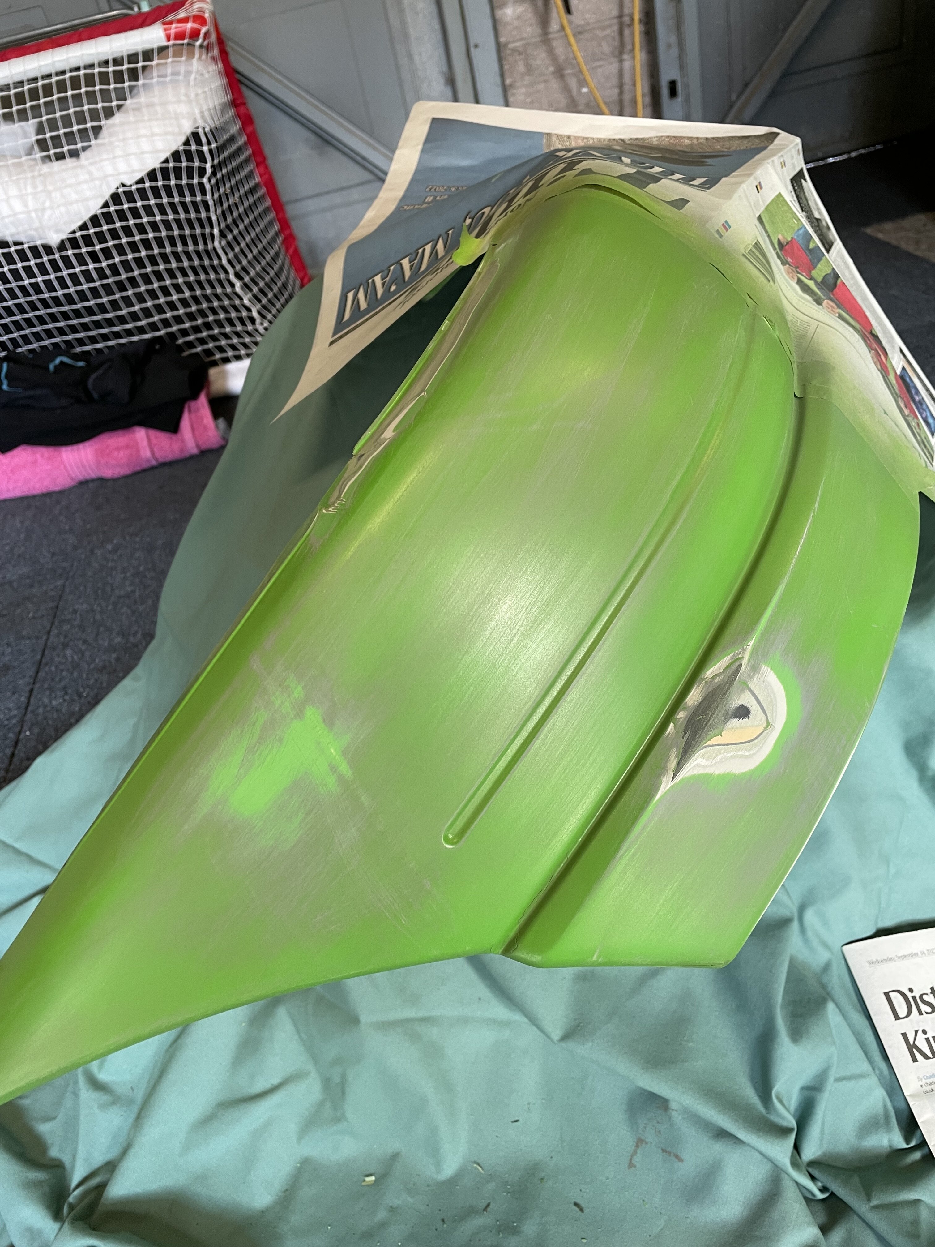

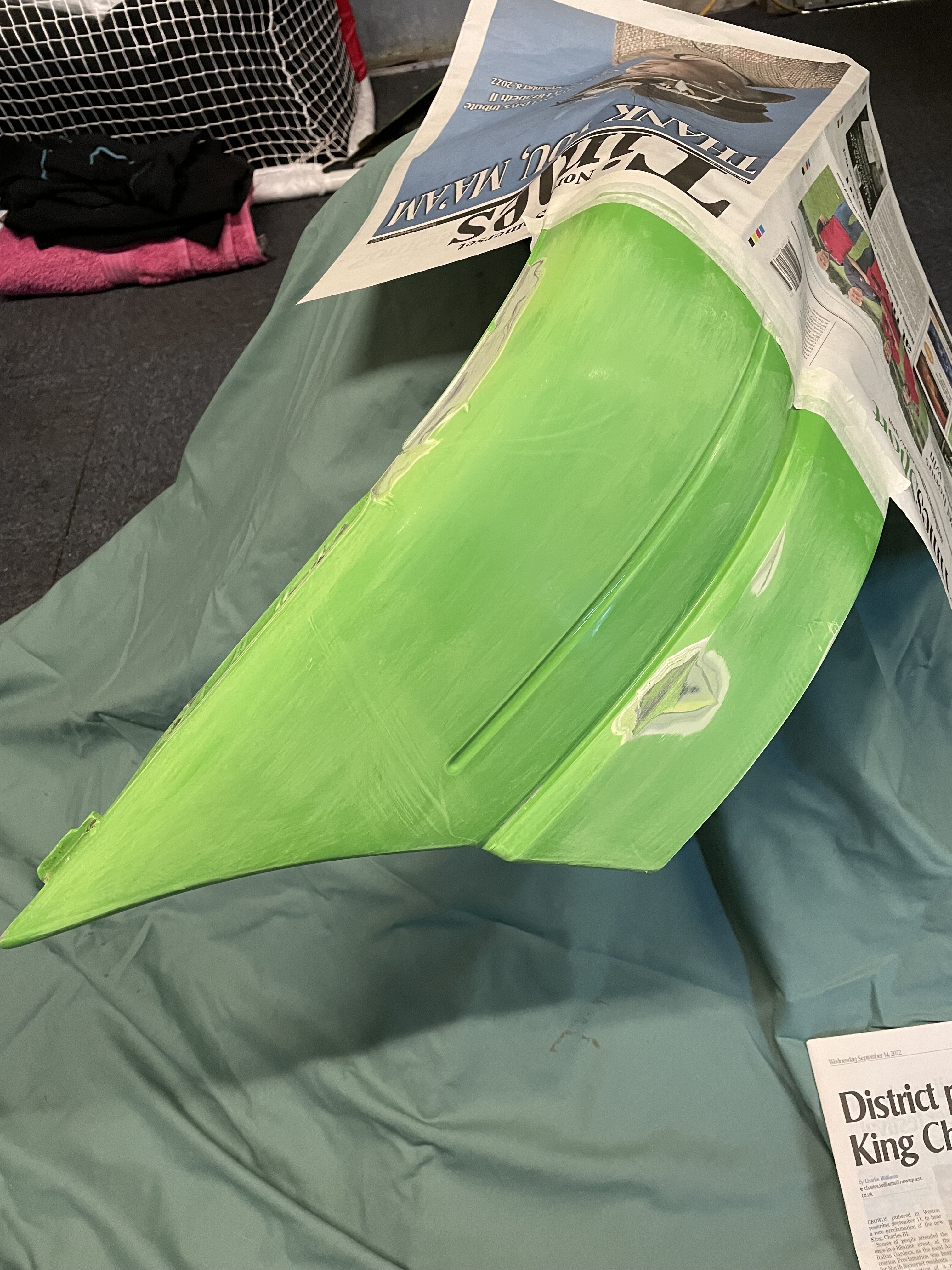

I am for sure not a painter and this seemed to tale a fair bit of work to wet sand back and polish up. I have also picked up a spare bumper just incase.
Next up was the rear quarter, I wanted to use the bumper as a bit of a test before I tackled the rear quarter. This didn't go anywhere near as well.

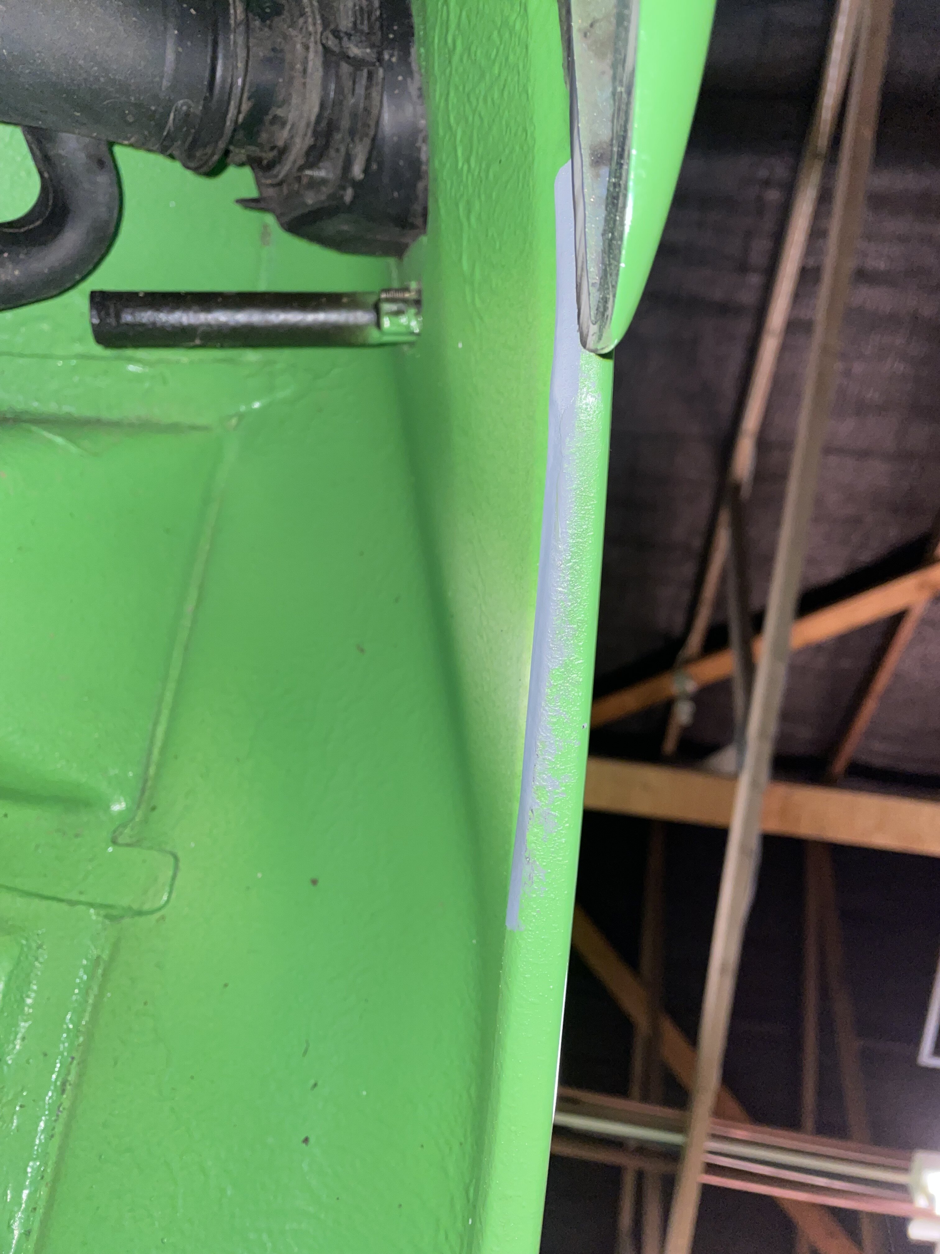

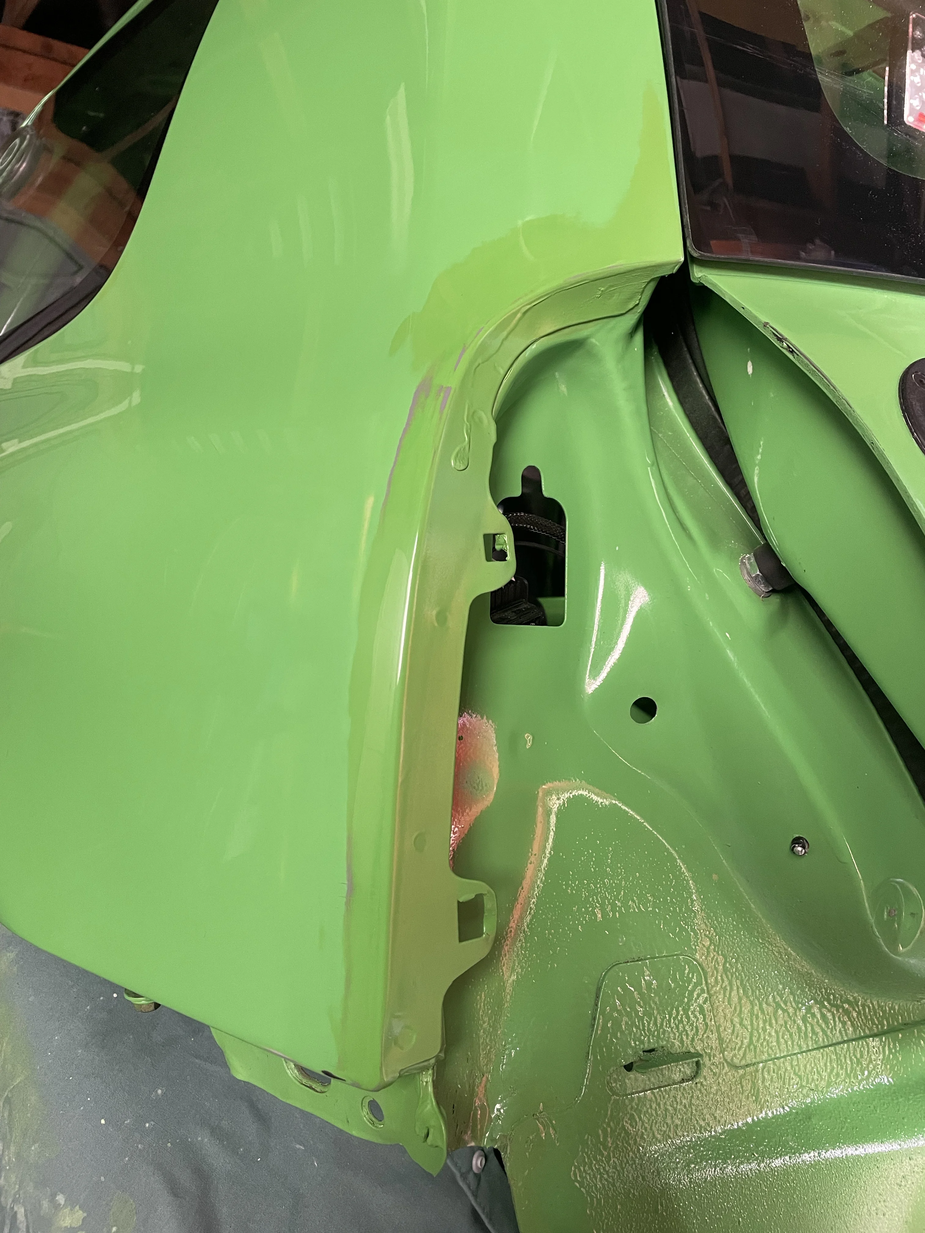

For some reason on the rear quarter the paint seemed to be a lot lot darker where I had painted it in (seen in image 2). I appreciate it is a track car but I really wasn't happy about it. It has taken a lot to get it back to the last picture and now I am debating my next steps but in places is back to the metal, do I try and rattle can it again or do I just get it blown in at a bodyshop...thoughts?
The car has now been sorned for winter, hopefully life will have sorted itself out, I will have a new house and I won't have to sell the car.

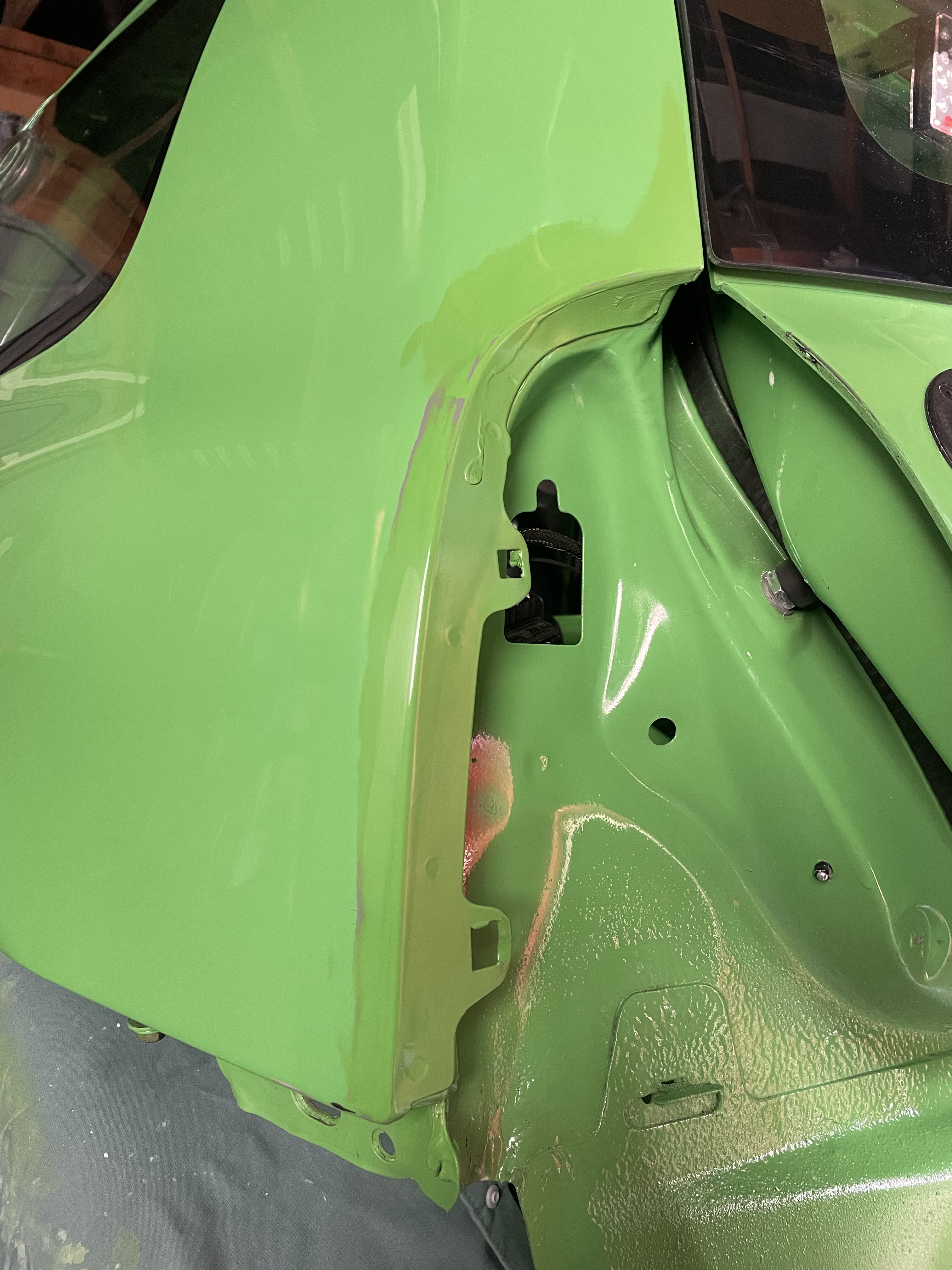

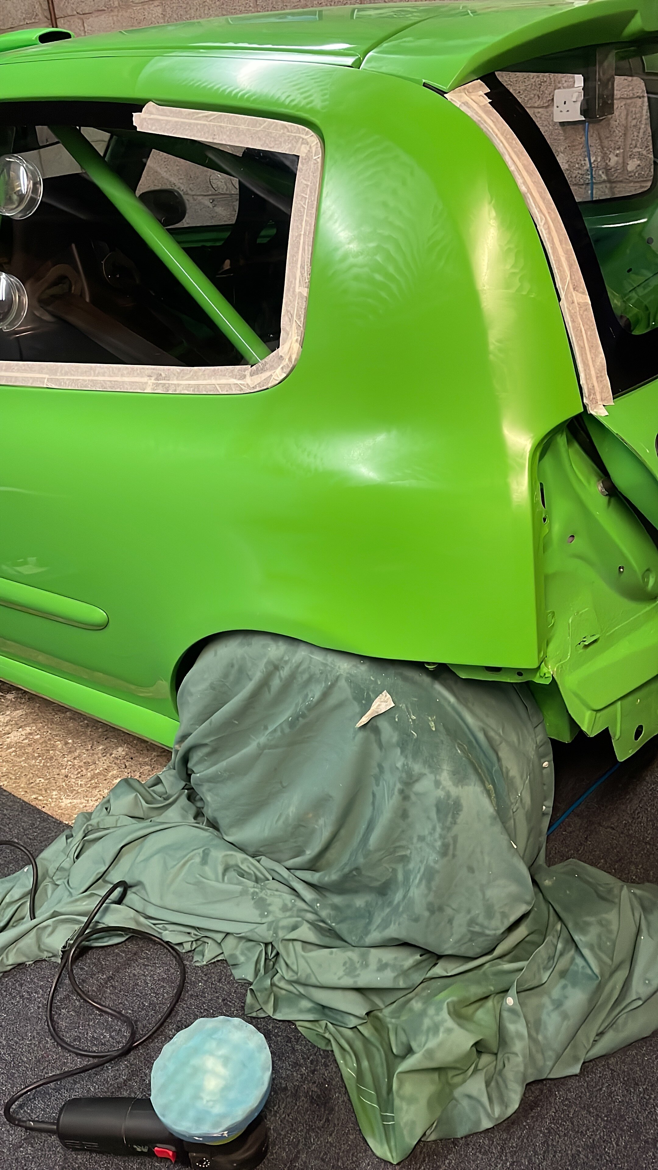

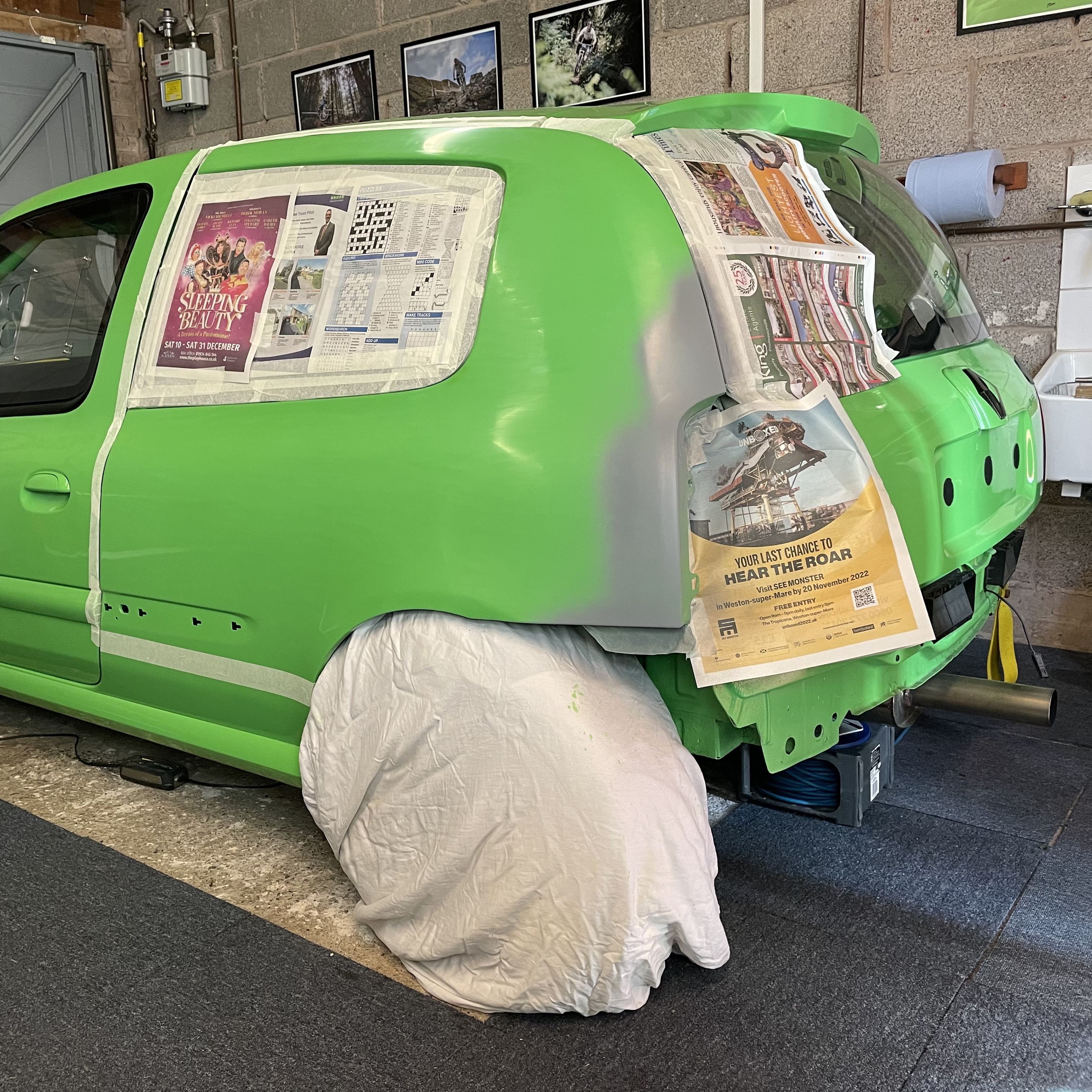

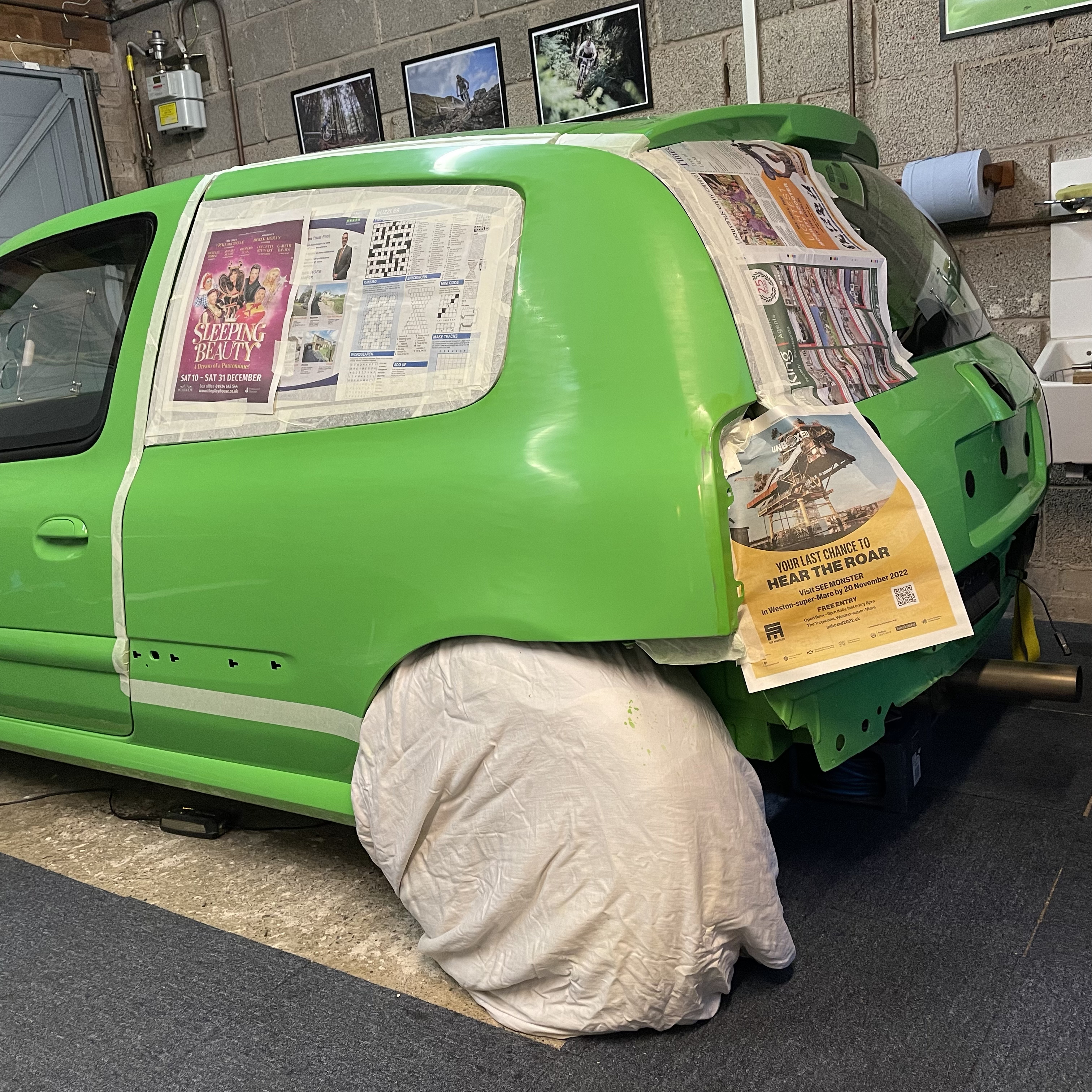

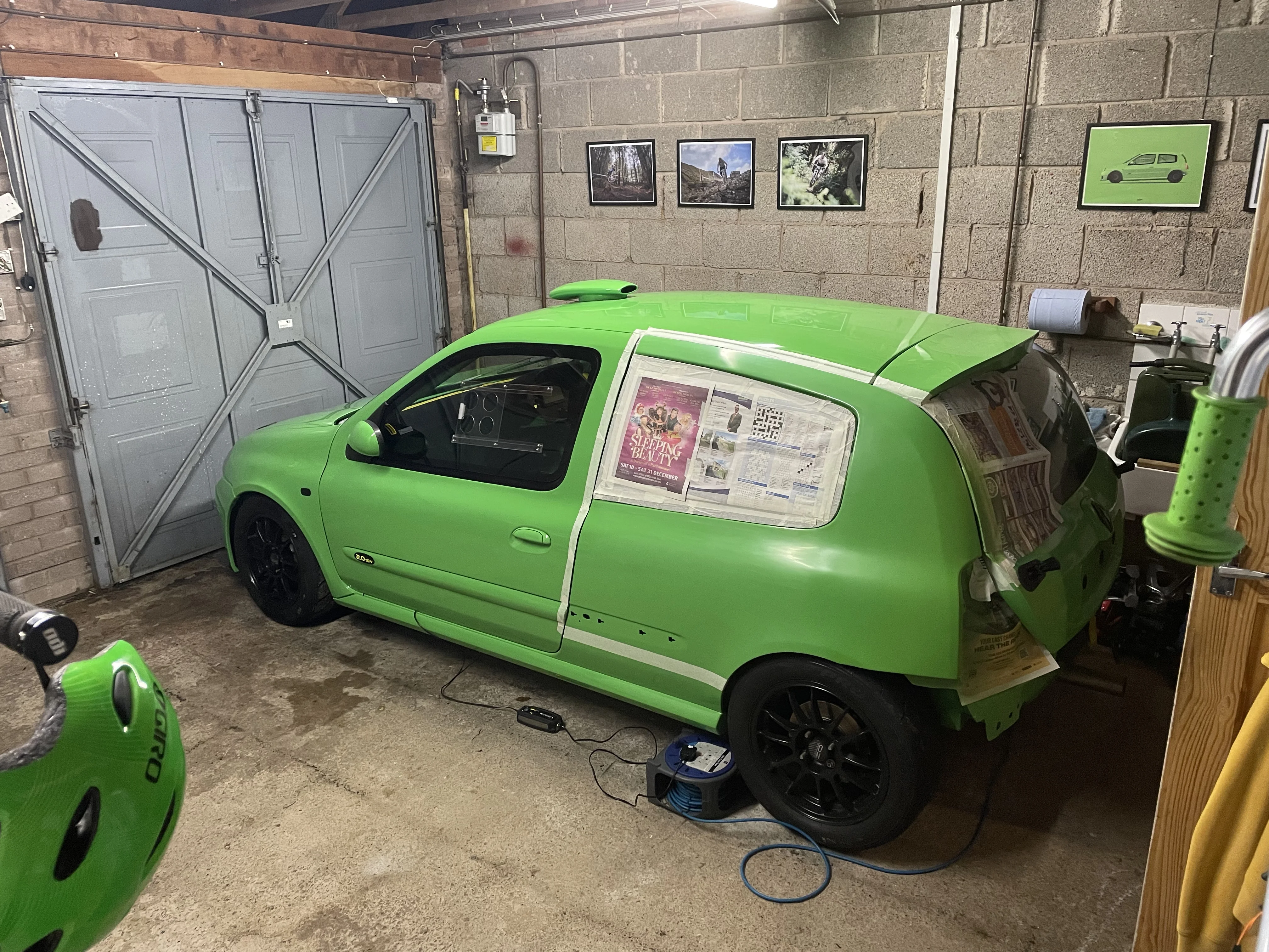

Well it has been a fair few months since the last update. A lot of change has happened...

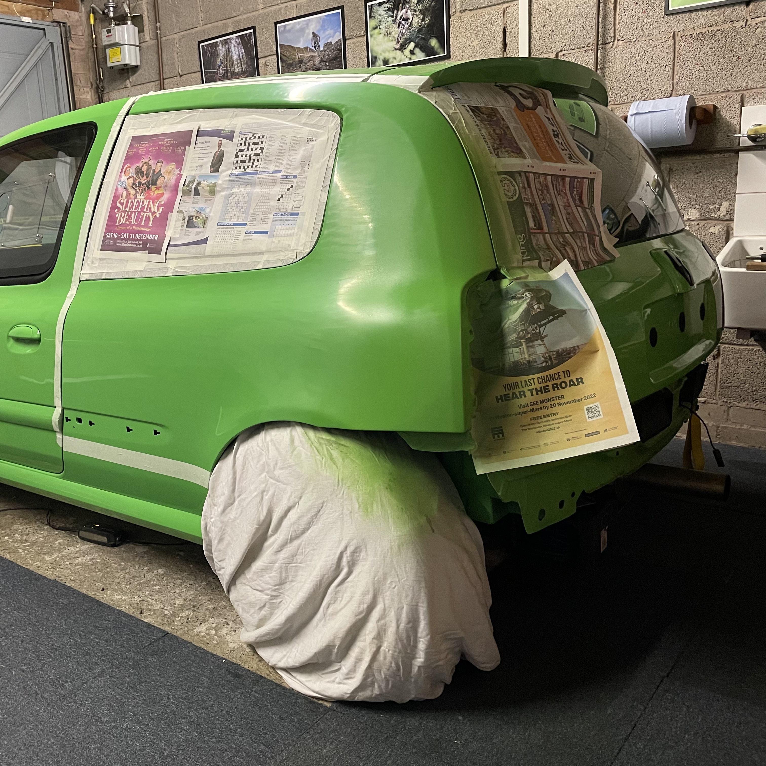

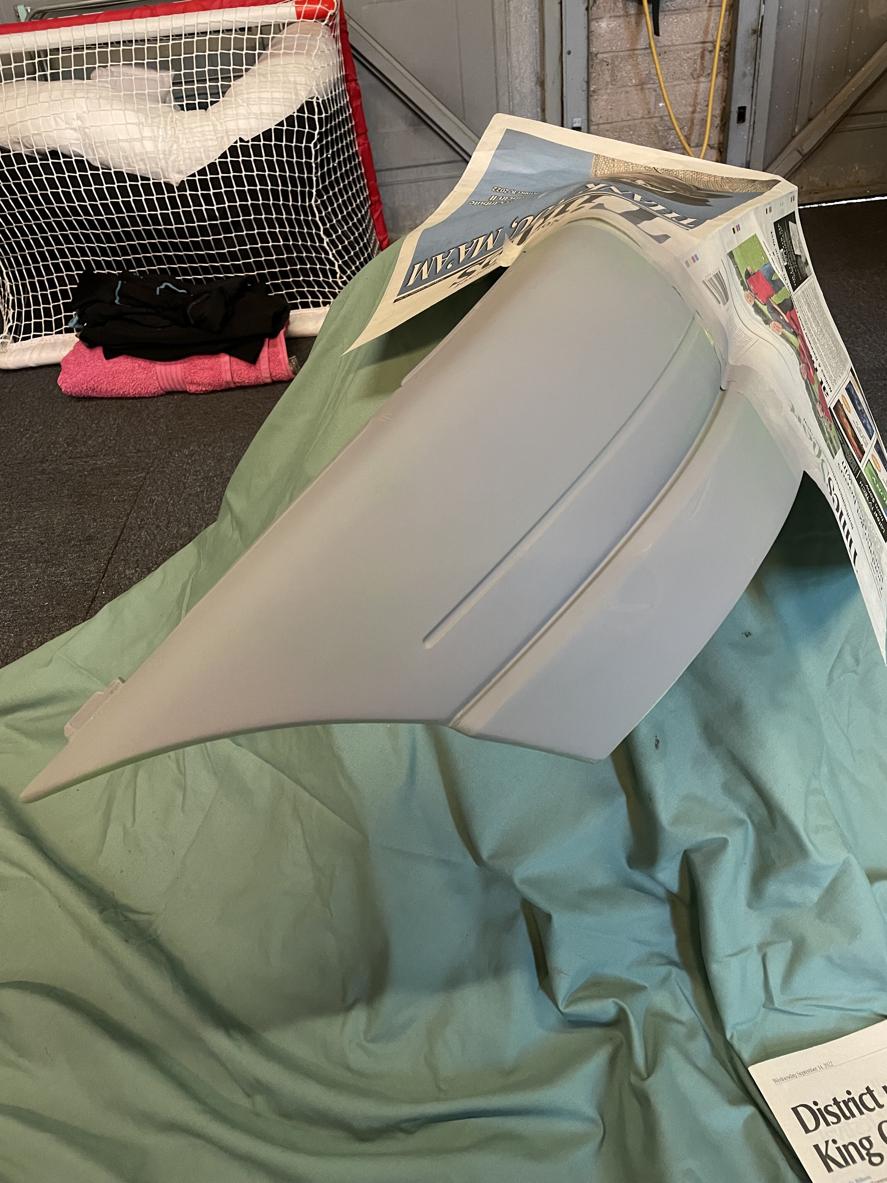

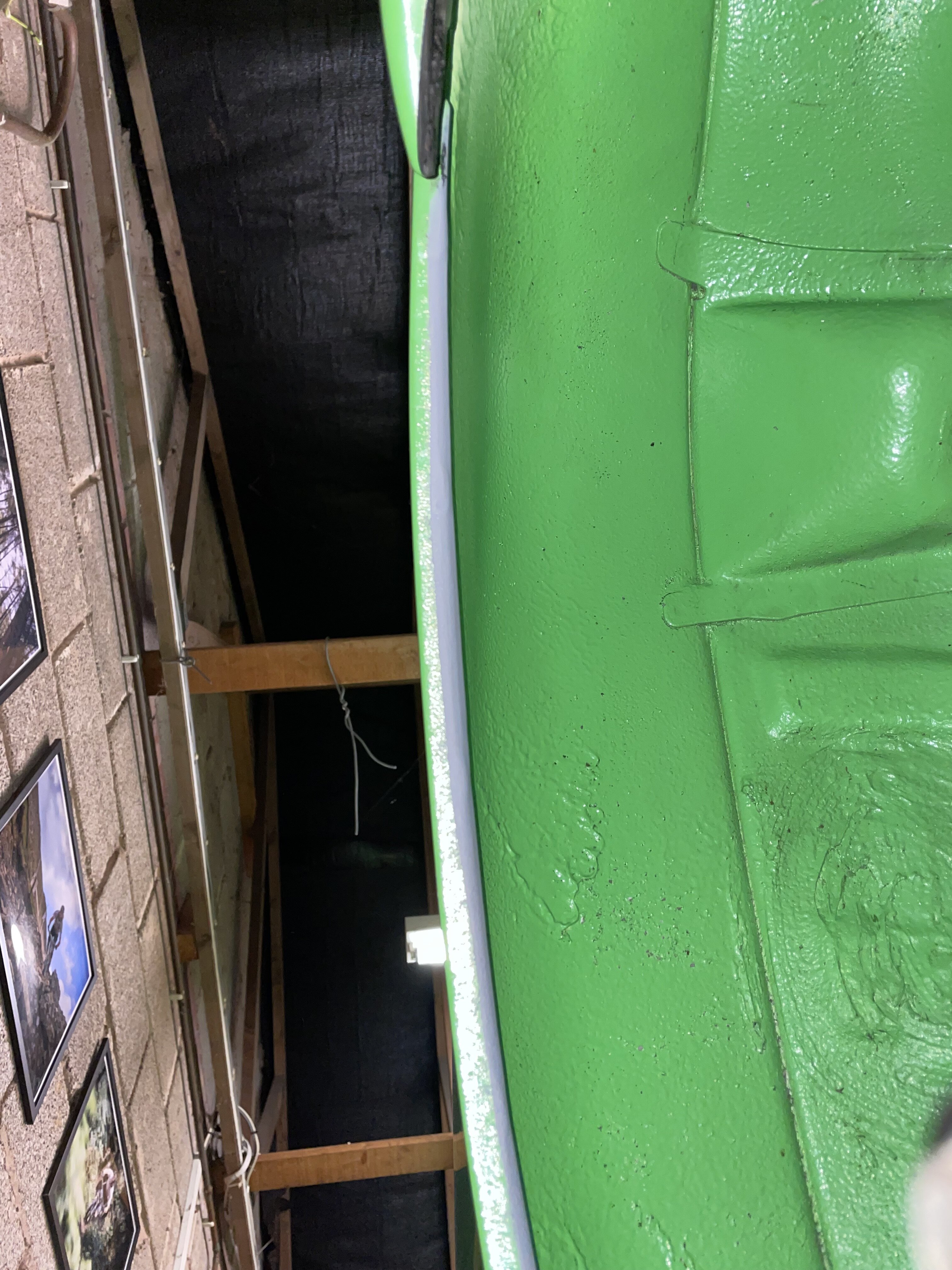

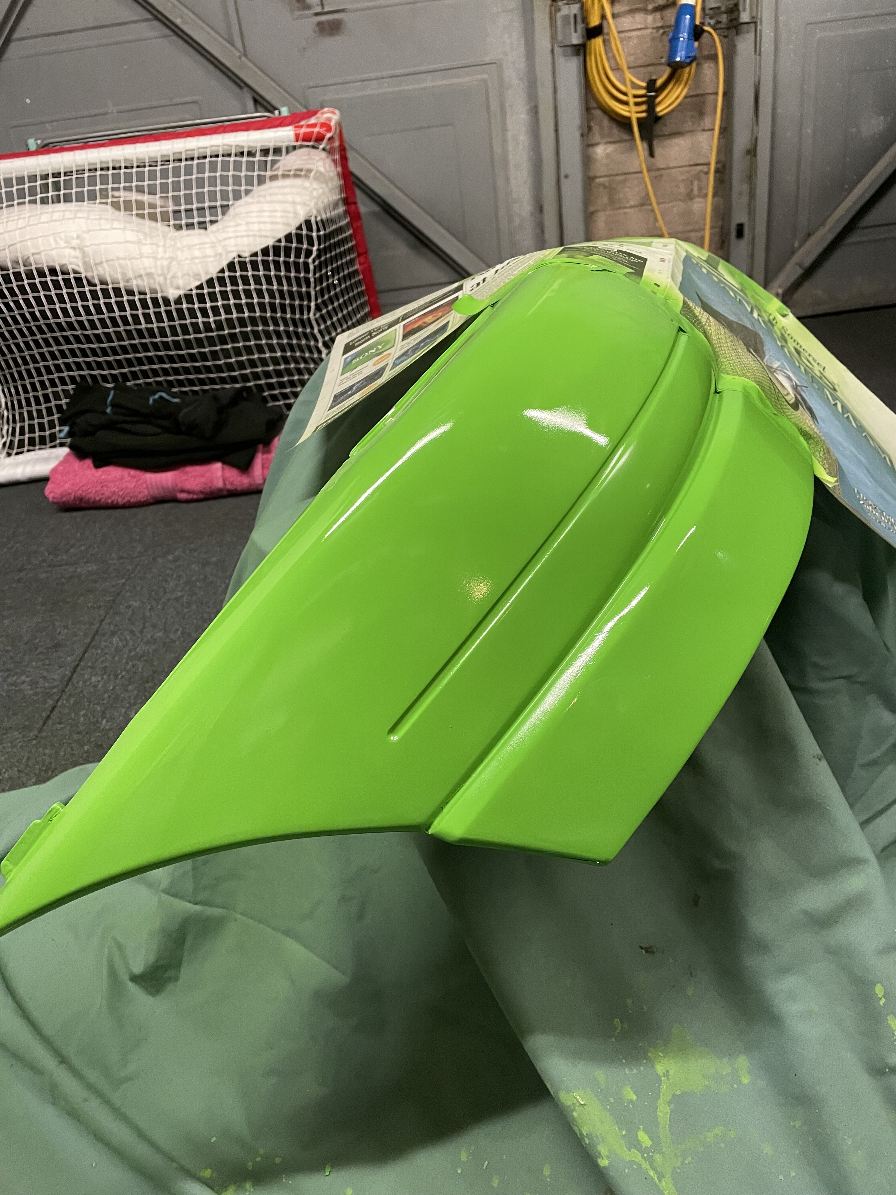

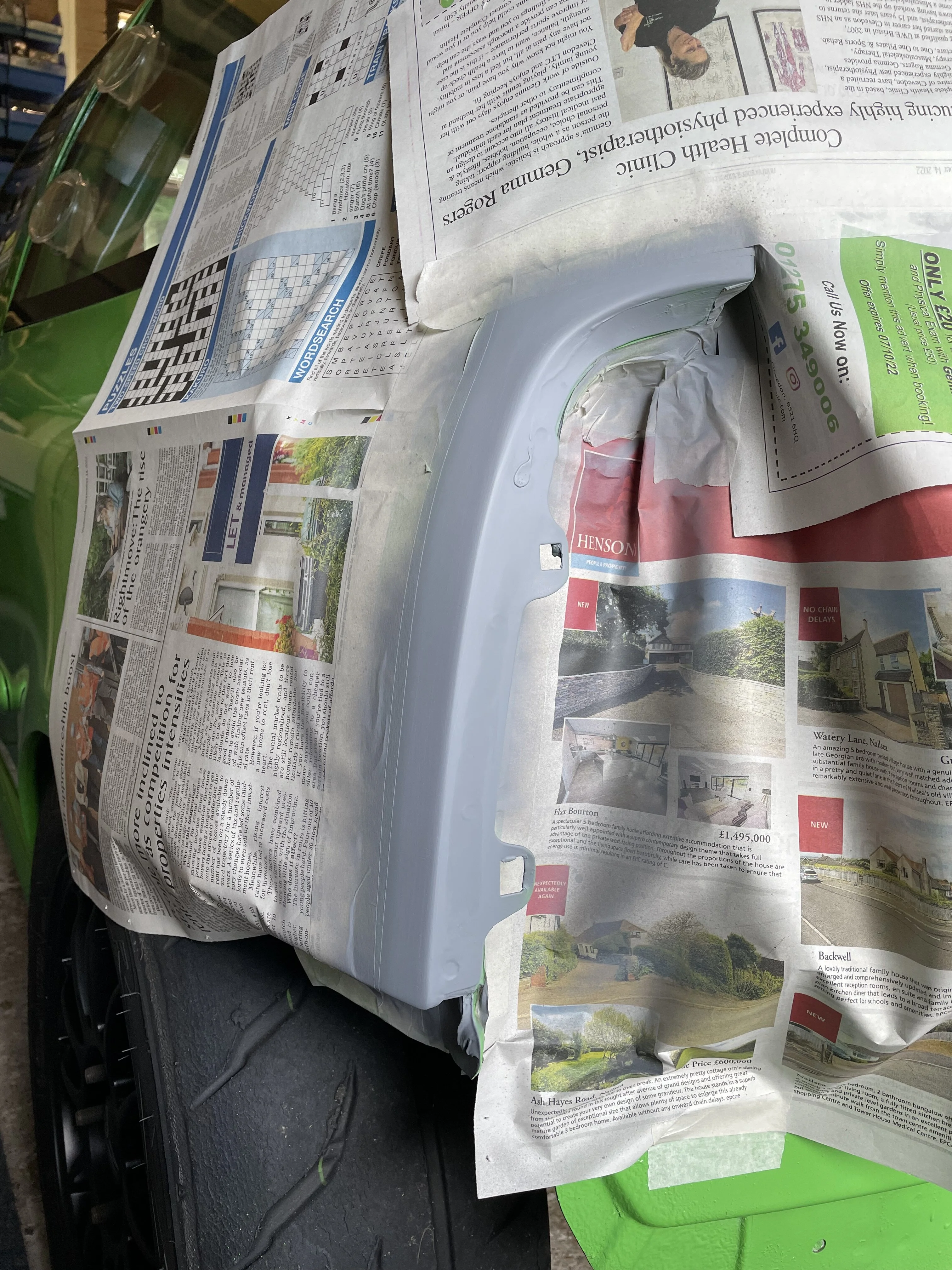

As previously shown/mentioned I really wasn't happy with how the rear quarter had come out so I have had to re-look at that. I thought it was worth 1 more attempt myself before I sent it to paint elsewhere. The car was properly masked up again and then I set about wet-sanding almost the full panel back, prior to primer covering the worst area's, followed by paint (all out of a rattle can).
I was picking and choosing my days as this was now into winter, and cold so I was needing to give decent time for the layers to dry.... did I say dry...
This was when a pipe decided to burst in the garage coating everything in lots of water....
Everything needed a good amount of time to dry out, all the carpet floor tiles came up etc....
I then didn't do anything for a long time... WHY?
Because life... the same reason I am now loosing the double garage sadly. I am going through a divorce and it has certainly been a journey with some pretty emotional moments for various reasons. The family house has been sold and in 1 weeks time completes. I am gutted to not have the double garage space anymore but at least I have a garage in my new rental.

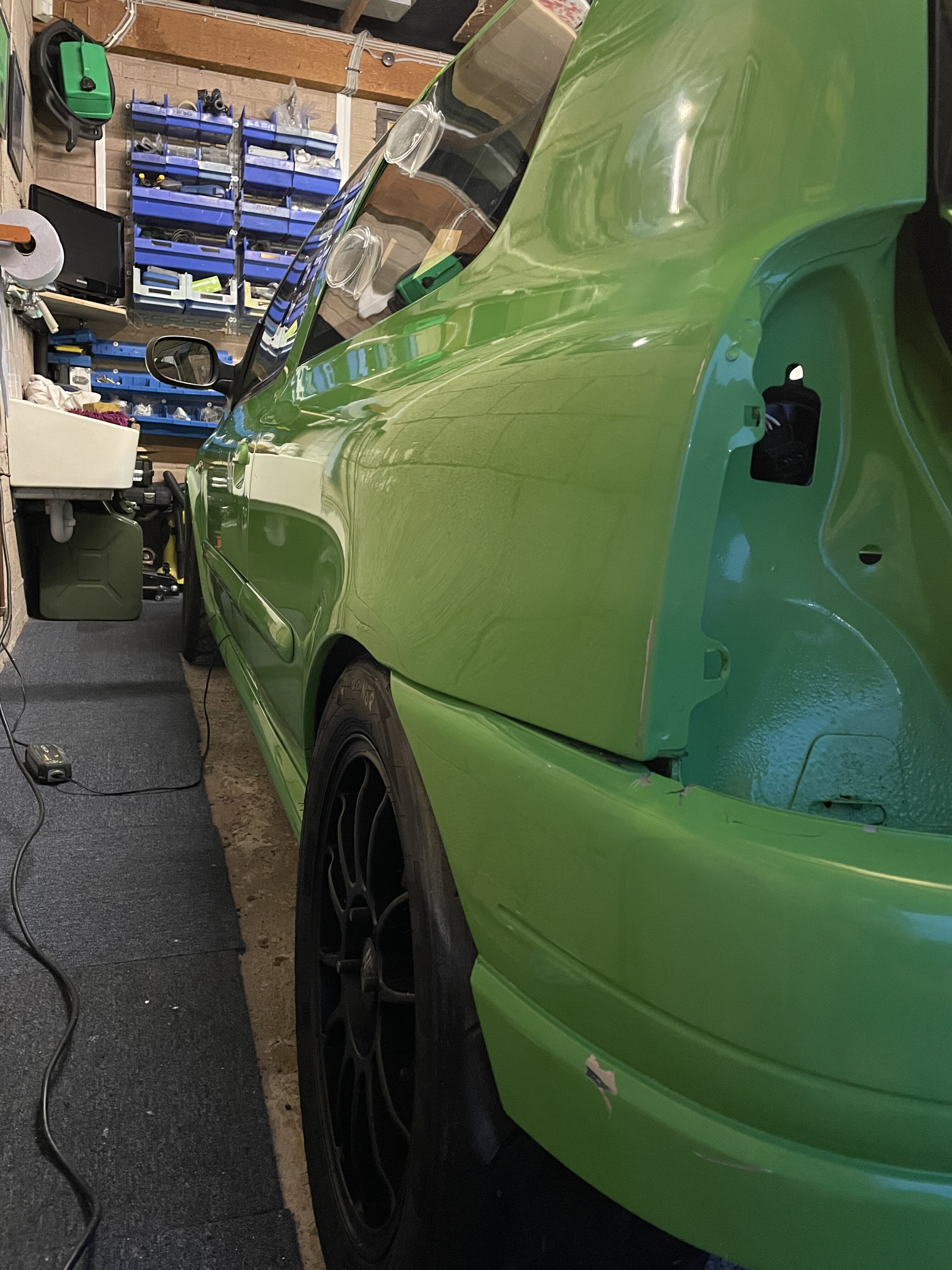

Because I will loose that space I needed to finish the car prior to moving it (for ease). Last night I set about wet sanding and polishing up the rear quarter before then refitting the bumper and testing the lights.
All done and ready to move. The paint is ok... It could be better... But for a rattle can in a garage its alright.
I am looking forward to getting this properly back on the road asap....
