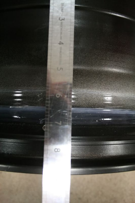

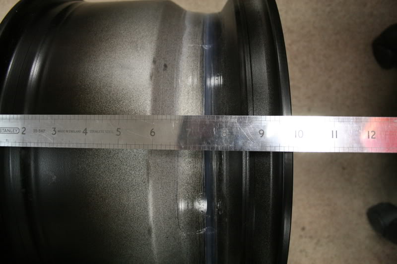

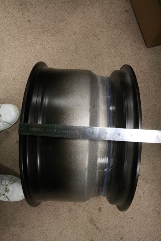

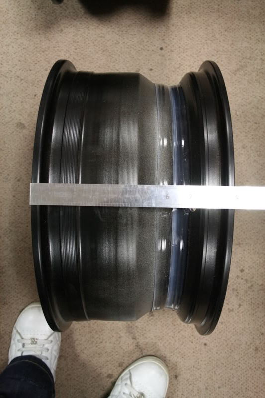

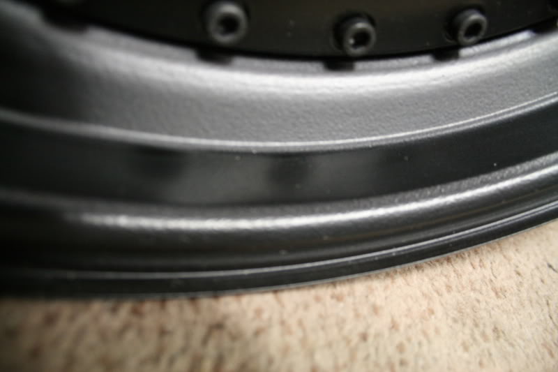

he didn't get back til 5.15 so i got the snaps then had to travel home...
here they are
front
rear

Bloody hell they look really wide, look awesome from what I see, can picture them on car.

8" fronts, 9" rears, they are measured tyre seat - tyre seat, this makes them 9" full width front and 10" full width back, these will have stretched tyres,
ads, they will not be illegal as long as the tyres tread is inside the arches mate, thats the law...just got to get my rubber stretch on

WTF's that stuff on the inside? Looks like silicone sealant.

it is indeed silicone, its because they are split rims, this needs to be on them to stop air leaking when the tyres are on
