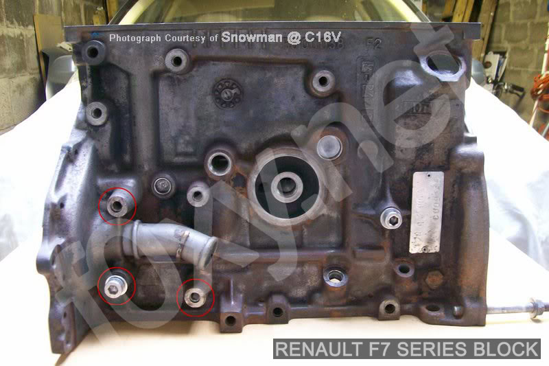

so on the subject of bracing the airbox i have a picture request if possible...
i need a front facing image of a 172 block if possible.....any takers?

this is the an f7 got the same mounting points as a f4 but the hight to the right-middle has the knock sensor

legend...
do you know what bolt holes are used and which are not off the top of your head?

all the ones down the left are used for the pas brakets unless your running none pas then it just the middle-left ones.
not to sure on rest off top of my head but will check for you when i go down to my car today
also thank f0xy and snowman its there pic;)

cool man, i have also posted this in media to get wider opinions, i am looking at mounting something of the block so need to know whats avaliable where...
i am still running the PAS but i am on a cup alternator set-up now

i am trying to work out (if i chose to do it this way) were i can brace the airbox from on the block...
