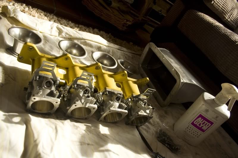

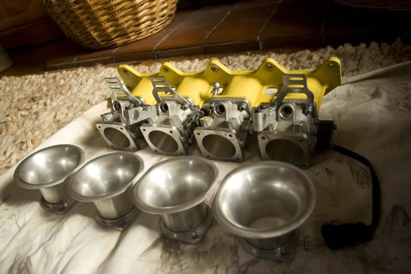

So i haven't really worked on the car all weekend but i did collect the airbox to do a bit on... ie refit the bodies and trumpets to it.
so i got all the bits together and sat at home in comfort to begin...

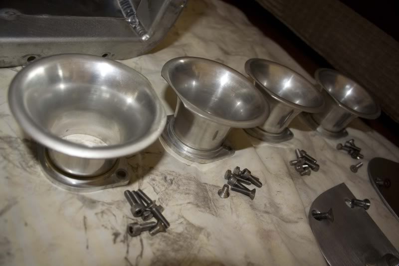

the airbox

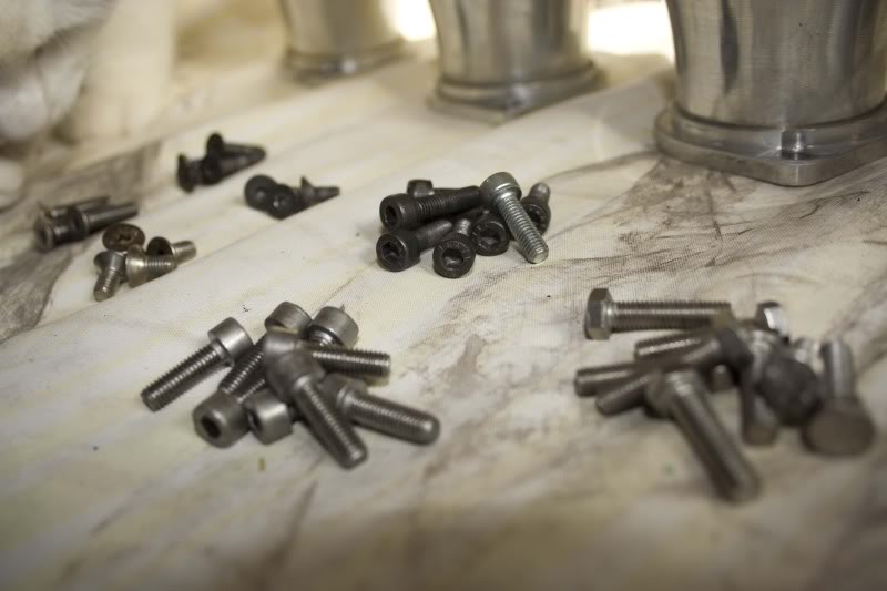

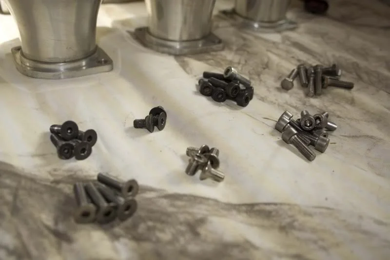

and the bolts, i went out and bought a load of new stainless bolts so they would be a bit stronger, i also have threadlock at the ready...
i sorted all the bolts to go with each trumpet...

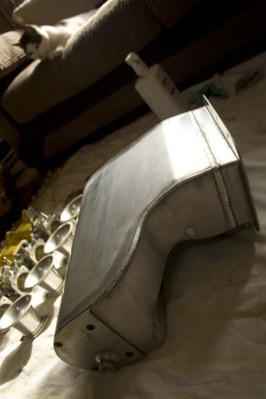

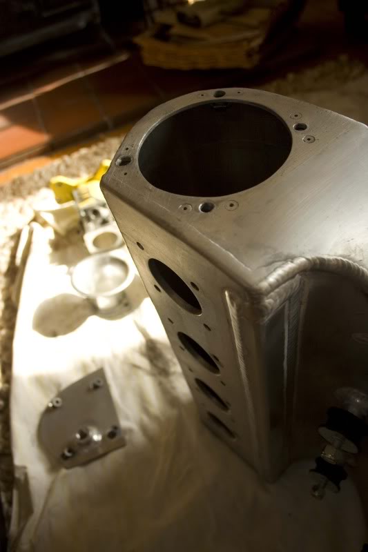

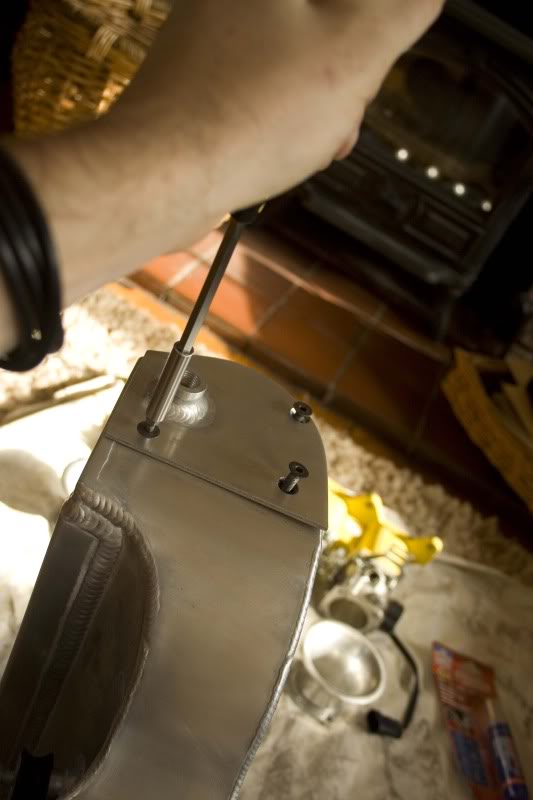

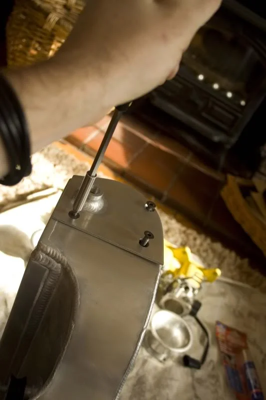

to begin then, first you have to remove each end piece of the box to get access to the inside...

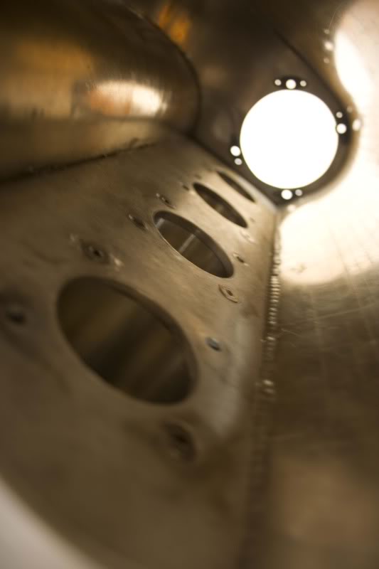

with this done you can then get to all the bolt holes inside, i have to put 2 bolts in per body to attach it them to the box...
all well and good, as you can see here...
until i got to the last body, i am thinking that when i had the box re-inforced it has pulled it slightly as the bolt holes are slightly off, tried varuious things but am really struggling, have now had to step away from it as am getting pretty angry, any suggestions welcome.
Christ that looks like a b*****d to work in!
Consider enlarging the holes in the trumpets to allow a little movement, however you want to be careful as it would be very easy to end up with a trumpet misaligned on the port.
Plan b would probably be to remake the base plate.
Pisser :(
It may of warped slightly when it was welded / heated up?!
Thats what i was thinking, i have dismantled it all again now which was a pain as i had threadlocked all the other bolts, proper fed up with it tbh... Lol
Due to some unforseen circumstances this build could go on for a fair old while now and maybe knowhere near my initial finishing date hope, pretty gutted, various thoughts have gone through my mind today, including breaking the car and selling it all...
If its only VERY SLIGHTLY off centre for the bolt holes to line up I would be tempted to enlarge to bolt holes on the trumpet, but as Tom said that could misalign the trumpet with the port if its too much!
If anything will be drilled it will be the airbox, that will keep anything else in-line. However this is going to my mechanic lol... He can sort it out i hope. We'll see.

Enlarge the holes by .2mm and try again? Also stainless bolts arnt strong in the slightest, black 12.9 ht bolts would be the best bet for strength
Yer i thought about doing that, but i think the rear of the box is warped slightly, there is no point in rushing in and doing things, will get various views first. as for the bolts, i keep saying stainless.... but they are not, i took in the old black HT bolts and asked for something stronger, so far i have only rounded 1 where as the black rounded alot easier...

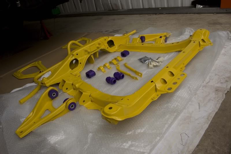

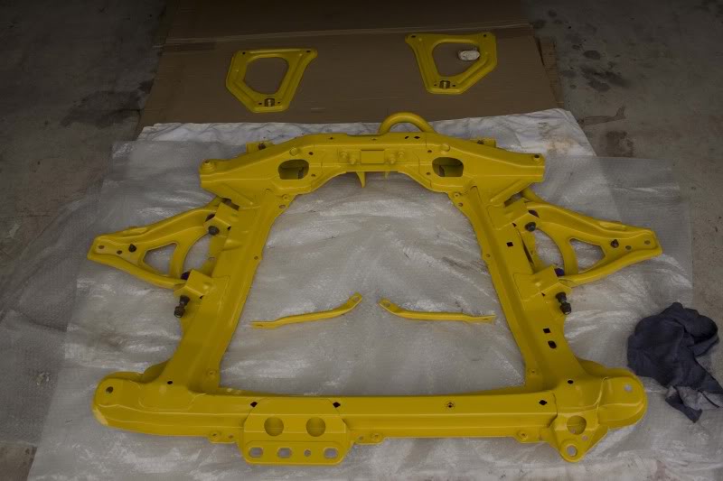

Have spoken to Caged Laser Engineering today and all my powdercoating is done...
will be collecting it tomorrow morning, good timing as the missus is away all weekend, updates will follow this weekend.

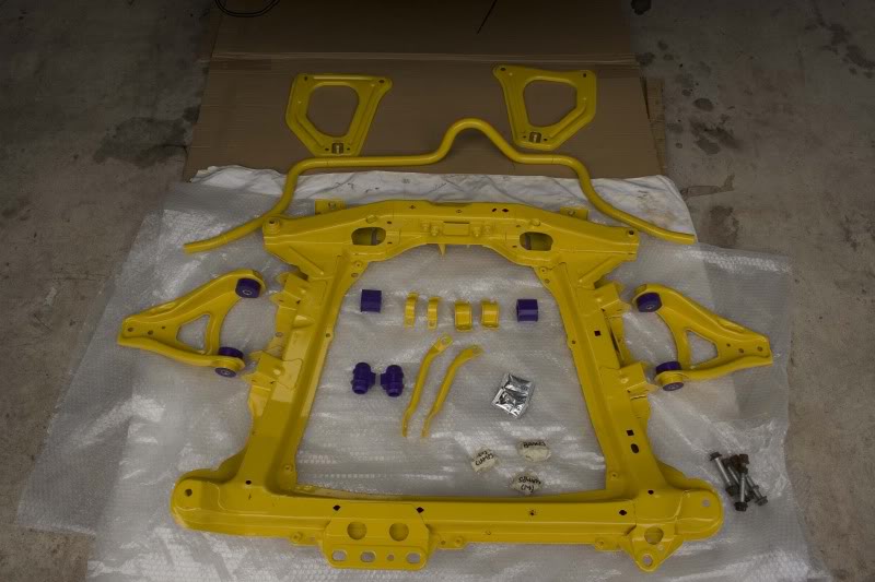

so i managed to get over to Caged Laser Engineering at about 10.30ish this morning so was back to work on the clio by 11, good times....
before i say anymore i must say that this was totally inspired by chris (crispy), great idea from a top bloke who also called back when i buzzed him with a little issue, thank you sir.

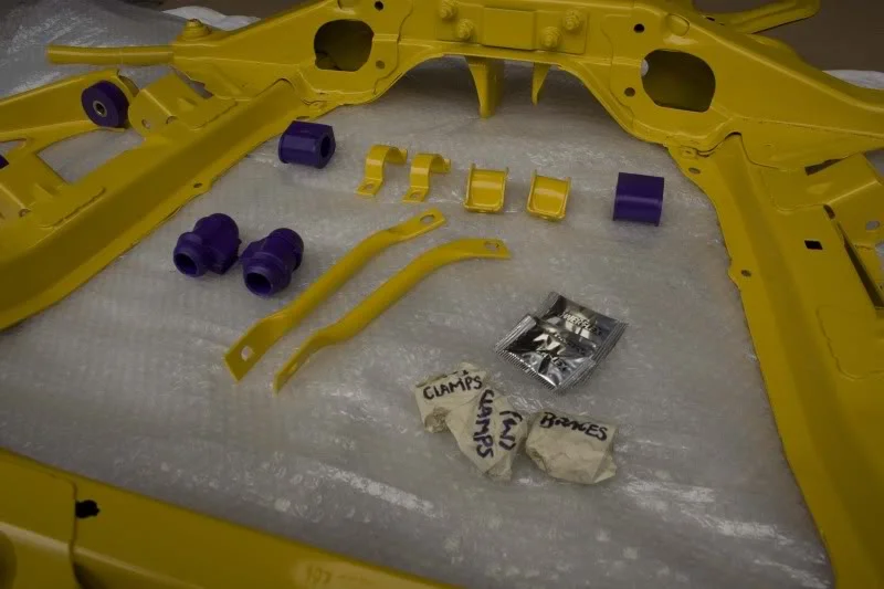

I am very happy with the finish, was all wrapped in bubble wrap too, Caged also welded in the wishbone sleeves and then pushed the bushes in (good service)

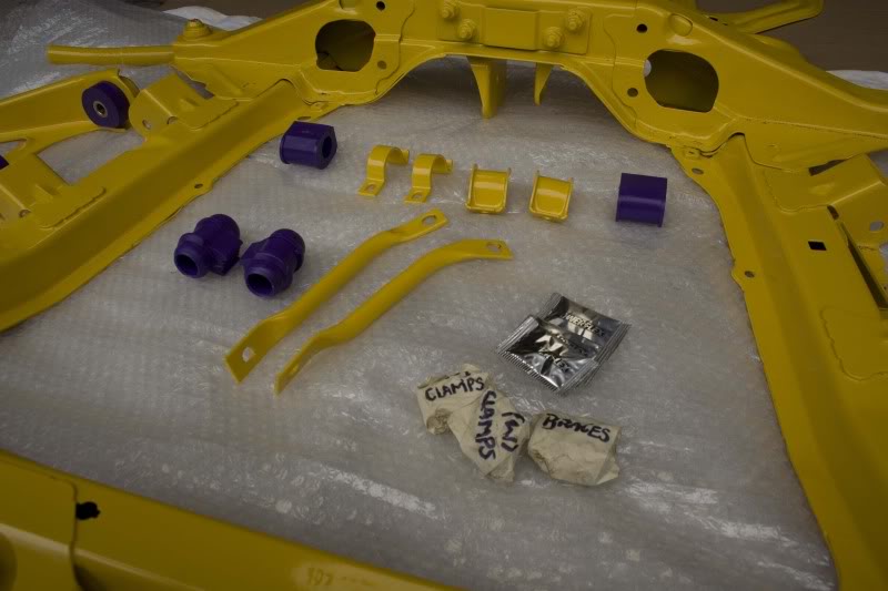

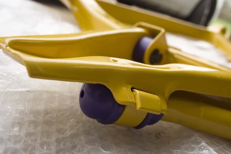

so back to the unit and let the work begin... all the bits, including all the Powerflex bushes i will need...

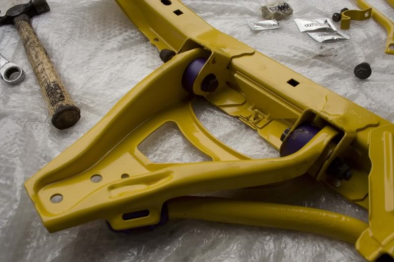

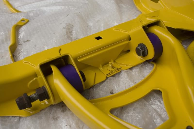

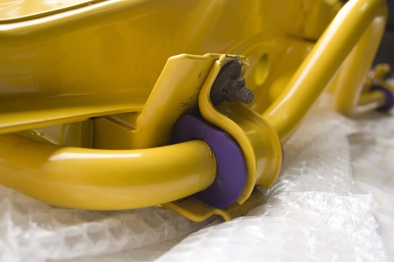

so working my way around the subframe i started with the wishbones...bushes all greased and slipped in, some took a bit of convincing..

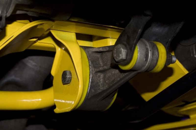

next the rear mounts / sandwich plates to hold the ARB, what a pain to really squeeze these in, a large set of mole grips and 4 hands were needed, anyways, job done....
and finally the ends of the ARB....slide in and clamp, no problem.
all good in one piece ready to go back on,

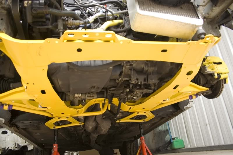

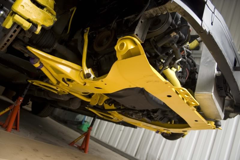

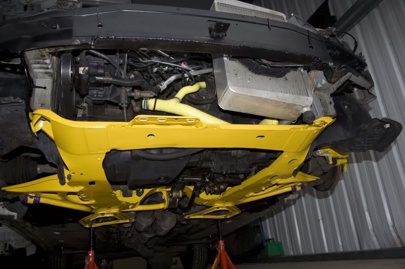

to get it back on the car i got 2 mates to help me also, made light work of it really with the only hard bit being attaching the steering rack back to it but i got there in the end... had to sit it up in, then drop it back down a bit to get to certain bolt holes....
sat up in and all done up with the braces back on
then to put the dogbone mount back on...
and all the attachments on the wishbones / track rod ends...
and jobs a good'un.... very happy with todays progress and how it looks on the car,

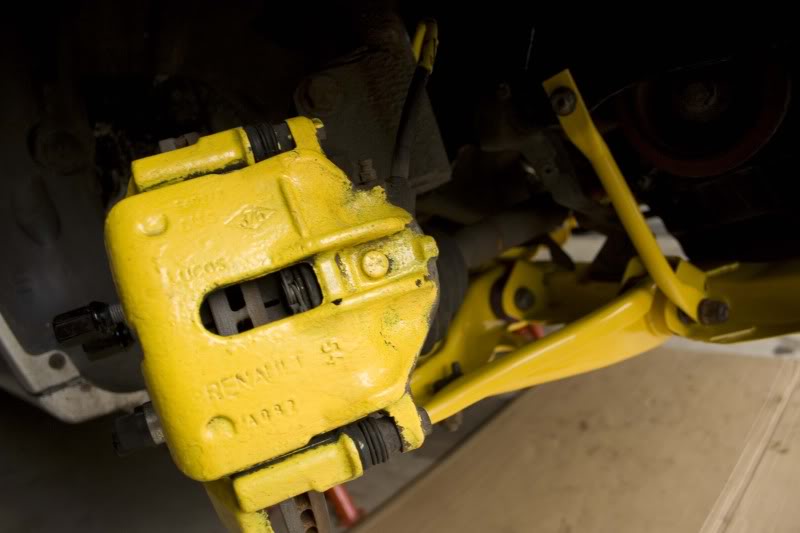

i did start to think about doing the brakes aswell today as the front end is up in the air but i thought i will quite whilst i am ahead....

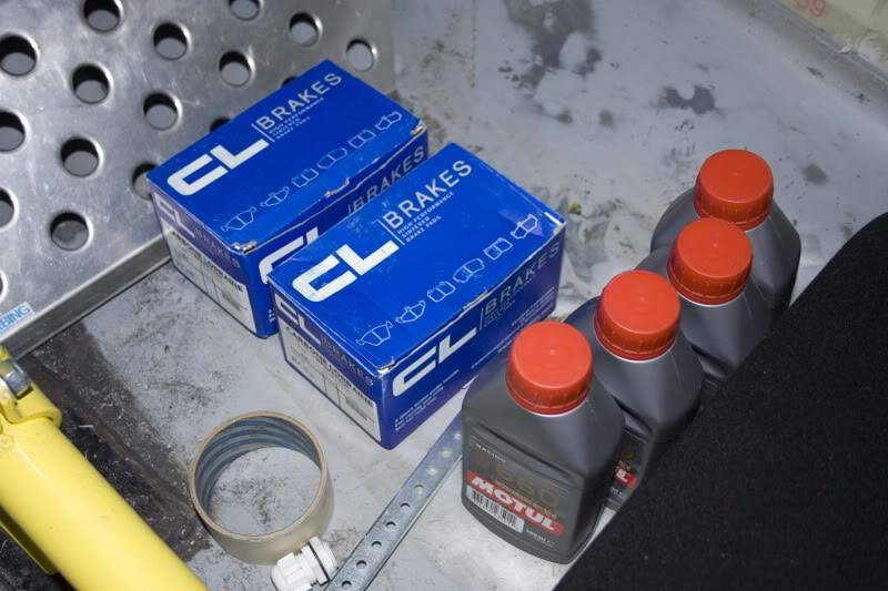

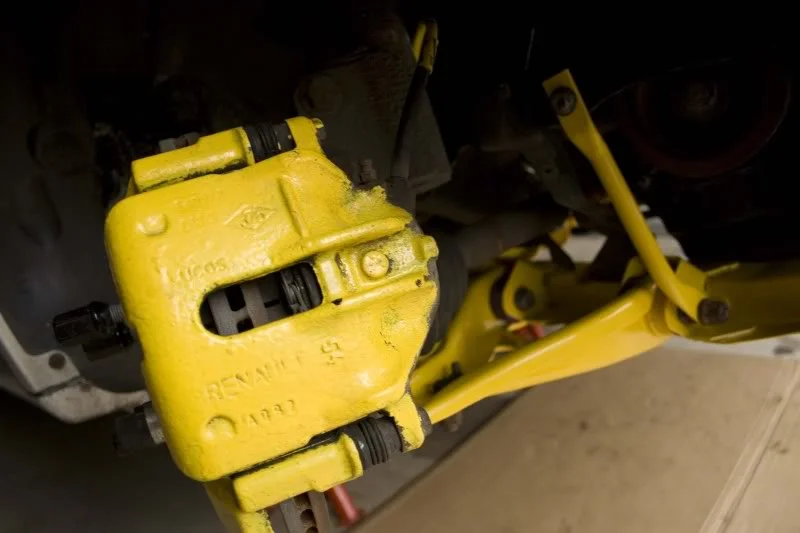

these will be getting sorted next, along with painting the rear beam and fitting the rear Whiteline ARB (now also powdercoated yellow)...
Carbon Lorraine RCE6 for the fronts
Carbon Lorraine RC5+ for the rears
and lots of nice MOTUL brake fluid.....
