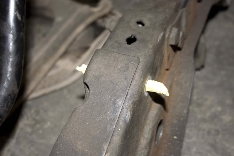

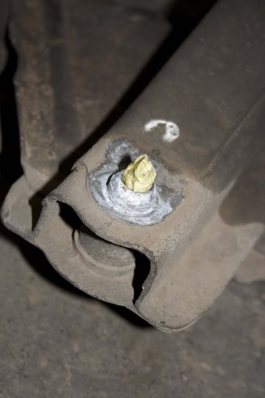

With the powder coating make sure the threads inside the steering rack brackets are masked off. Mine were coated and I had to strip the paint out of them which was a right pain. Also I had every inch or the wishbones coated even the inside of the metal selves, this made it slightly harder to press the purple bush in and made it even harder to push the metal thing inside the bush, just loob it up and it'll go in fine haha.

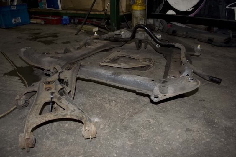

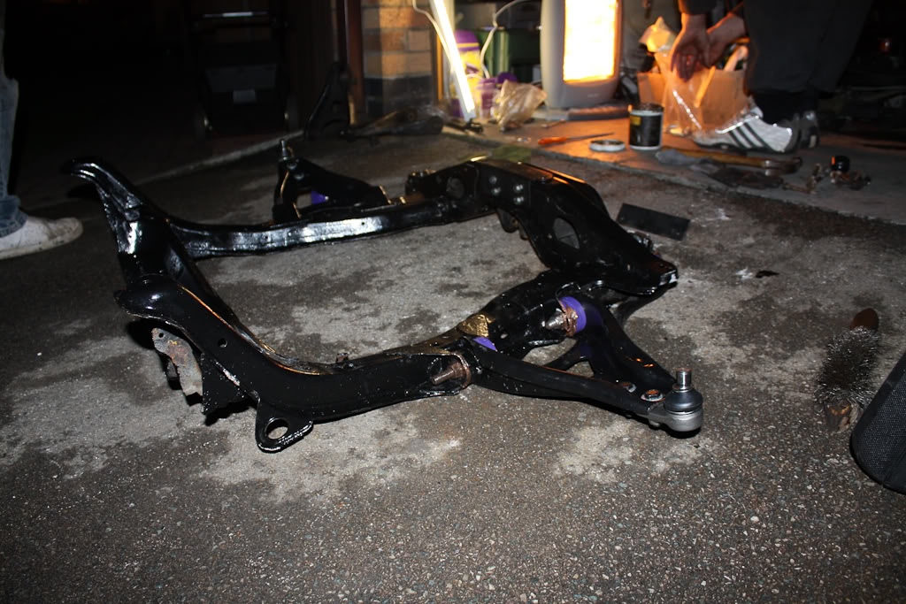

Neil, did it take you long to drop the subframe? I'd like to get mine off to clean it up and have it finished (just boring black, no funky colours I'm afraid)
Going from the progress photo, it seemed to be a fairly straight forward enough job!
Yeah mate its not as bad as i thought it was going to be, mainly down to the fact i had the directions from gray and crispy. Its all nuts and bolts so isn't too bad but i had an impact gun also which sped things up a fair bit... The only real pains are the top steering rack bolts (through the subframe), the ARB, the exhaust and its heatshield get in the way, i have the use of the right tools and i still needed a fair bit of patience.
Don't let it deter you, if i can do it anyone can, just don't try to rush it.

Should just screw a bolt in a couple of threads then take it out once the powdercoating is done, nothing will get in the thread then... I did similar on brackets last time I had stuff done

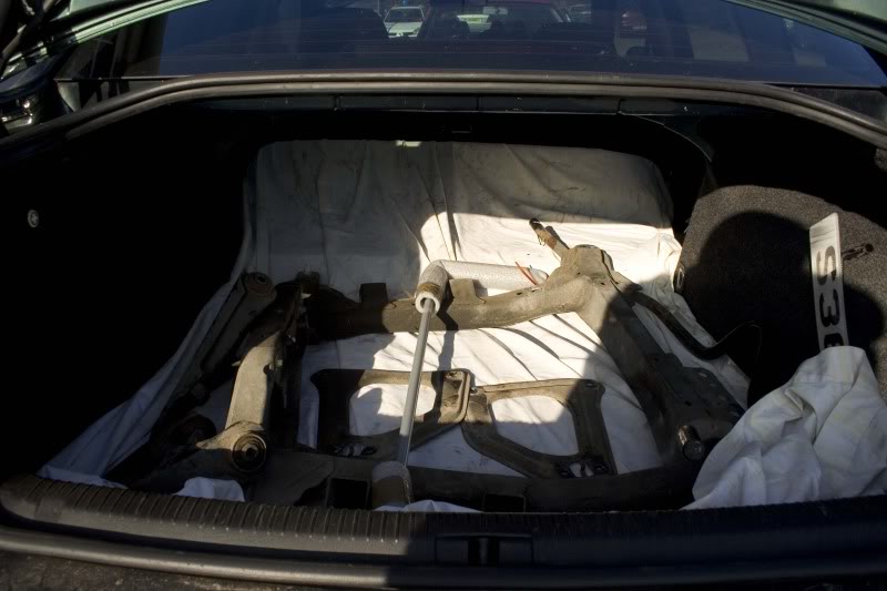

popped down the unit to collect it early this afternoon and to strip the final bits off...
just couldn't press the bearings out of the wishbones so have left them in and Caged said they can do that. happy days
i also bunged the threaded holes i need, hopefully they will see this,
if not sure i will sort something, and then all loaded into the back of the trusty stead along with the ARB from my rear whiteline kit to take across to caged
looking forward to seeing it in the yellow, better get to cleaning the other stuff now though...

Cheers! Hmmm maybe I'll get the subframe off and away to be powdercoated at the same time my intake goes on! Would make sense to do it that way! :)

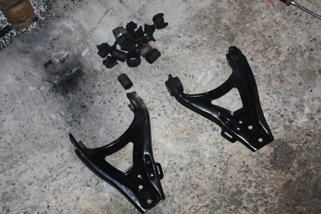

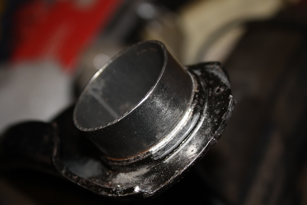

So you getting the wishbones powder coated then tacking the metal sleves in? You'll have to scrape the coating off won't you to weld on? I got them tacked and the coated!
  340i
Re: No Compromise ph1 ITB build (Fastcar, BTM, TDF, RS Fab) - ITB update p77
Get the sleeves welded in place first, then powder coat them :)

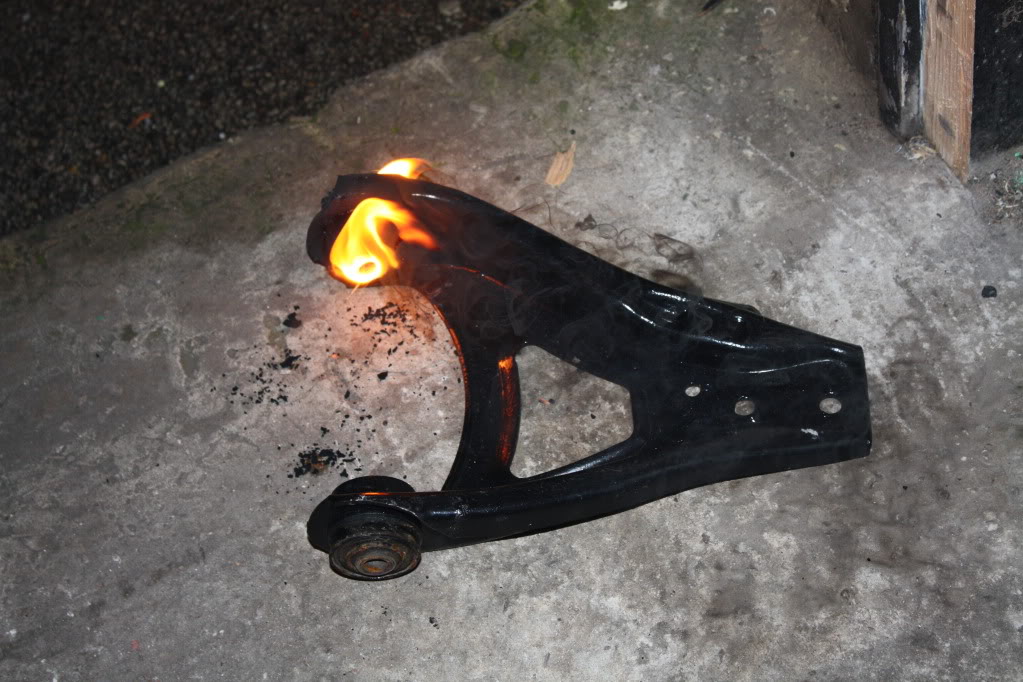

I had mine burnt out. Used a blowtorch :)

To remove the bushes I got a socket of the same size in a vice to press the bushes through, than attack with a lump hammer, BOSH... done

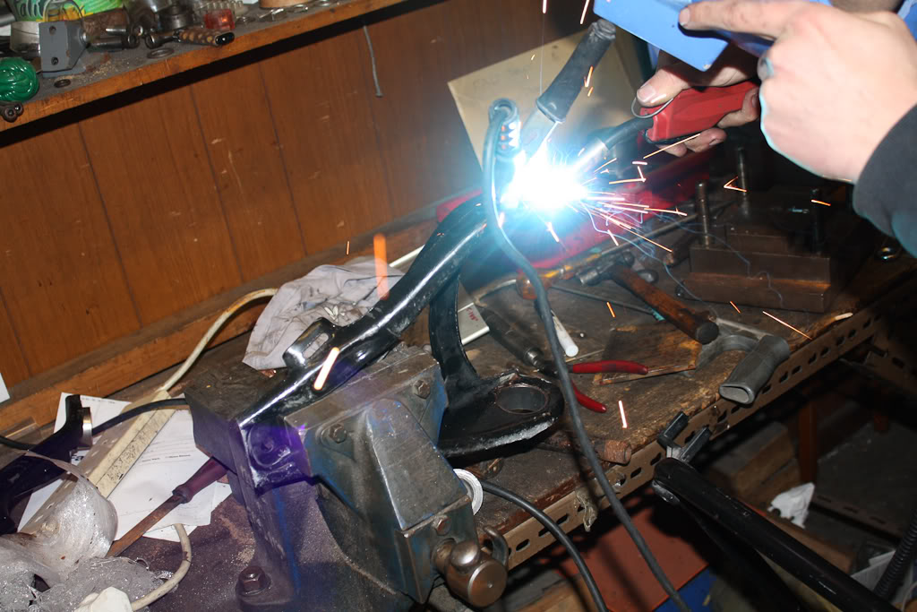

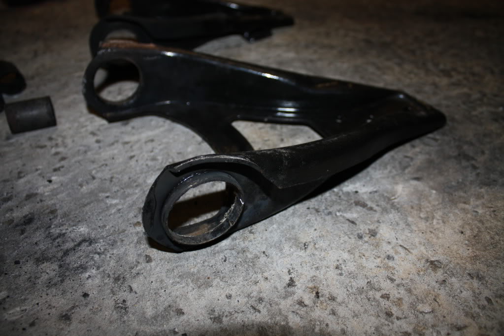

We just got the blowtorch out...
The rubber dropped out...
Then took the blade from a hacksaw, put it through the sleeve and reattached to hacksaw. Cut through the sleeve to release the pressure and it fell out of the wishbone...
Pushed the sleeve in by hand...
Then welded a couple of short runs round to ensure they dont move over time...
*Insert Powdercoating here* then press the Powerflex bush into place...
Done!

It took ages even with a blow torch really (one of the handheld jobbys). Probably 5-10 minutes of heating the rubber to get it to carry on burning by itself, by the time the flames died the bushes literally fell out leaving the sleeve there

Caged said they can push the bearings etc out
may just leave it with them and then just sort my mistake out when i get them back
will just grind a tiny bit back for the tacking....
  TrackCar & F30 330d
But if you do that then those little bits could rust/go manky. I dont know how far Caged is from you but just drive there with the metal sleves and a new poly bush, then press the new sleve in and then slip the new bush in so it sits flush and then get caged to tak them in for you in that position (after you've removed the bush again)
