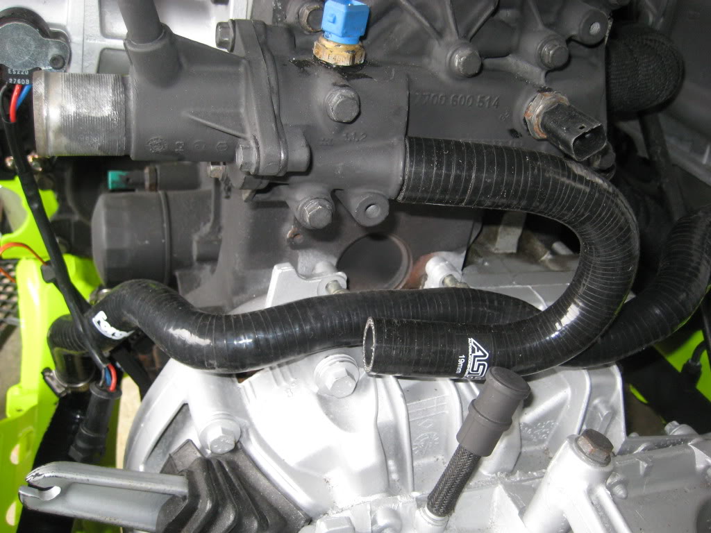

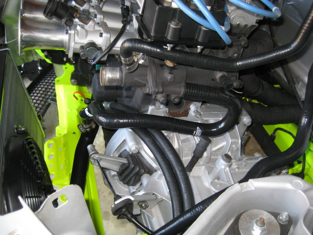

Look in my thread I recently showed how I re-routed/deleted my heater matrix. Buy a 180degreed bend and it makes it all a lot neater
Befor
After
Nafoff
ah.... freaking awesome, right, better get onto samco for some more yellow hose then...

Yeah you will need those parts Neil. 19mm tubing iirc.
You will also need some hose clips too as it might leak if you just push the metal bit in.

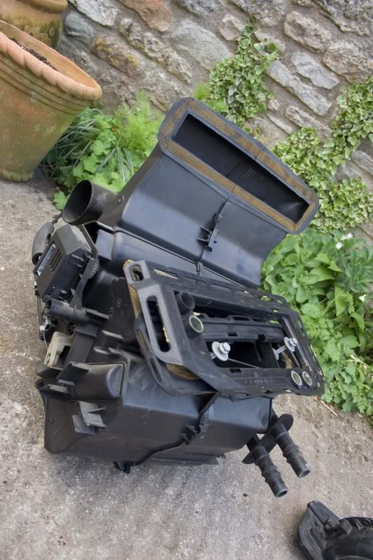

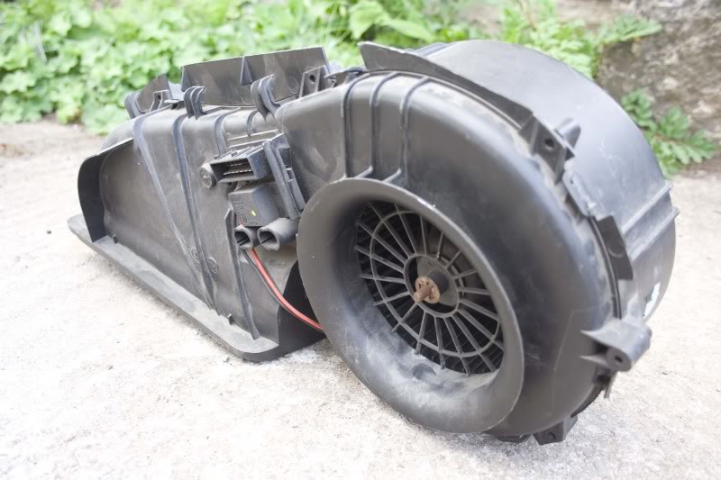

first up i removed the blower/heater bits, this didn't take long as it was only in roughly...(these bits are both up for sale now...cup set-up anyone?)

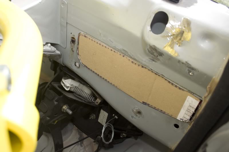

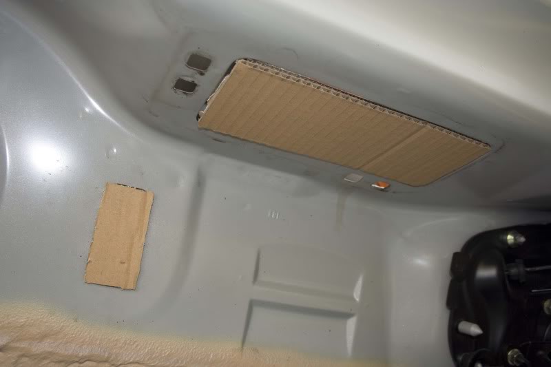

with those bits gone it leaves some nice big gaps in the firewall / dash area so next up was to may some templates so i can cut some metal right to weld in instead...
i am thinking i may leave the tope one, this is only for blowers to the windows usually but i think i may recess my switches here and tuck my wires up in this dash section to keep the interior nice and tidy.

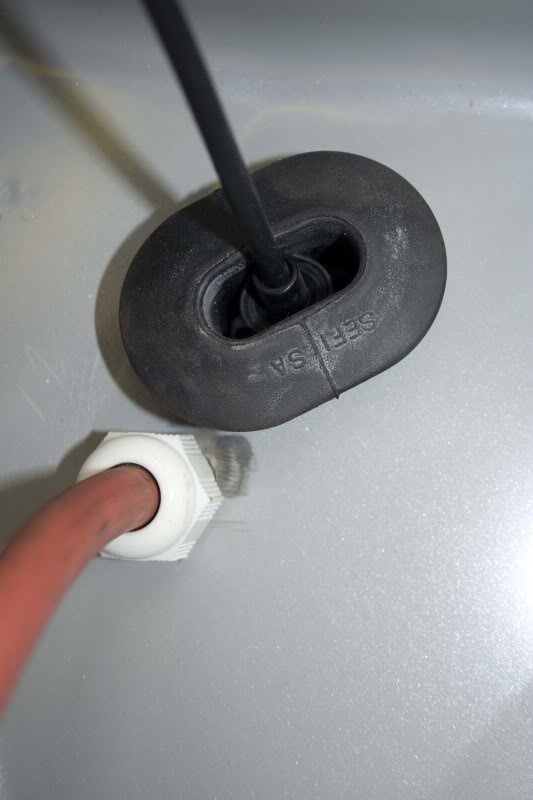

once this was done and set about the other few little jobs i needed to do, first up was the hole where the battery cable was coming through the firewall, it needed enlarging so the gromit could sit in there.... job done...

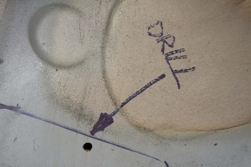

and whilst i had the air-line out i then set about the other holes i needed in the car that i will be bolting the passenger footrest and also the battery bracket too....

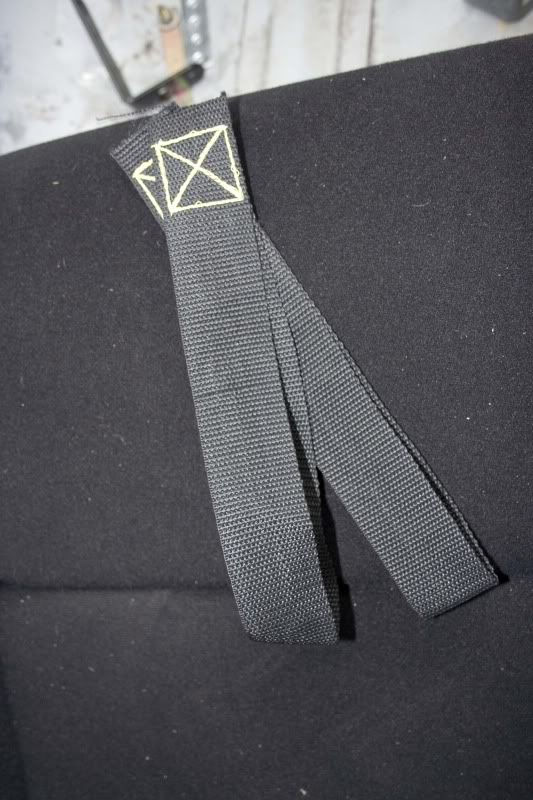

whilst i was doing the brakes my missus also turned up, weird i thought but she come bearing gifts, i asked her a little while ago to make some pull straps for me for the door-cards as she works in soft furnishings i thought it would be a peice of p*ss and it was apparently, awesome,
