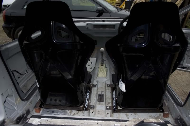

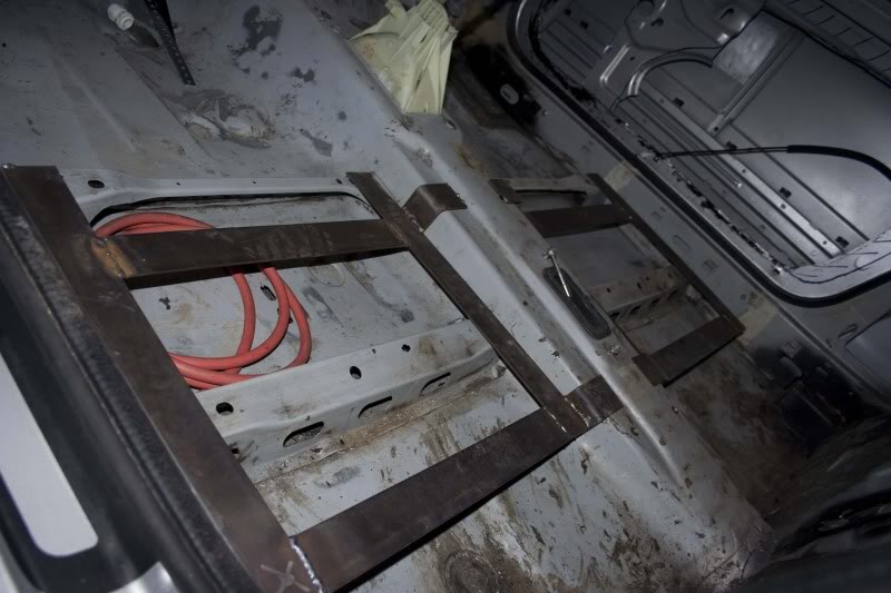

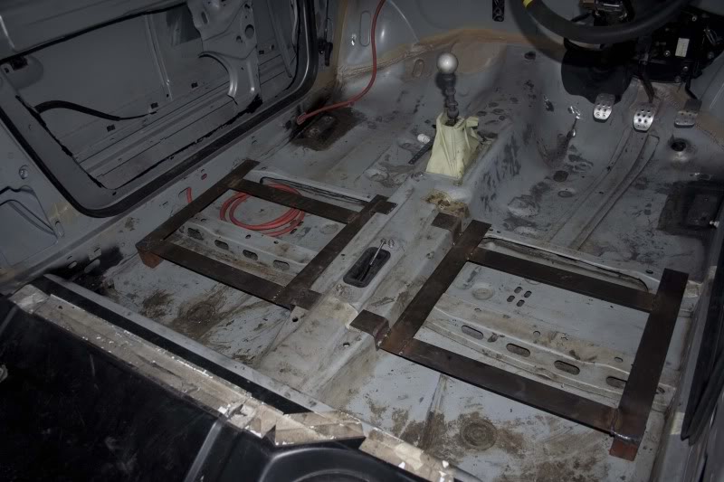

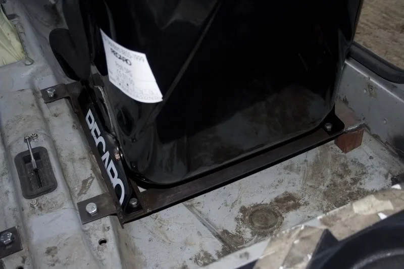

another thing that again i spotted in Kennys thread was the use of seat rails, its nothing new i know, but its something i have thought about for a while, i was picking Foxy's brains on it a while back when i spotted them in his E30, but seeing it done here again just reminded me of it...
as i mentioned at the top i am wanting to do things properly and after seeing these pics and re-thinking my subframes i am wondering about this now, although there is nothing really wrong with my subframes, after all they do the job and will be super-low in that respect however i can't feel a little bit pikey about them for 2 reasons...
With the nature of where the existing mounts are these frames mount to those and then aim towards the back of the car, this meant the seats where mounted back a fair bit, this isn't a problem with regards to the frames as they are nice and solid but with the seats so far back it could cause flex, so we welded on a stanchion on the outer corner to solve it....again this does the job... the second reason was the Hockey-puck spacer, again with the nature of the existing mount points one is higher than the other, i then come up with the idea about using an ice hockey puck (galvanized rubber) trimmed down to act as the spacer, again it does the job but again i can't help but feel a little bit pikey for it....
am i just over-thinking things? or thinking beyond my means?
at the end of the day i don't have any fab skills so everything costs (as i said at the top)
who knows if i will complete it.... or sell....hmmm
if anyone has any experience with making seat - rails t would be good to hear your opinions..
i know you can also purchase them from demon tweeks and the like... anybody had any experience with these?

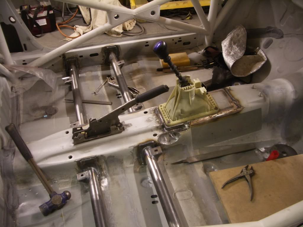

I put seat rails in my track car. It's easy to do as well. Just make sure you measure everything up and get it square to the sills/tunnel. Also make sure the bars are level. I bought the rail kit from Tweeks and found it to be excellent quality.

Regards the seats, I would be inclined to put seat rails in, as much as you perhaps dont want to, you need to consider the worst case outcome, In an accident, the harness will take a lot of the stress but the seat needs to be solidly mounted to provide you with the best level of protection. If you intend to compete with the car, it's probably worth having things like this done now, doing things right the first time ultimately saves you money.
As I mentioned I my thread, if you have any specific questions regards putting the rails in, ask away and I'll do my best to help. You dont really need any fancy tools, just a angle grinder with a few flap discs, so much better than a grinding disc regards finish and control, a few files, hack saw, drill etc. If you can get them all cut to size and ready to weld in that will save a heap of time, assume your mate has got welding facilities?

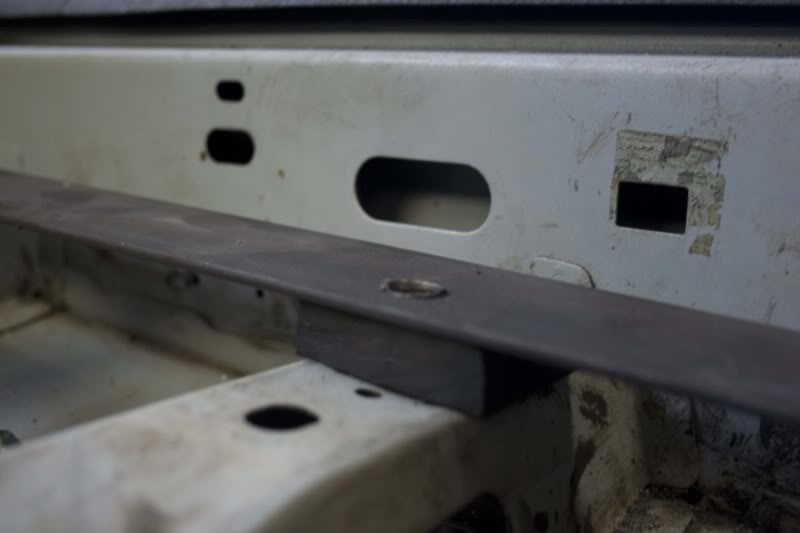

The rail kit I bought uses the 25mm tubes and it was the cheapest as well iirc.
Yeah it comes in separate pieces so it can be made to suit all different widths of sidemounts. You drill the holes for the tubes to pass through, then put the strengthening plates over the tubes/holes and weld them on. All that's left to do then is offer the sidemount locating brackets on with the seat and sidemounts and weld into place accordingly. Took me about 1.5hrs to do both sides.

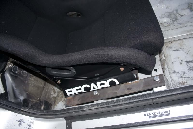

not sure what kit he got but i recently fitted some to a clio Matt @TDF id preparing and they had some nice captive nuts that floated side to side to accomadate varios sidemounts/seat widths.. think they were £50 a side from memory...
when i did his old Xsara i welded in some 30x30x3mm thick box section and drilled thru that..
on my car i used some 40mm diamter tubes (old OMP doorbars from memory) and then got the tabs laser cut to TIG on:
you can make them by holesawing/disc cutting box section but tbh the laser boys only charged a quid each...

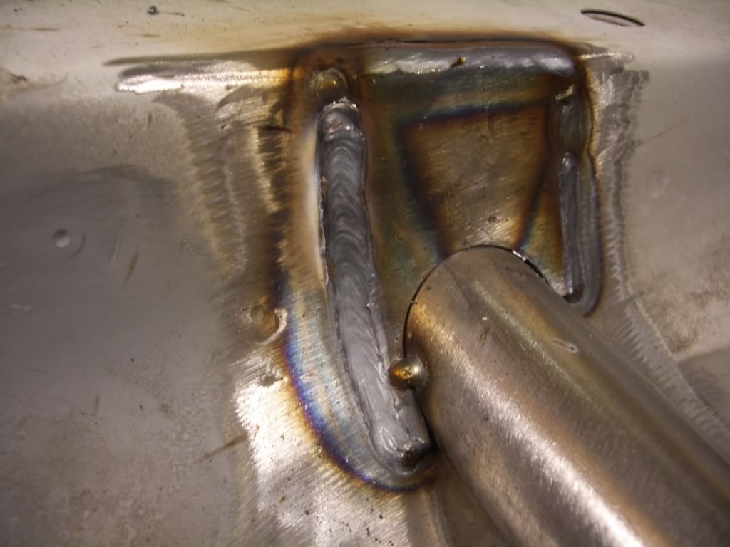

ahhh, so you have to drill through the inner sills and then the exhaust tunnel and slightly slot the tubes through?...correct?
do you then weld the pipe in before you put the strengthening plates on?

I only welded the tubes to the strengthening plates after they were welded to the shell. I didn't weld the tubes to the sills/tunnel as the hole needs to be bigger than the tube to get it slot in. Make sense?
it does make alot more sense as you say.
so, you drill holes into the sill side and then through the exhaust tunnel. But where the tube is in the exhaust tunnel, surely thats left open (so the inner of the tube is open to the elements).... that can't be a good thing
NorthloopCup
so, you drill holes into the sill side and then through the exhaust tunnel. But where the tube is in the exhaust tunnel, surely thats left open (so the inner of the tube is open to the elements).... that can't be a good thing[/QUOTE]
Yeah the end of the tube is open to the elements but there's not much weather that would reach the insides of the tubes due to the close proximity of the exhaust and it's tucked up in the tunnel. You could always weld a blank over the end of the tube if you were that worried, or just underseal it or waxoyl it?

so i have pretty much decided that i will be going with some weld in rails from demon tweeks, just need to keep an eye on my fundage and will probably get them ordered asap.

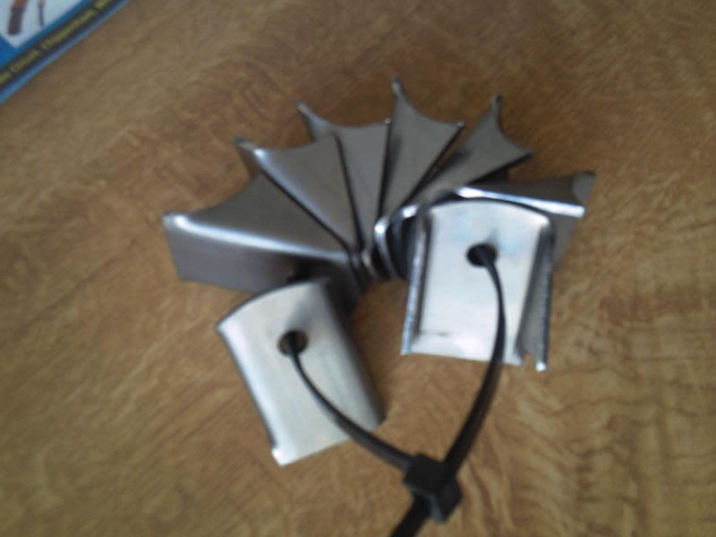

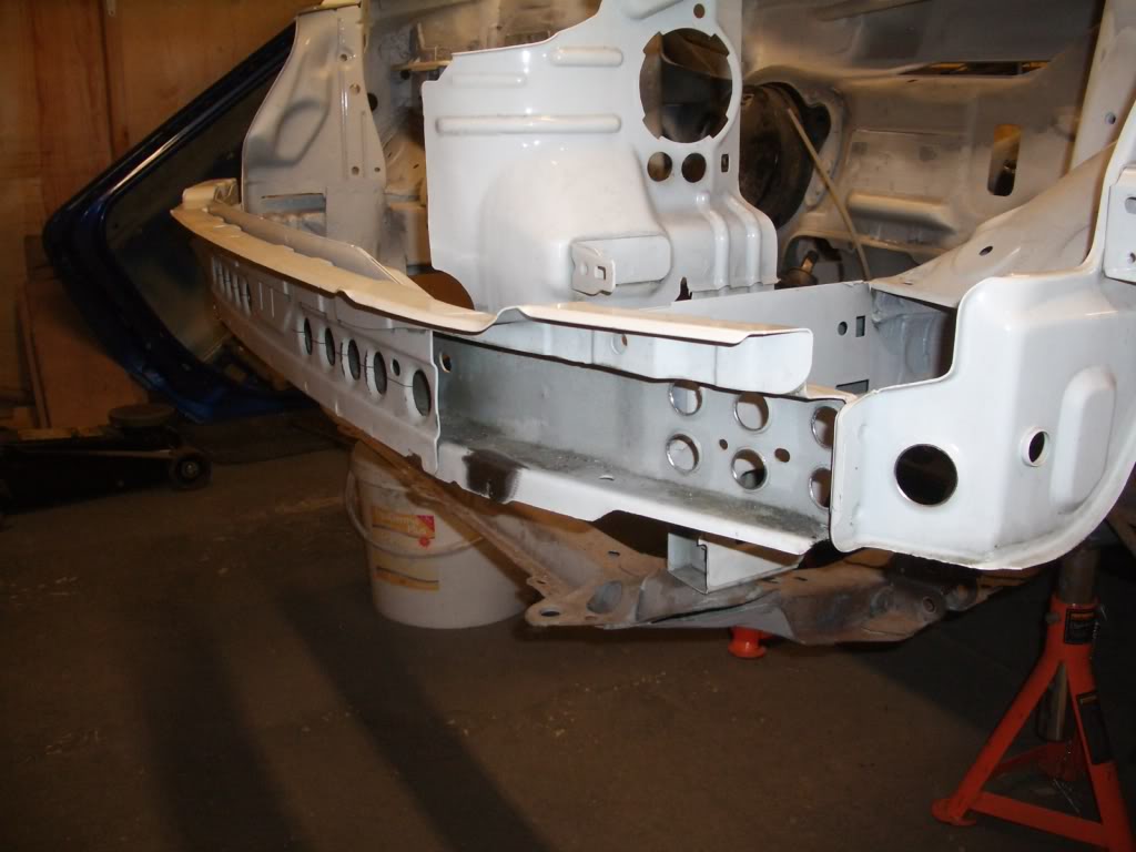

What bits on the car are you wanting to flare? The ebay ones will be fine for thin stuff
I was looking to totally playgourise (spelling?) your idea of drilling/flaring anywhere i can really, cross-member, doors, tailgate etc. I may end up buying/using the ebay ones, however it seems pointless for just 1 application.
if you know someone with a lathe i have some drawings somewhere in CAD to make your own... its what i did...
Sounds interesting, by saying that you have now made me consider another mate that may be able to help, i may get back to you.
  Audi A6 & 172 Cup
The ebay ones should be fine for thinner stuff, doors etc but as they're made from ally, I dont know how well they'll cope with doing the front crossmember, might do it but got a feeling they'll get mashed up doing so.
The 30mm one I made is just mild steel but has a noteable mark on it from doing the crossmember, on the last hole I flared on the crossmember i put a smear of grease on all the contact faces and oiled the bolt up, definitely helped.
If you know someone with a lathe they're dead easy to knock up, I just did mine manually on the lathe but CAD would obviously be better if you have access to that. Dont imagine it would cost much to have made, and would mean you could have them made in steel. Plus if you did that, you could probably sell them on once you were finished with them.
I recon 30,25 & 20mm are all the sizes you'd need to flare which ever part of the car you care to put a hole in.

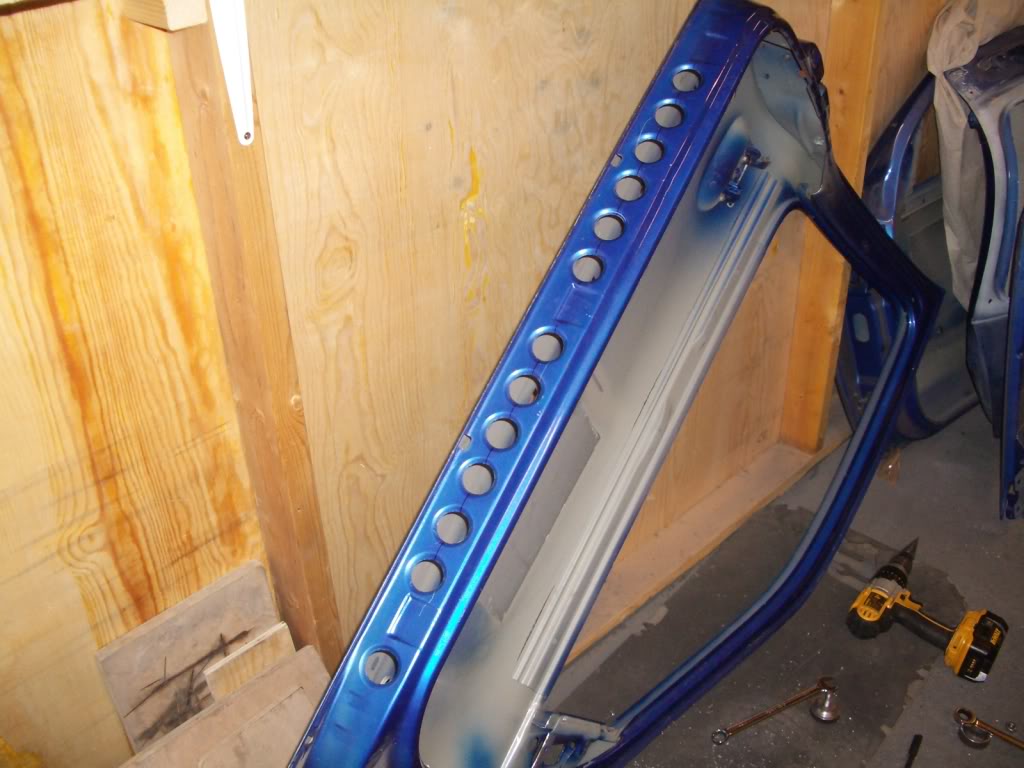

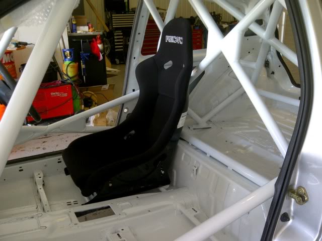

spoke to my mate (painter/bodyshop) and un-expectedly they have drilled out the seat-rails, happy days, saves me that nasty job...
will be ordering the demon tweaks set up aslong as they fit the recaro widths, then will sort all the other interior welding out...
need to decide on a final colour soon too
Nafoff
I have pole positions so thats sorted.

as i said the seat rails have also been drilled out....
