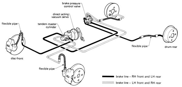

this is a diagonal spilt service brake system with load sensed (compensator) rear axle
this diagonal circuit is preferred due to the fact that if you burst a front hose you still have some braking nfs our for example where as if you do a simple from treat split you will only have the rear brakes and we all know how poor they are.

this diagonal circuit is preferred due to the fact that if you burst a front hose you still have some braking nsf our for example where as if you do a simple front rear split you will only have the rear brakes and we all know how poor they are.

If you are starting from scratch mate, I personally would pipe it all in with a bias valve. The compensator is piped up as a diagonal braking circuit, so it can cause headaches when you decide to get rid of it, not to mention money and time wasted!
Ahhh how did i nearly miss a good brake debate... lol
If you remove the compensator valve youll need something else, as a bias valve (ap racing) didnt reduce the braking effort enough.
I use 2 x inline Ford pressure reducing valves, along with a bias valve, now works perfectly at long last.
I've just got the compensator and nothing else, after I fiddled with it, and set it in one place, the braking is mint. No rear lock ups!!
A long m6 bolt and a couple of nuts with loc tight. simple.

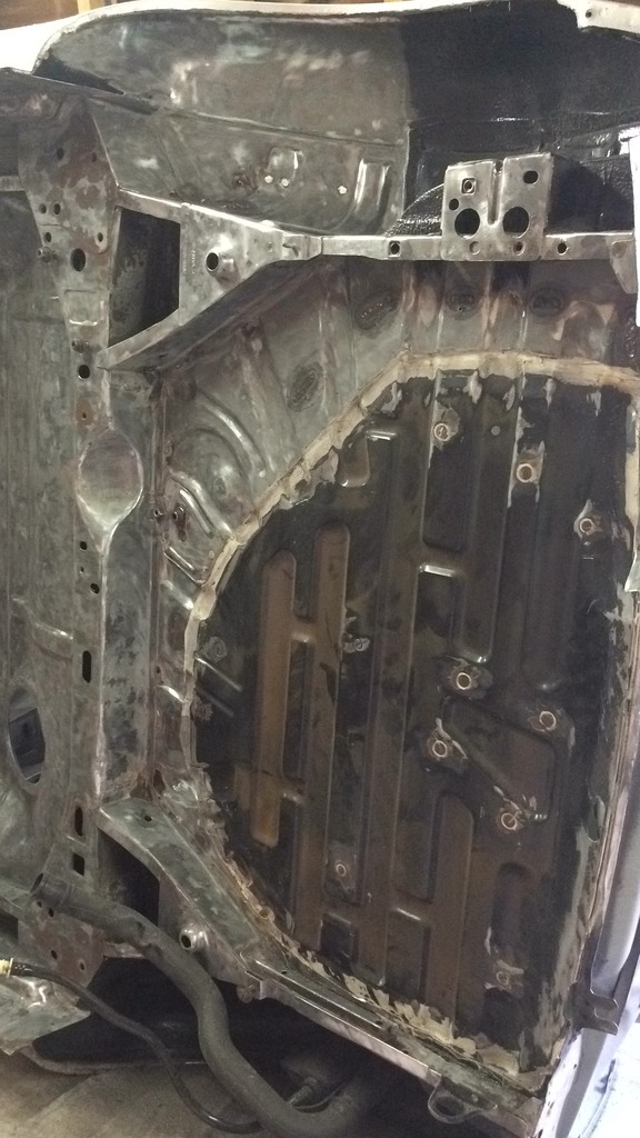

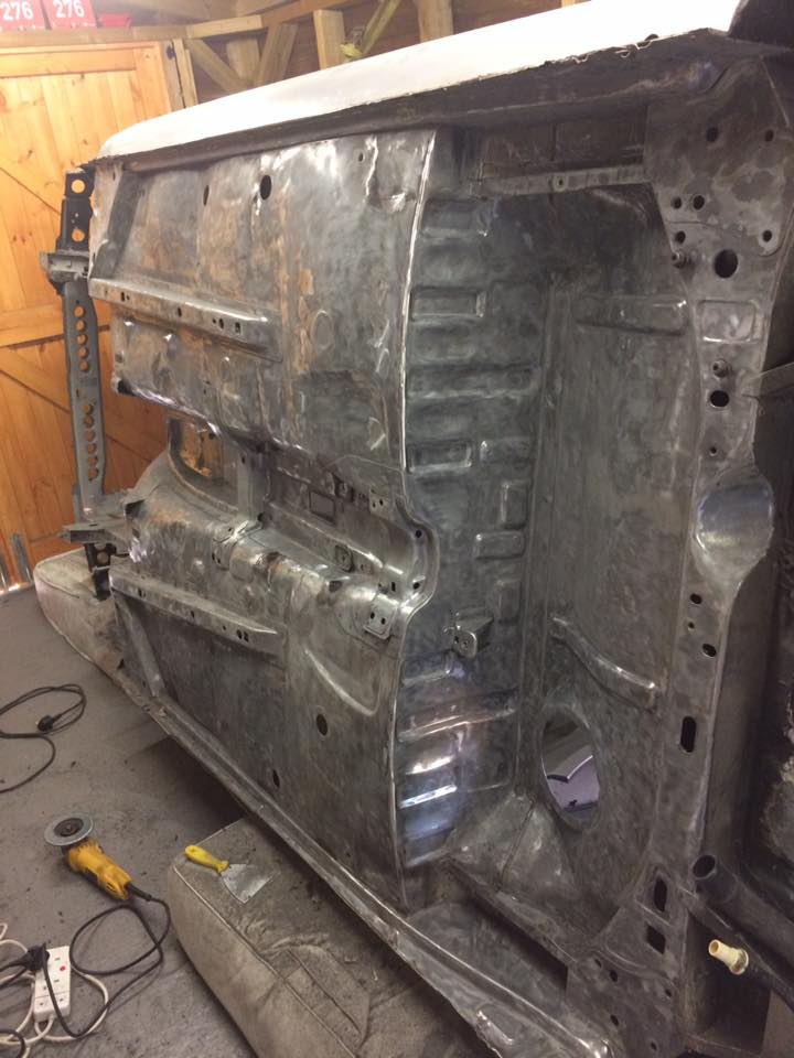

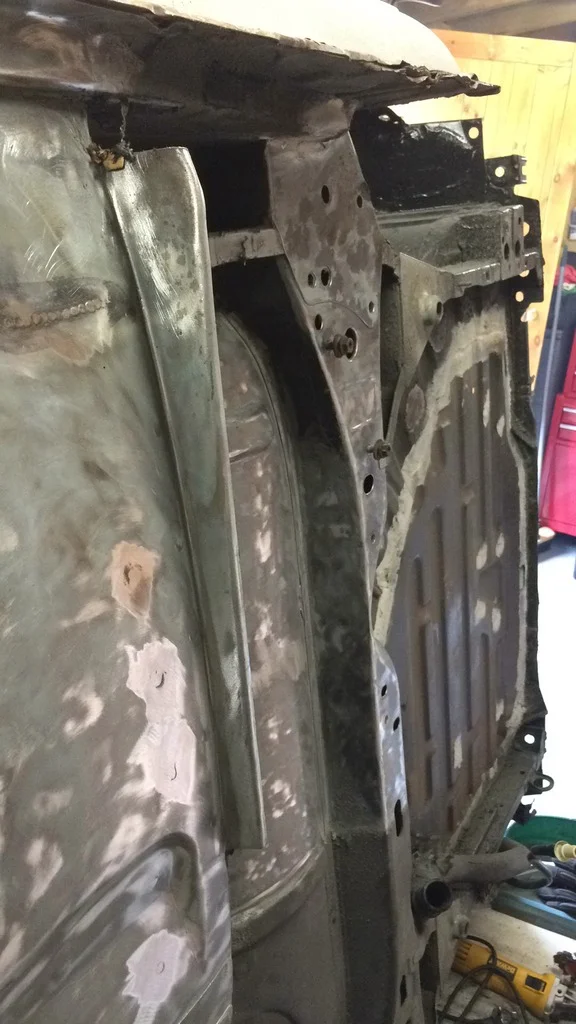

My old Rally Escort was stitched welded, just to allow a little flex, otherwise you would get windscreens cracking after a big jump. Tbh modern shells, esp Clio's have really robust shell anyway.
Fair play for tackling the sealant like that. I would have just sent it to a blaster lol.
I saw a bit of a seam welding chat and I would be interested in what problems your friend thinks it could cause?
My OCD wouldn't let me not do it now you have it completely apart!

Tony plus a few other peoples opinions (people who race track and rally events) advising not to bother for various reasons (a few pages back i think). I was initially thinking it would be a good idea whilst i was here, but on reflection and speaking to various not doing it also makes a lot of sense. Its similar to the thought process with aero.
With regards to OCD, i am full of that so everything is being massively considered, want to do everything properly once - lucky i am in no rush... ha
The silver Ph1 with the rear difusser.
I think i am going to remove it though and just keep with a cut bumper
Fair enough. I would do it myself. The car is totally apart and every little helps. You can only really do the shell once, so it's best to do it right first time in my opinion.
This comes from someone who has a lot of background in engineering and motorsport by the way. As I say, my OCD wouldn't let me not do it lol.
Totally appreciate your advice, and that was my thought process (i will only do this once), but the other part of my thought process is will me and my driving ability even notice the difference....
Oh definitely not, but it's nice to know it's right, just for nerd factor lol.
